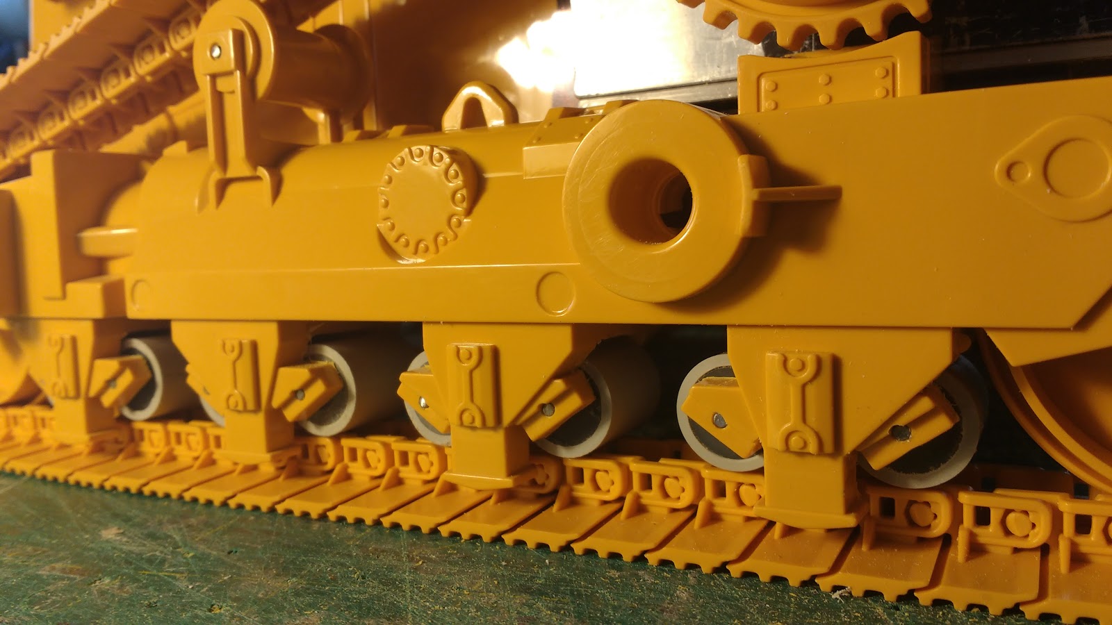

The Bruder dozer has molded-in fake rollers that the tracks just slide over.
I wanted to reduce the friction so I decided to try and modify the track supports and add actual rolling rollers.
I hacked away all the bits of ABS that were the non-functioning rollers leaving the support brackets.
These were then drilled to take a 2mm piano wire pin cut with a Dremel metal cut of disc.
The rollers needed to be 16mm in diameter, I had some 12mm PVC rod and then found some PVC conduit in my stock with
a 12mm ID and a 16mm OD, so in my mini lathe I machined up 16 sets of roller parts.
I also made the top track return roller using the original molded ABS one I cut off.
In the picture below you can see the modified track support above with the un-modified version still with the non-working rollers at the bottom.
I mostly used pair of electronic flush cutting nippers to hack away the unwanted plastic along with a razor saw and
much careful sanding and filing.
Below is another comparison of before and after on the track supports plus the new rollers and pins.
The separate roller parts were glued together with thin superglue wicked into the join and then once set they were
assembled with the pins being retained with another small drop of thin superglue, being careful not to get any on the rollers.
The result has been quite successful the tracks now roll smoothly along and the friction has been substantially reduced.

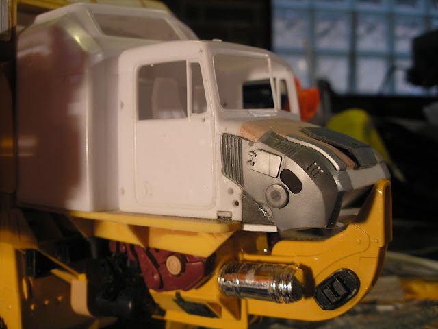

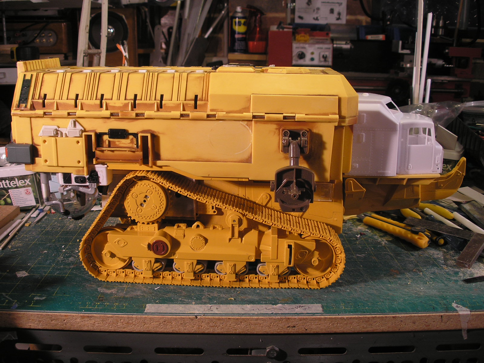

Now with all the major mechanical issues addressed what does the vehicle itself look like, well here it is so far...
I was originally thinking of using the Wall E cab but remembered I had a 1/25 scale truck cab lying around which I think
looked a lot more interesting when combined with the digging tooth from the Bruder dozer.
The cab section is held on with some screws so it can be removed and worked on separately.
Some acrylic plastic wine glasses from a charity shop are being used as tanks at the rear, covered with a plethora of
pipes and kit part detailing.
The whole rear tank module is removable (held on with a couple of cap screws into some more superglued PVC sheet
drilled and tapped M3) so the motor mount can be extracted for servicing if necessary.
