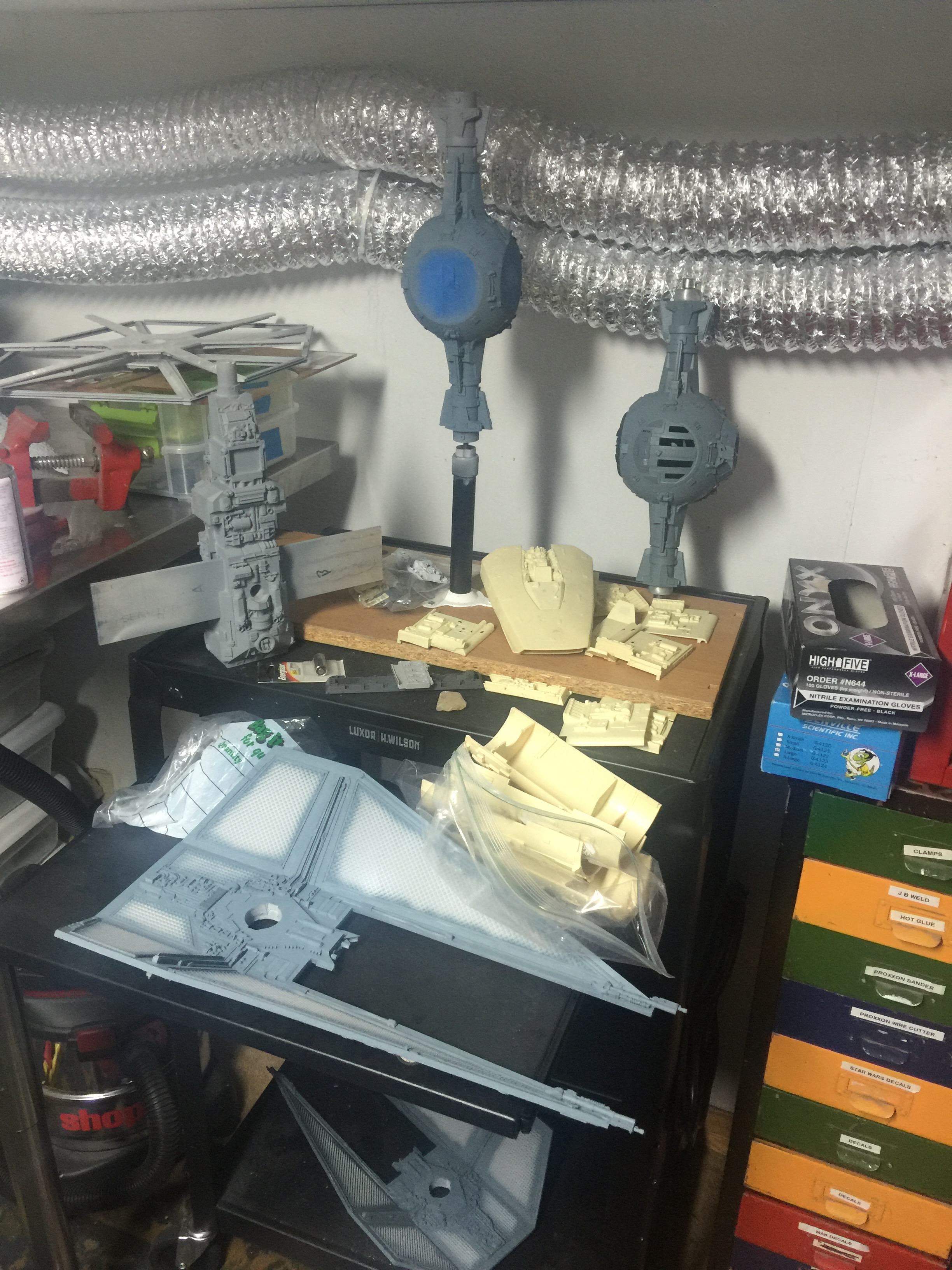

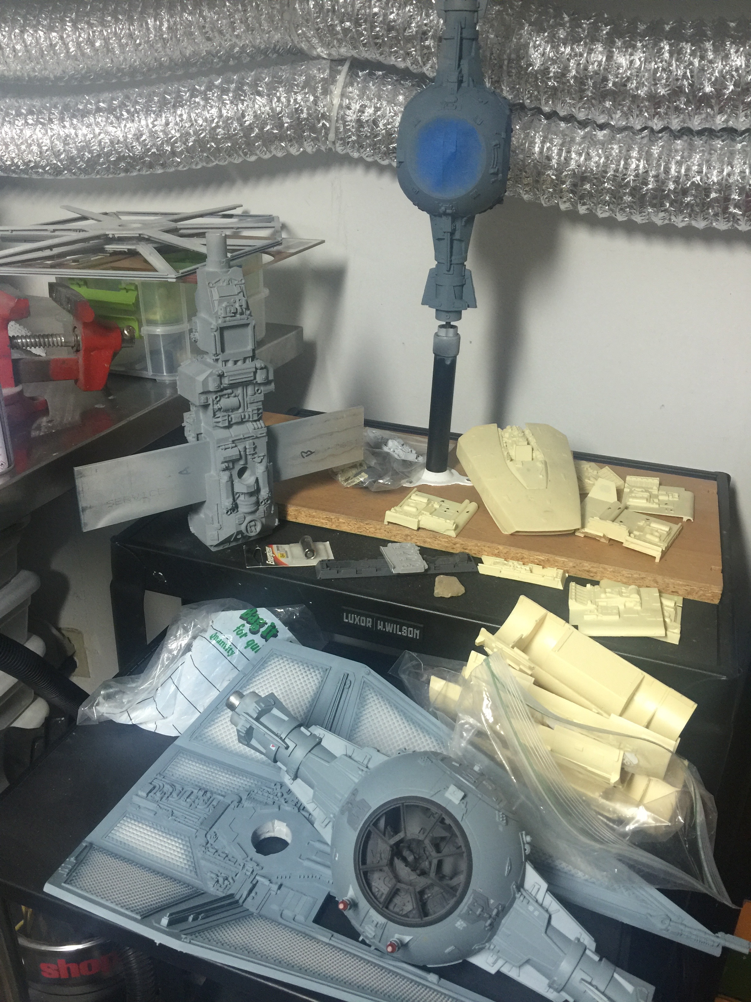

An Interceptor, a Hero ANH TIE (matching the color to the EFX tie), and the "Triangles" Y-Wing in progress. A paint master landed and has sidelined these for a week, but l should have the Interceptor done for Jerseyfest. I'd like to bring something new, after all.

I'll try to have at least the Interceptor done for it! I can bring the Hero Wing Stars to if you want to take a poke at how I glued 'em up. The lasercut inner frame really feels like it's going to make a clean glue of the Kool Shade/sandwich of the stars.
I'm going to use styrene cans for Y-Wings from now on, since we have those engine plant-on assemblies being cast up. Game changer, for easy to achieve perfectly round engines!
John, I got a RUSH when I saw that TIE in the trailer! I'd love to see the "Pentagon" one make an appearance. Two tone you say? I will take a closer look!!
Steve, I am looking forward to the next TIE you offer. These ones in progress are amazing models and they do have the correct armatures I had machined (the Vader one you had machined is even more accurate with the pass-throughs for the wiring to the wings!). My current one becomes "Vader's Wingman" with the crumpled wingstar and the one I get from you (when you are ready) will be the other wingman - with that sweet sweet Vader TIE in the middle. All mounted to the wall, from the backs, banking downwards (well, Wingman will maybe be spinning out of control, lol)... It's gonna look COOL.

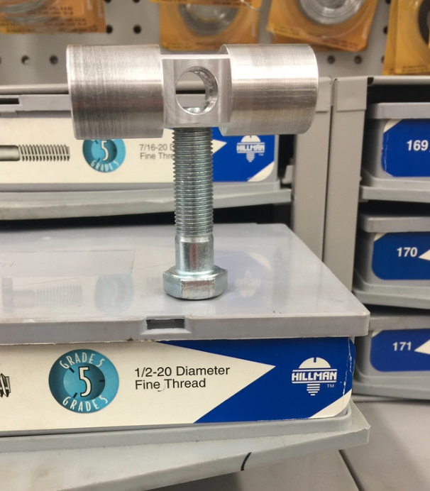

This will save some aggravation at Home Depot - you need fine thread not coarse, so go to Ace. I had a machine shop cut the heads off these bolts and thread the ends to 1/4-20 so you can mount the TIEs to a Panavise and angle them any way you want. The nice thing is that the bolt can be screwed into the center mount until it is barely prod from the mounting hole, and you get a great lock with the Panavise without marring the paint.

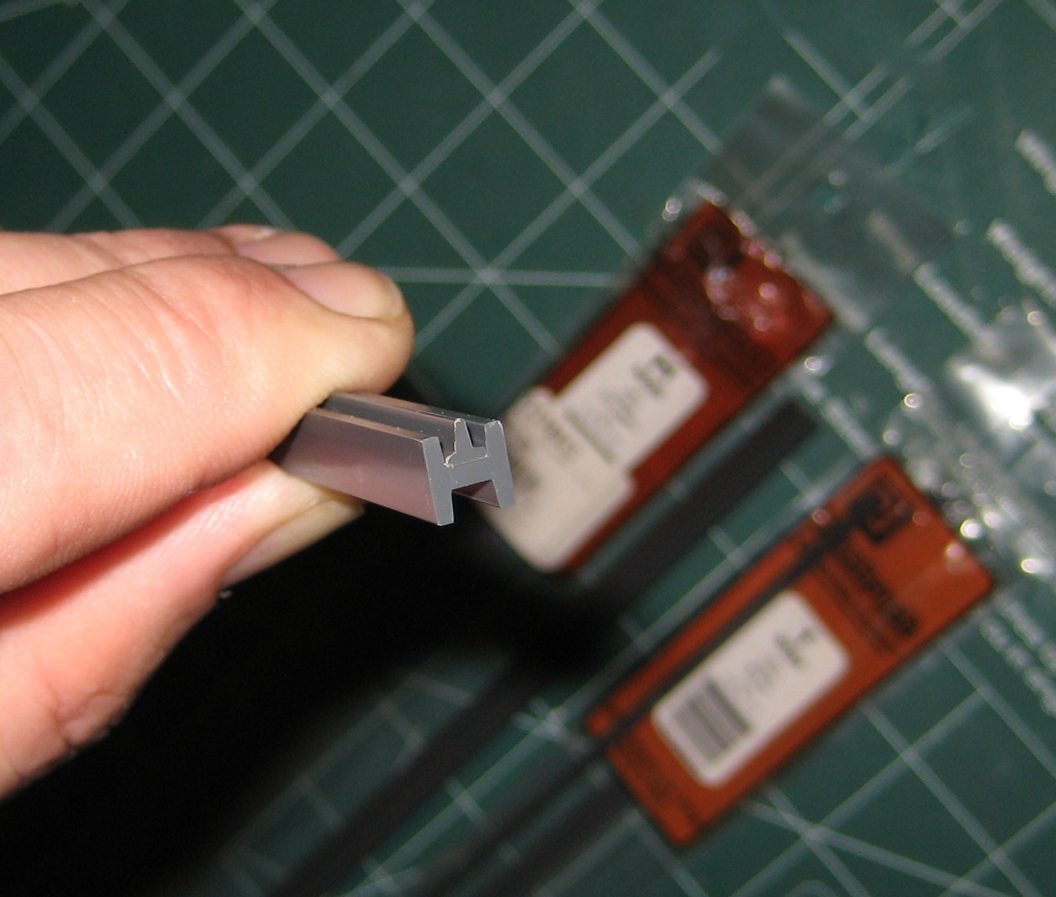

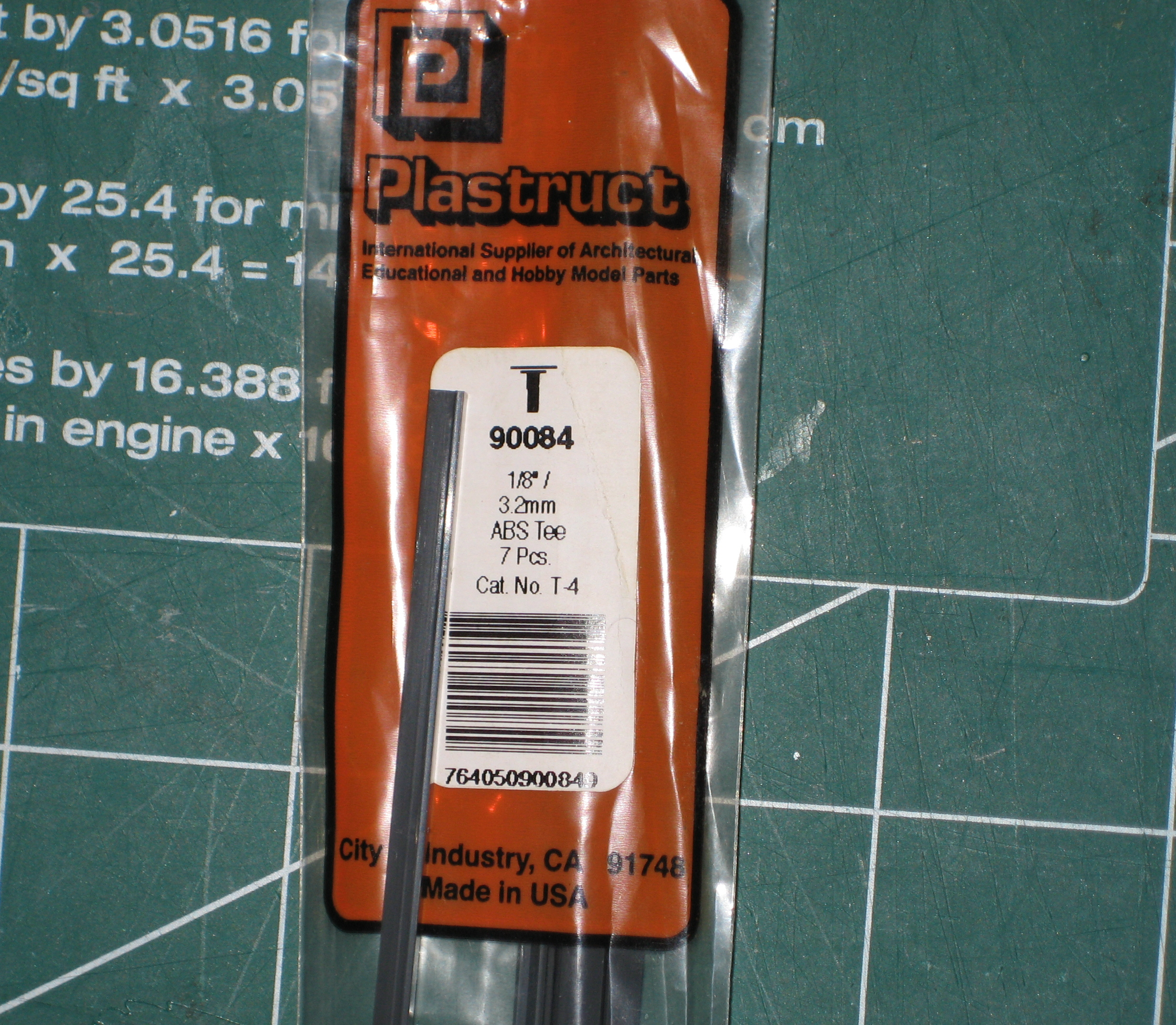

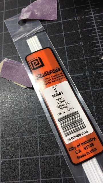

I am afraid you indicated the wrong Plastuct 1/8" T-Beam. in the one picture on FaceBook.
Your picture shows the Styrene 3/64" T-Beam which has a completely different profile/cross-section than the Grey ABS 1/8" T-Beam (see pic)
Back in 1977 ILM modelers used the ABS 1/8 T-beam Plastruct Catalog item # T-4
Also in 1977 the Styrene T-Beam (Catalog # TFS -4) was not part of Plastruct's product line. That came out later in the mid 1980s
I can see you may have just grabbed the wrong package from your stash as it looks like you actually glued the ABS (T-4) on the wing itself
I have a diagram I made which has Miter-cut guides to assist in cutting the ABS stock --for both the 1/4" H_Beam (item # H-8) and the 1/8" T-B (item #T-4)

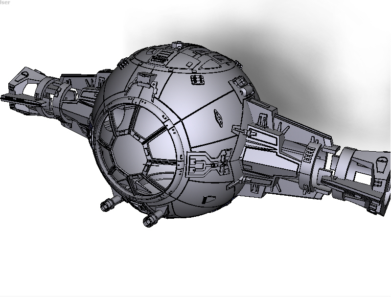

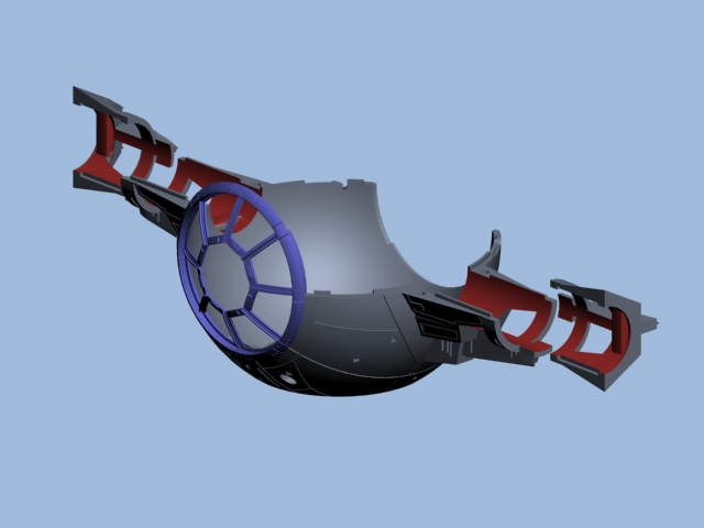

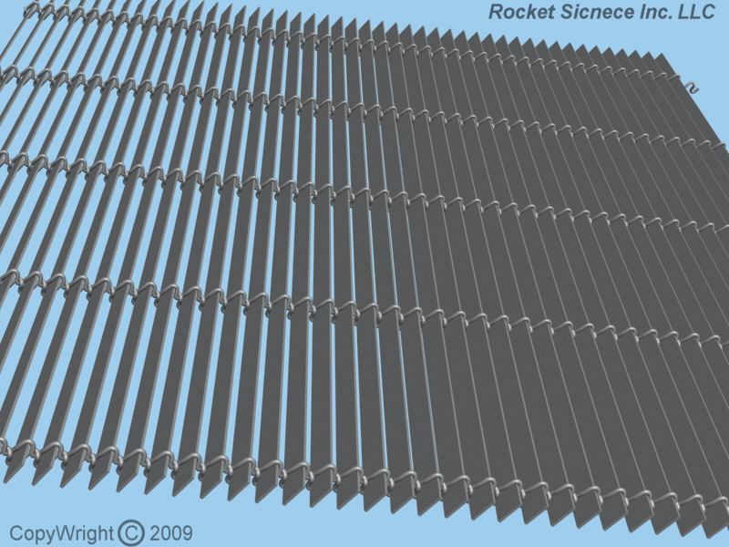

Can’t Wait to get my editions of the Tie fighters too... (back when I re-designed and reverse engineered the SS Wing-Stars) along with making the Virtual Kool-Shade for non-hero version cores. -- John too, did a great job ID-ing & mastering all the greeblie details on the wings.
I had some lacquer paint custom matched from a spectrophotometer scan off the EFX TIE. So it could look in-correct in every different light apperrently... :lol

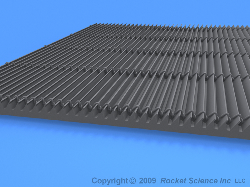

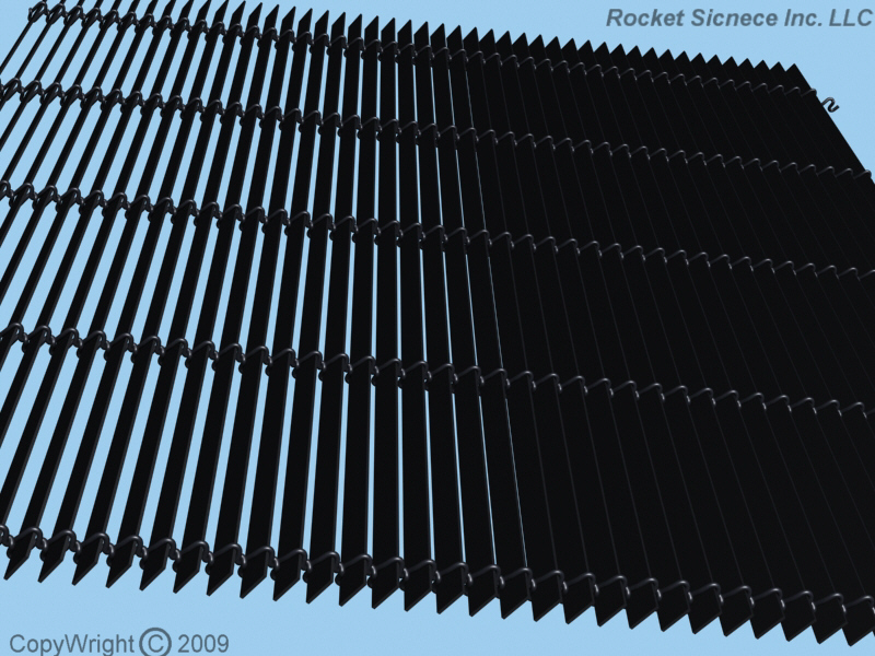

At the time (2009) we were pushing the limits of what could be done with stereo-lithography.
We could only print (practically) about a 6” by 9" inch section of the Virtual Kool-shade (VKS)
It was a lot of work engineering a section of VKS that was tile-able and interlocking without any visible seems. The Plan was to cast the prototype and inter-lock multiple sections then the seamlessly combined large piece would be again cast again. I was able to “Key” the interlocking sections (perpendicular to the louvres) at the braided wire, hiding the seam perfectly. Test prints showed it looked a lot better than the clayed-up real Kool-Shade
We had problems with the Printed material warping and we decided it was impractical.
The technology has been moving along so rapidly (and now it’s become so main-stream)
...fast forward to 2014 we were able to print pieces large enough for all the triangles needed for the Basic TIE wing… and out of newer material with better qualities and no warping troubles.
All for less money! God Bless capitalism
This re-design also lets the “non-hero” wings go together more like the “hero” versions with real Kool-Shade. (Without the $600 additional cost just for the Kool-Shade)

Indeed I did use the right stuff - but my code numbers are correct. Where are you seeing incorrect #s listed?
I'd like to fix the page.

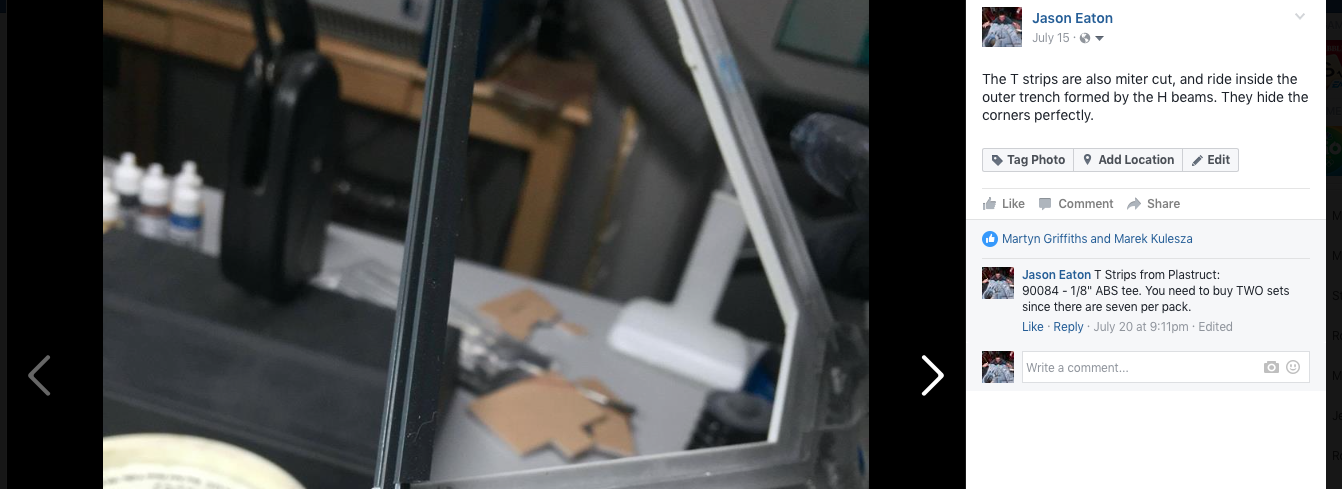

I was referring to the picture on your FaceBook instructions ( see attached) I think you accidentally snapped a pic of the wrong type of Plastruct T-Beam (3/64 Styrene was shown)

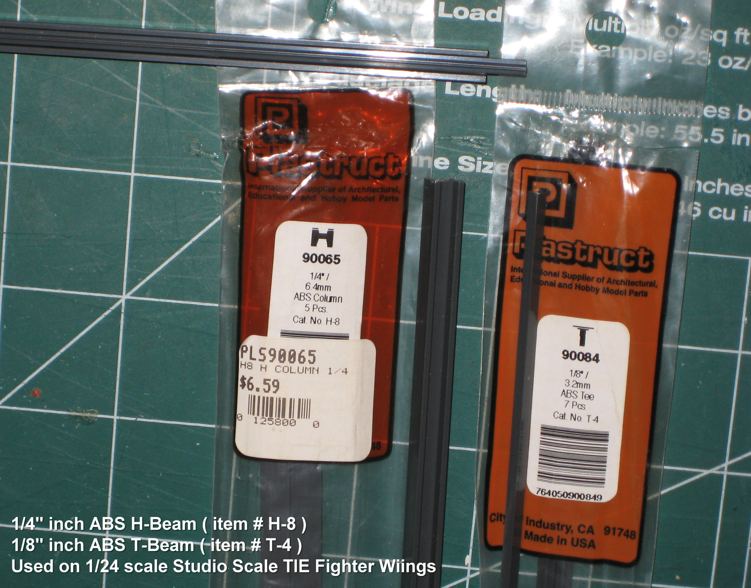

So for the sake of Clarity -for anyone taking notes on building themselves a SS TIE Fighter
Below are Pics of the Type of Plastruct ABS Stock to use for an accurate ANH TIE Fighter
The original ILM miniatures used Plastruct 1/4" inch ABS H-Beam ( item # H-8) and 1/8" inch ABS T-Beam (Item # T-4)
Keep in mind: in many cases the styrene plastic (usually white) Plastruct stock has slightly different shape & profile then their ABS plastic counter-parts

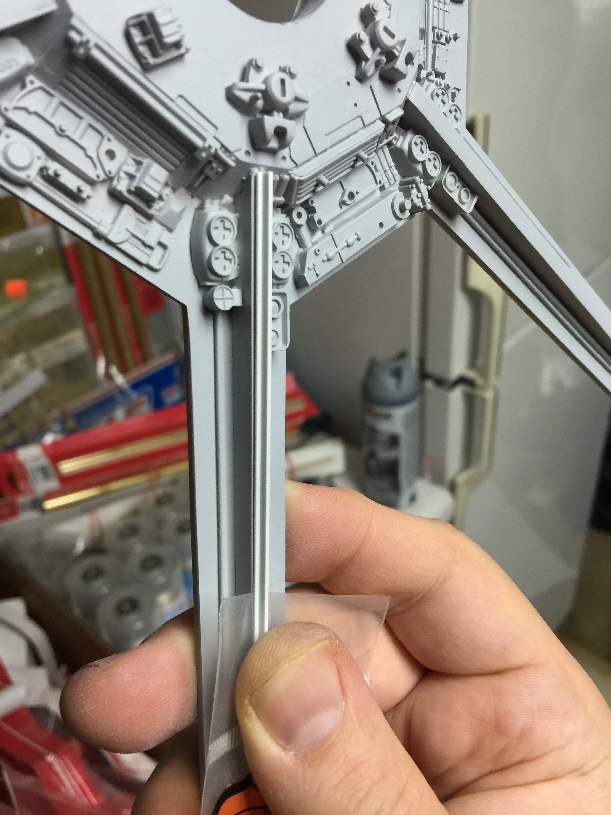

Mike I was asking about this. That is why that picture is on my FB album. I know in that pic above the t beam is too big, but was the only pic I have handy on my phone
Jason, my apologies, for creating any confusion I thought your picture on FB was frefeering to the Outer frame.
You are correct that 3/64" T-beam should go on top of the Wing-Spars. as you have illustrated.
I Just checked re-liable reference and my project notes. Also 3/64 T-beam used on the X-1 Vader TIE (measured first-hand btw) -as after all, they used cut-up "standard TIE" wing spars to detail the bent wings.
However it is more likley ABS Plastic was used. ( as I mentioned Plastruct expanded their product line in the 1980s including more shapes in styrene
The Profile of the ABS may be a bit different than the styrene 3/64". I can not check for sure, as I am out of stock of the styrene 3/64 T-beam, at the moment.
3/64" is the smallest size T-Beam Plastruct ever made, most likley the profile for this particular size is the same in either ABS or Styrene.
