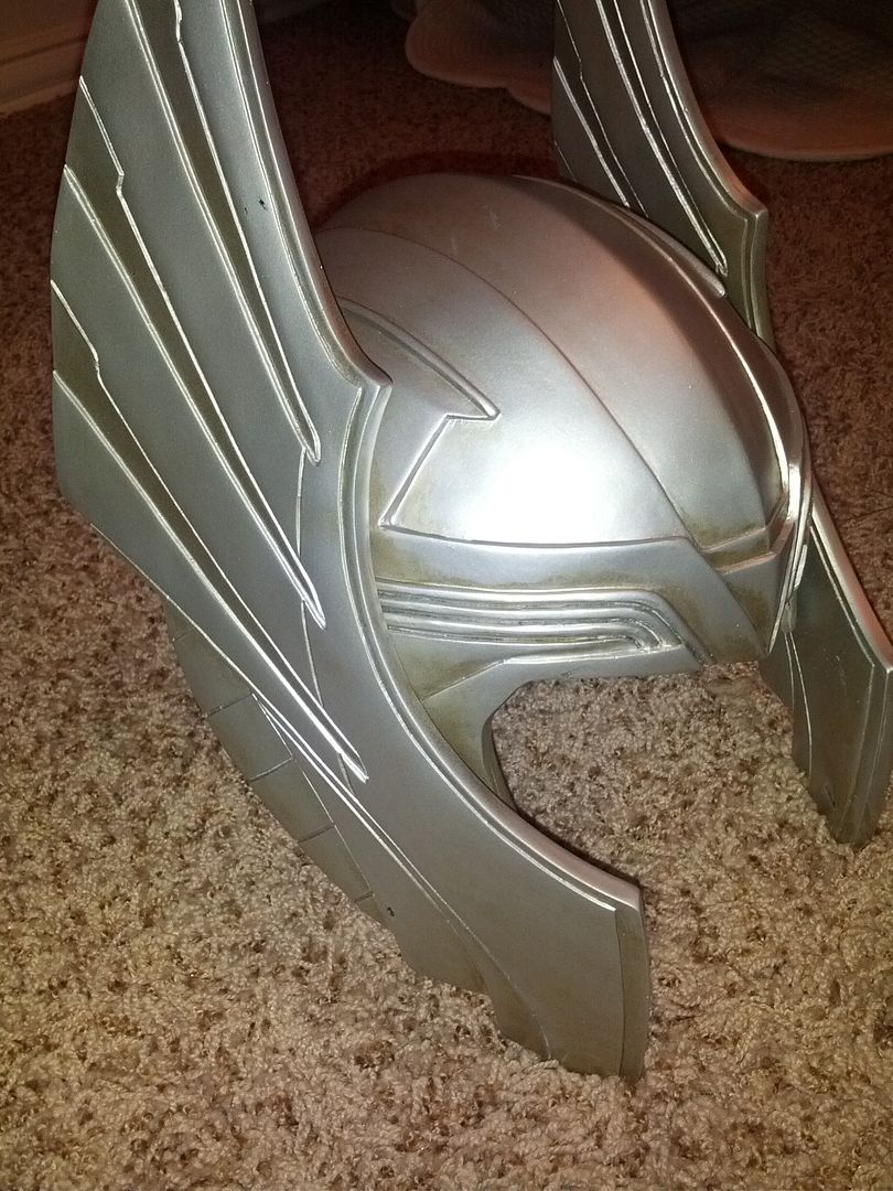

For Christmas, my wife purchased a Thor movie helmet for me from ebay. Wasn't too bad out of the box, but I knew there were a few things I could do make it look a bit better.

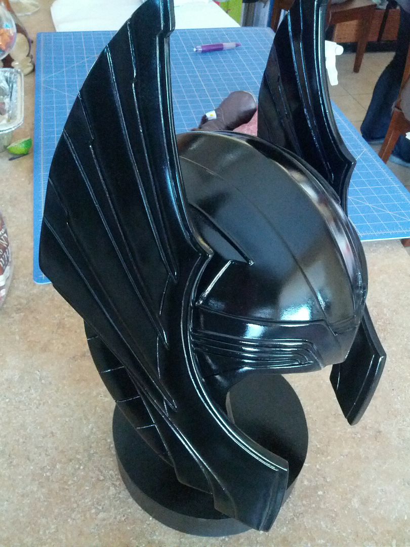

Mainly I wanted to clean up a few areas and repaint it. It was a dull silver with some "patina" or "rust" weathering added on. I wasn't a big fan of the yellowish patina, so I wanted to give it a brighter finish. First thing I did was sand down a few bumps, and take off the paint. Once I got down to the bare resin, I filled a few bubbles and imperfections, sanded it to 400 grit, and gave it a coat of primer. At this point I wet sanded the entire piece to 1000 grit, and gave it a shiny black gloss undercoat.
For the final finish, I used Dupli-color Chrome. It is a pretty decent rattle can chrome, but won't give you a mirror finish (which I am OK with in this instance).

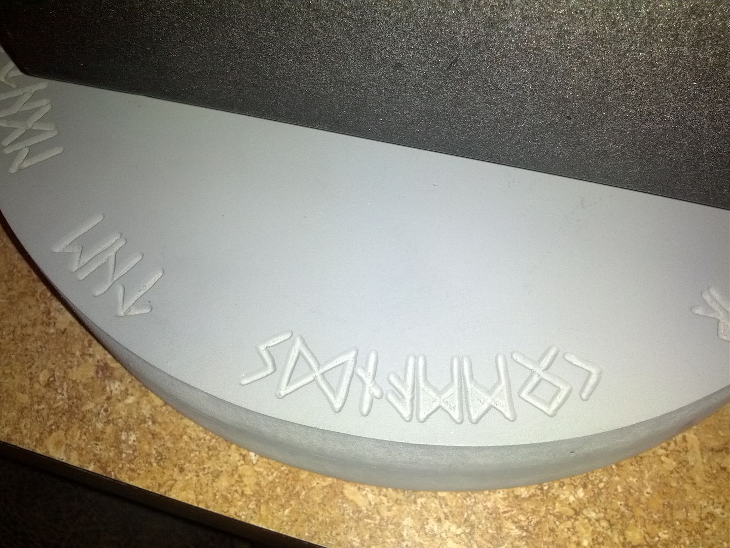

Here is the helmet on the primed stand:
And a close up of the runes:

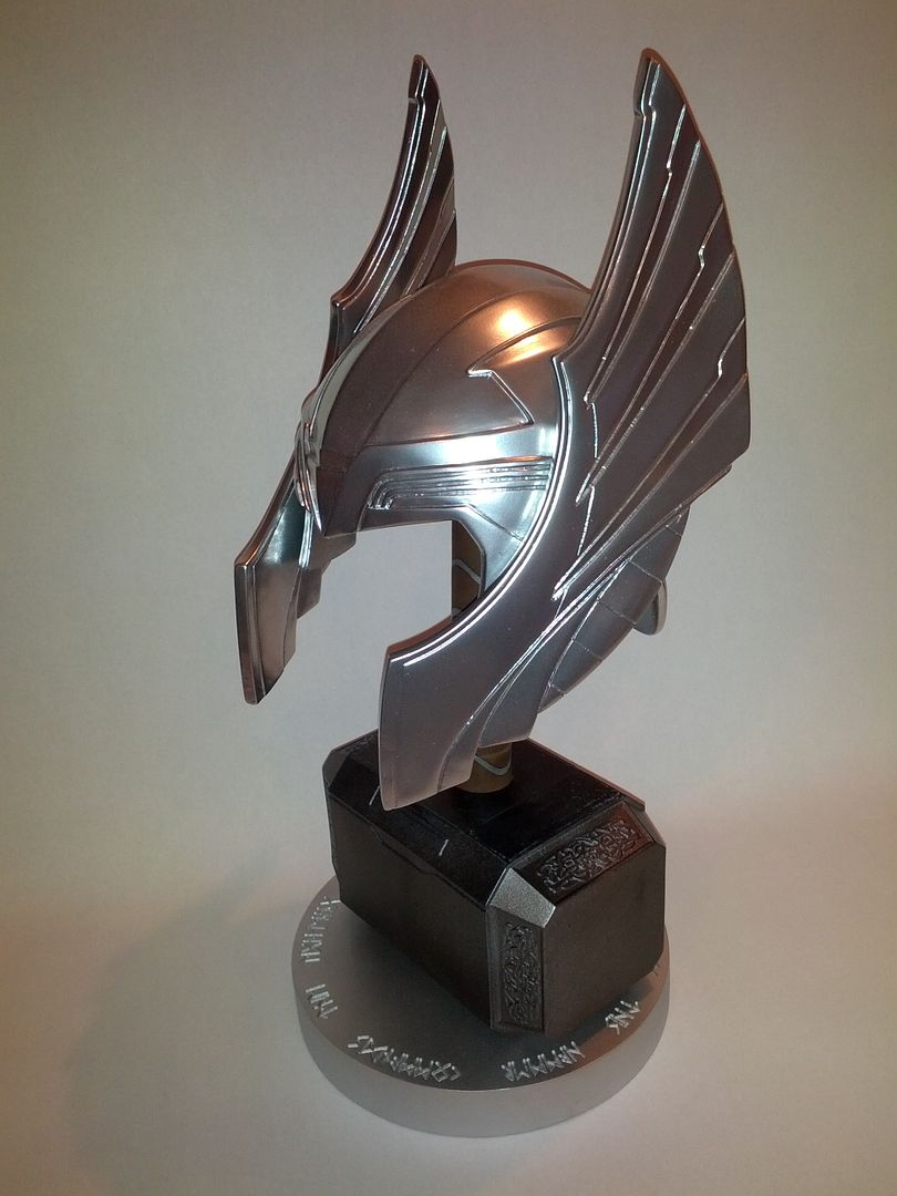

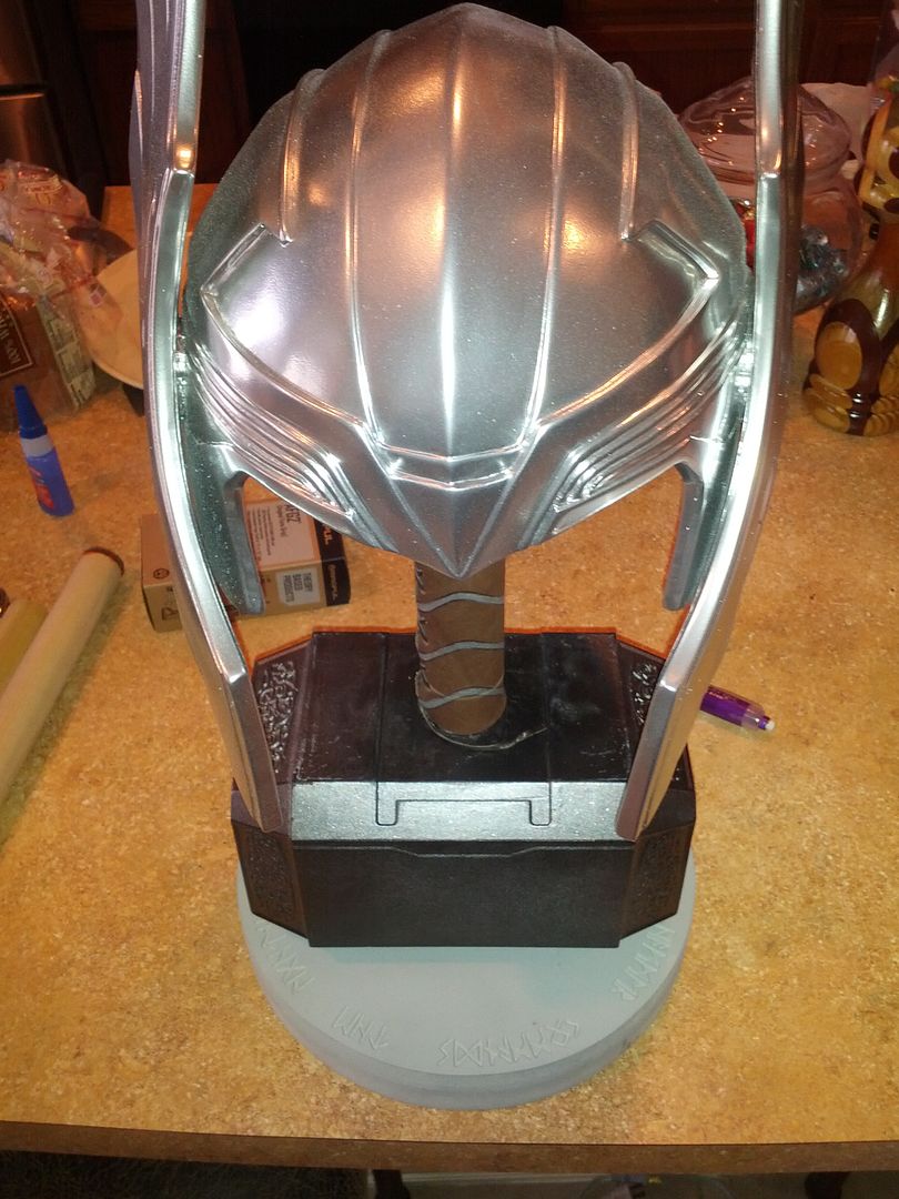

Then I came up with another idea... What if I incorporated my Mjolnir into the base? Here is what that looks like:
In order to it work, I would cut a hole in the top of the hammer so that I can secure the dowel to the base and through the hammer so everything is nice and sturdy.
So what do you think? Base by itself or Mjolnir and Helmet displayed together?
Nice helmet! Reading your description it seems to me that you're gonna have to sacrifice a perfectly good Mjolnir to fix it to the base! Seems a waste. Isn't there a way with magnets or something? If so, I like this set-up.
The base itself looks great, and when you throw in the hammer I like it even more. :)
If indeed you are making another hammer and you plan on displaying them together I'd make the suggestion of muting out the hammer in the same color as the base. This way the focus will be on the helmet and the new and improved hammer.

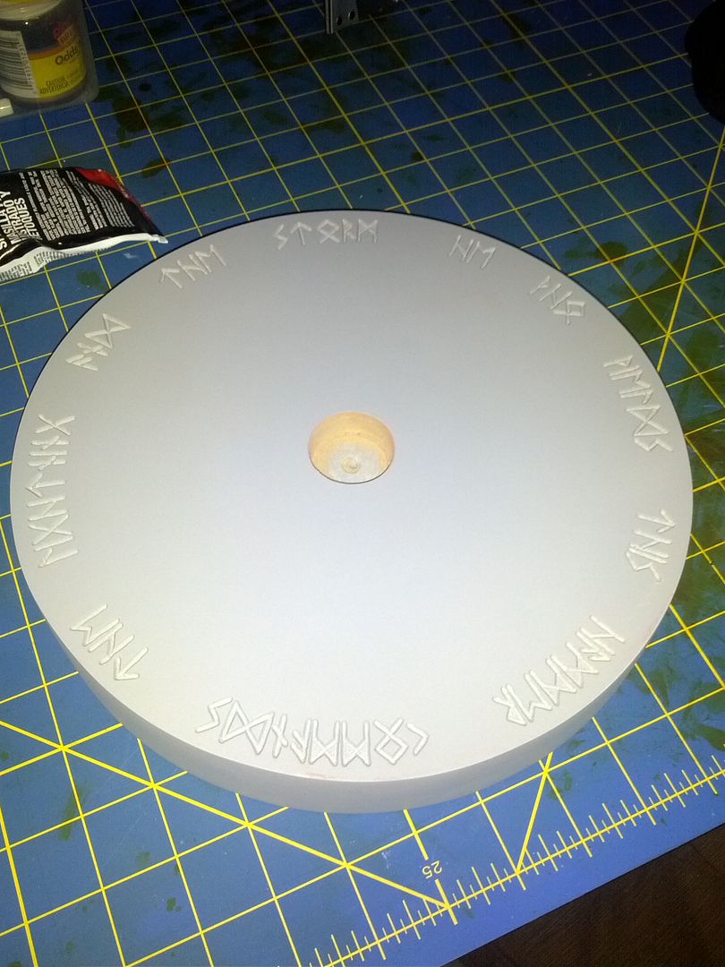

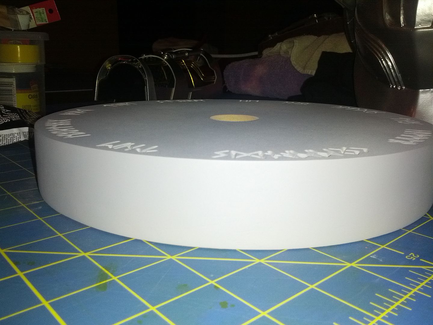

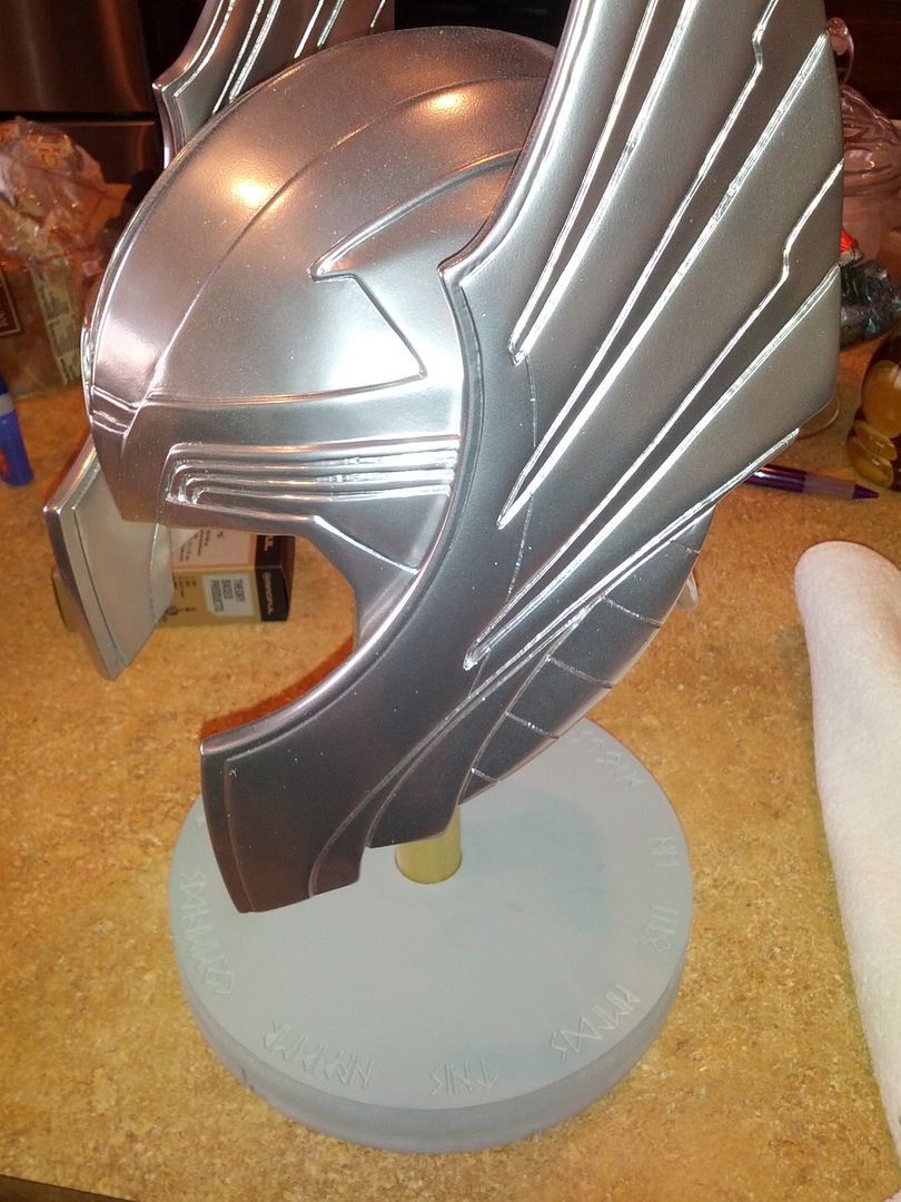

Did a little finishing work on the base last night. I wanted it to be a little thicker and heftier than what Eric normally does, so he laminated two baseplates together. He also unexpectedly shellaced and primed it for me too, so it was practically ready for paint when I got it!
There was a slight seam where the two pieces were laminated together, so I used some spot putty to fill the gap. I used a popsicle stick as a trowel and put a thin skim coat along the entire outside edge. Once dry I sanded it smooth and reprimed it.
Now it's ready for paint!
I've thought about doing something similar.
Can you post a pic of the hammer and helmet together from a little further away? It's hard to tell how it actually looks in that photo.
As you wish :)

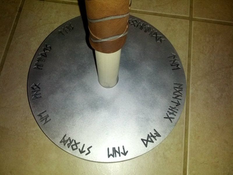

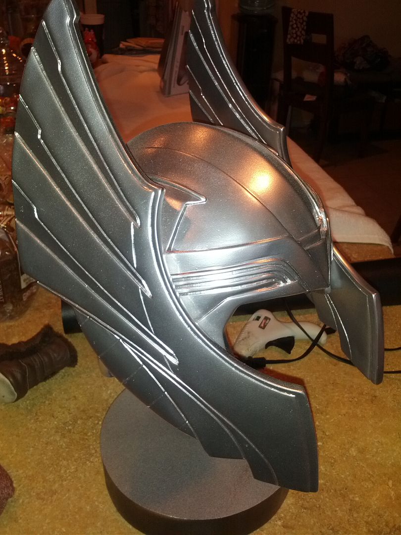

Got the base painted a nice aluminum/silver today. Just need to do a black wash on the runes and add some depth to the piece. Then I'll sand down and refinish the hammer so it matches with the base.

I think that looks badass.
I was thinking of just having the hAmmer just holding up the helmet by itself but the addition of the disc base really turns it into a proper display.
Which hammer is that?
I'd hate to see a perfectly good hammer get messed up to just be On my way! A base though. Does look cool however.
Wonder what it would look like if you had the hammer on an angle, sitting on one of the corners. Have the handle of the hammer tilted backwards, away from the front of the stand? Just thinking out loud.

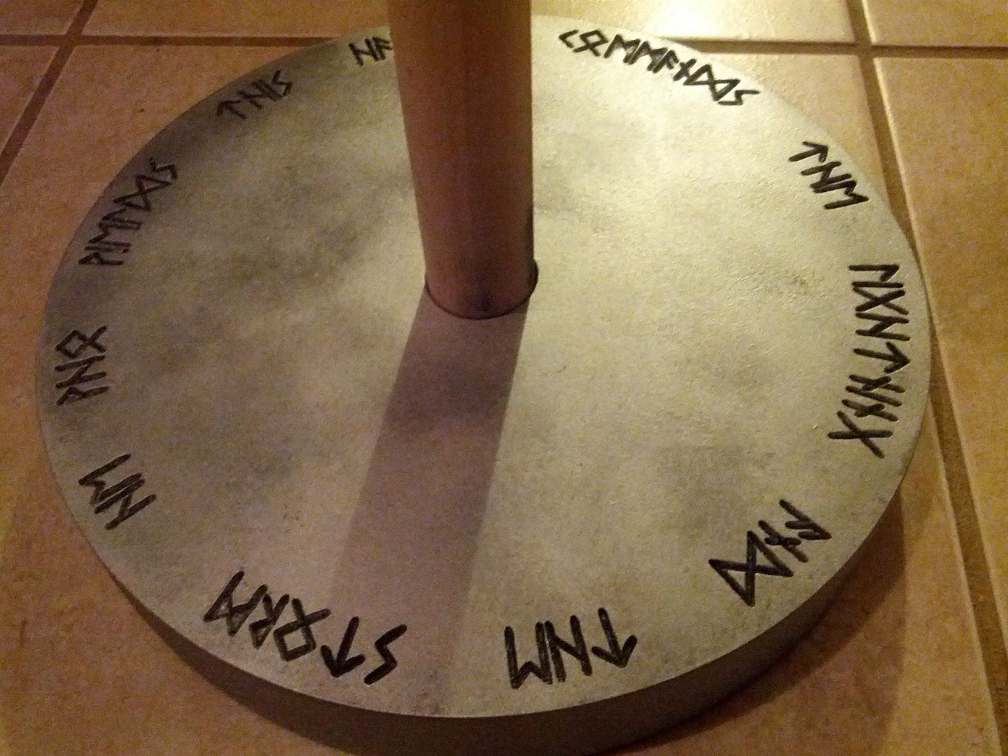

Did a little more work tonight on the base. Blackwash on the runes, and then used a round sponge brush to stipple a mixture of gunmetal, chrome, and paint thinner in a random fashion to give the piece an aged metallic feel.
Without flash
With flash
Also sanded down the hammer and primed it. If I get some time tomorrow, I'll do a little spot putty filling and more sanding, then apply the same paint technique as the base
The aged base looks awesome.
Using the hammer as the helmet stand takes it to another level. I vote for using the hammer.

Since pretty much everyone (except my wife :lol) thinks the hammer adds to look, I'm going to incorporate it! It has been sanded, primed, spot filled, primed, and painted the same base coat of silver as the stand. Tonight I will add in the blackwash and "aging" to give it the same depth as the base, then this one will be all done!
If I had thought of using the hammer before having the base cut I probably would have gone bigger too. But I still like it :D
