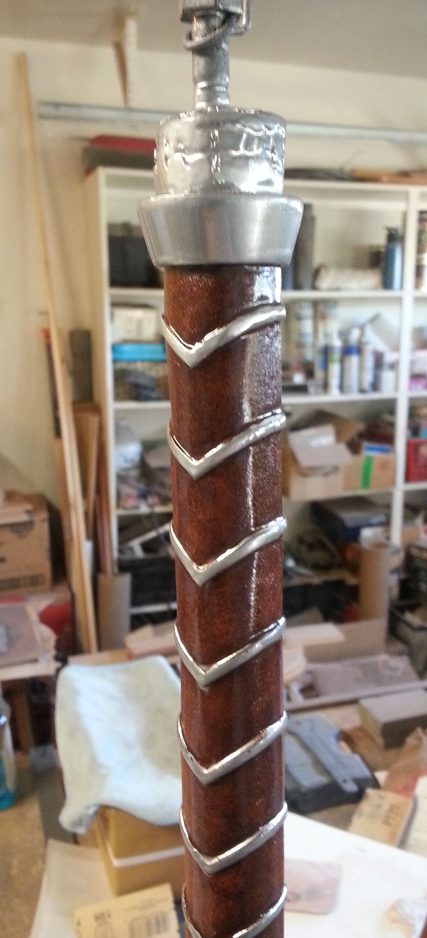

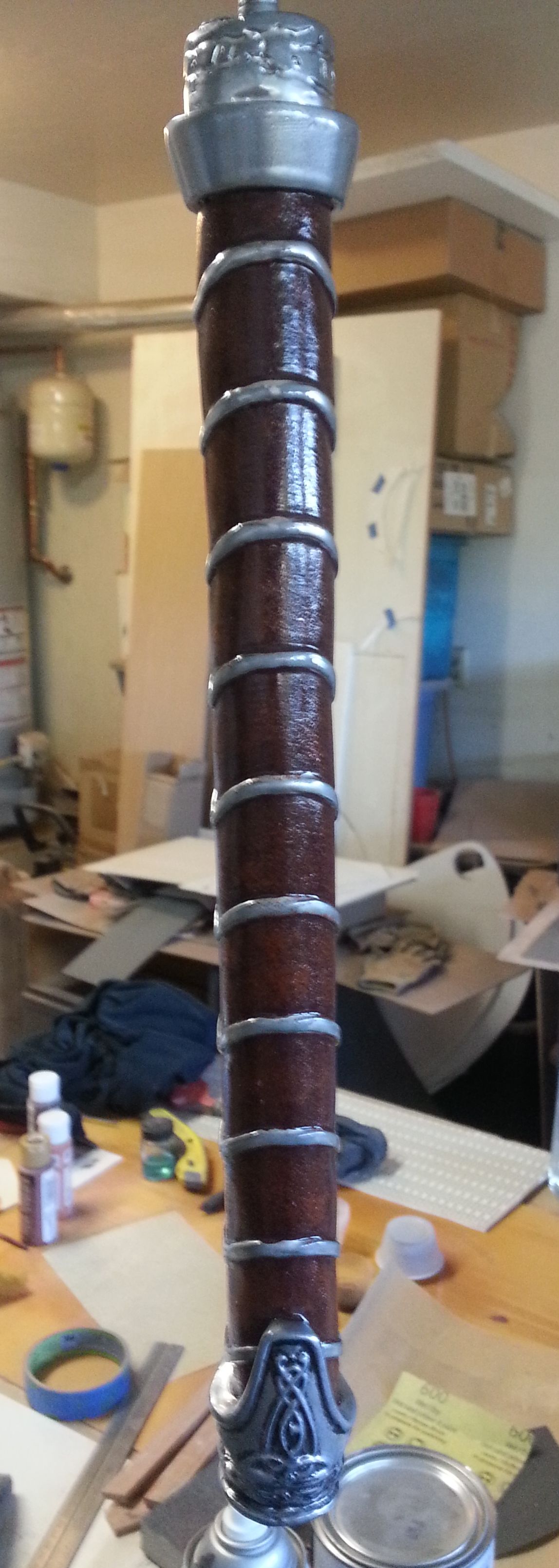

The handle itself was not horrible, The casting detail was ok and they installed a metal rod in the cast about 1/4 in diameter. Not sure how far through the handle it goes but the handle has nice feeling of weight. I drilled through end of handle and installed a bolt so when I reattach it there was something for the epoxy to grab. The tapered collar was way too small in diameter and distorted so i built that up with a few layers of bondo to fix. Then its just a paint job of chrome covered with floor polish then a faux leather job.

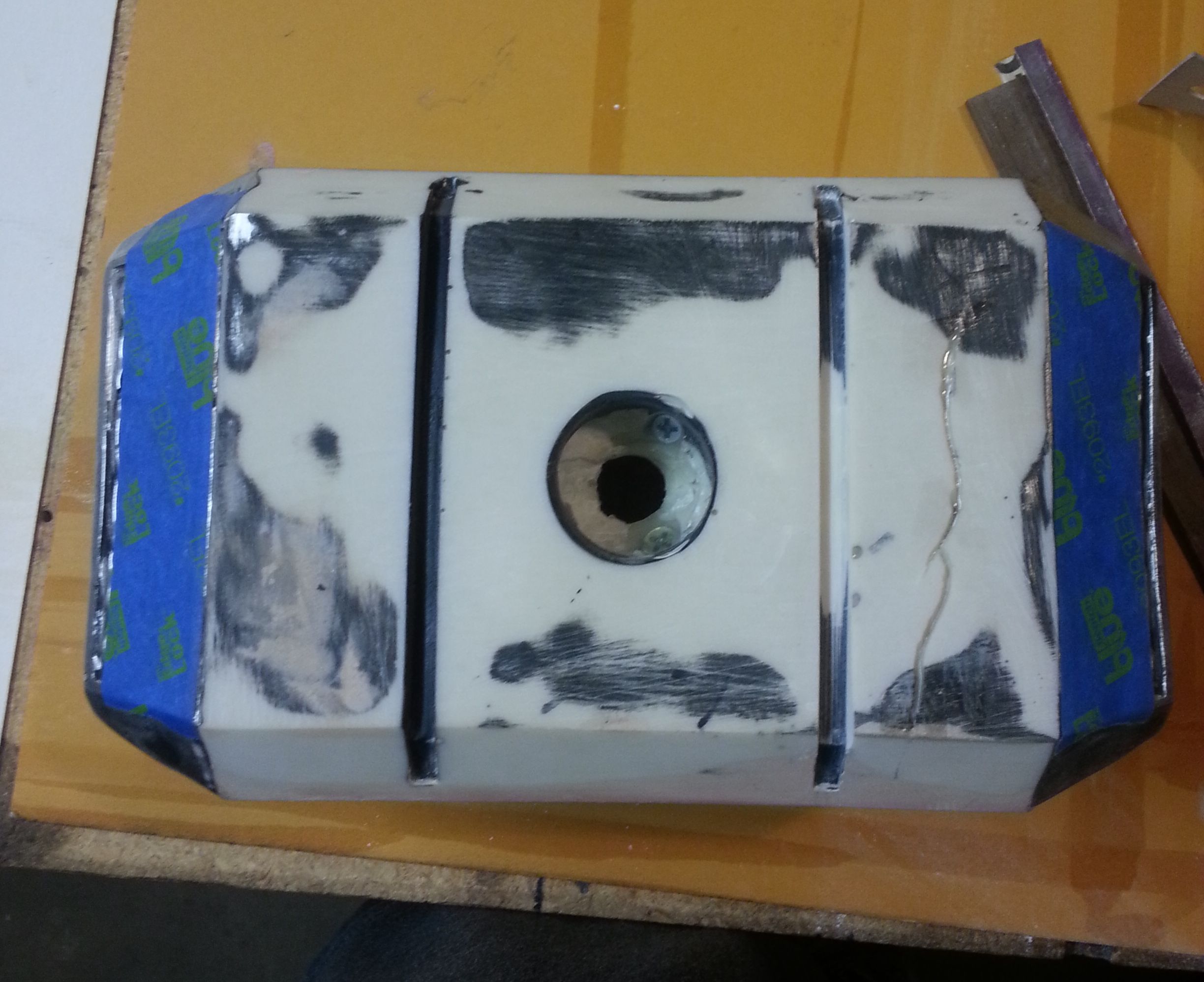

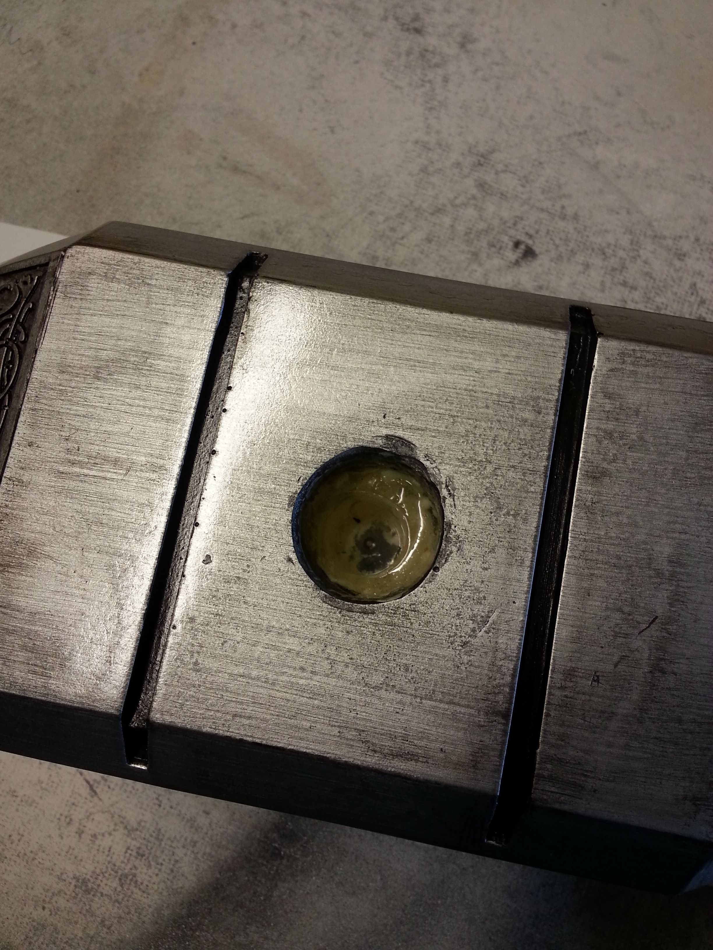

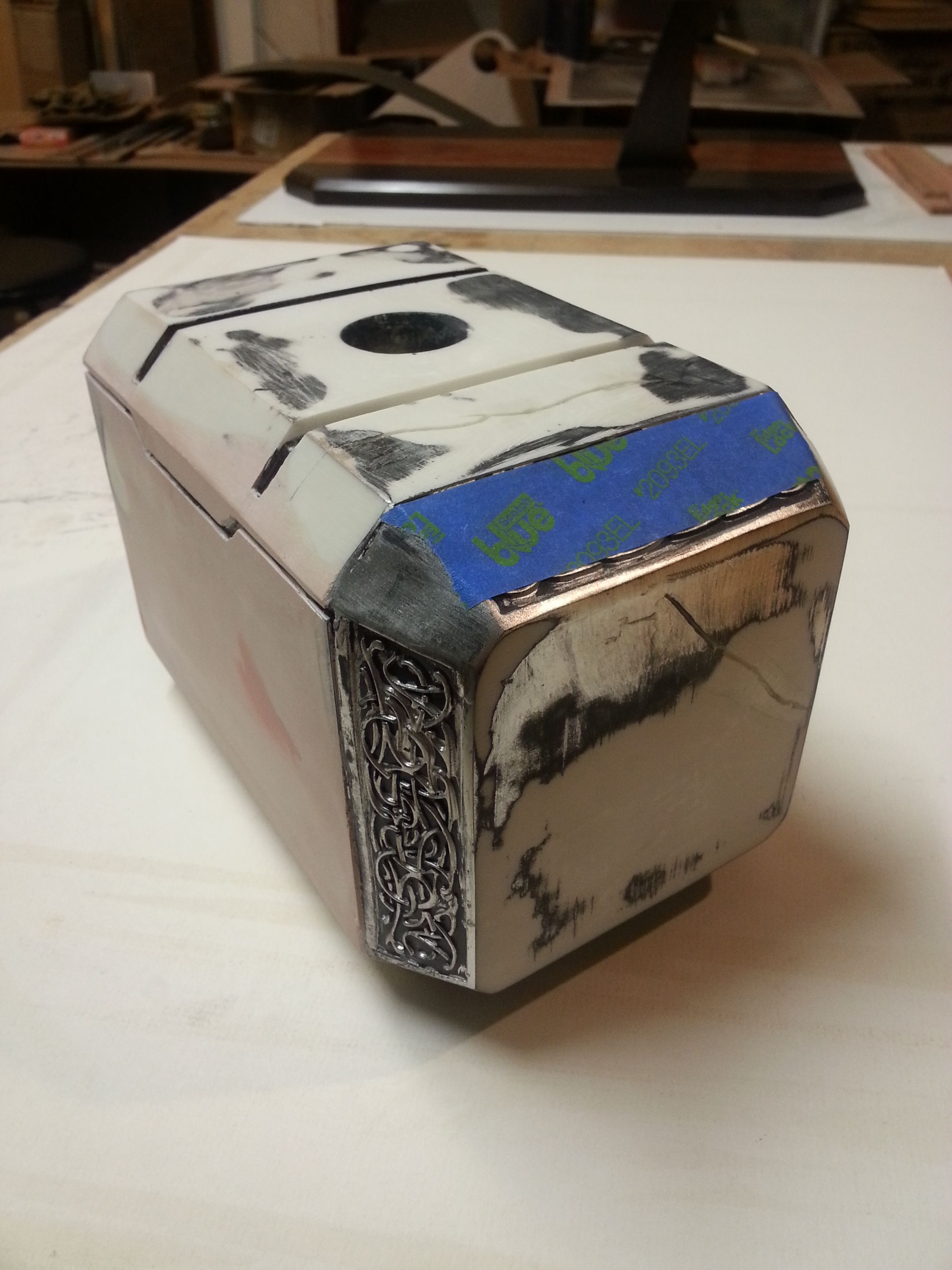

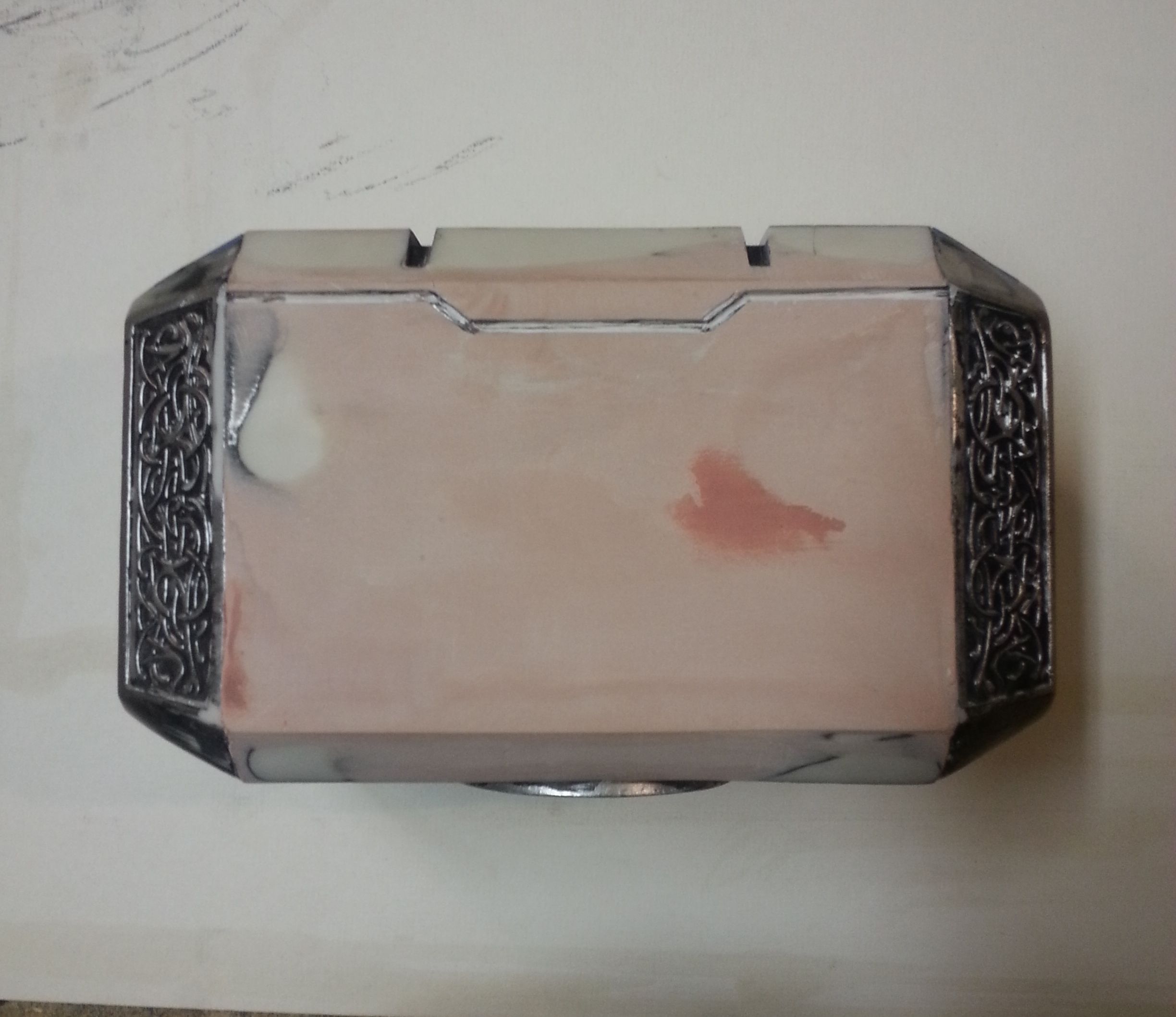

So since there was a big hole in the head already I thought to fill the airspace with some weight to make it feel less like a cheap toy prop. I found cheap $1.50 a tube caulking at Wal-mart that was heavier than all the others. 3 tubes went in, raised total weight from 3 lbs to 10. The head itself just required epoxy to fill cracks and a lot of bondo.

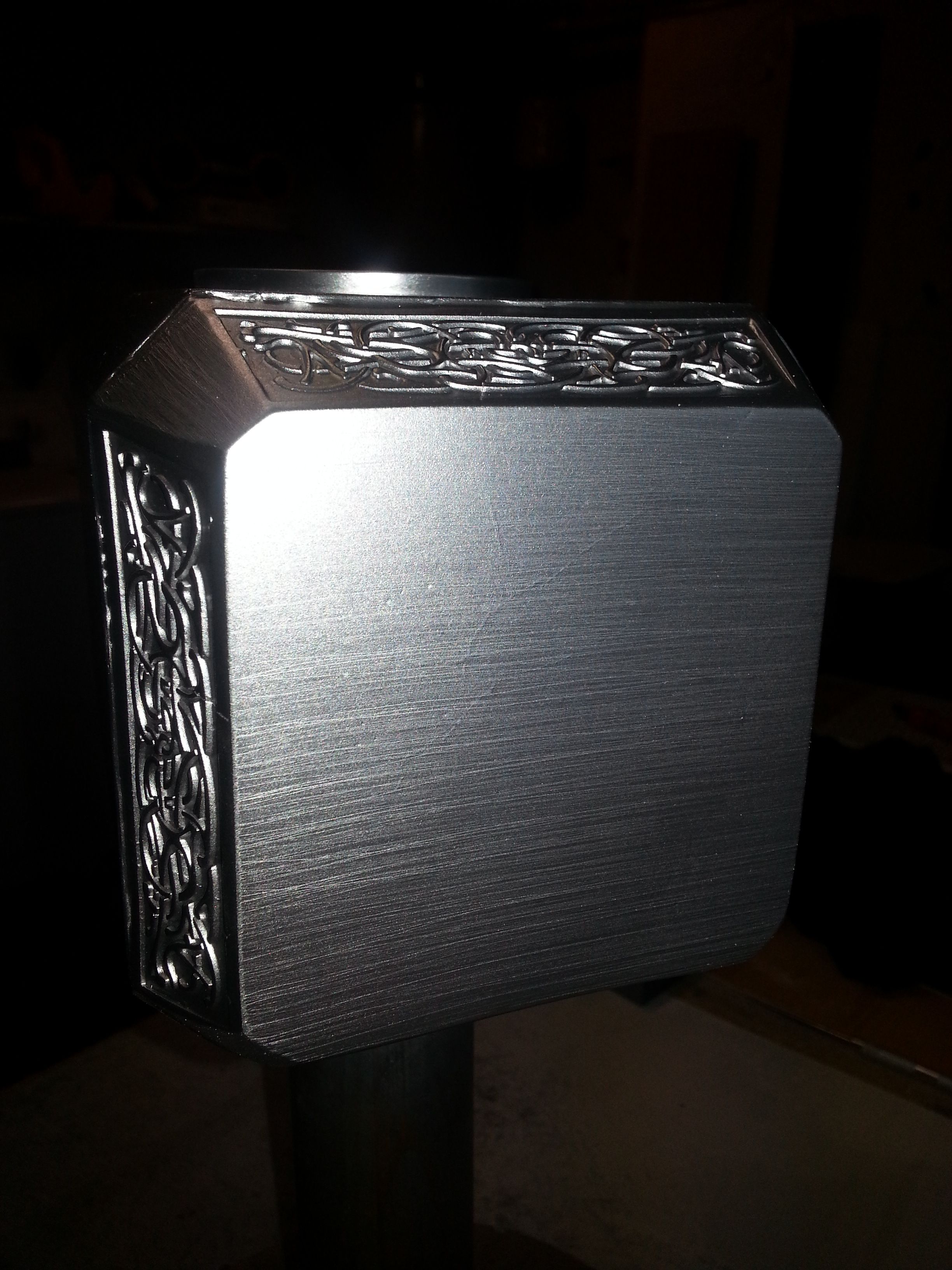

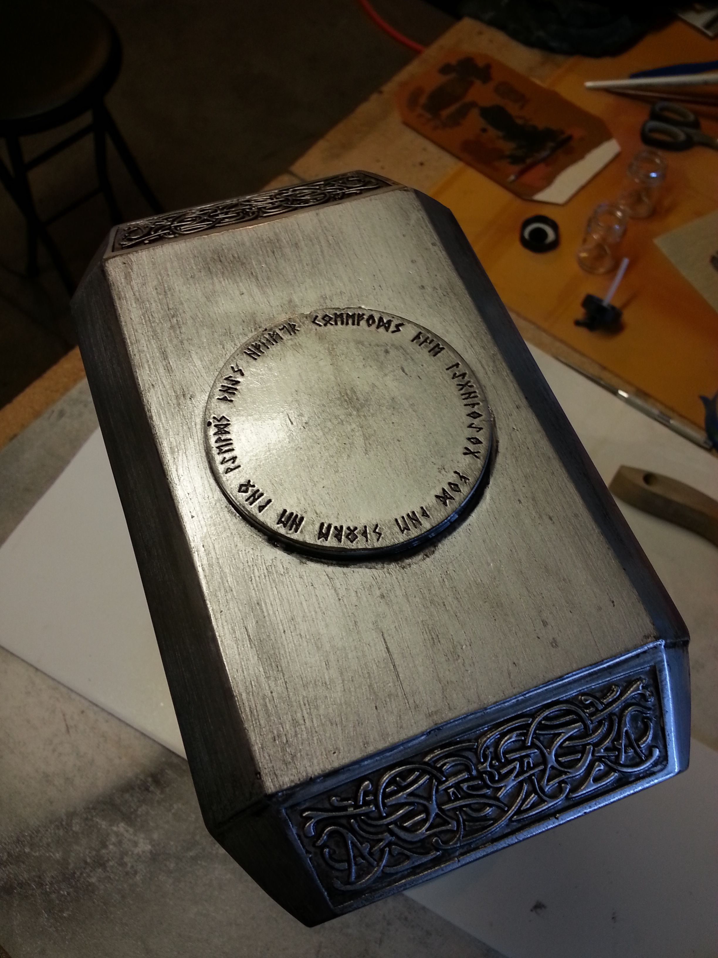

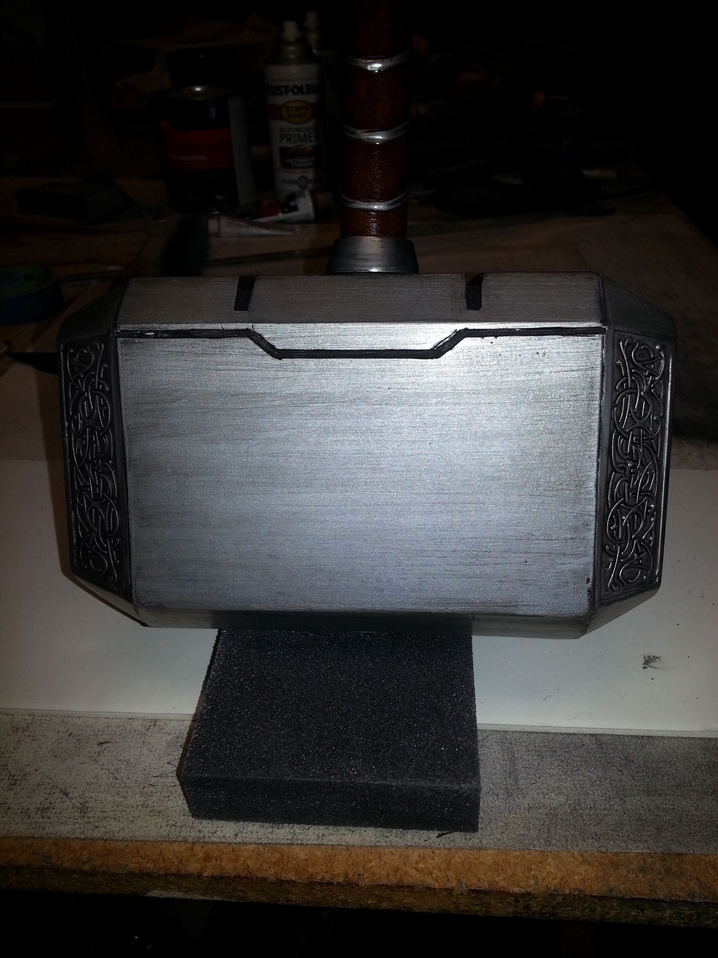

The silver used is rustoleum bright silver metallic. When paint felt about half cured i scuffed it carefully with a new unused medium grit sanding sponge. This will not work if paint is dried, you wont get the deep scratches. This worked very well when weathering is applied, I got the metal look i was happy with.
I am very new at weathering but this was a very easy chore. Just a dirty black wash with acrylic craft paints that stuck in my scratches nicely.

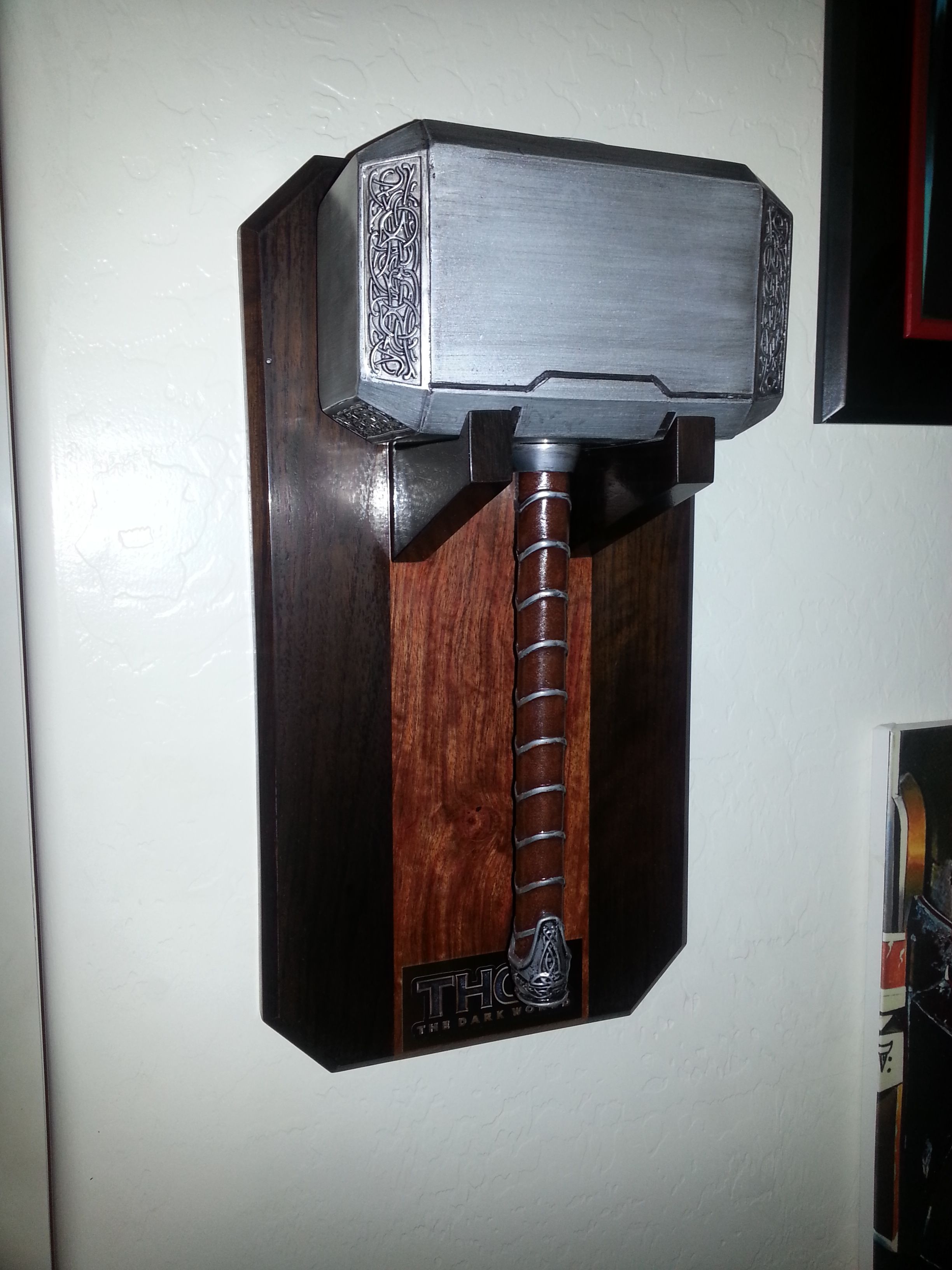

I dont have a lot of shelving or display table space so this needed a wall mount. I had some very nice wood leftover from a recent project, The center piece is bubinga and the dark pieces are tropical walnut. I had a custom vinyl label made for the brass name plate. All thats missing is the leather strap (the one it came with was plastic !)
