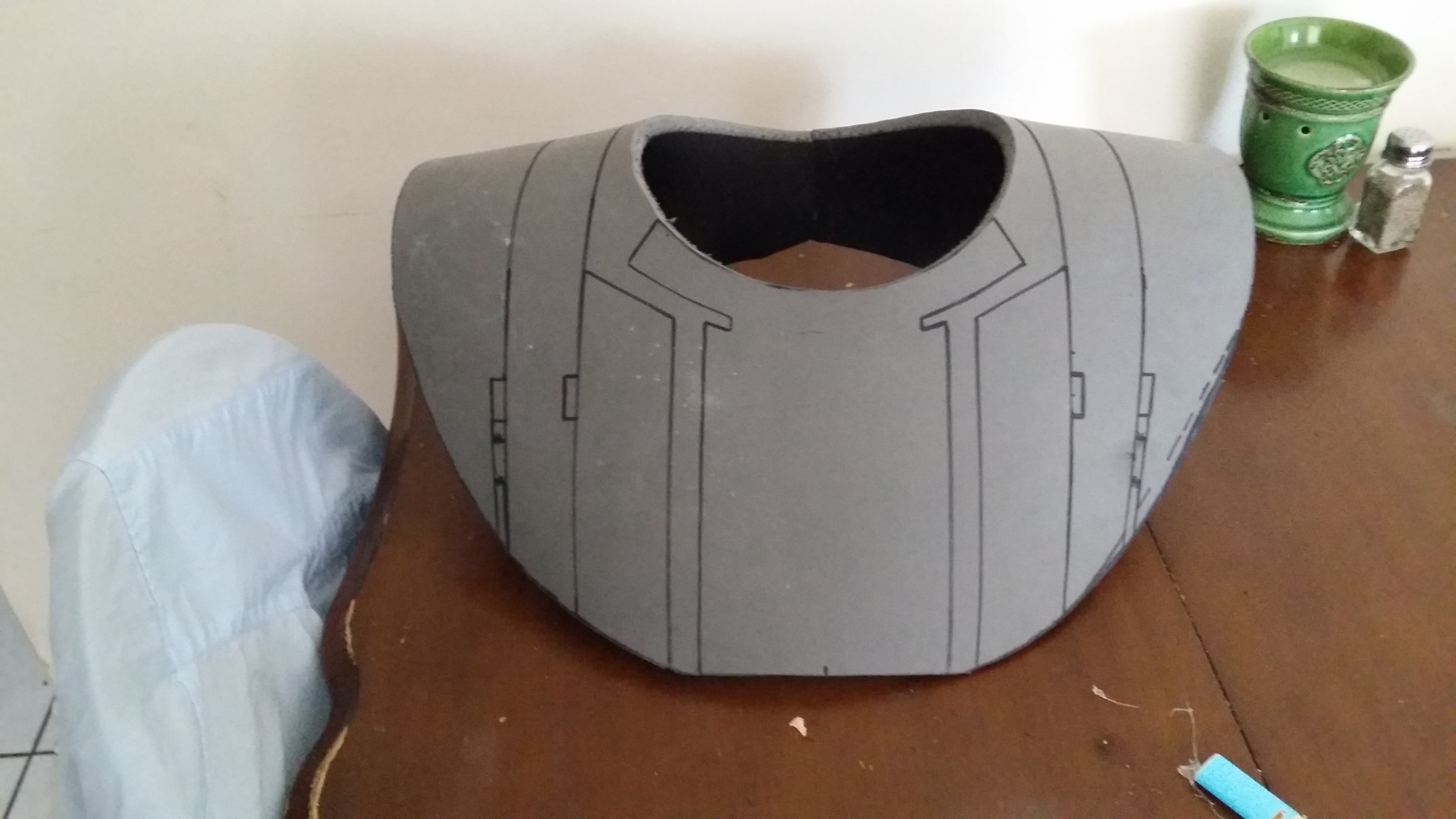

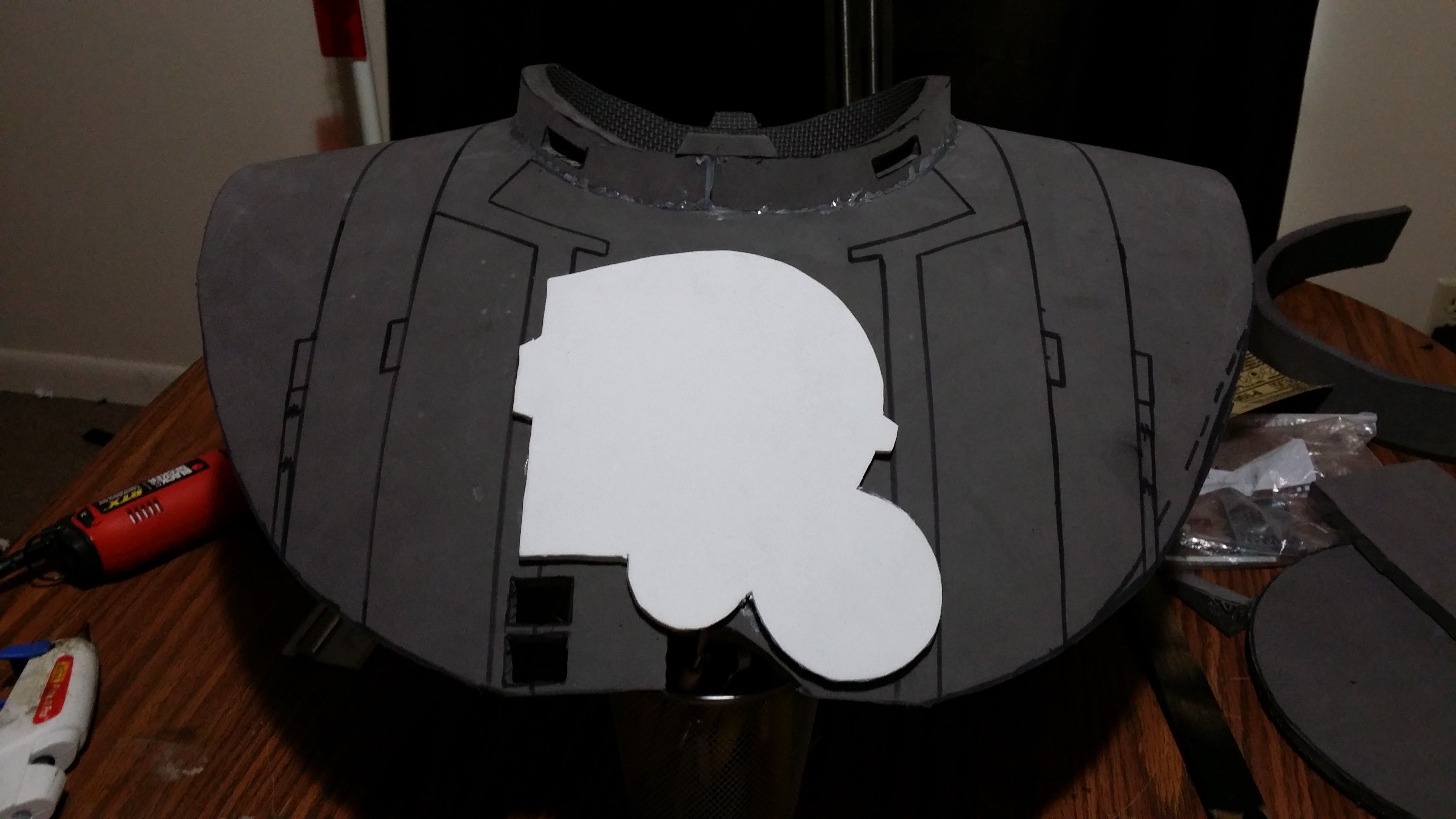

The first thing I went to making was the chest piece. I carefully measured and drew all the design lines on the EVA foam while it was flat, and then cut a 10" circle out for my head. My nugget is kinda large, but the 10" was mainly to get the wide collar look the finished piece has.
I then used a heat gun to heat up the eva foam and with the help of my son, I shaped the piece over my shoulders. I don't have a mannequin so all my work is shaped on my actual body. WARNING: Don't be crazy and shape hot EVA foam over yourself wearing just a t-shirt. Thats just asking for it. I wore a t-shirt and then put on a snug sweater before shaping the foam.
Now, while the curves over the shoulder looked great at this point, the shoulder line was perfectly flat still. I had to actually split the EVA foam in the back, up to the collar and then trim off a triangle shape out of the back, so that when I hot glued the seam back together it allowed for a slight slant to the shoulder line.
Here is the initial Chest piece base:
As you notice the curved cut on the front shape isn't quite as steep as what I have seen a lot of people do on their Malgus Chest Armors. The reason is because 1, in all the reference pics I am using, it has a lot more flat surface area at the bottom than the ones with the more intense "V" look, and 2, is because I am kind of a broad shouldered guy so it wouldn't look right.

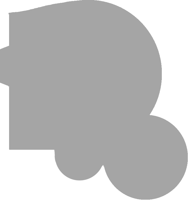

So I went ahead and cut out the chest piece center detail out of some thin EVA foam sheeting from Hobby Lobby. I made a stencil in Photoshop to make sure I got all the dimensions right. I have posted it below for anyone to use.

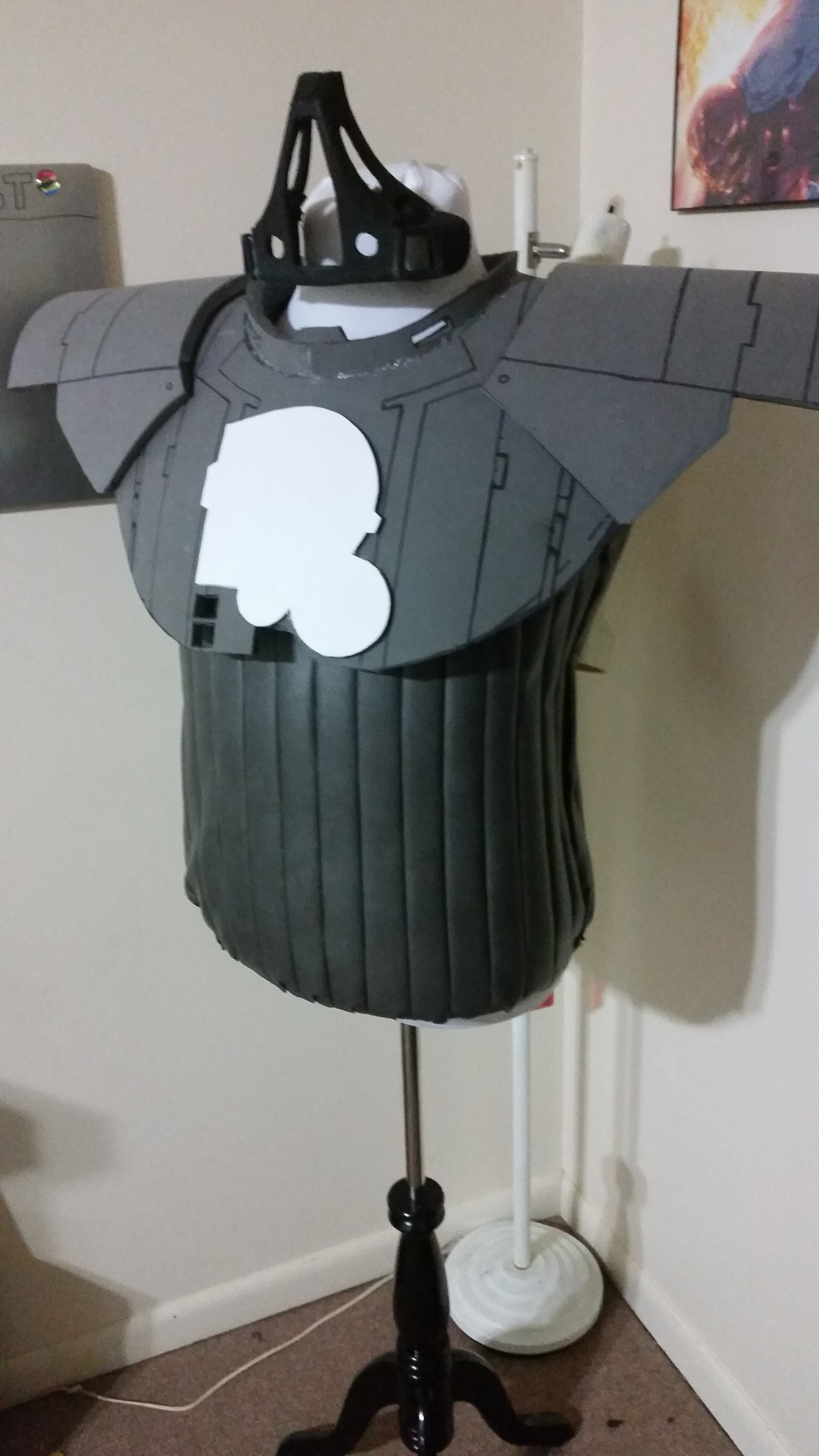

I've got the base piece for the Shoulder Plates added. It's important to note, that there is a second layer underneath the shoulder plate. I almost missed it myself, but if you look at the first reference photo above and then focus on the side view on the far right you can see there is a smaller plate layered underneath the Surface Plate. As far as I can tell this is to make the Shoulder plates sit parallel to the ground even though the Chest plate has a slight slant on the shoulder line. I have the strip for the top of the Shoulder Plates ready, but I ran out of Hot glue, so I'll have to add them later.

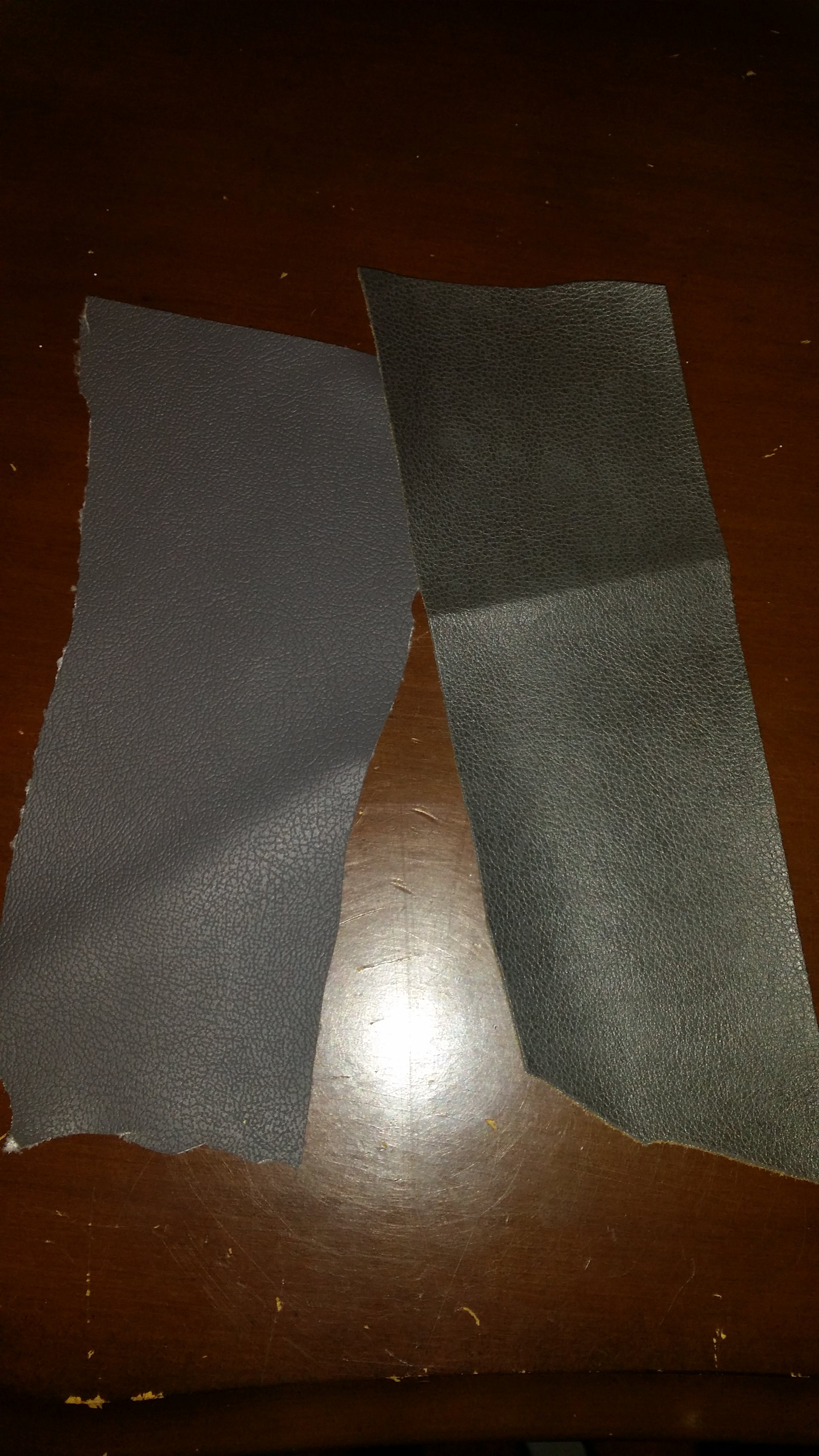

One last thing for today... My Under Suit Fabric Swatches Came in today!!!!
I have went through a bunch, but here is what I ended up with:
The top one is an Angus Graphite Faux Leather from Fashion Fabric Club. http://www.fashionfabricclub.com. It will be used for the under Shirt, It has a better sheen and is a lil darker as to match up with the Reference photo.
The Bottom is a Dark Titanium Knit-Back Vinyl from Bolta-Soft. I would link their site, but you can't purchase it there, I had to find an automotive customs shop here locally that had it. It has very little sheen and is the perfect shade for the Pants.

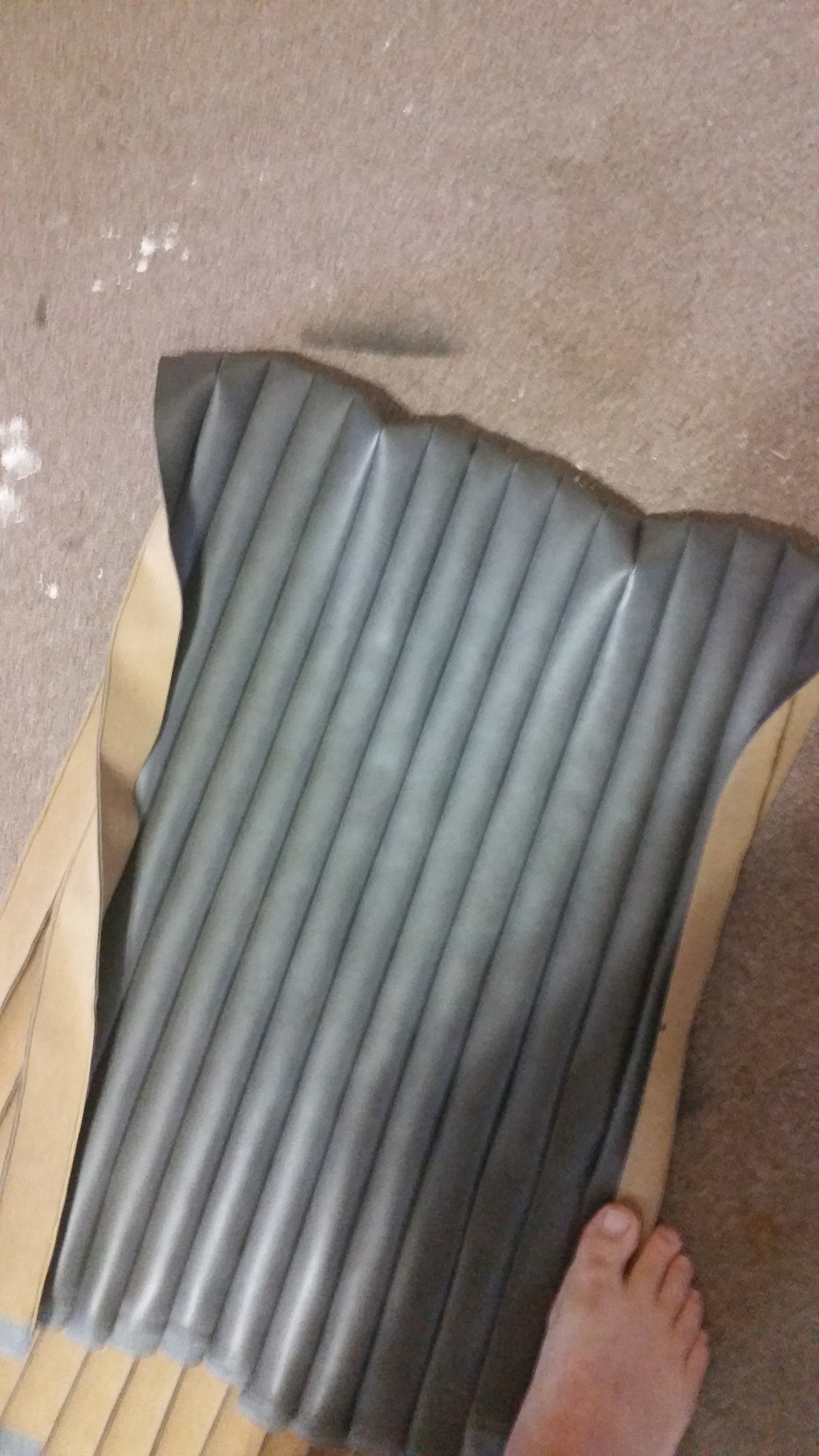

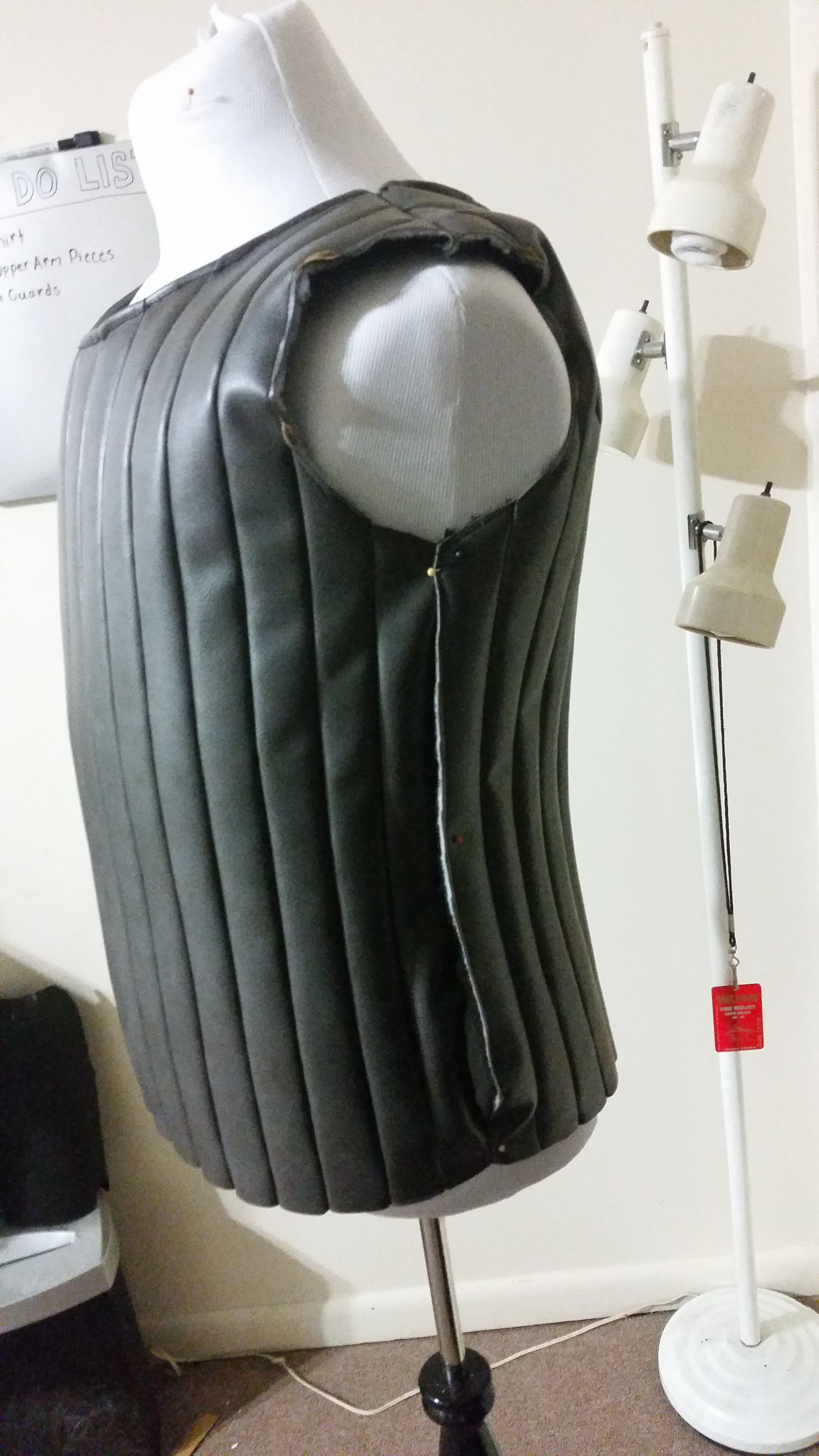

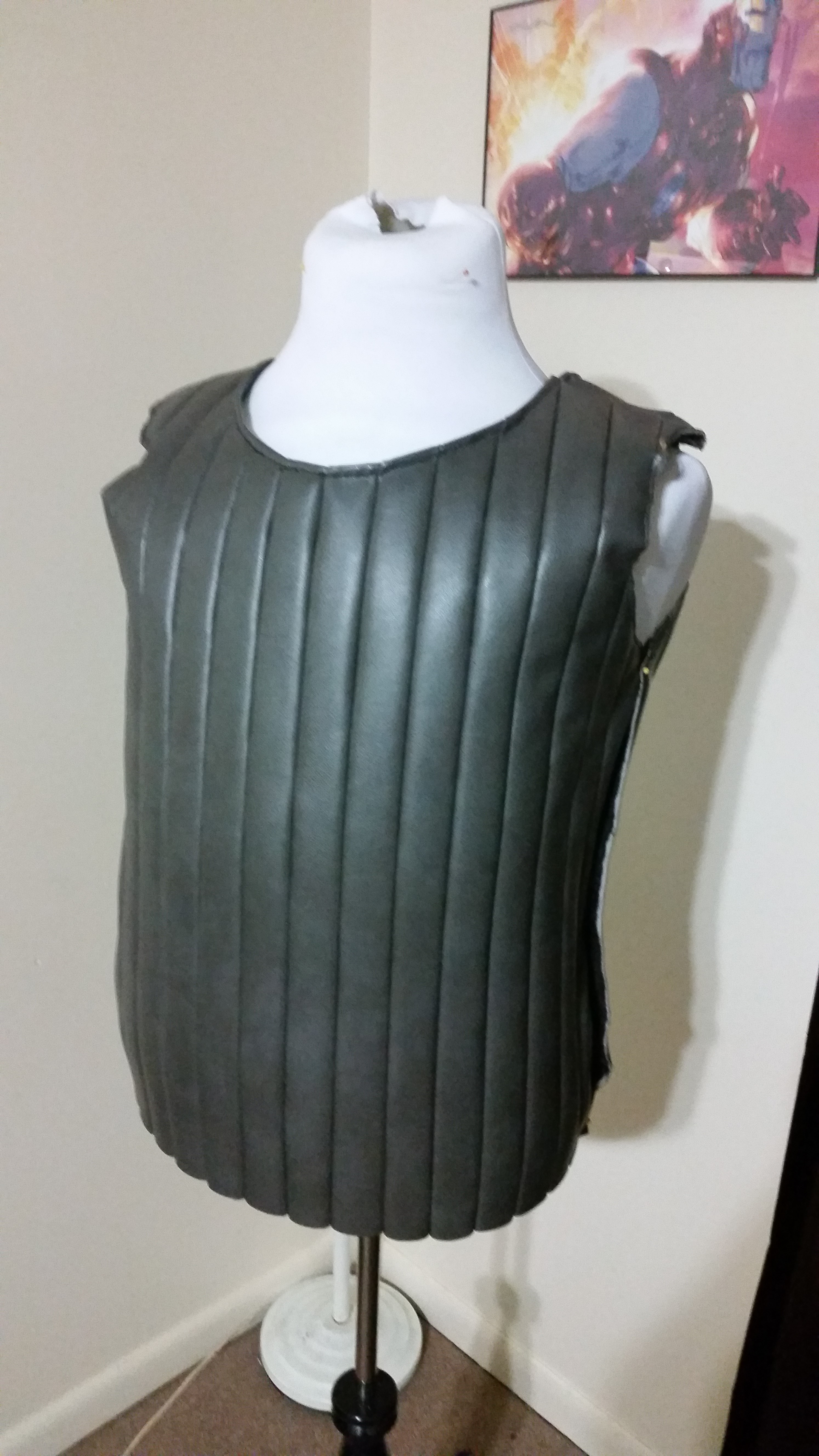

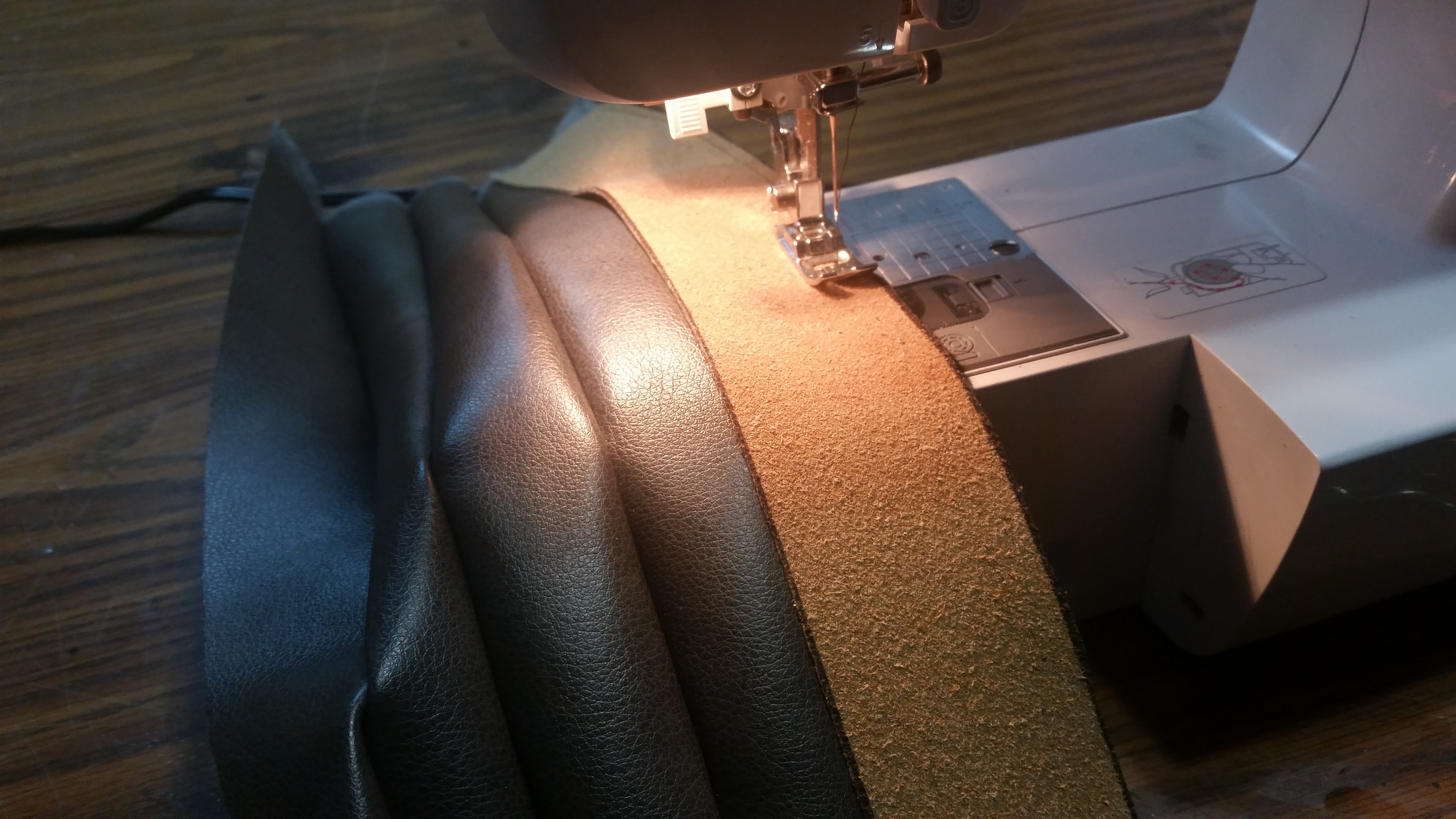

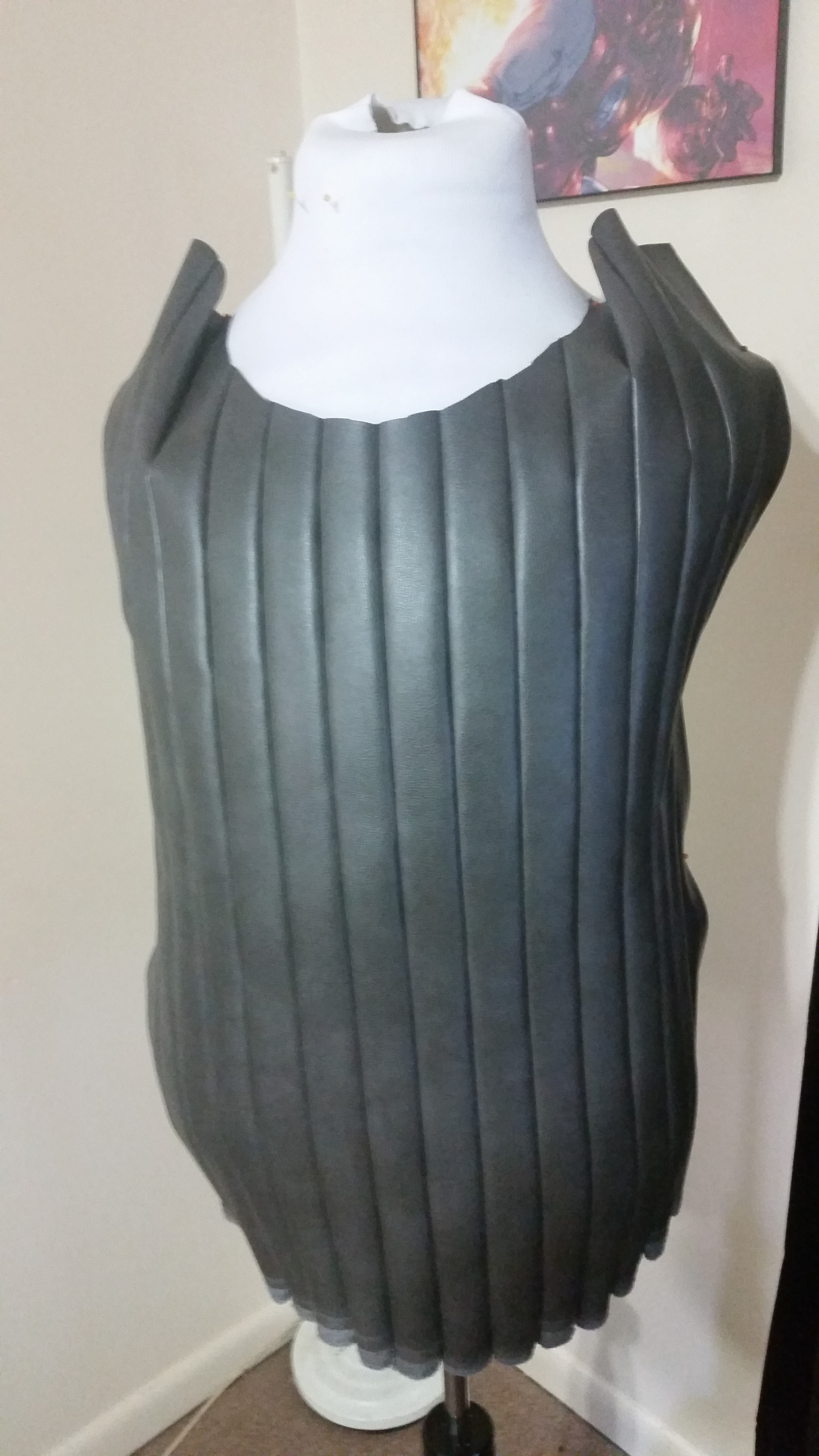

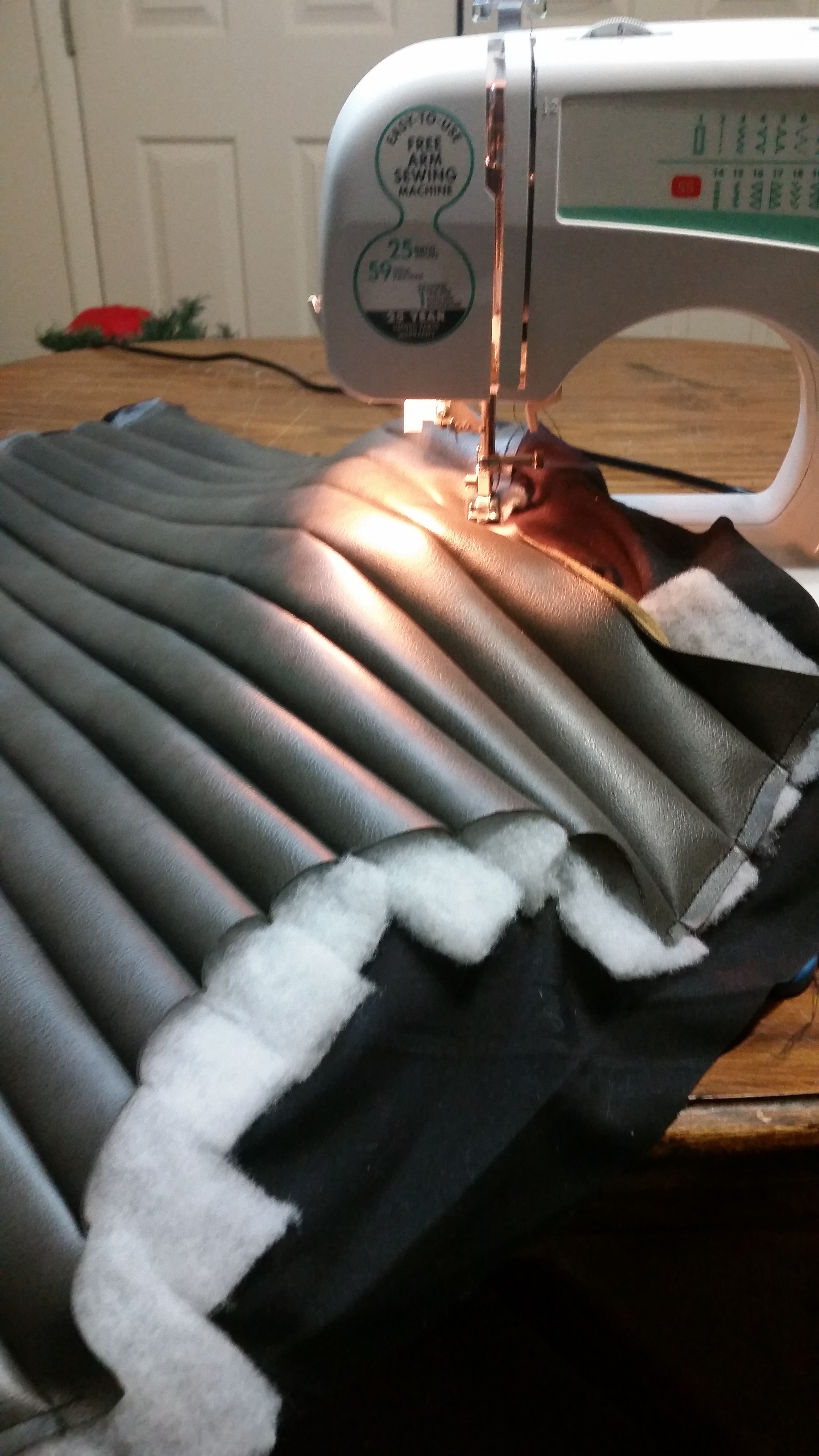

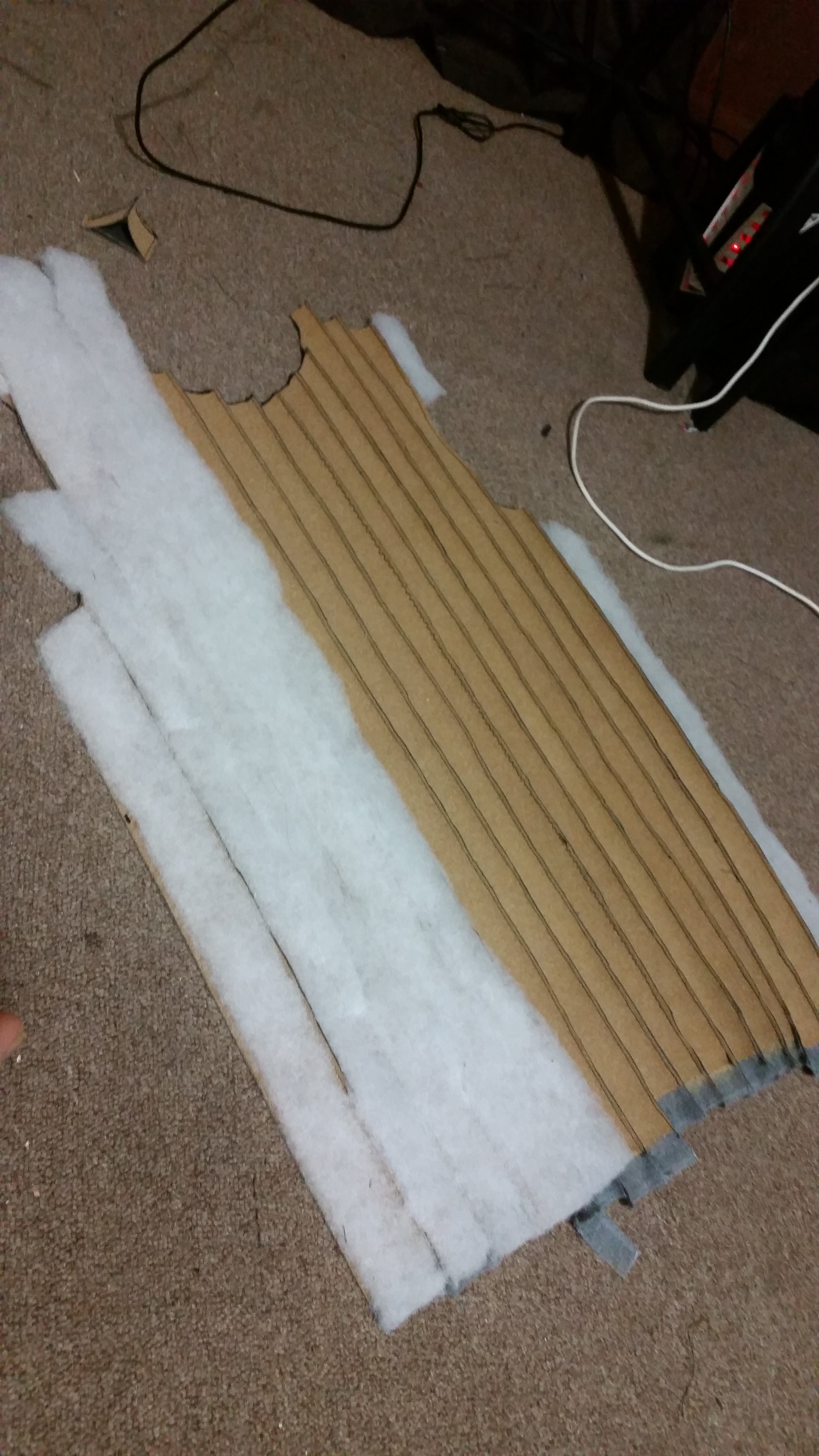

It looked as amazing as it did in the swatches and it was indeed the perfect choice. I got started with it right away and did some test patterns on how exactly I wanted to do the quilting for the suit. I had a few different Ideas based on ease vs. what will look the best, with looks winning out. The Ideas were:
1: Cut the leather into strips, Add batting and backing to each strip, and then Sew the strips together.
2: Cut out the whole shirt shape, Add Batting and Backing to it all, seam up the edges, and then go back and sew the "quilted" lines in.
3: Cut the Leather into strips, Sew all the strips together, then add batting and backing ans seam all the edges.
Options 3 was the clear winner. It looked way better than option 2 in which you just couldn't see the lines well enough and they definitely looked cheated on there. As for Comparing Options 1 and 3, There wasn't a lot of difference visually, and Option 3 was way easier to do. So without further adieu, The pictures!
Undershirt Measuring Strips.jpgUndershirt Sewing Strips Together.jpgUndershirt Strips Sewn Together.jpgUndershirt Pinned on Mannequin.jpgUndershirt Batting Added.jpgUndershirt Sewing.jpgUndershirt Sewn No Sleeves.jpgUndershirt Sewn No Sleeves 2.jpgUndershirt With Armor 1.jpg
I have the sleeves cut out and ready to sew, so that's what I will be doing tomorrow, and then I'll start on the Arm Armor. Hopefully by the end of the weekend I will have those sweet Gauntlets Foamed out. I'll post up some more photos once the sleeves are on.

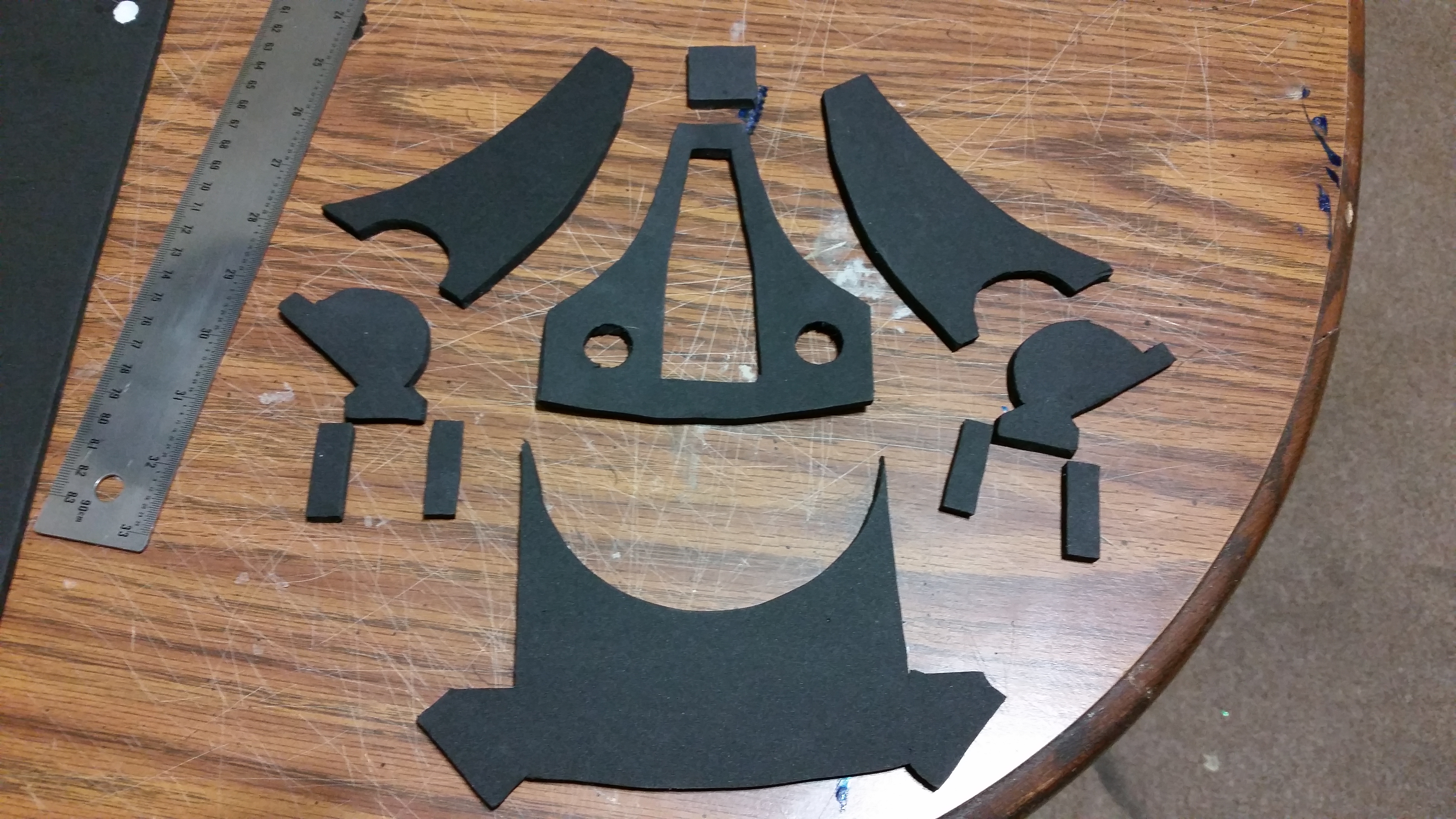

I assume you meant to type Mask. There were no casts made. All parts are made from scratch out of 5mm EVA craft foam. The only things used were stencils that i made myself on Photoshop. If you'd like, I'd be more than happy to share the stencil, just be sure to credit me for it.

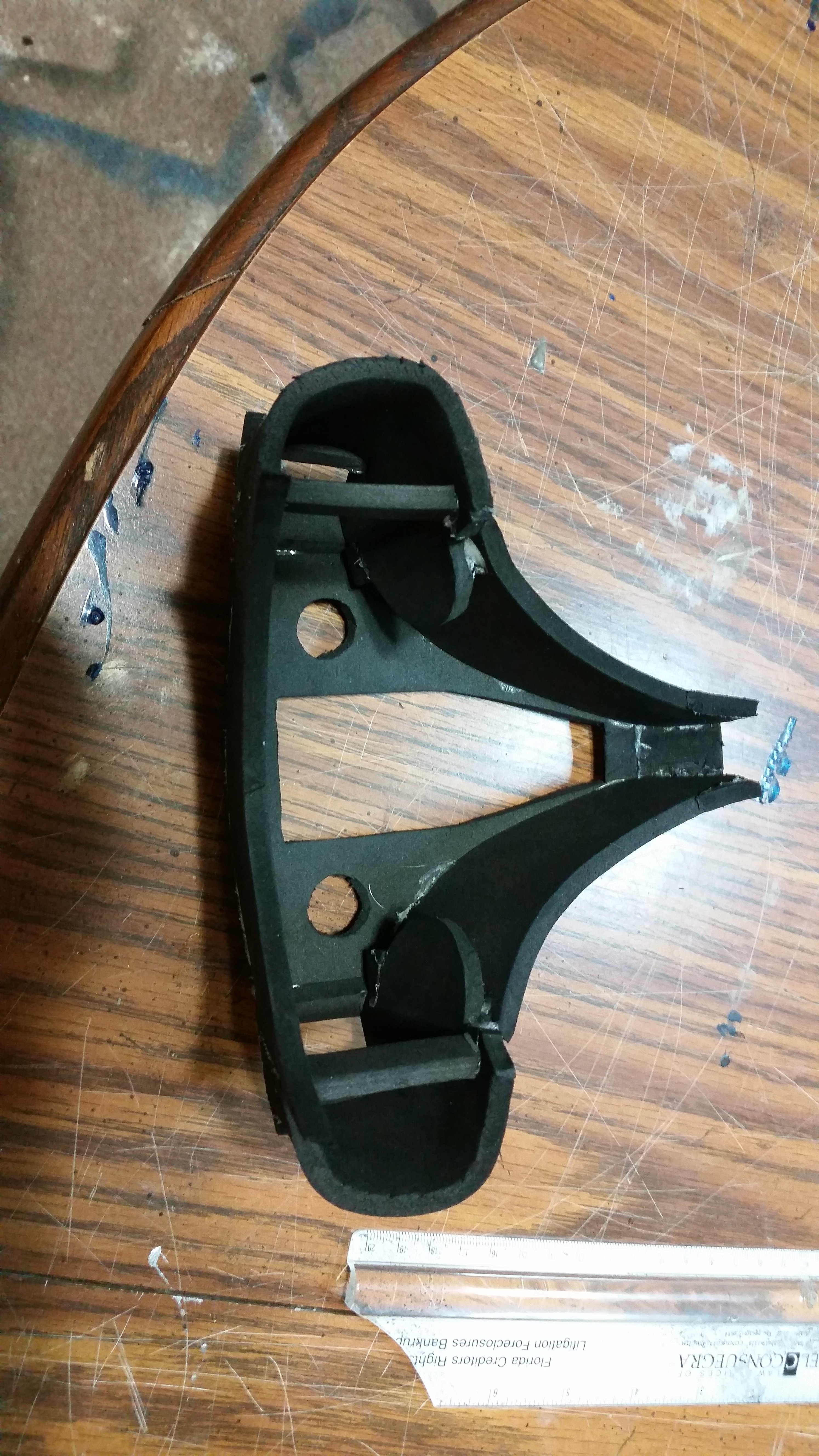

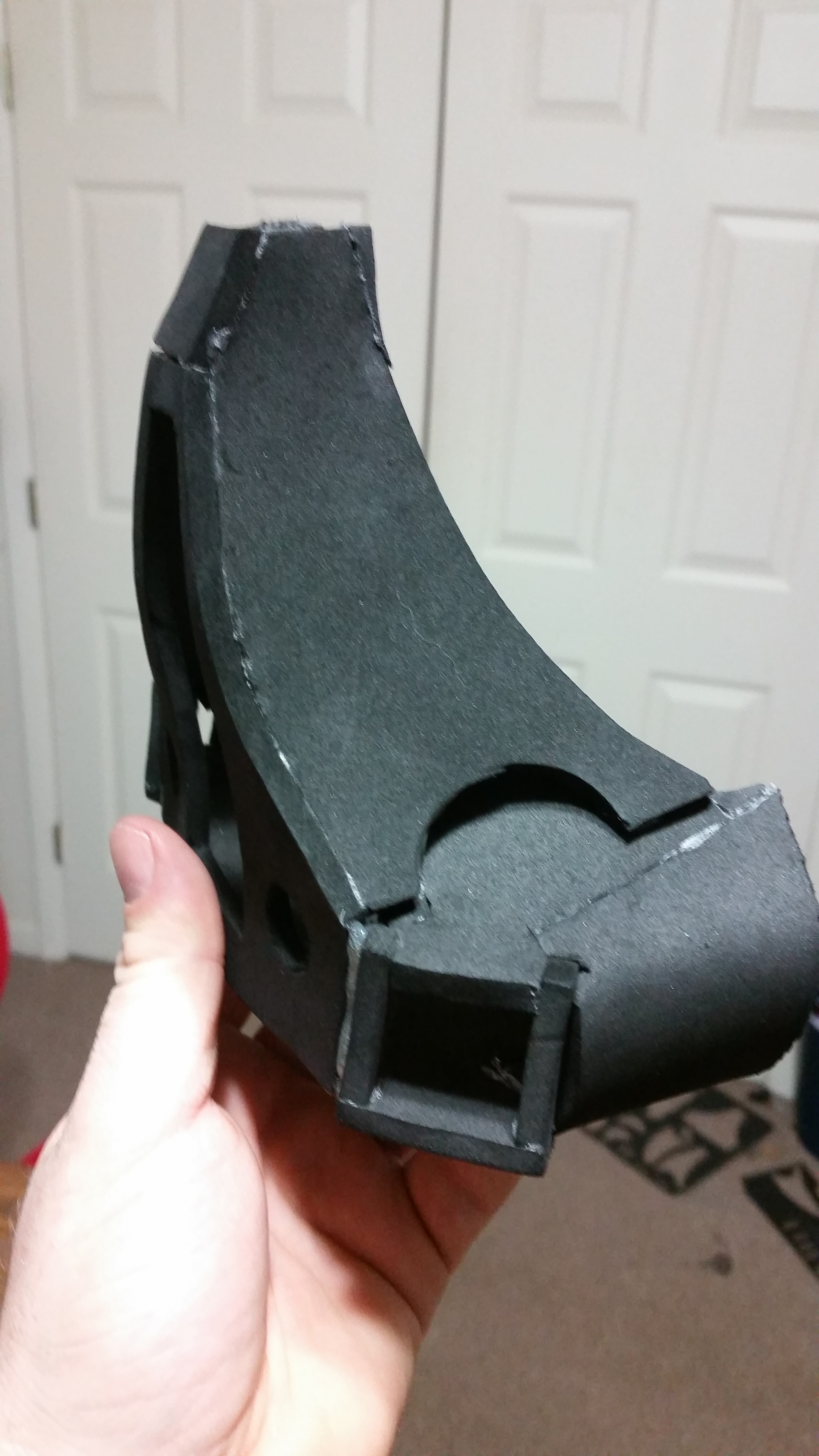

2: Arm Armor is fabricated and ready to go. I used another self made stencil to get all the light positioning correct. I did the ribbed part on the upper arms by taking a strip of 3mm foam and gluing one side to the arm piece, and then squishing it down a bit till it kept a slight curve to it and then glued the other side.
View attachment 449478View attachment 449479View attachment 449480
