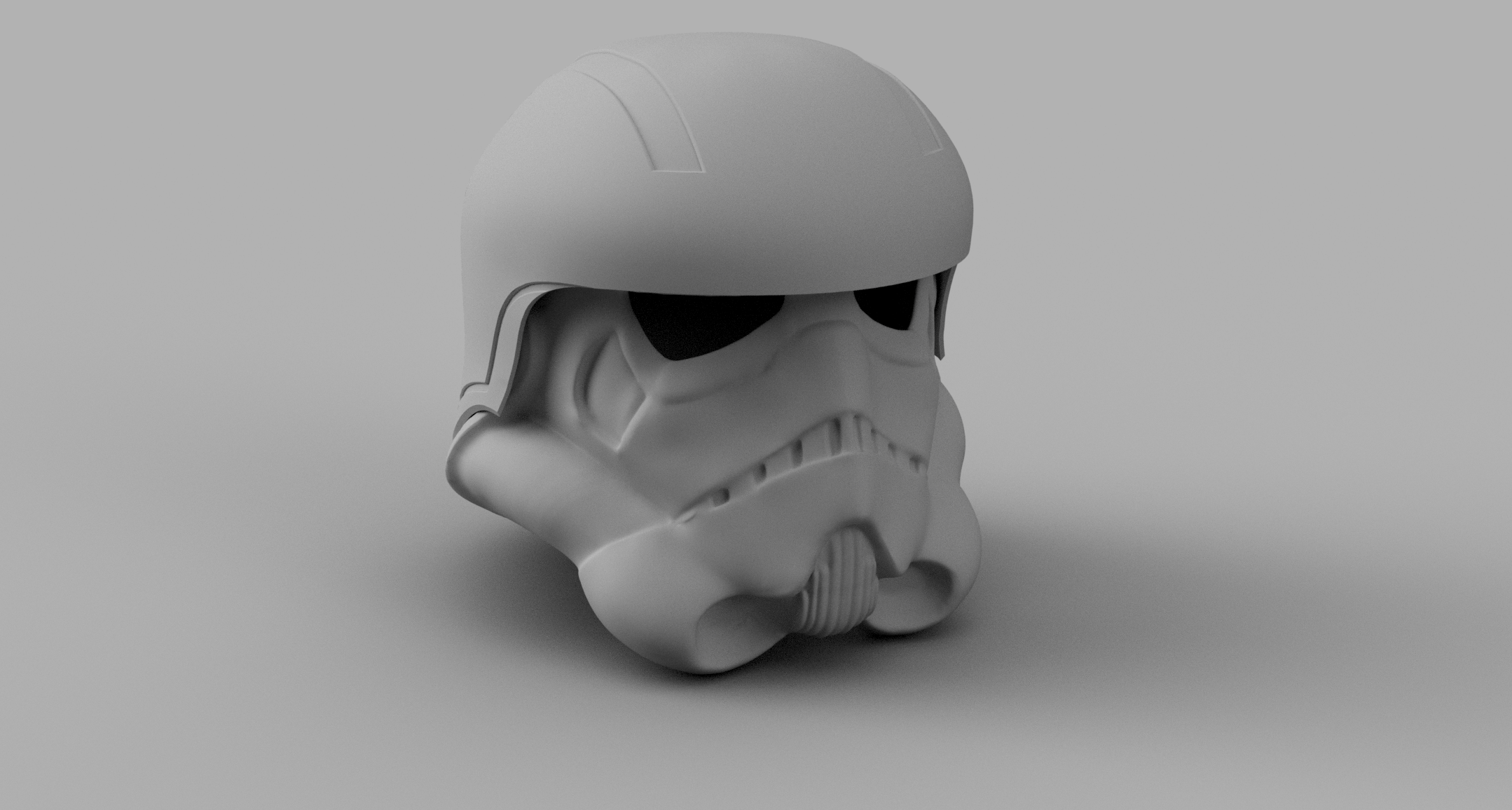

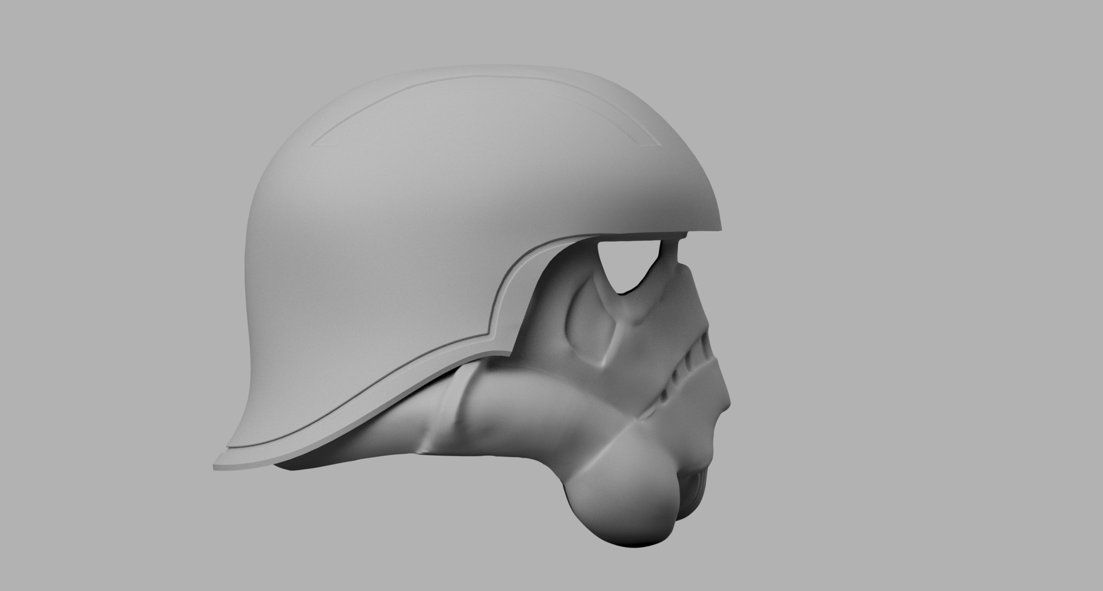

3) Pilot helmet. To me it looks like a combination of traditional stormtrooper helmet with the bowl head of an AT-DP / Imperial Cadet cowl on top. My 3d modeling skills aren't exactly the best as I'm still learning, but I should mainly have to just design the cowl to fit with a stormtrooper helmet that already exists, rather than reinvent the entire thing. This will more than likely be 3d printed.

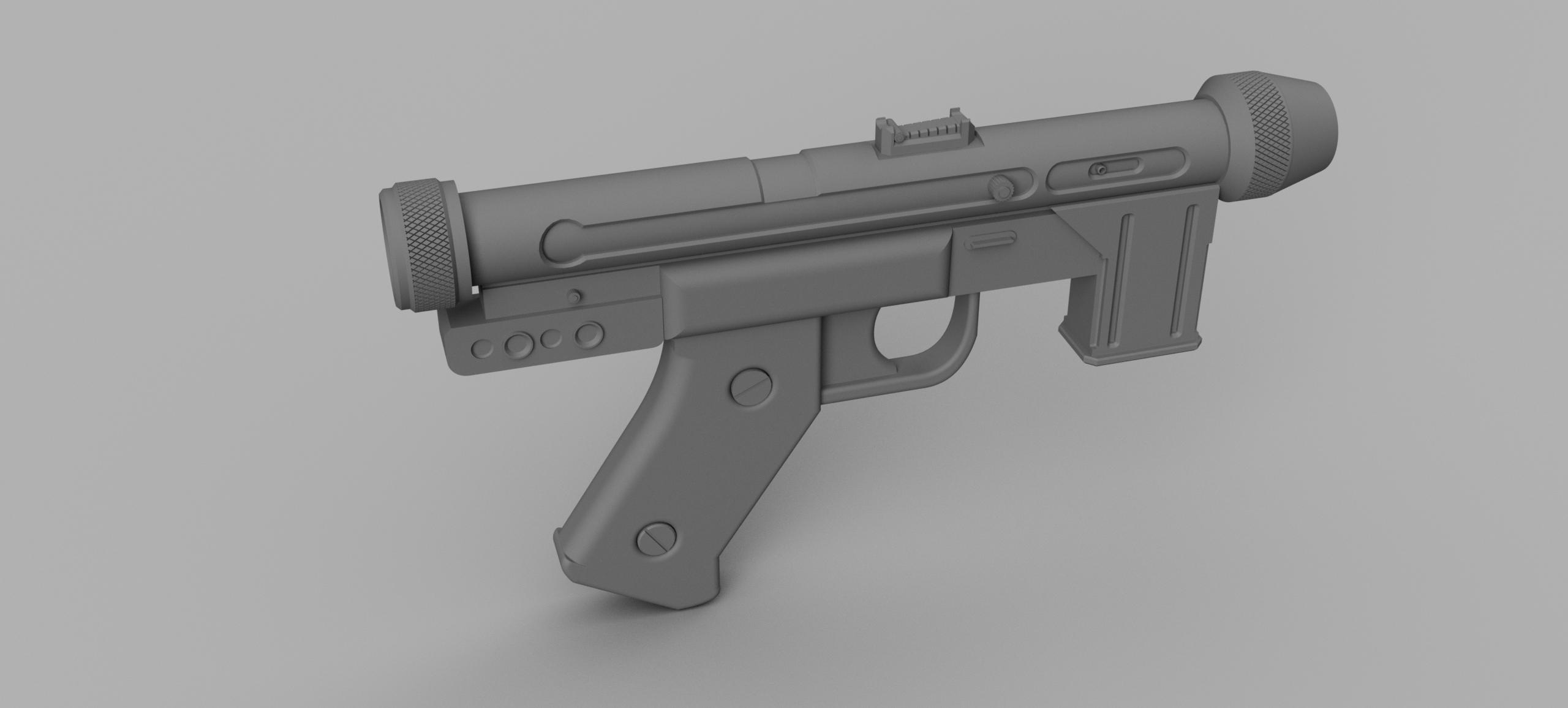

I've already begun on step 1. Using Fusion 360 I drafted up an initial model. My google-foo wasn't quite up to snuff when I went digging for reference photos (That's what I get for trying to find them at 3am after a long day at work). Ended up printing out a couple revisions of that base design to get everything right (Scale to begin with, then a matter of tolerances and exploration of connection joint experiments. But with the entire blaster in hand it just felt too large and bulky for me to be a blaster pistol.
So I started over from scratch. And this time I stumbled upon Hot Toys K2SO figurine, which comes with an SE-14 Blaster. Using that, based upon with the dimensions I already physically dealt with, I've come up with version 2.0:
I know it's not entirely accurate to an actual SE-14, but since it is based upon concept art (I'm awaiting the release of the paperback of the comics Task Force 99 are featured in to get a better look), I'm not too worried about that.

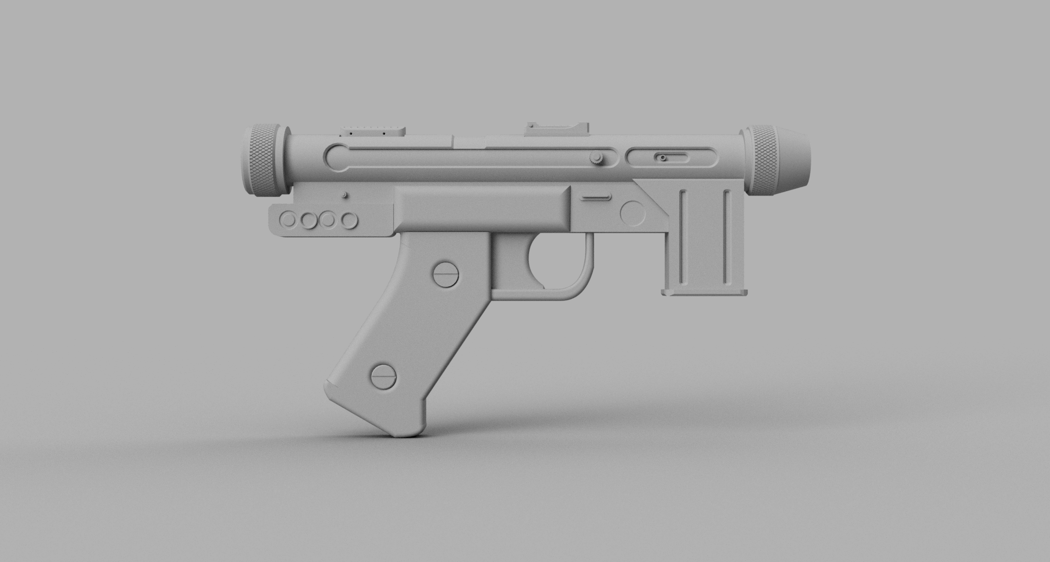

The last of my Christmas presents I was awaiting on, a pair of digital calipers, finally arrived, letting me get final calculations I needed to size my parts together. Some adjustments may be necessary once I get everything truly printed out and test print, but I believe everything should fit together beautifully. Here's final render of what the pistol will look like:
After about seven hours printing, I was able to see roughly the size of the pistol will be, and test fit my electronics. Note the "magazine" is not the actual one for this version; I've yet to print it out and used one I had already printed out for another revision. It's essentially the same, however the new version is a little shorter and has different ways of attaching together to the rest of the printer.

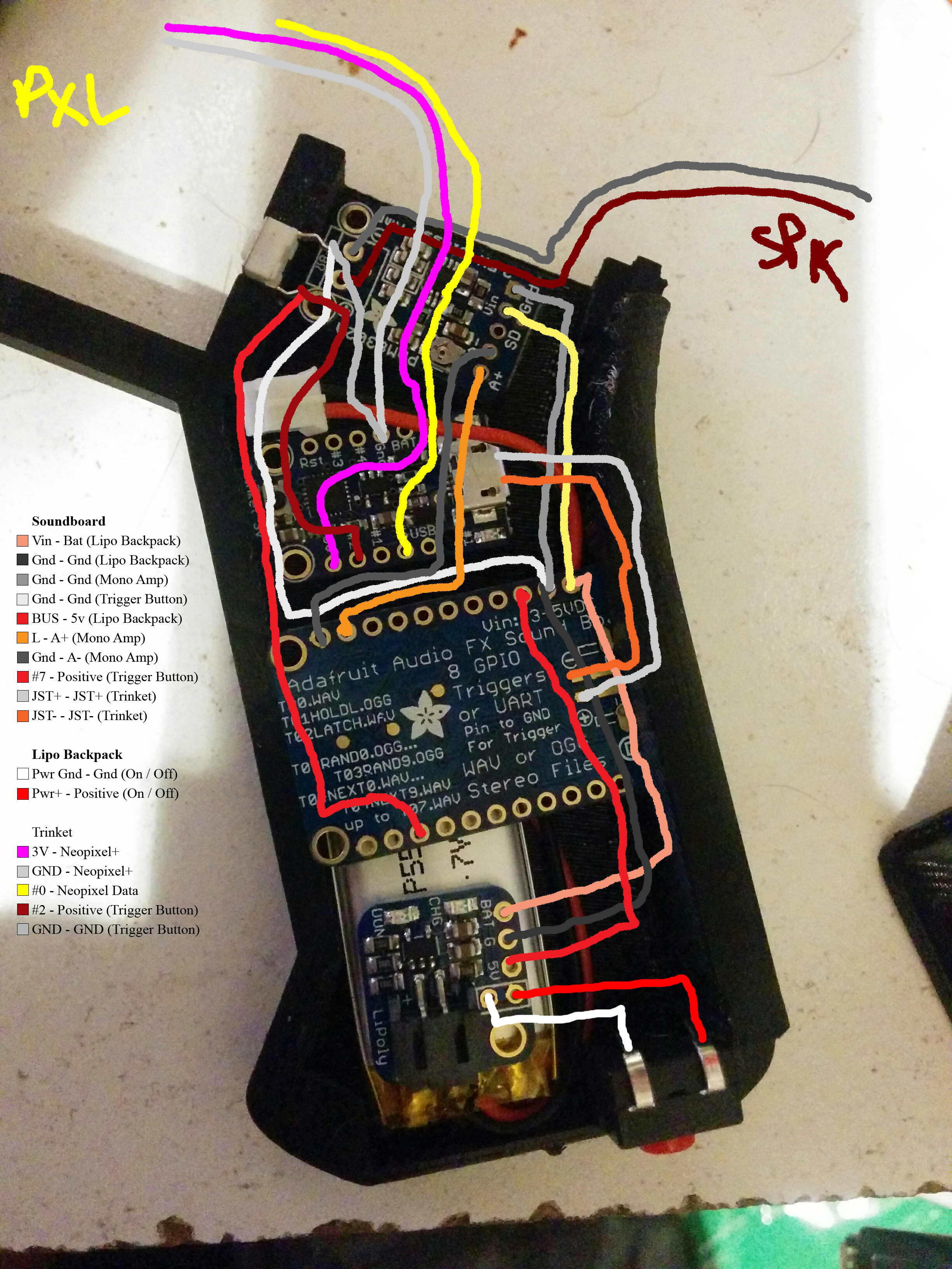

And speaking of wiring, I finally managed to put my wiring diagram, based upon my breadboard layout, together in the handle. I'll be using 30awg wires for everything, so there should hopefully be enough space within to press everything down. I unfortunately don't have enough wires in as many different colors to use as in my diagram, but it'll help a lot for bringing everything together. I'll likely end up taping certain wires or putting on small sheaths of heat shrink to identify which wires are which for assembly.

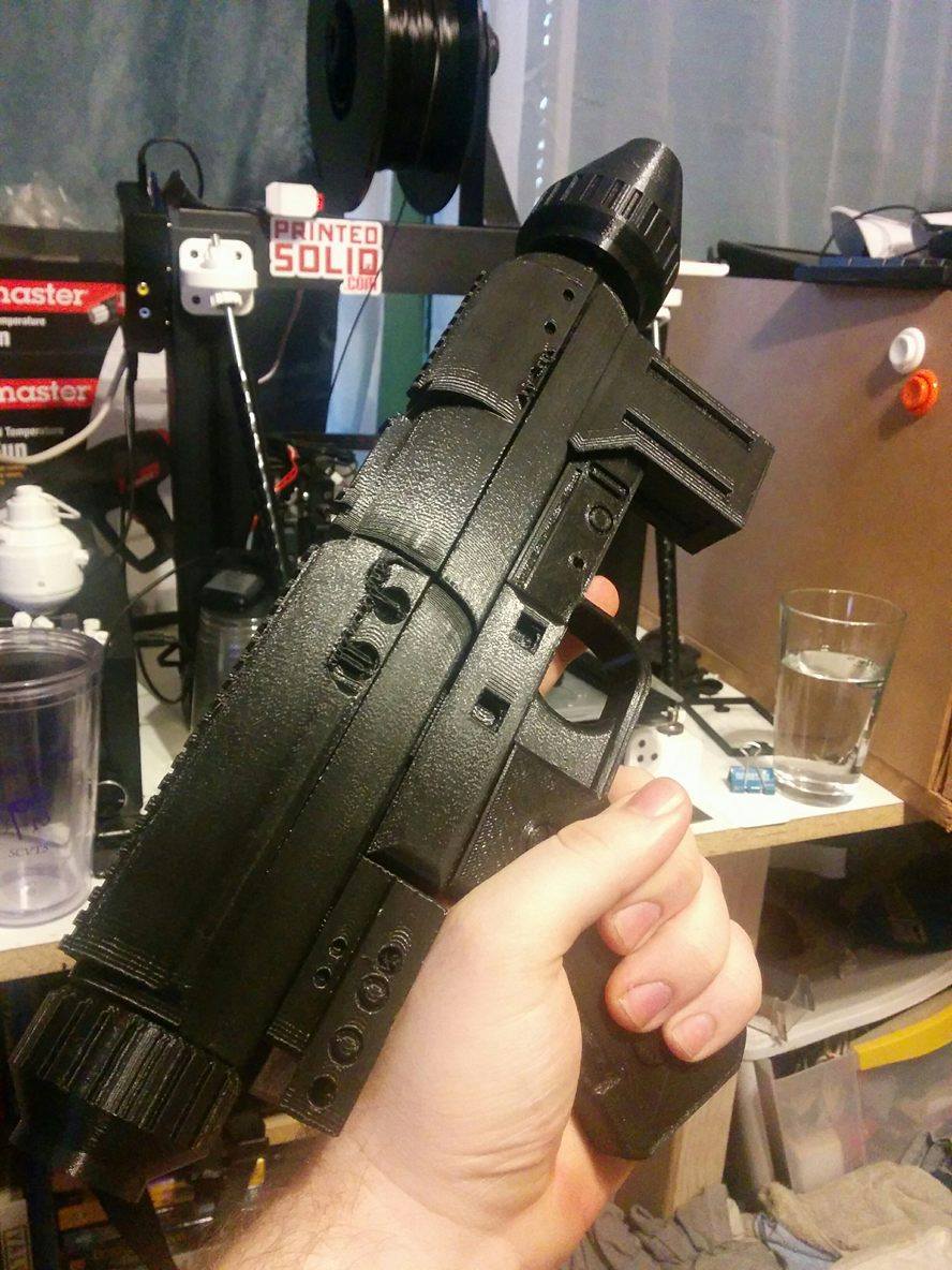

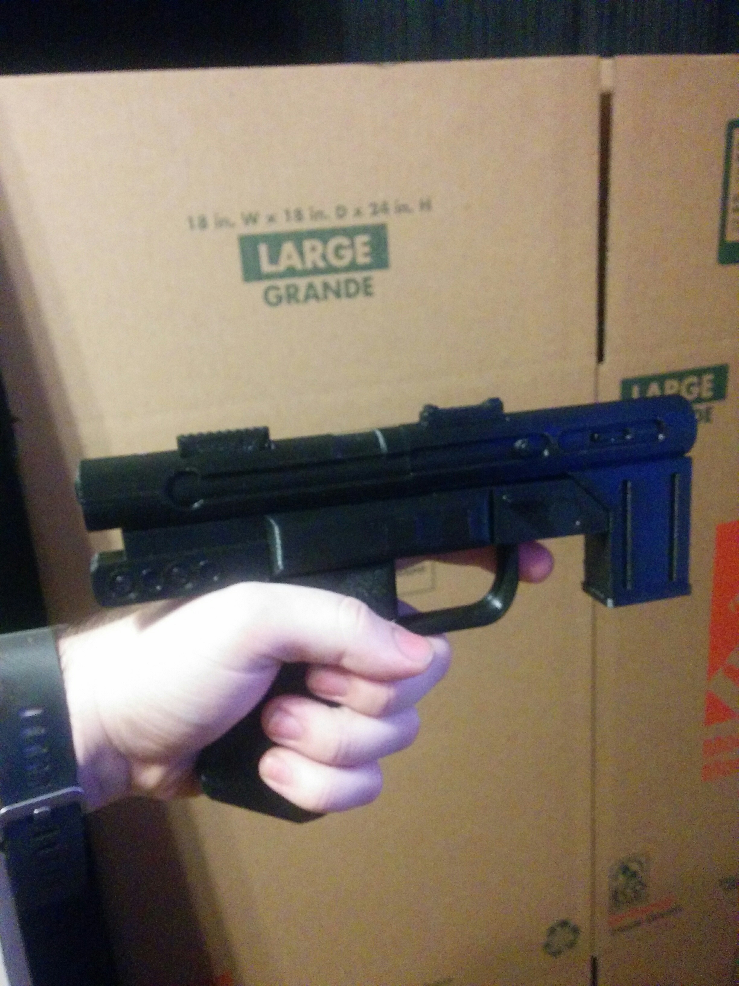

So after a slight snafu with making a wall too thin in the handle and it not printing, I finally got one pistol fully printed! (Minus a trigger. I need to work on that some more so it'll press the tactile button / fit nicely / spring back and forth).

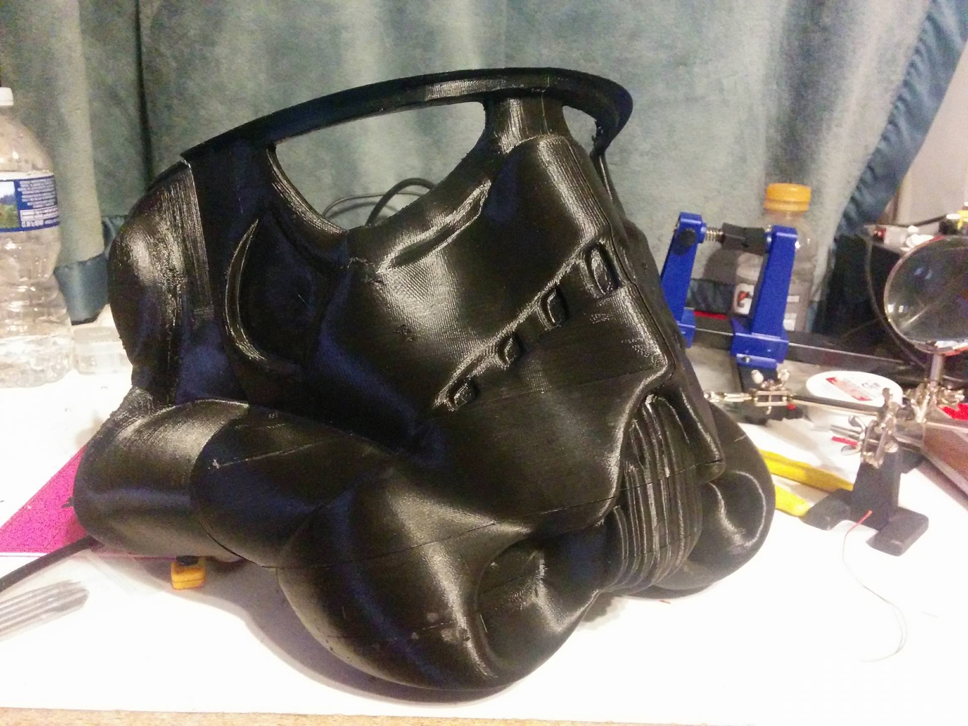

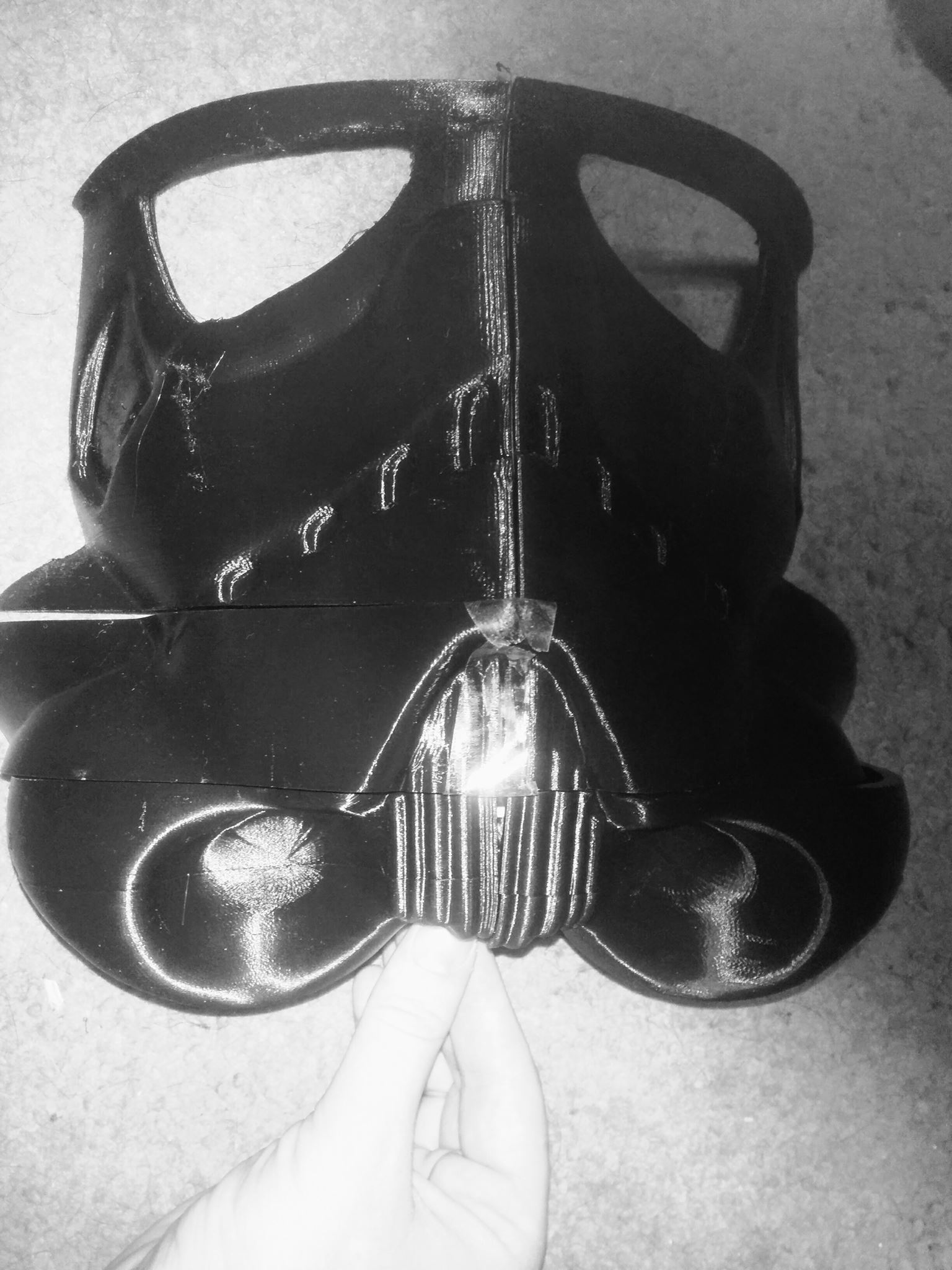

So with today as much of the Eastern US Coast got hit with snow, myself included, I decided to work on the helmet. Hit a few roadblocks at first, but I was finally able to get the shape worked out to how I liked. Gotta work on a few other things like attaching it to the base of the helmet and all that fun stuff to make sure it'll actually be attached to the helmet. Thinking about adding the back vents of the stormtrooper helmet to it to give it a bit more dimensionality to it rather than being a mainly round hood.
Pilot Stormtrooper v5 front.pngPilot Stormtrooper v5 3.5.pngPilot Stormtrooper v5.pngPilot Stormtrooper v6.png

First up, 3d printer's been busy churning away. I recently got my bed dialed in enough to be able to reliably print at 0.1mm on it. It's been a pretty big increase in print times, but I'm loving the quality out of the prints. Been busy get the main faceplate of the helmet pumped out, and all these parts in total took me about 80 hours roughly:
I'm thinking to save filament for parts that will never be seen, is to print out the cowl next, and then use some cardstock and fiberglass to stiffen things up and fill in gaps. Should save me a lot of time and filament by not having to print essentially the same opening twice, as well as some weight. As well, I would slide up the back sections so only those bottom parts I need for the rim are revealed. I'm saddened by the fact that if I were to print the next four main pieces I need altogether, it'd be a 60 hour print :/

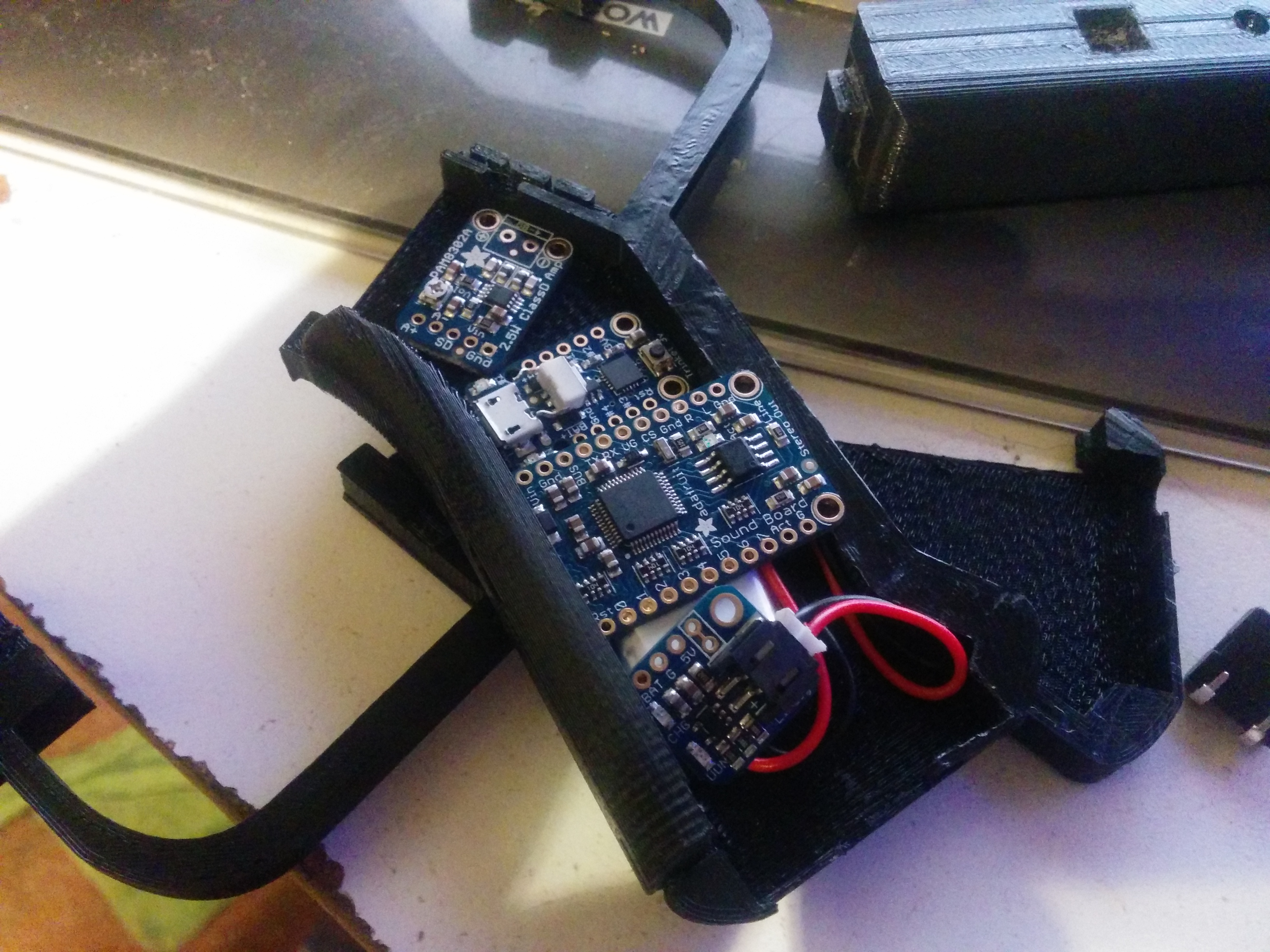

Also finally got through with support for my electronics, and got a replacement soundboard that I needed. So I was able to get everything all wired up for a test fit:
Everything's roughly where I want it to be. I'll need to tape some things down for final assembly, and trim some wire lengths up when I do the second pistol, but it fits and works, so it's a good experience.
And here's what I was most excited for: Pressing the trigger and hear the pew pews!
Now to yank all the electronics out, sand things down (Definintely printing the second pistol iat 0.1mm instead of .2mm), prime the parts, and stick the electronics back in. Unfortunately only space I have to really work and sand is outside on my deck, so may have to wait for weather to warm up a bit.

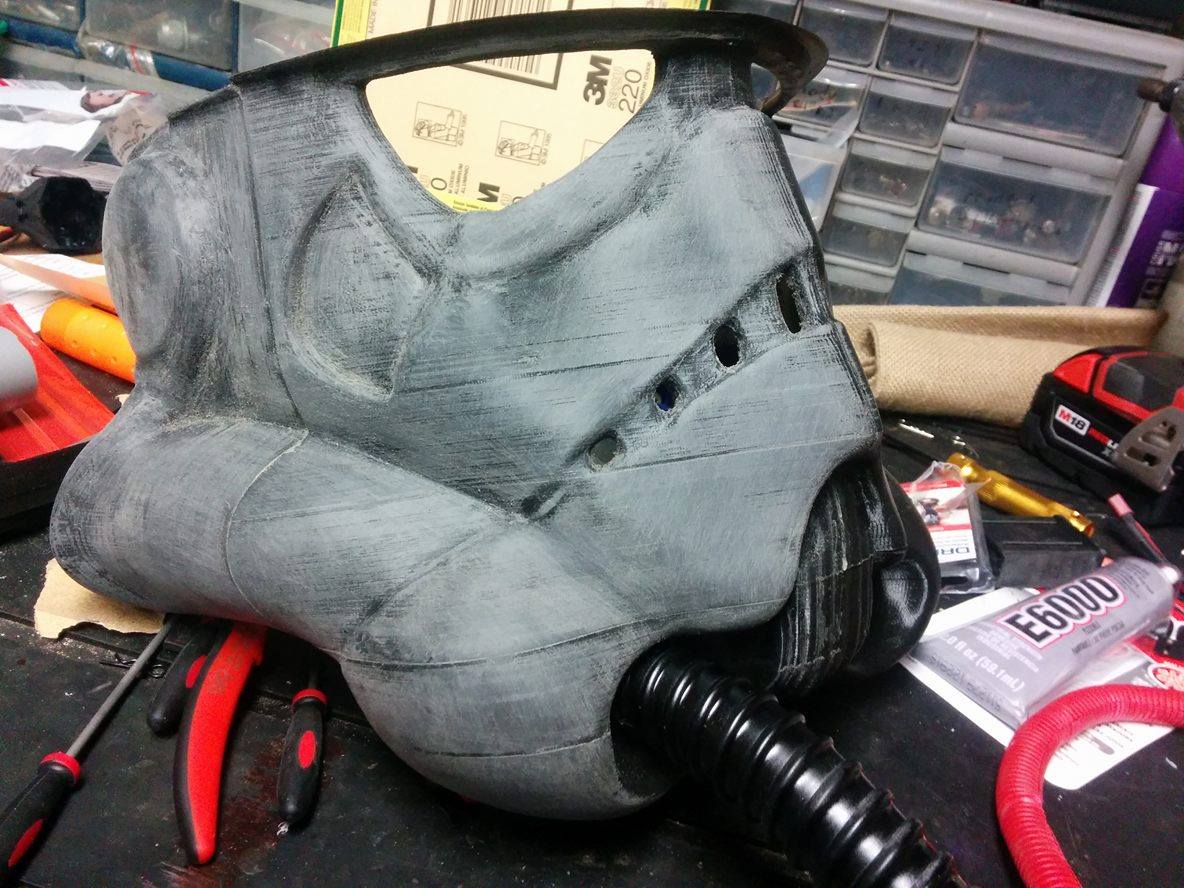

After that hit up my local walmart for some more sandpaper, glue, and other misc. supplies. Picked up a couple graphite pencils to try a cool technique saw Bill Doran do: Flat black paint the pistols, then apply some crushed up graphite. Gives it a nice sort of sheen,
Also picked up a vacuum tube that I think will work well for the air vent box, amongst some other supplies, including some weathering paints. And finally, I got to work sanding down the helmet, while the rest of the pieces for it print out:

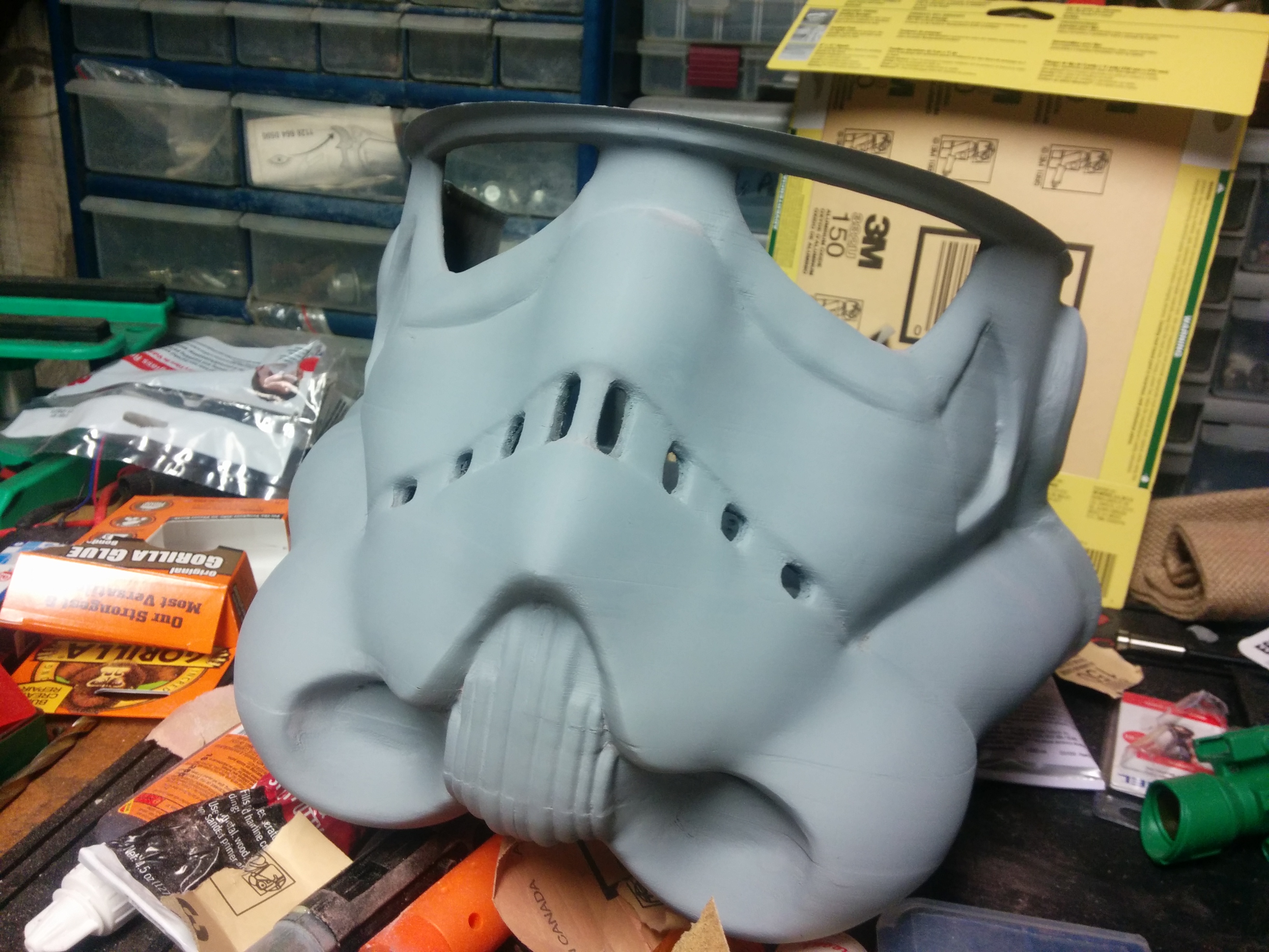

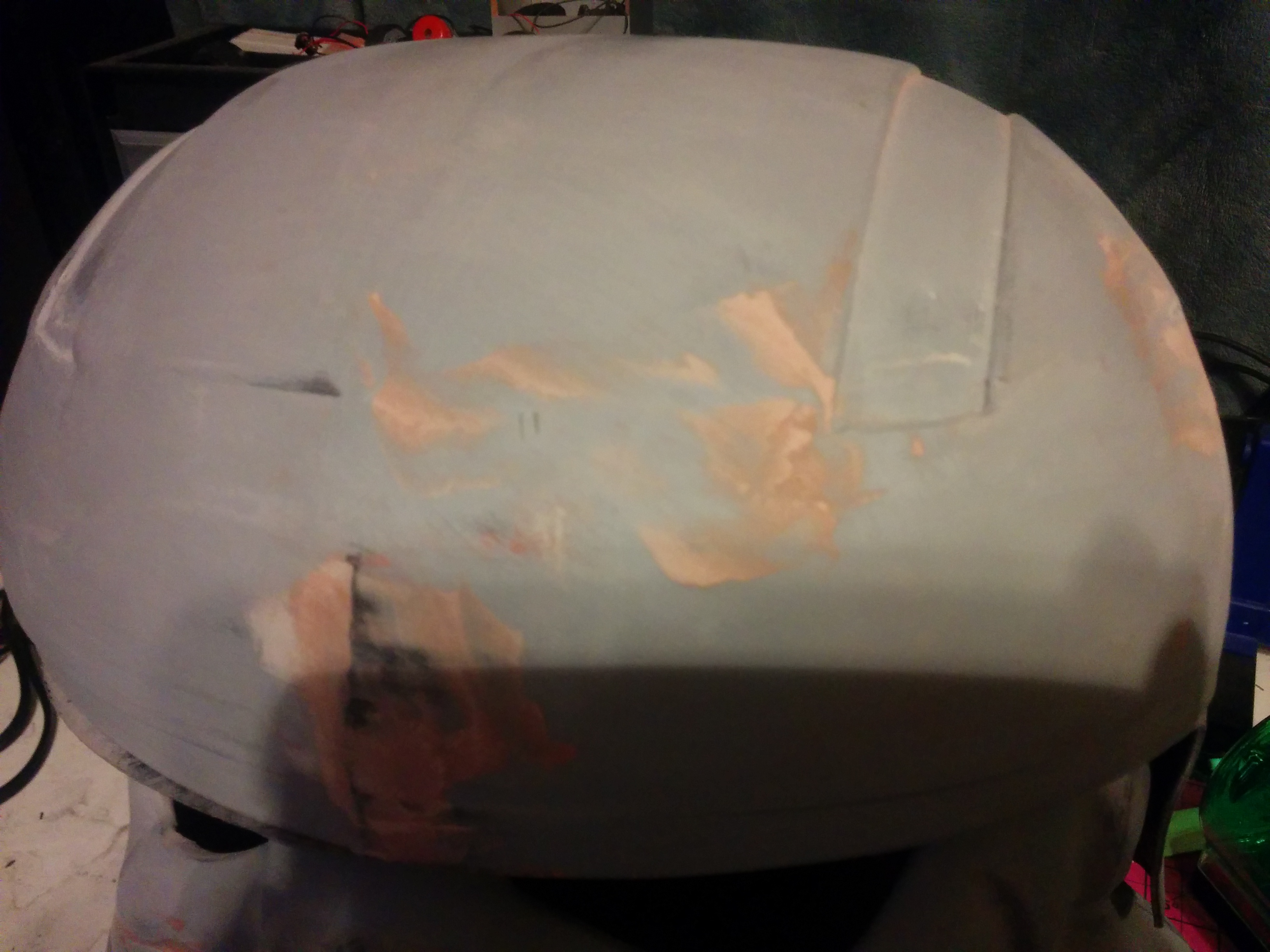

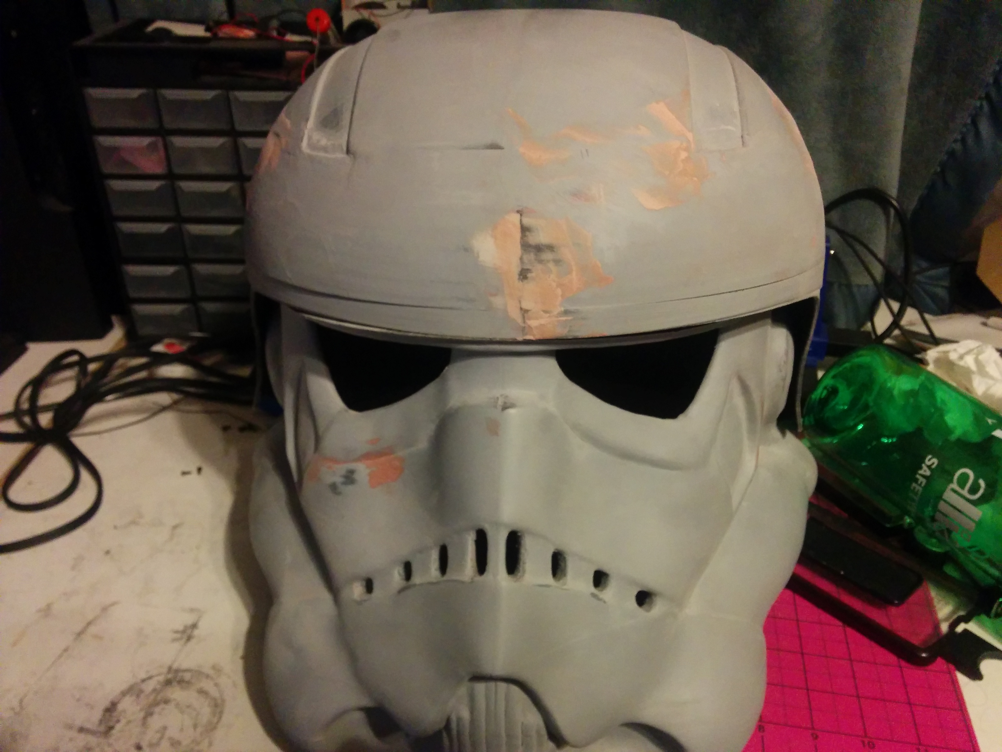

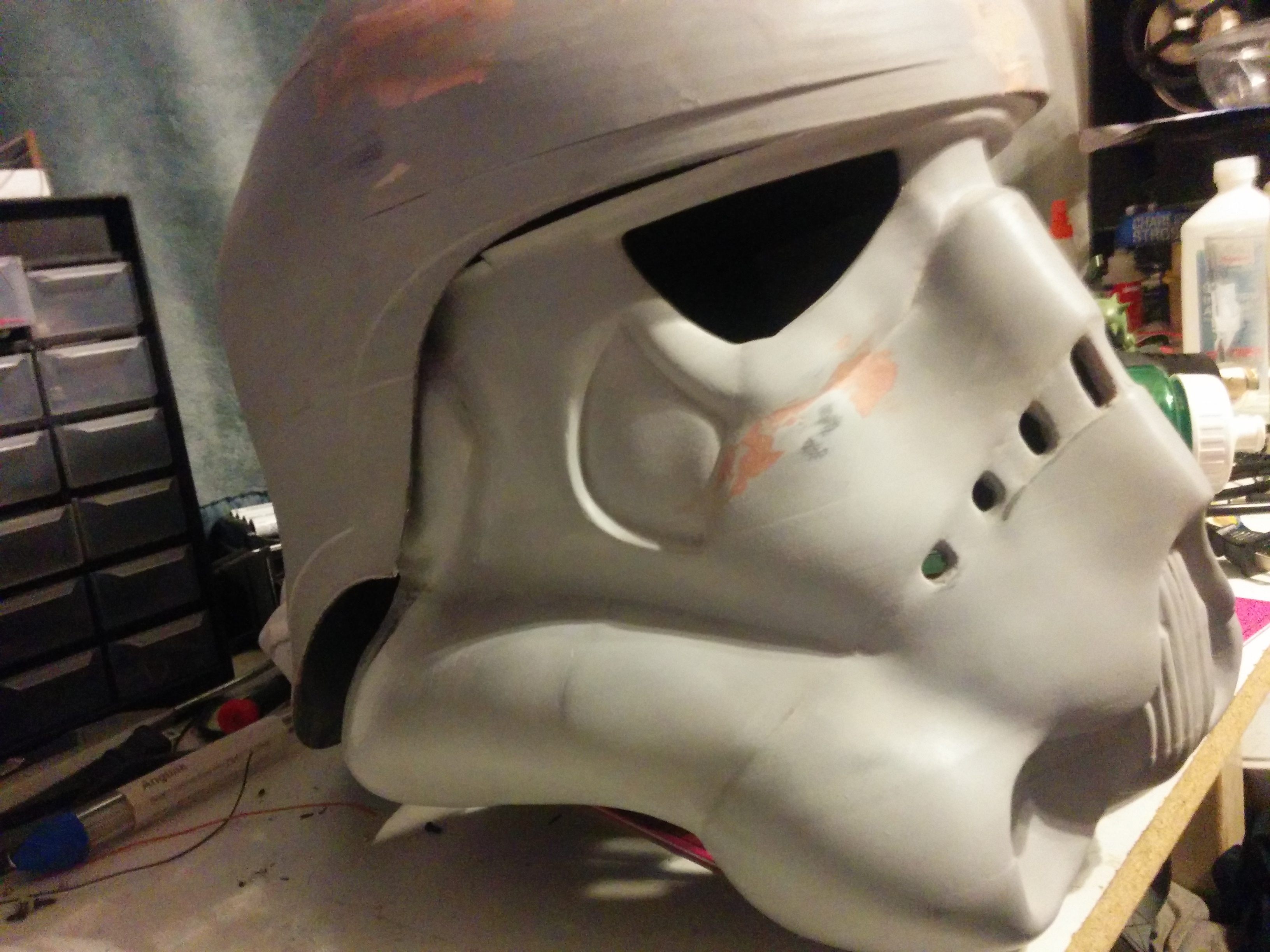

I've been full force working on the helmet as lately, sanding and smoothing, primer, sanding and smoothing. Got a couple coats on now, and it's getting to level where I'm starting to get satisifed with it. There's definitely trouble spots, considering that it's been rather cold out and my spraying area is limited. I need to figure out a better rig so I can rotate it around and get a nice even coating around.

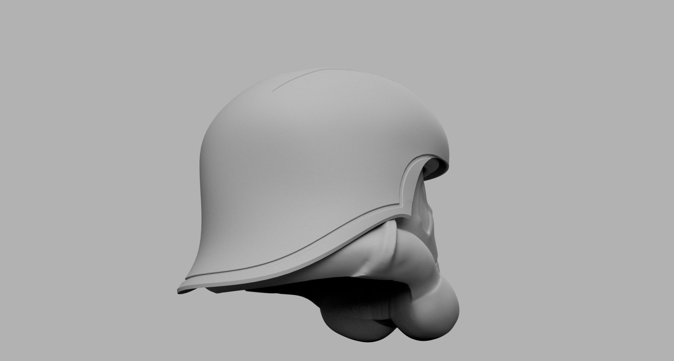

It's a lot more straight back depicted in the comic than it appears in the concept art. I'm thinking I like the cowl as I designed it, closer to the concept, than that style for the helmet. What do you fine folks think?

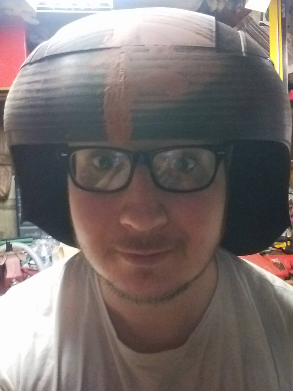

Quick little update,
Haven't been doing much. Been waiting on the cowl pieces to finish printing out fully before doing anymore work, mainly due to the fact that I've run out of dust masks to wear, and I'm waiting for new respirator to arrive from Amazon (I could have popped down to local Home Depot and get one, but I was ordering from Amazon anyways, and with Prime I thought it'd have been here Saturday, like rest of my order, but won't be here till Wednesday). Already begun sanding and filling in some of the gaps. Don't mind how looks in some of the pictures, I had to scrunch my head down to wear it without it separating, because I just couldn't resist putting it on!
