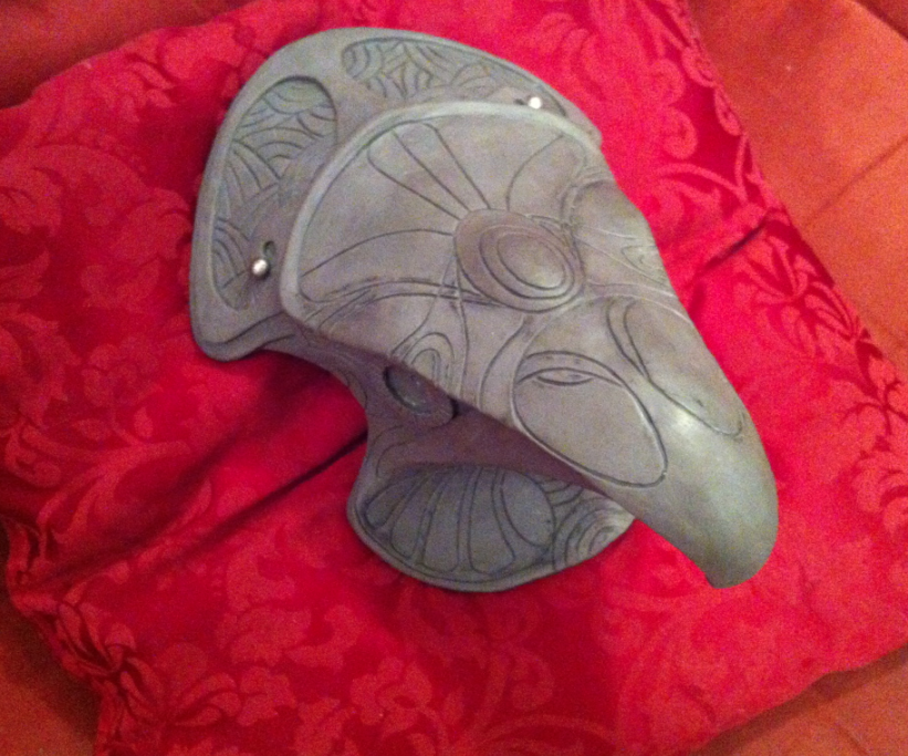

Two year ago I started to make a more precise model in plasticine, planning to made a silicone rubber mold:
I made also a good quality head, and I made a mold:
But when I start to replicate the Horus' head in resin, I discover that the result was heavy and fragile. Compared with my current helmet, the new one made in resin will be too heavy and fragile. So I decide to destroy the plasticine helmet even if it was almost complete.
