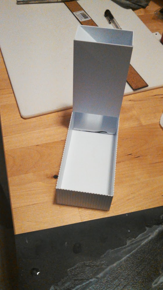

I built the basic form using Evergreen styrene sheet...
I tested it out and determined that it was hard to drop the dice in the hopper, so I added a bit to the top, and then started stealing kit parts to greeble it up.
