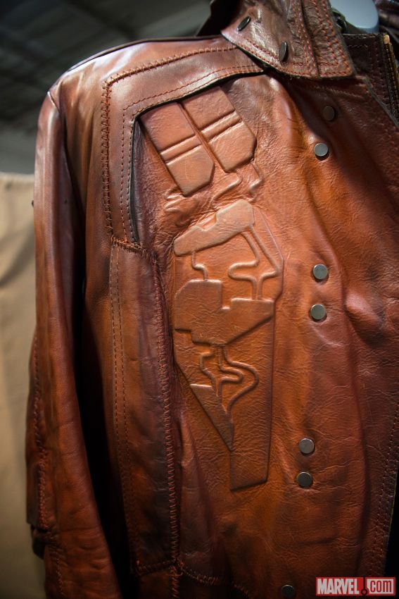

Don't get me wrong, but the trench coat is not the same color as what the Hot toys have figured it out. Here's another visual reference for the actual leather trench coat. The trench coat has got 2 layers by the way. Now I let you hunt for more references. Muahahaha *Flies away to home planet*
Happy searching hunt my Star-Lord friend. :lol Star-Lord fan to another.

For you, here's an extra reference of which I meant its a double layer for that trench coat. Well technically, it's like a cut leather jacket, and trench coat over it.
Still trying to figure out the exact color of the trench coat. Is it Maroon, or Chestnut? Since its a Marvel Custom, it's a blend color. When you see it from up close its chestnut distressed color with some reddish wine blend to it. From far way, it is Maroon blend with.....Err so many choices. Here's where I could used some help though. :lol
Also, what you said about the video is true for the case of trench coat reference. Its an absolute excellent video showcasing the patterns details of the trench coat, and the Hottoys Star-Lord Action Figure.

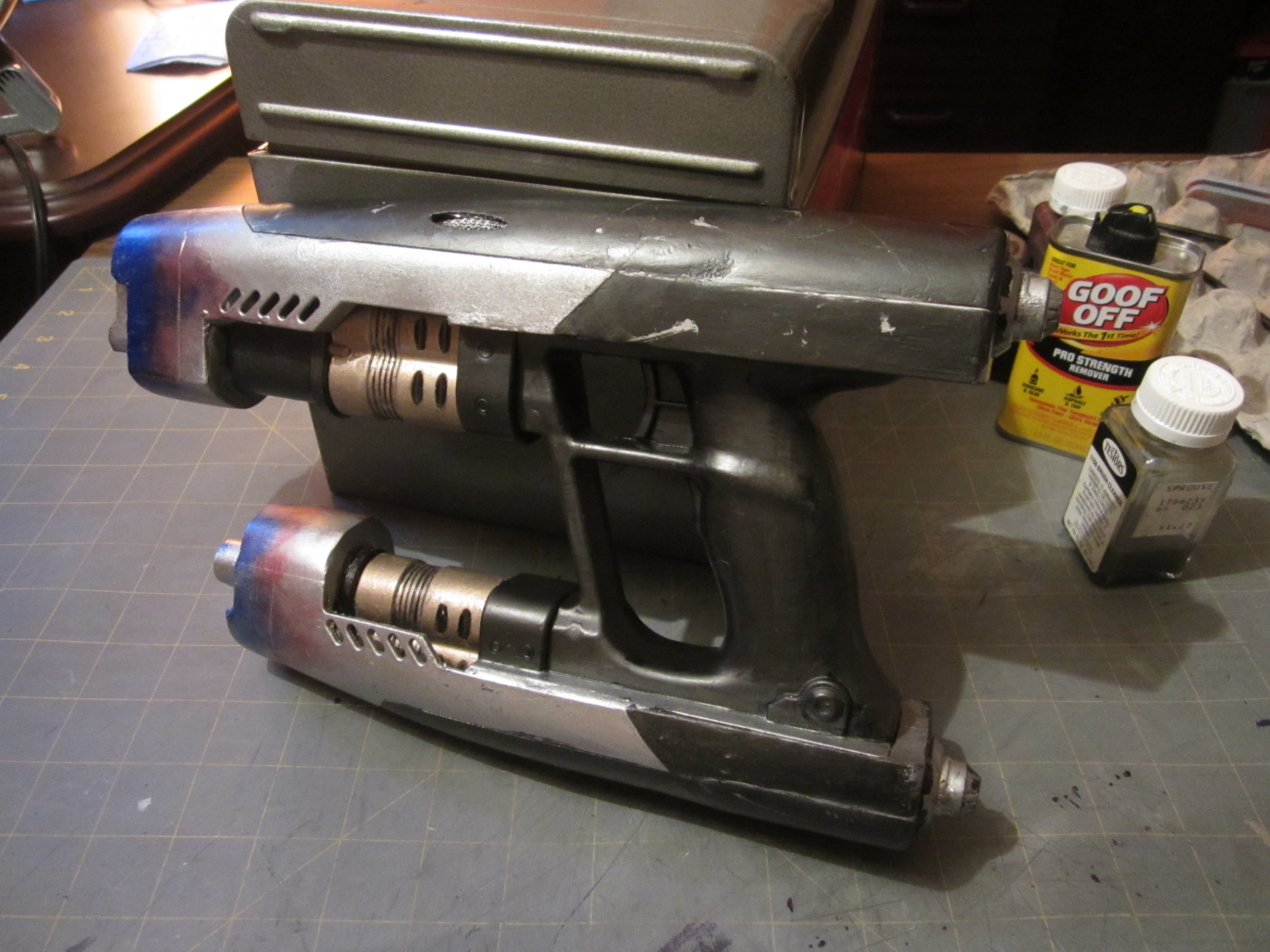

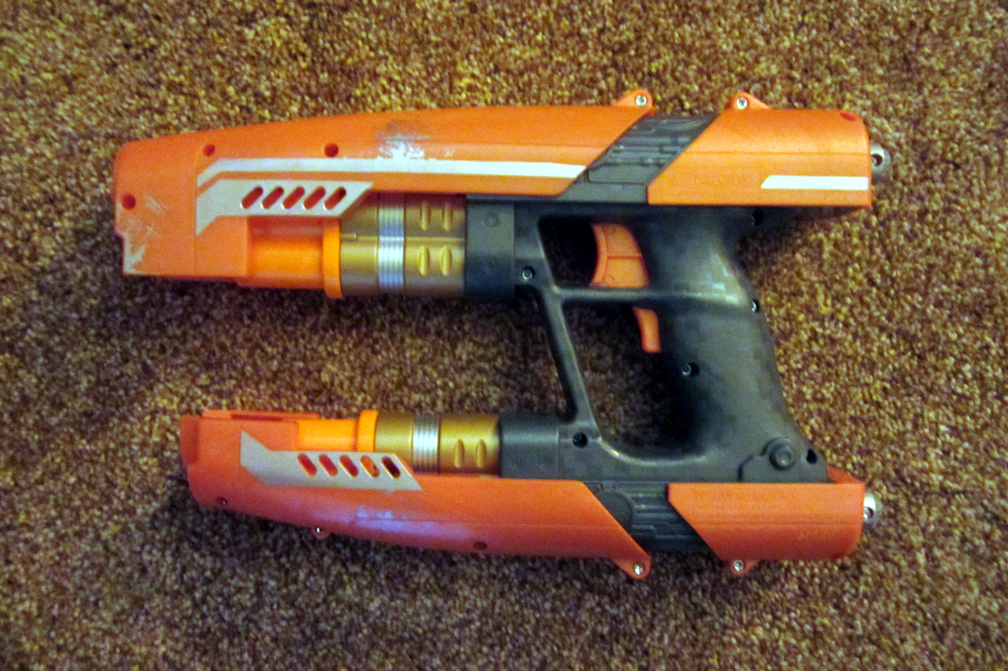

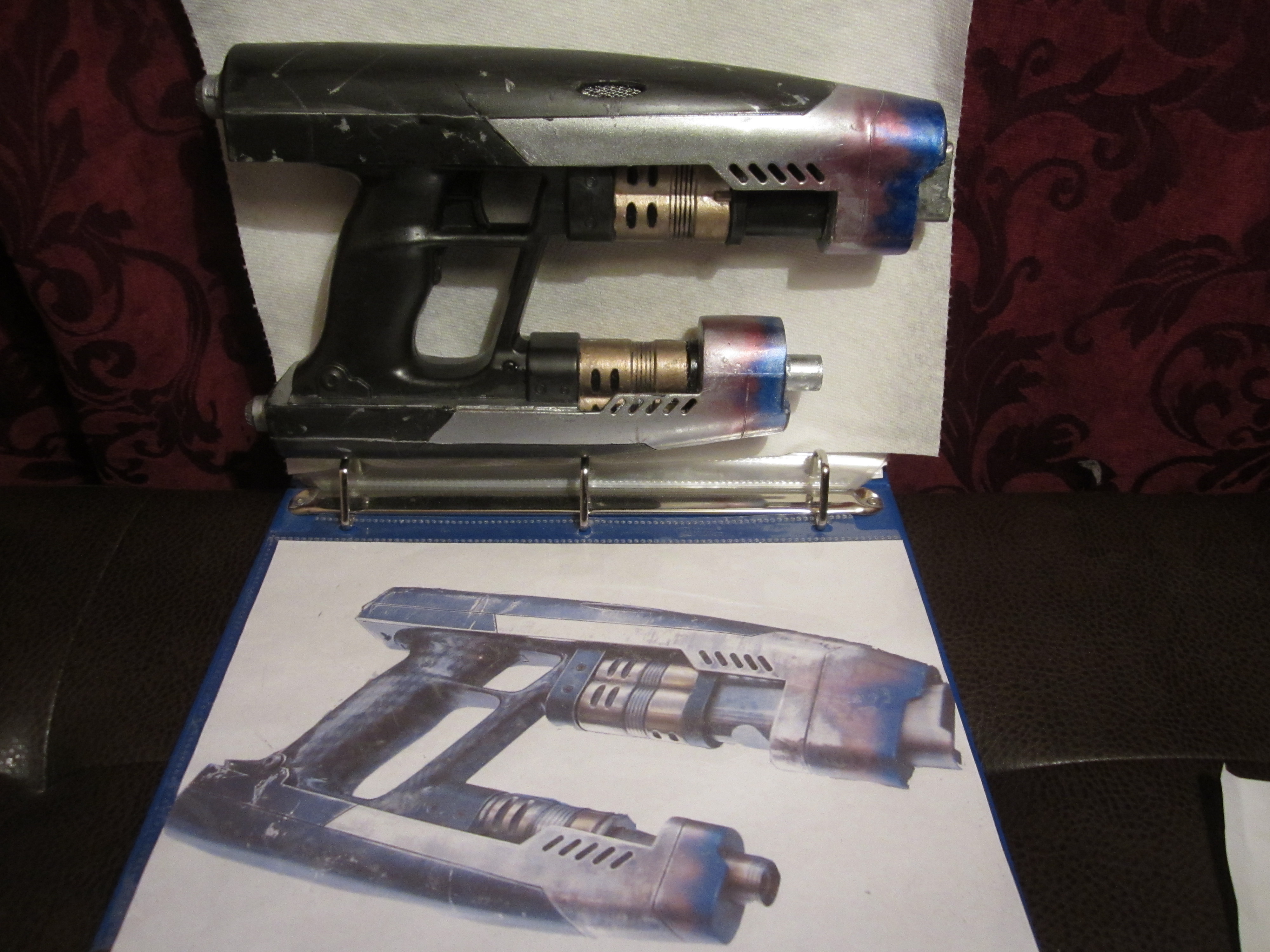

So far, my build has been monopolized by my Element guns. I'm happy to say that one of them is 98% complete...it needs a few tweaks on the tips, but overall, I'm happy with them. Here's the finished one...
Now remember, this thing started life like this;
...my god...look at all the HOLES for SCREWS!
and now, if I may say so, myself...it almost looks just like the image I was using as reference...

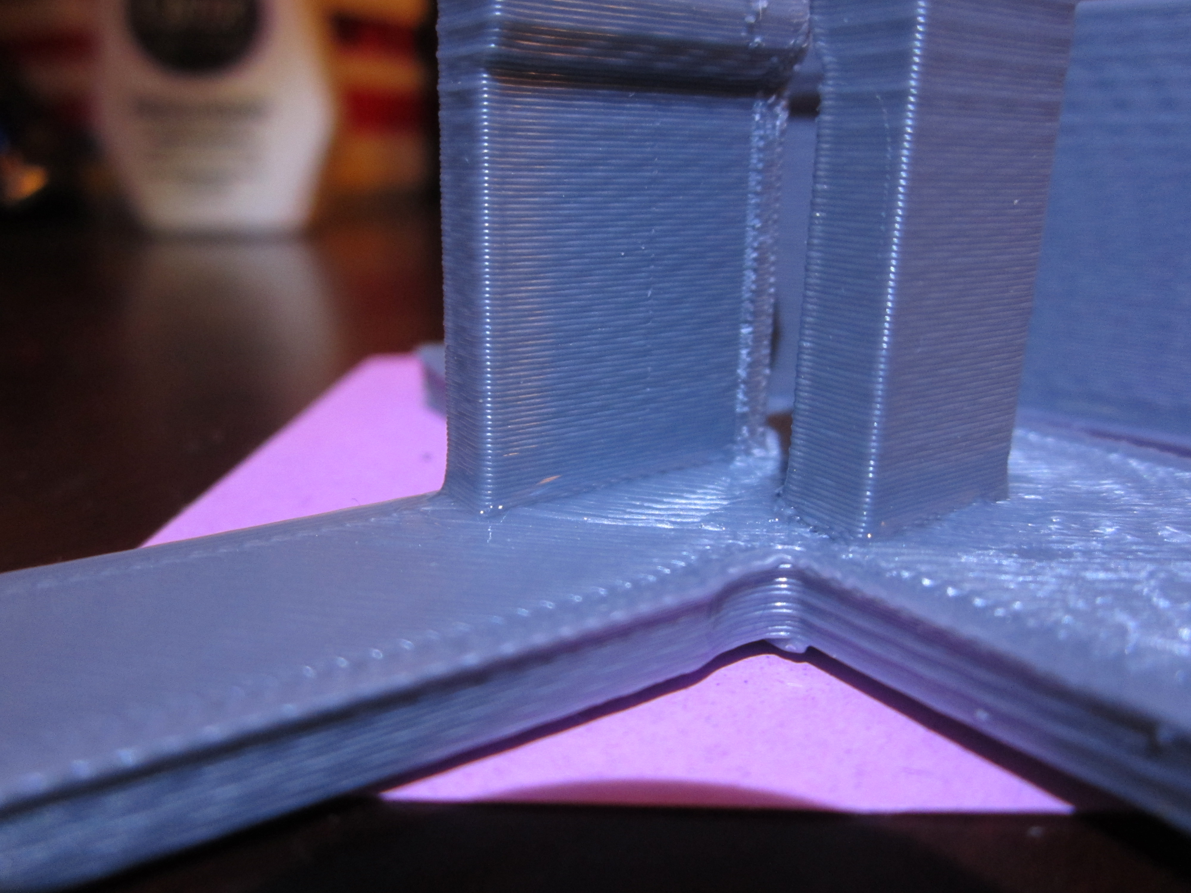

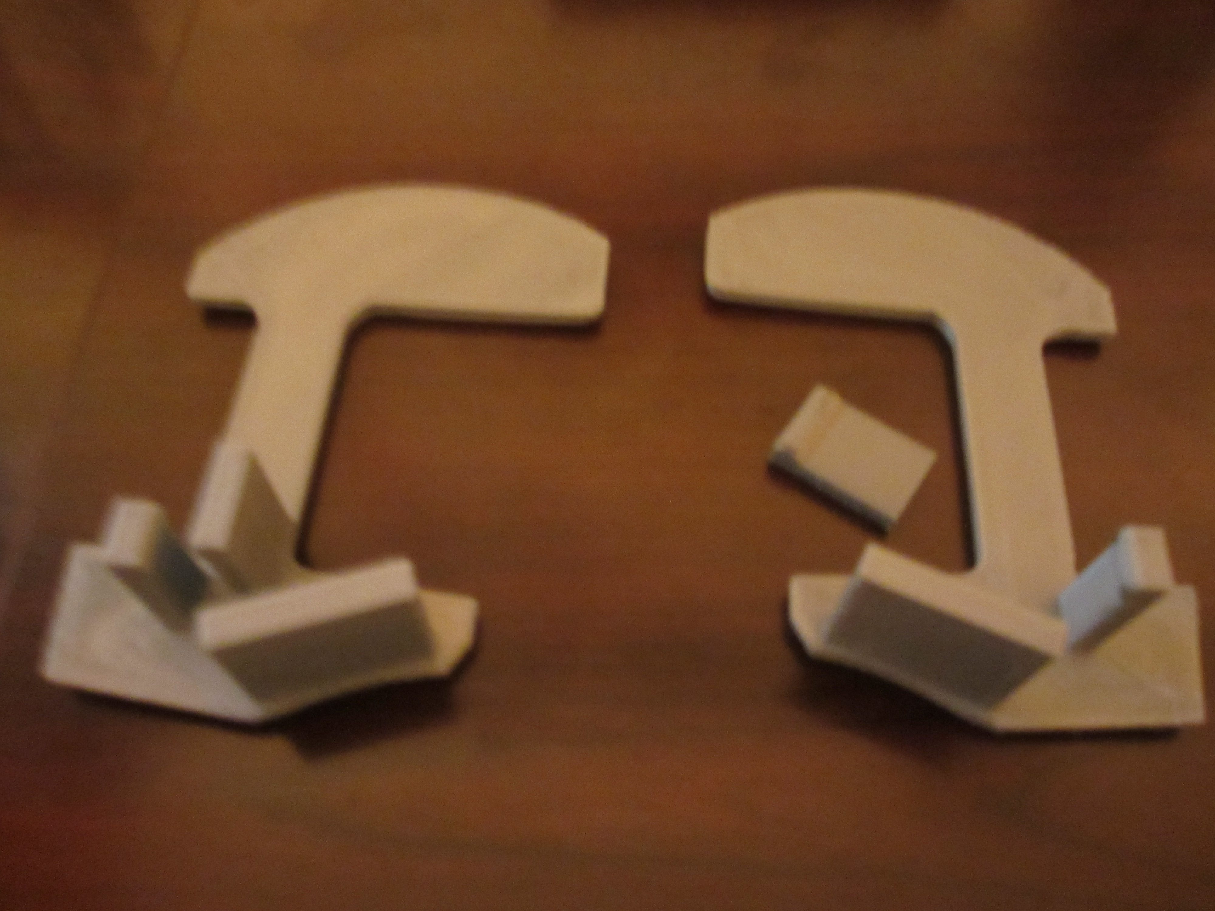

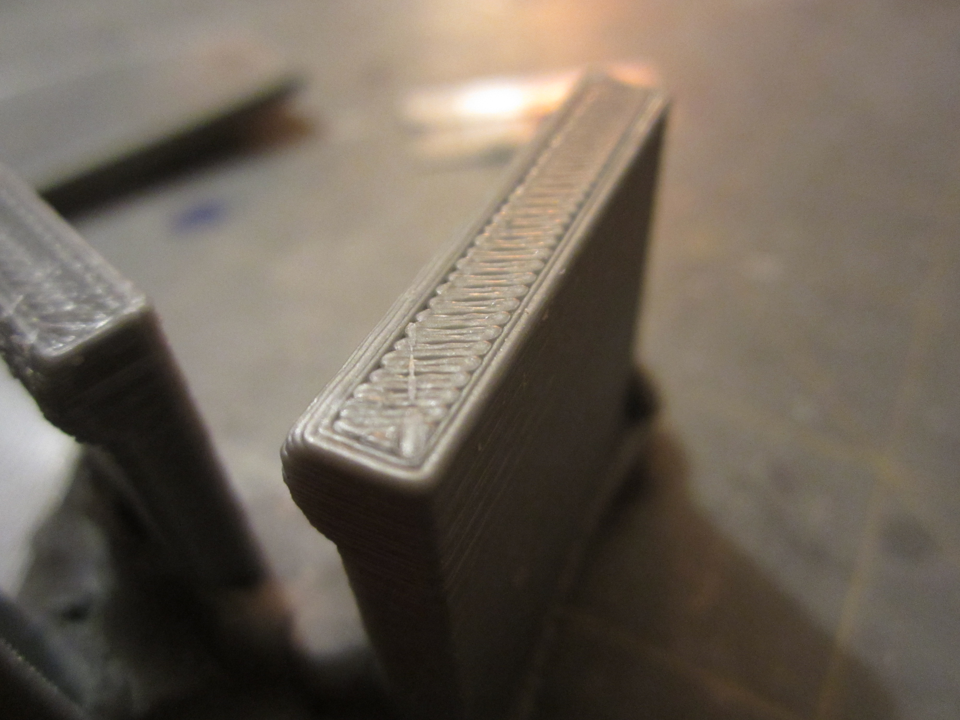

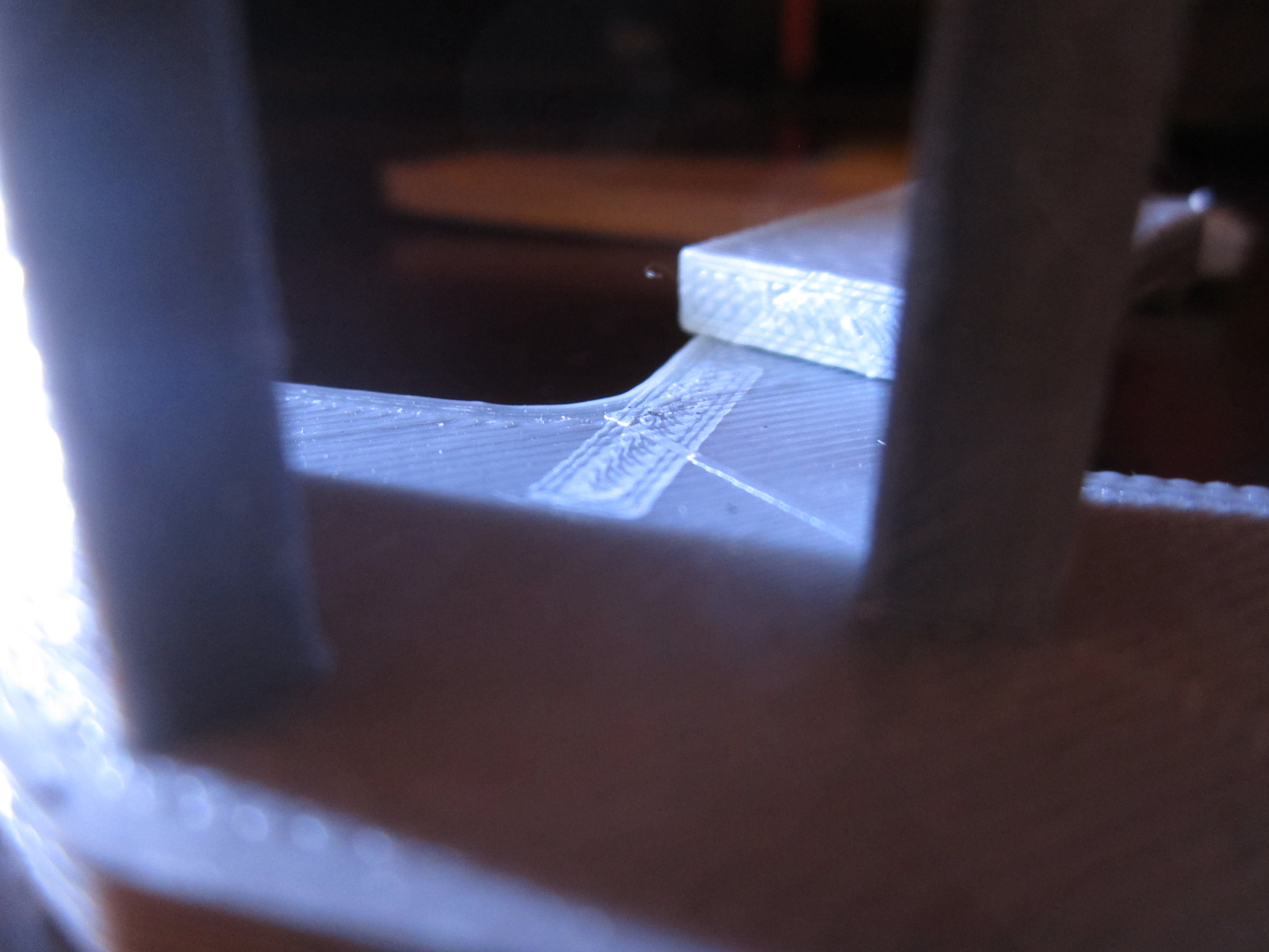

I got mine today and as you can see, I immediately broke one of them. There is a slight issue with the support blades staying affixed, (2nd and 3rd image);
On the bright side, they DO hold the gun in place quite firmly. It's the removing of the weapon from the clips which endanger the clips. I know I probably should have not been so excited right off the bat and I should have reinforced them by using small screws from behind, but hey....it was like Christmas for me, getting these things, LOL!
Anyway, After a quick and very helpful conversation with Kevin Gossett, I went at it with some of this stuff...
...which works like gangbusters, just don't forget to wait for that fully 60 seconds before applying the glue. Stuff sets like IRON.
...I made sure to really goop the glue on to reinforce these things...
...but then I got to thinking about how these things have to flex just a little bit because they have knobby ends on them to keep them affixed to the weapon. The clearance is less than the width of each part of the trigger guards so it should 'click' into place. Unfortunately, the second time I did this, the holster clip snapped off. To accommodate the width, shaved a little of the ABS away from the knobby bits to lessen the flex and the amount of scratching which occurs on my paint job. (==side note==) I've heard that ABS has a certain smell to it and as I cut away the tiny layers, some of that gas escaped from between the layers...very interesting...and smelly.

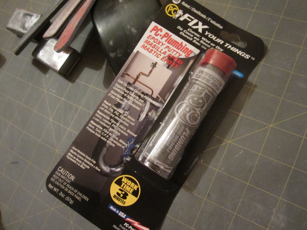

I also realized that I still have some of this stuff left over from doing the emitter housing build-ups on the guns themselves...
So, I had a look at the holster clips as they were affixed to my Element gun and found that there is some clearance to work with, (the blue lines),
Currently, here's where I am with reinforcing them.
I'll be building the putty up to reach the blue line and probably, I'll be spreading it over the texture of the entire thing so as to give it more strength as well as a smoother finish.
If you've never used this stuff and if you plan to, just be aware that it turns into something as hard as stone in about three minutes, so work fast. You can always sand later.

Yep, plain old sharpies, but I didn't apply the ink directly - I used a neatly folded up paper towel and "inked it" before rubbing it on. The trick was in the blending/layering. I'd suggest practicing on something other than your own Element Gun first.:cool
Now that the weather has warmed up a bit I"m getting ready to start the painting on my element blasters, what paints did you use for the heat scorching?
He used sharpies ;)

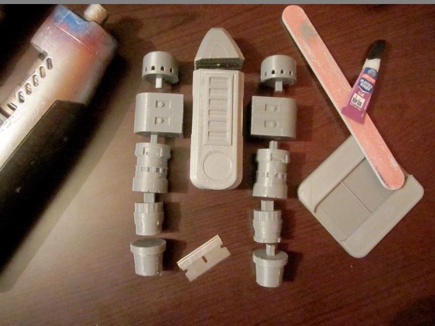

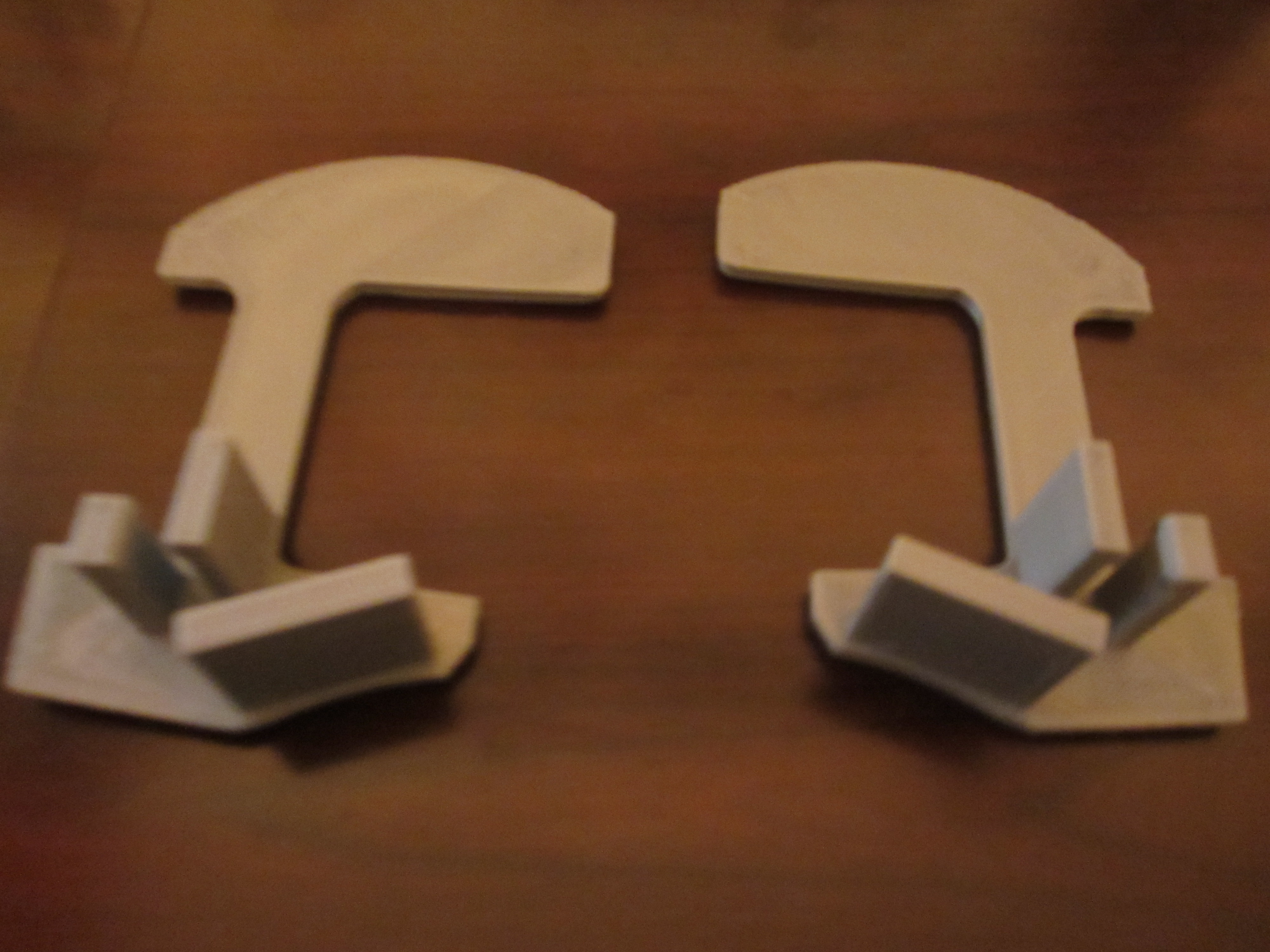

I got the boot-rocket assembly in the mail, (some assembly required, as you can see) Being a 3D print from ABS, the it needs a few tweaks with a nail file or Emory board, ABS shears far too easily, so, so if you should decide to print this up, check your numbers on the tabs and slots. The exterior-measurement for any given tab should be made a fraction smaller so as to avoid accidental tab-shearing while 'filing to fit'.
In keeping with my Ren-Faire training, everything on my costume must have a story, however small the item or fantastic the story, so....
As you can see, I've brewed-up names for each part shown, below. My only regret is not being able to make these weigh about a half to three quarters of a pound, (each). I imagine I could get some Strong Neodymium Magnets and hollow out a chamber in the 'KCC' housing.
...for those curious about the size, I've placed a razor blade in this shot for your reference;

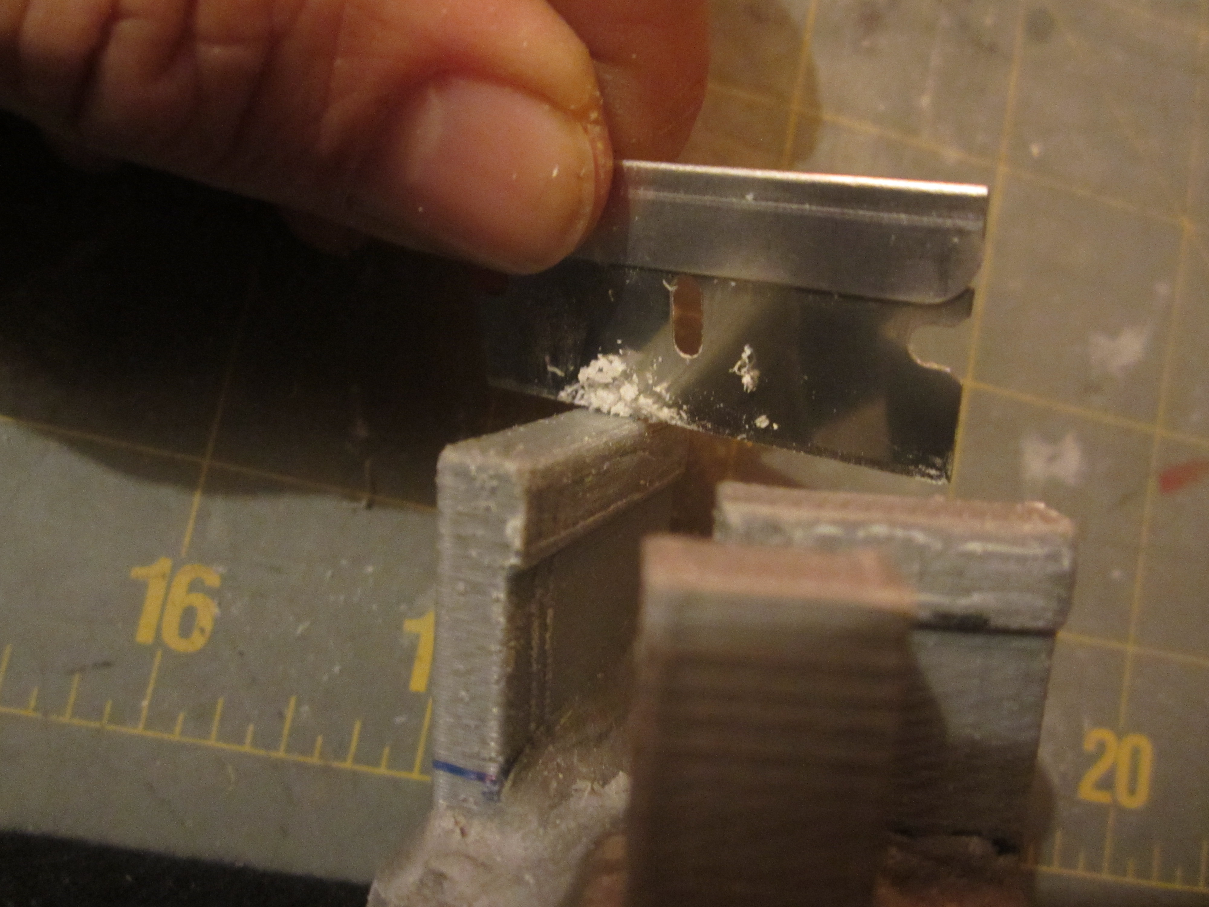

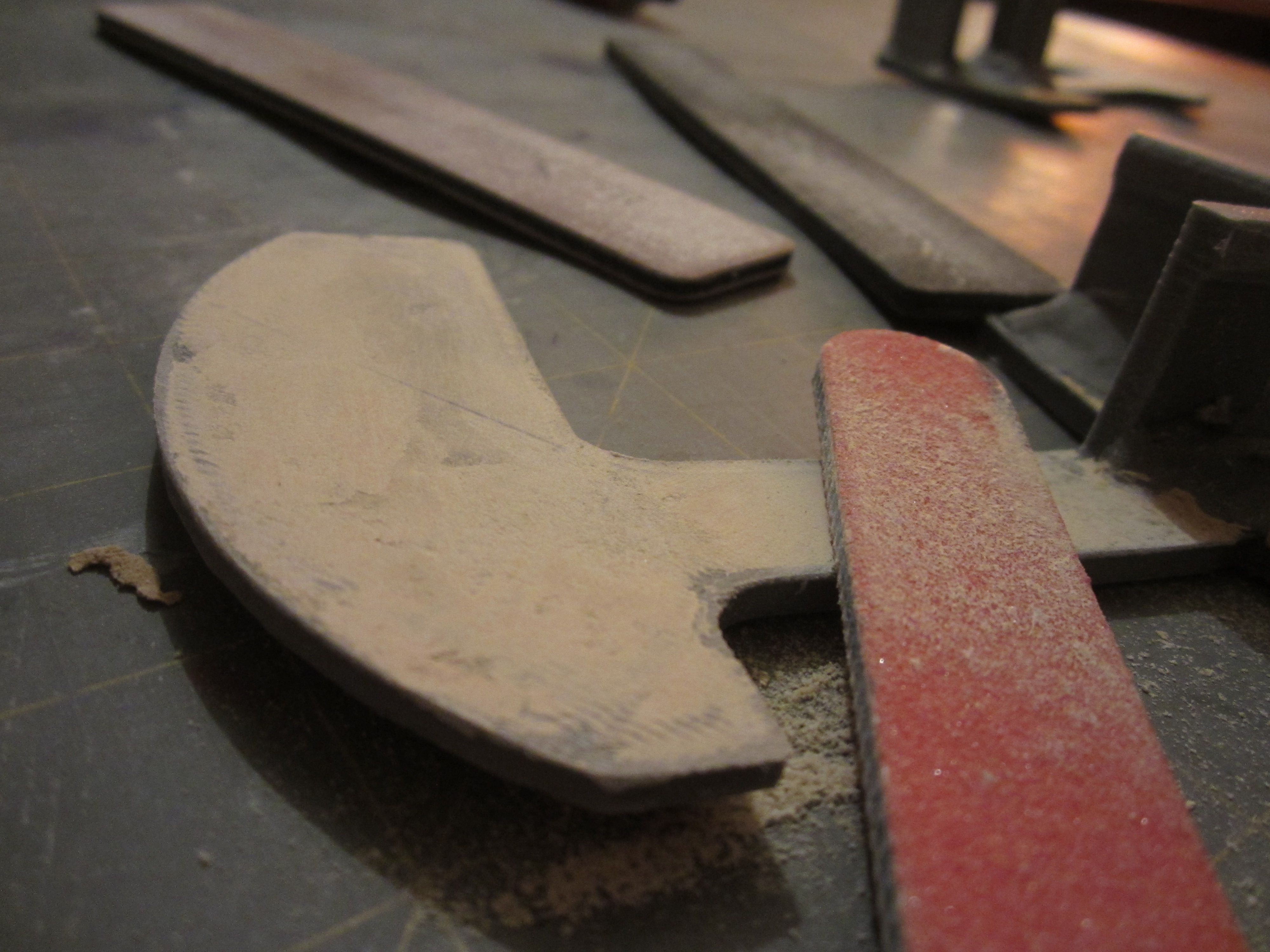

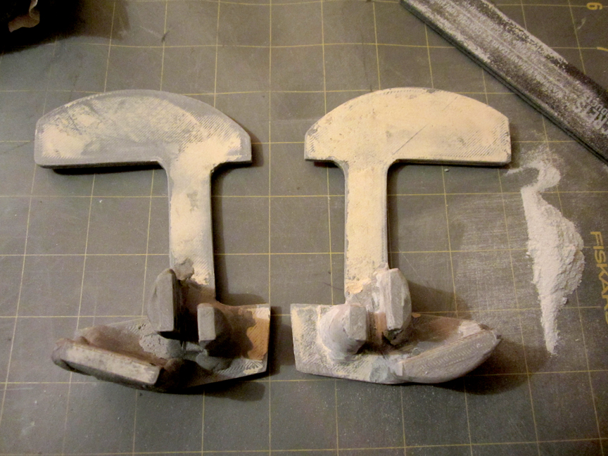

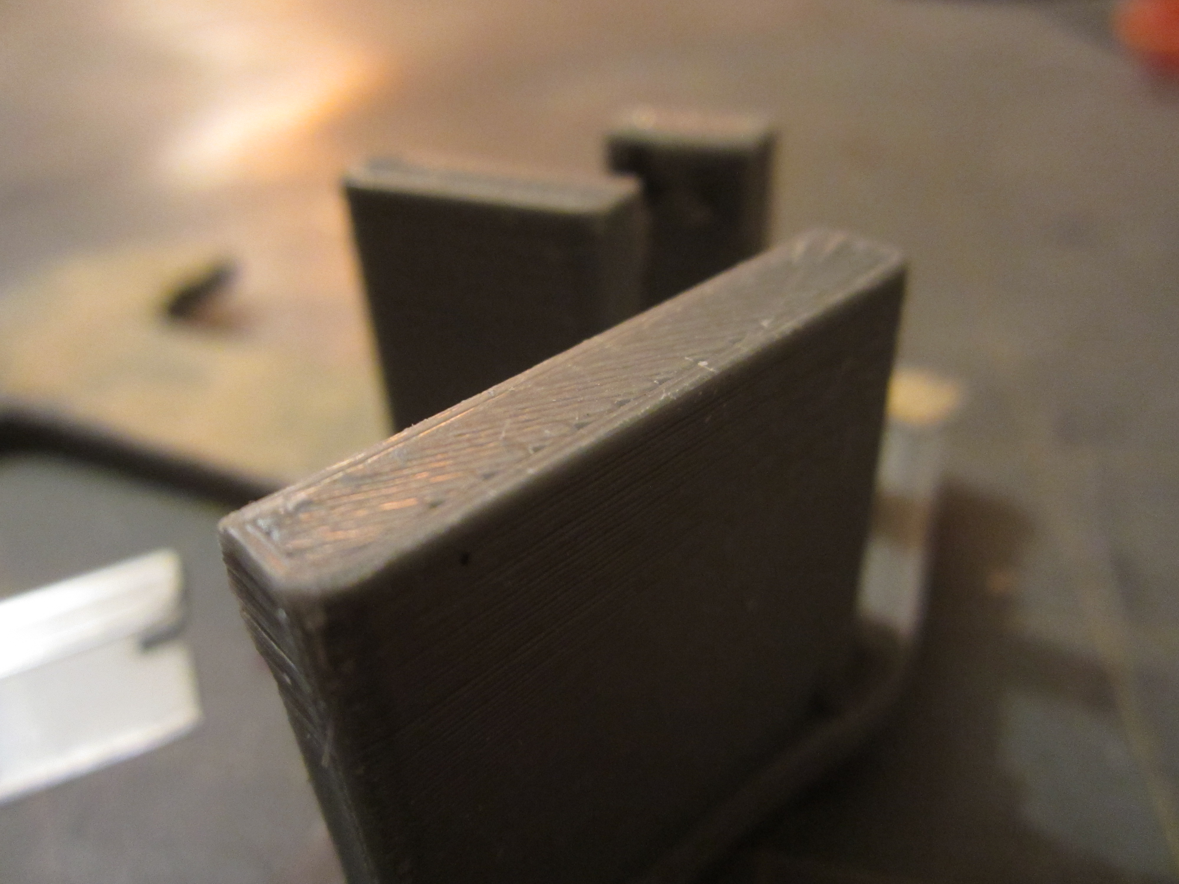

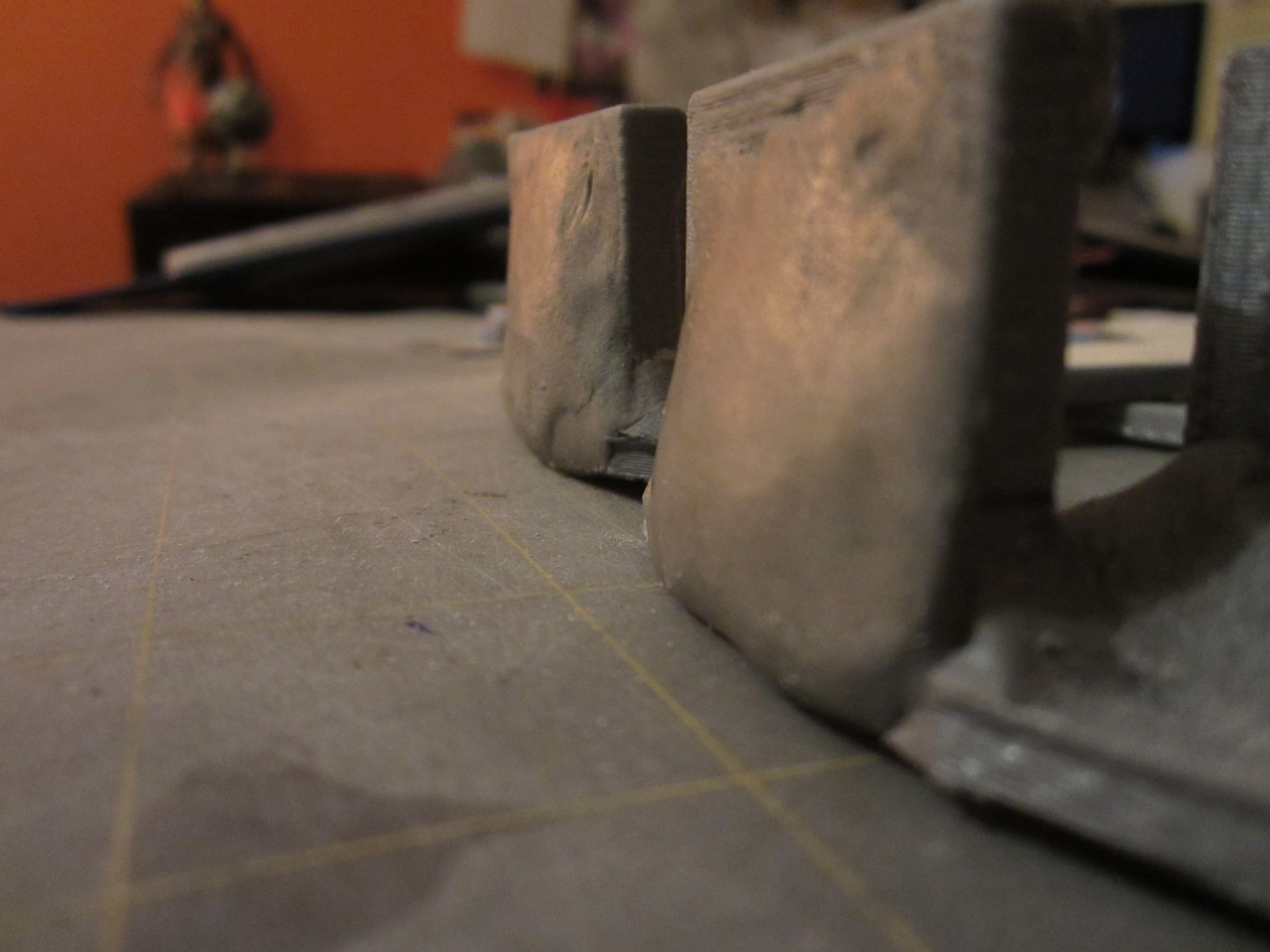

I started to clean up the holsters while I await my tube of Bondo Glazing Putty to arrive
There was some resolution I wanted to smooth out, so I used plastic wood for that part...
And earlier, I mentioned that I was experiencing issues with how ABS does not like to flex. So I did what I'm used to doing and attacked the things with some more two-part plumber's epoxy. it went on sloppy, but I filed one of them down for shape and once it's painted, and there's a gun on it...well...nobody's gonna see it anyway, LOL
Oh, and yes...filing all these angles was a pain in arse, LOL!
On a final note, the nubbs which are meant to hold the gun in place are actually filed completely off on this version of the holster.

You can print a few different kinds of rubber. There's one called ninjaflex that is very flexible but sometimes requires a specific feeder/extruder since it tends to "pop out" of alignment. Great for something like a bike grip. There's also a rubber-like PLA from Colorfabb that seems fairly good and might be stiff enough to hold blasters.One difficult aspect with them would be smoothing the surface, since you can't really sand effectively. I haven't tried them myself because I've heard that they are fiddly and temperamental.
One potential problem I can see with using "hard" fillers on a piece that is likely to flex slightly is that the filler may crack and since you don't have a strong bond to begin with there's a risk of it flaking off in chunks. (I tend to stay away from ABS because it's harder to glue and paint than many other plastics... though not nearly as hard to work with as PVC. It's also not very health-friendly.)
You could also split the model up and print the larger piece in something rubbery and the holder in PLA... best of both worlds. PLA can actually be set up to be flexible depending on how solid you make the part...
Thanks, Joe, good info. The material I'm using hardens as strong as concrete and the flex issues have been addressed with a lot of filing. The gun fits snug without much flex, at the moment, and what I plan to do after everything is said and done is to affix some kind of strap with a snap on as a safeguard. Also, I'l be reinforcing it from the rear with a couple of small pins so that it won't snap off. Of course, there's the whole 'learning-that-I-have-extra-stuff-on-my-legs-and-avoiding-going-around-corners-too-tightly-so-as-to-avoid-snapping-the-sub-strait-off'...thing,

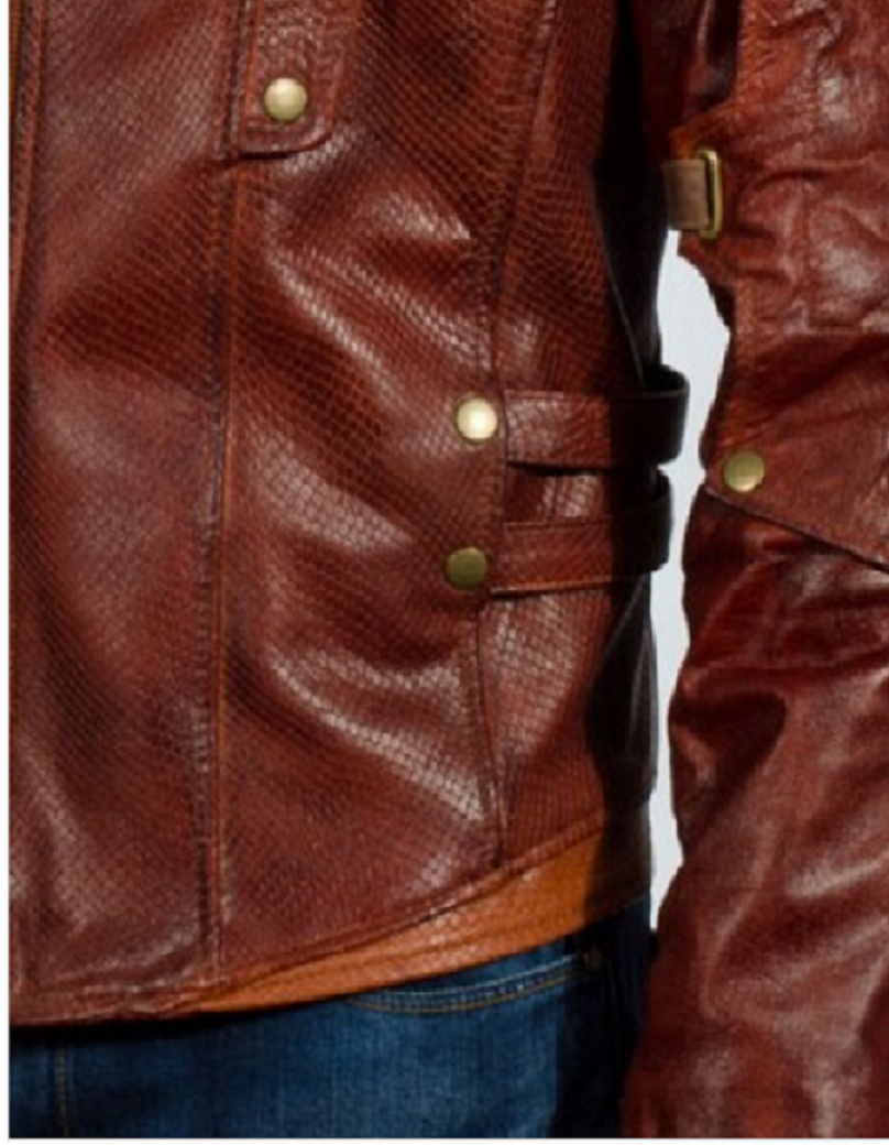

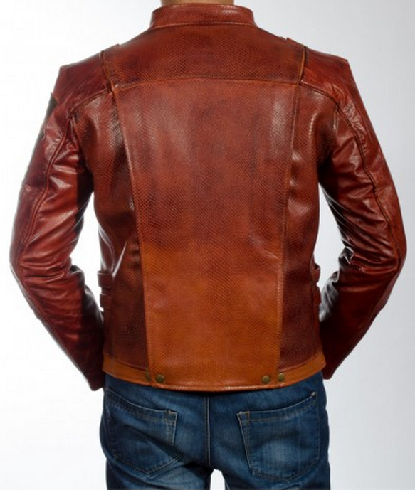

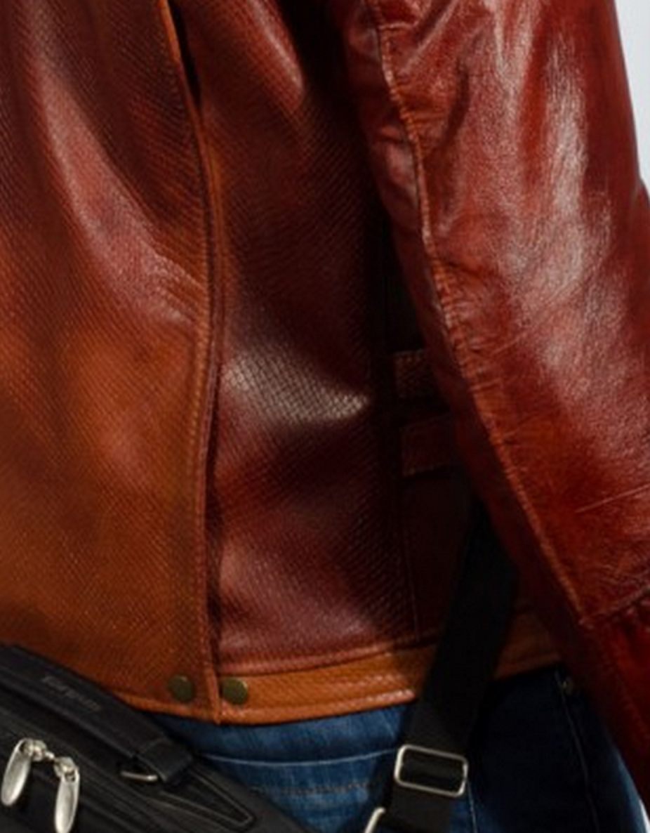

I am posting this jacket here as a way for me to find it and as a note to those who are trying to do an Orange Gradient detail at the bottom of the jacket, (...check the images...) Also, I've seen a screen printed jacket but can't confirm if the screen printing is on Cotton Twill fabric or not. Ultimately, that's what I'd like to get...a jacket with THIS Orange Detail and gradient....not this one...the pattern is not right and it's all leather, but I'll give them props for choosing a texture to emulate it...
The Jacket Makers $335.00 for pete sake!
Back Gradient.pngFront.pngOrange Seam detail-side.pngOrange Seam Pointed detail.png
Danny's jacket is probably the closest you will be able to get from a "commercial" maker. To get the orange color on my jacket I used a lot of orange dye in in the mix, then bleached before I did the printing.
As I understand it, the pattern on Danny's jacket is solid red and not clear, so bleaching that would make it look odd. The fabric in that jacket also seems to contain a lot of blue since it shifts towards magenta in a lot of photos instead of rust/brown so it would turn bright pink if bleached. One thing you could do is get it and drybrush (or airbrush) orange fabric paint over it. At a distance, it'll probably look OK.
@joatrash, thanks for the idea of dry brushing or air brushing the orange color gradent effect
If it's Danny's jacket you mean (also available on ebay) I recall him mentioning it being gabardine and not twill. That probably means that it has a smoother texture/weave and not the diagonal of twill or denim. No idea as to if it's cotton, wool or synthetic.
