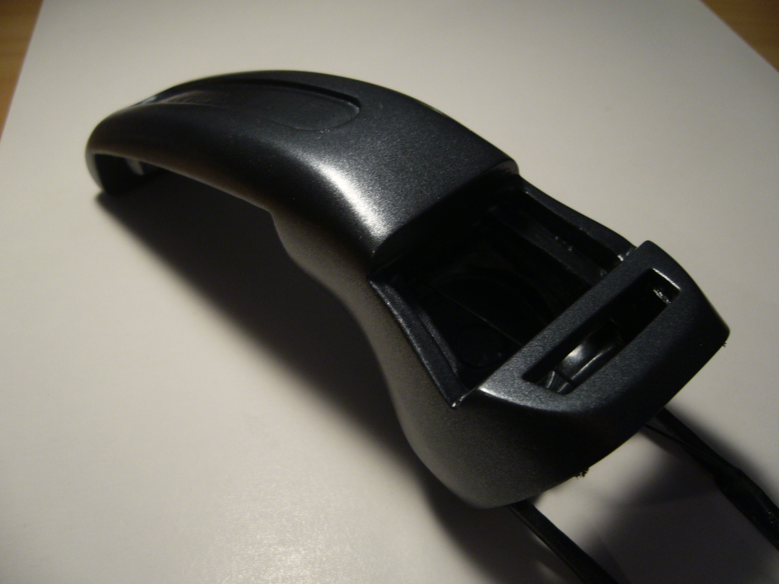

I'm putting together a Star Trek Nemesis Type II Dolphin phaser, and I'm wondering whether I used the wrong paint color for the body.
According to these two posts (1, 2), the paint used was a metallic gray with the color code DSGM 347 / BGM 0347. As I live in the southern hemisphere, auto shops don't stock the full range of Duplicolor paints, and I had to get mine custom mixed using the Lyndar Color Matching system.

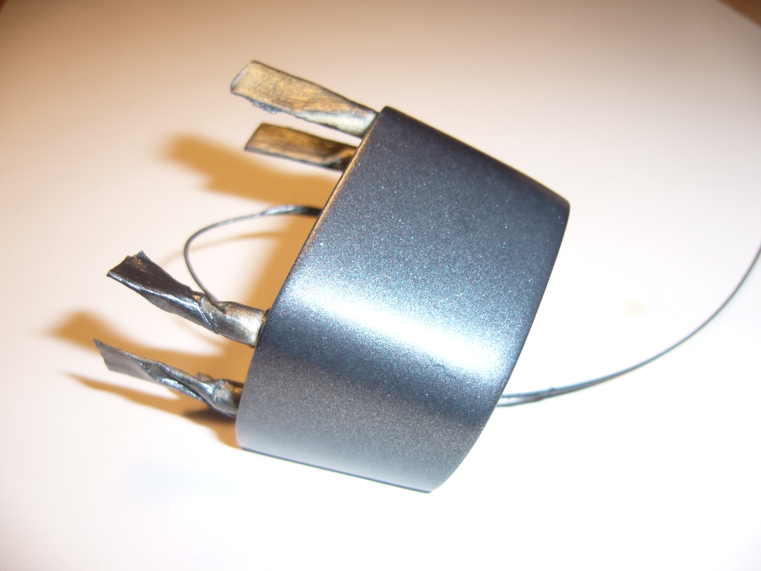

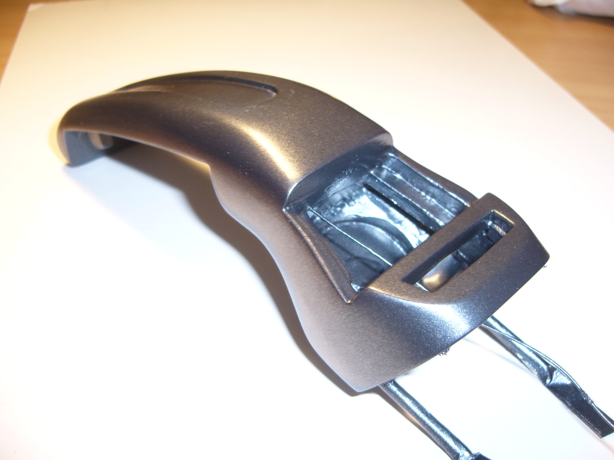

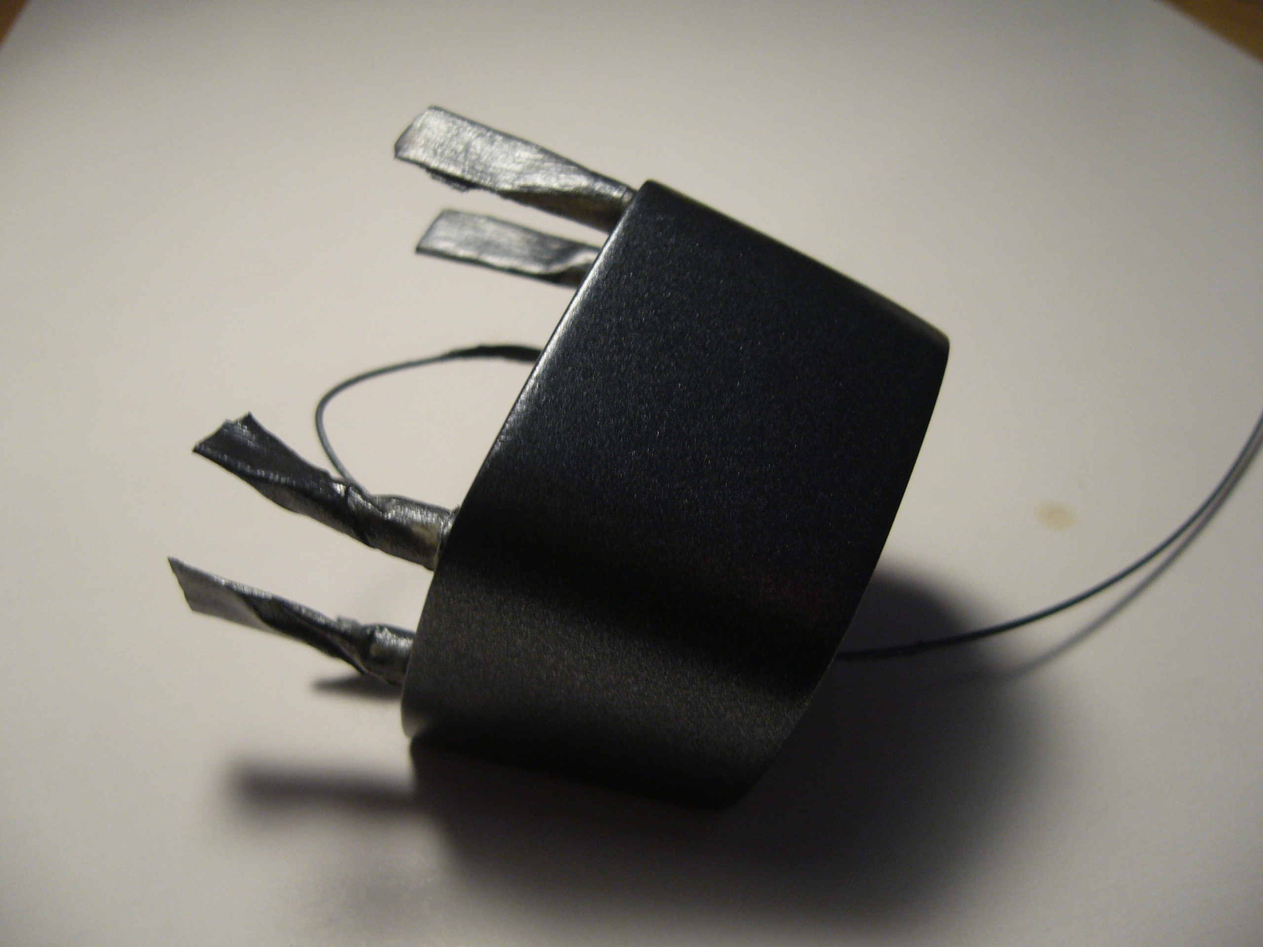

Unfortunately, the phasers look really dark (almost black) with only a hint of the metallic speckle (photos taken without and with flash):

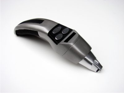

Looking at prop photos on the net, most Nemesis phaser are a much lighter shade:

Unfortunately colour matching always seems a little off. I'd say it looks a little dark but not in an unpleasant way.

That actually doesn't look to bad. It could be a little bit lighter but I don't think it is enough of a difference to matter.
When I was having on built for me I asked Myron Stapleton what he used on the kits he made and he said he used Plasticote 1004 or equivalent. He also mentions that Duplicolor makes or made a similar color.

A couple of TFW members were kind enough to compare some paint samples with original props. One member said that the BGM 0347 was a little darker than the BFM 0225, while another said it was too much darker and unsuitable.
Both members also suggested inaccurate mixing formula or cross-reference - which might explain why the Lyndar BGM 0347 is much darker than the official Dupli-Color BGM 0347.
