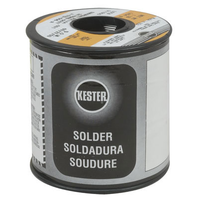

Like Dave said, Weller makes some good soldering irons. Attached are images of everything you need to get started.
One tip: Many say use a wet sponge to keep the iron clean. I've found this does not work well and might even encourage problems. Use a brass tip cleaner (see attached image). Also, use tip tinner religiously. Use it before you solder to prep the iron, and use it again before you turn the iron off and put it away to keep the tip clean and protected. Also, have spare tips in different sizes and shapes as they do eventually wear out.
