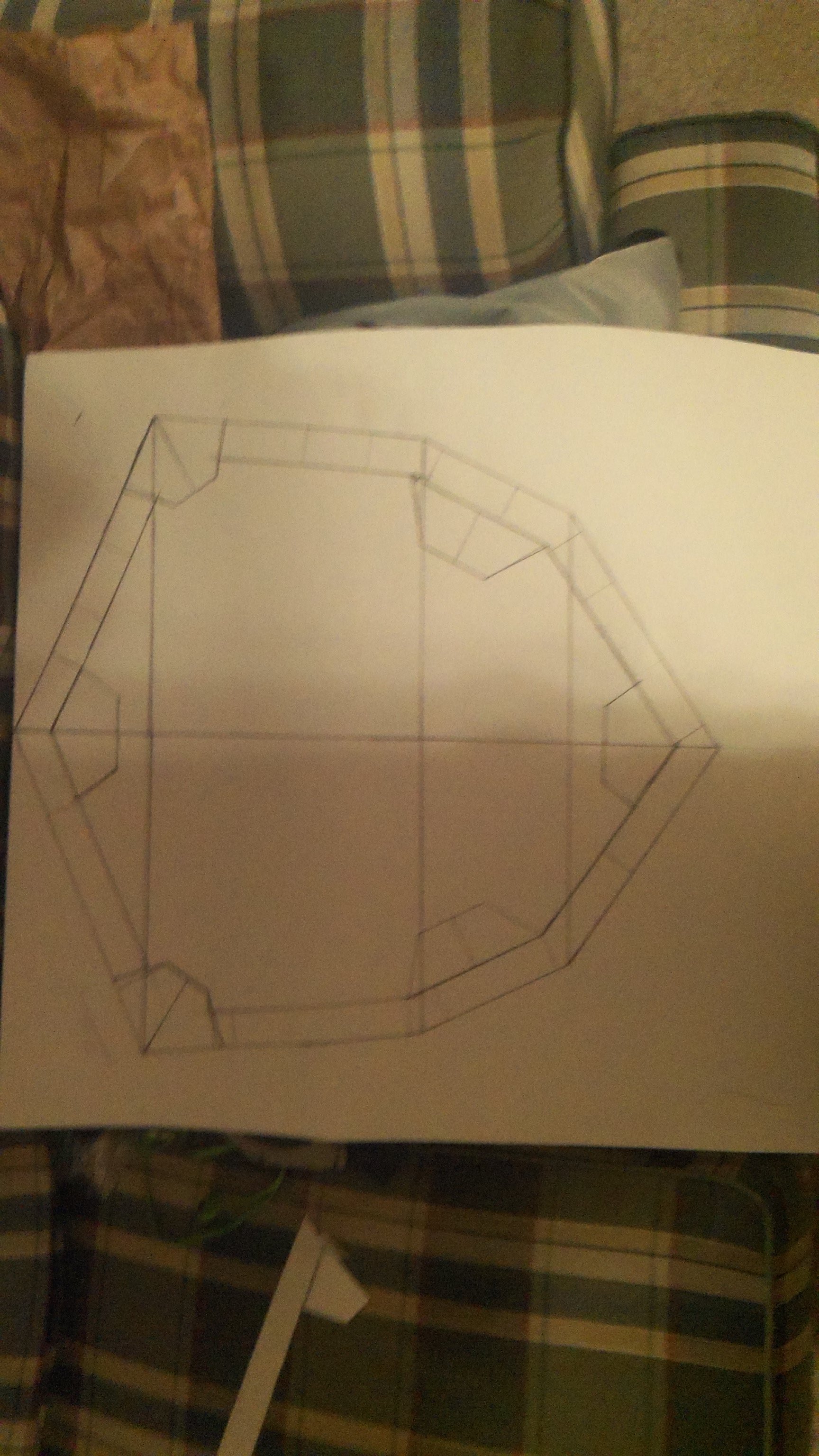

Along with my template sketch on some poster board (I sketch the details on smaller poster board later.)

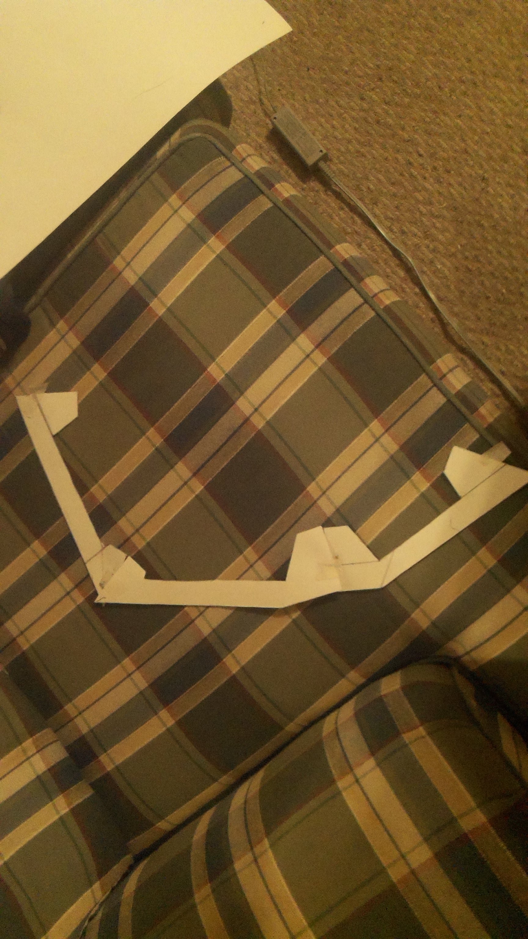

And the trim templates.

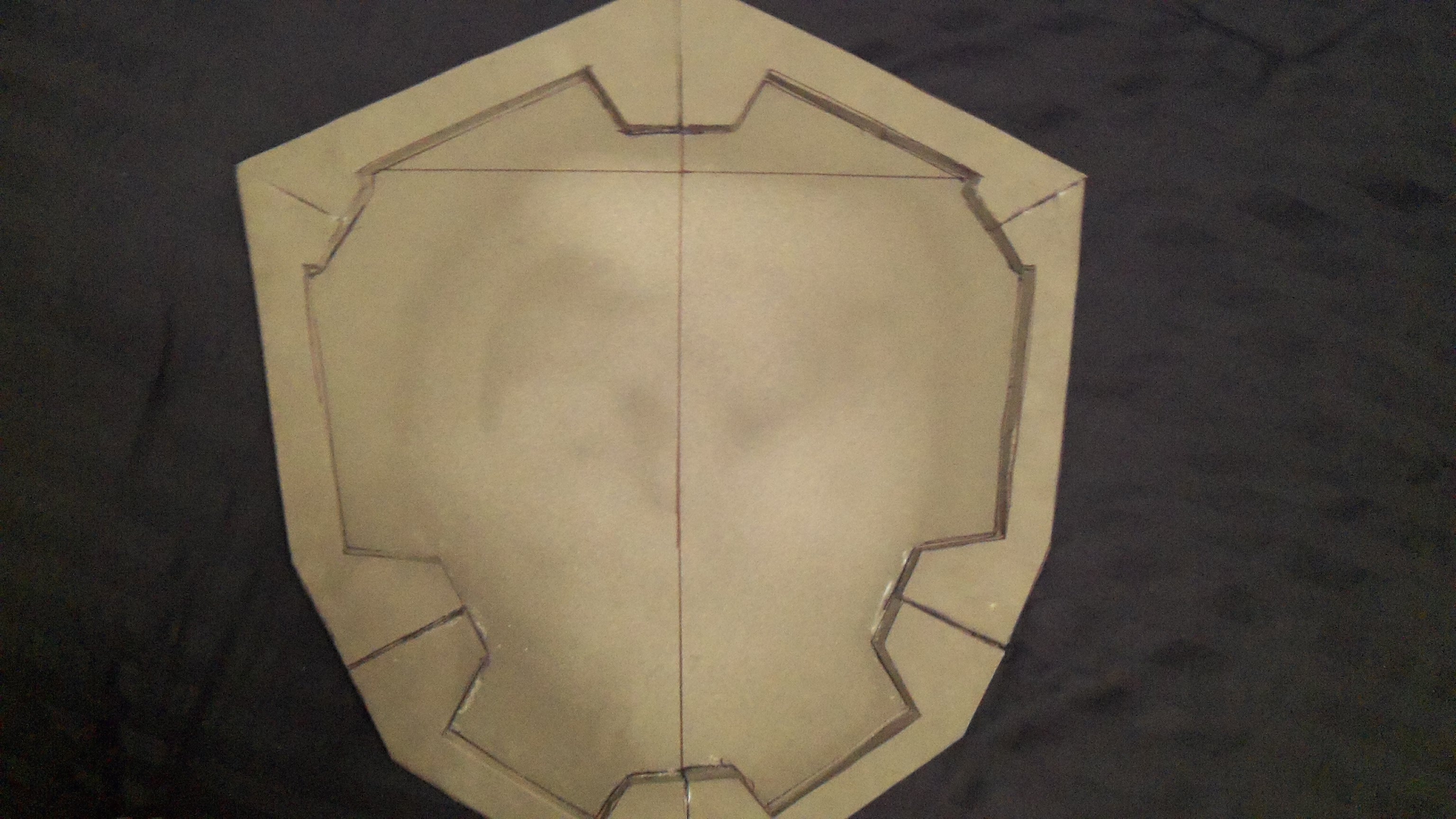

The outcome was this:

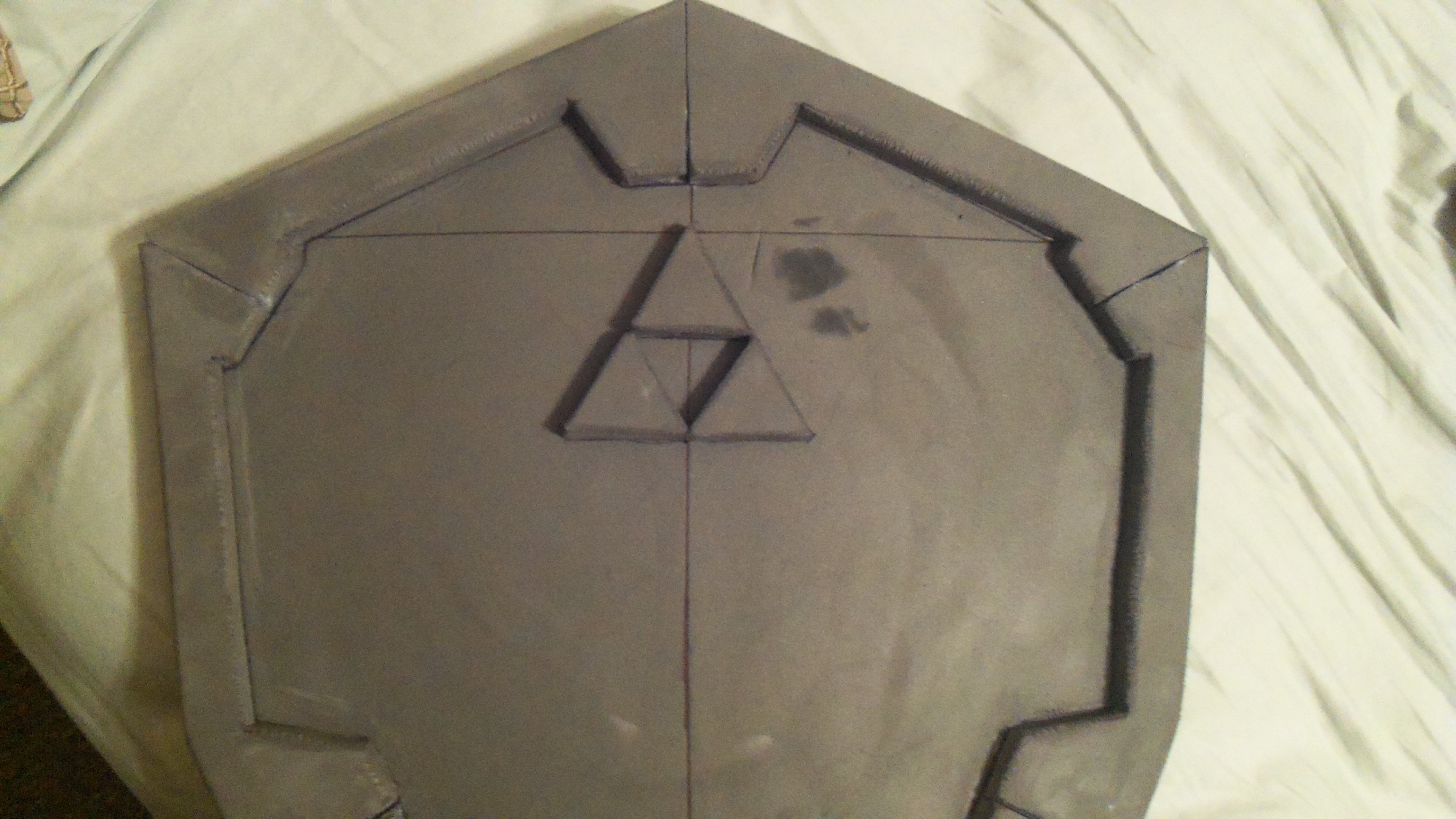

What I got was this

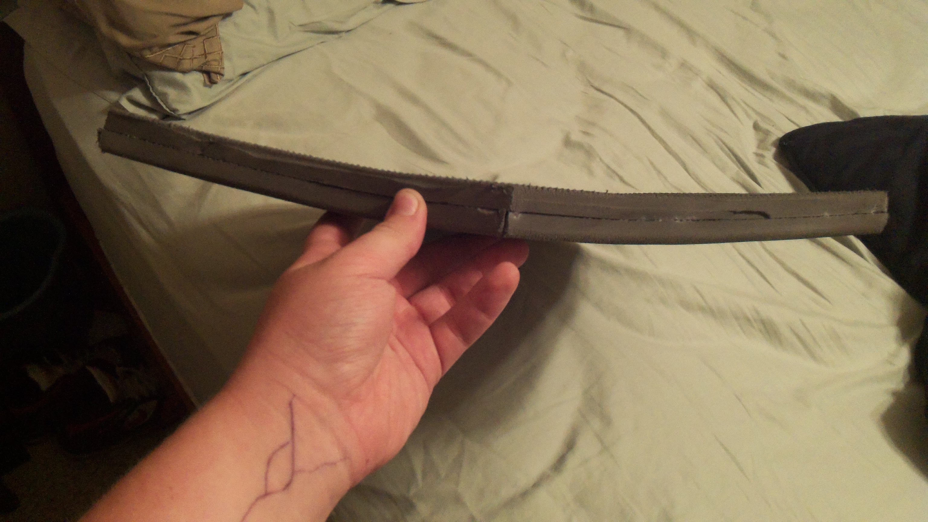

My job after this was to give the shield a natural curve, using a heat gun. (Roughly 20 bucks, but I had it on hand.) Using the heat gun, I applied heat all over the shield, and curved it with my hands to my liking. Here's a idea of the curve.

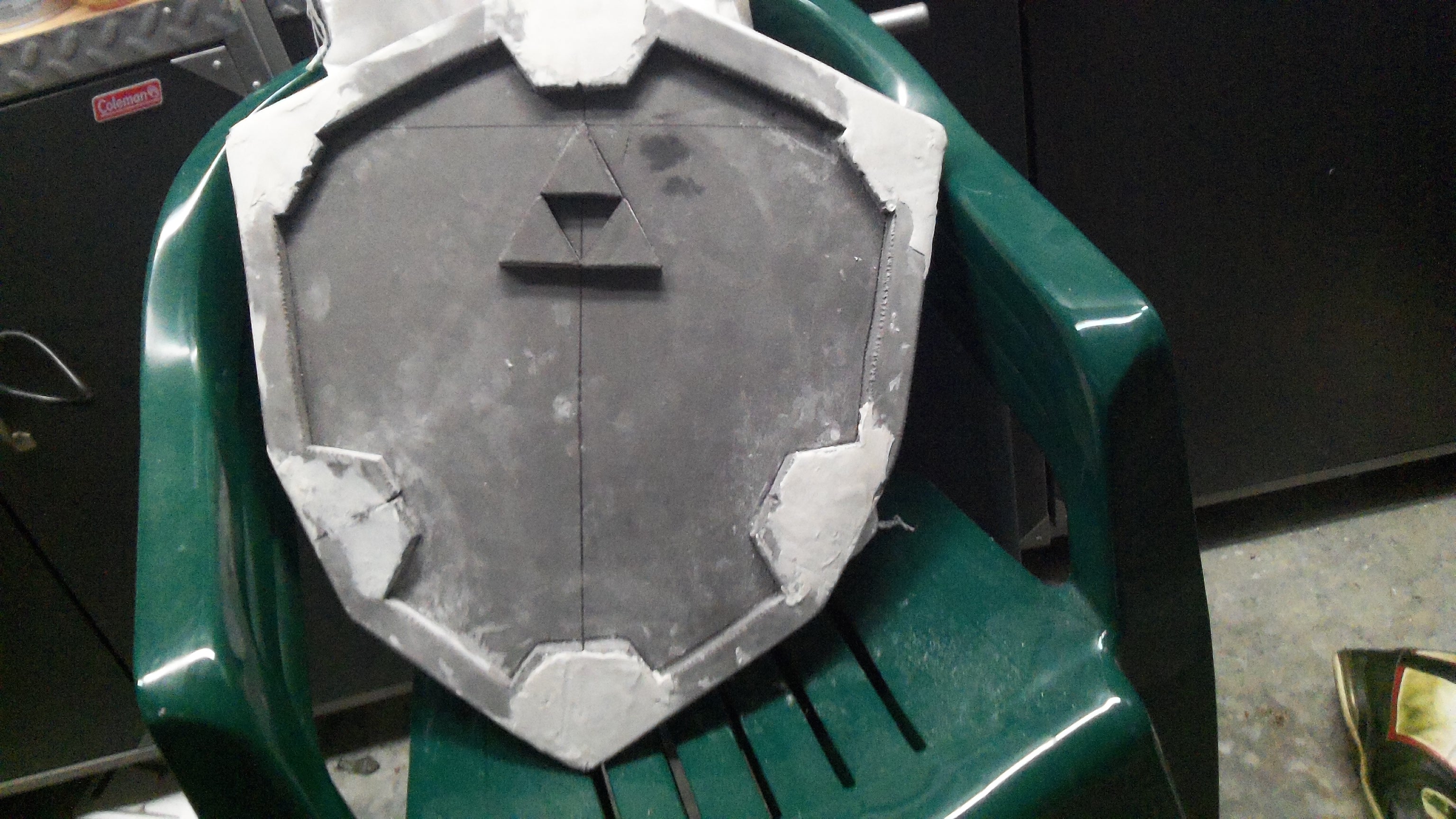

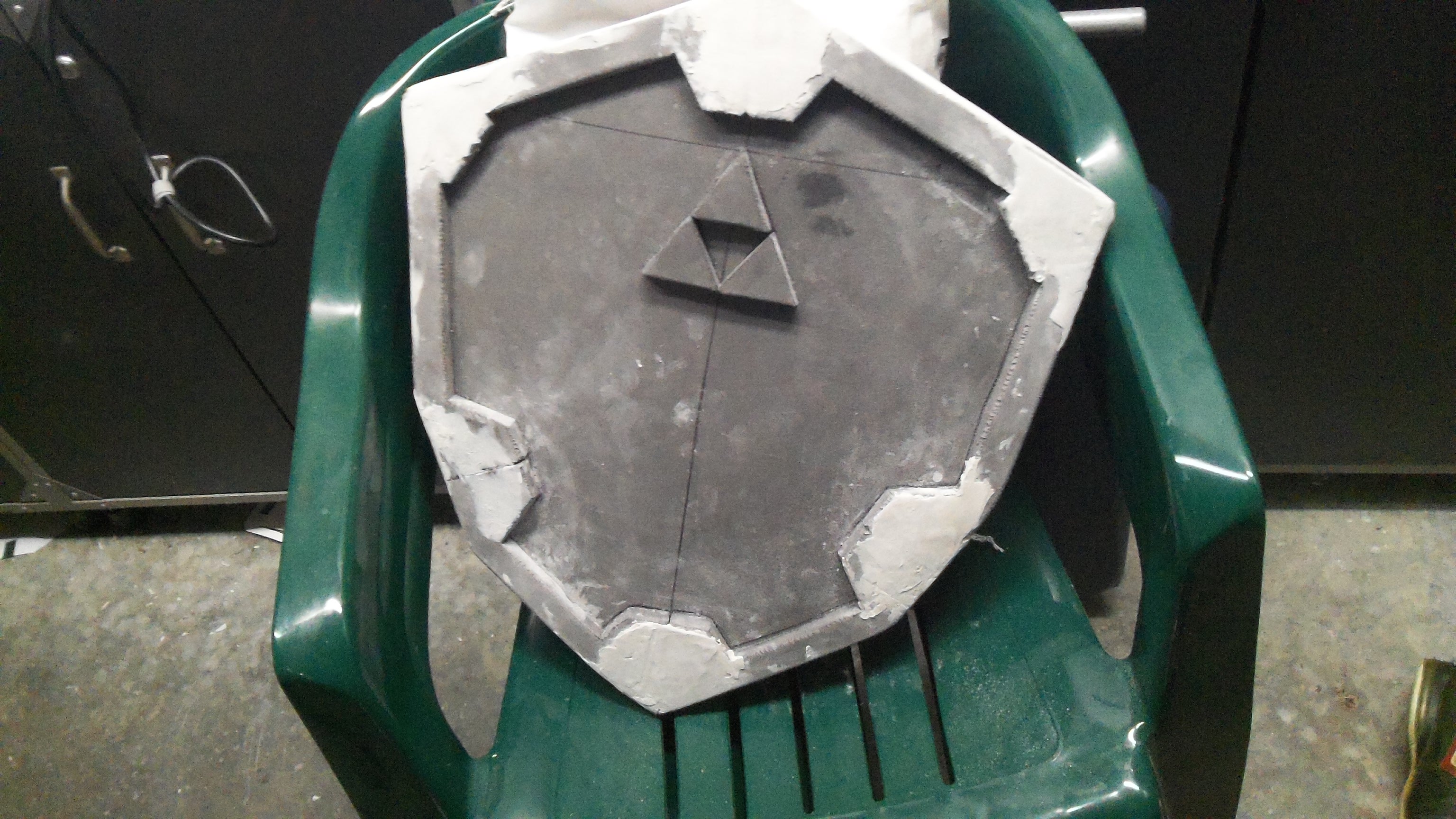

The last thing I've done as of Halloween night, I halfway applied bondo to the edge of the shield and the trimming. I'm using the All Purpose Bondo Putty I got from lowes, roughly 11 dollars. And I need to finish applying the bondo today or tomorrow. Heres that.
So this is my main progress as of right now. There's a few other things I've done, but ill share in my next post. But overall, I love how its turning out so far. So much easier then making it out of wood. I'd appreciate any help I could get. Any suggestions. As this is my first serious project. Thanks guys! Enjoy!
