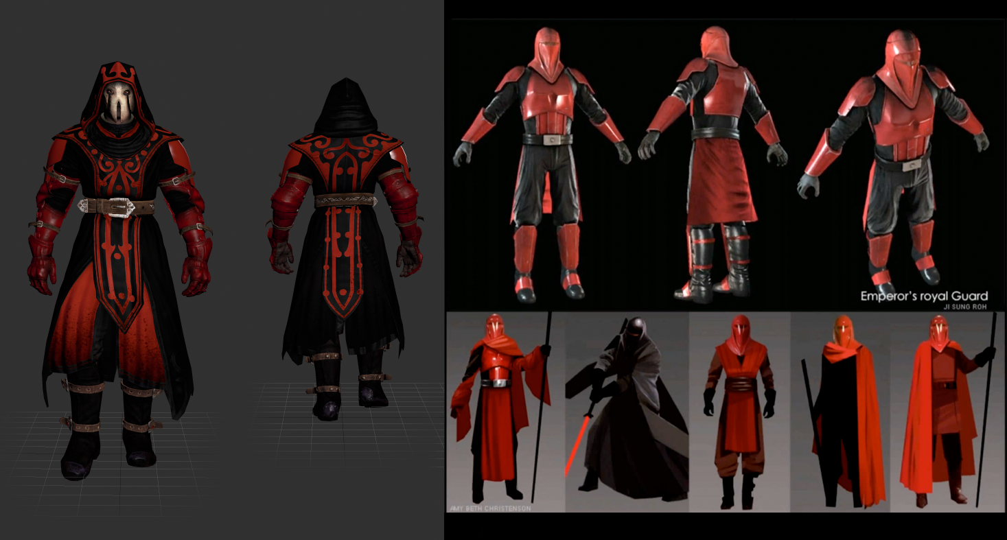

My main inspiration comes from a character in the game called "Of Orcs and Men". He seemed appropriately Sith sorcerer-like. I ripped the 3d file from the game and edited the textures to get a color scheme I was happy with. I plan on doing the cloth bits, for the most part, in the same way and use fabric paint for the designs on the tabard and trim. For the armor I'm taking my inspiration from the Emperor's royal Guard on the top right which I believe is from The Force Unleashed. I got the pepakura files for the armor from Fierfek's thread. I plan on just doing the shoulder pauldrons and gauntlets first. I'm considering doing the greaves and plate over the top of the boots but I'll see how it looks without it first.

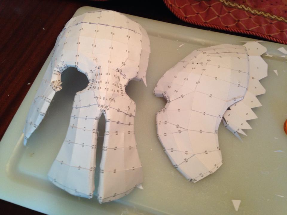

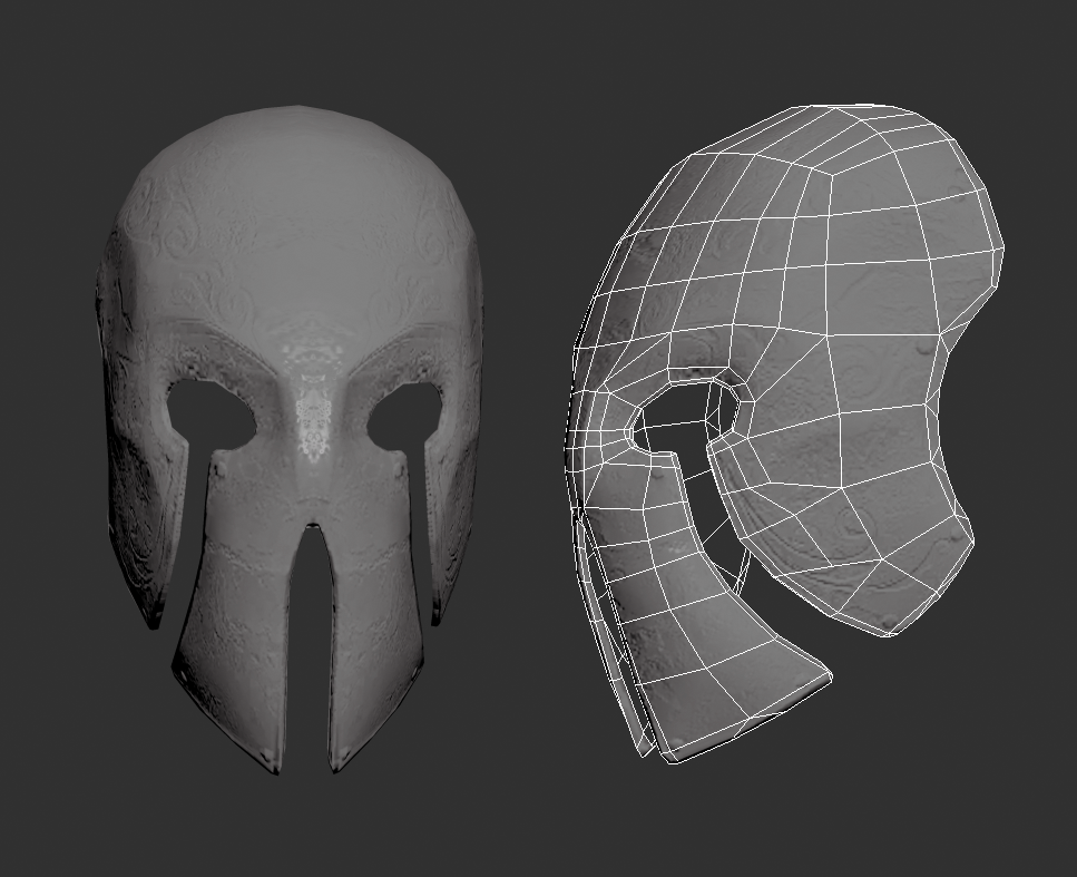

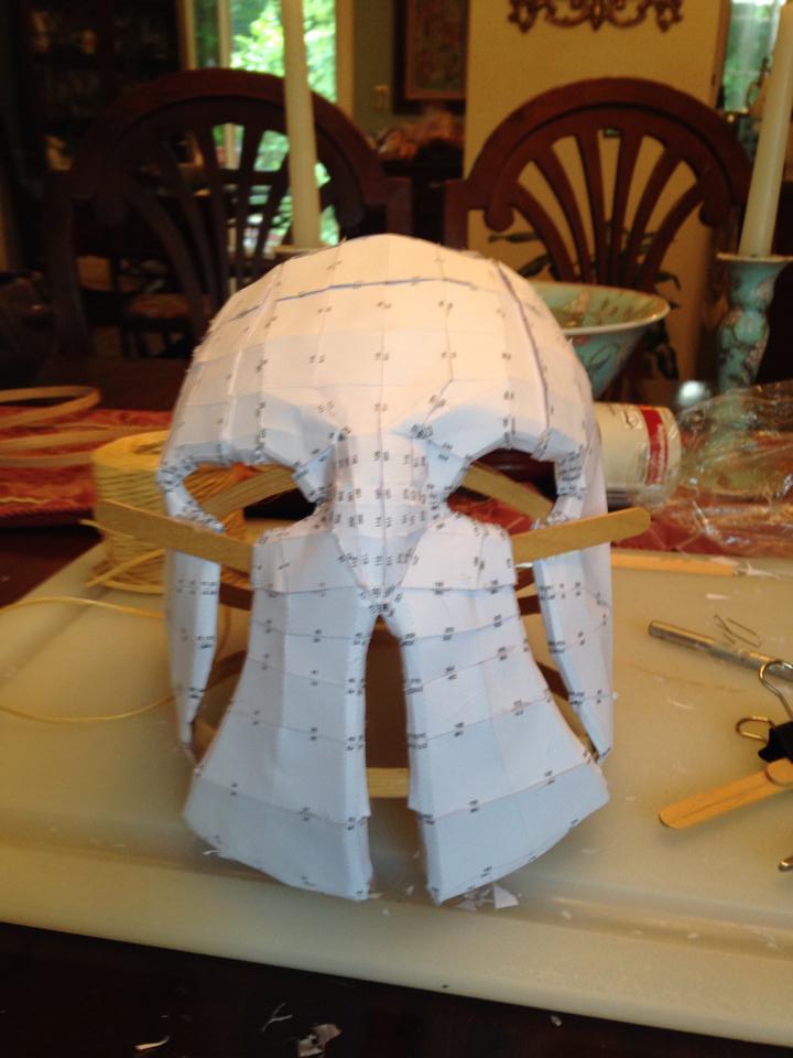

I separated the mask from the rest of the mesh and cleaned up the geometry a bit to bring into Pepakura.
I had to resize the mask because the eyes were a little too narrow. I'm adding a row at the split here. In hindsight I should've fit the mesh over a anatomically correct human model and done some real measurements. I was just eager to get started.

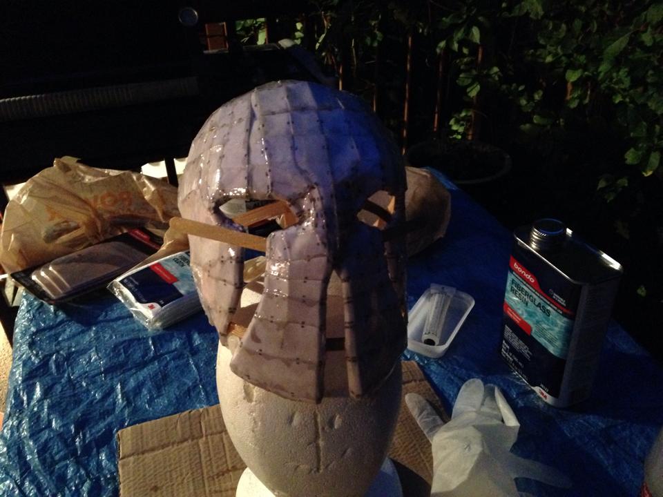

Trying to keep the mask in shape was really a pain. The middle part is just hanging for the most part so the model isn't under much tension and therefore doesn't retain any shape. The solution I came up with was putting some tension in with craft sticks and circular wicker that I hot glued inside the mask at various diameters of my forehead, nose level, and chin. Has anyone else run into this problem of keeping the pep'ed piece to keep it's shape?

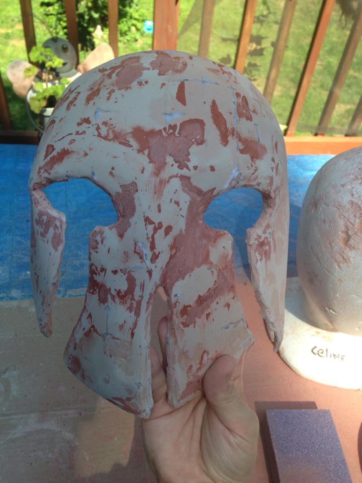

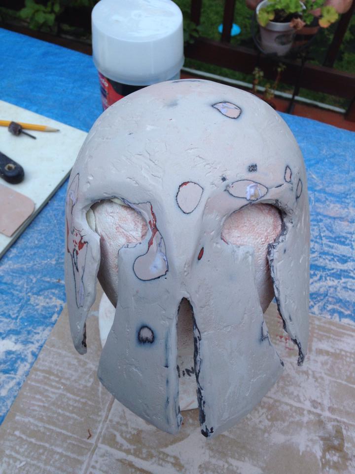

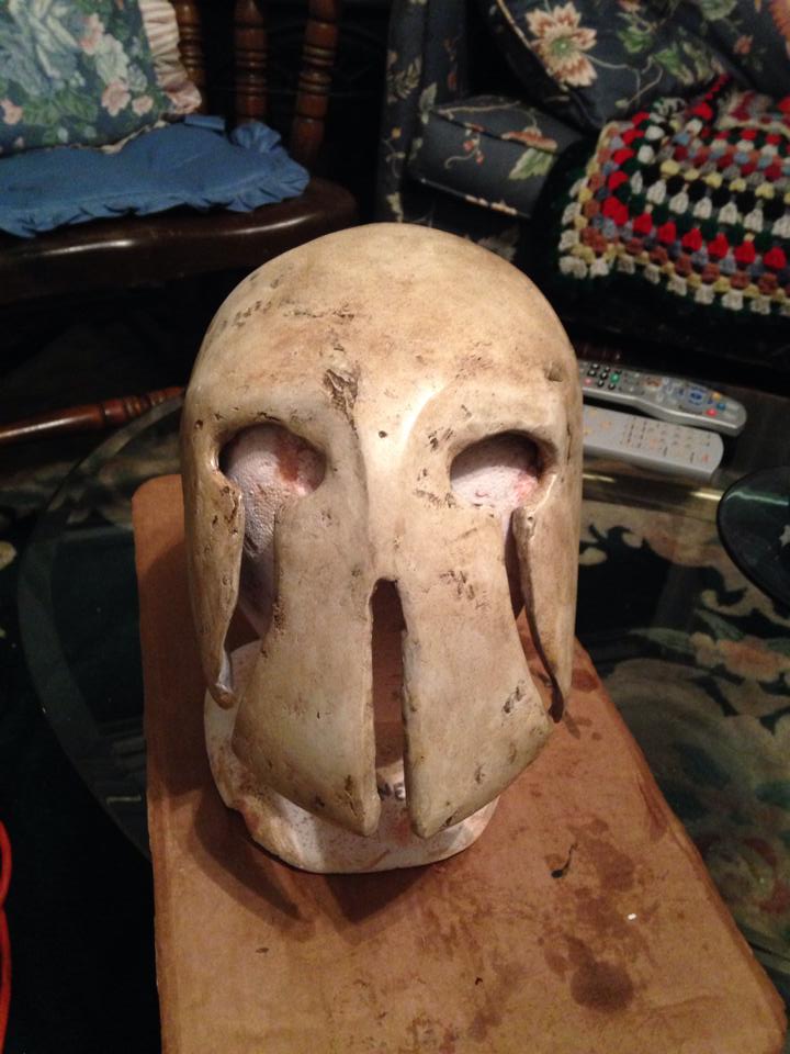

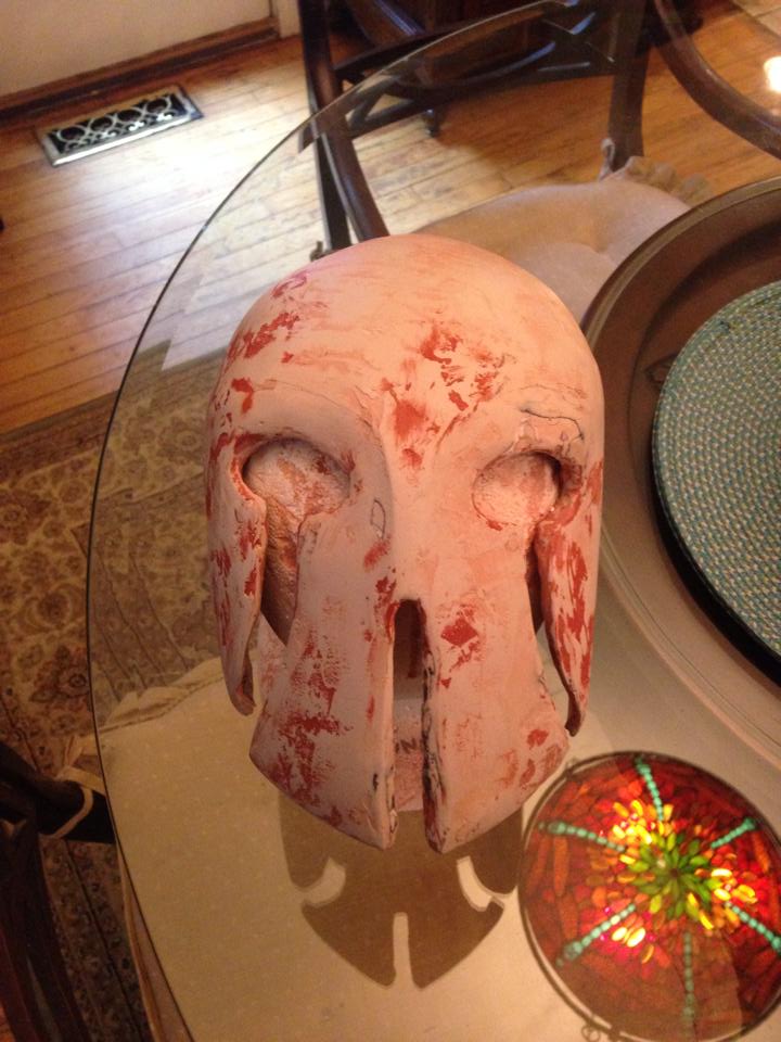

You can see the mask is really bowing out here and I was trying to figure out how to fix the left side as well. So I used masking tape as backing, built up the eye areas in some parts, and also shaved some away with my dremel.
I decided to push the mask together and use fiberglass cloth for reinforcement. This was a step I'd intended to do anyway, but it worked great for fixing and keeping the slimmer shape I wanted.

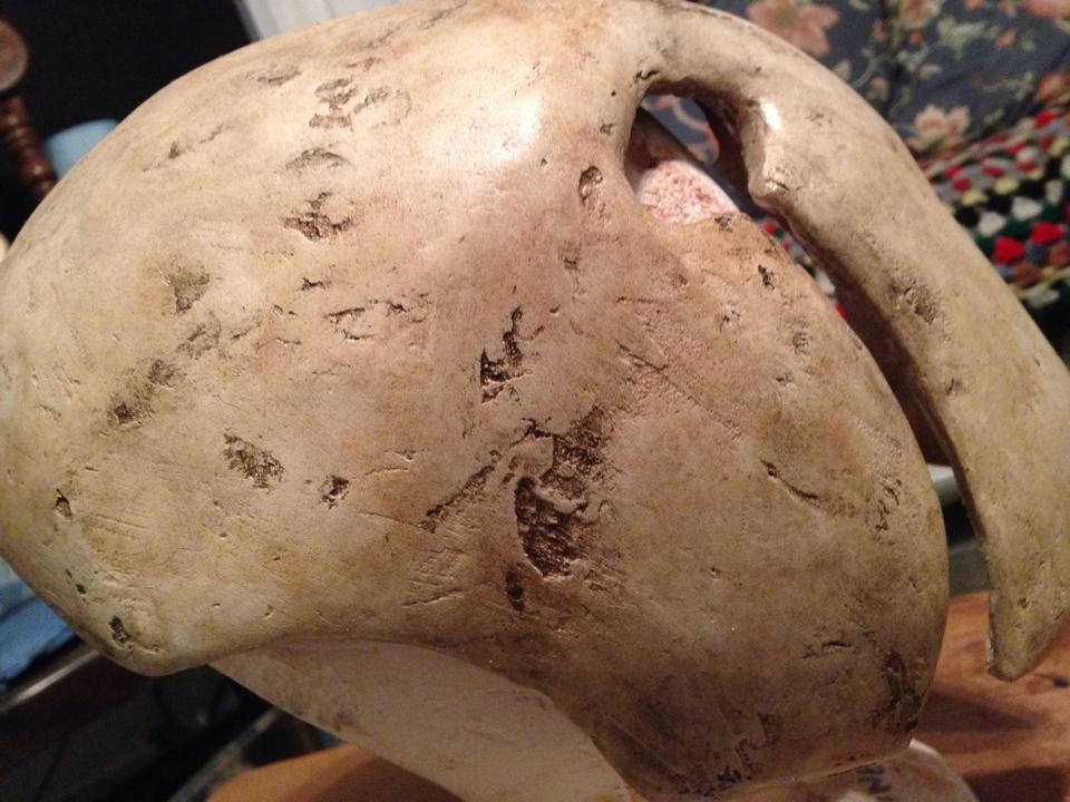

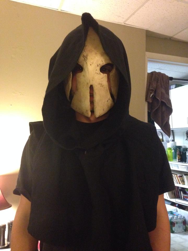

Then I painted it using some spray paint primer, acrylic browns, yellow, and black. Also some natural wood color stain to come up with a texture that looked bone-like. I also purposefully left it pitted for some texture.
10644905_835048053186366_5265364904358111881_n.jpg10600531_835048033186368_820671308901176286_n.jpg

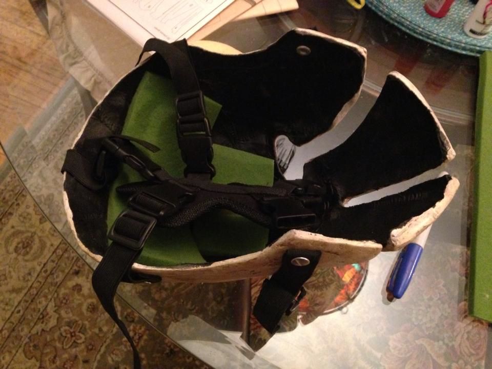

After spraying plasti dip on the inside and I re-purposed the 5 point strapping system for an airsoft mask I own. I just drilled holes in it and inserted the hardware in and it seems to be pretty snug. I also put some temporary foam in, but when I get some fabric to cover it I'll cut more out into the proper shapes and hot glue it in there.
It's a little lop sided, but overall I'm pleased with the result for my first pep'd piece!

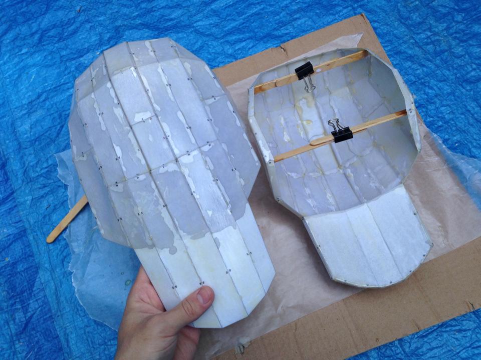

So the mask has been put on hold until I get some fabric to cover the padding. But I've begun work on the pauldrons in pretty much in the same way I worked on the mask. I pep'd out the piece and put some supports on the inside then resined the exterior and interior.

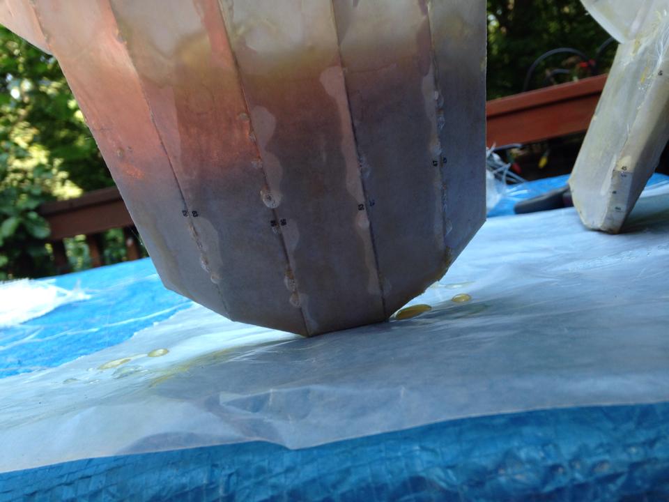

There is a hollow portion on the lower part of the pauldron that I filled with fiberglass cloth and poured resin into. I think maybe next time I'll use a 50/50 bondo, resin mixture because it used up a lot of material doing it this way. The chemical reaction also got extremely hot. I took a picture of what I believe is the hot glue from the pep'd pieces boiling.
10603557_836364879721350_6169087603024078675_n.jpg10592908_836364899721348_6116000706630863859_n.jpg

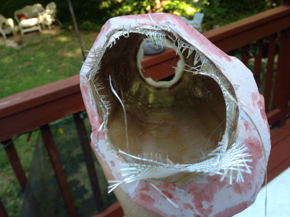

The good thing that came from filling the hollow part in is the thing is extremely solid now. After using some fiberglass cloth to strengthen the whole interior I moved onto bondo and sanding and this is where I left off. I'm going for a battle worn metal look more than the plastic look in the reference. It's pretty smooth now, and I'm going to experiment with some real damage with my dremel before I start painting.

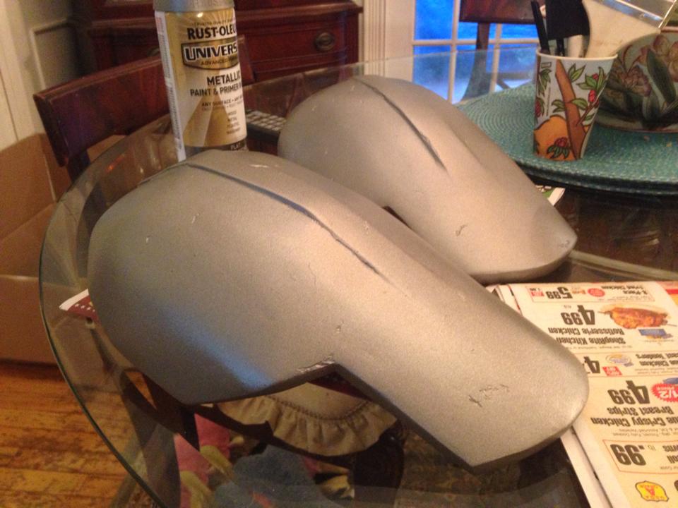

So I've been working on my shoulder pauldrons and finished painting them. I sprayed the pieces with a primer and then this flat nickel metallic color for the base metal. Then I used the condiment/toothpaste technique to easily take away the gloss colonial red top coat on the damaged spots.
10647074_837093886315116_2347242981109512399_n.jpg10386352_837093862981785_6006749786151015517_n.jpg10407173_837093899648448_7177608526750165781_n.jpg
Finally, I did an acrylic black wash and dry brushed some more of the metallic spray on the edges for more of a battle worn look.

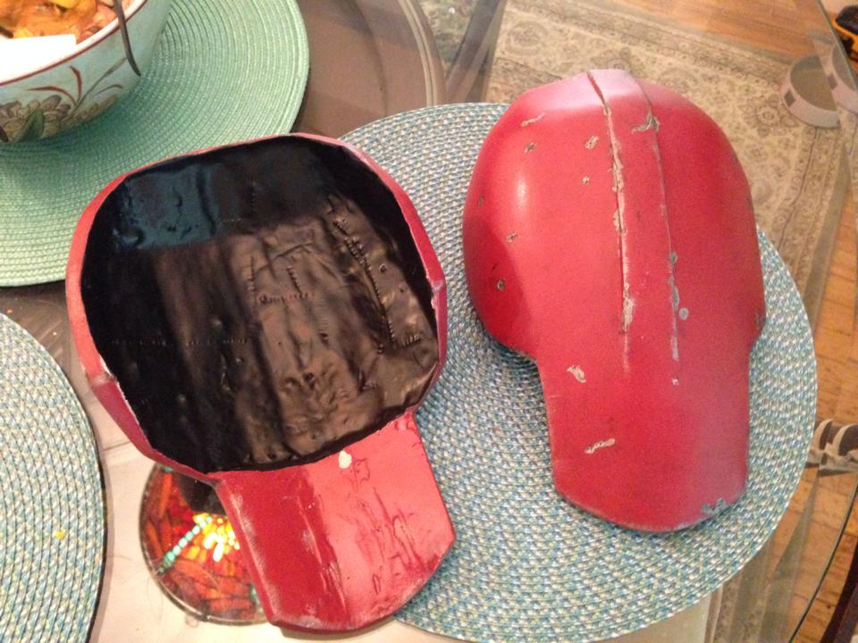

So that's where I'm at. Next up I'm going to spray some Plasti-Dip on the inside of these things and in between coats I'll pep the gauntlets I re-designed.

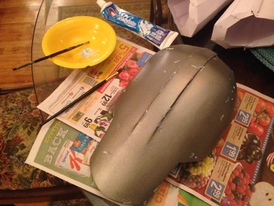

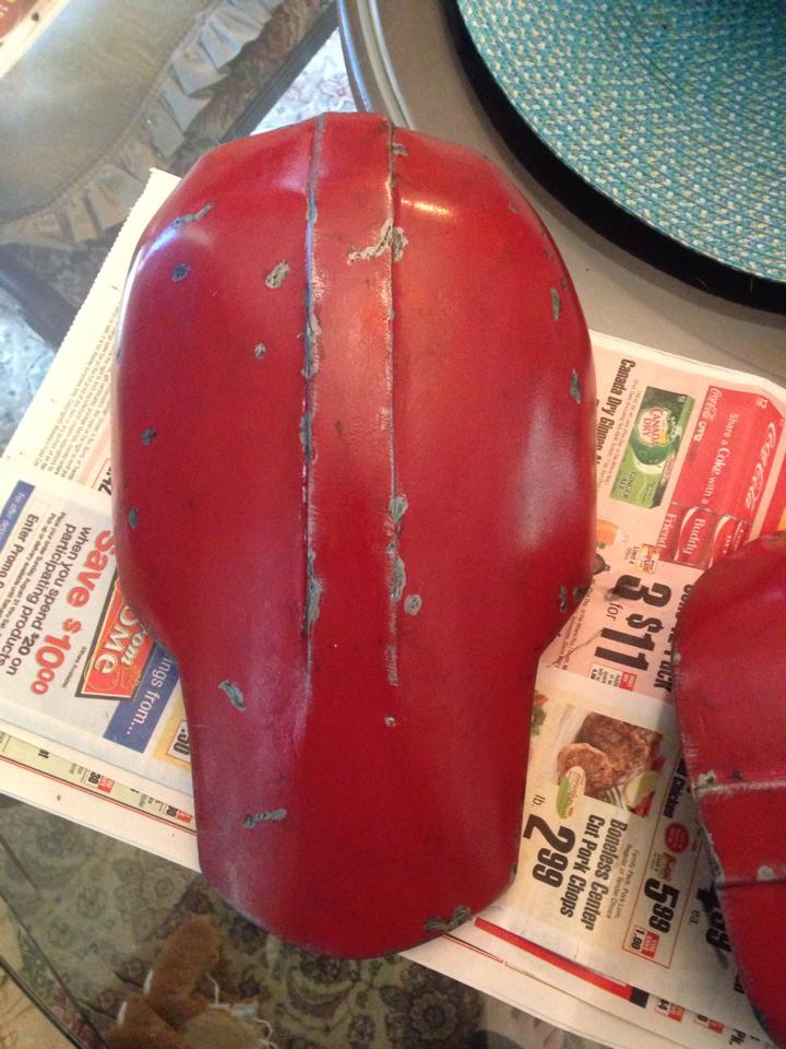

Small update about what I've been up to. I didn't like the glossy look for the pauldron's "metal" finish. It seemed a little too plastic looking so I got some satin clear coat spray paint to dull it a bit. This picture doesn't do it much justice, but I like the result a lot better. I also sprayed some Plasti-Dip on the inside to seal it. Next up will be just figuring out a good way of strapping these things to myself.

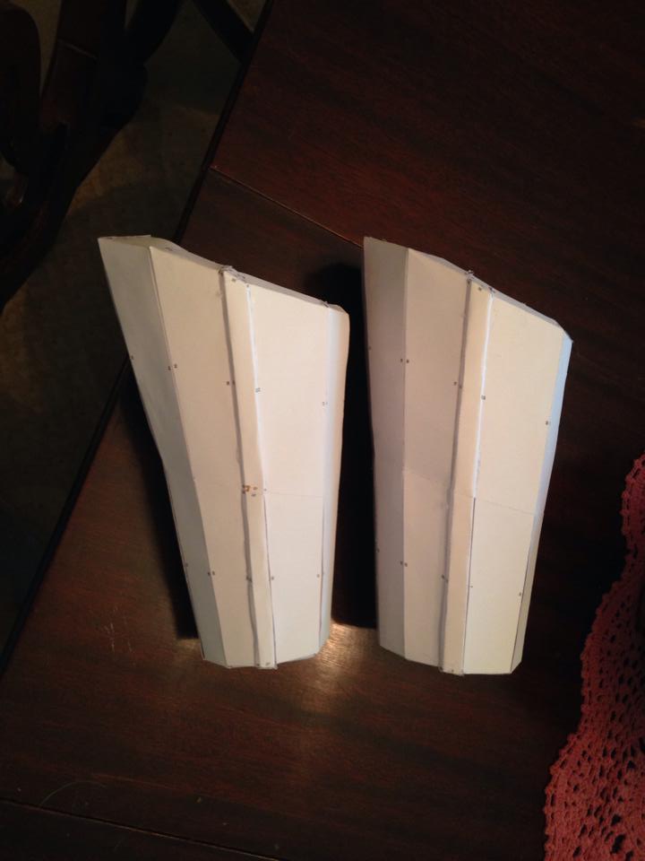

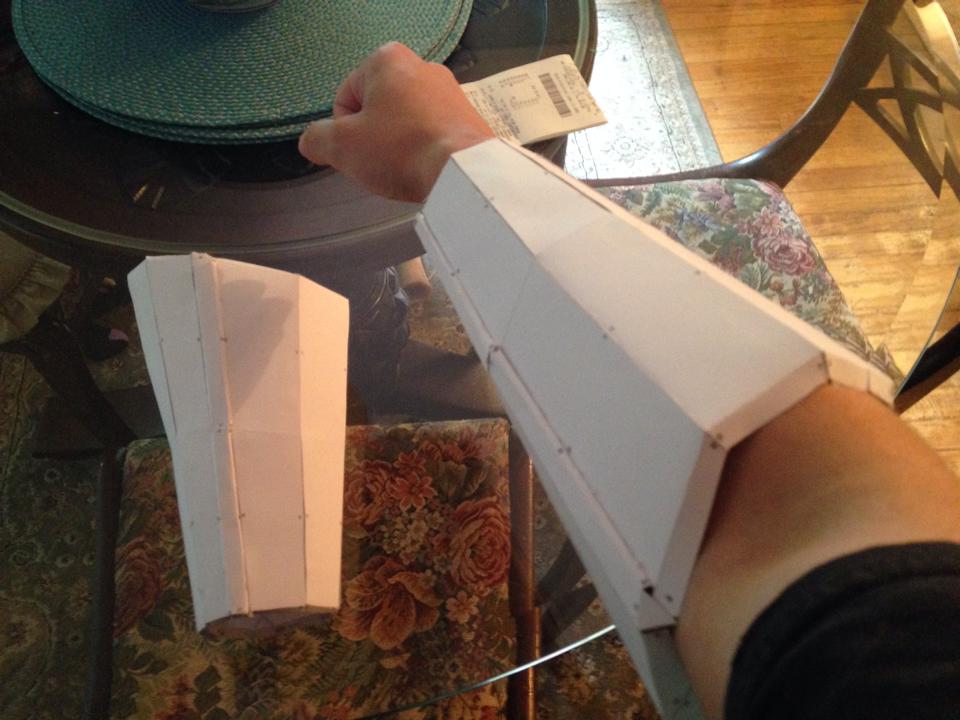

I also re-peped my bracers. The original is on the left and the version I resized and edited on the right in the first picture. It's still a little too small. I'd like to be able to pull it over my hand and have it rest there rather than having to worry about two pieces for each bracer.
It's technically still a good size, I can get a decent range of motion of out them. The problem is they don't really stay in place when I drop my arms down. They just slide down to my hands and they end up looking too small anyway. I imagine some of that sliding will be minimized when I'm wearing my robes and gloves as well. But anyway, I'll be trying again and making it bigger.
So next up again is re-sizing and re-pepping the bracers!

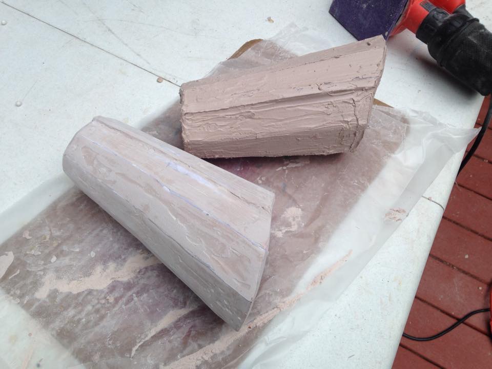

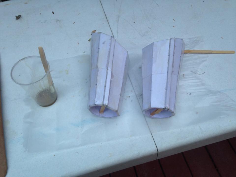

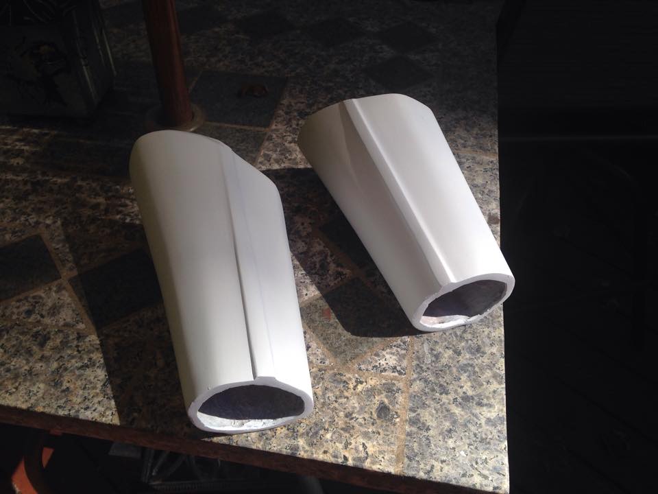

Anywho, I started a new job so have had less time in general but have still been chipping (more like sanding) away in my free time. I finished up the bracers the other day.. here are some works in progress shots.
1622147_849888968368941_1532154803798237568_n.jpg10628013_849888995035605_6409638731771055252_n.jpg10450167_849889011702270_7920932562357221017_n.jpg10689558_849889041702267_7004575381093491350_n.jpg

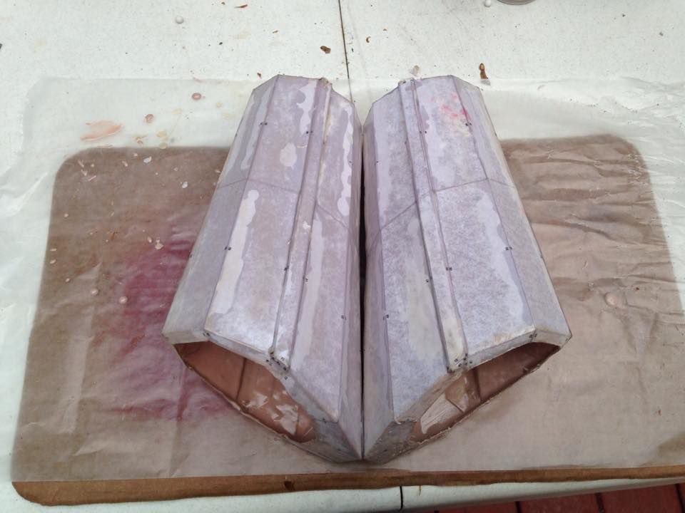

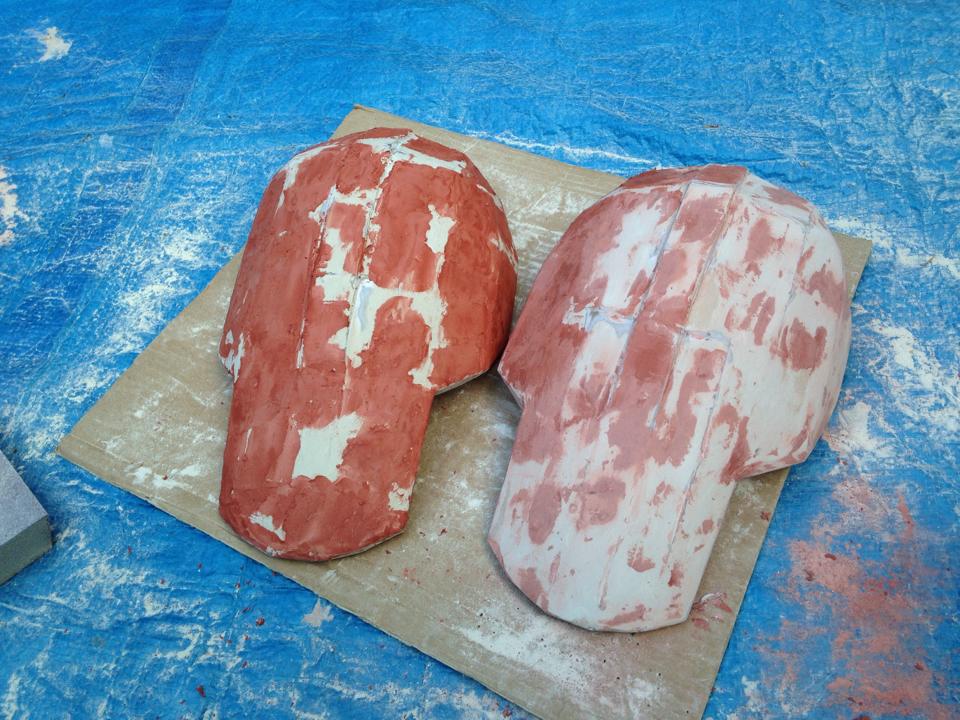

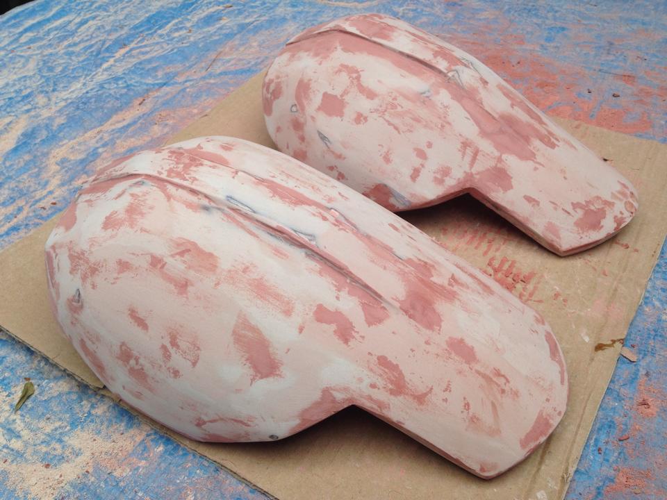

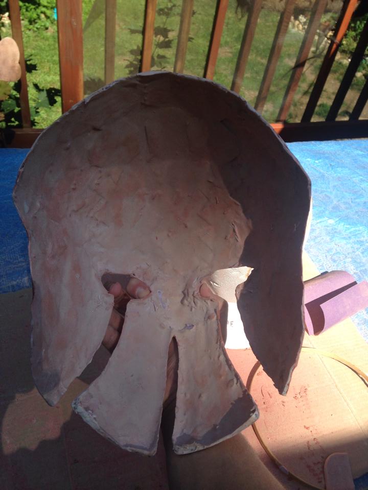

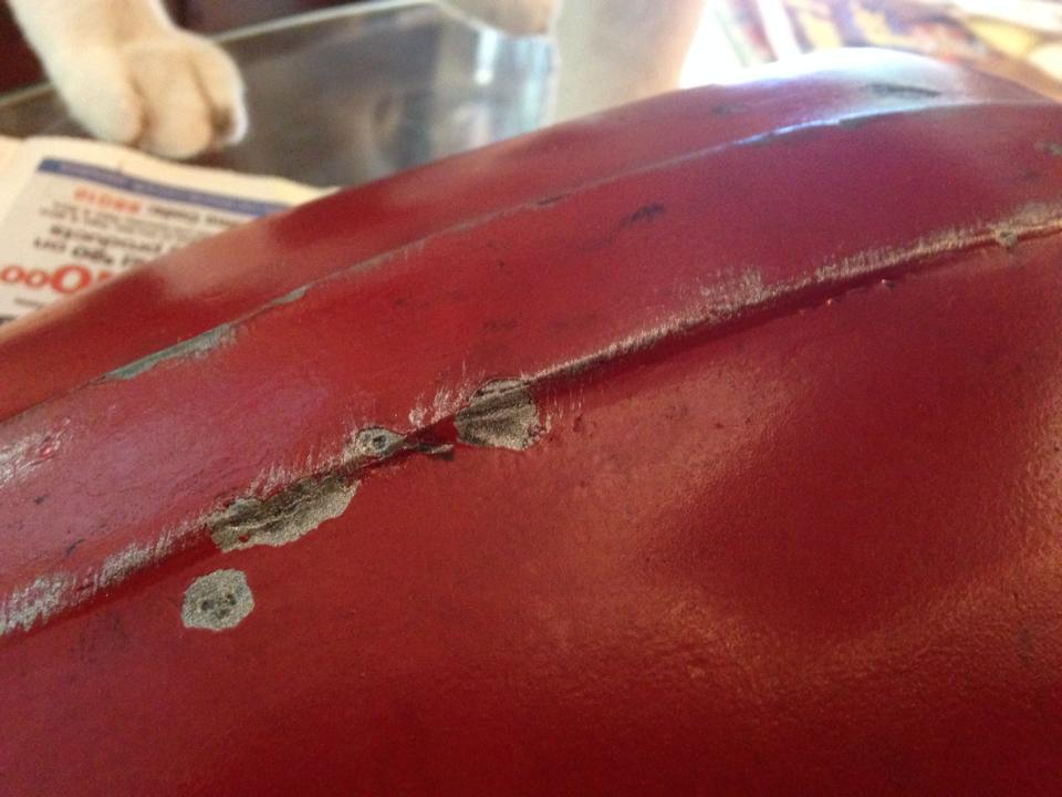

After like 3 or so coats of bondo and spot putty and plenty of sanding they were pretty smooth. So I moved onto painting them pretty much the same way I did the shoulder pauldrons. I also snapped a shot of my makeshift painting rack - 2 lawn chairs, 2 garbage bags, and a dowel.
10653627_849889068368931_9217236400450158837_n.jpg10355766_849889101702261_4011066001937305451_n.jpg10659444_849889121702259_995453175803190673_n.jpg

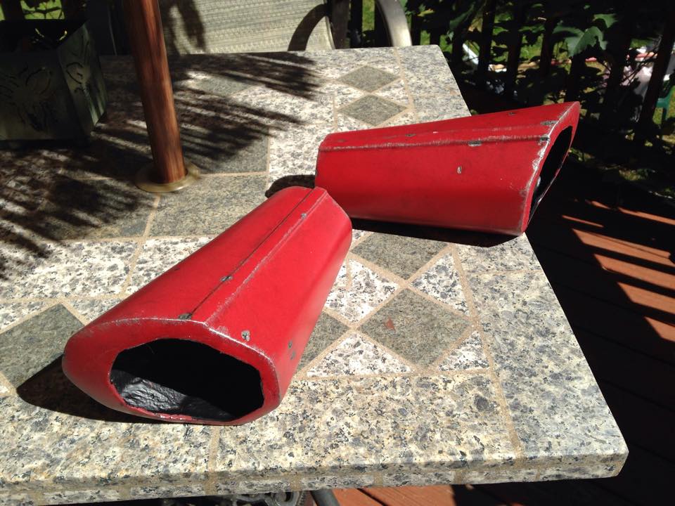

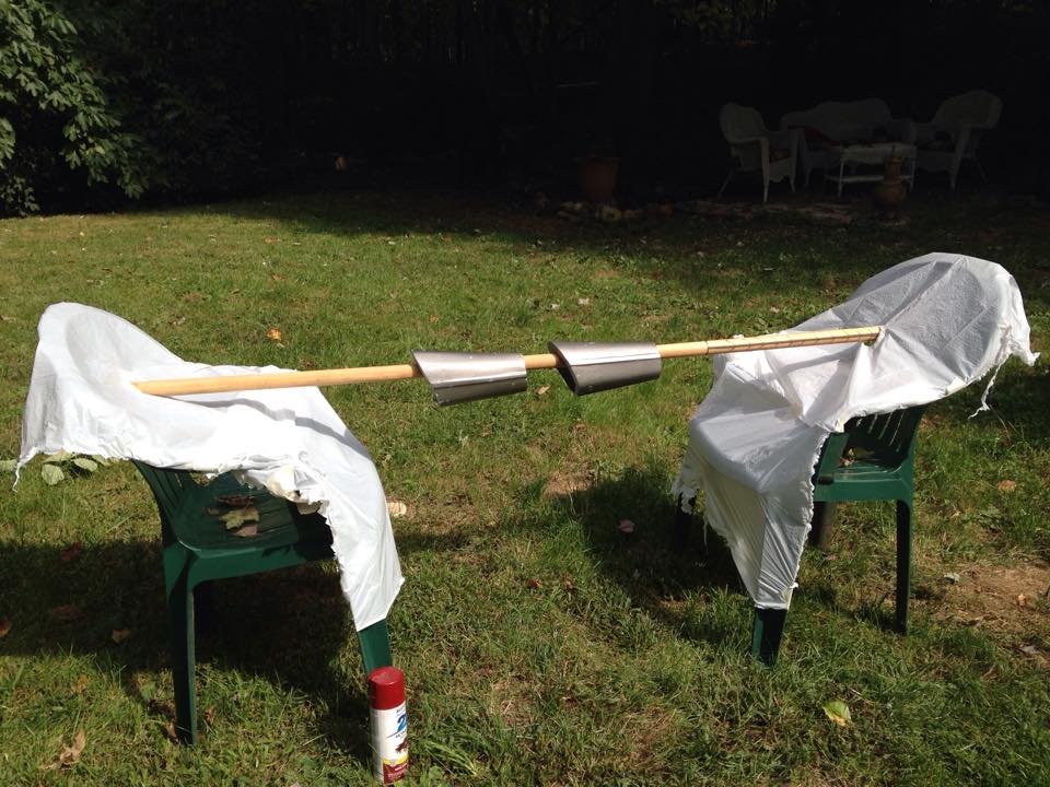

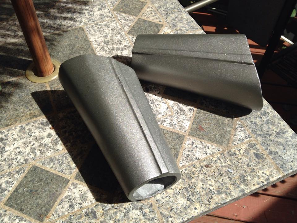

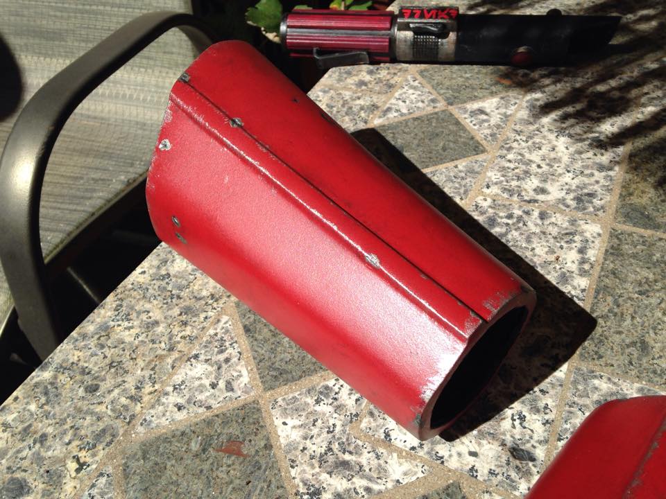

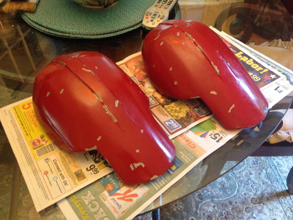

After a few coats each of primer and nickel metallic spray paint, I went on to the colonial red gloss and then acrylic black washed them. I also dry brushed some of metallic paint around the edges, and then used a satin clear coat on it. I finished them off by spraying some plasti-dip on the inside to seal it like the other pieces.
10403545_849889158368922_2090145087519448681_n.jpg10565097_849889138368924_7801892651184664358_n.jpg

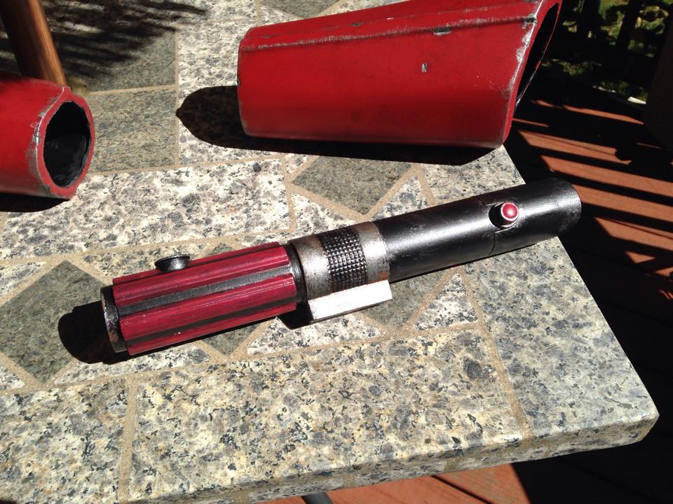

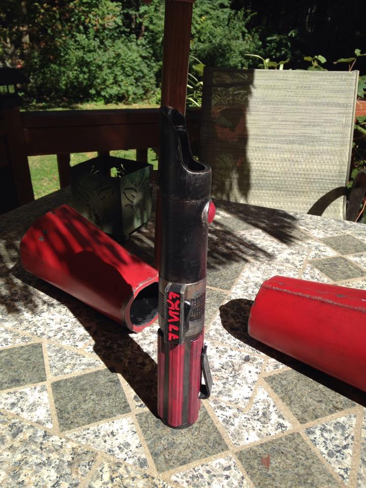

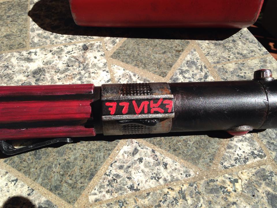

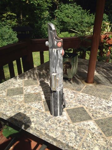

Also, I worked on this simultaneously with the bracers.. I needed a lightsaber and didn't have too much money to spend so I went to the toy store and picked up this version of Anakin's lightsaber for $10. I removed the blade, cut off some of the parts like the sight on the top and filled others in with bondo. I sanded it down and painted it with a matte black spray paint. Then I took my metallic spray paint and dry brushed damage in certain areas, and painted it on heavier in other places I wanted to look more metal. Then I used black wash to take some of the details out of the silver, and painted the red on buttons and the fins, some brown for rust, and added a little inscription in Aurebesh that reads "Dread".
10704991_878881648920_1701279847_n.jpg10702225_849894921701679_2794034383289223144_n.jpg10703799_849895071701664_836241933498274299_n.jpg10711014_849895035035001_6403731582391379678_n.jpg
So that's all done.. I still have some strapping to do for the pauldrons and padding for the mask. The clothing is coming along as well.. the hood and tabard are done I just haven't decided if I want to paint the red designs on or do something like applique. After that is just the jacket and the red under tunic. Whew.. it's getting there! Thanks for all the support guys!

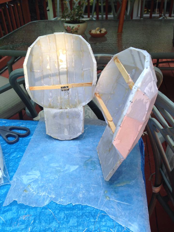

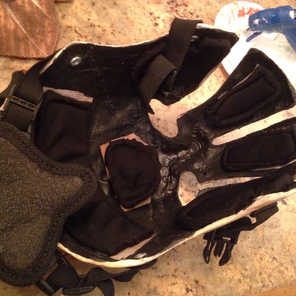

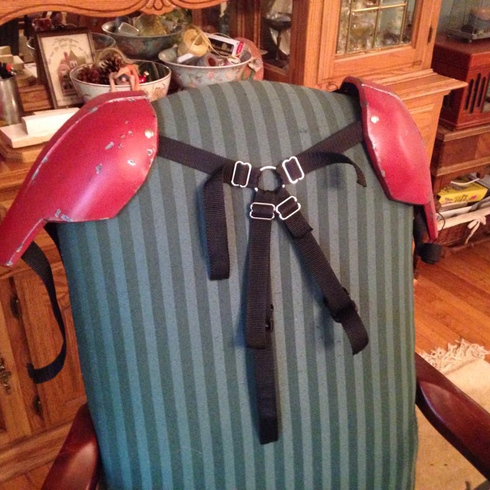

Here are just a few more work in progress shots. I finally got around to doing the strapping and padding I'd been putting off. The padding was very simple.. just like I thought it would be. I just cut out areas of the Plasti-Dip so the hot glue+craft glue would adhere better and stronger. For the pauldrons, I followed the looks of various armor strapping designs I found on google. I used a combination of parachute buckles, chicago screws, and good ol' velcro. It's pretty secure, not exactly sure how it would hold up if I tried any stunts in it, but I'm not worried about regular movement in them.

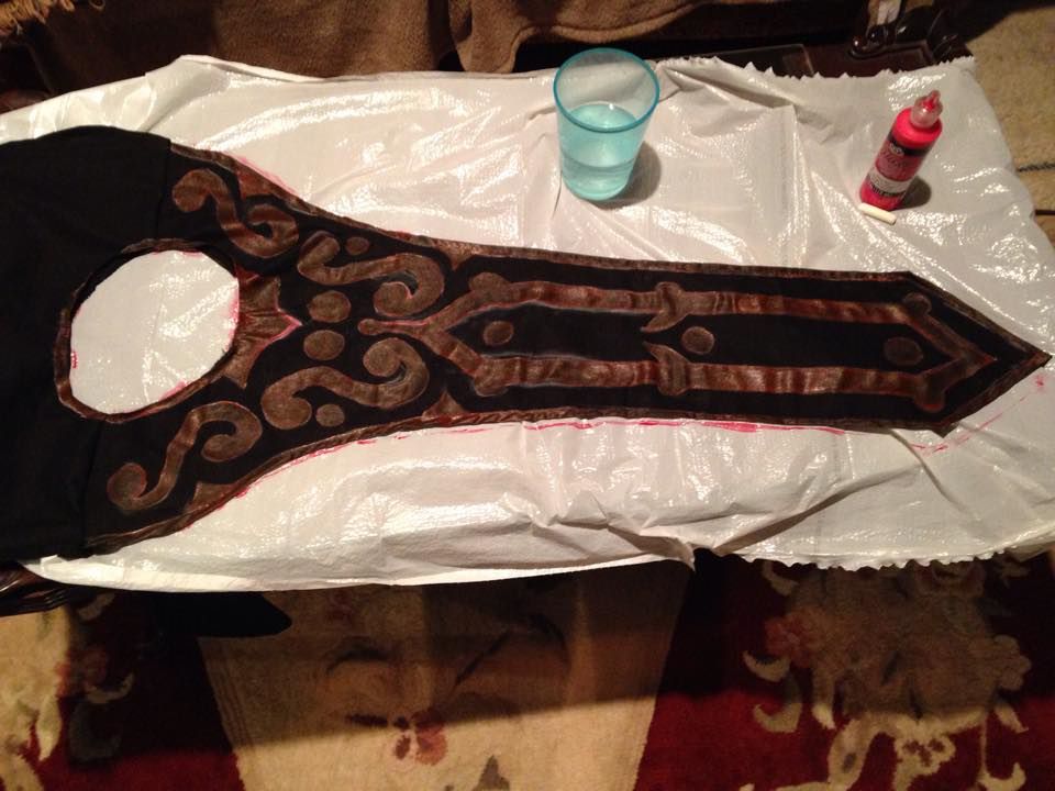

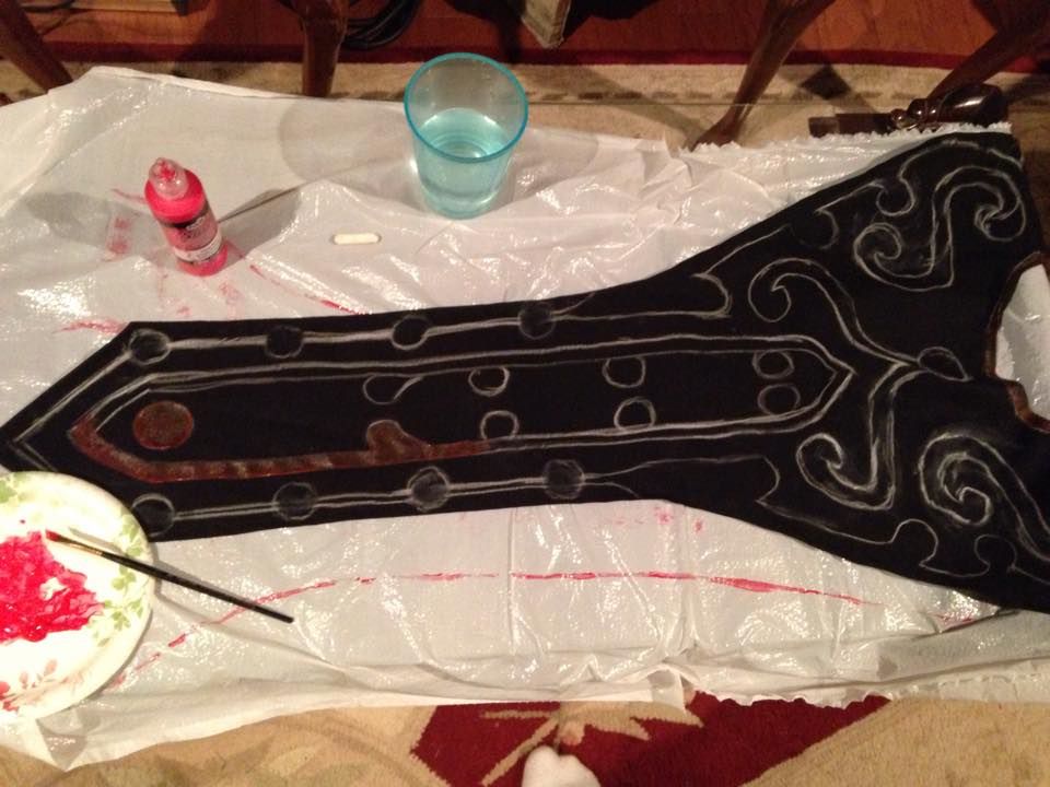

I also decided to go with fabric paint over applique. It was probably the more time consuming way to go about it, but I'm happy with it. I I freehand stenciled it in chalk and used water as a sort of eraser for errant chalk lines.
