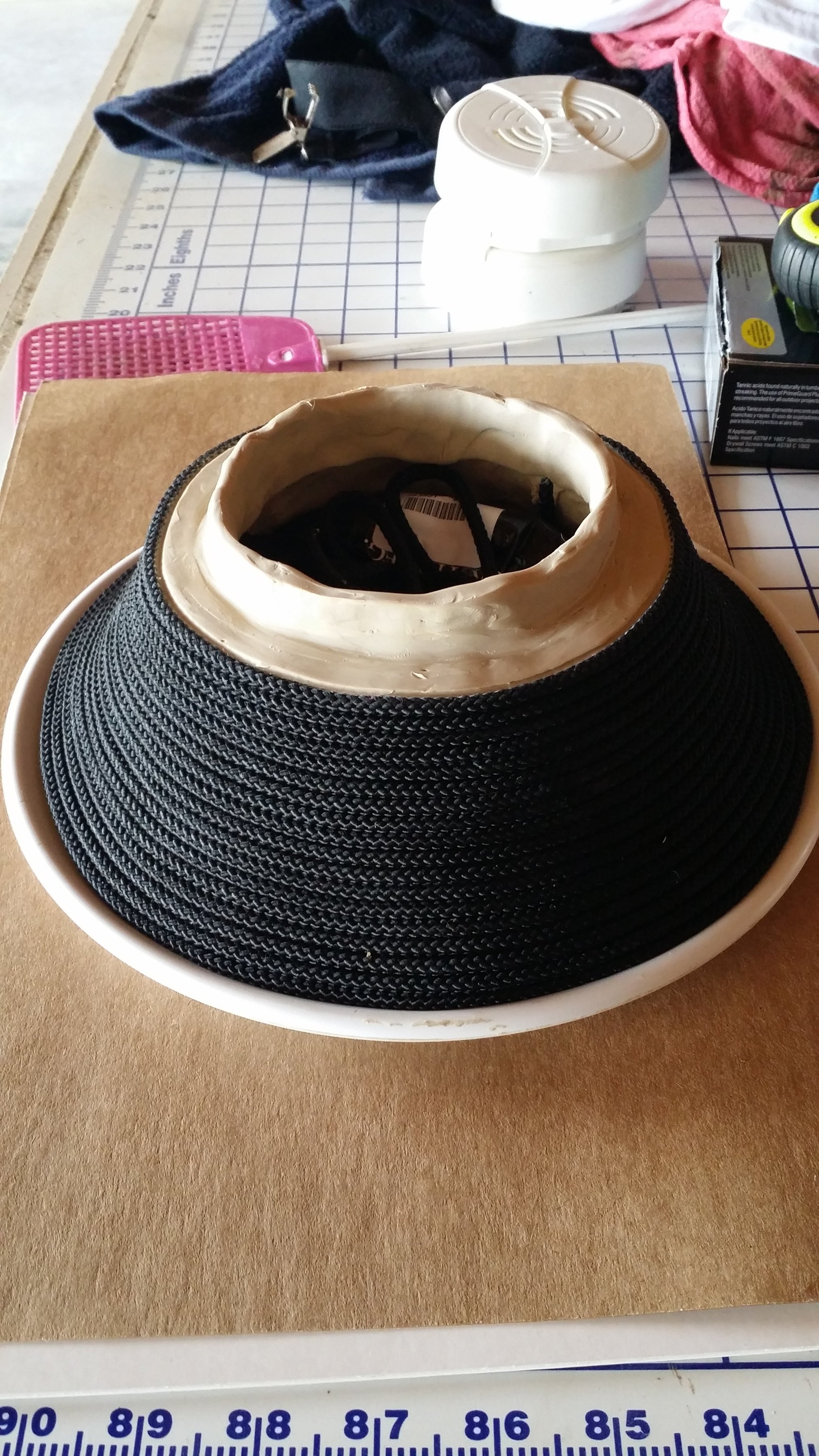

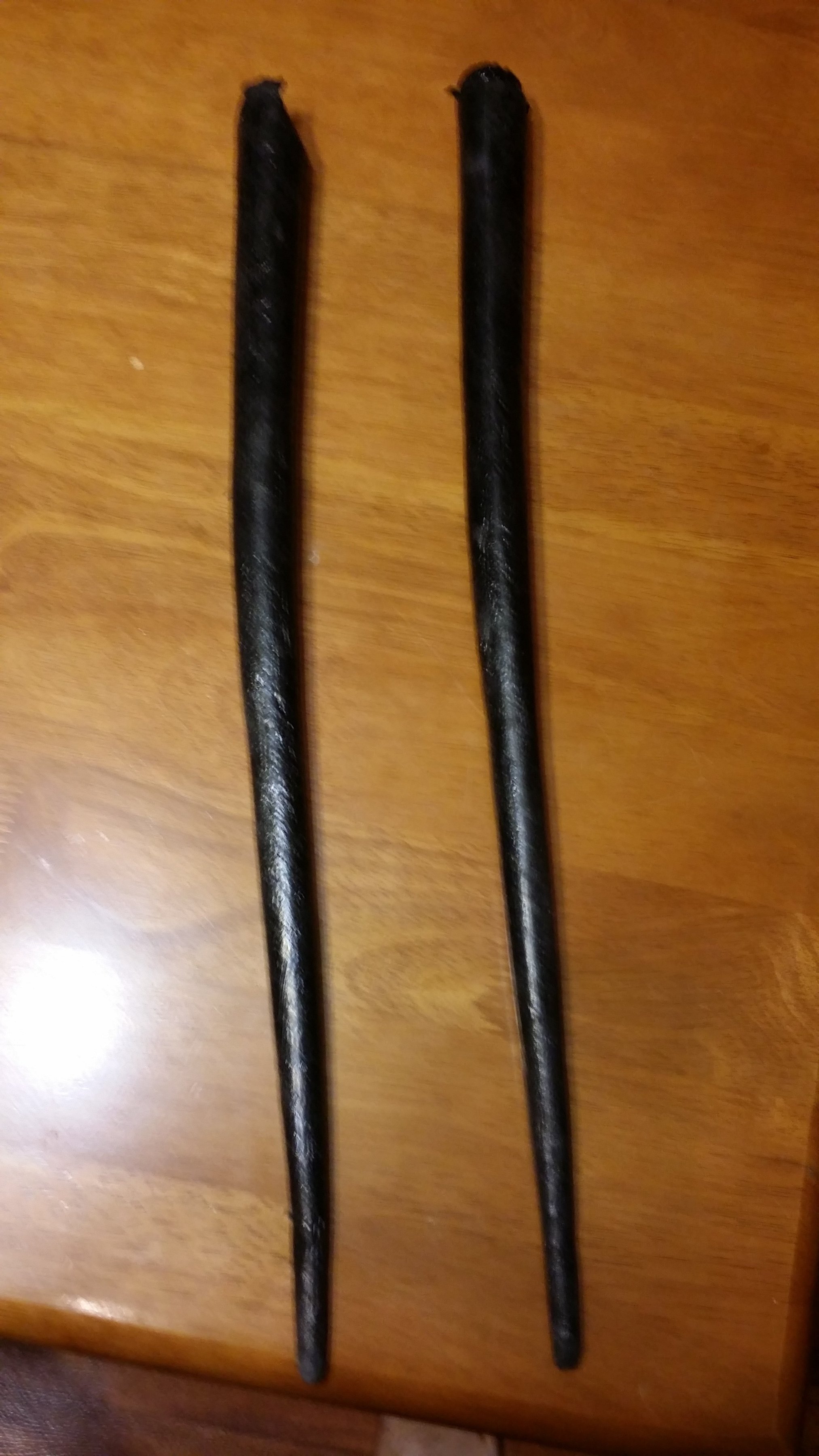

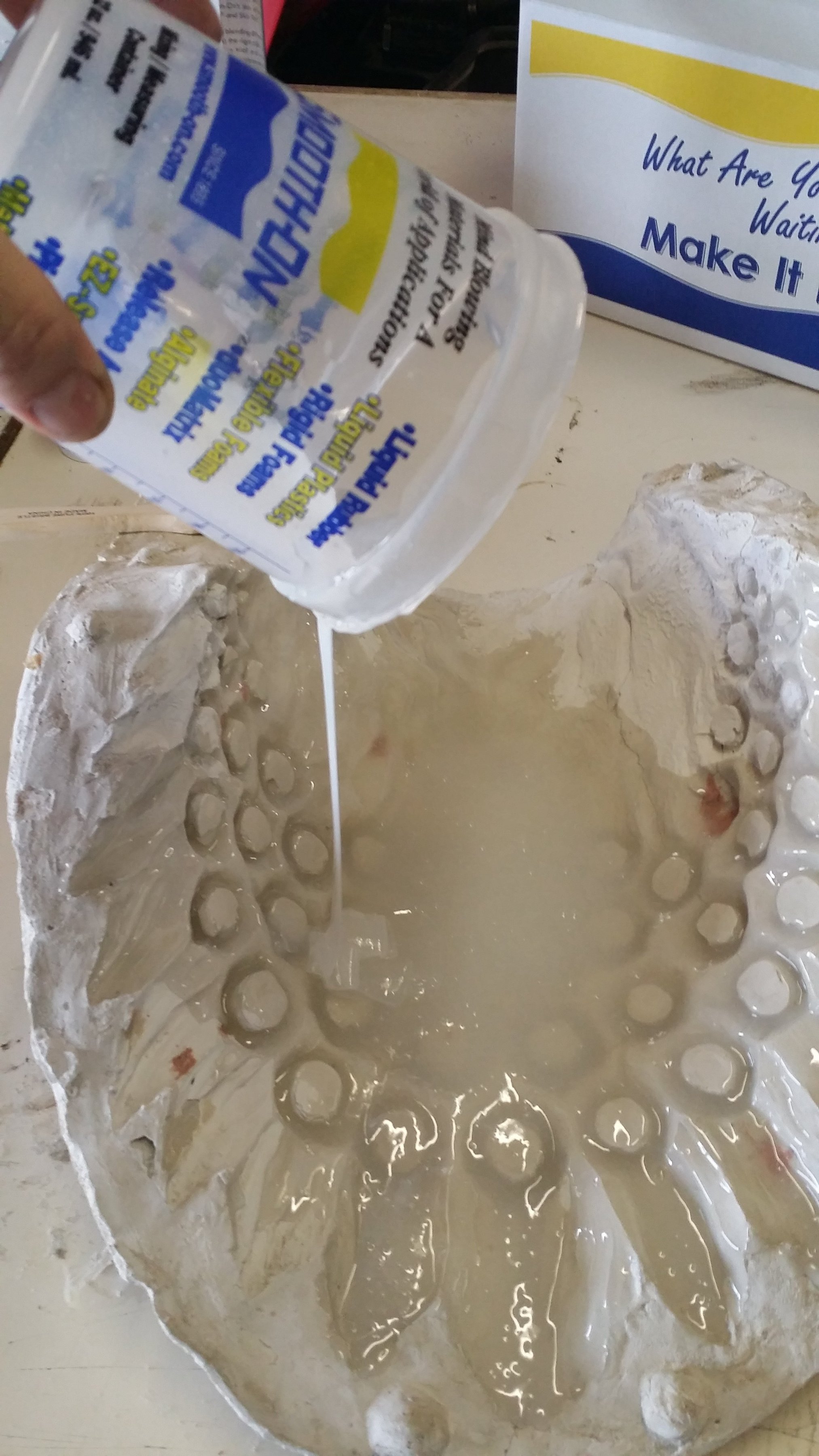

I started with making a dread ring because i didnt have one so i decieded to make one the cast is ultra cal the Silicone i used was Dragon skin Pro with there coloring agent to tint it black. The next thing i did was make the dreads using there flex foam 6 pillow soft foam with the black tinting to color them.

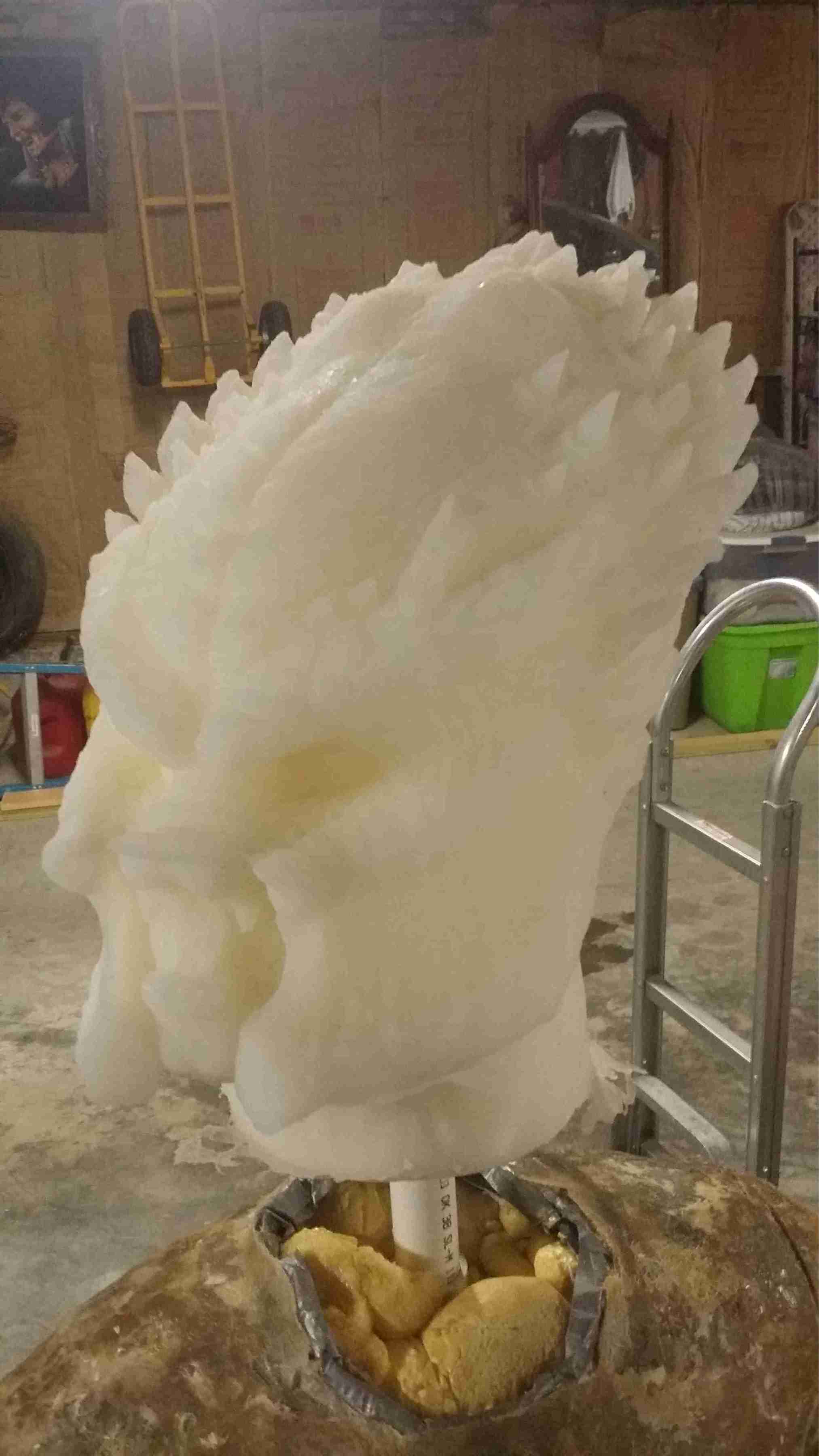

And now for the hard stuff .. I got out one of my molds for the head that is made out of ultra cal 30, they wanted to use dragon skin Pro for the skin on the project. That had many problems here is what i ran into. after using alot of release agent the silicone wanted to stick to the mold Normally it's not a big deal but for this project i had to fill the head with foam so it was a Nightmare to get it out of the mold with the foam inside of the silicone . But after a few hours or pulling kicking and screaming i was able to get it out intact.

thanks guys. The only problem i ran into was it was sticking into the mold but with some gentle pulling i was able to get it out . If i had to do it over again i would use a fresh mold.
Here is the mask out of the mold and filled with foam. so far no problems. Now on to the paint. They sent me Psycho Paint and a set of colors to use Now i have never used this stuff before and it's a bit tricky but once you get the hang of it it's ok to use and the colors are so life like.

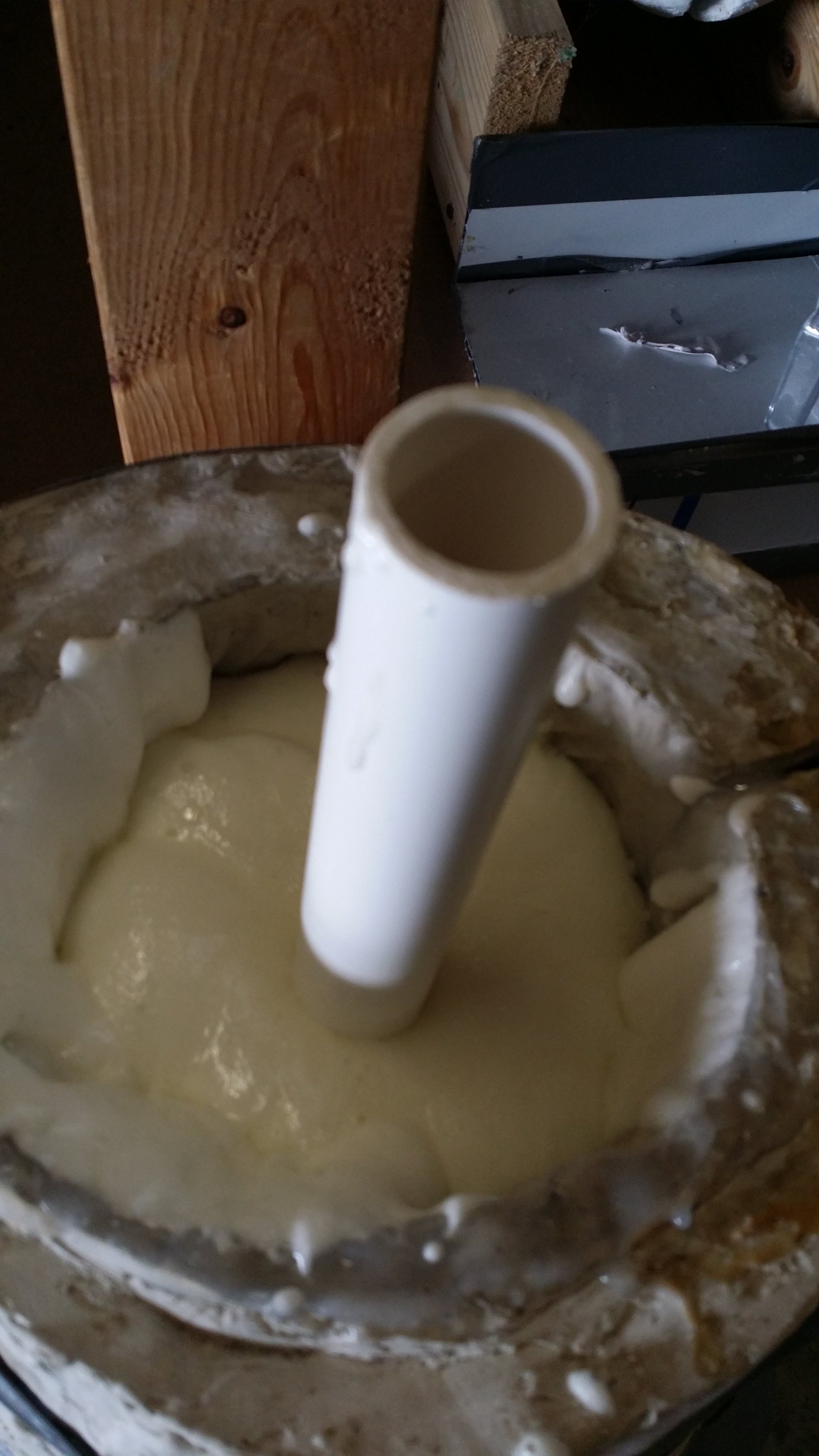

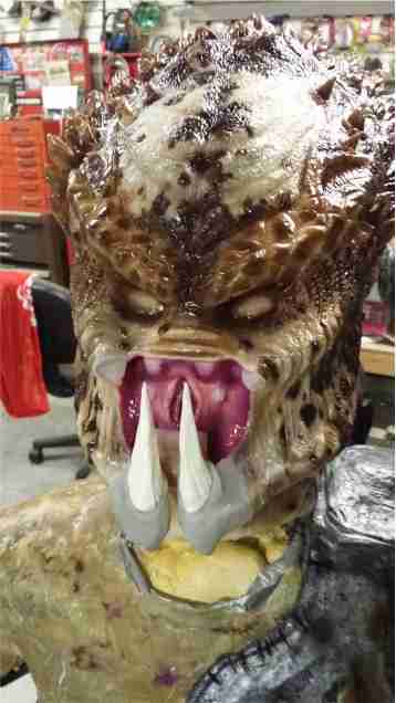

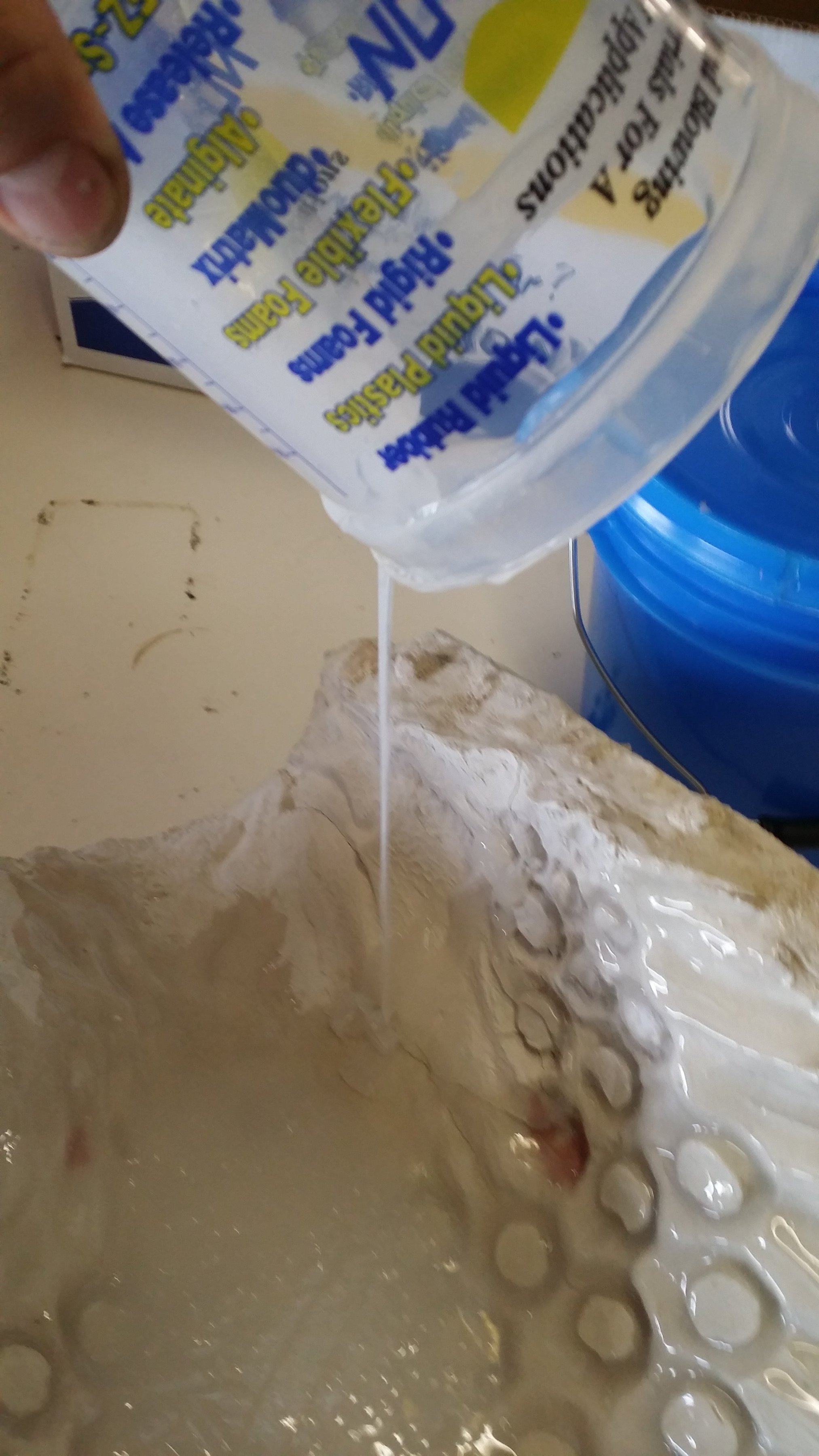

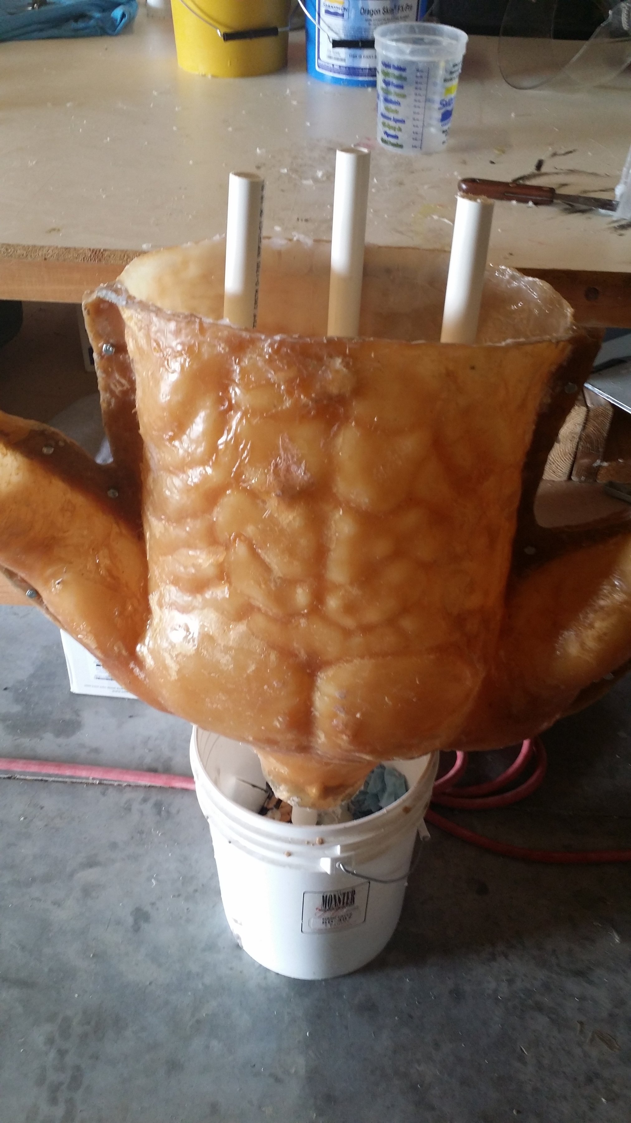

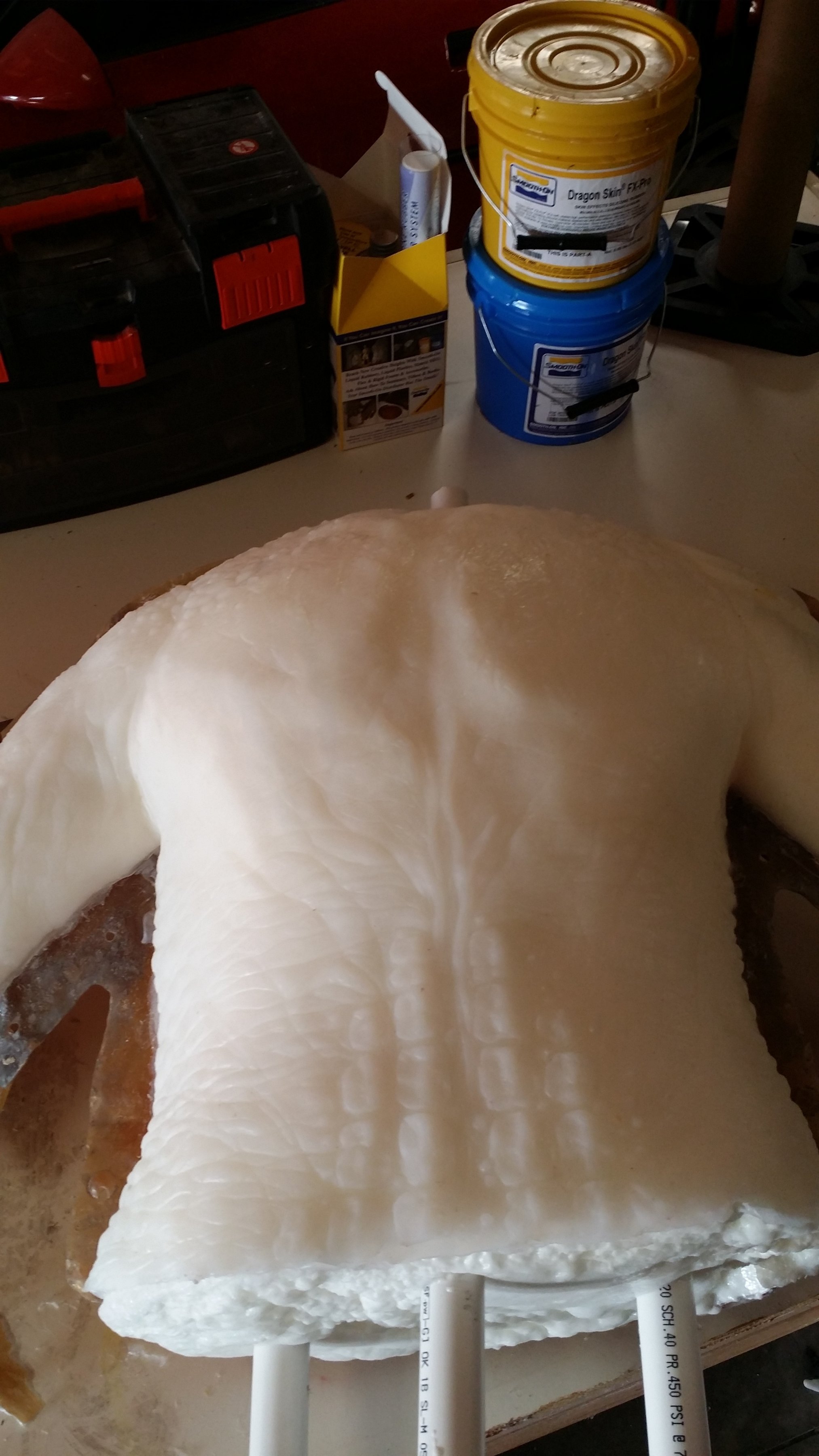

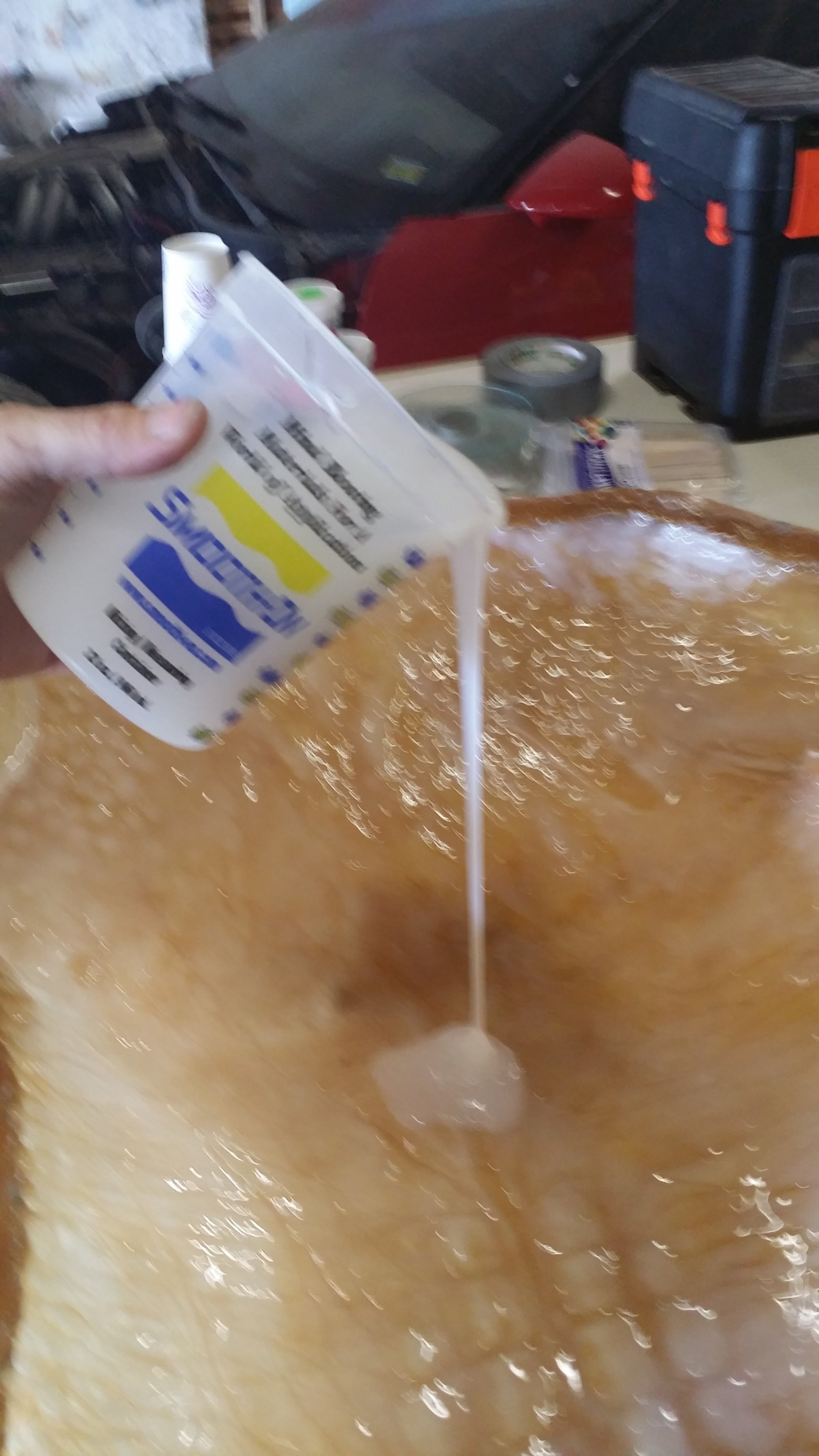

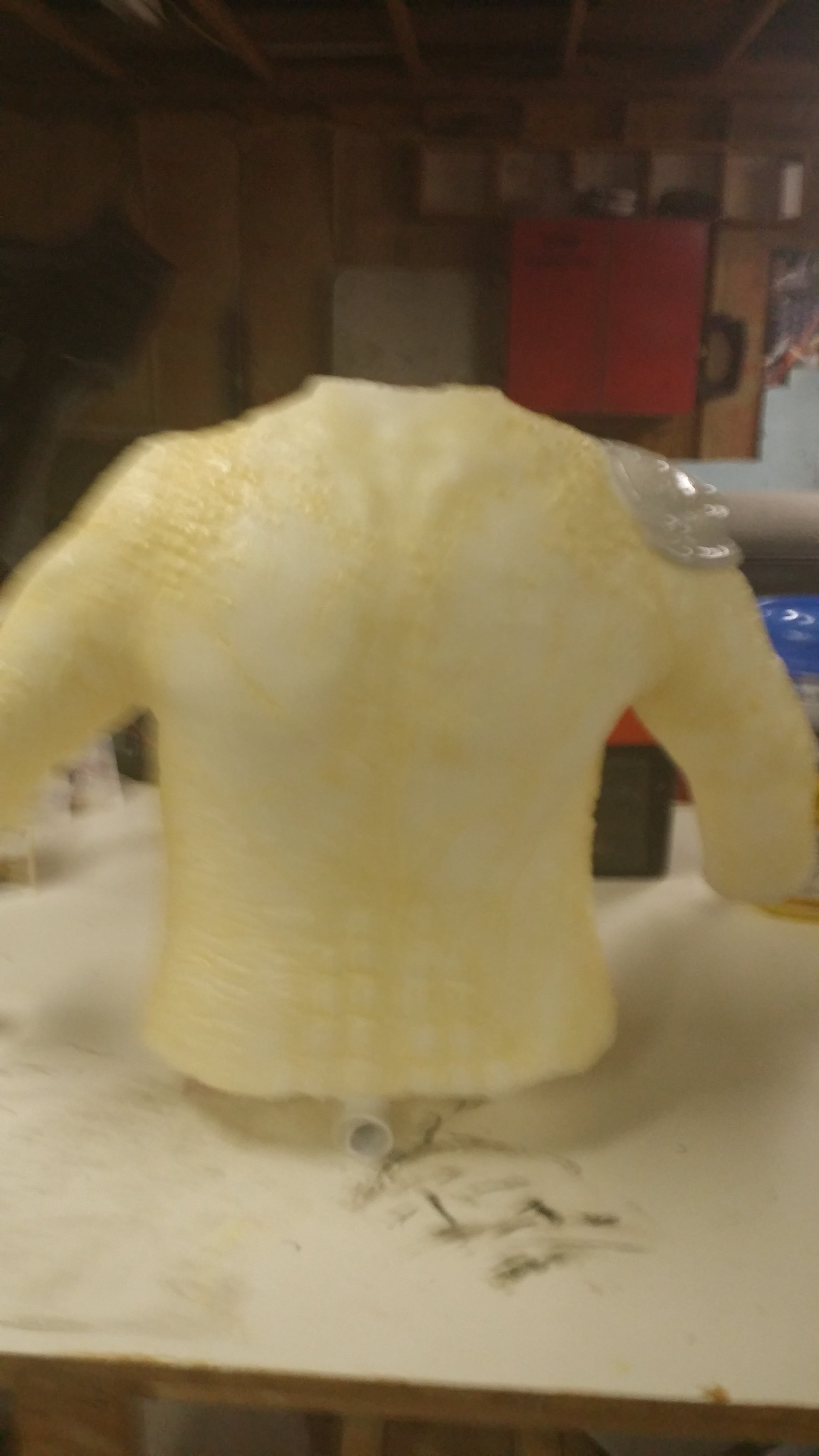

I did the usual color scheme on it for me. They wanted something a little different than whats out there so i made it a desert style hunter. Keep in mind these colors have to be sprayed on with in 48 hrs of pulling the mold so the paint will bond to the silicone. Here is about 5-7 layers of paint. Since i never painted with the stuff before i made a test piece of the face so i could try the paint on it because once you put it on there is no going back once it is drying. I used their Resin for the teeth and to get the mandables attached they sent me this stuff called sil-poxy. It will bond almost anything to silicone but it's 9.00 for 10 grams. It doesn't exactly go very far but i got a tip that if you use clear ATV gasket silicone from a autozone or Napa store its 4.50 for for a whole tube. and it's basically the same stuff. i am now on to the torso Now it's a fiberglass mold and has been used for latex but i soaped it out and sprayed there release agent into the mold letit dry BTW i put down about 4 layers of release agent in it. And built a PVC skeleton for the inside so i had something for the head to attach to and so i can put legs on it when i flipped it over.

the silpoxy alternative is GE Silicone 1 clear... sold at most home depots, You can paint with it too ... however if you want the maximum adhesion use Shinetsu

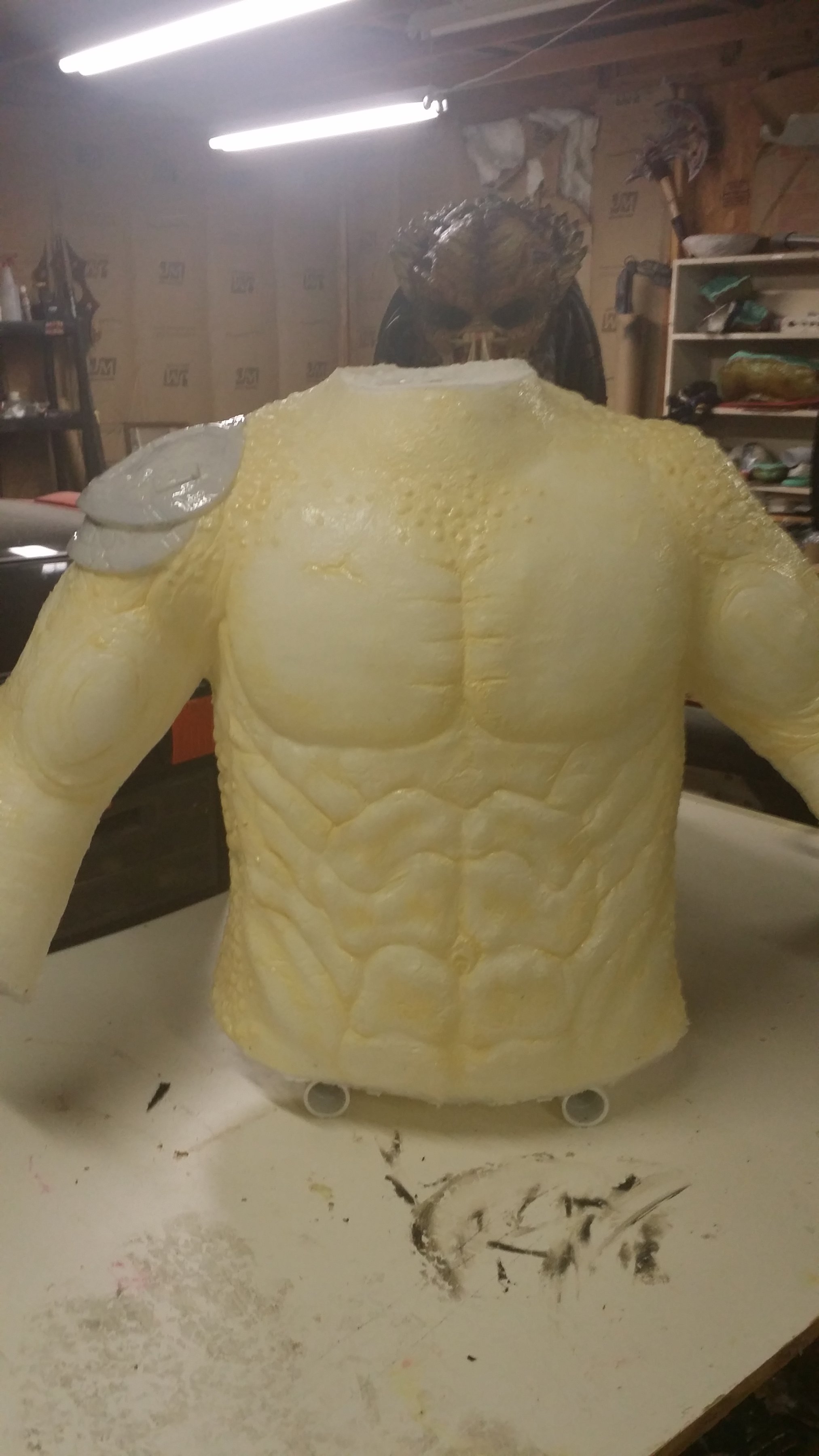

20140817_182516.jpg 20140817_182510.jpg 20140817_162644.jpg Copy of 20140816_110531.jpg 20140808_202215.jpg 20140817_162644.jpg 20140817_182510.jpg Here is a couple of more pics i was finally able to upload of the process of the torso and head piece.

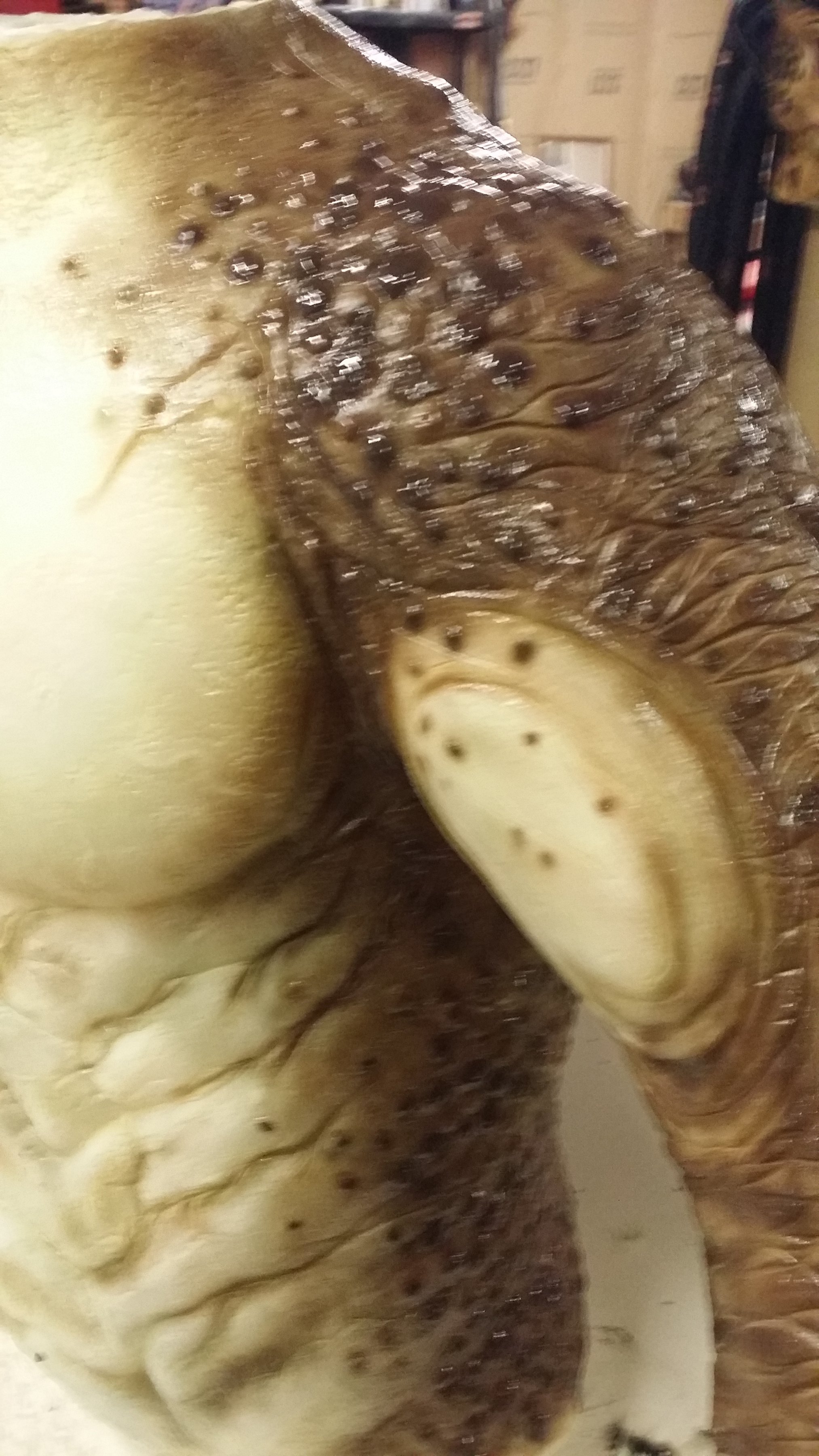

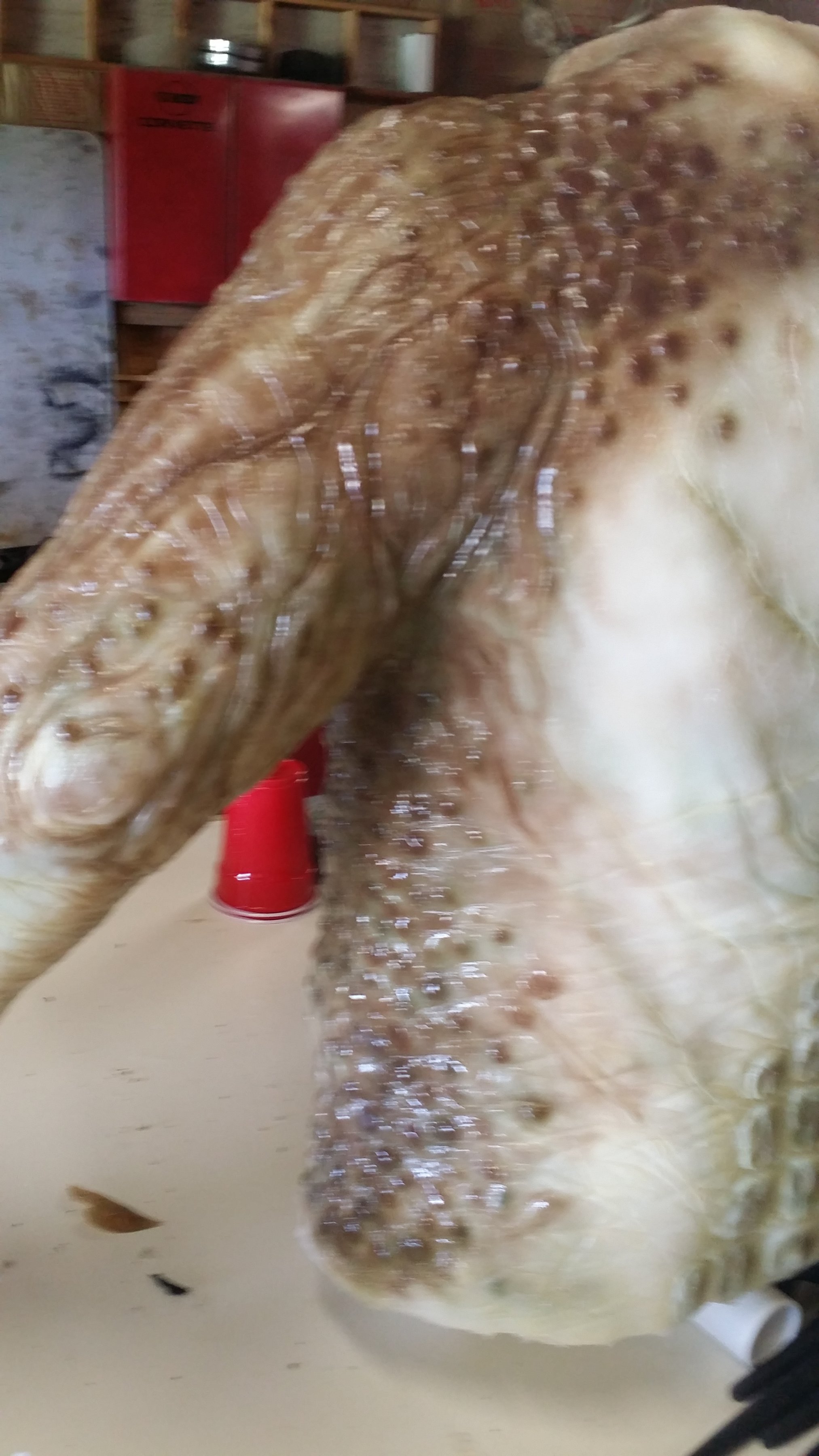

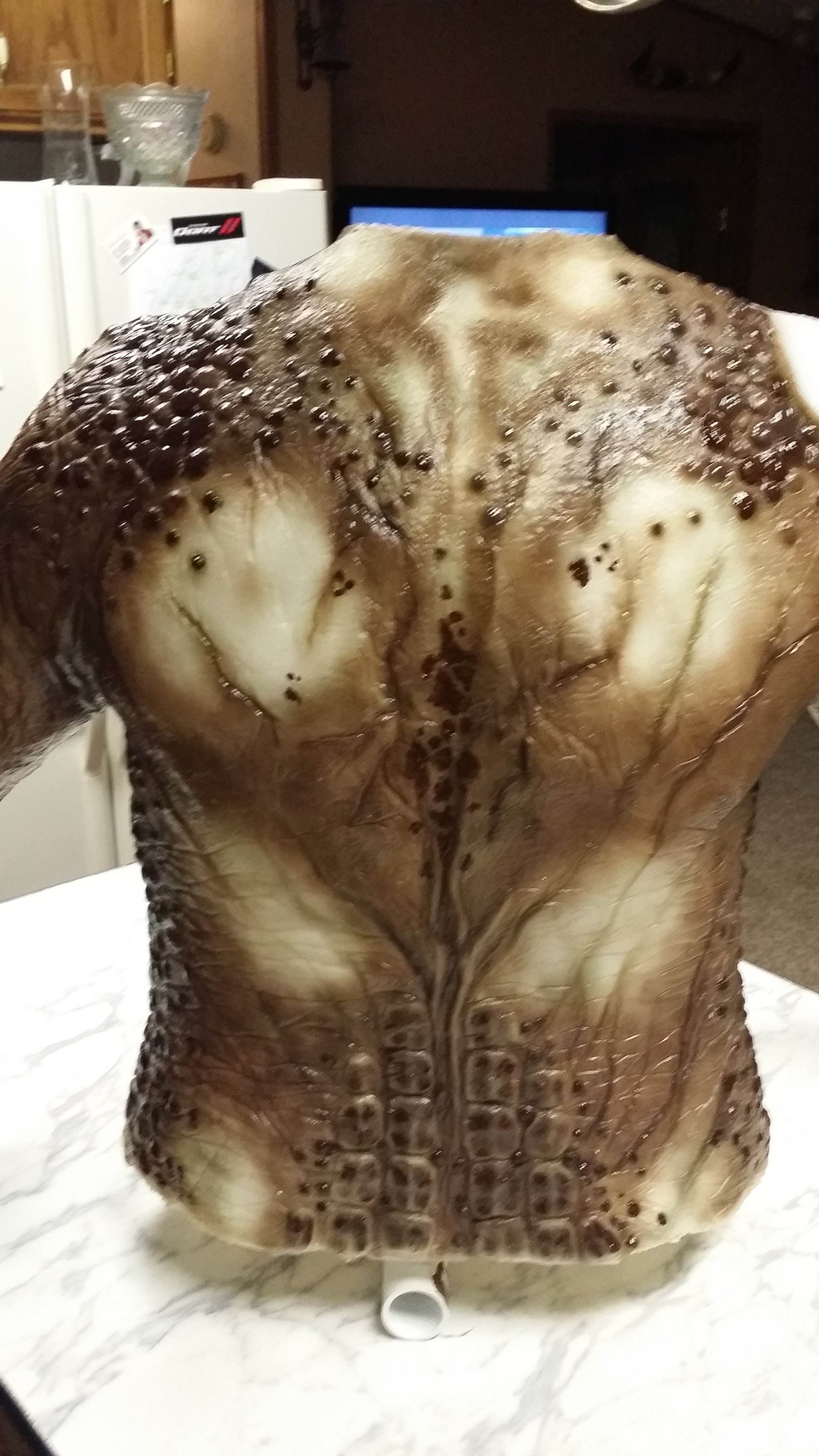

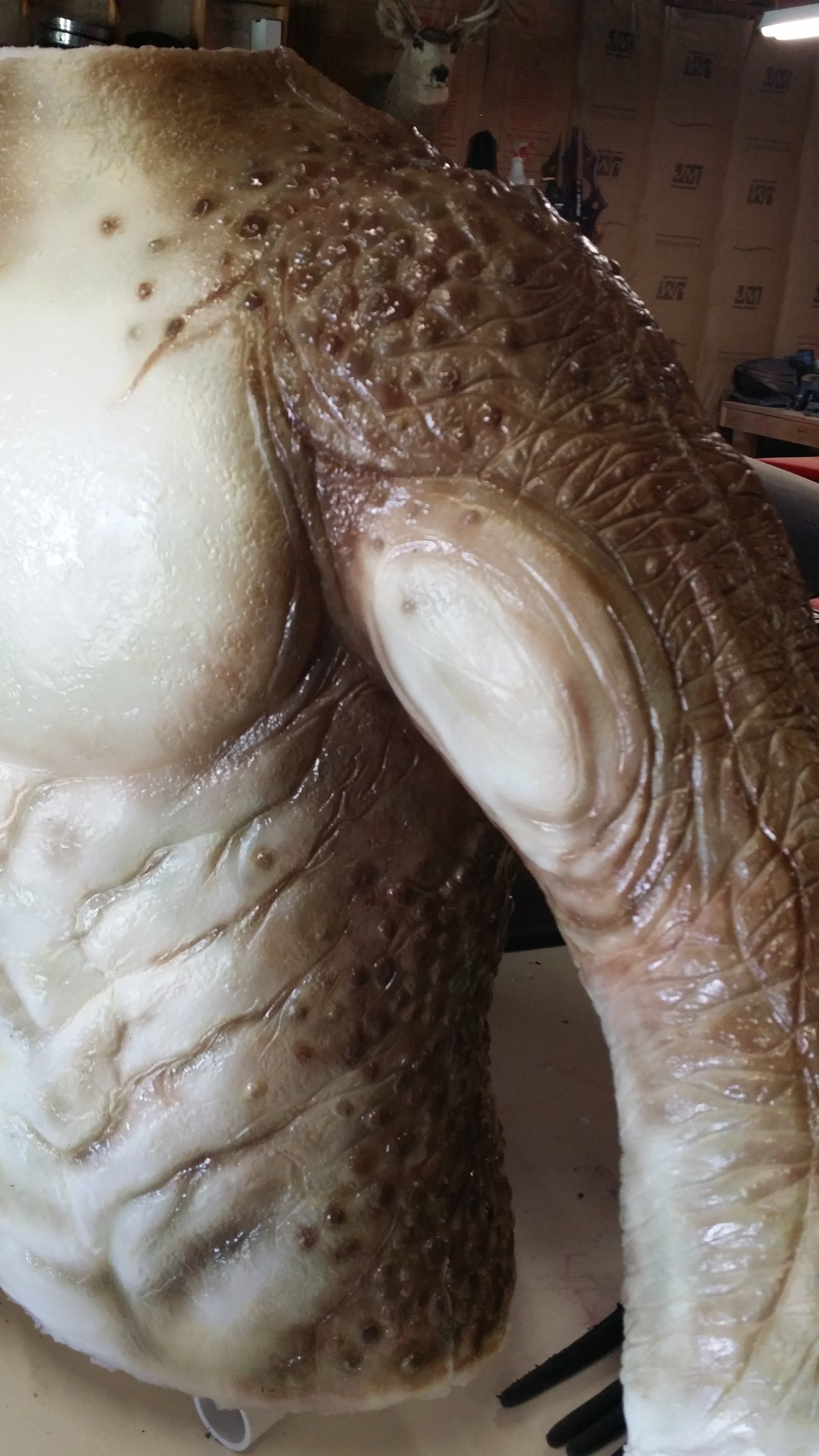

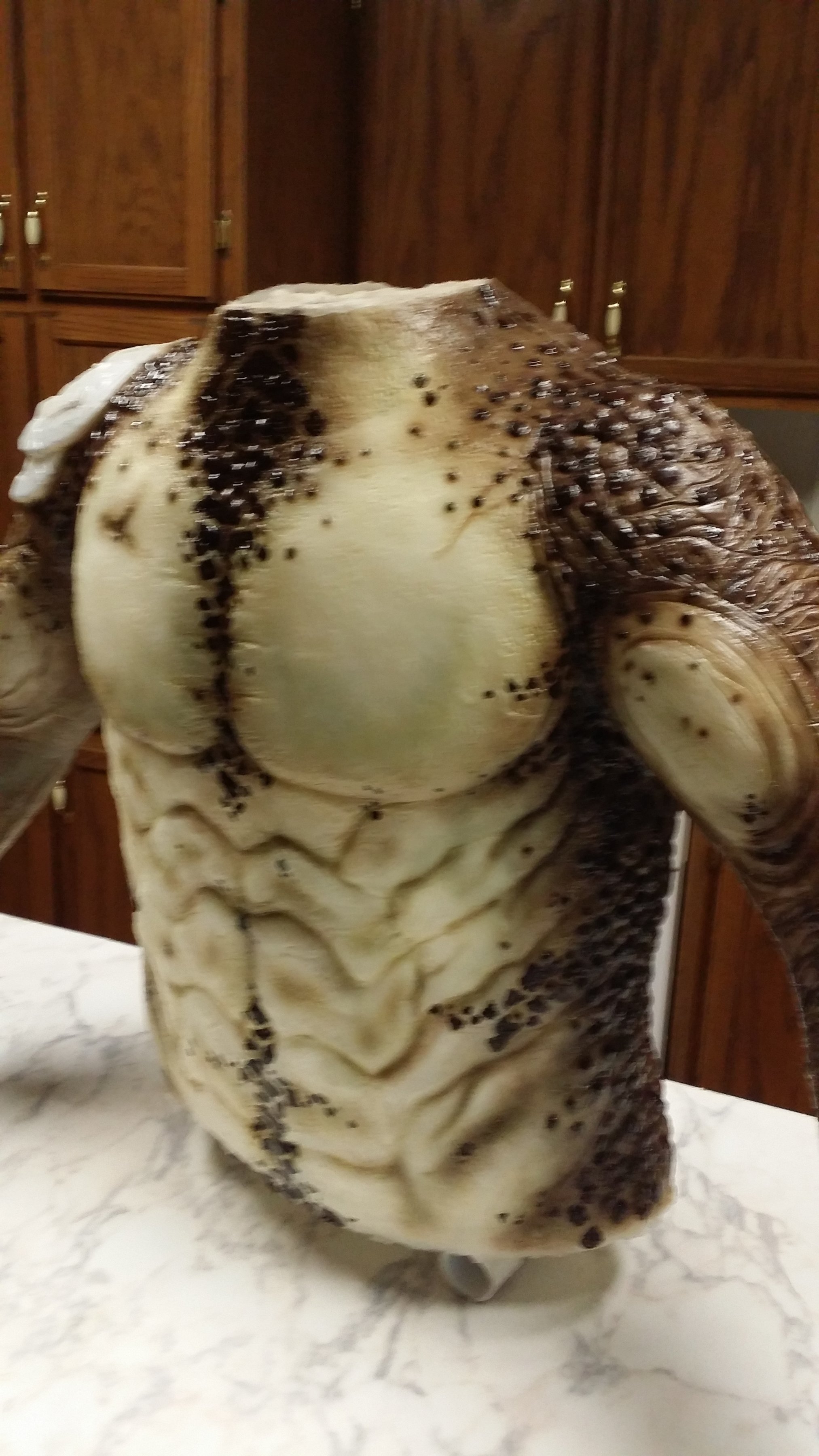

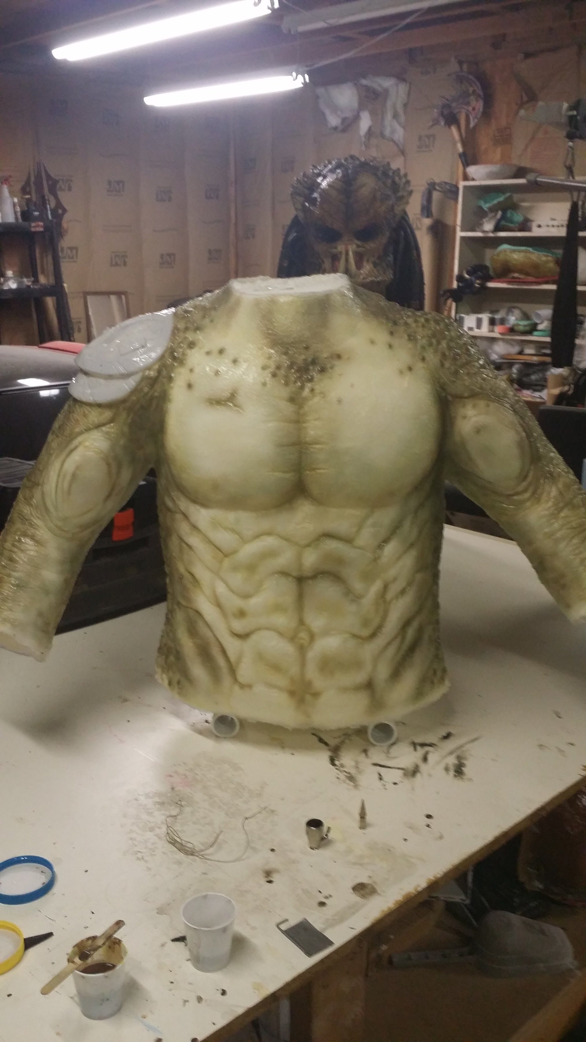

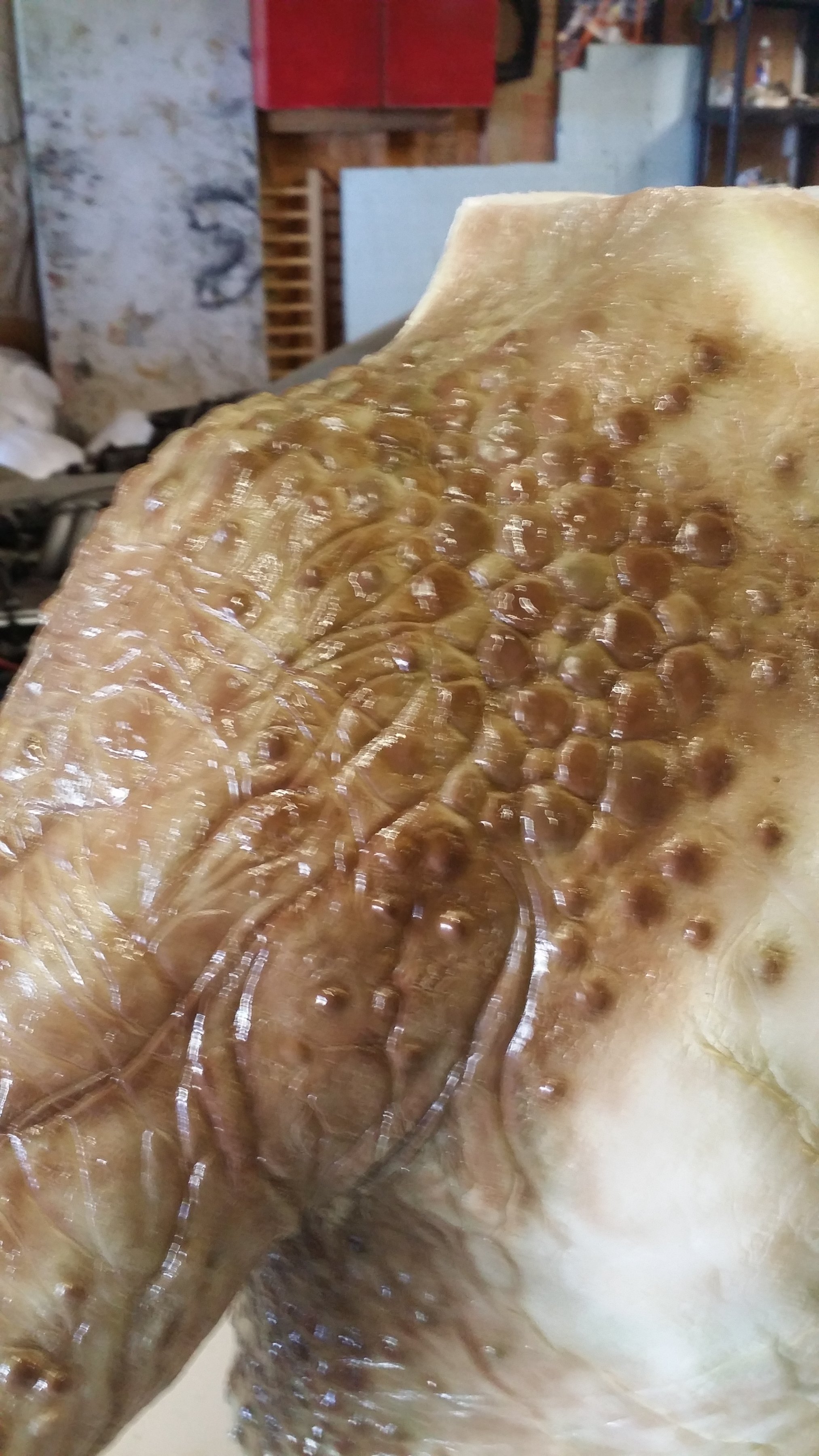

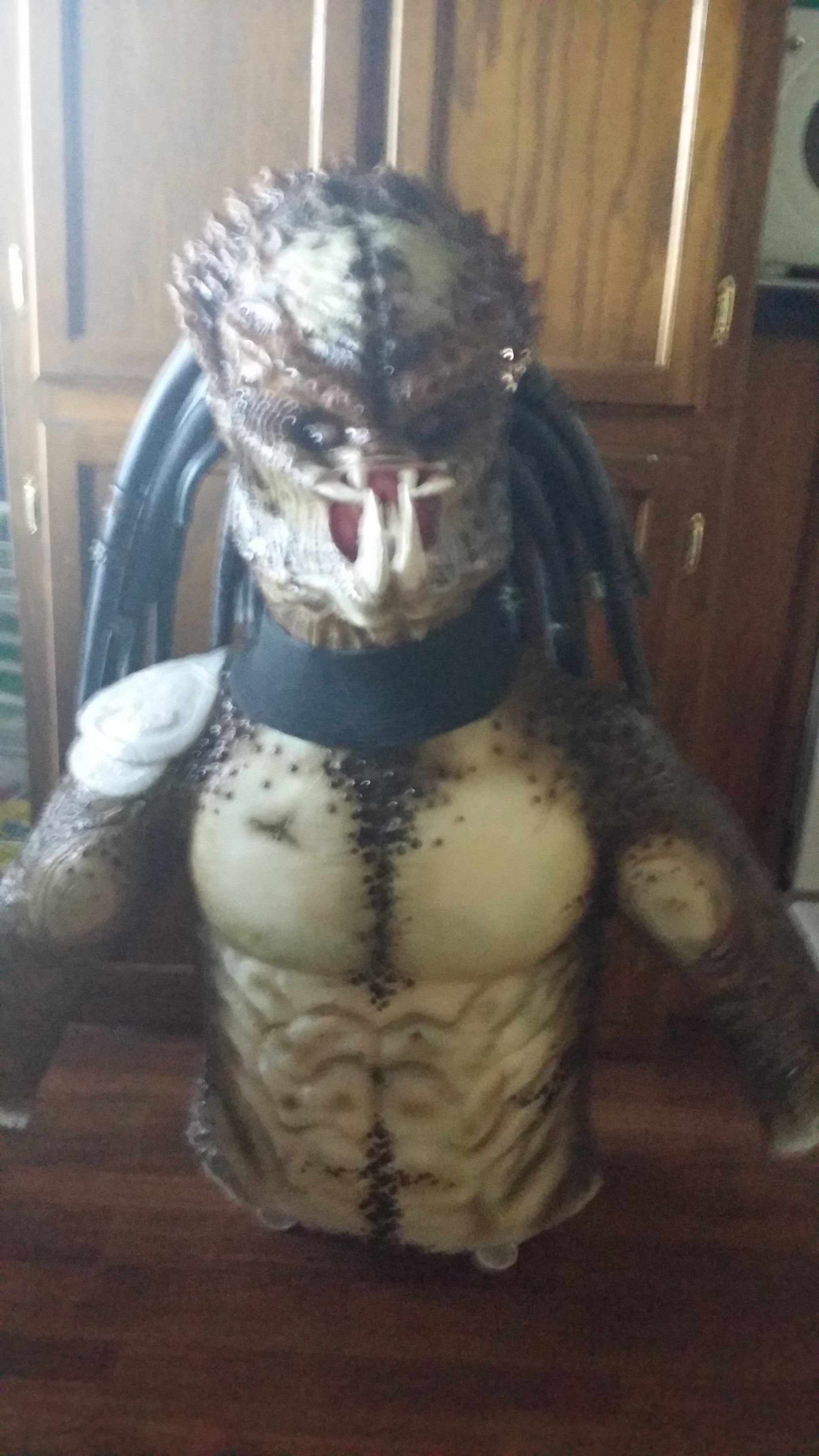

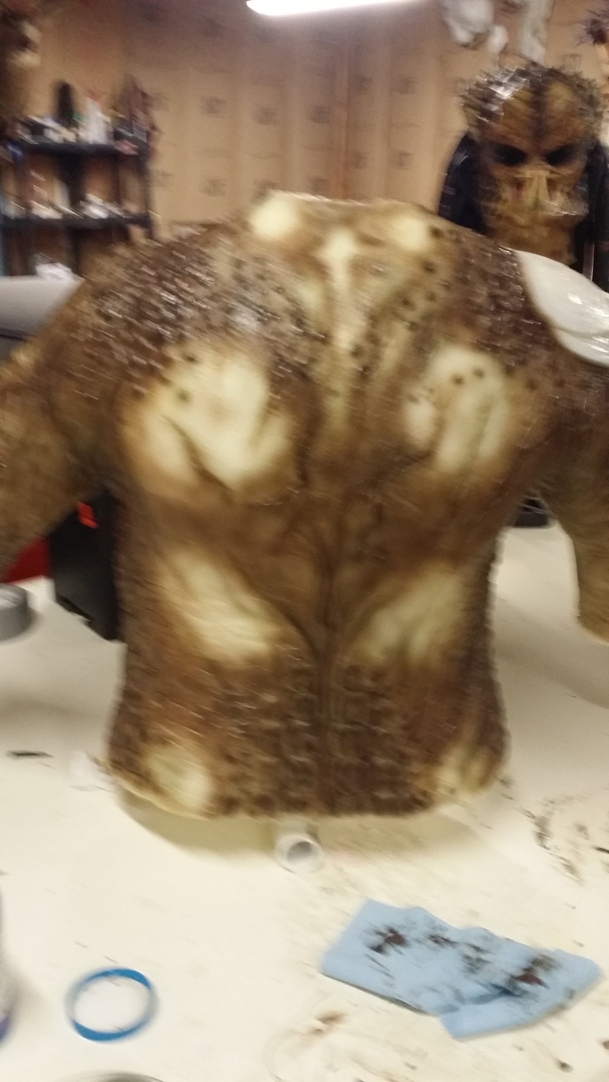

20140818_191218.jpg 20140818_220544.jpg 20140821_221537.jpg 20140821_221559.jpg Ok jeff here is some pics of the paint on the body there is actually a base coat on it that is an off wite with a bit of yellow and green in it. I only sprayed 2 layeres to do it and then i went with a deeper yeoolw and green to start the highlights and i painted the sholder belll a solid grey to make sure it wouldnt delaminate if i didnt get back to it.20140822_223110.jpg sorry for pics juming around still getting used to the site20140823_123302.jpg
20140823_123352.jpg 20140823_231835.jpg 20140823_123302.jpg 20140823_123332.jpg 20140823_231835.jpg 20140825_081833.jpg 20140823_231848.jpg 20140827_200210.jpg 20140825_213355.jpg here is a few more. the top picture was to see the transition from the layers of colors each color took about 3-5 layers of tint the more you spray the more you deeper the color goes but you have to remember once you have laid a color dowm don't over spray. it will just start to run and there is not really a good clean up option. this is not a slap on paint job it takes patience. but once it's tacky you can go back over it in the same spot just don't overload it. these tips are for you jeff.

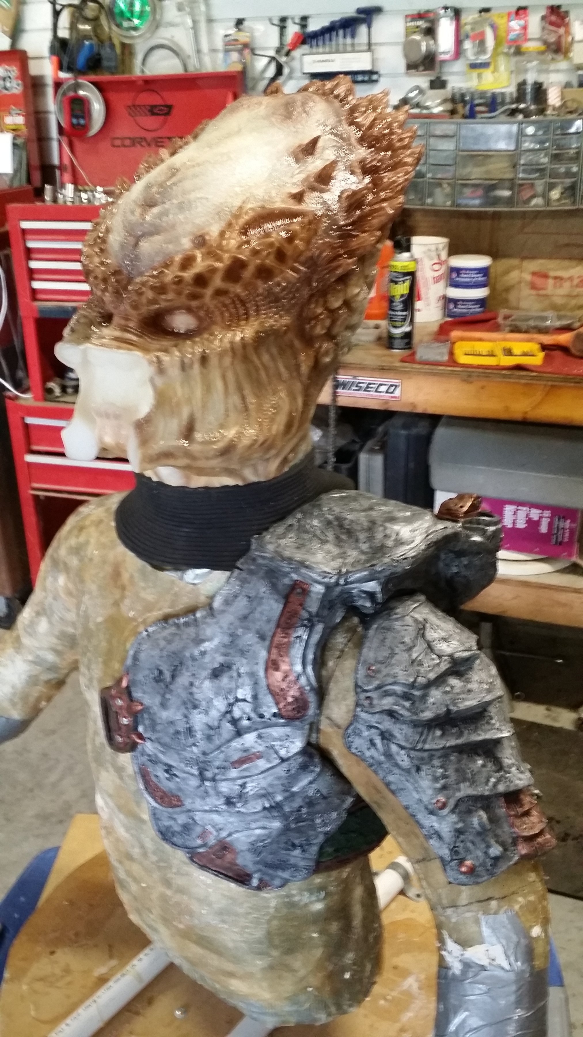

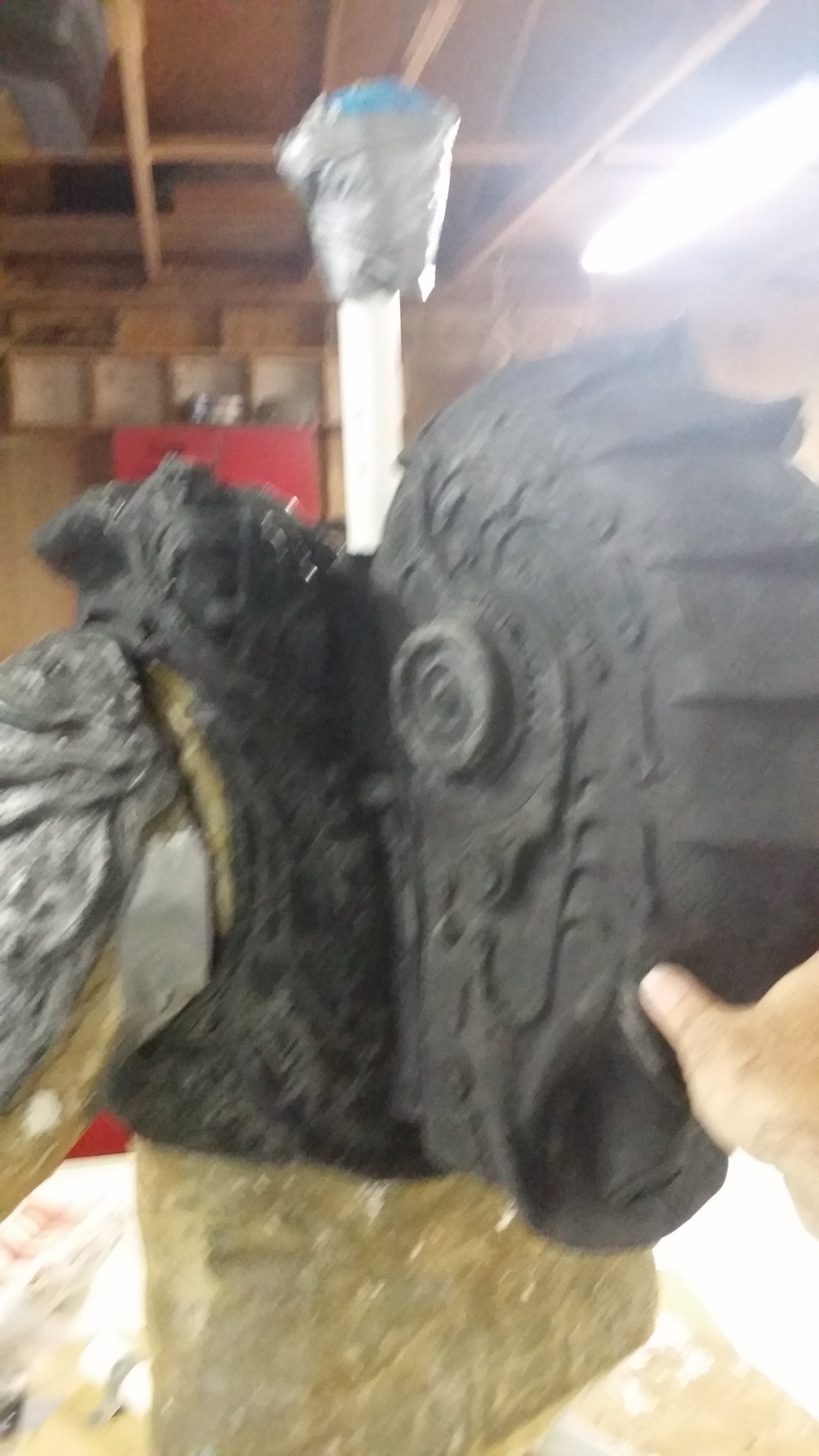

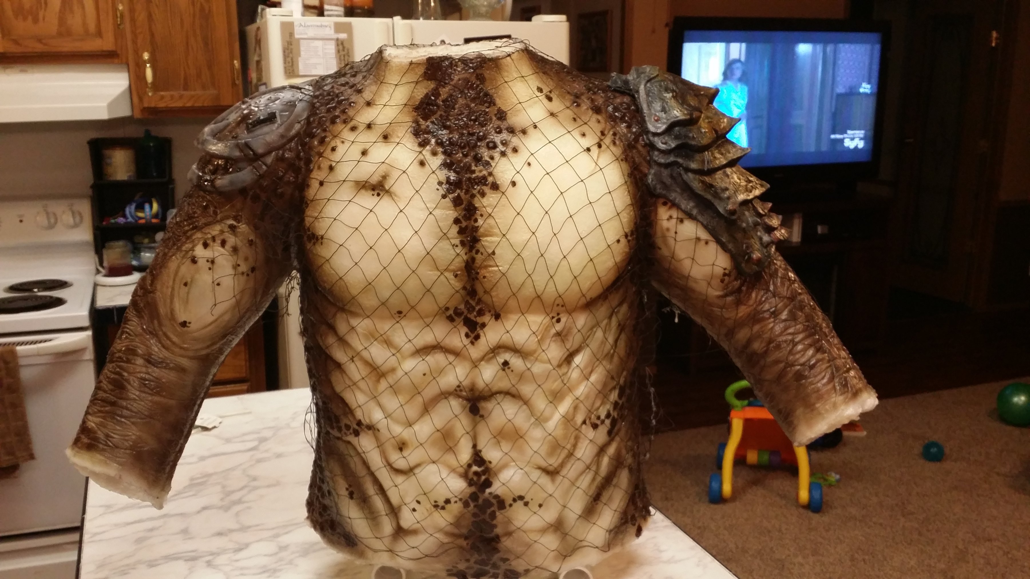

Now the next part of the project was the armor i used Simpact 85 it is a rubber compound that you can tint in the casting process that will be posted next.
