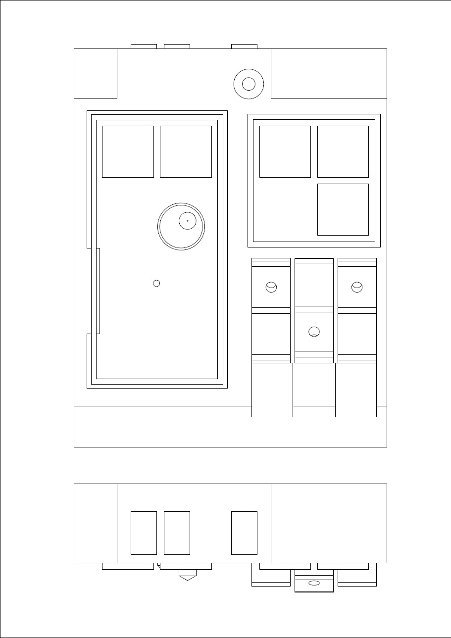

I made a CAD model of the Chestbox and printed out a template to get the right dimensions.

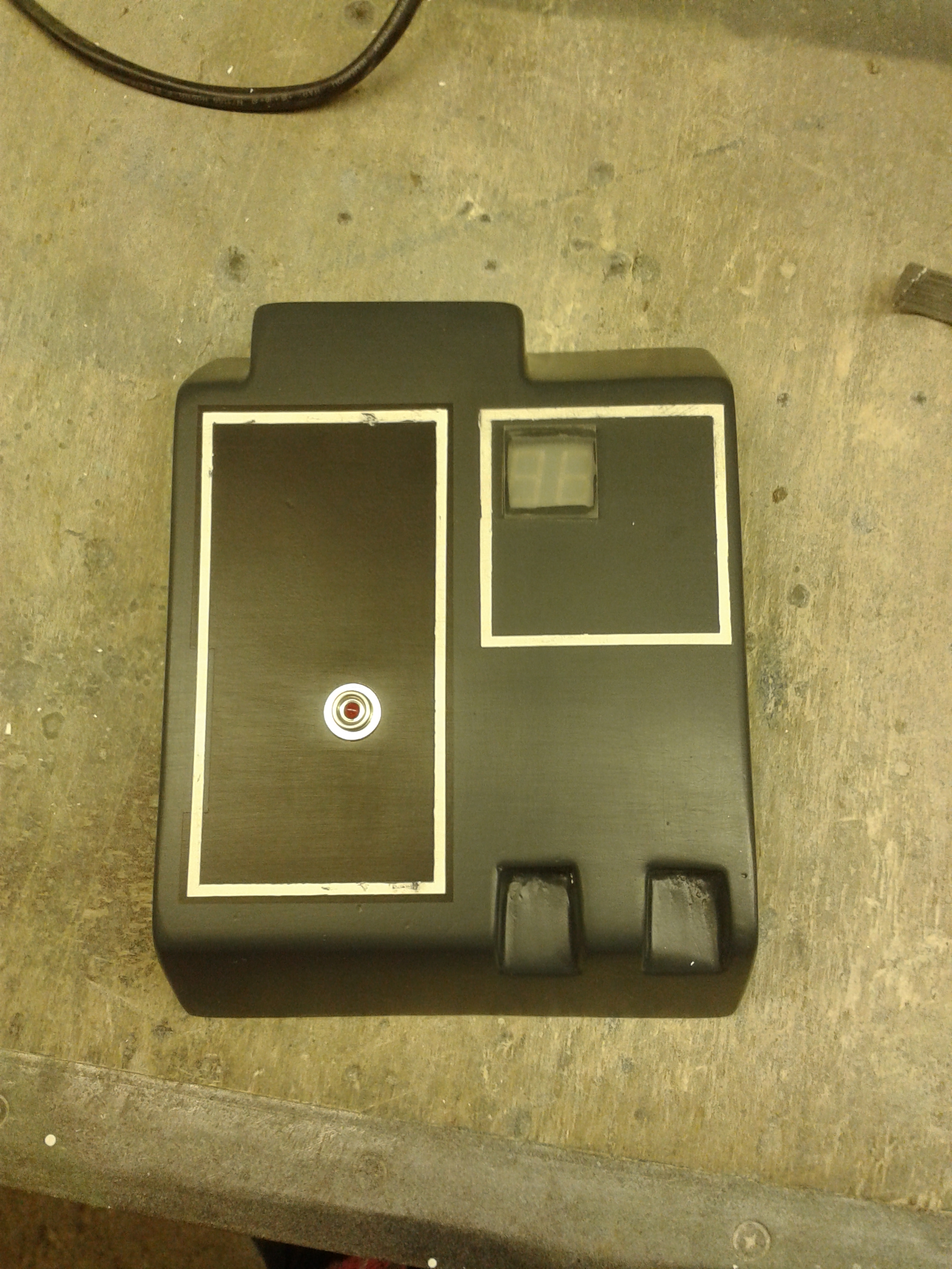

I covered the whole box with fiberglass, applied bondo an sanded it smooth. Then i primed it with a coat of white gloss paint.
In the next steps i painted the box gray and masked of the surface which would become black.
I drilled a hole and attached a decal knob with an M3 Screw, which will later be replaced with a LED.
I masked of the frames around the black surface and attached a little screen I took from an old darts game.

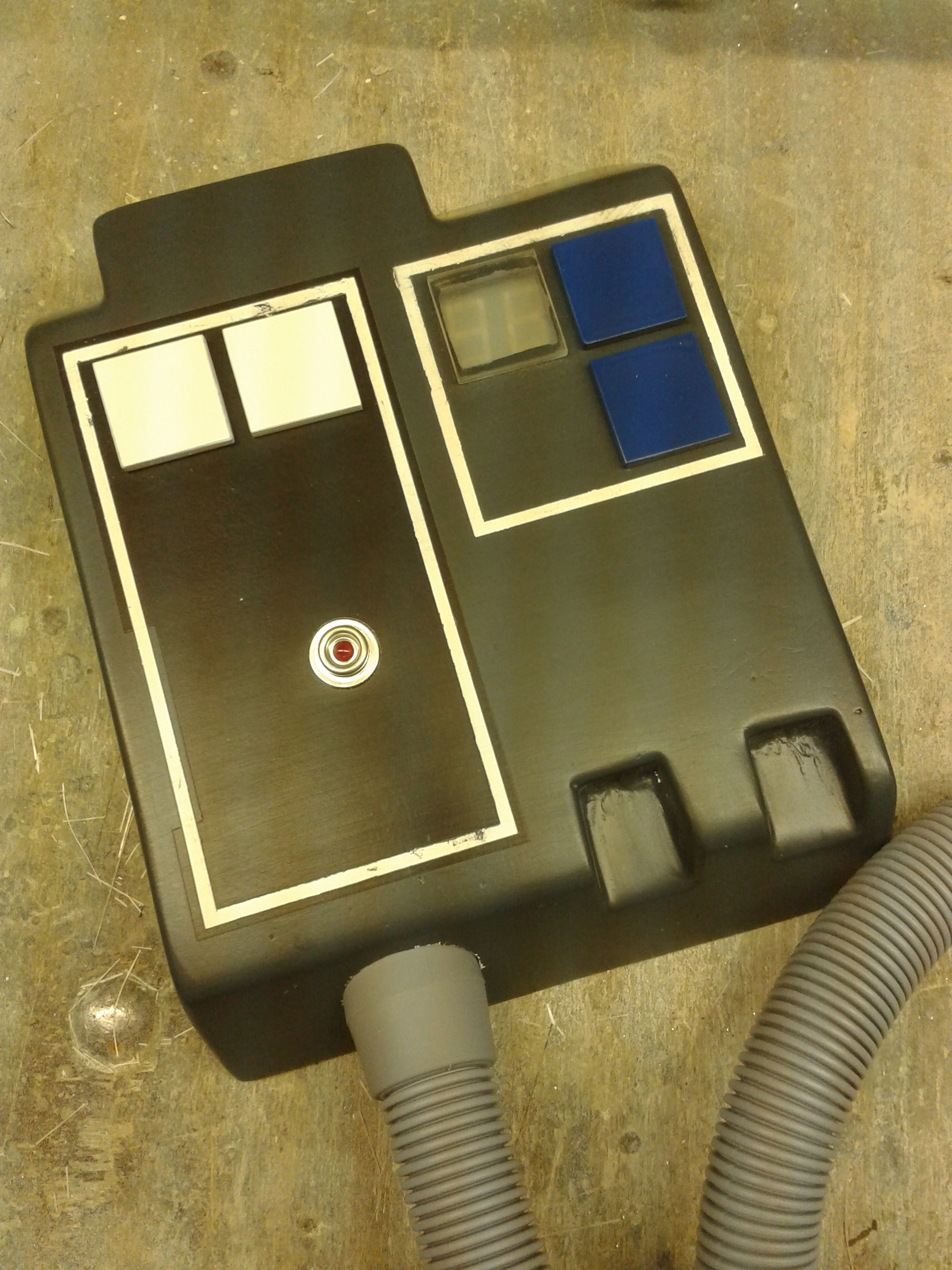

I painted the white frames and covered the screen with a 3mm thick piece of Plexiglass.
I added a few more Plexiglass squares, which I painted fitting to Wedge's. I also added a one inch hose to the chestbox.

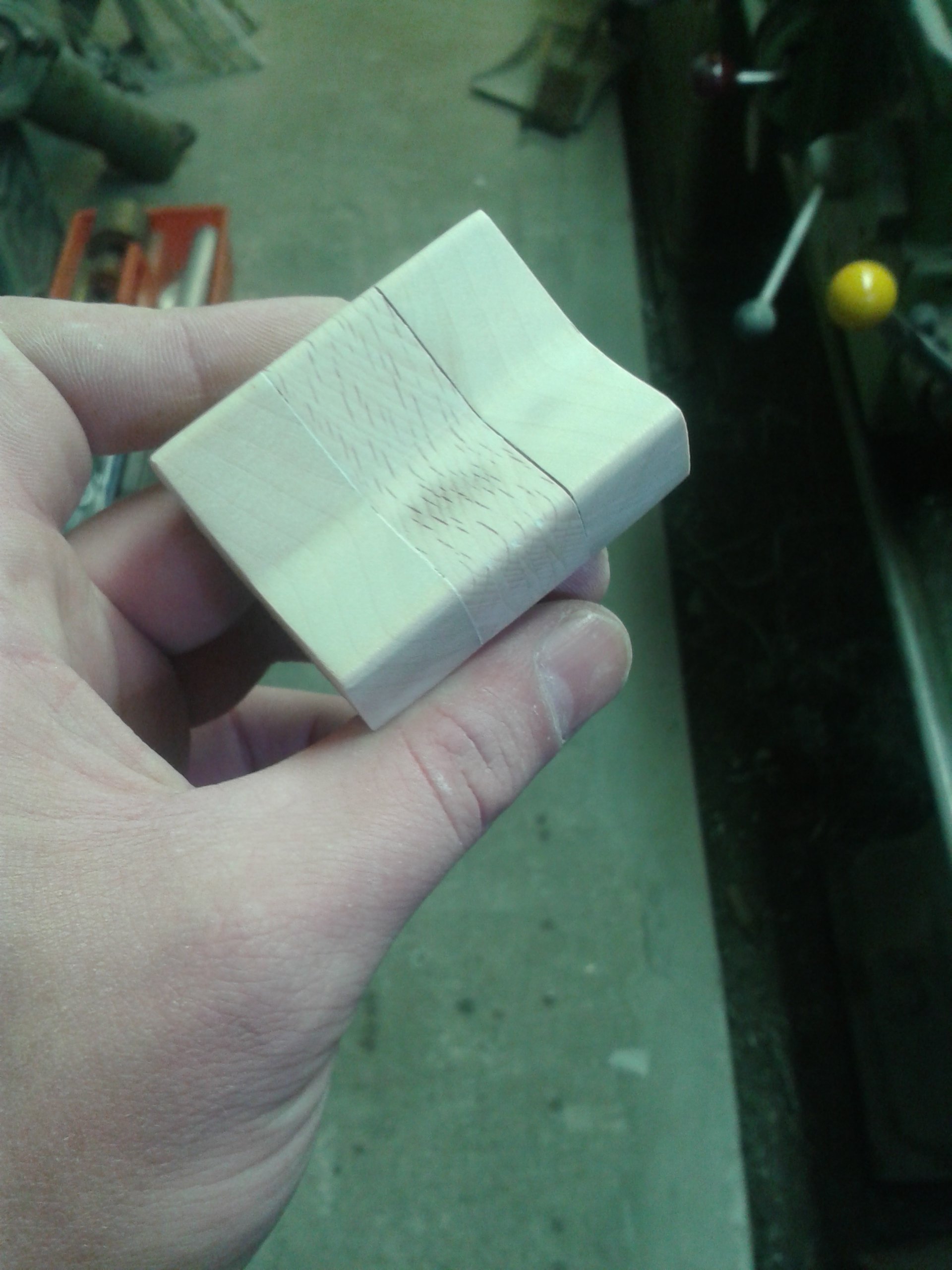

The next step was to build the three switches. I took three pieces of wood, clamped them together and sanded them to the right shape.
I painted them and gued them to the Chestbox. Then i drilled holes in the switches and attached LEDs.

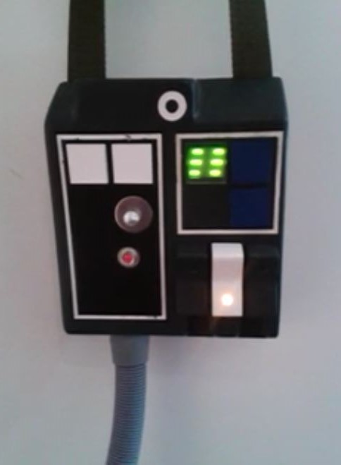

So there is the completed Chestbox.

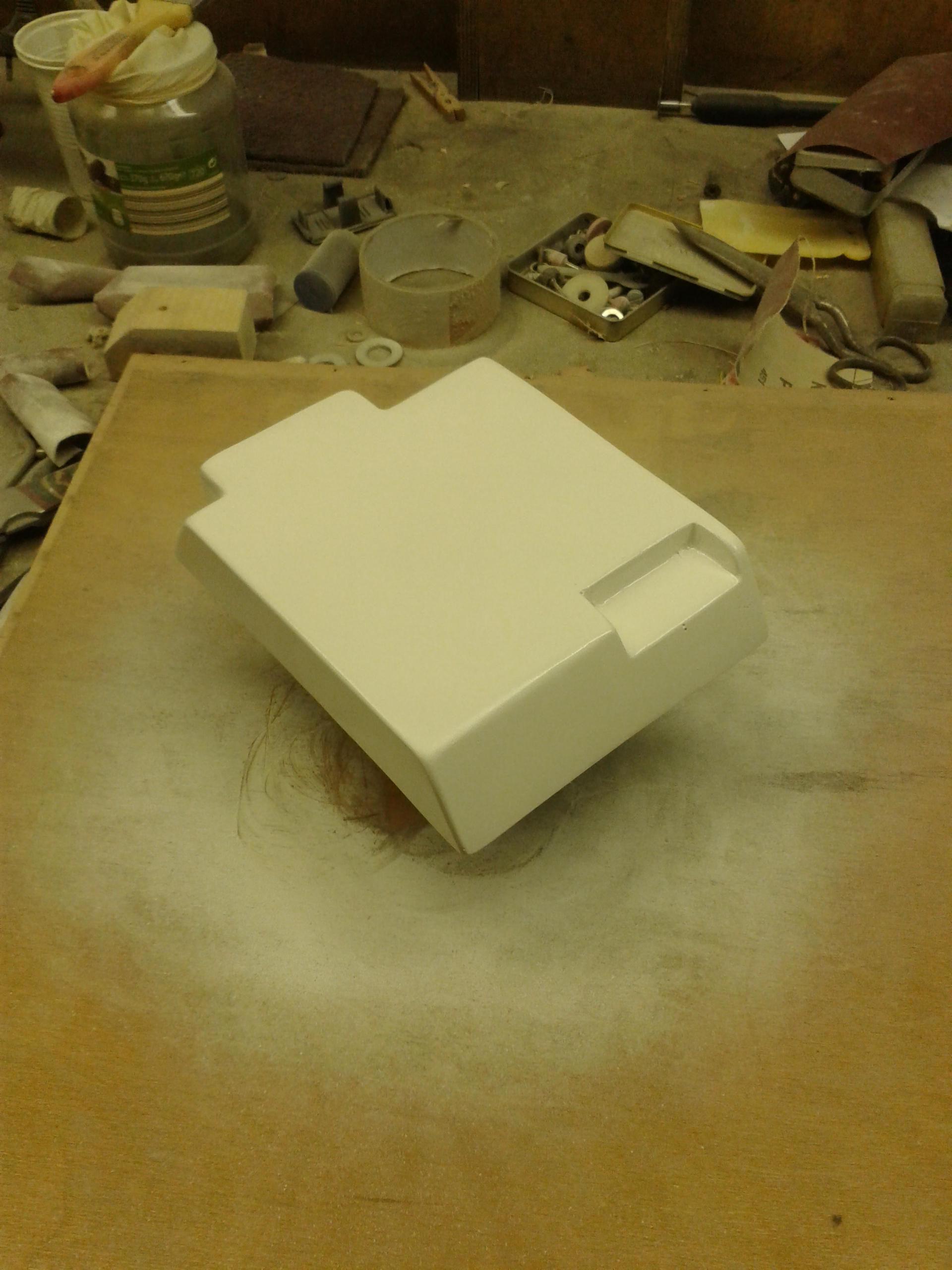

I built the raw shape of the Chestbox with 3mm thick Styrene plates I glued together with hotglue.

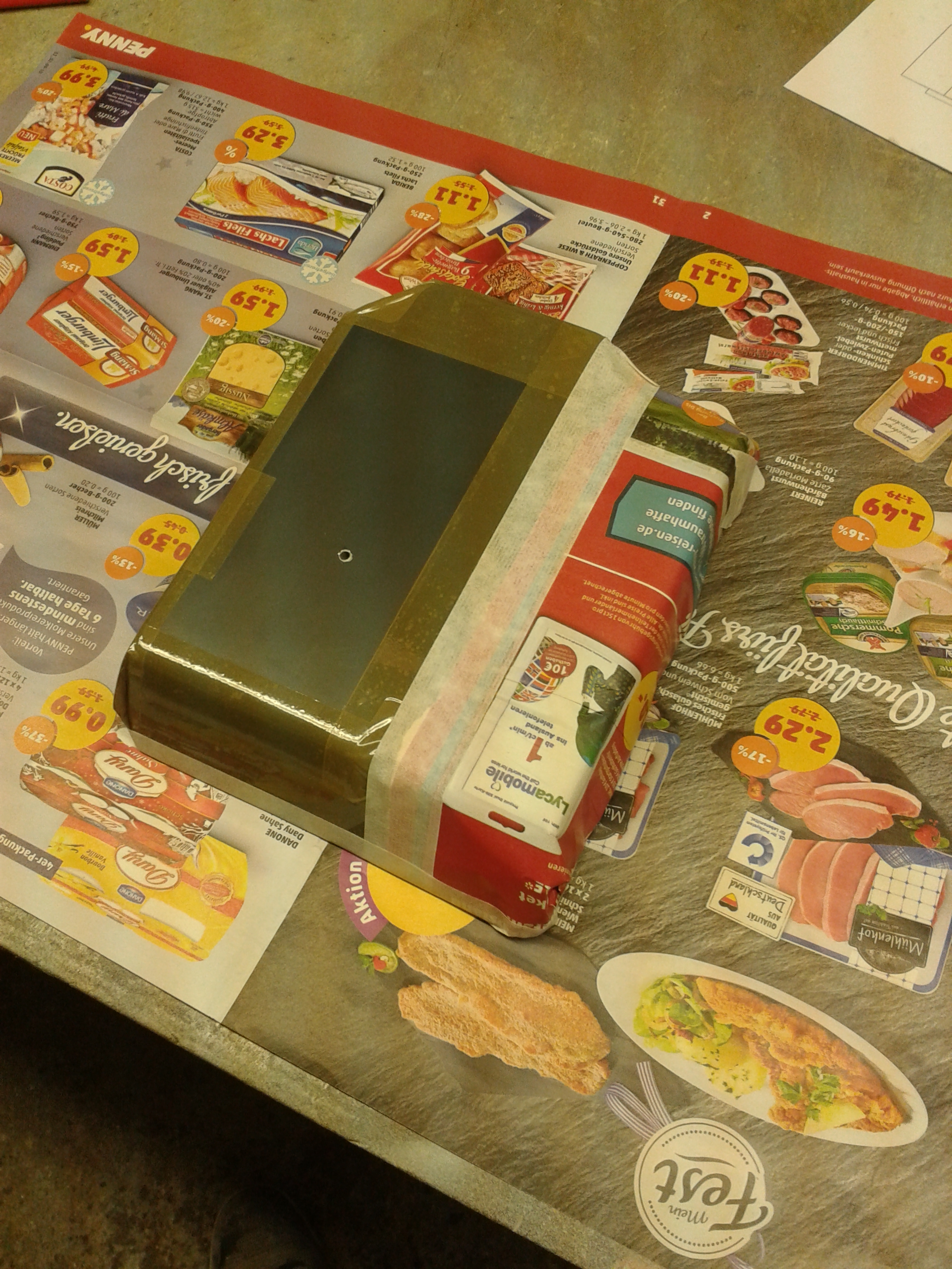

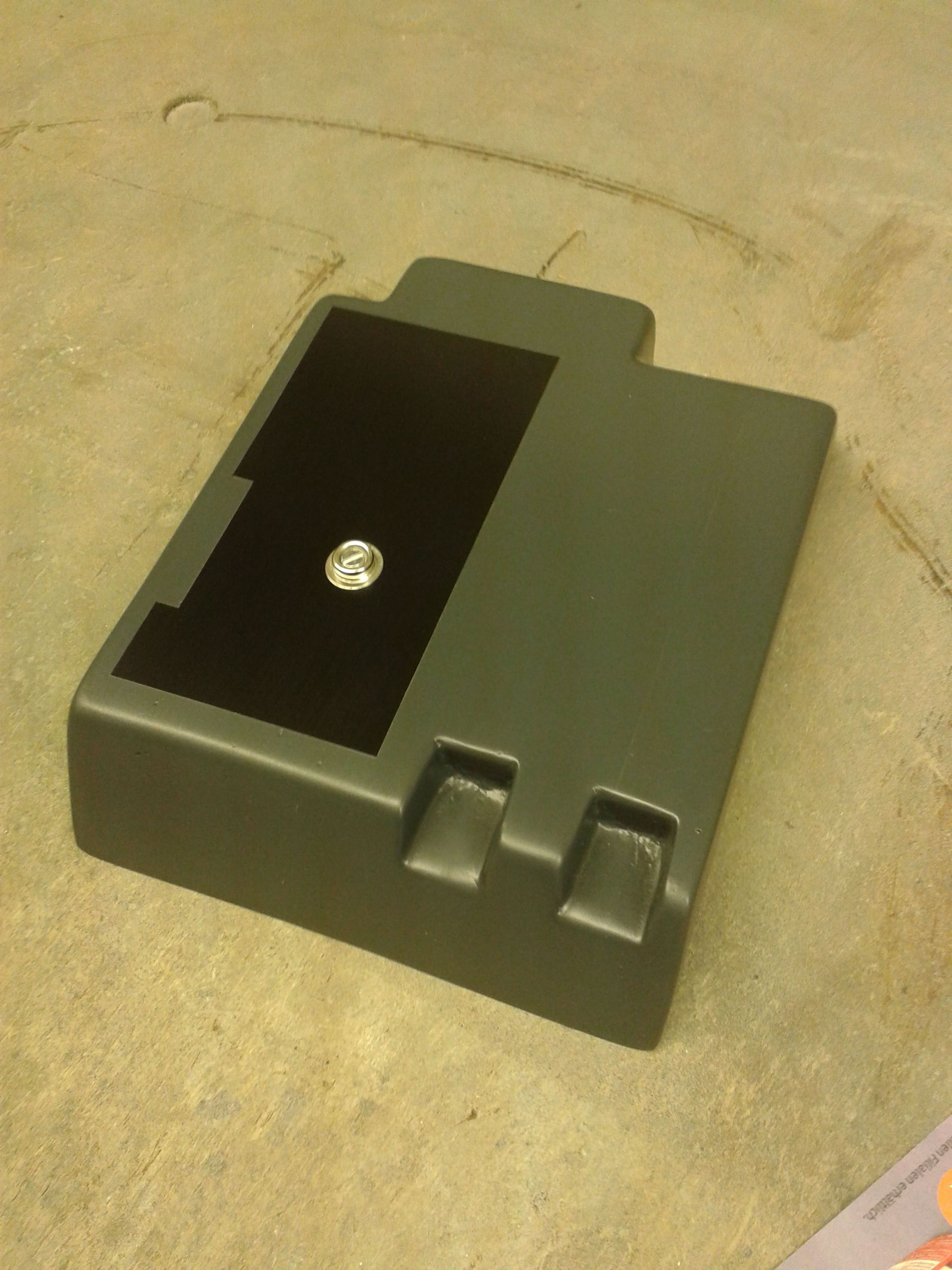

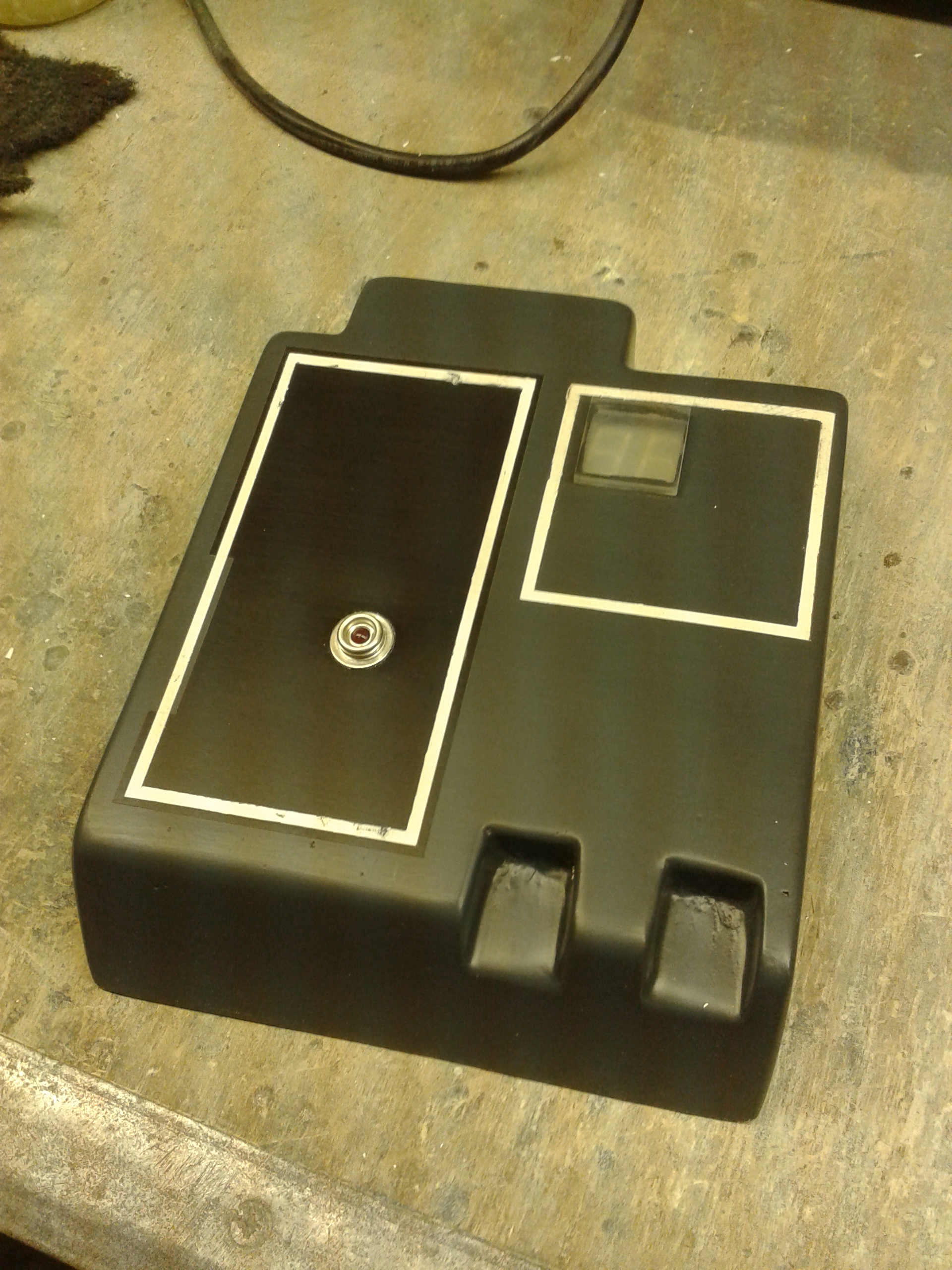

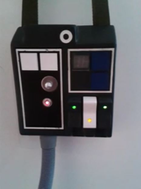

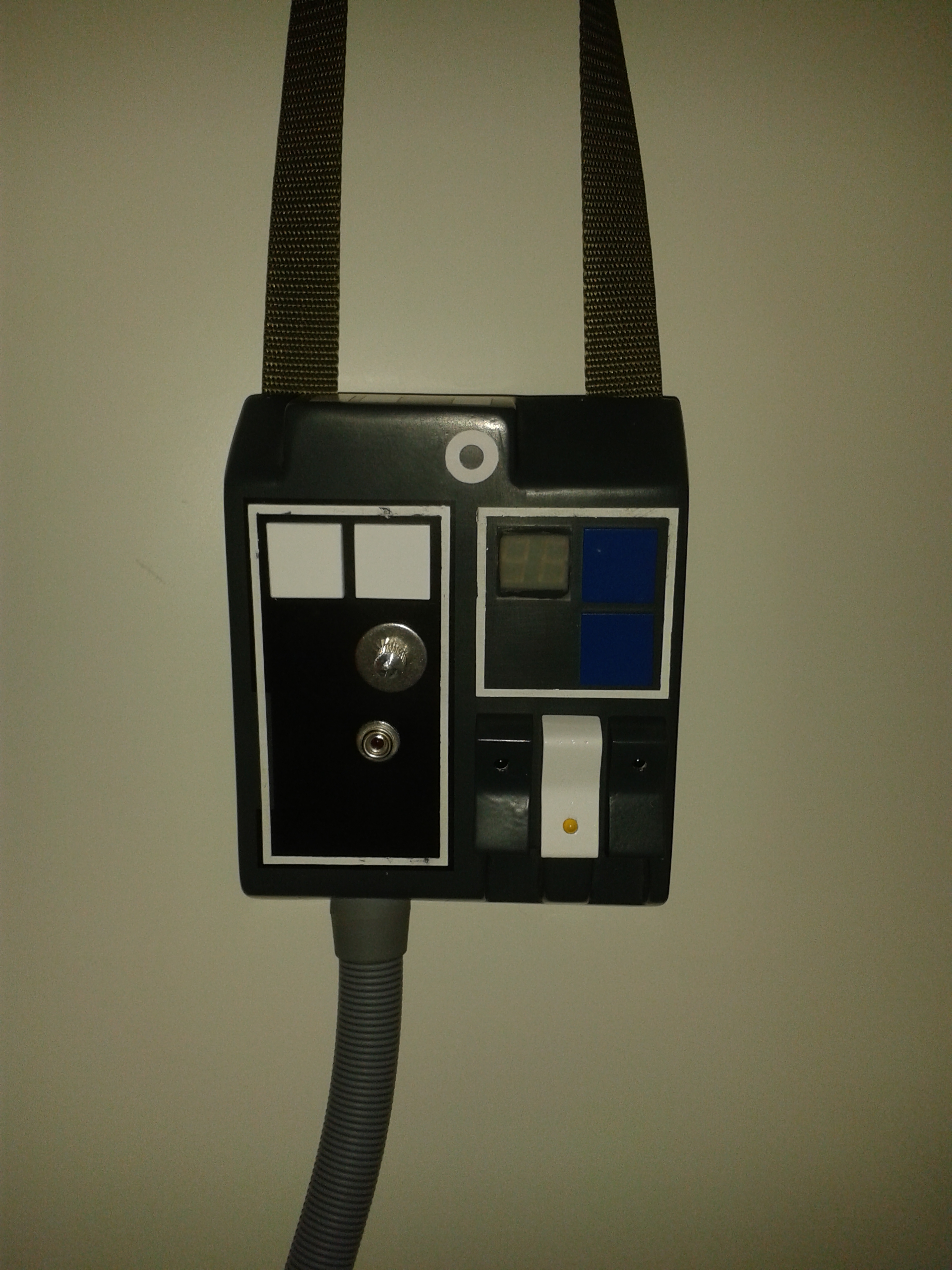

The final step was the to wire the electronics and to attach the one inch dark green straps.
I also attached a decal washer and another knob.
