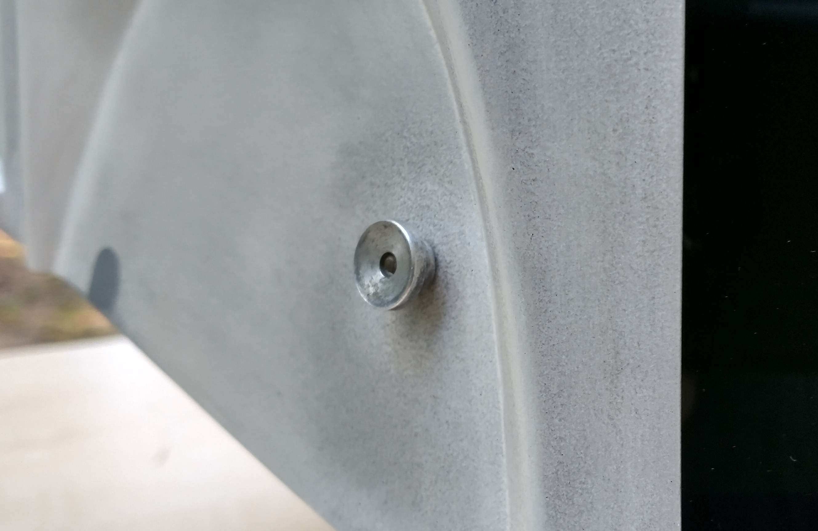

Cut out the original visor and made a new one of of a welder's shield. I glued some shortened T-nuts inside the helmet and bolted the visor in with some screws with hard rubber washers. A small steel bracket holds the helmet together at the bottom and keeps the helmet "flared" properly.

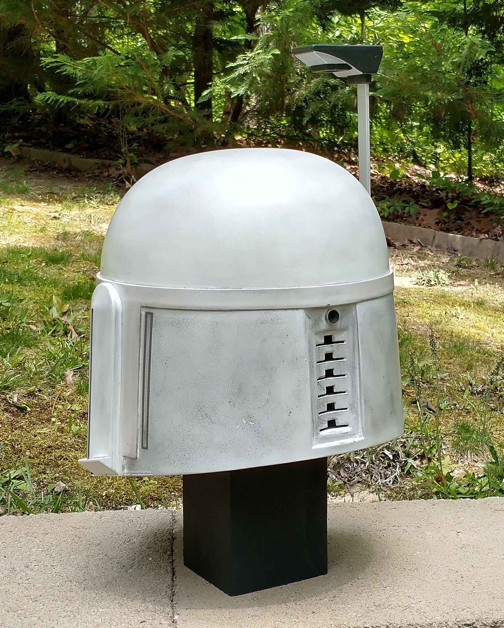

Cut out the keyslots in the back and cleaned them up with some mini-files.

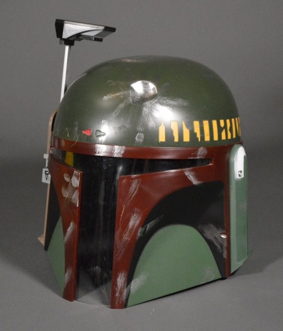

I started the painting process last year, trying to recreate the paint damage seen on the ESB and ROTJ helmets. The rear panels of the helmet looked pretty good, but I wasn't happy with how it was looking everywhere else.
So...I took a break for a few months. I eventually got back to it, doing some more paintwork and suddenly said "Wow, this looks terrible."

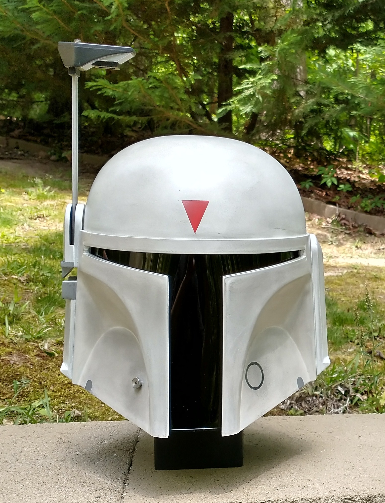

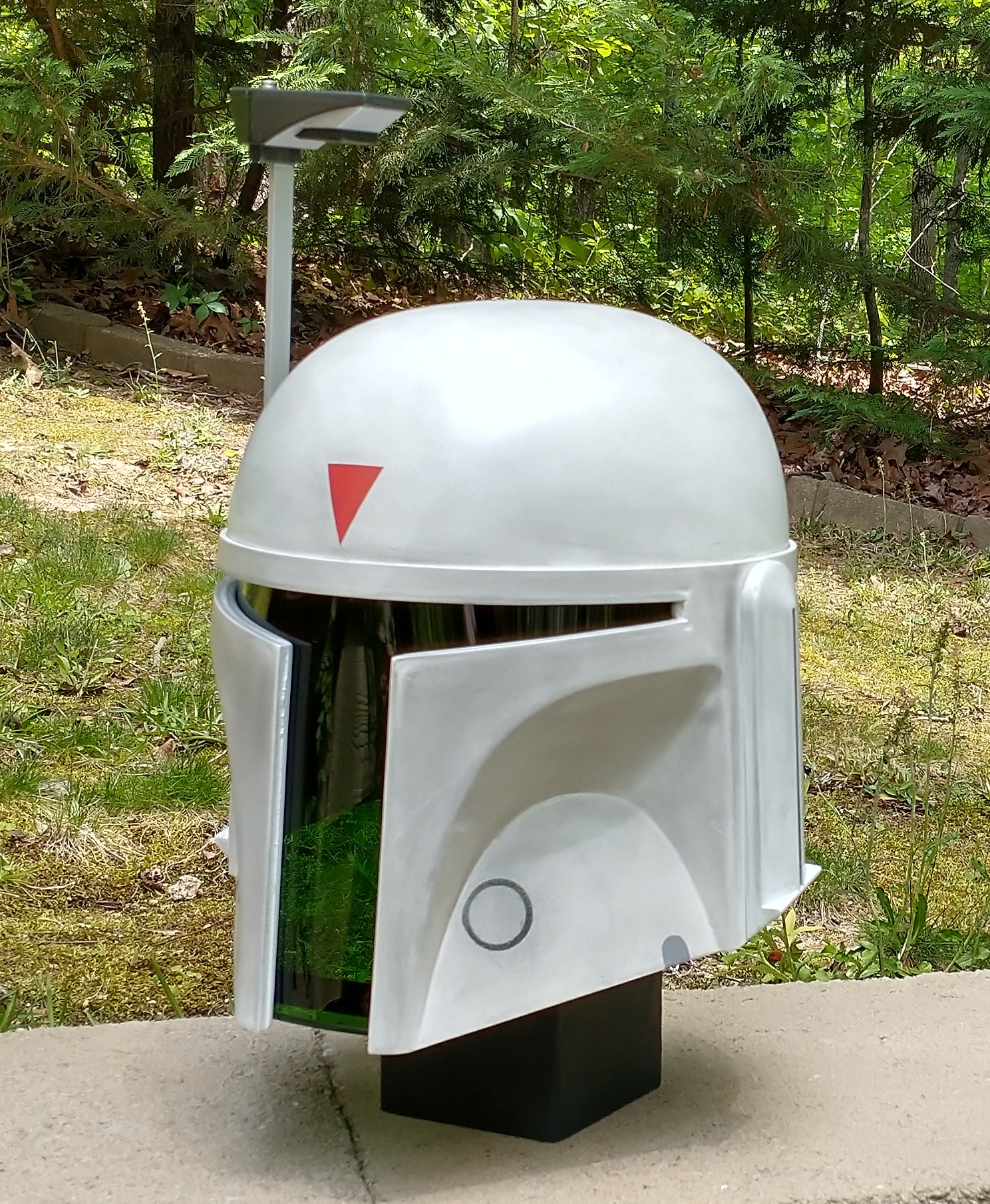

I stripped it back to bare plastic and decided to make a Prototype/Supertrooper helmet. "Keep it simple, Scott," I thought to myself.
Once I got it all painted up, it then looked too darn clean.
I then decided to add some McQuarrie graphics and dirty it up with some graphite. After some trial/error and one partial repaint, I was happy with the results.
It's a little grubbier in person. The top always looks washed out, no matter what lighting I try.

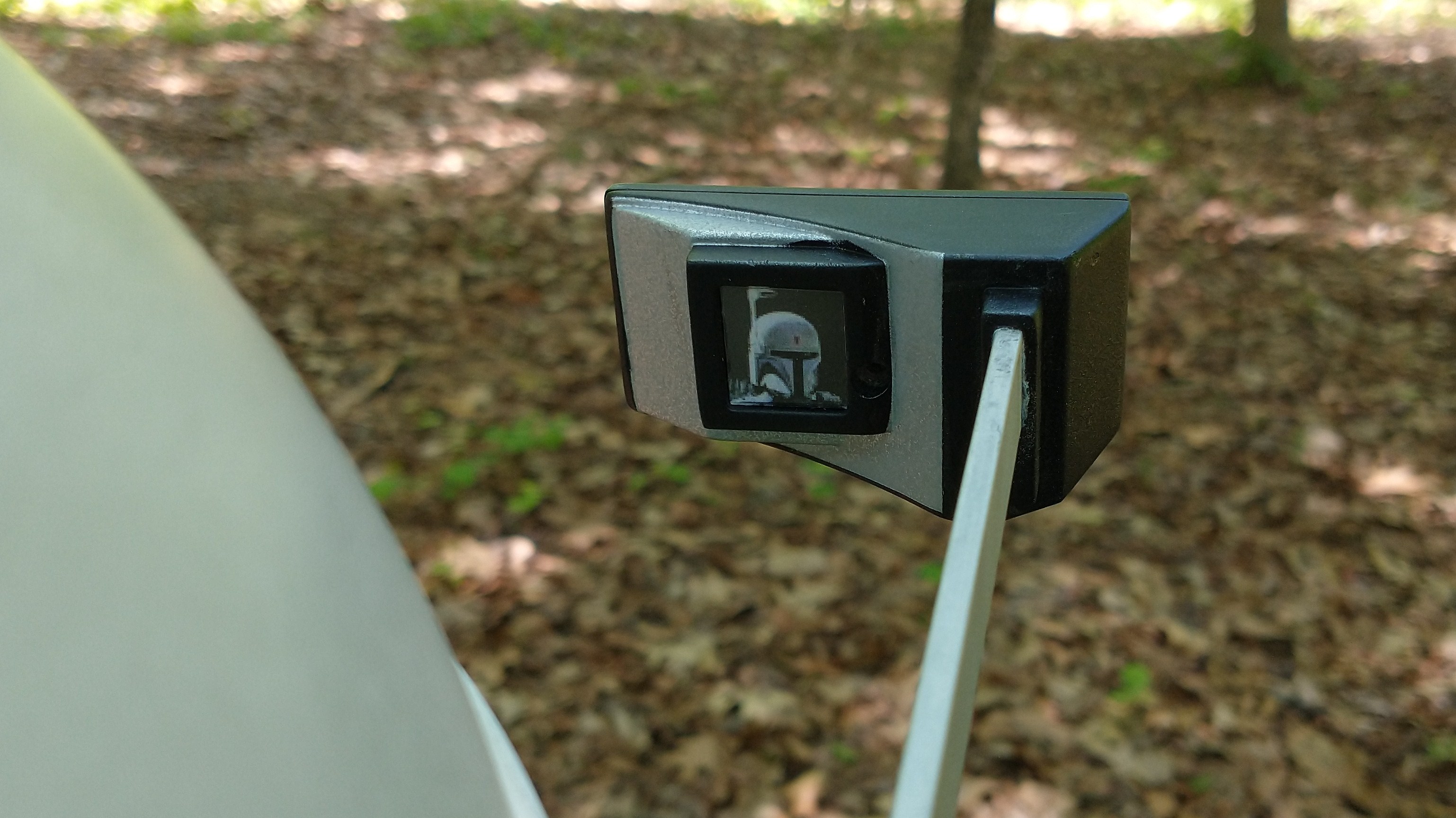

I remember one of the original helmets had an Easter Egg on the rangefinder screen, (A movie frame from a western film, I think?) so I did the same.
