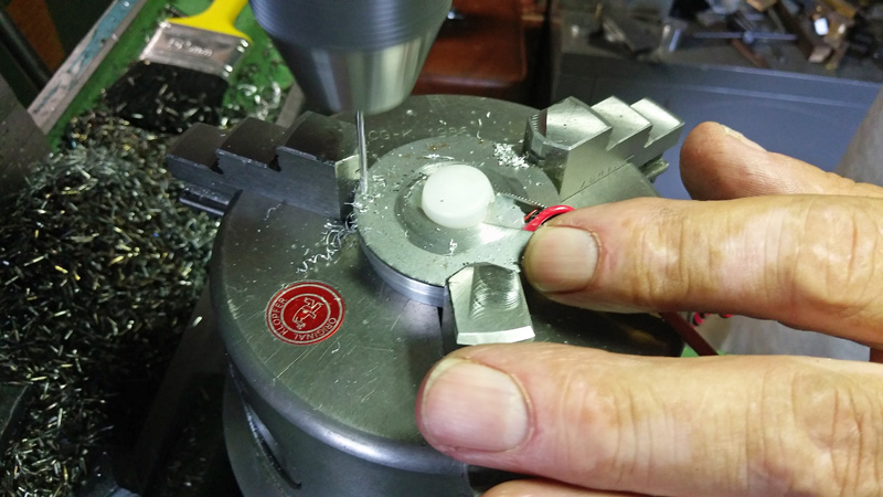

Drilling and tapping M2 holes x 3, 120 degrees indexed. The backplate will sandwich the gauntlet material to secure the repulsor in the centre of the palm.

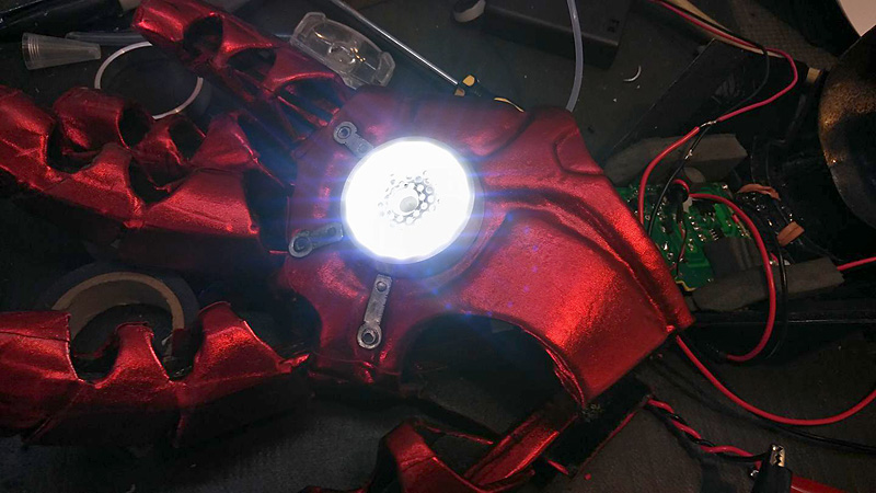

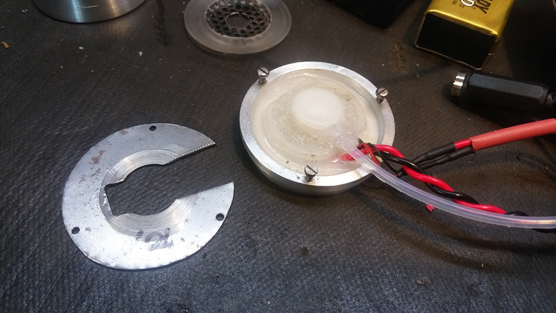

Repulsor fitted to gauntlet and working, although I'll have to find a way to slow down the water supply a tad.
I got a vacuum lock so I put a breather hole in the reservior bottle. Now the flow-rate is too fast for the ultrasonic plate and it floods.
A friend has suggested I use a micro-mesh or similar over the breather hole to find the Goldilocks zone. I'm hoping to stop the water unless it is demanded by negative pressure behind the USP.
