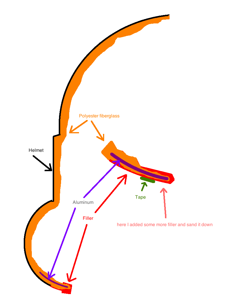

And yes, I mean the rubber lining around the opening. You gave your helmet a nice round curve in the opening. I was wondering if you could briefly explain the steps you took. Where do you get this rubber lining and how do you put it around the edge?

well, I didnt use any rubber on my helmet. I found some of these rubber material, but didnt used it. the reason is the following. I had to add some material at the opening, because the hole was too large, so you could see too much of my head while wearing it. so I completely laid out the interior with a layer of fiberglass and put in some extra aluminum net into the neck area for more stability. for that reason the neckring is around 5mm thick there. so my rubber lining was not fitting anymore. so, after filling and sanding these part of the helmet, I just put some thick tape around the opening, but circa 5-6mm away from the opening. than I added some new filler there and before it hardened out completely, I put the tape away. than I gust had to sand down these polyester lining a pit, fill some holes in it, sand again and my lining was finished. no rubber, but with some black mat paint on it, its looking pretty well.
here is a small cut section of my helmet.
sorry I have no photos of how I made it, but I forget to make step by step photos at that time.
best regards, hinrich
Wow thank you so much for the cross section! The mat finish is looking like rubber (like the efx storm trooper helmets). Good stuff! Thank you so much for all your advice. I'll post pictures as soon as I start work :)

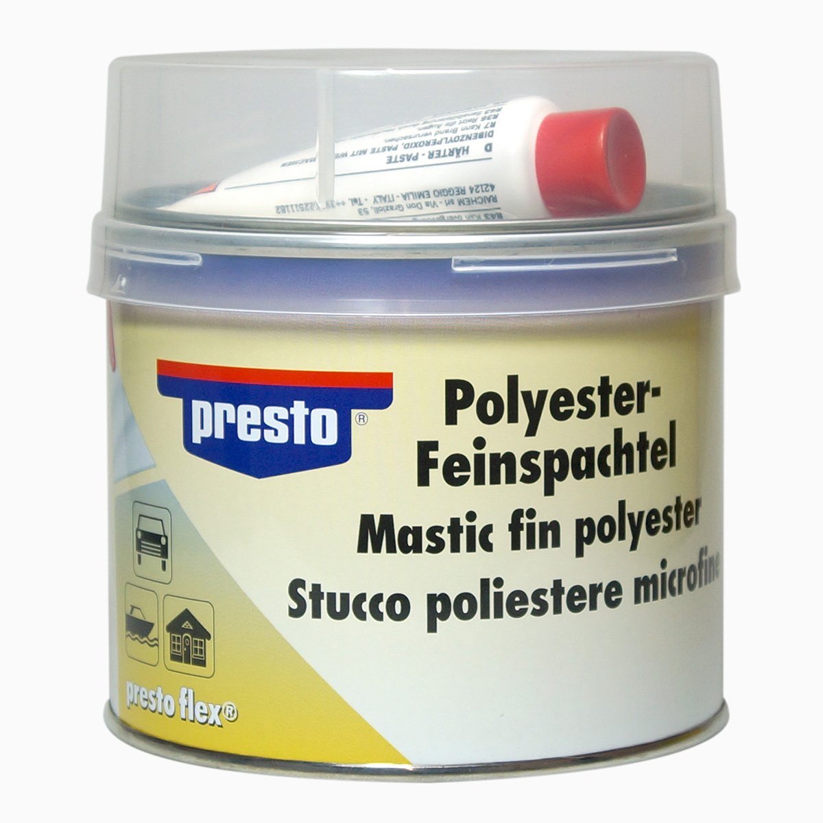

This is amazing! I have a rubies helmet and I'd love to modify it given the chance. But I have a question though: What filler did you use for the outside of the helmet? I know for the inside, you used a Fibreglass polyester resin, but what about the outside? Thanks for any info in advance!
hello mjohnsimon,
for the outside I used a polyester based filler, just the same I resculpted the helmets entrance with. this is the stuff I used:
I m sure its not the best filler you can get.
But I used a special primer for PVC first, out of a rattlecan. and around the slit between the 2 half pieces I have cut some x shaped slits into the PCV with a dremel so the filler would have some more grip. you can slightly see the filling process on one of the first pictures. the helmet is gray there, that is the primer. the brighter areas (a little bit pinkish) are the ones with the filler on it.
