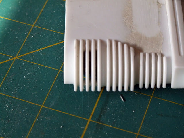

So while I was trying to figure this out, I turned my attention to the housing for the hammer that I will rebuild too. I started by cutting it wider as a safety mechanism also needs to be installed.
Now the real point here...is don't throw away anything. Why, because the curved bits that I cut out, fit exactly to the profile of the littel curved bit I mentioned earlier...eureka!!!
With a little trimming and shaving here and there, the two curved pieces follow nicely and the with the usuall filling and sanding, it will look identical in no time. As you can see, I have also cut away more of the top section to be rebuilt as this will be a lot easier.
