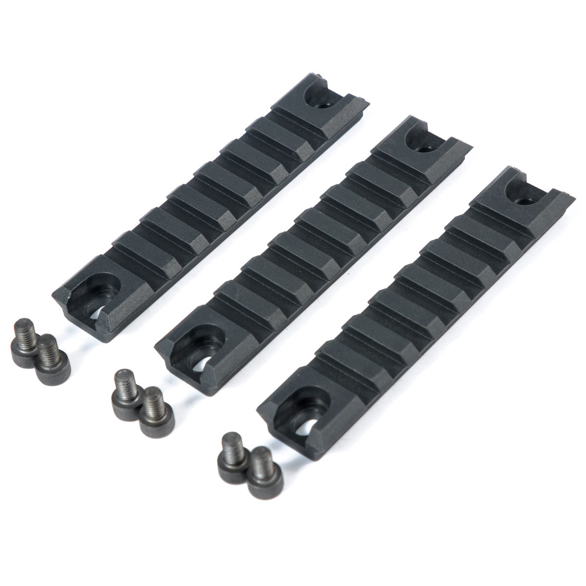

The closest rail I've been able to find is a G36 or G36C handguard rail.
They don't come in a 3-slot version though, so one would have to be cut down:

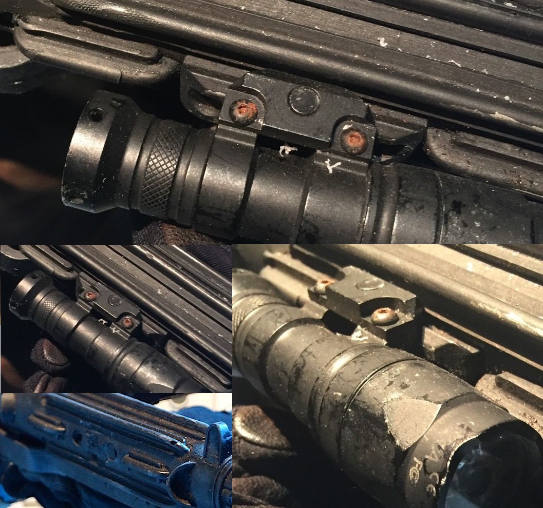

@SlyFox don't forget the weird rail for the flashlight! :)
Ugh a mystery, that one. One day we'll get it ID'd
Yes I'm aware it's not on my list, I have not yet been able to identify that part. Hopefully we will be able to pinpoint it. It could be a short weaver/picatinny rail, possibly for airsoft or paintball, or it could just be some obscure mounting bracket for something that the flashlight clamp fits onto, possibly modified.

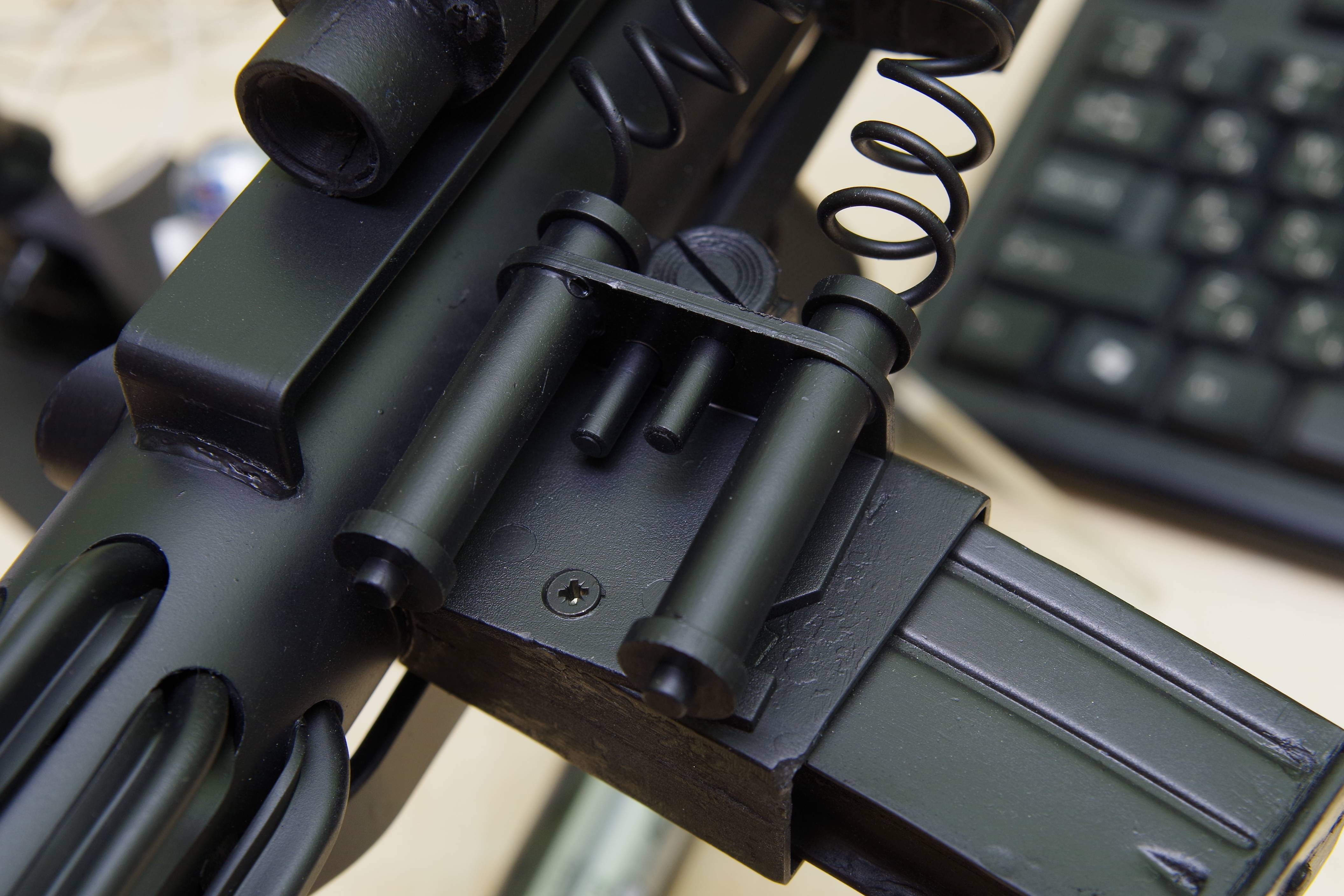

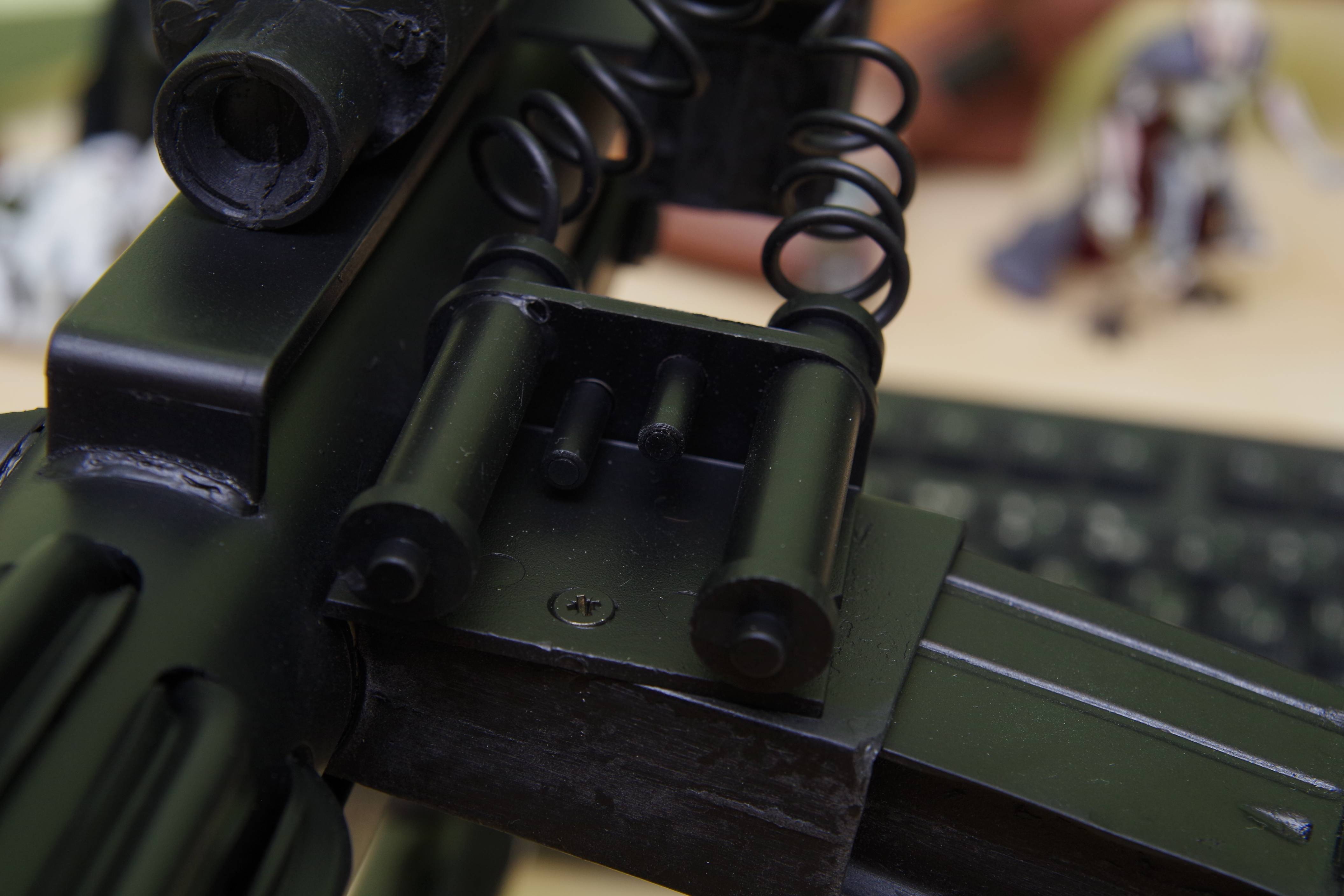

Here are confirmed photos I found of the plastic Power Cylinders on a Shepperton Design Studios E-11 Blaster (taken from whitearmor)
Again these blasters sold by SDS are cast in plastic with dense foam filler.
72936_original.jpg73584_original.jpg72524_original.jpg74194_original.jpg73922_original.jpg

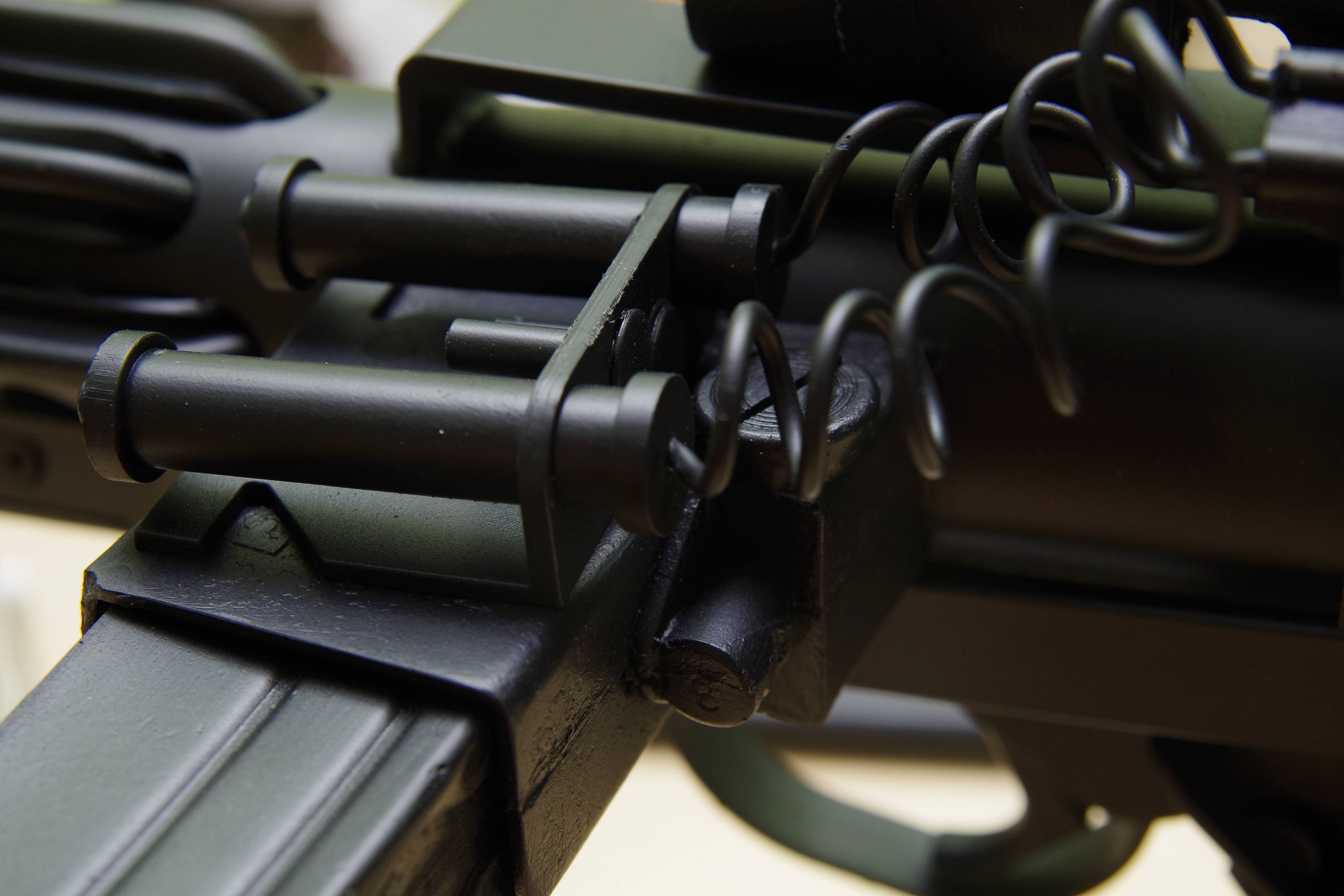

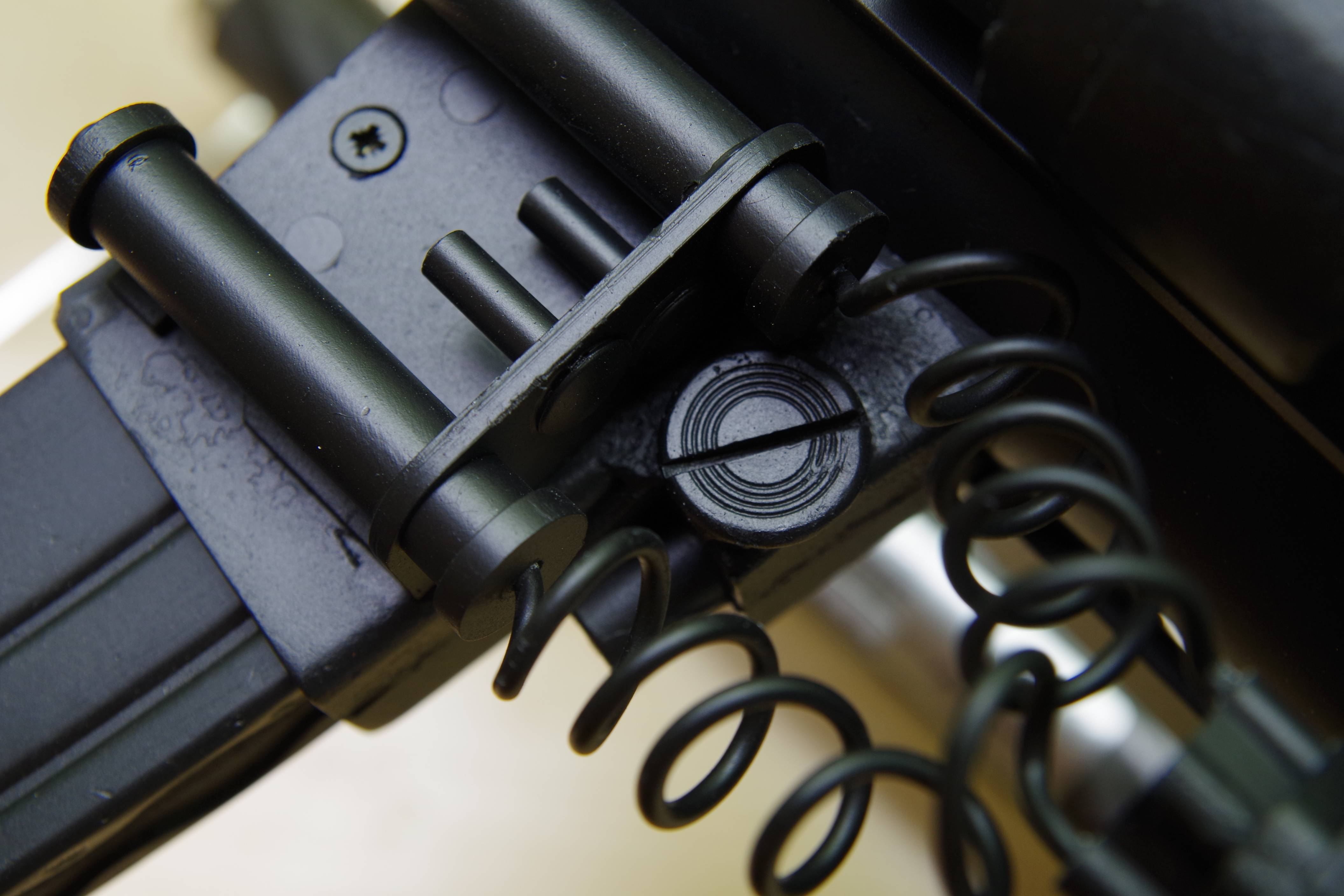

Hmm, the Rogue One power cylinders have a few details that don't match those.
-The small diameter tips on the front of the power cylinders are longer on the R1
-The single screw on the SDS is further from the front edge of the base/bracket than the front-most of the pair of screws on the R1
-The base/bracket looks thinner than the rear cylinder caps on the R1 version, but the SDS has approximately the same thickness
-No discs backing the attachment of the little staggered detail cylinders on the R1, but the SDS has them
The left column below has two more shots of the R1 version:

It does seem like they might have been modeled on the SDS interpretation but I'm not certain they're exactly the same. What do you think?
Chris' version (themaninthesuitcase) are not 100% accurate, he admits that himself; http://www.whitearmor.net/forum/topic/37744-suitcase-props-3d-printed-e-11-parts/?p=528760
Secondly the cylinders used in R1 are resin or rubber casts, they are not actual items taken off an SDS blaster. So they are copies that may or may not have been modified before recasting (ie: adding a second screw to stop from turning or moving). If you look at the base plate they are exactly the same obscure shape which is very unique to the SDS blasters, I've never seen that anywhere else ever. The other differences in dimensions that you indicated are negligible, again these are cast copies that may have even been modified. Also there is a huge variable of shrinking/expansion when casting Resin and Rubber depending on volume, temperature, ect, ect. This could also change the outcome of the cylinder casts used in R1.
I can't really imagine anyone making an imitation based off the SDS design, that E-11 is widely known to be a very inaccurate to ANH. But I could also be wrong on this, maybe someone in china used it as a base for their knockoffs thinking it was good reference. It's possible considering the website is called "OriginalStormtrooper.com" and considering many inexperienced beginners are drawn to his armor at first just because he produced the original screen used suits back in '76. It's all very deceiving but one trip to whitearmor.net and you'll quickly learn his armor and blasters are not very well received among the trooper community.
Hey, good observation. I'd been imagining the whole thing with a Y-shaped cross-section but we really only see the ends where the mounting screw holes are.

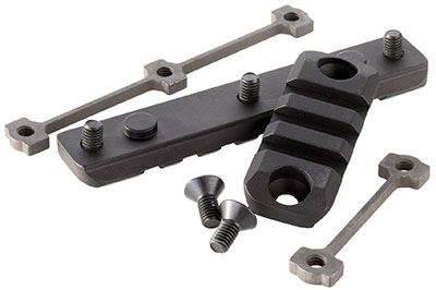

I believe this is the rail (it shows up on quite a few other blasters):
Unfortunately, despite having an image of it, I haven't been able to find the name of the rail (here's the source of that picture).

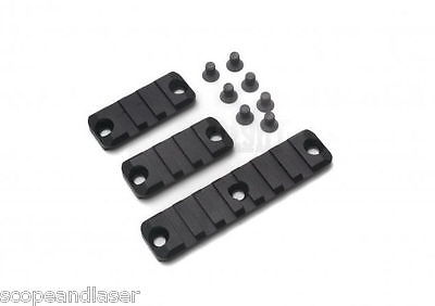

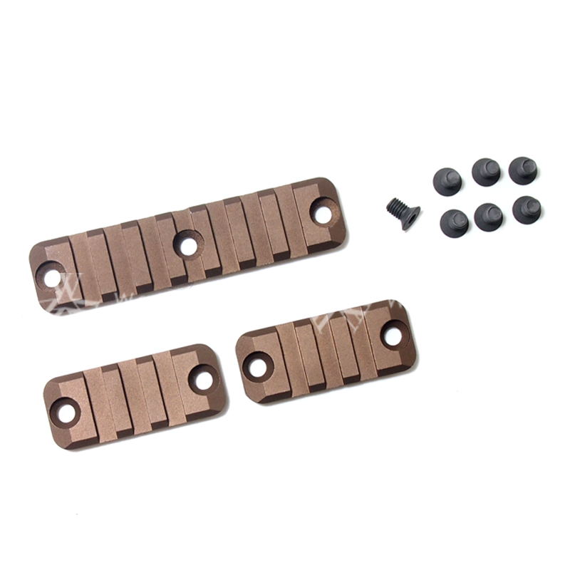

I found some airsoft specific rail that is rather close to the above. Will be a while before I can confirm as it's being shipped from China:
Maybe someone can translate the acronyms and pick out the important ones but it's described as FCC Modular Rail For SMR1 Systema PTW.
That definitely looks to be accurate, and most likely the correct found part as it is also meant for airsoft just like the gun itself.
The only thing I'm unsure of is that the corners of the rail look to be cut at a 45 degree angle, where as the screen used one does not. Maybe it's just the angle of the photo playing tricks on my eyes, could you please confirm this when you receive it. Thanks
Where exactly did you source this part from?
It's likely a trick of perspective. The lower right image here is the most deceptive - it looks like the end is a flat 90 degree cut like you'd get from a bandsaw but looking at the top image that is obviously not the case. Maybe the huge zoom in these photos has thrown off much of any sense of depth.
Take a look at your flashlight clamp - If the profile of the rail was not chamfered along its outer top edges, rail accessories would not fit since that is the profile of their clamp as well.
I found them by looking through ebay auctions for rail with a similar hole and slot pattern to the one Toa Quarax posted. Most 2" long rail pieces have 5 slots, so these with the extended slot-free sections on the ends and only 3 slots stood out.
Oh I know that. it's definitely chamfered like all rails are, otherwise no accessories would fit on it. I play mil-sim paintball and I own many weaver/picatinny rails and accessories so I know exactly how they work.
What I'm talking about is the corners of the rail looking at from the top, all 4 corners of the rail you found look angled at a 45 or almost rounded off even. Where as the rail on the Rogue One E-11 has rather sharp 90 degree corners.
Ahh I see what you mean now. If it ends up having rounded rather than sharp corners I suppose it will have to stand in as the closest possible until we can find the exact one :)
Still might just be an optical illusion from the angle of the photo, it's really hard to tell, but the screen used one does appear to have sharp corners both at the base of the rail and the weaver rail itself.
Well I found a photo taken directly from the top of what seems to be the same rails, the corners are definitely rounded on these. That's too bad...
