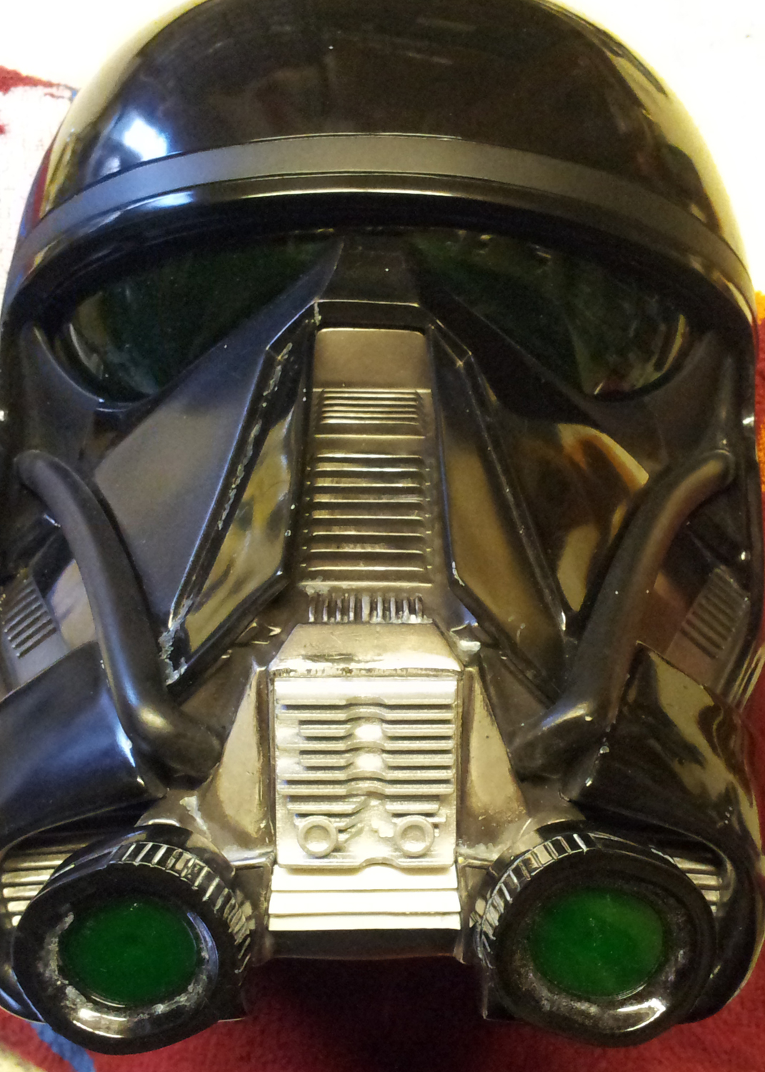

It is great helmet, but the details on the nose are a little rounded and look sqidgy, as if the mold has been designed for quick release, and it just doesn't look square.
andy preston death trooper repaint and mods 1.jpgIf we zoom in a bit, we can see the rounded feel of the edges. I have filed this as carefully as I can to try to bring everything into line, but it just doesn't look correct.

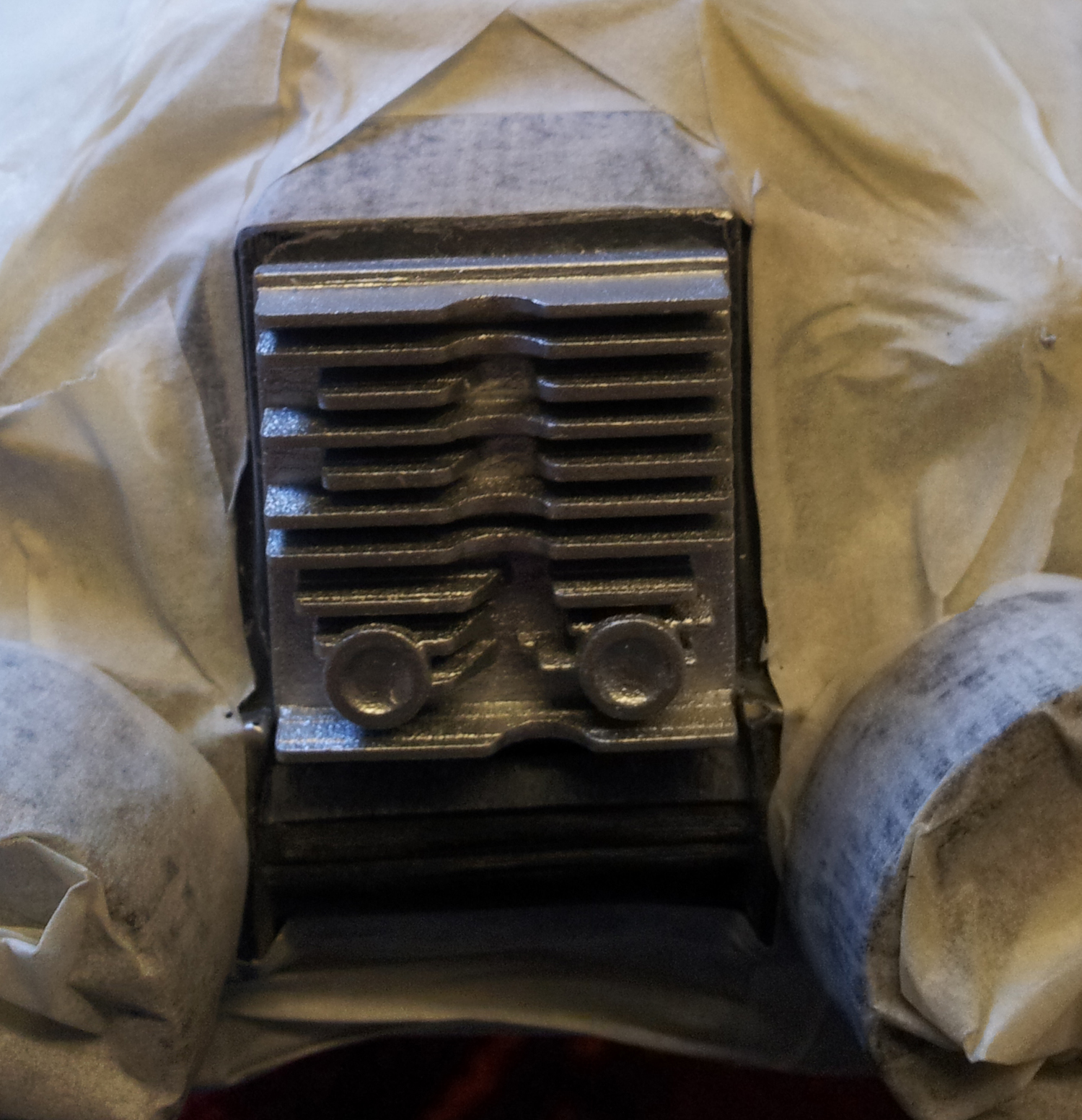

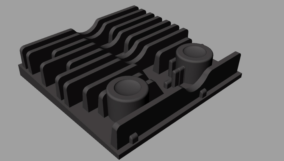

andy preston death trooper repaint and mods 2.jpgI have given it a preliminary shot of gunmetal over the original silver to make it a little less "black and white" but the grills below the louvres are all out of line. The filed areas just don't cut it. So I modelled a new version in cad to get some SLS prints done. I am going to remove all the front detail and replace it with new.

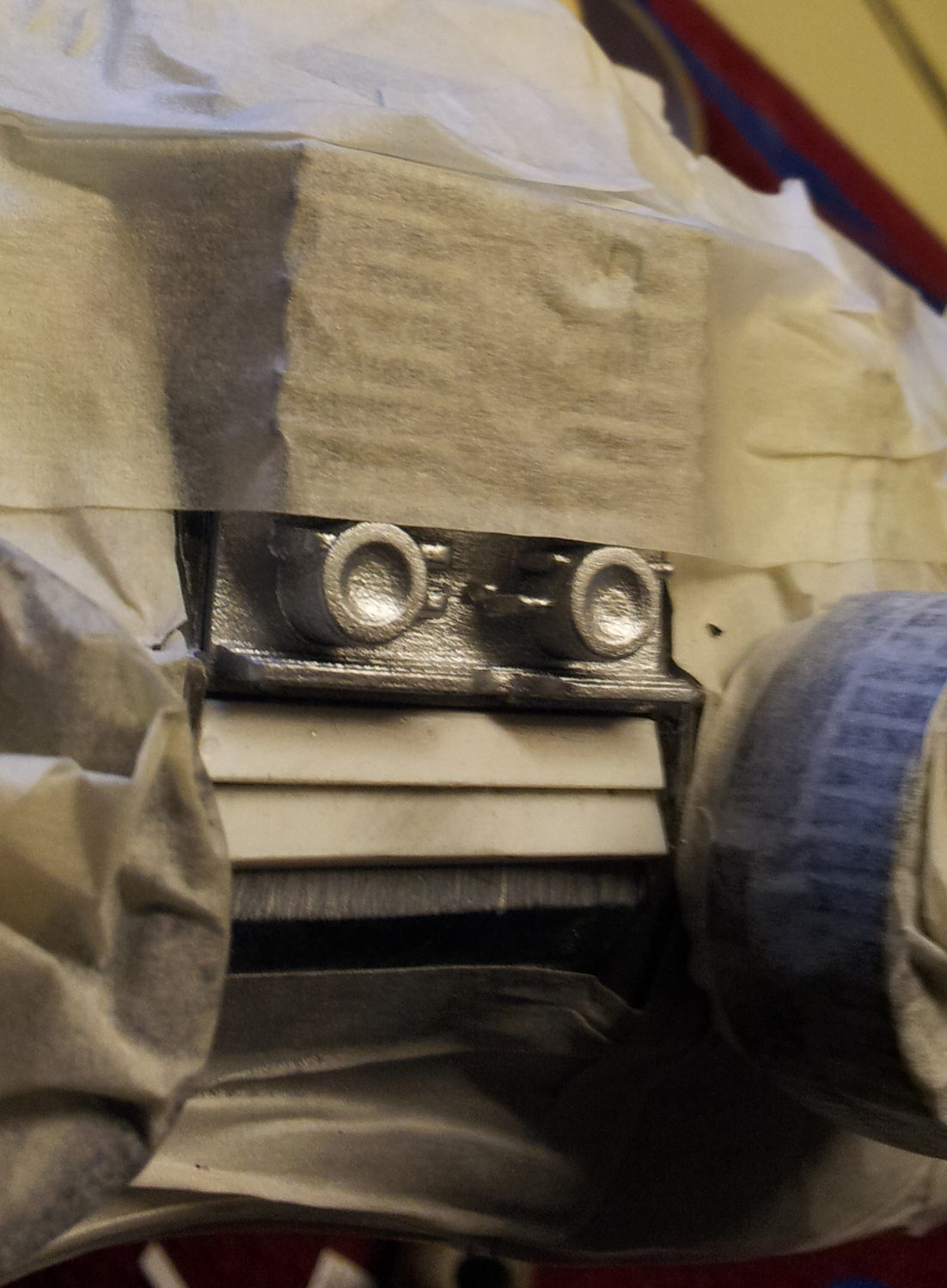

So once I had received he printed front details I removed the front grill and lower louvres ready for the printed parts to go onto.

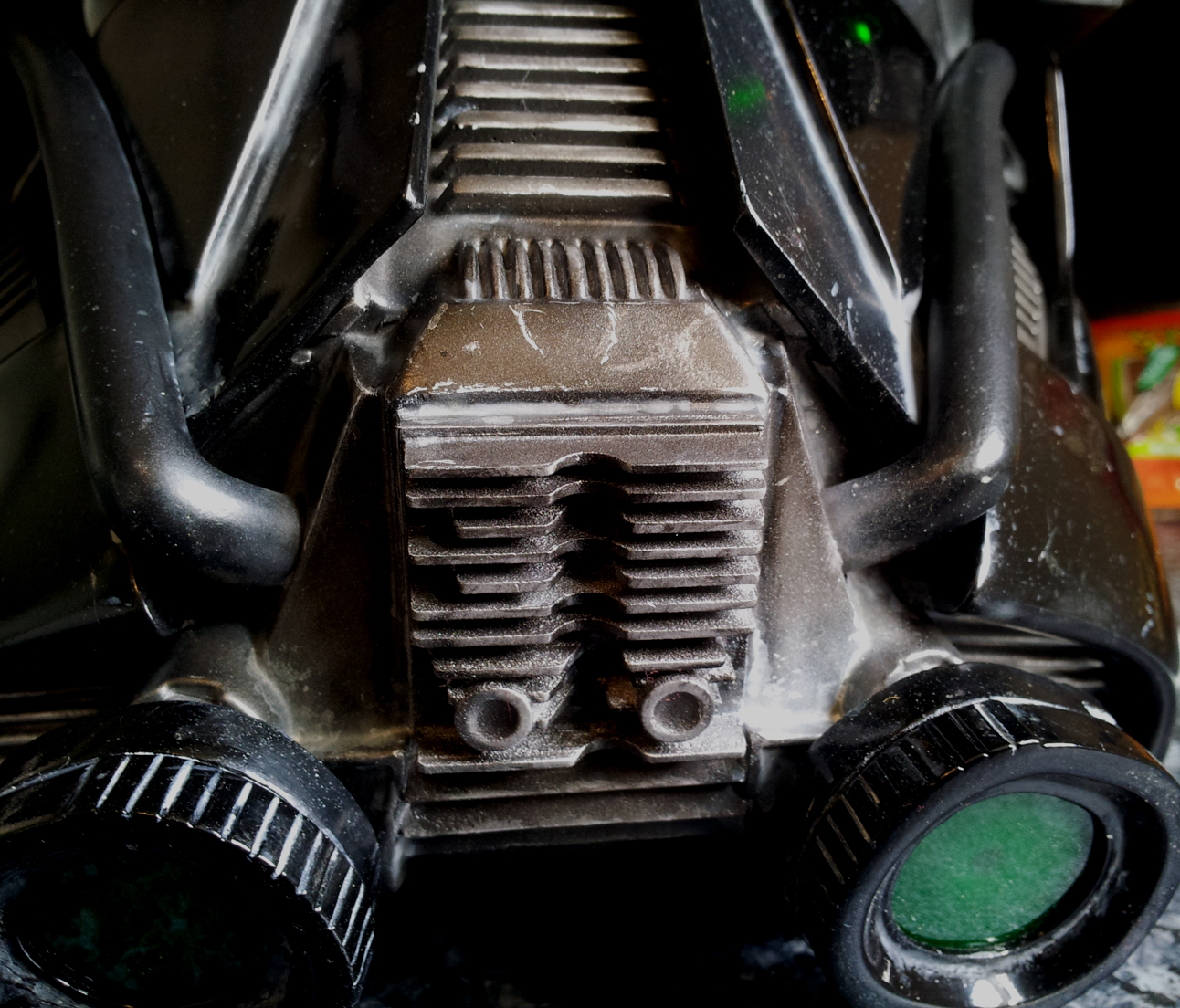

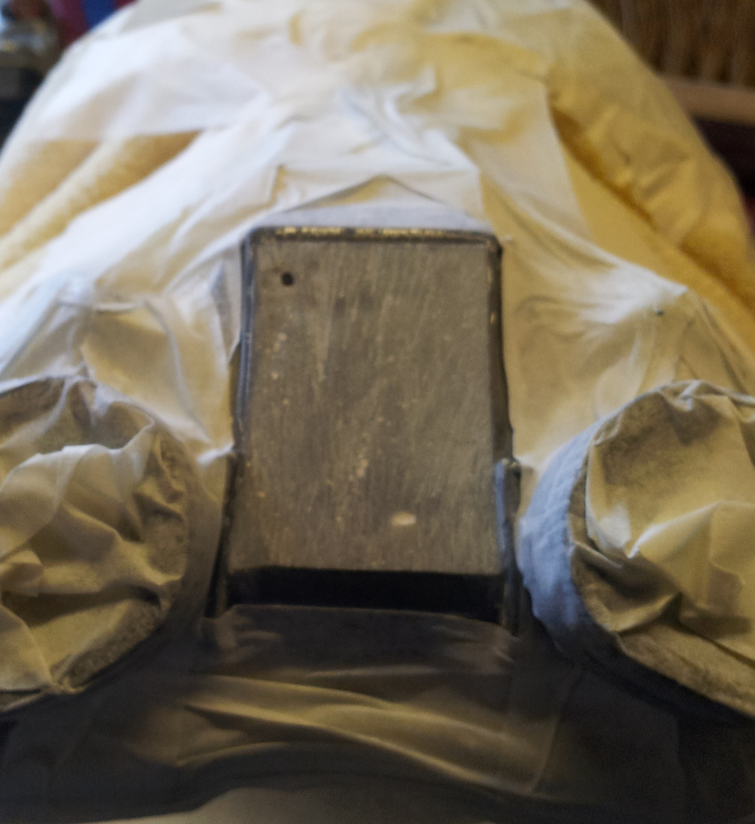

andy preston death trooper repaint and mods 5.jpgfront detail carefully removed and flattened off.
andy preston death trooper repaint and mods 6.jpgreplaced with the new printed version ready for filling and making good.
andy preston death trooper repaint and mods 7.jpglower grill louvres replaced with plasticard to give the correct saw tooth finish to the details as seen in this reference image.
