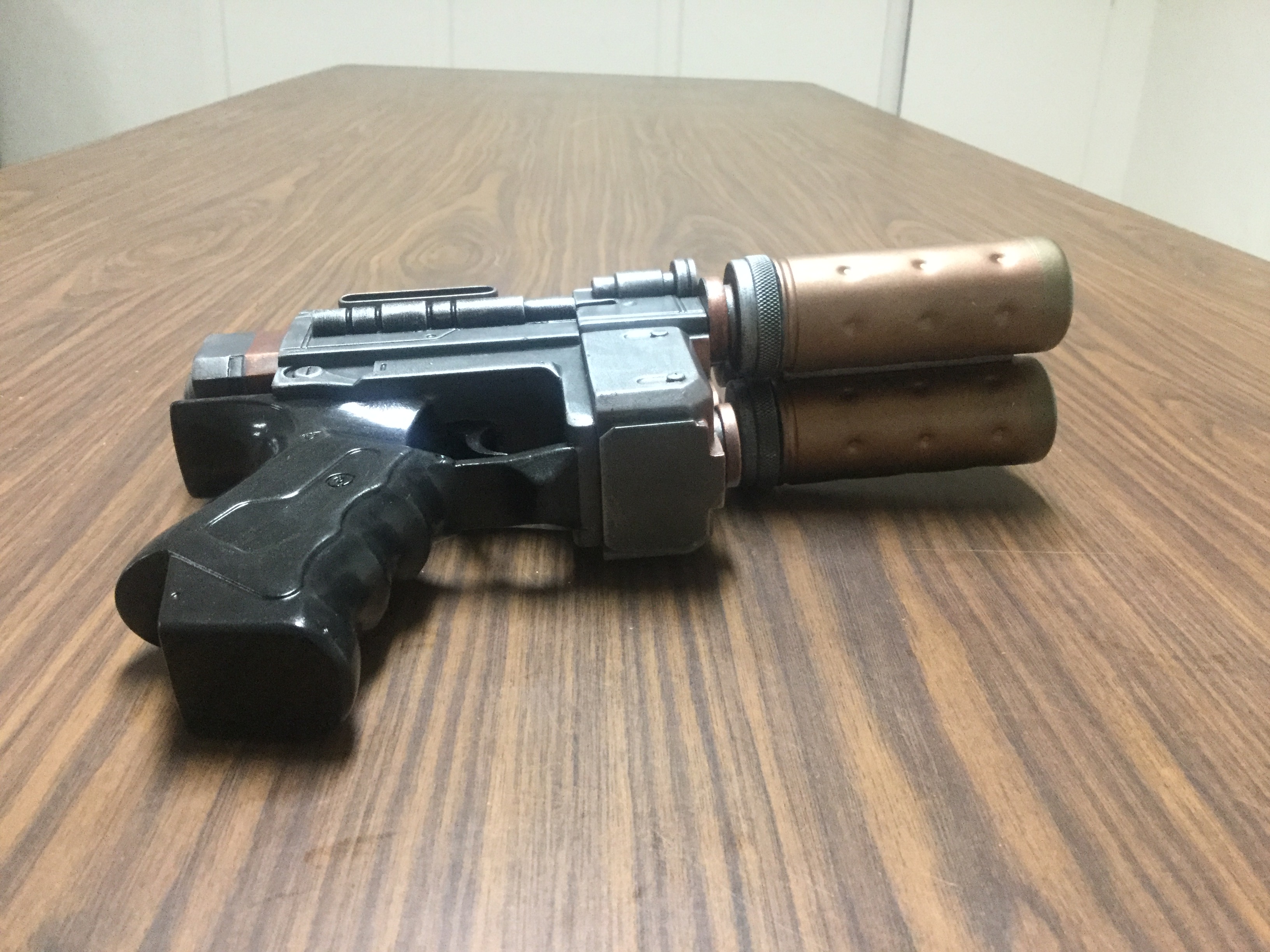

Rocket's Nite-Finder NERF gun from GOTG2.
I posted this in its own thread but thought I would add it here too. Thanks for all the great finds guys...

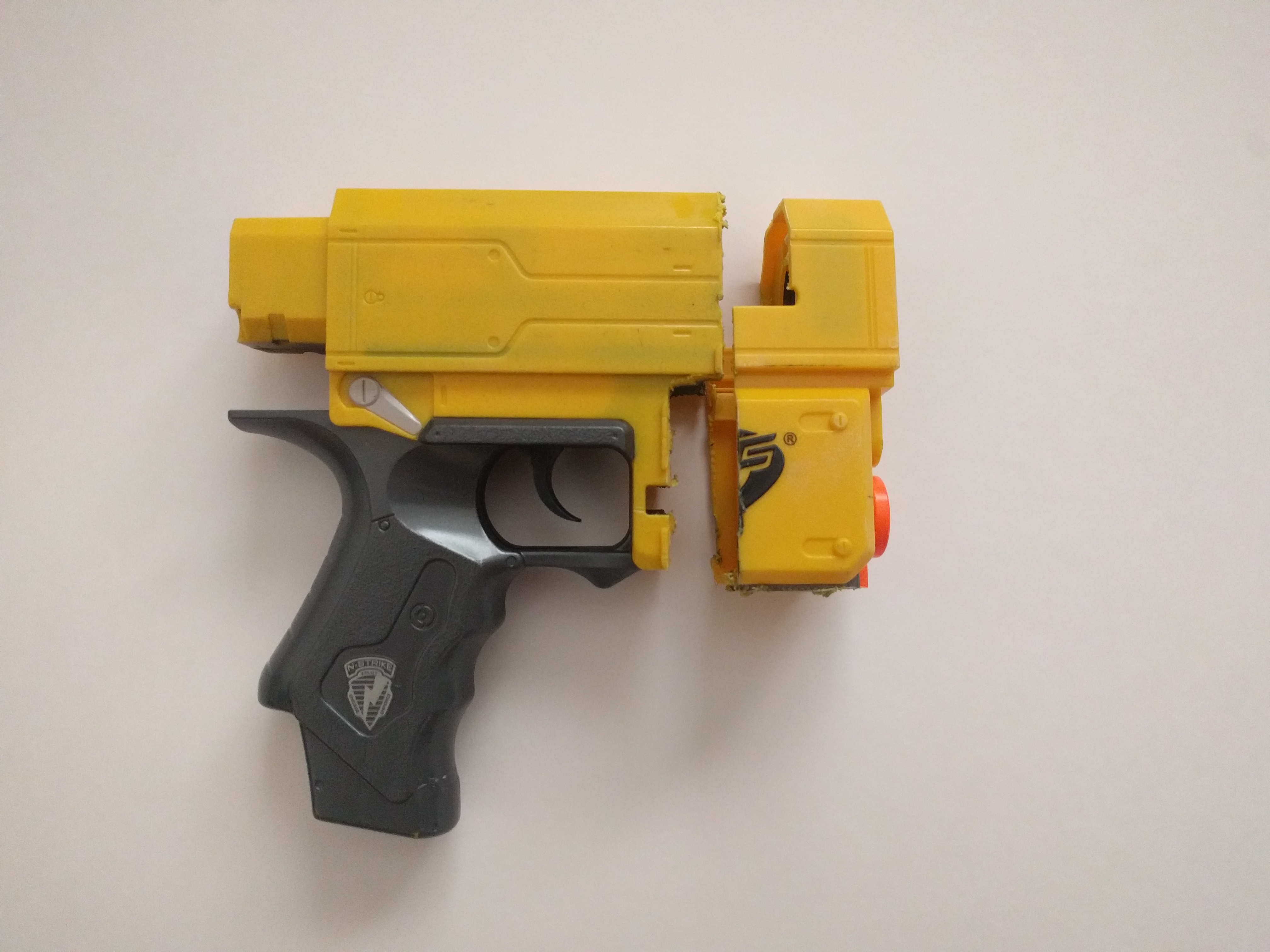

The final step was the assembly and the scope which came today. Now I just need a few more greeblies for the part of above the top barrel and the piece coming out of the flashlight.
Now onto Rocket's other gun made from a Nerf Retaliator (which I also had a spare one of)

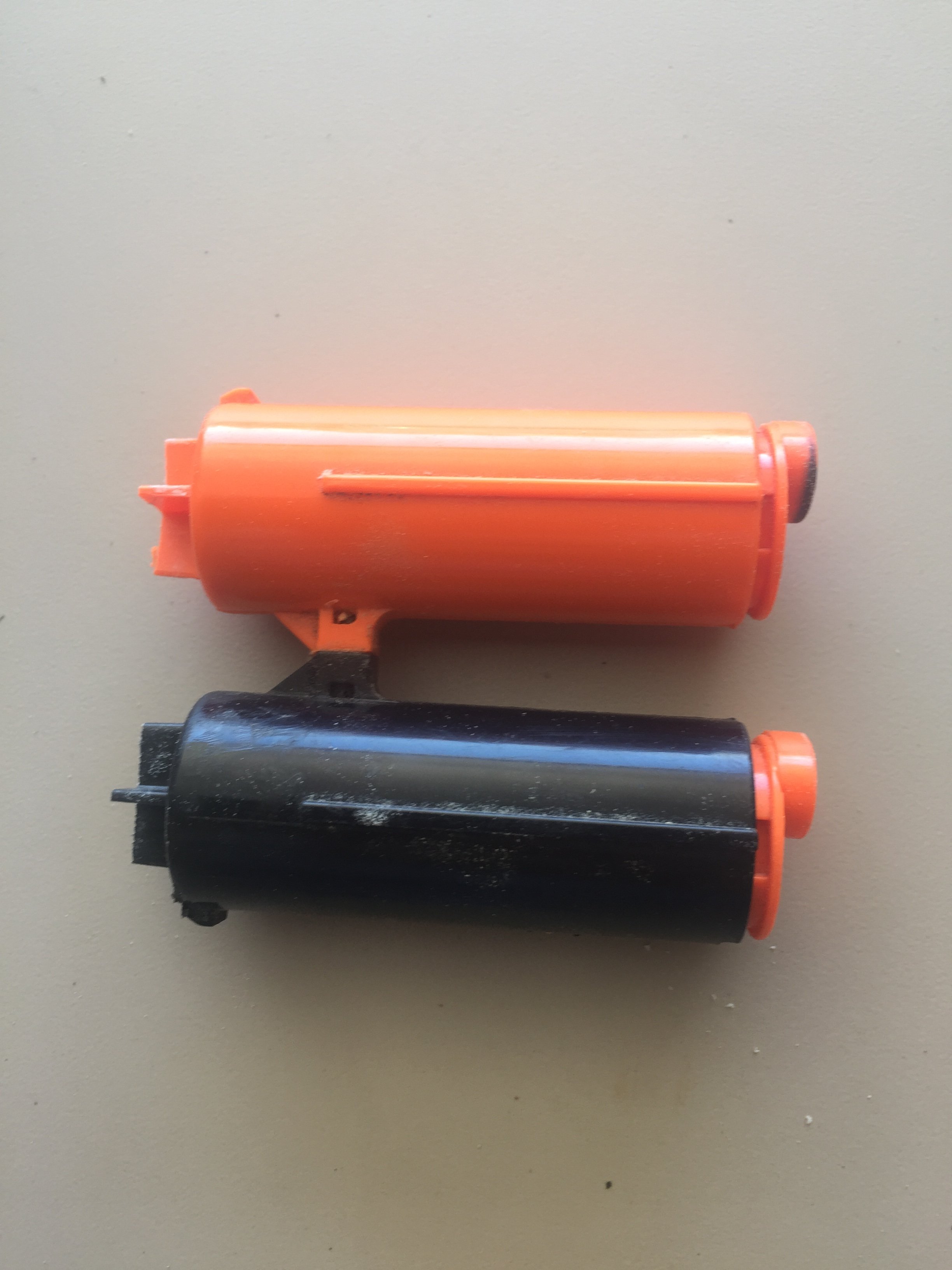

In terms of complete accuracy though, I came to the conclusion earlier in the thread that the upper Maverick plunger is just the inner tube. As you can see in the screengrabs, it has a channel that goes the complete length of the tube, rather than a kind of fin? I did some measurements in PS and I'm almost certain that the upper tube is narrower which would account for this. This is not reflected in the Hot Toys version however. The upper Maverick plunger also has some kind of fin on the top which I haven't identified but wonder if something similar could be cut out of the Maverick tigger (that was my plan anyway).

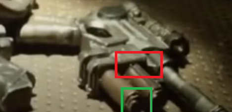

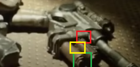

I thought the same thing about the inside plungers at first. In the photos one of them has a channel like the inside of the plungers the other has large strip. They definitely have the inner tubes inside an exterior tube. You can see the gap between the two where the inner tube is coming out. I have highlighted that in the green square. I agree it looks like it but the inner barrels have a grove around the outside for the o ring - which is not in the pictures.
I believed the channel you mentioned is actually added on to the exterior tubes. I added a polystyrene U channel piece to the side of the tube.. That would account for the shape it makes when it meets the nightfinder. That is in the red square
I also believe they used the exterior because of the small piece that connects the 2 tubes. which I solved by simply rotating the tubes until the 2 notches that are on both connected. That is in the yellow square.
I think you might be right, although I don't like how U-channel looks. My plan is to cut material from the outer barrel to match the grooves underneath, then glue the top and bottom halves onto the inner plunger. That matches how the Hot Toys looks.

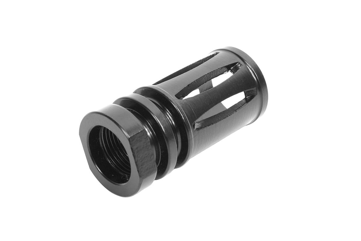

Hey, that's pretty close! I wonder what it is? "All-Metal M4 AEG Flash Hider"
Well there's no way that the prop shop used a Nerf gun as a base and then used such nice
AEG parts for something as trite as a flash hider. Let's see what other airsoft M4 barrels exist...
Look at this one:
Look Familiar? Look at the previous screenshot from the prop video and this sculpt:
It's dead on. And who wants to bet that flash hider is threaded to fit the barrel?
Thread Type: -14mm Counter Clockwise (CCW)
- 14mm CCW threaded barrel compatible
Again, dead on.
I hereby nominate the following:
a) Barrel and flash hider are separate parts threaded together
b) The barrel is that of specifically an M4A1 Carbine, M16/AR15/M4-a-nothing barrels are all slightly wrong
c) Marvel spent more money on the barrel and flash hider than the rest of the gun combined apparently

^I have both the metal flash hider and barrel in question, and the plastic one @Sillhof used. After studying screen caps, I believe sillhof's barrel is the correct one. The metal flash hider has closely spaced slots around only half its diameter, while the plastic has slots arranged equally 90° apart around the while barrel. In screen caps, every angle of the gun shows one slot. Never two and never none. That matches the plastic barrel perfectly.

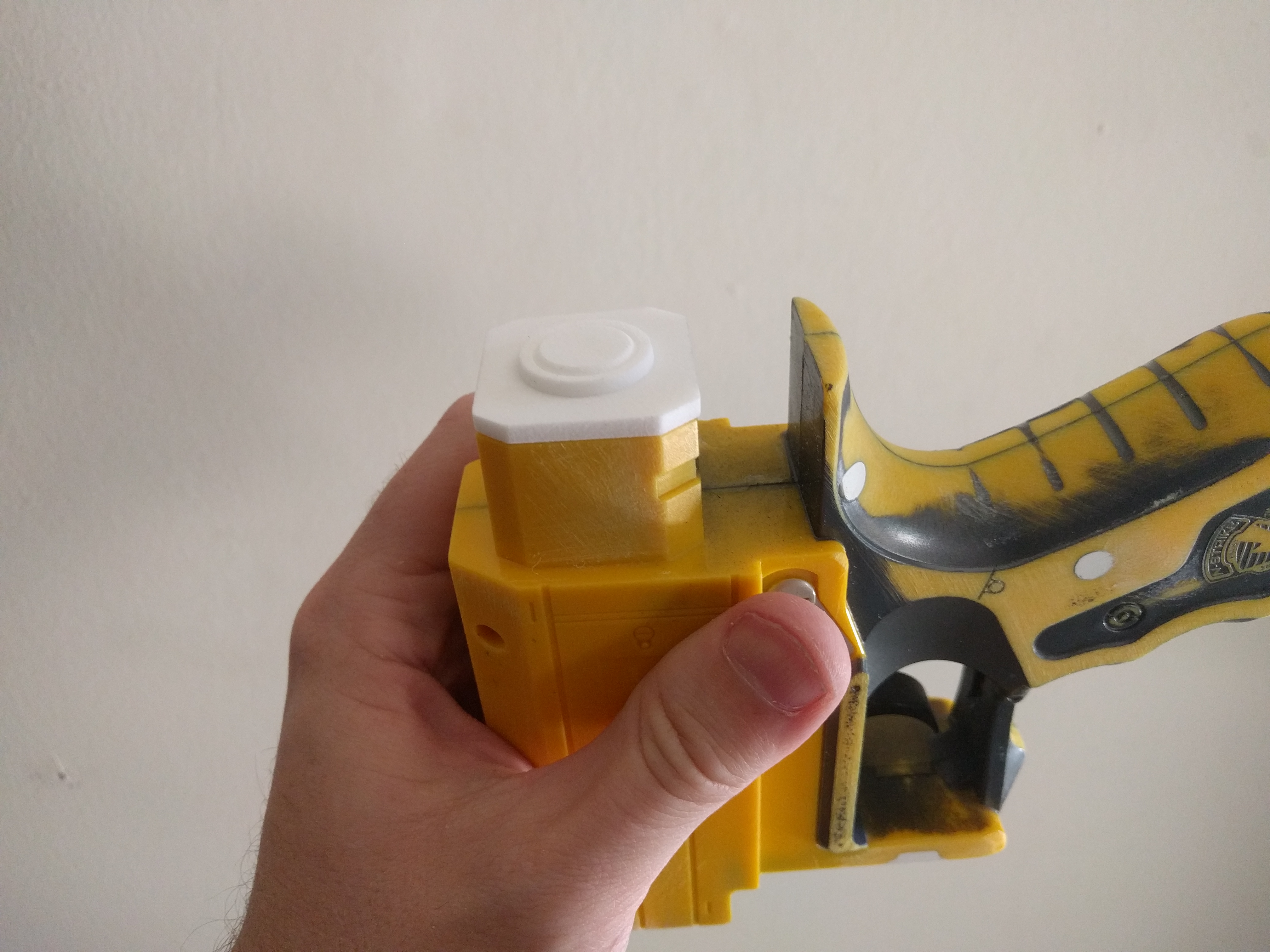

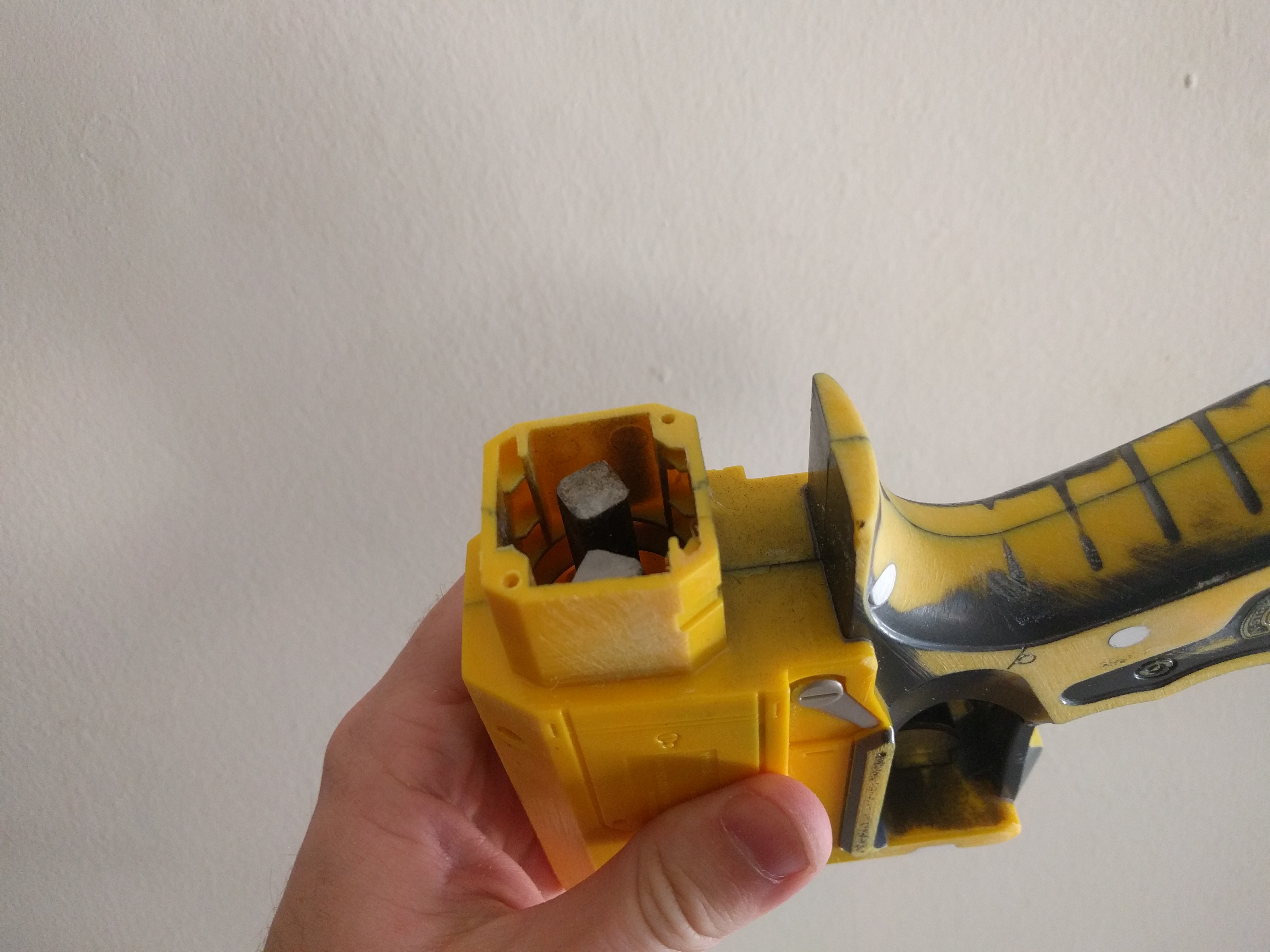

For anyone using the printed Retaliator backplate, FYI here's how I designed it to install.
Remove the black plunger cover off the back, and trim the plastic flush with the two screw holes found under the cover. Like so.
The printed part replaces the trimmed material.
Now that I have it in hand, the round protrusion should be about twice the high to be accurate. I'll update the model later.

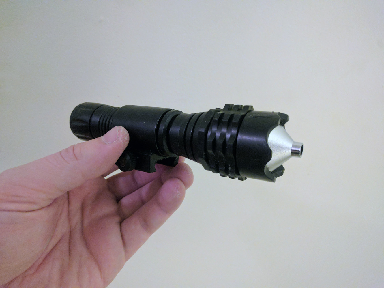

The copper cone sticking out of the flashlight is the reflector pulled out and flipped around. There's even a copper coating under the vac metal, so if there's a way to strip the chrome off, you're all set.

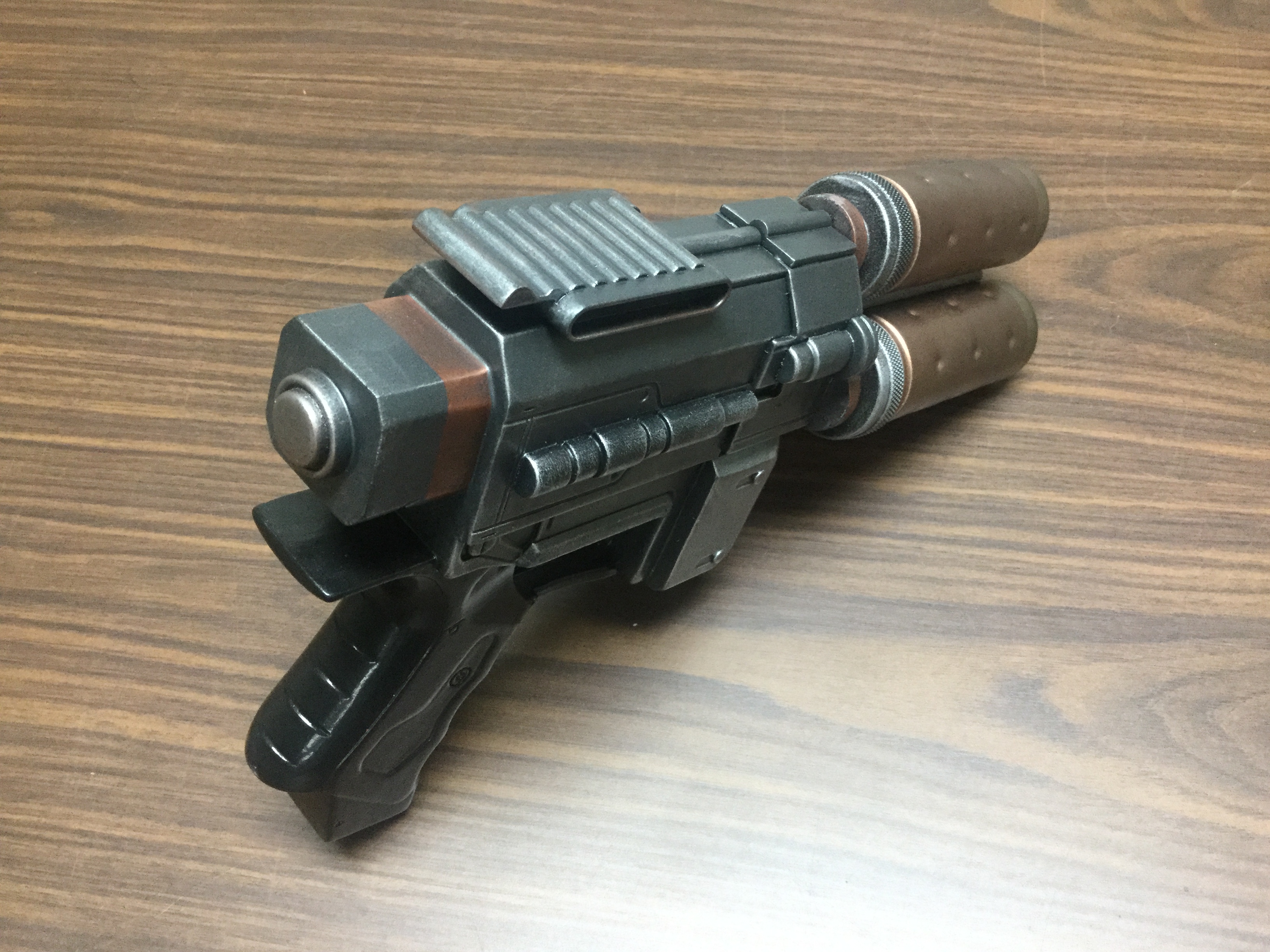

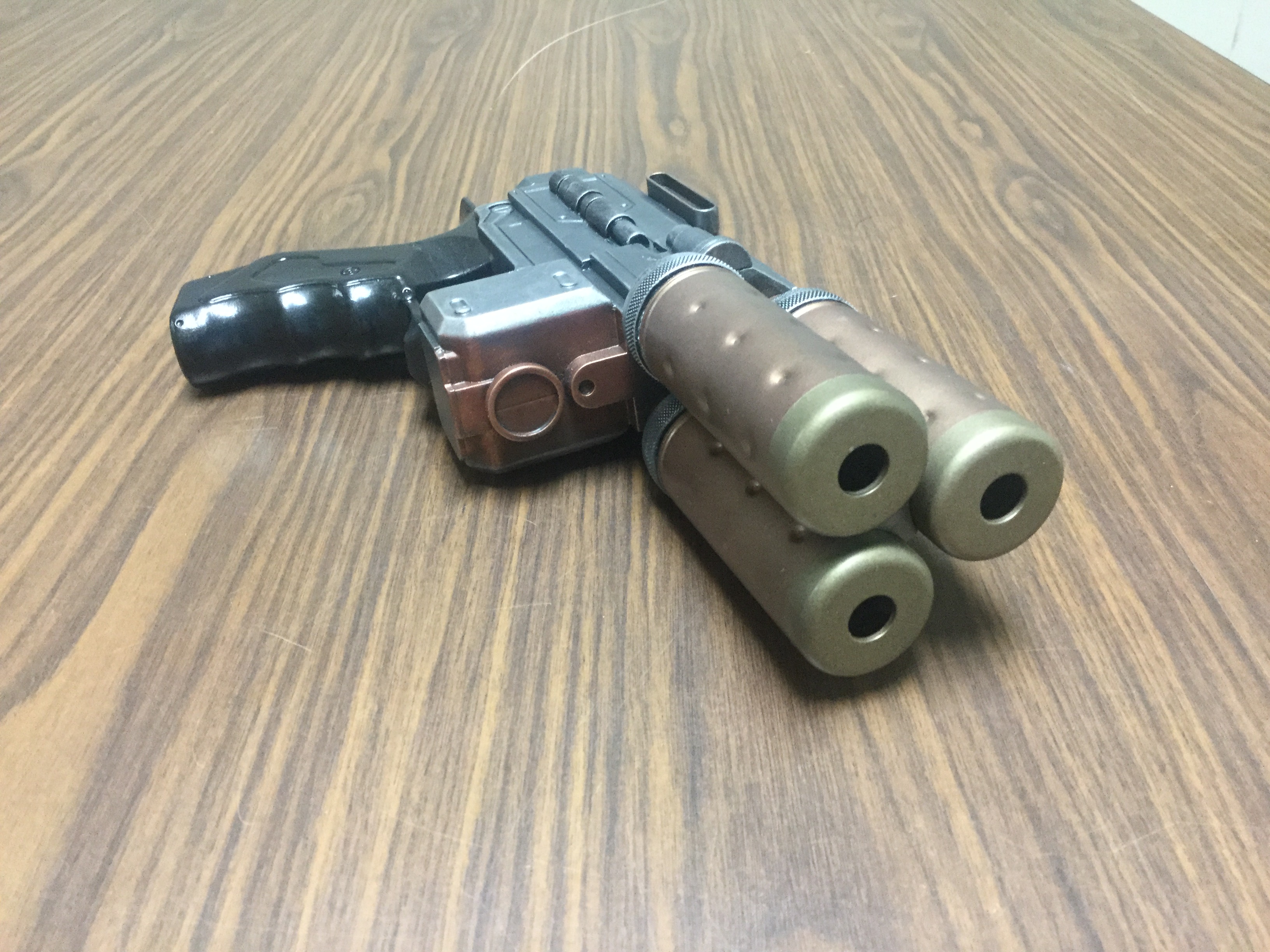

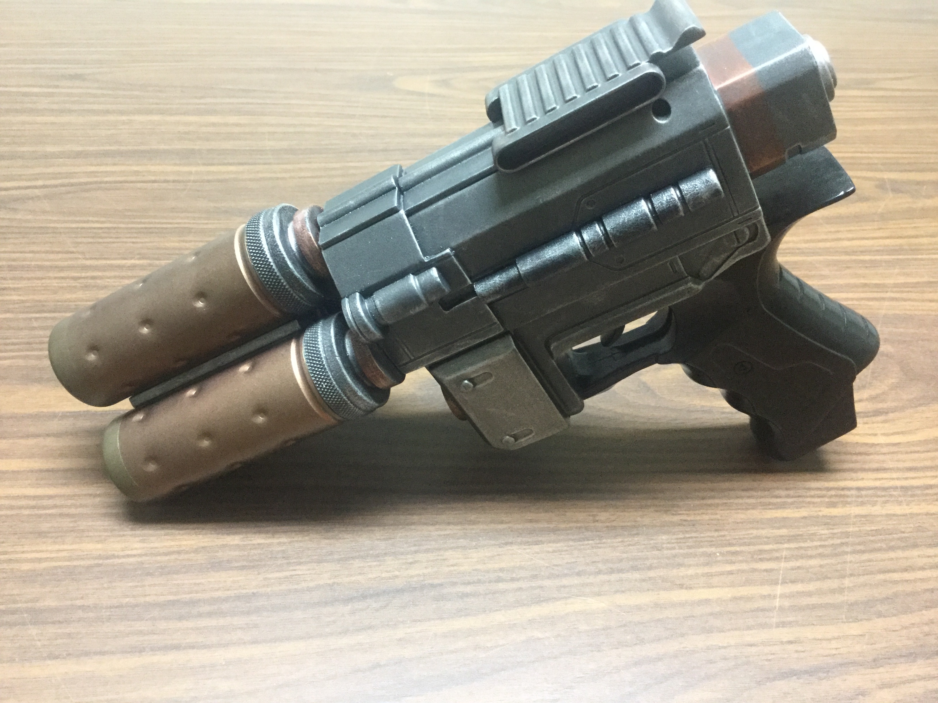

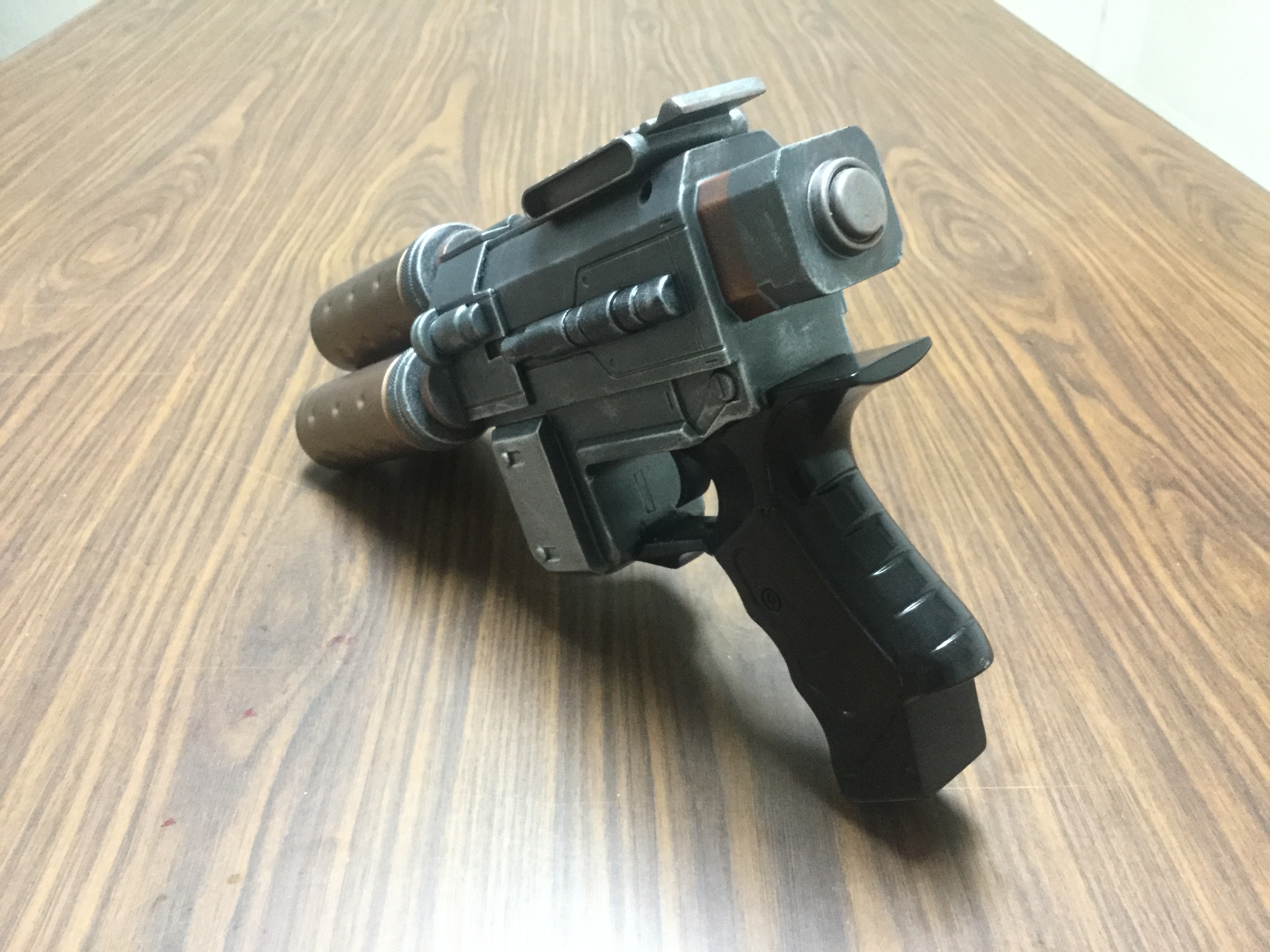

Multiple revisions, corrections, and mistakes later, I present...Rocket Blaster #1. Getting the barrels attached was a bitch. They're not quite correct but it's close enough. I can go into detail later. For now:
Colors are are based on the CG model, with the Hot Toys and Chris Pratt prop video uses to fill in a few unclear areas.

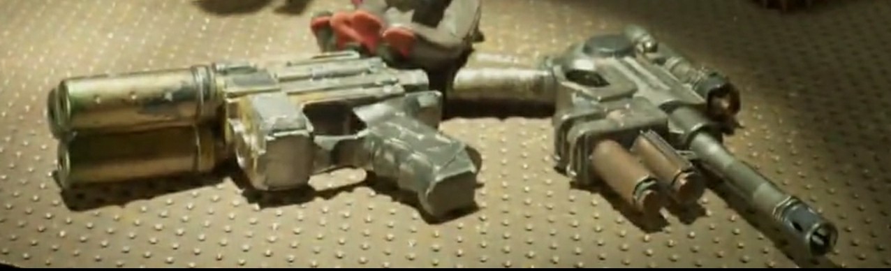

1080p rips of the film are online. Here's the close-up of the physical props:
This confirms the copper cone in the Nite-Finder's scope, as well as the U-channel on the sides of the top Maverick plunger.
