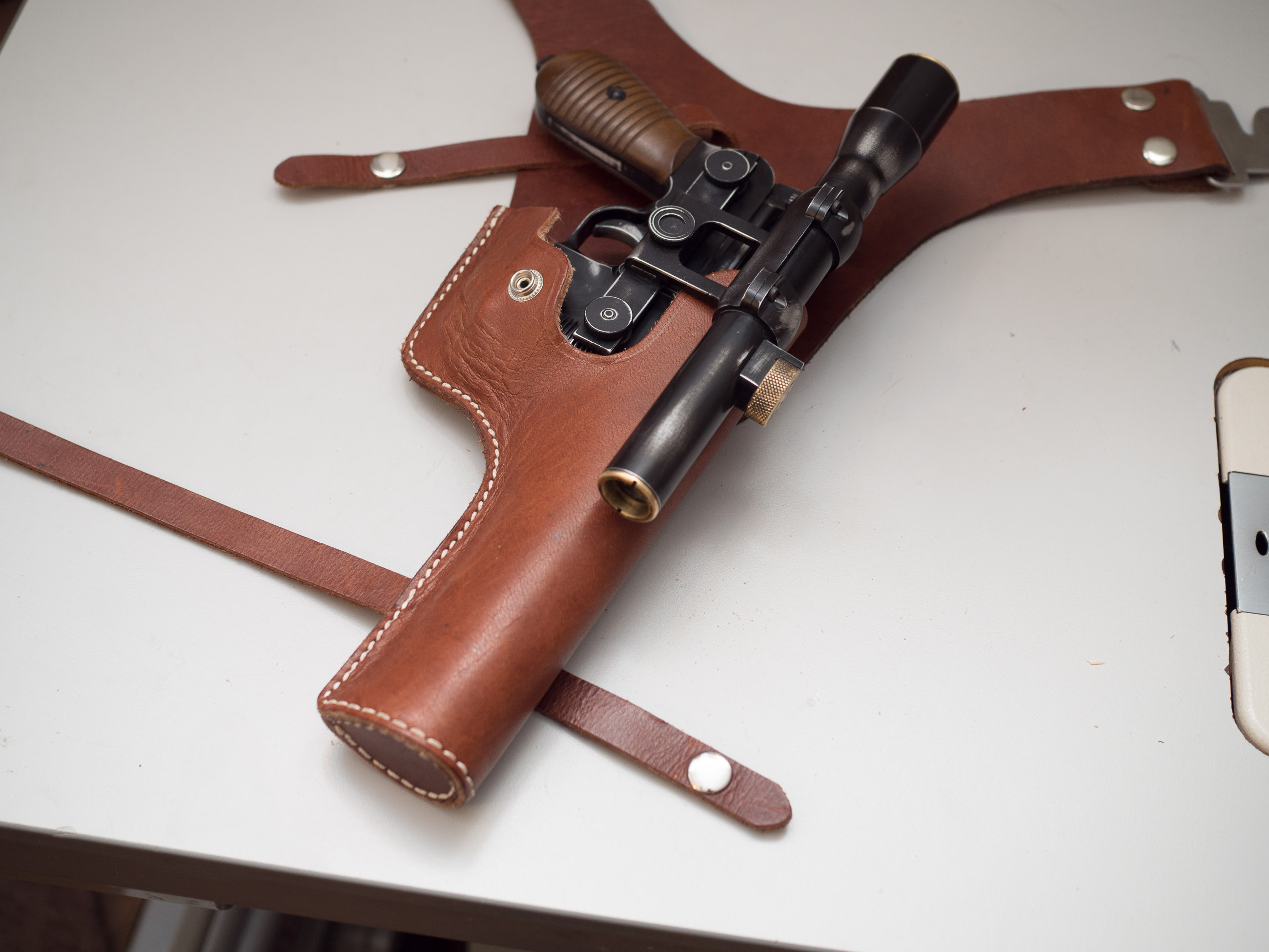

So, I had the (apparently) unusual experience of the leg strap on my Han Solo holster peeling off of the holster body while sitting down (with an all-metal blaster in said holster) today. I'm guessing that the combination of a heavy metal blaster, and possibly fastening the leg strap too tightly without realizing how much more stress would be put on it when I sat down resulted in stress shearing the rivets.
I want to start off saying that Todd's Costumes has been absolutely fantastic - they immediately offered to reimburse me for the cost of having a local cobbler repair it, or take it back if it couldn't be done locally. A++ customer service, and I'm definitely still planning to shovel more cash their way for future projects! (those buckles for a custom holster rig, oh my!). The holster is a thing of beauty (seen with the rest of my rig here), and received a huge amount of attention.

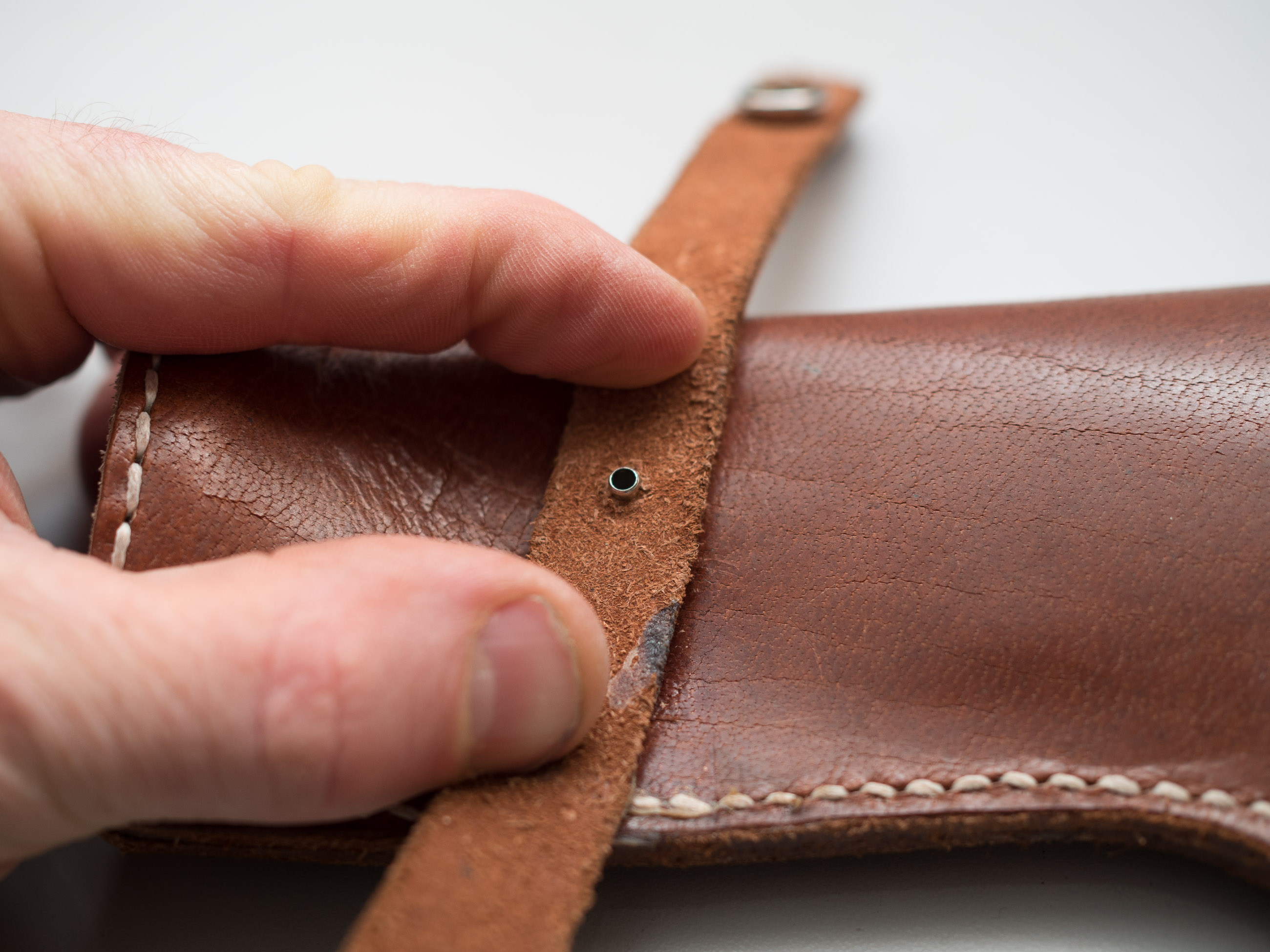

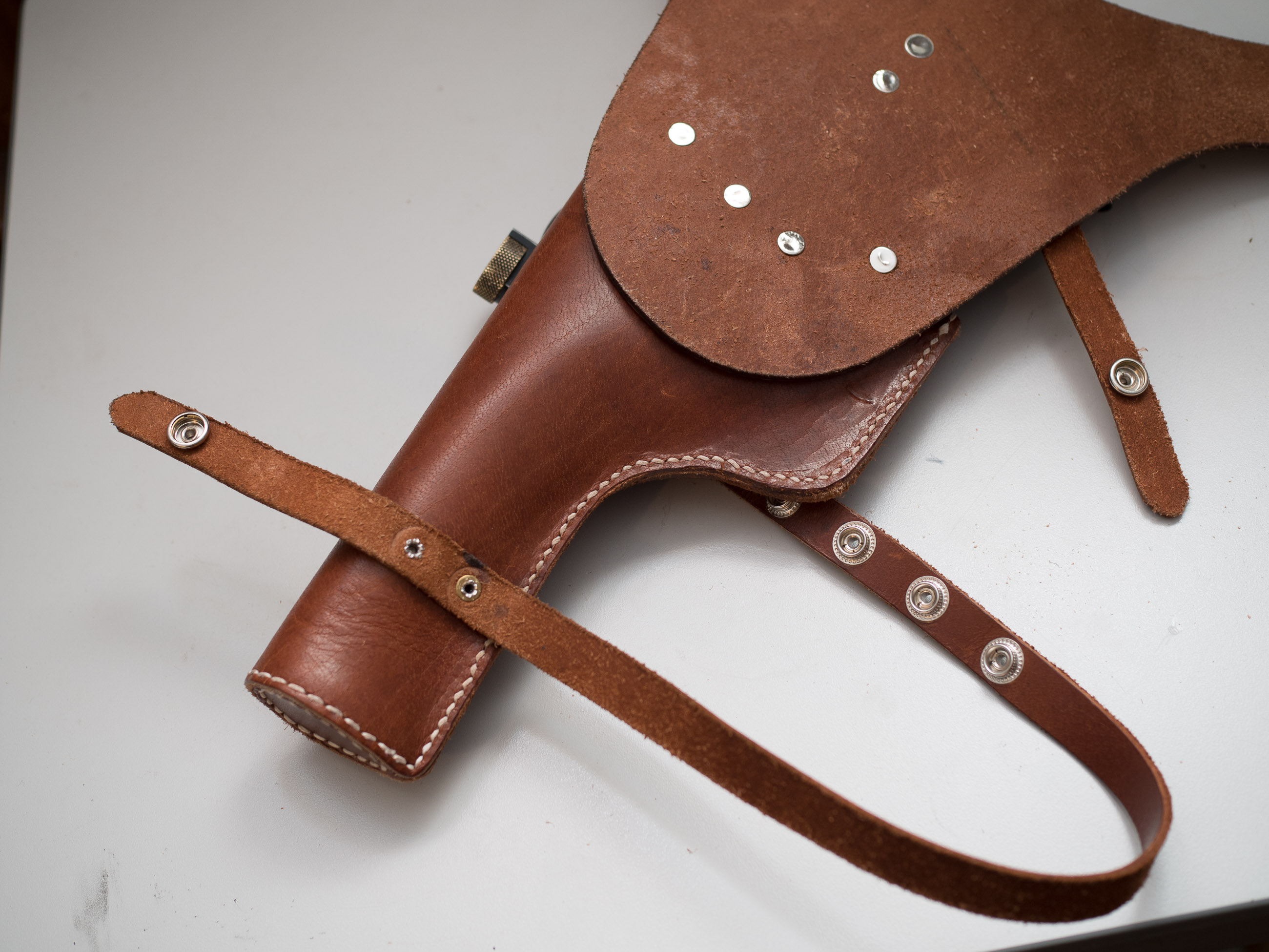

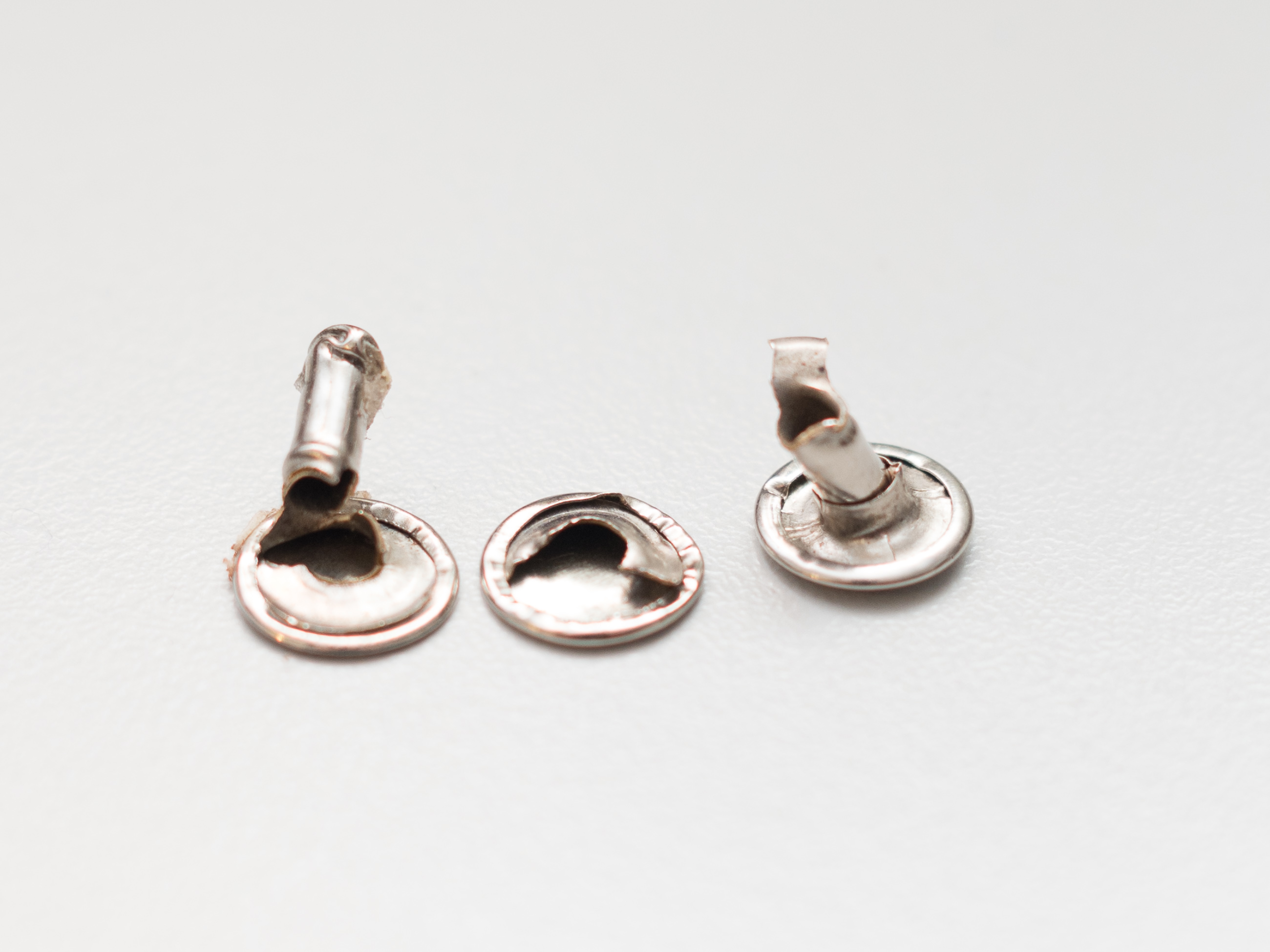

OK, now that we've got that obligatory pun out of the way...look upon the lamentations of the rivets, and despair!
Yep. My thighs did that.

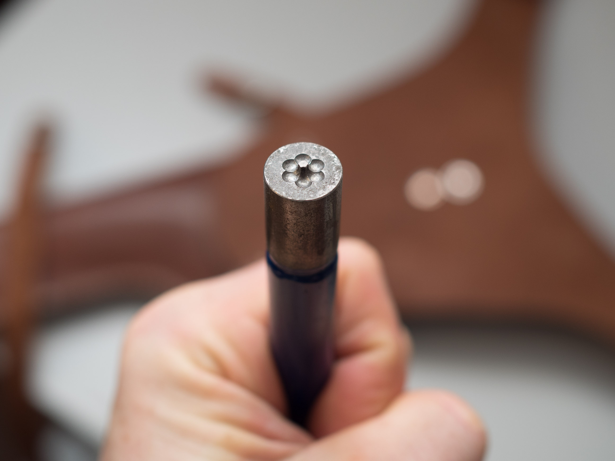

I still have quite a lot of tubular rivets, which can be set easily and fairly securely with a "splash" tool, which splits them into six prongs. They're juuuust long enough to fit through the heavy leather. But the first problem is, how to get them set deep inside the very narrow holster?

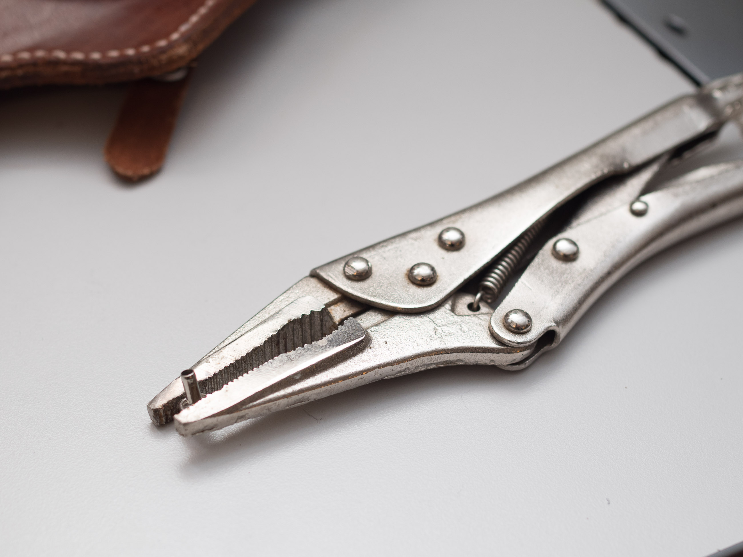

Locking pliers and brute force, of course.
Getting locking pliers to hold a rivet evenly is tricky, but doable. I only sent them flying off into corners of the room at high velocity a half dozen times.
This is a re-enactment of the general idea of using the pliers to position the rivet in the hole from the inside. The reality involved a headlamp for illumination, awkward grunting, and occasional cursing.
