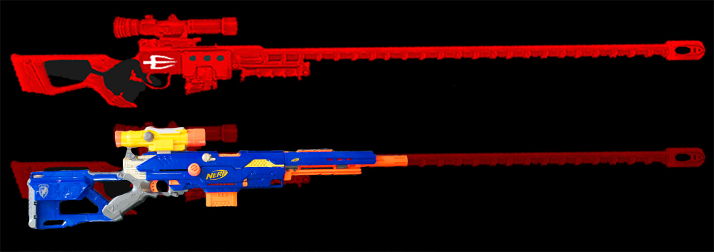

Second bit. So, I know, obviously, this gun isn't the perfect thing to build my prop off of, but it's extremely close to the actual design and I'm sure I can do something to make it work, but, I'm having a few issues with the looks. For example, the notches cut that have been cut into the barrel of the rifle in the comic re a thing I'm pretty unsure about, I was thinking multiple PVC pipes, one inside the other, but that seems as though it could work, but would do nothing to help me get the barrel lighter.
First of all, I don't think "light weight" is a realistic option considering the length of that gun and the added length of the barrel:
questions-about-reinforcing-modifing-nerf-n-strike-longstrike-cs-6-roxycrockersniper.jpg
Therefor I'd go with a second PVC pipe that has cut outs to create the ribs of the barrel (after all, PVC doesn't weigh THAT much, so I shouldn't matter much considering the overall weight of your 2 meter rifle ;))
