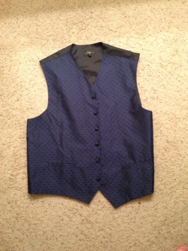

Also, I got the only vest they had, a patterned blue polyester one (I know, wrong material). So, I'd also like to know how to get that to be a hunter green like the movie vest? Here's what I have:
I have no idea how to change polyester. Maybe an acrylic wash...?

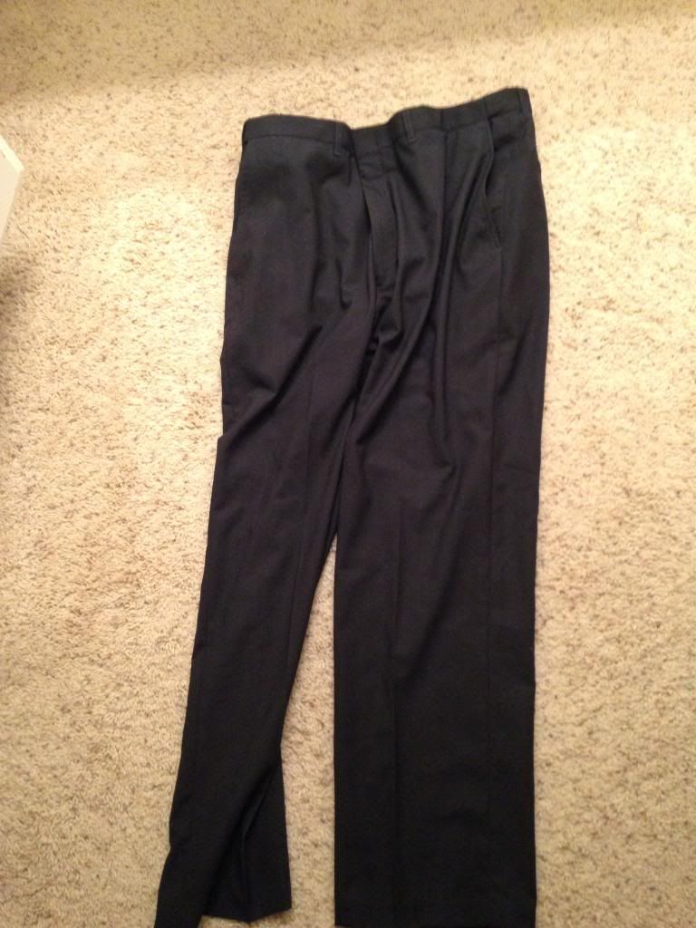

Pants (yeah, solid, and yeah, black-but again....$70 total)
