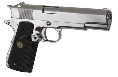

Fist thing to do was find a suitable gun to mod. The best all-metal candidate I found at a local retailer (I didn't want to wait, lol) was a WE Matte Chrome model. It has no markings (aside from the "45 APC" stamp on the barrel at the ejection port) so would be ideal for when I eventually have the STAR markings laser engraved onto the slide.

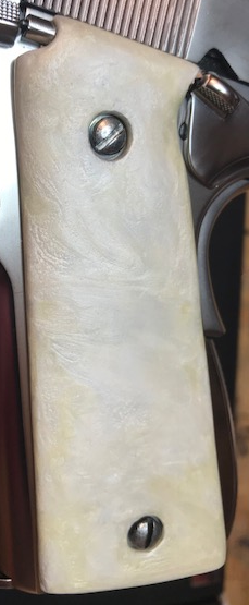

The grips were done first. I found surprisingly few (=none, haha) pearl grips readily available that were a good match, so I decided to see if I could make a set or paint. After a few failed experiments with mixing metallics and white paint mediums, I remembered that I had some leftover pearlescent powder from when I screen printed my Star Lord jacket fabrics. Turns out that by mixing the powder with clear epoxy glue, I could spread it out in a 'swirly' pattern that at least looked similar to the screen grips. I modeled a set of grips shaped like those on the STAR, but made to fit the 1911 (and cover the plunger tube). Unfortunately, the differences in overall grip fram shape meant I couldn't get it exact in shape, but I think it sells the look overall. Then followed a hell of a lot of sanding to get the epoxy smooth.
The result (with a coat of satin varnish):
