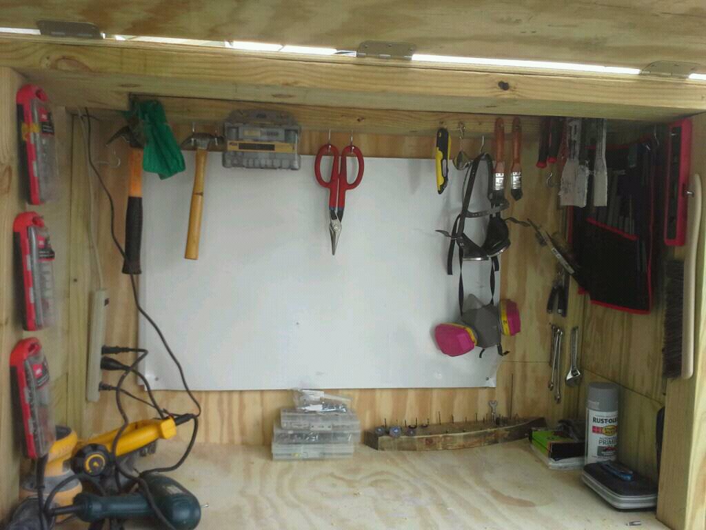

I live in an apartment with a small balcony. I built a tool box/work station on the porch. Been working good for me so far.
