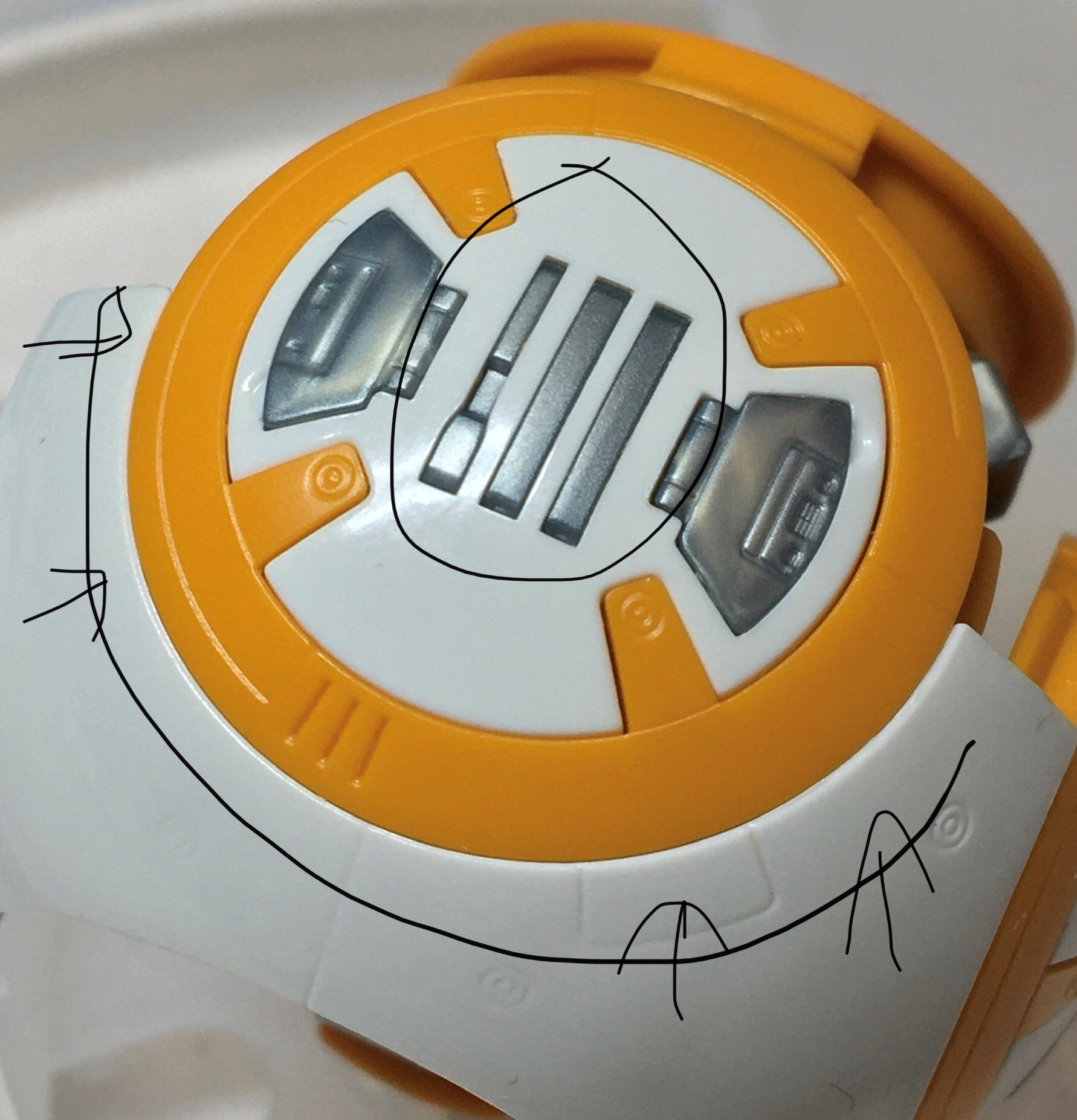

The technique of scraping the surfaces in contact with a blade seems the most relevant, but does that not weaken the hold of the paint on the edge? And about varnish?
Also as I will include lights in each model, I would like to keep the possibility of disassembling certain elements (to repair them, improve them, etc.), so I would not want the paint to come off when extracting the part.
Indeed my models are very precise Bandai models.
Regarding the hidden fixing points, no problem, I will do some masking.

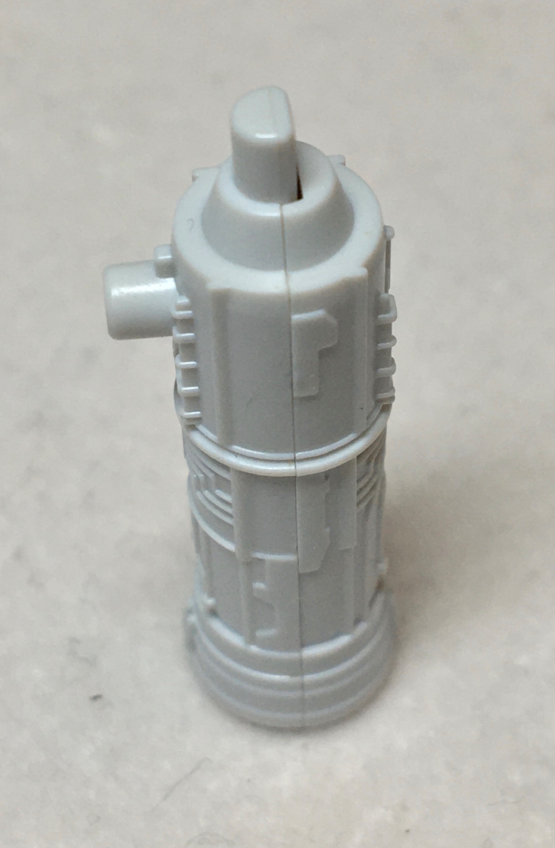

But I am particularly worried about this kind of connections / contacts between ultra-tight elements (see attached files).
Thanks

For the BB-8, I did paint the metals and the white body before assembling. I don't remember any real fit issues but I was also careful not to paint the the inside
For the X-Wings I did in sub-assemblies. The main thing with the X-Wings is not getting paint layers on the connector pins for the upper and lower body shells and the wing hinge mechanism in the middle of the wings. Those parts are really tight even before paint. You fine with the engines and stuff
If you plan on disassembling the models once painted I would strongly suggest painting everything separately. Otherwise you are susceptible to paint bridging the joins and tearing on disassembly.
No scraping the paint off the edge on a model kit wont weaken its hold onto the surface.
Funny, taking the photo of the wing of the X-wing, I was wondering precisely what would be the behavior of the paint / primer subjected to friction on the moving parts, such as the axis of the wings, or joints like the "neck" of BB-8 or "neck ring" of R2.
Indeed, this requires anticipating above all which parts will need to be disassembled and which can be painted together. I have to calculate my stroke really well before attacking the painting!!
