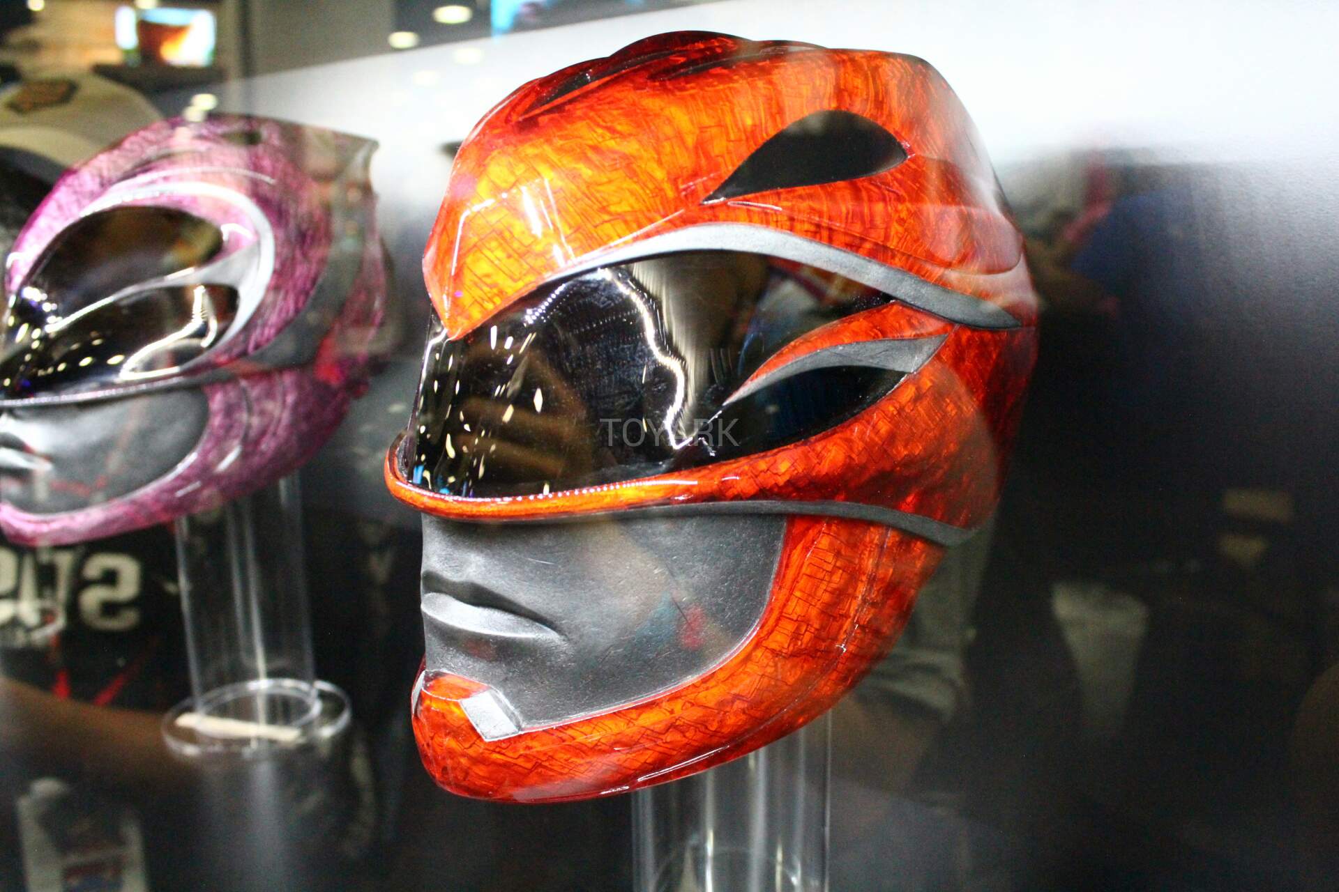

I am trying to replicate the design on the paint job they did for the new power ranger suits. I cannot figure out a way to replicate the pattern. I have tried alternate methods like using plastic wrap. But anyone here have any Idea how to get a very similar look?

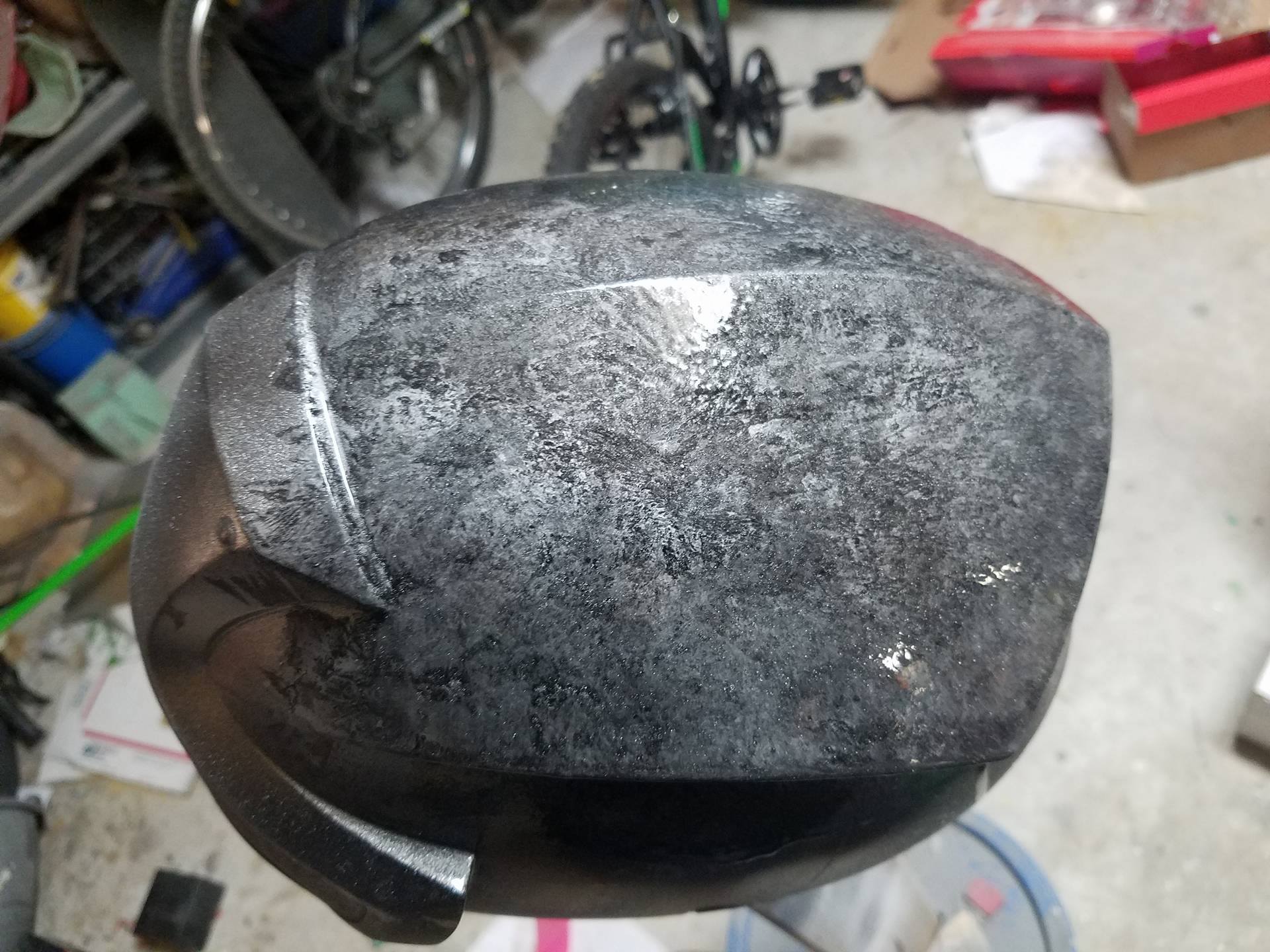

Here is my attempt with plastic wrap.
The closest thing I can think of is marbled spray paint, but thats still just sort of a "close enough"
How did you do the plastic wrap? Im modding a Red Ranger Big Fig by Jakks Pacific and that looks like the best way to add that texture... I know the general concept of the plastic wrap method but what color was applied with the wrap? The lighter red or the darker?

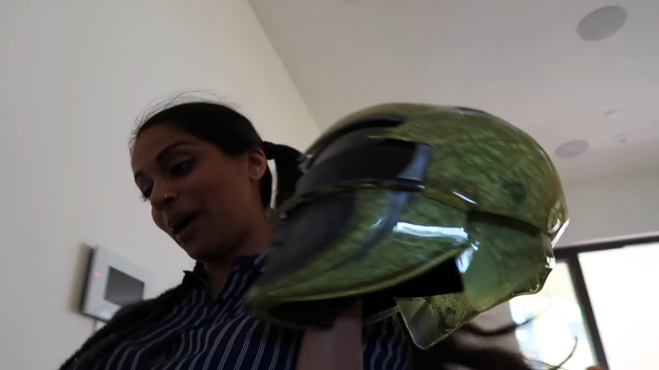

Took a screen shot from SuperwomanVlogs' video on Youtube, and we get a nice shot of the inside of the helmet. You can see the engraved details, and it does look to be tinted translucent resin, maybe someone else can confirm. Lastly, it doesnt look to be painted silver on the inside? Not sure how they made it opaque...
What we meant is that a silver base layer is used, and a candy/transparent colour on top. However, that'd work for /my/ method. For the other method, I'd expect them to lay down the transparent colour first, and then the silver.. It's the same effect through.
Oh I understood that, completely. What I was saying from the screen shot posted above, it looks like it was casted with a clear, tinted resin (yellow in this case) so no candy paint required. Not yellow anyway in this example.
As it was mentioned above by Kylash, I think they made the armour the same way they made the coins, this potenially confirms that theory.
Ah yeah. Sorry, I misunderstood. Too bad the image is a bit moved. I'd love to see them up close..
