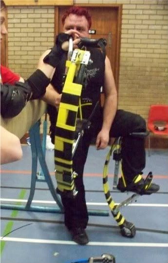

I join this forum has I'm about to make a pair of these boots. These boots are very much like the type of stilts I use which are called Power-bocks ( jump stilts ). We can sprint at over 25 mph and jump over 2.5 meters.
This picture show me wearing test pair called FUSION, normal stilts have one spring, these are the most powerful stilts in the world and could carry three people.
http://img.photobucket.com/albums/v699/Dark-Knight/Bocking/n884665091_5783998_7871-1.jpg
They make these types of stilts in a junoir size which is how I plan to make a pair. The difference in how they work is portal boot spring from the back of the heel where as Bock stilts use the ball/flat foot.
