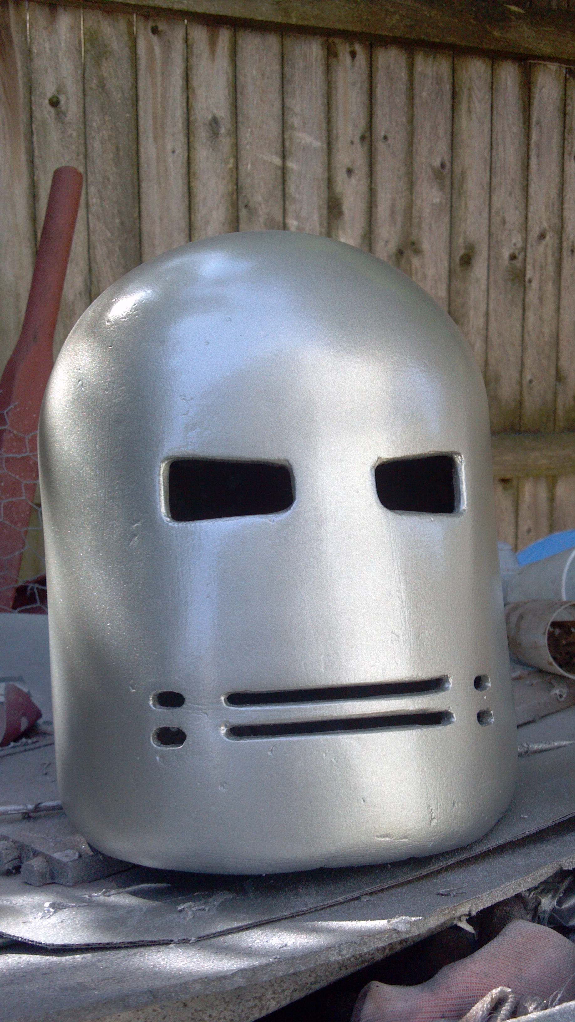

I used this to seal the paper mache and cardboard for this.
Specialty - Triple Thick Glaze Product Page
Sanding a little 'keys' the surface and helps the resin bond better , but you don't really need to sand , I like to, as it gives me the opportunity to fix any blemishes as I go , just make sure you give the paper mâché at least two good coats of glue and let them dry completely before you use the resin , do that and you should be fine
