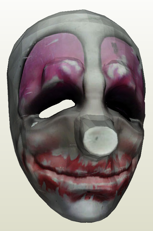

I have some art skill and I weighed out our options in terms of timing, difficulty, costing, and quality of the end result. I really wanted to take the clay molding route as seen here [Harry Potter Death Eater Mask : DIY - YouTube.]. This route seems like the creative professional choice and allows you to really shape the mask as well as recover from any mistakes by adding clay and reshaping. The hard part of this would be working from reference pictures and being able to see the features. The day I was going to pick up the clay, my friend sends me a link from the 405th that a kind soul known as dung0beetle had uploaded, found here [Payday the Heist masks.], for something I had never heard of before; Pepakura files. I draft 3D parts and assemblies for a paycheck, so this program took me 0.2 seconds to understand.

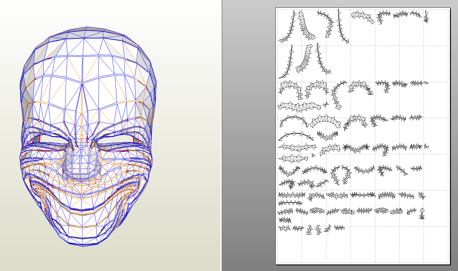

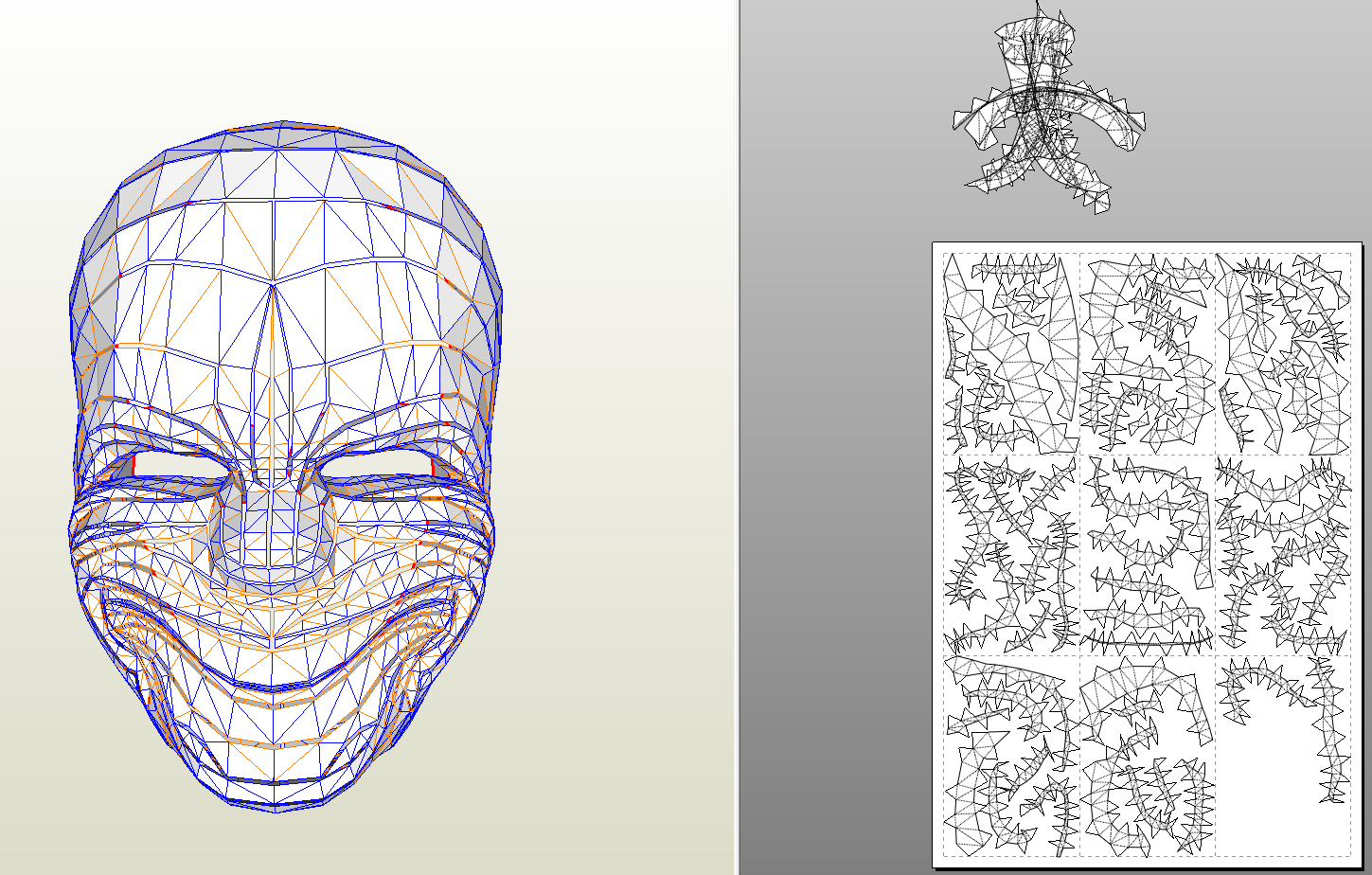

Unfortunately the files were not unfolded and I did not have the Pep read/write software. I bit the bullet, paid the registration and told myself that I would use it more than just this project. I had gone through a few tutorials on how to unfold the masks, found here [Pepakura Unfolding Tutorial Part 1 - YouTube.] and [TUTORIAL HOW TO Unfold projects in Pepakura Designer by Spartansonny.], which turned out to be from the 405th.
If you want some really solid advice for the entire process, please pay a visit to Cereal Kill3r’s YouTube page found here []Cereal Kill3r Studios - YouTube. His videos are not short, but they are not lacking. I needed to watch the scaling tutorial once I had printed a page with a few pieces and noticed how small the mask would have been. I had glued maybe four pieces before saying “this mask might fit a baby.” I’m still considering that one.

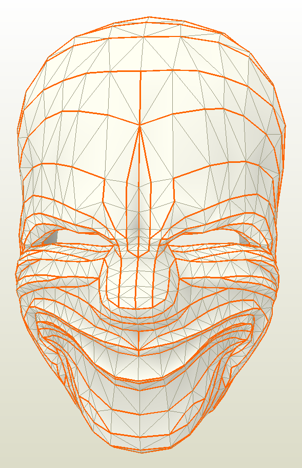

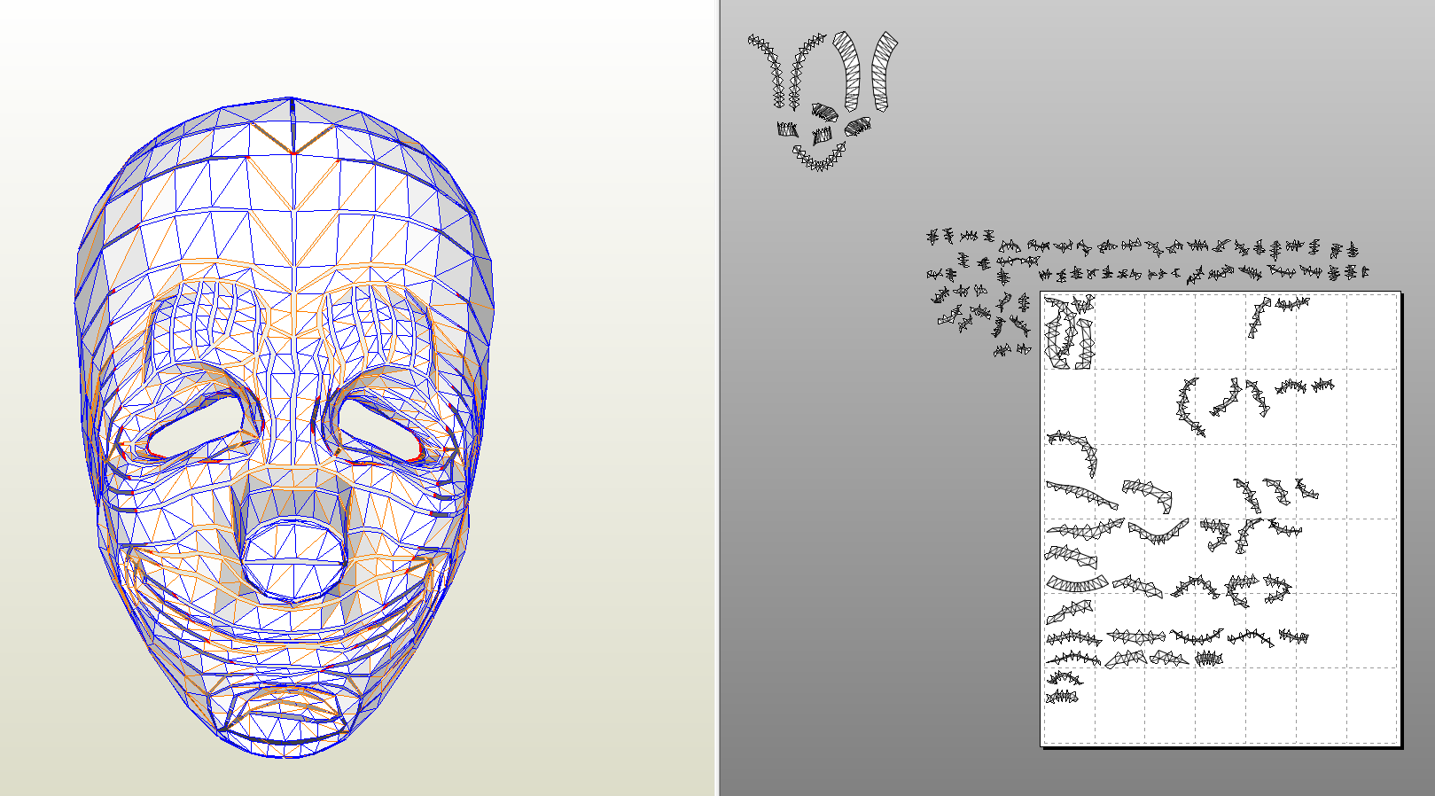

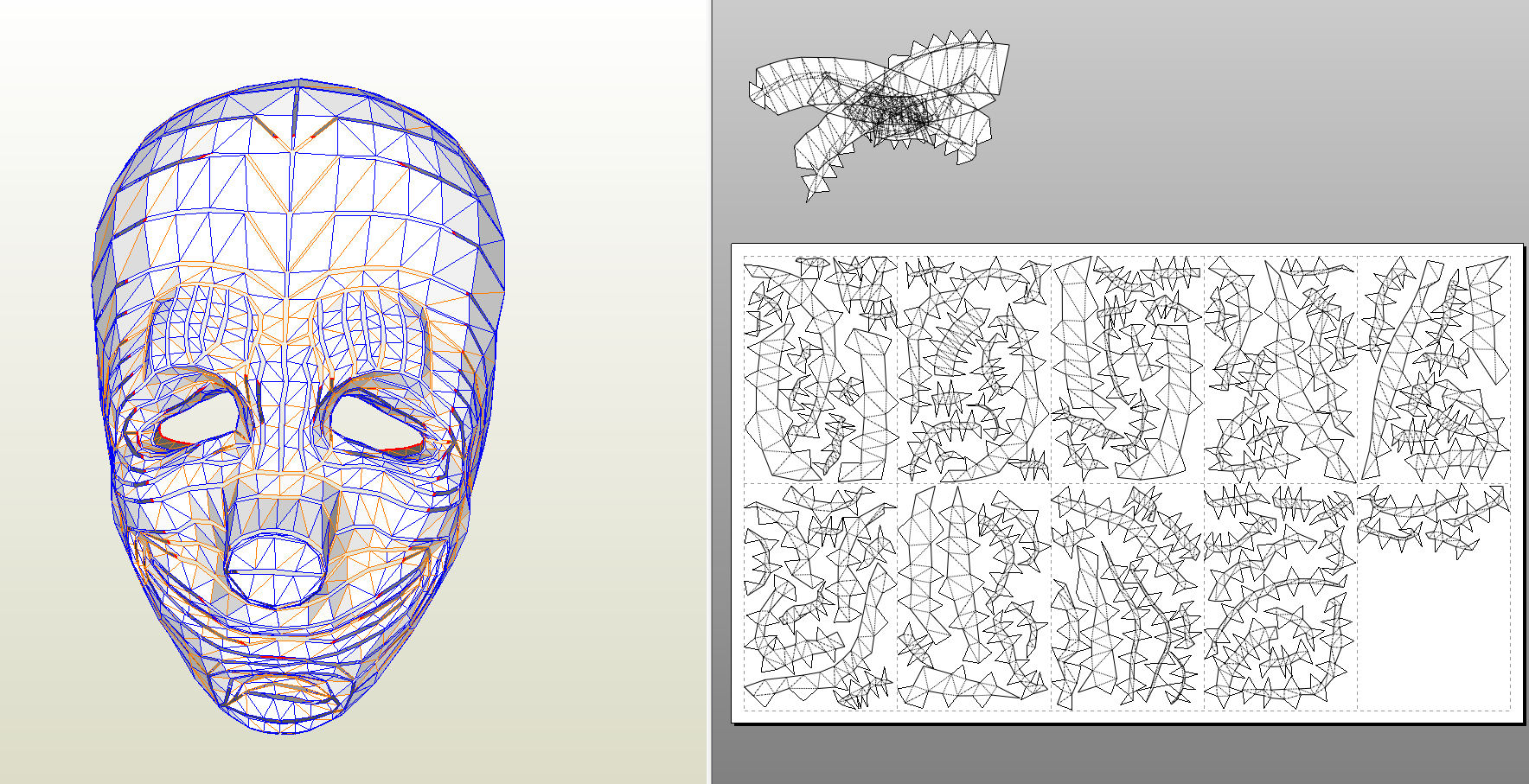

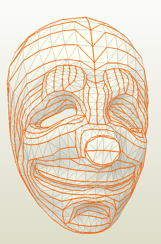

Okay. I knew how to unfold and scale the pep files. Unfolding does take a certain visualization to have a controlled unfold. Having a piece too large will result in conflicts ridge folds. Below you can find the finished unfolding (cut) lines for both masks. Some pieces were too large to fit on the card stock so additional cuts where created (mostly the mid line cuts).
For those that have experience in pep builds, please note that this was my first and after getting knee deep I realized that I had no idea how time consuming this would be. Spartan armor looks like cake to me after this. Once the mask was really unfolded, I realized I would need to nest the pieces somewhat efficiently. I have experience nesting parts on sheet metal for laser cutting, so I don’t have a tutorial. My advice is to try different pieces and rotate and bump things around. Put your big pieces and start filling in the spaces. Sometimes the tabs from the same piece will overlap so adjusts can be made switching which side of the edge the tab is on as well as the size and shape. Outside of ensuring no major overlap, I did not adjust much. The before and after nesting images are below. Note that the pep file had ‘trash’ pieces that would not benefit the mask.

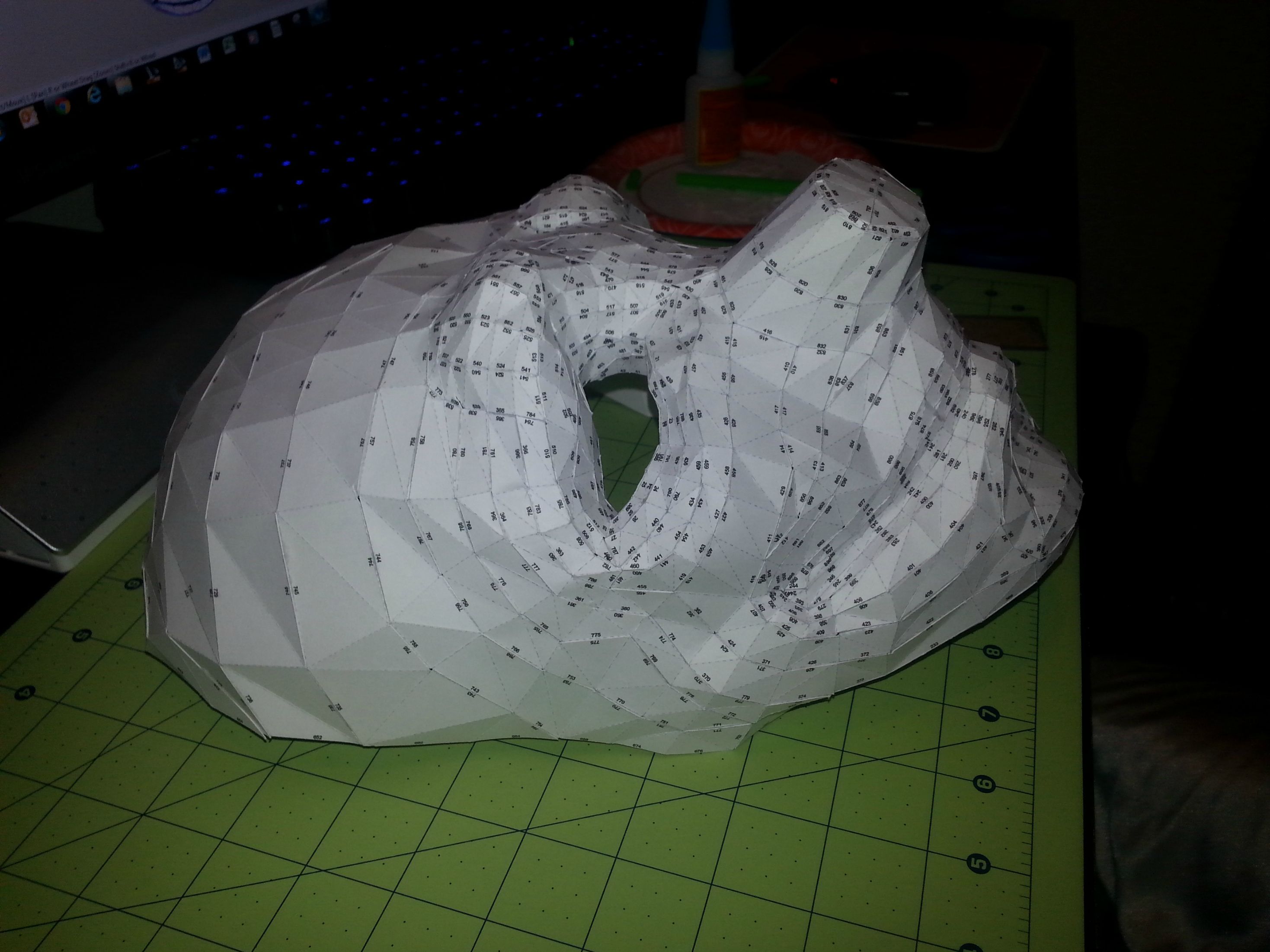

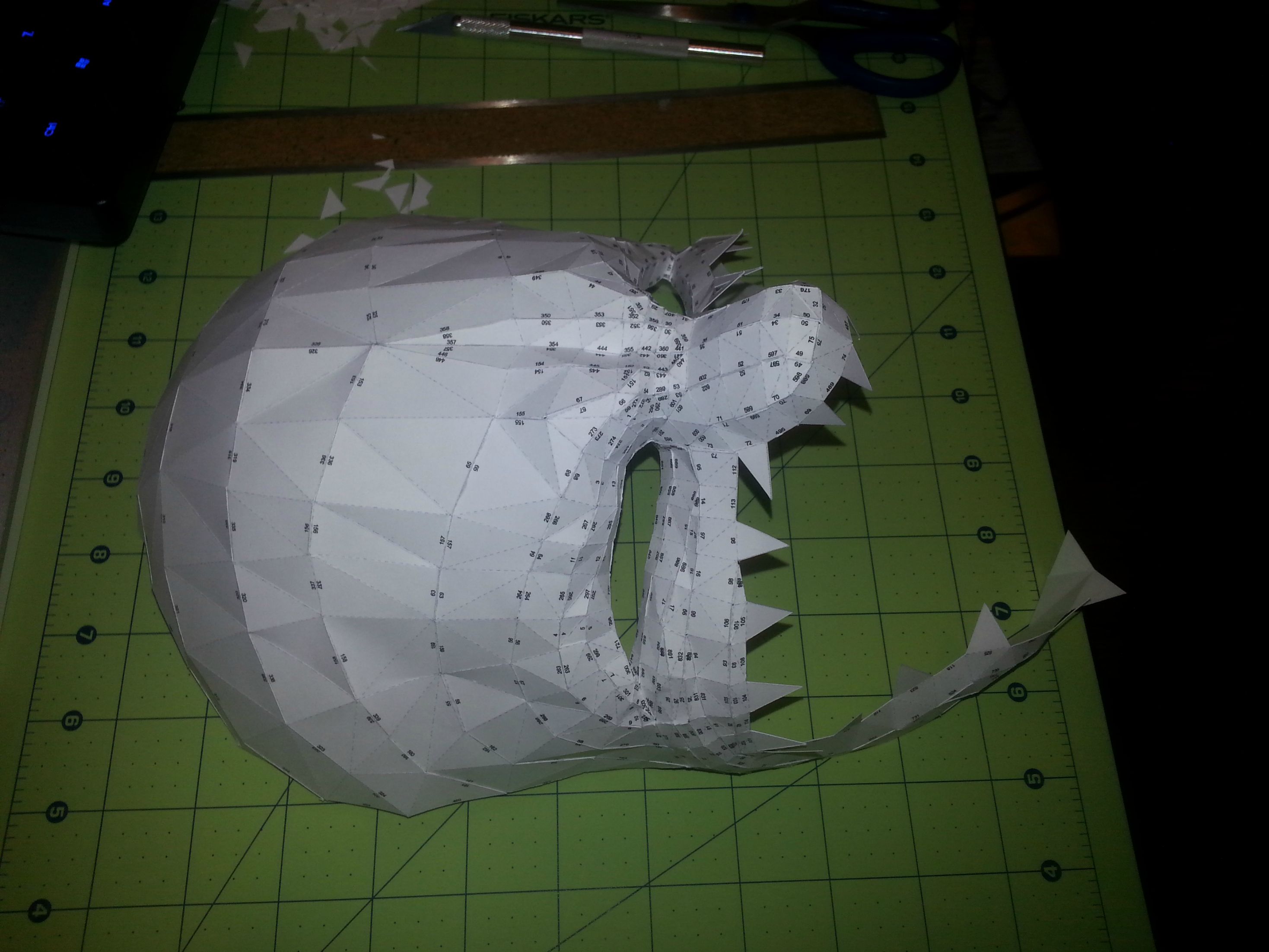

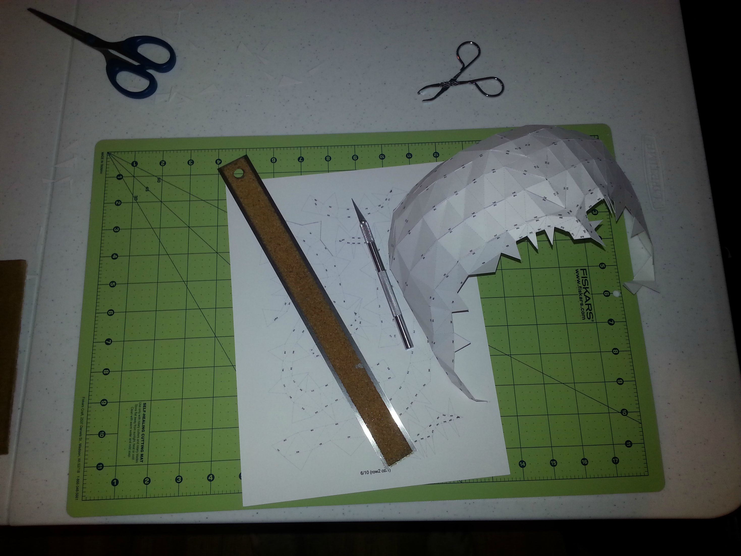

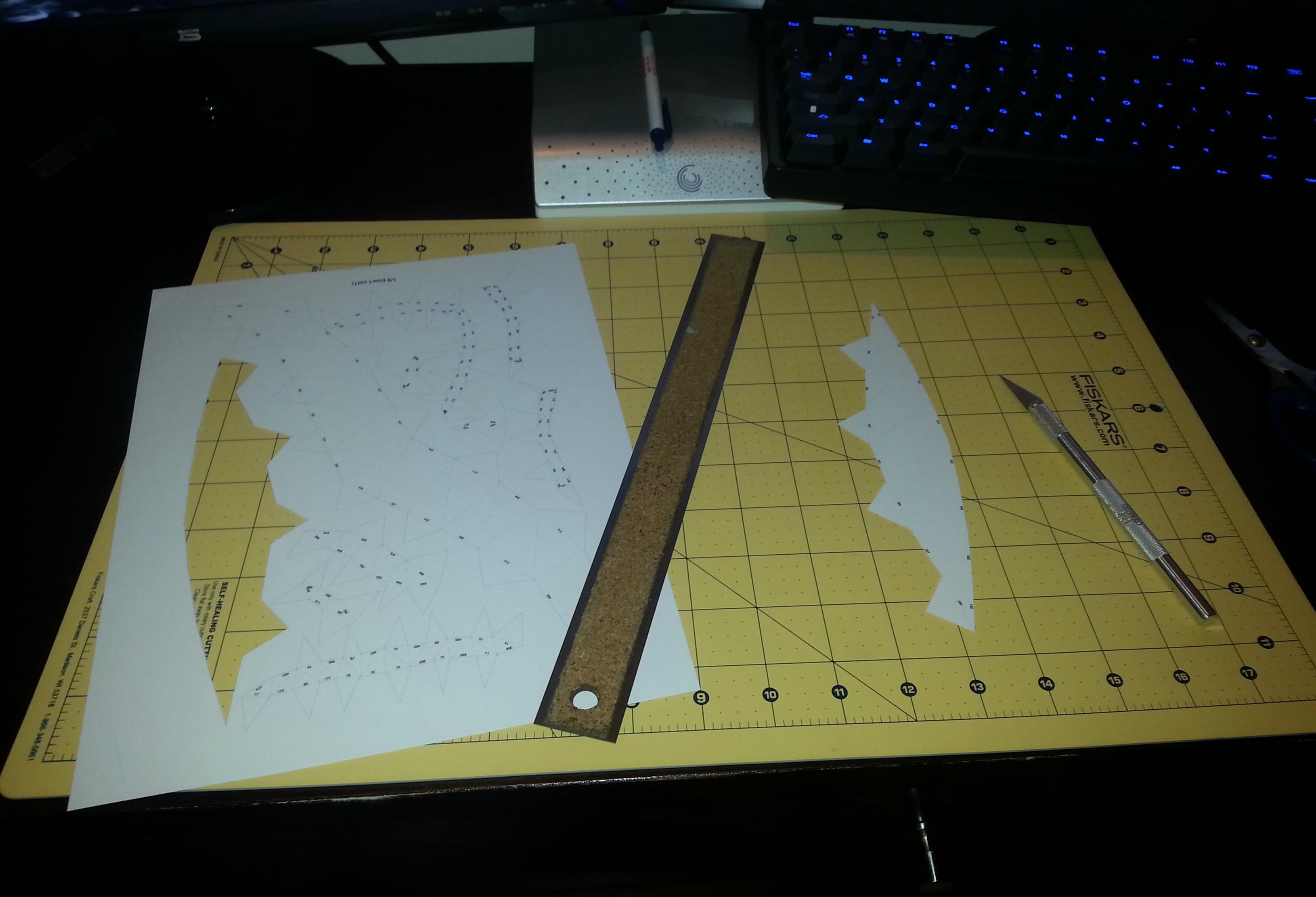

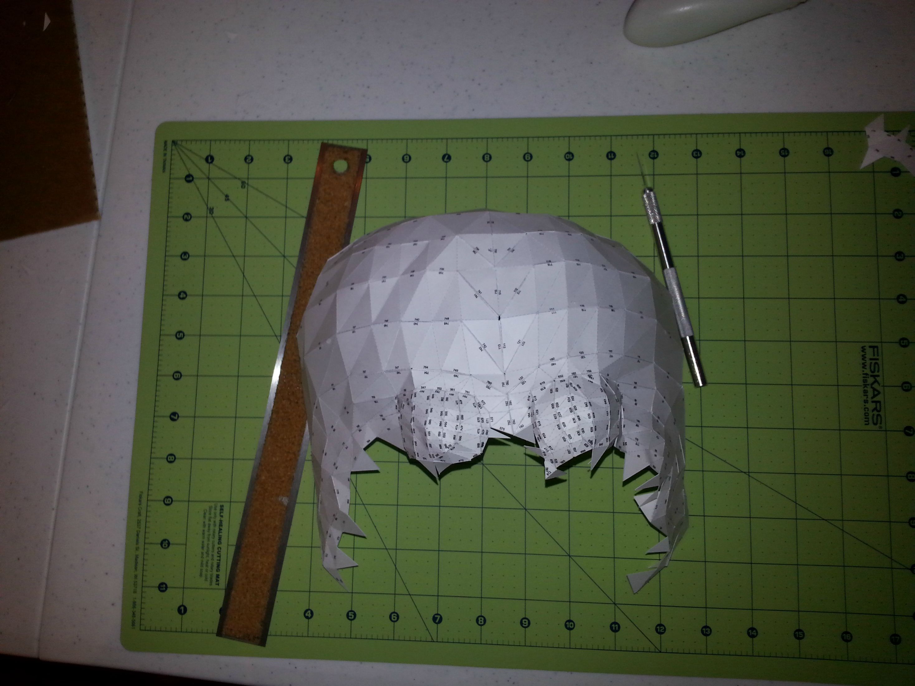

So this was the beginning of a two week ordeal that involved a raw spot on my finger from the utility knife and super glued fingers. Please refer to the tutorials to find your own preferred method of pep construction. Since we did not adjust the tabs, there were lots of cuts needed to keep the tabs from overlapping the folds on the opposite side.
First piece cut
How the first 12 some odd hours were spent
Those drinks were tasty. +1 for those who catch the time difference

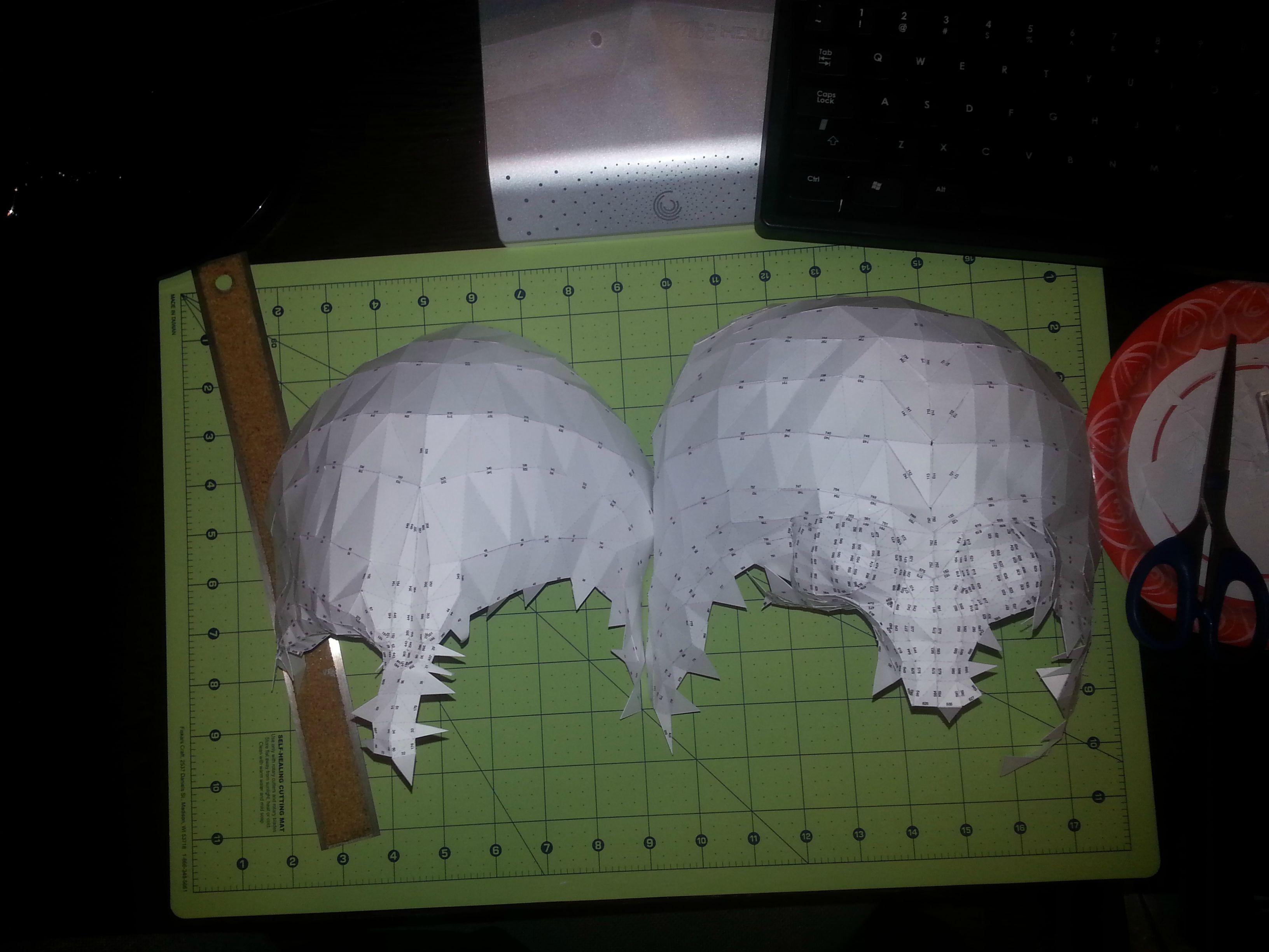

Remember those cut tabs I mentioned. EVERYWHERE. I’m still finding them in random rooms
Due to the time frame, I was spending an average of four hours a day working on this after work and full days on the weekend.

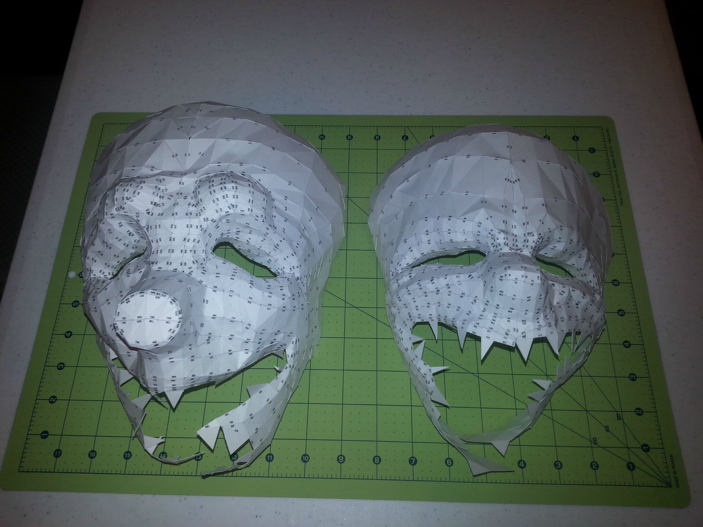

Most of these photos were taken at the end of the night after working for several hours
This was slightly terrifying to look at with the shark teeth tabs.

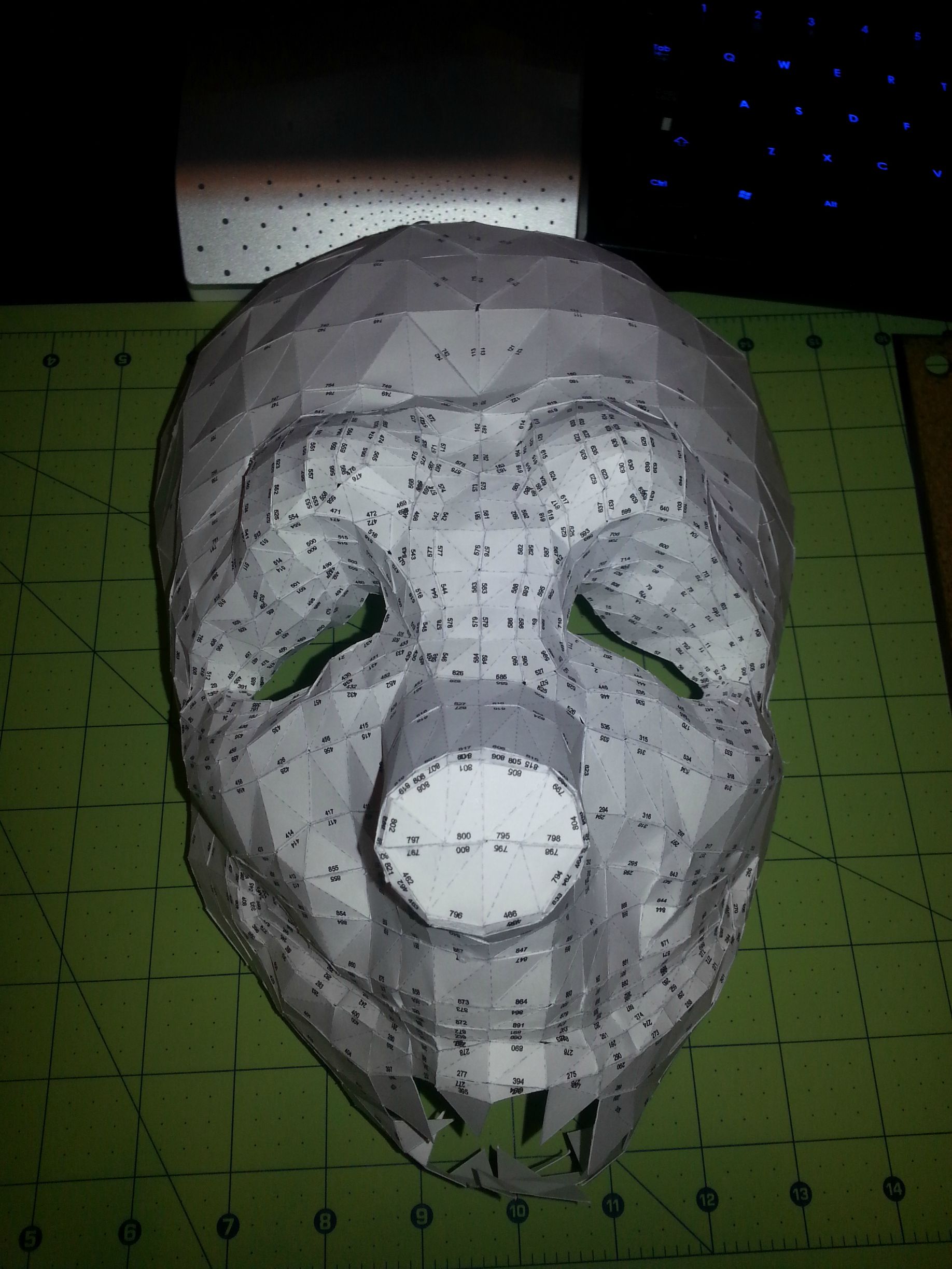

This was a glorious moment. My mask finished
Finished my friend’s mask early one morning. Before work. Two hours sleep. Schedule. Needed finish.
Pepakura is ****ing awesome for testing your patience and gluing your fingers together under the guise of building parts. I’d say I’m keeping an eye on pep, but I’m tired of looking at triangles for a while. Seriously, two masks took two weeks for just the pep. Do not expect to rush this process. Make sure you align every line and numbered edge. Pro tip: Dry fit each edge before applying glue. Pro Tip Addendum: Cut all the tabs during the dry fit.

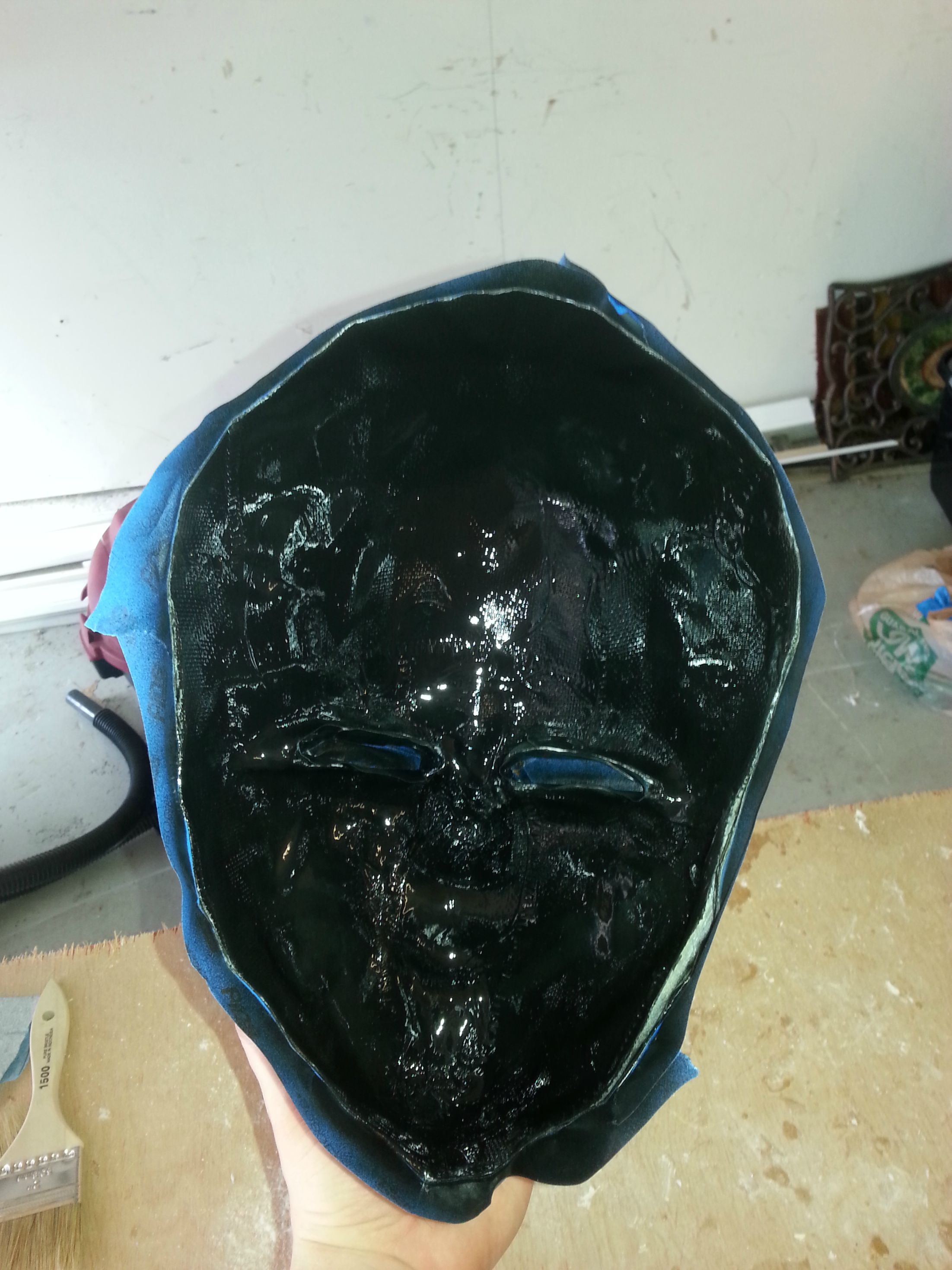

The next step in the process involves strengthening the card stock and glue. This was a multistage process and after searching through multiple forums and tutorials, I picked the repeating pattern.
Straight application of resin (Polyester/Fiberglass Resin; see Epoxy Resin as alternative) to the inside and outside. Apply fiberglass the outside. Finish with body filler (Bondo) on the outside.
There are plenty of methods and theories on how to take the pep build to the next levels. Research and pick for your application. Another noteworthy method is Rondo which is a Resin and Bondo mix.
Prepping for Resin Coat
If you notice the breathing mask, good. Use one. Organic filters. Fiberglass resin is funky stuff and you shouldn’t breathe it. Safety is not something that should ever be sacrificed. Gloves are smart. Safety glasses are for the one-off splash.

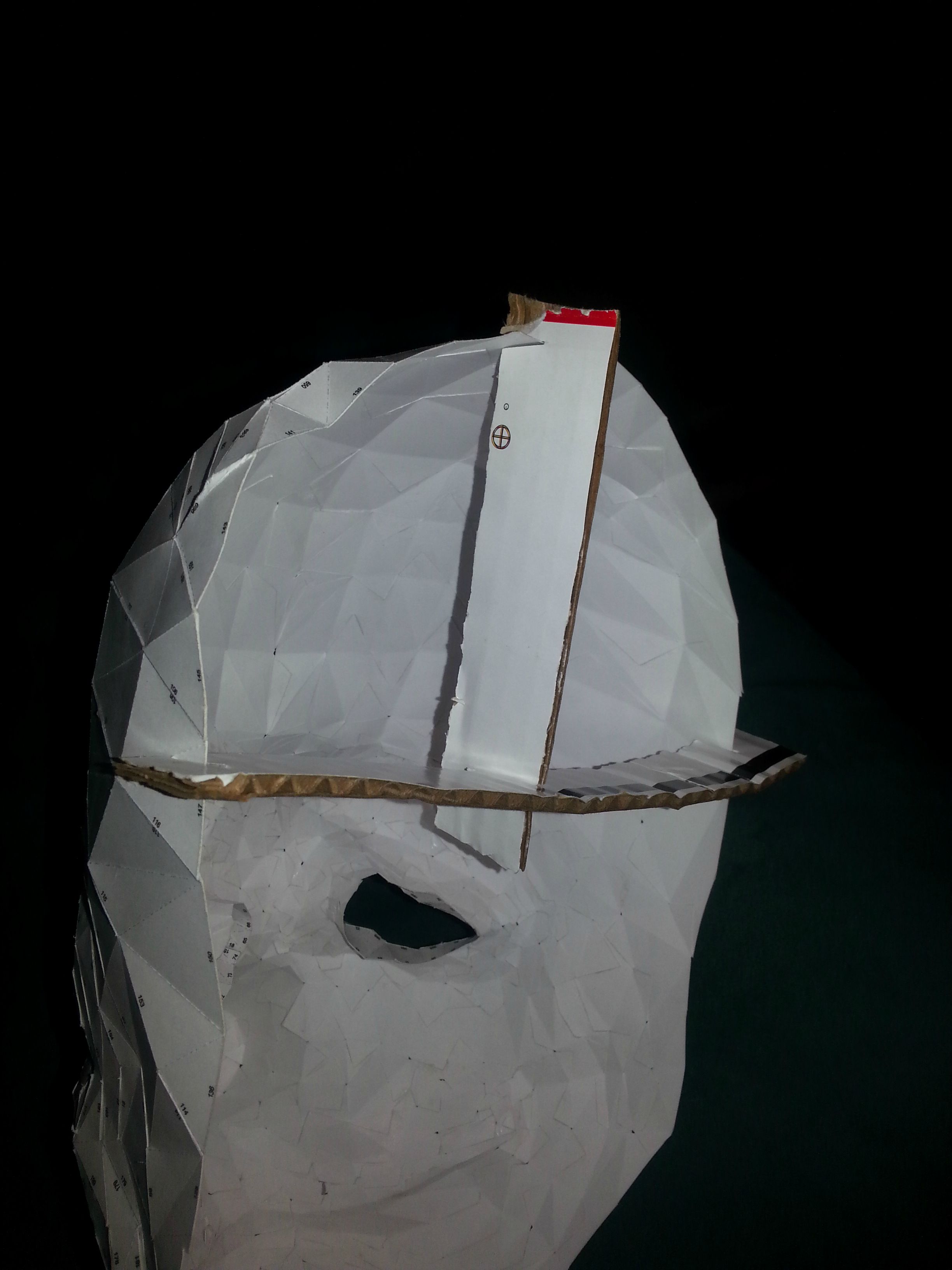

My first issue was the flimsy nature of the foreheads. There were not many edges to hold the shape. One mask in particular was manhandled a bit much and was slightly deflated looking. Knowing that the resin would cast the hardened shape, I needed to make a spacer that braced the forehead into the correct shape with some degree of accuracy.
It’s my understanding that most released pep files come with some reinforcement pieces to prevent MacGyvering your own supports. Give me office supplies and I’m unstoppable.

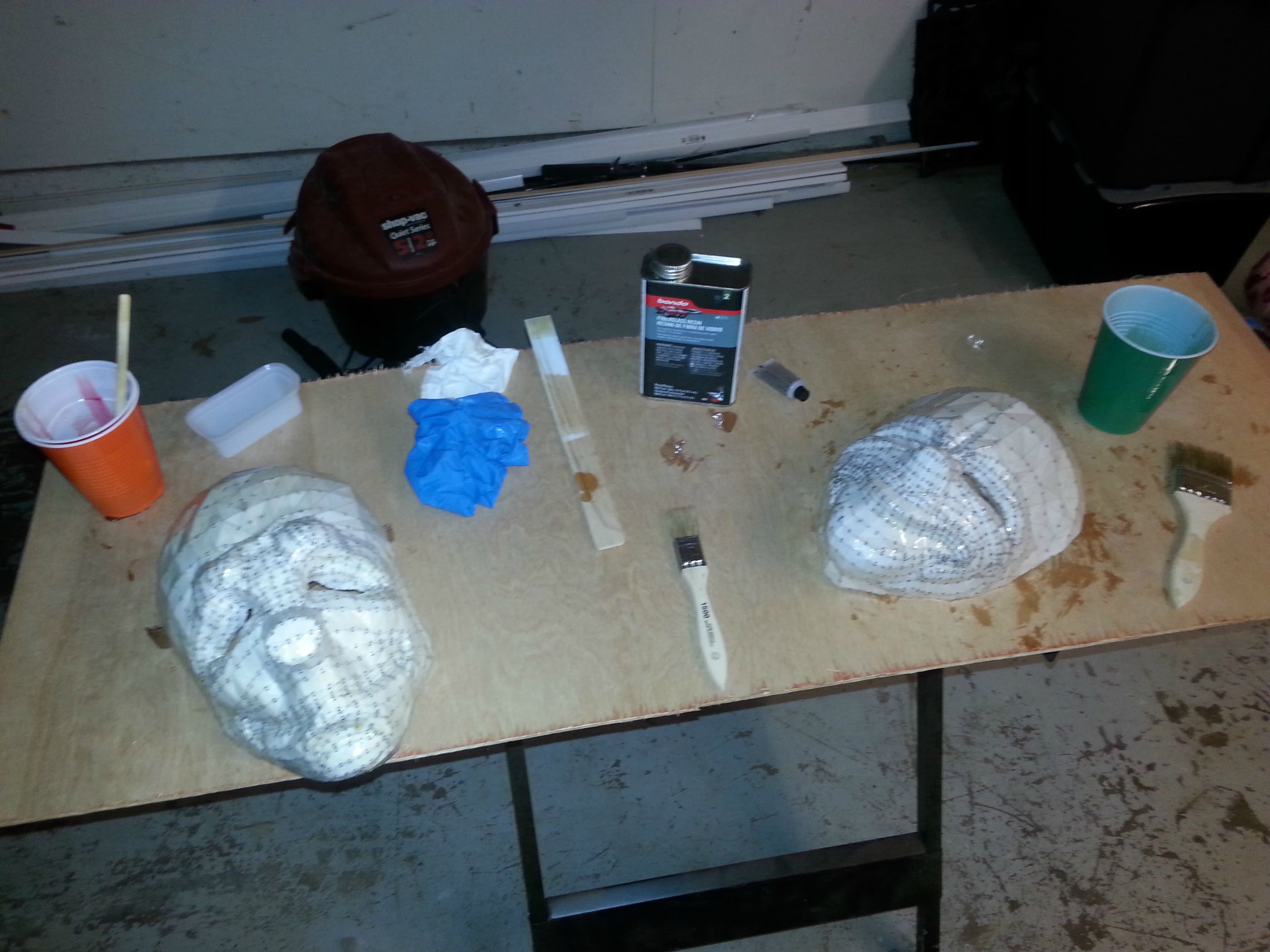

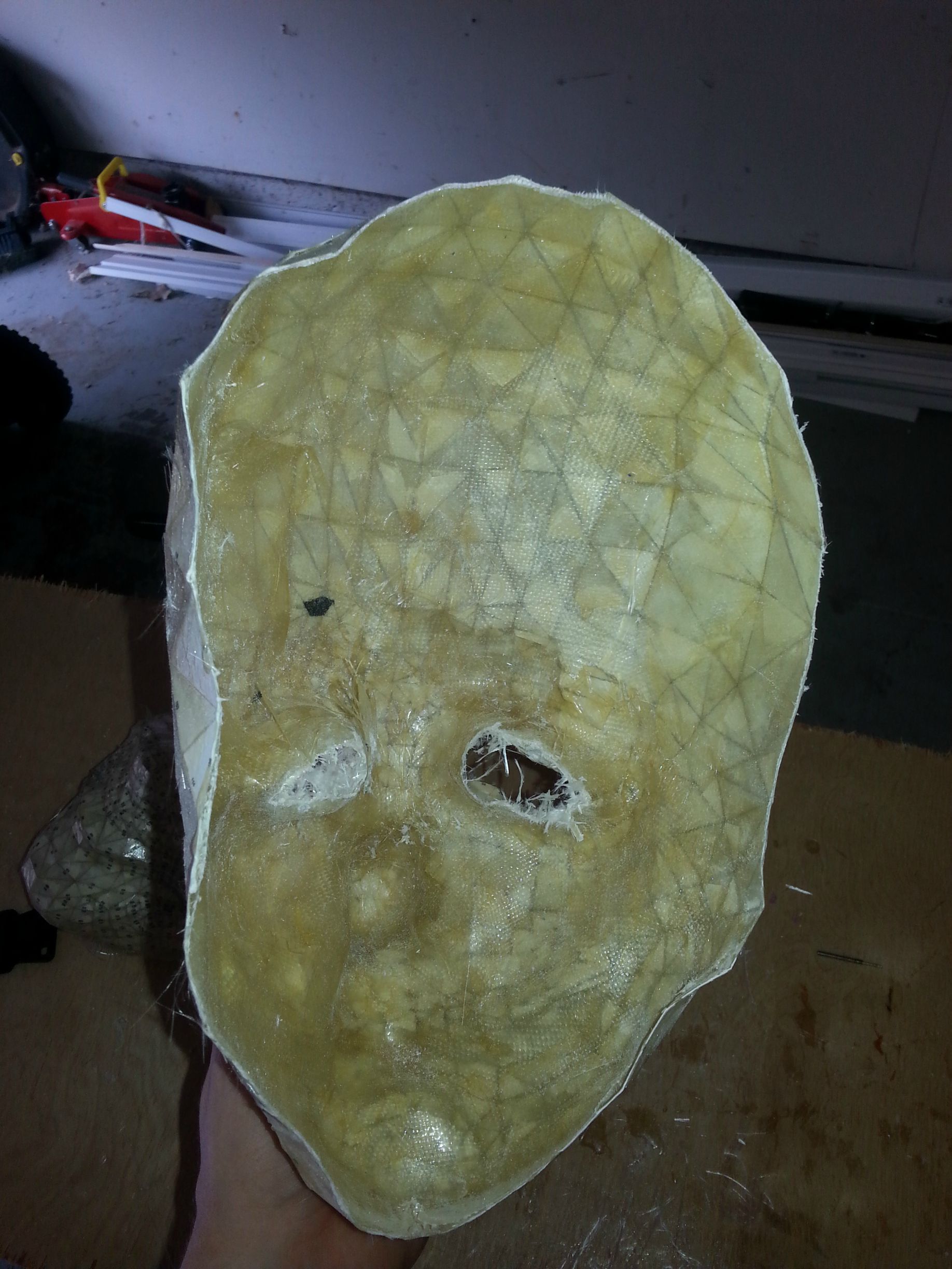

Time to apply the resin. I worked with one ounce of resin at a time using 9 of the 10 recommended drops of the hardening solute. This did make the resin slightly tacky when cured, but there are ways to address that. My excuse is that I needed the extra time.
I did not waste any resin (minus the resin on the board). I picked each cup clean with the brush. Better to need more and not have it than have it get wasted. I don’t recommend using these cups. Even a little bit left in the cup will lead to the curing resin heating up the plastic to the point of melting.
Shiny resin coat applied to outside

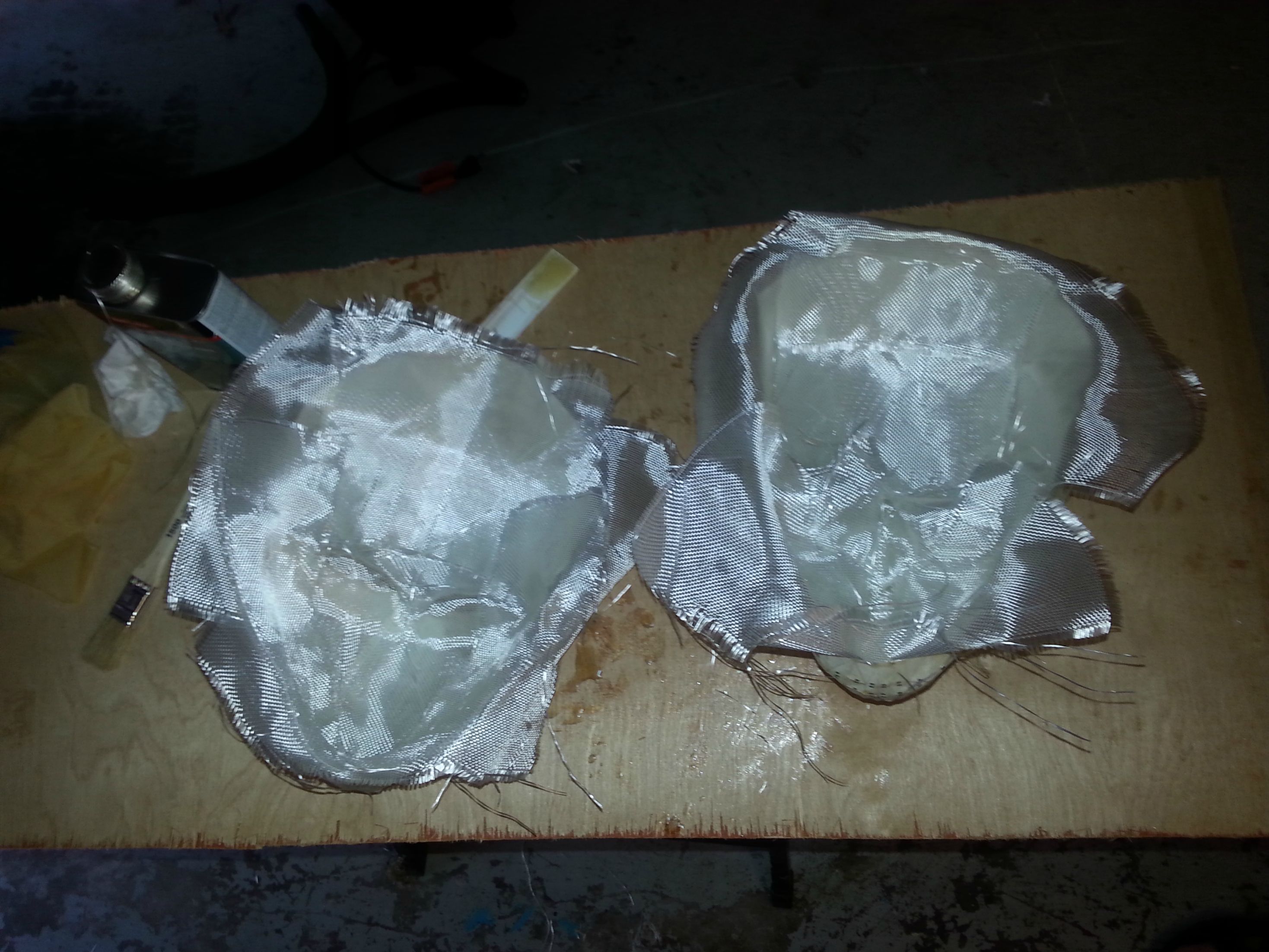

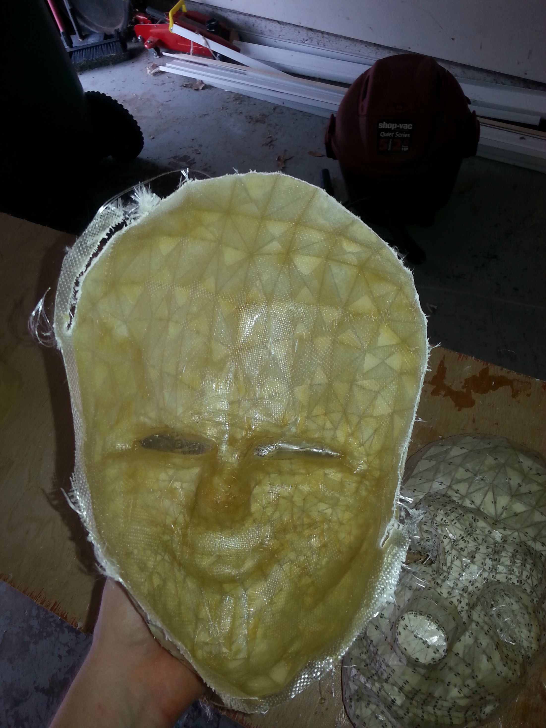

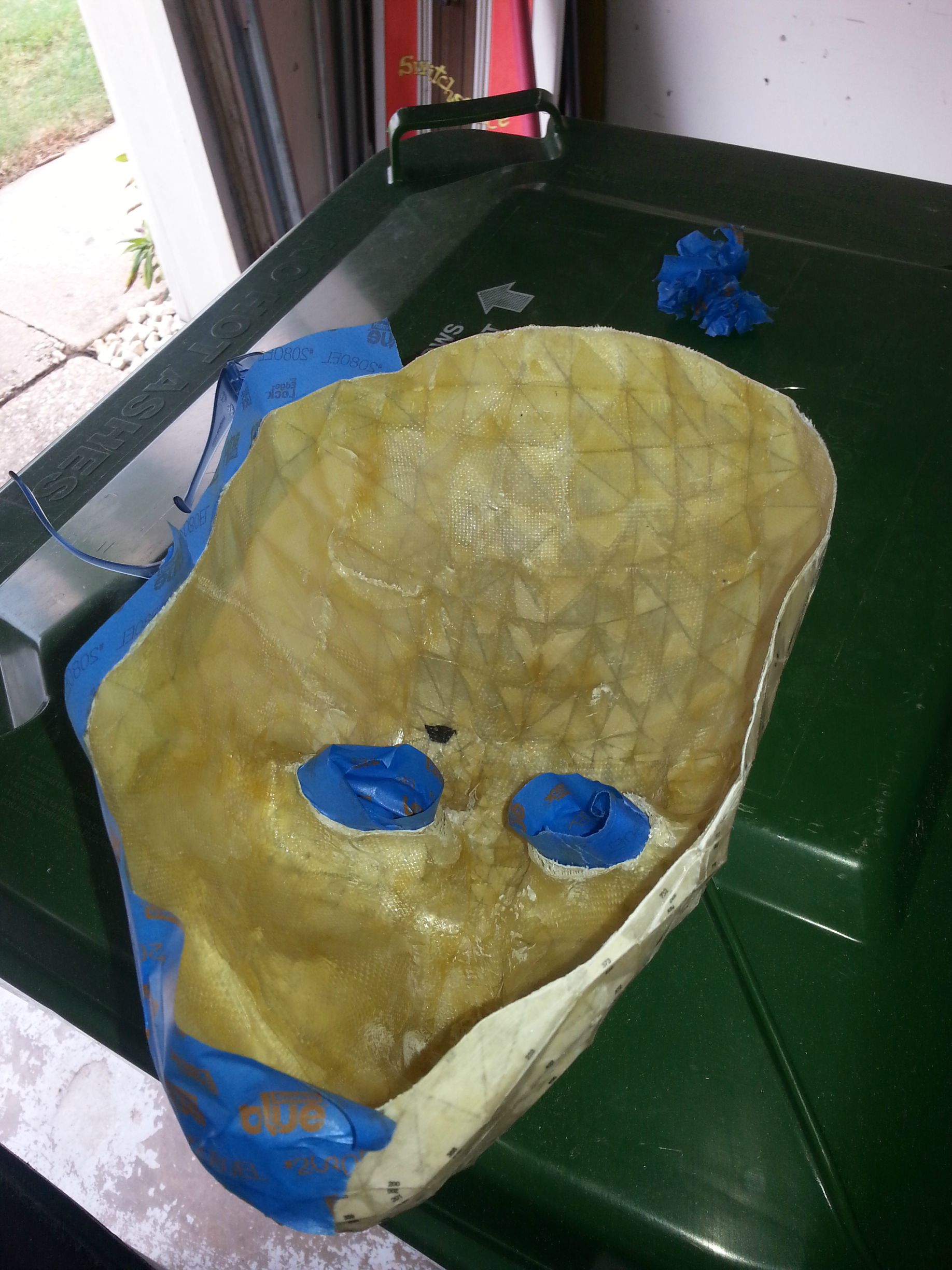

Once cured, I applied the fiberglass. We had fiberglass cloth. Until proven otherwise, I think fiberglass mat would have filled the inside of the masks more effectively than the cloth. Cutting the cloth into smaller shapes and overlapping was a tough. Kinda like twisting a bunch of firecrackers together, hoping they stay together and lighting the fuse. It’s more prep time than smothering the fiberglass with resin.
Try not to coat over openings too much but don’t skimp around the edges. The fiberglass and resin will need to be cut out. Likely with a rotary tool (Dremel). When applying the coating to the fiberglass, be aggressive and push the resin into it so you minimize bubbles and gaps to the paper.
When the resin cures, you get to cut the excess off. Pro Tip: COVER YOUR SKIN. Like the suits we were wearing earlier. Especially if using a rotary tool. Anyone who has worked with fiberglass can attest to that ****ty, ****ty itch when the stuff gets in your skin.
I didn't think I was getting any on me
WRONG
I ended up using duct tape like I was getting cat hair off my clothes. Except this was glass. In my skin. I hate that itch so much.
We had to buy another tapered bit to get the eyes cut out after the fiberglass ate the first bit. I don’t have much advice here. I imagine cutting bits work better for the major work. I used grinding bits for the shaping. I’m still open to advice on this.
For reinforcement, this was about done. Cleaned up the edges and the work area.

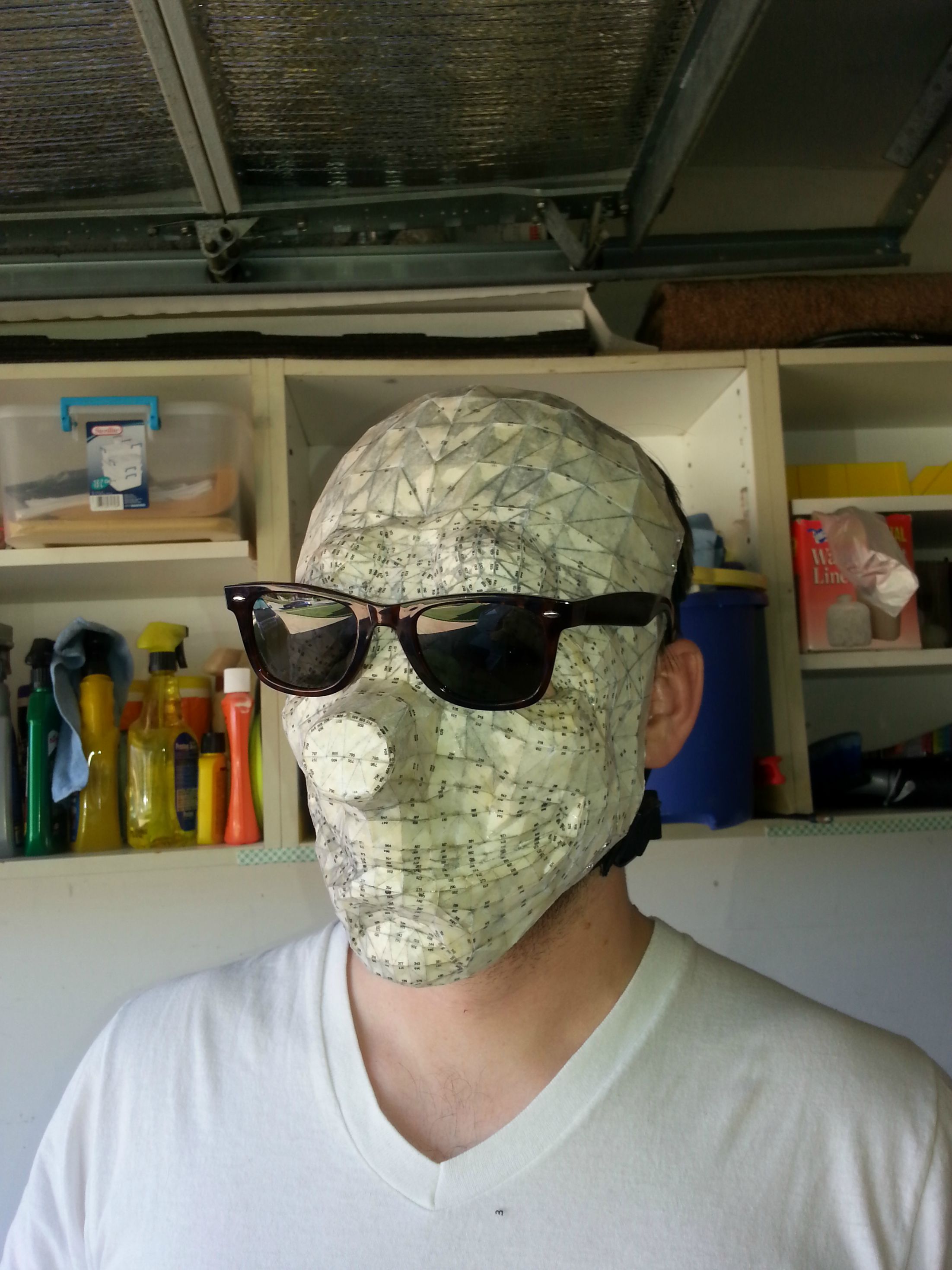

After the fiberglass was finished we taped the edges to prep for spraying the inside with Plasti-Dip. No way I was going to put the fiberglass near my face. This also would give the inside of the mask the correct color
The Plasti-Dip soaked into the fiberglass grid so we need a few coats

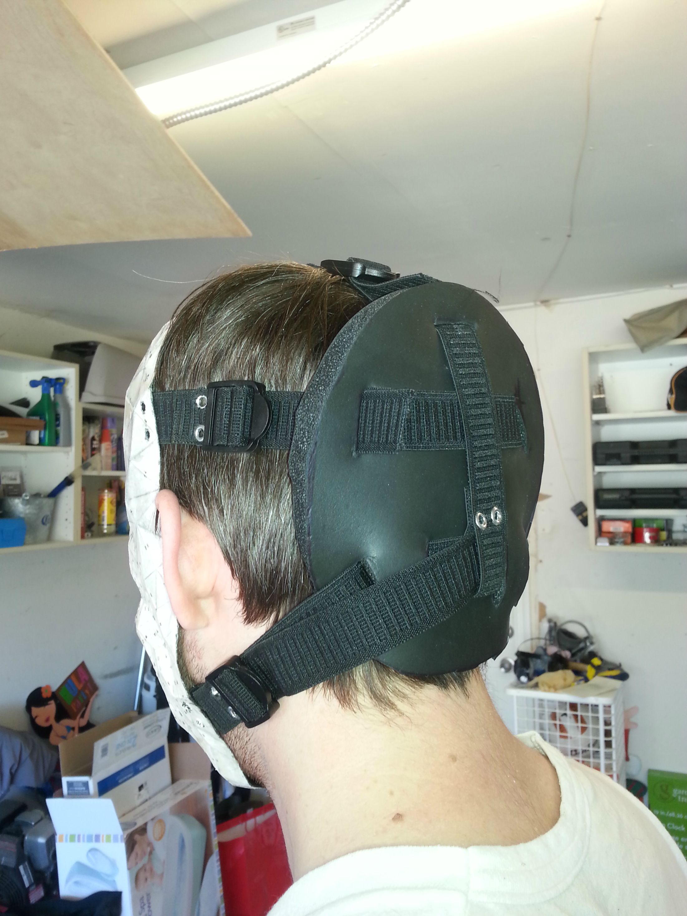

The next step was to attach the straps that connect the back plate to the mask and hold it to our head. The final verdict was to use grommets. Using black elastic waist bands for the straps, we cut the holes for the grommets side by side and marked the masks at specific locations on the mask.
Here we drilled the spots for the grommets on the masks
The elastic bands gave me some grief when facing the same direction when attached to the dead end of itself. So it flipped the grommet direction
After destroying my thumb pressing grommets into holes, we finally attached the back plate which was a foam seat cushion much like a cheap gardening knee pad. This was really a settle since we wanted to use plastic but had trouble finding something and time was short. My friend considered getting into character by stealing a back plate from a catcher's mask but decided against it.
First hands free fit
This was a milestone for us and we could see the light at the end of the tunnel

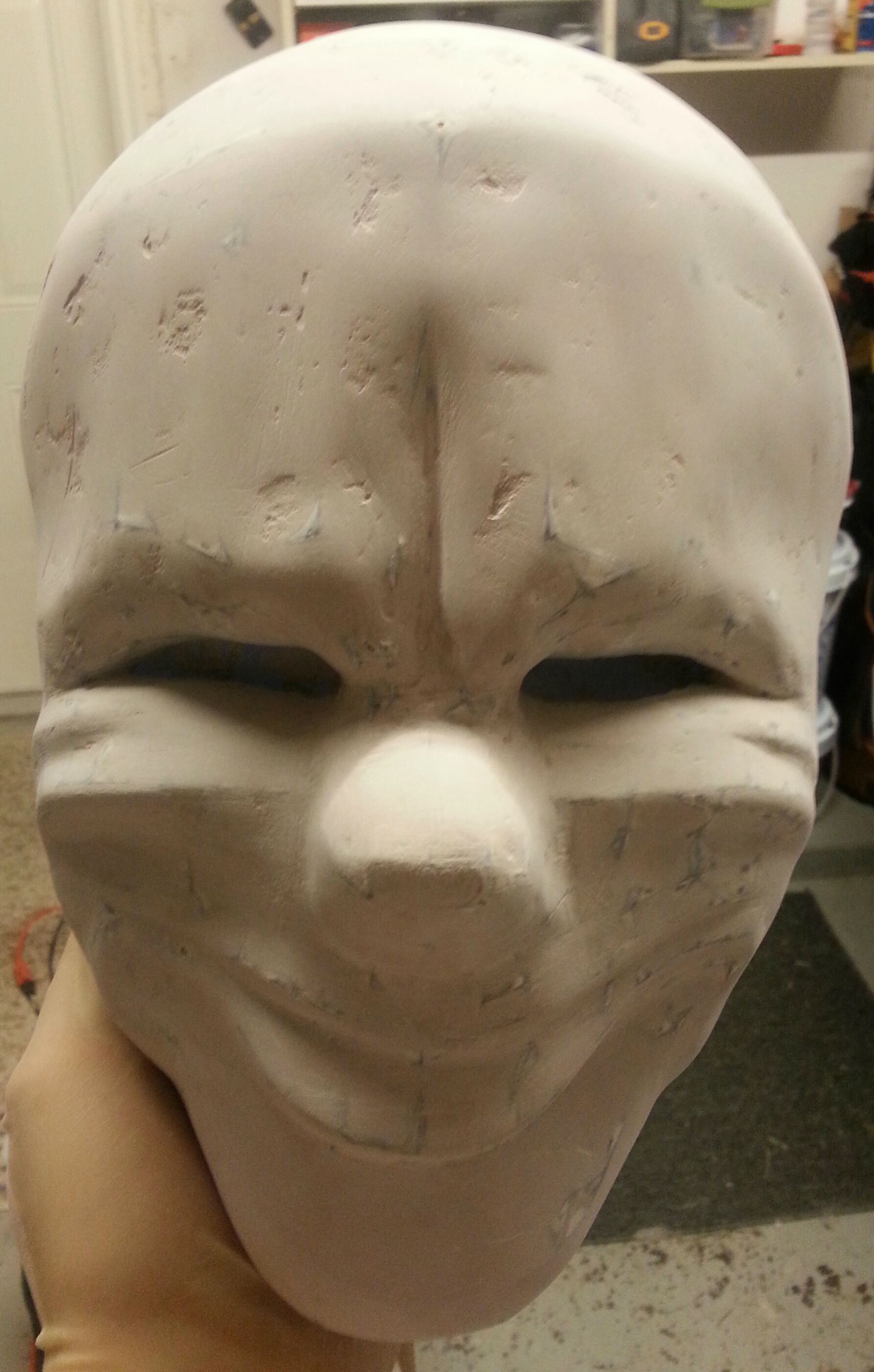

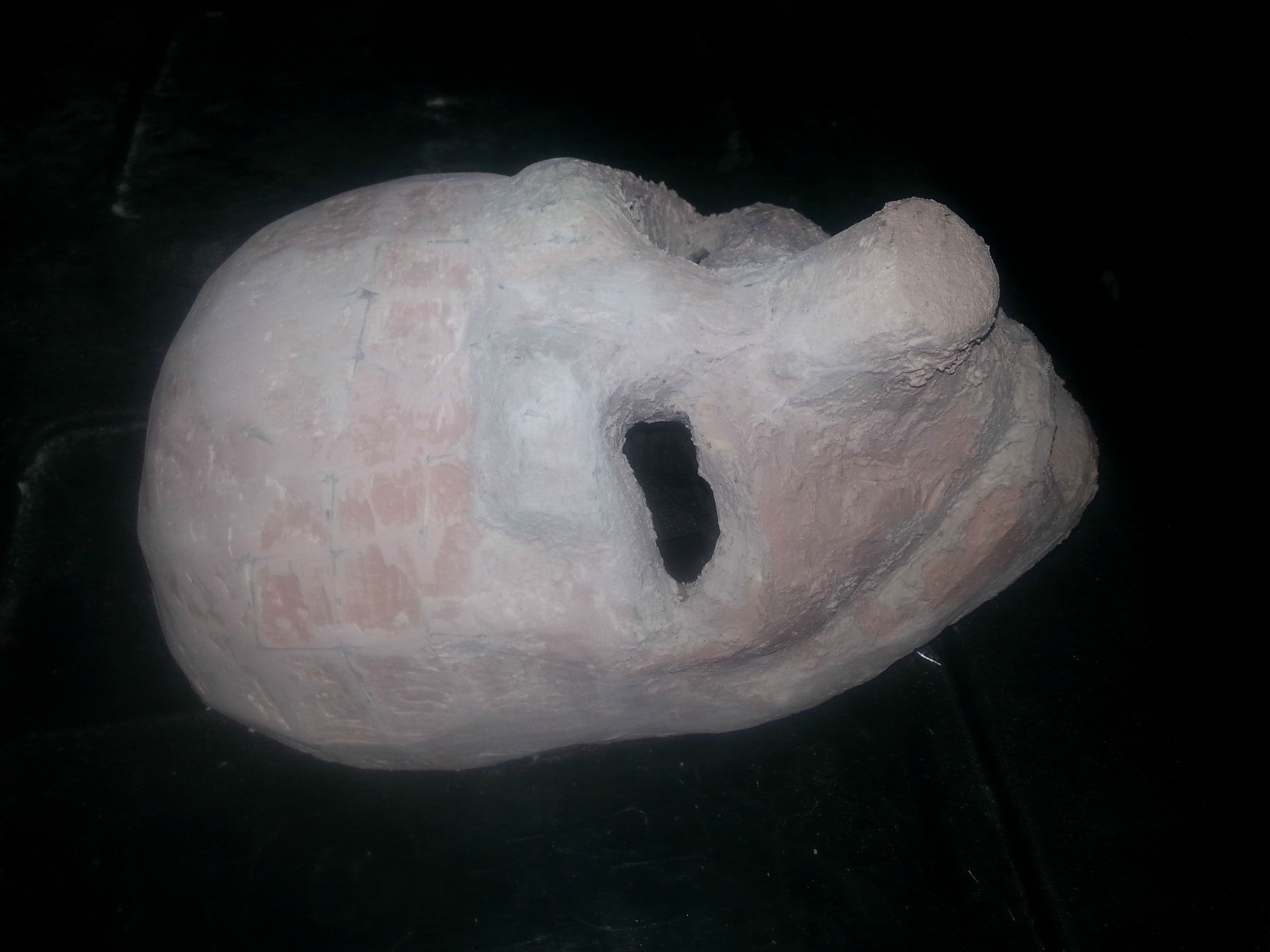

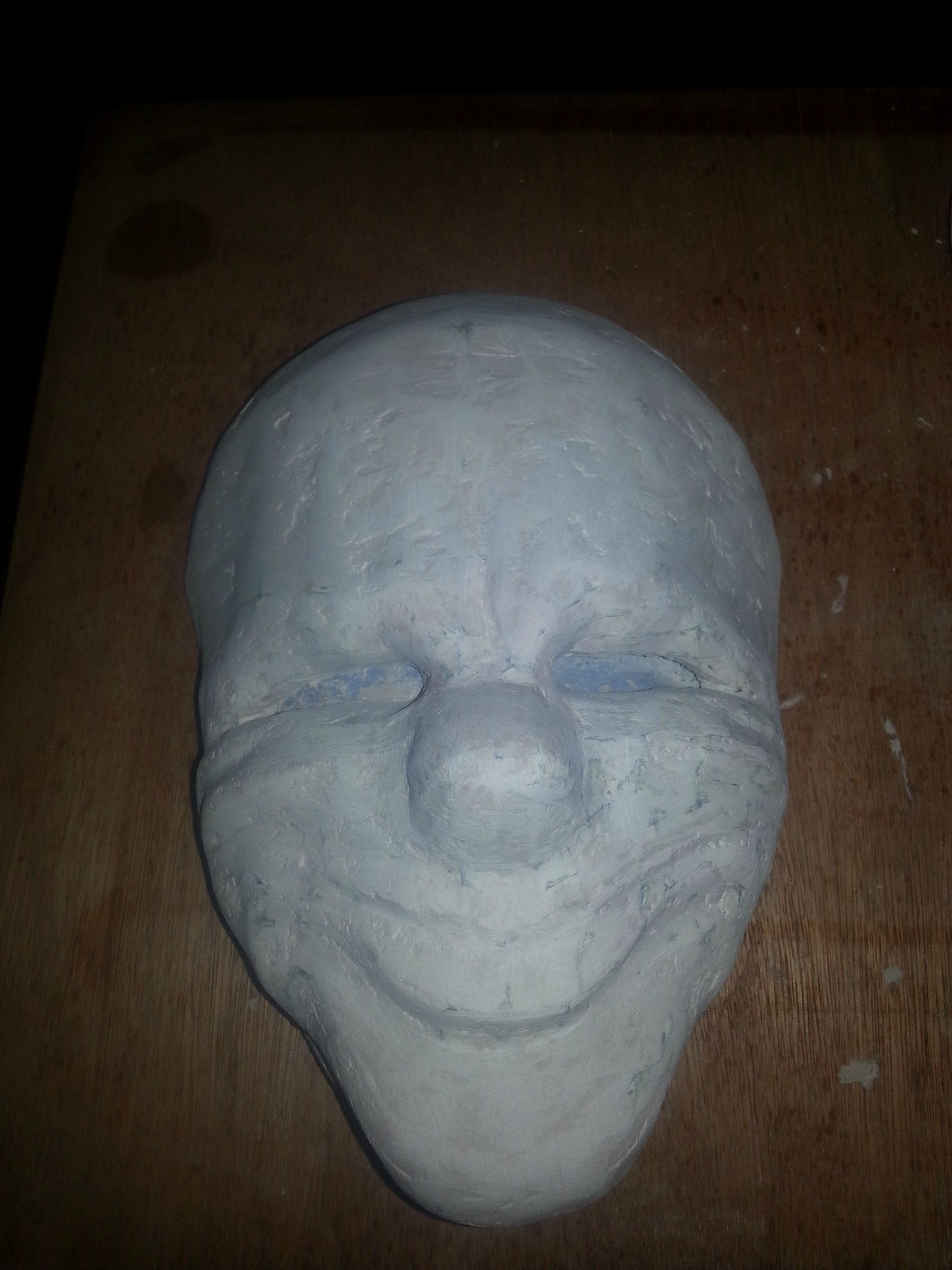

The next step was applying body filler to the outside of each mask. This stage, in my opinion, is critical. After going to the con and seeing some bad surface jobs, I found a respect for this part of the project. Please dig through the tutorials. Use the body filler applicators and cut various sizes. You’ll need them.
We started by sanding the edges of the geometry down. Enough to smooth it out but not break through.
Key point of advice on this is to plan each application. Before you grab that gooey sludge, think about what area of the piece you’re going to work on. Like the resin advice before, do not try to overextend. Completed small batches trump large batches that end up with waste.
Our masks have quite a few details to work around so this stage took some time.
We took a few batches to get the ratio and timing right for the body filler and the hardener
My friend was the the first to test the body filler and hardener ratios. We learned what was too much quickly.

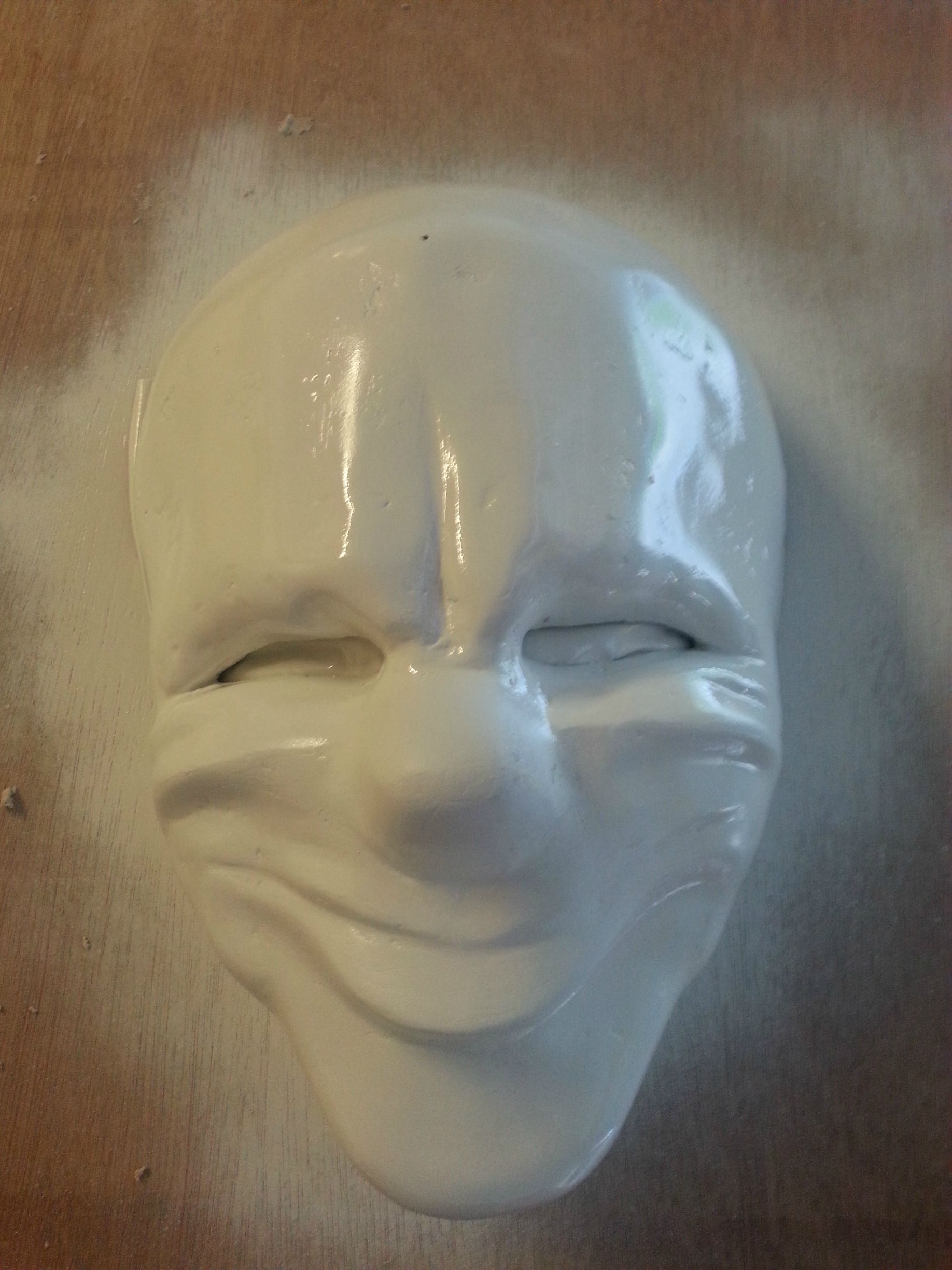

Here are the two masks with the first coats done
After the filler cured, we shaped the first coat with 60 grit sandpaper. We did not have the choice to use flat sanders. When the rough edges were knocked down and the major pits and protruding corners identified, the second coat of filler was applied.
Again, we shaped the masks with a 60 grit paper being very aware of where pressure was placed on the sandpaper and on the mask. I ended using the round of my finger and the folded abrasive edge of the sandpaper to my advantage quite a bit. After the 60 grit, I moved to 120 grit to remove the major scratches and then 220 grit to really smooth out the areas that didn’t have battle damage. To achieve a perfect smooth surface, spotting putty can be used for the touch-up, but we opted for the "experienced" look.
You can see some of the paper still showing but the surface is rounded and smooth. Trust the feels of your fingers.

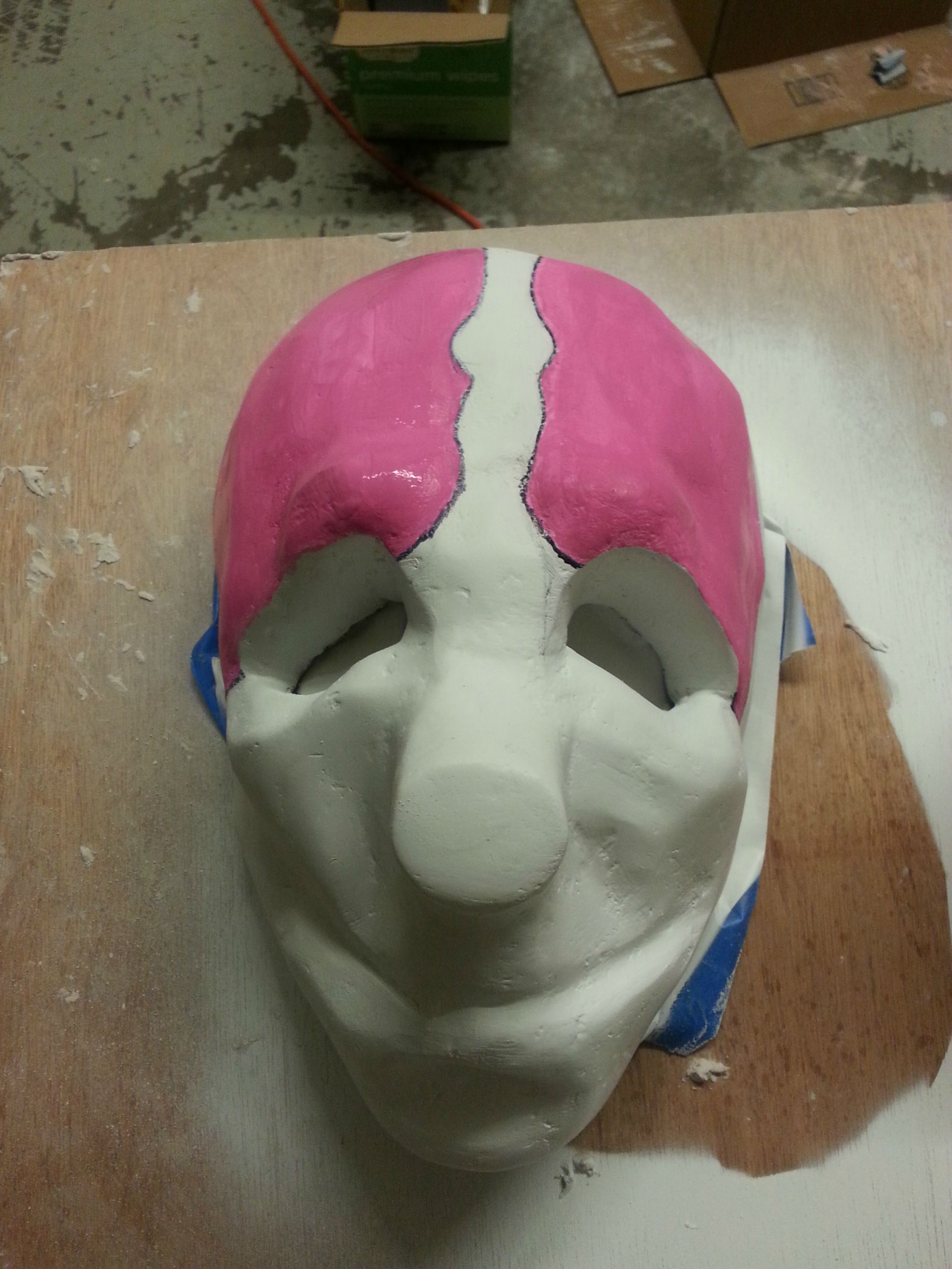

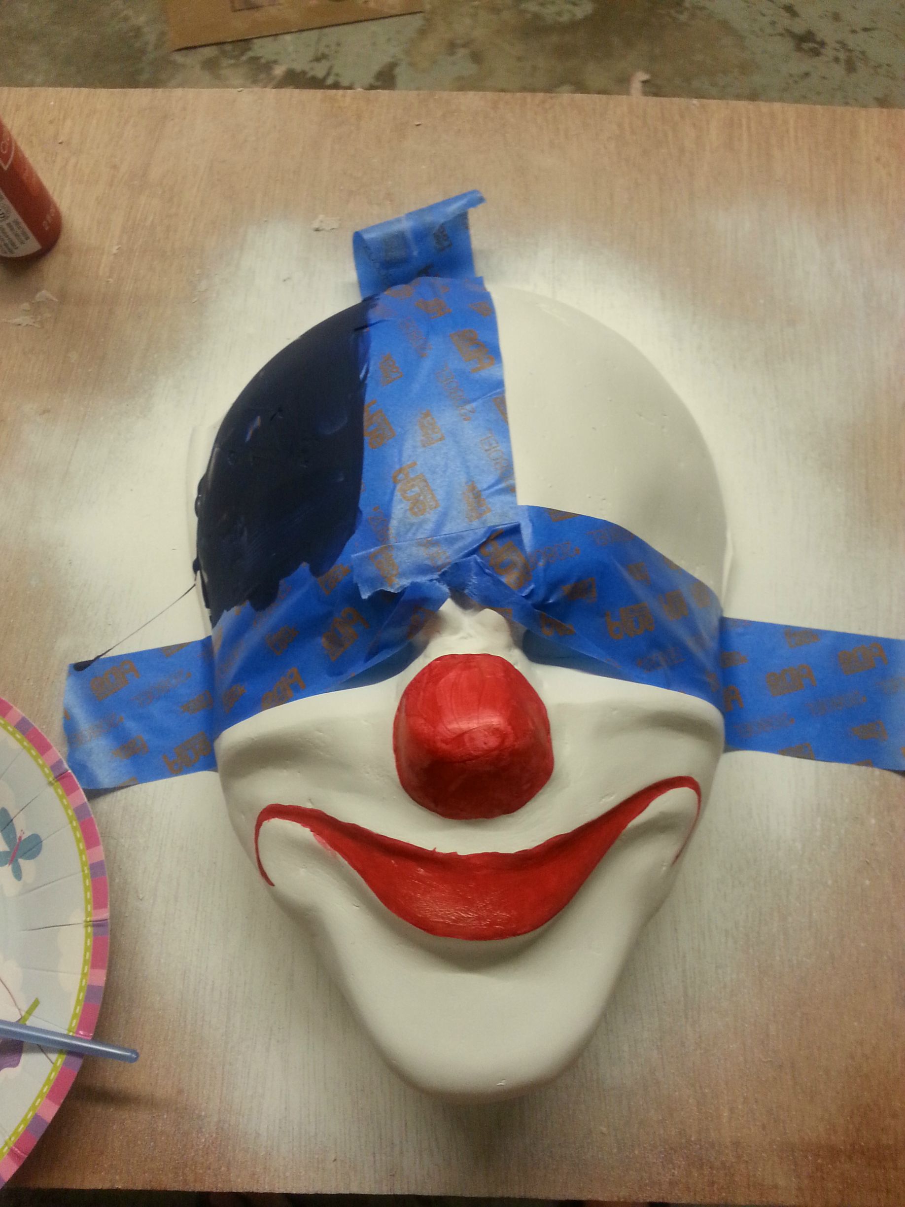

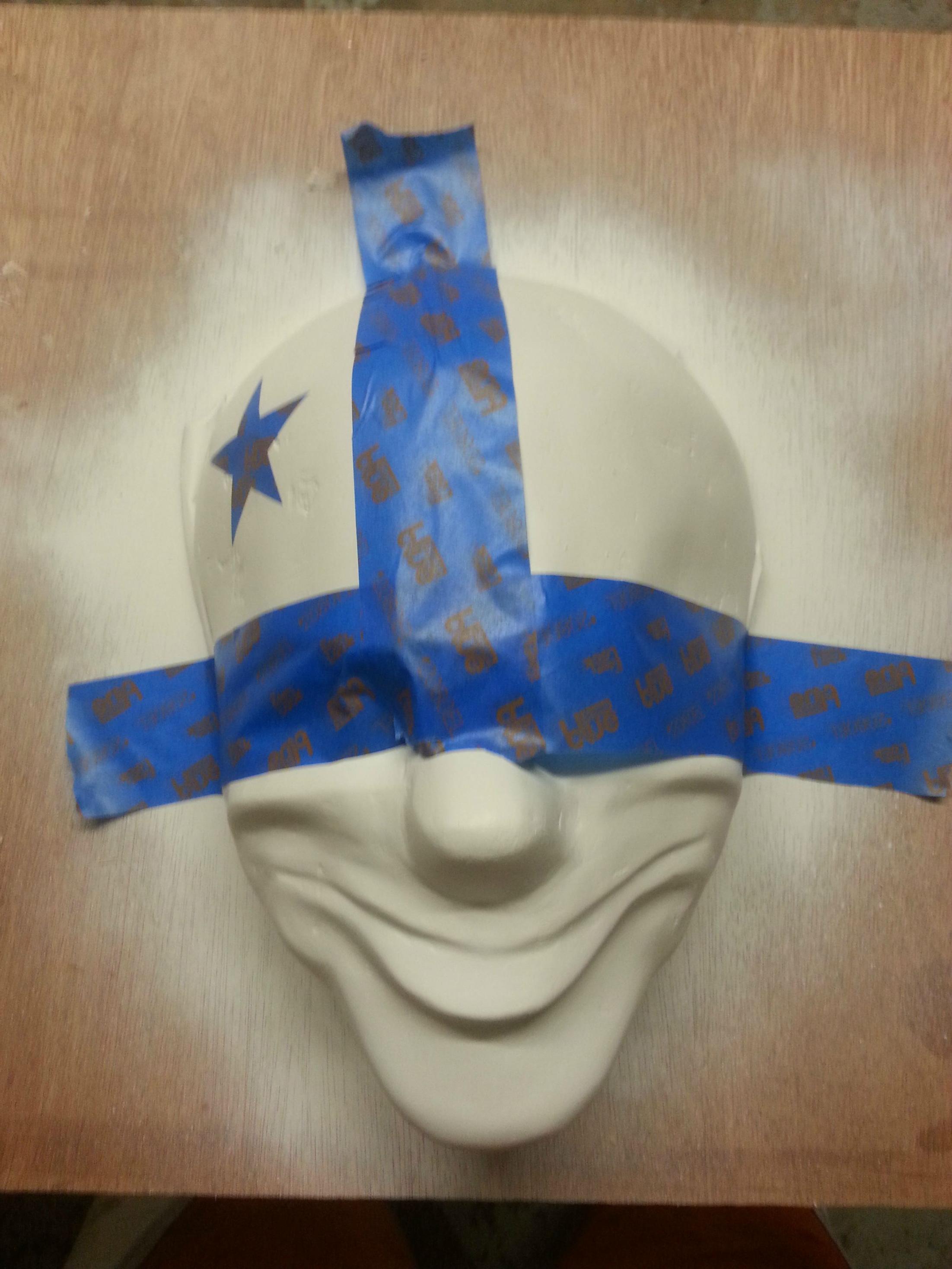

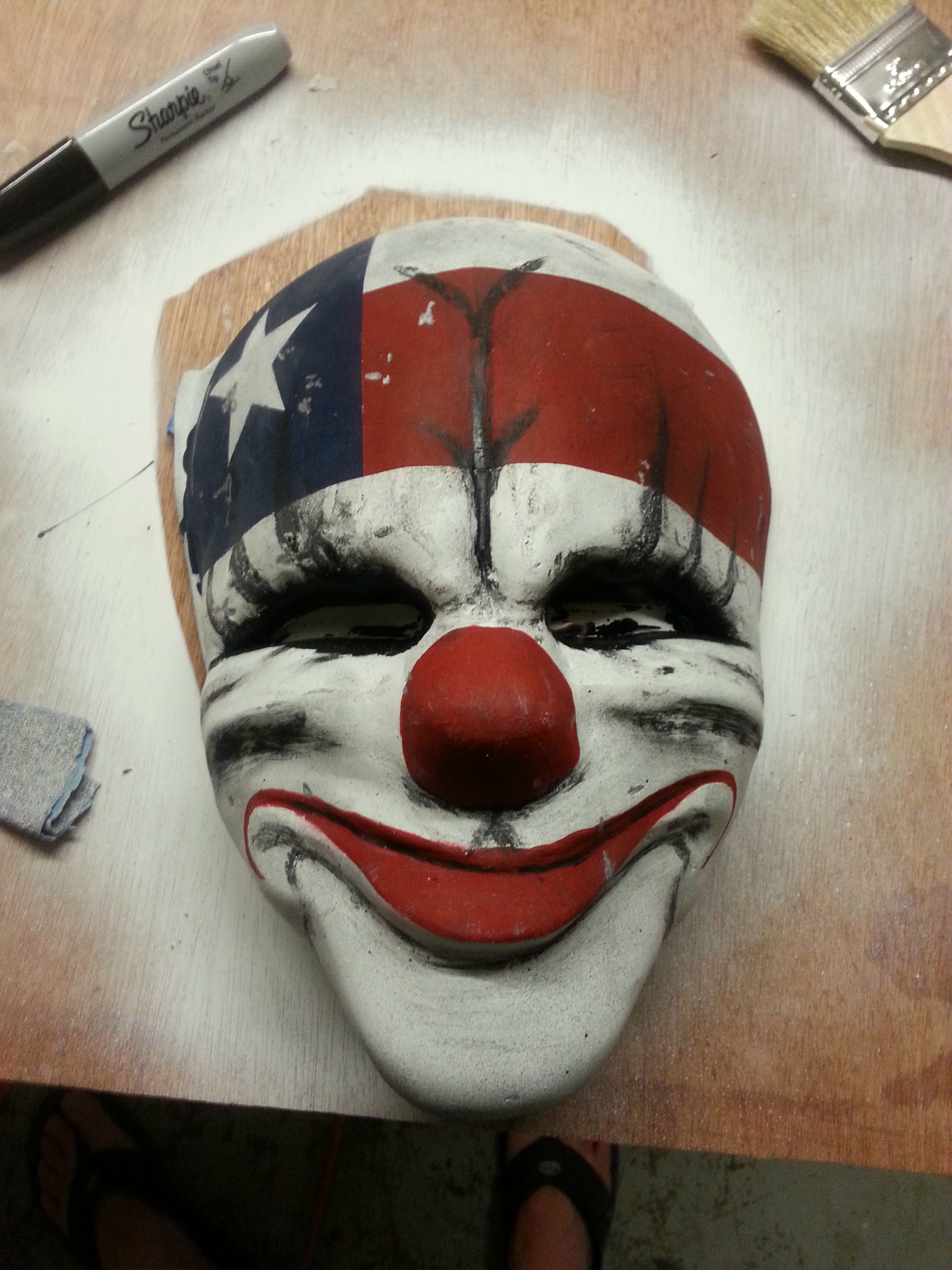

Painting step one: Base coat (white spray paint)
I always felt I was terrible at painting and it showed at the beginning. I ended up finding a method that worked for me and calmed it down.

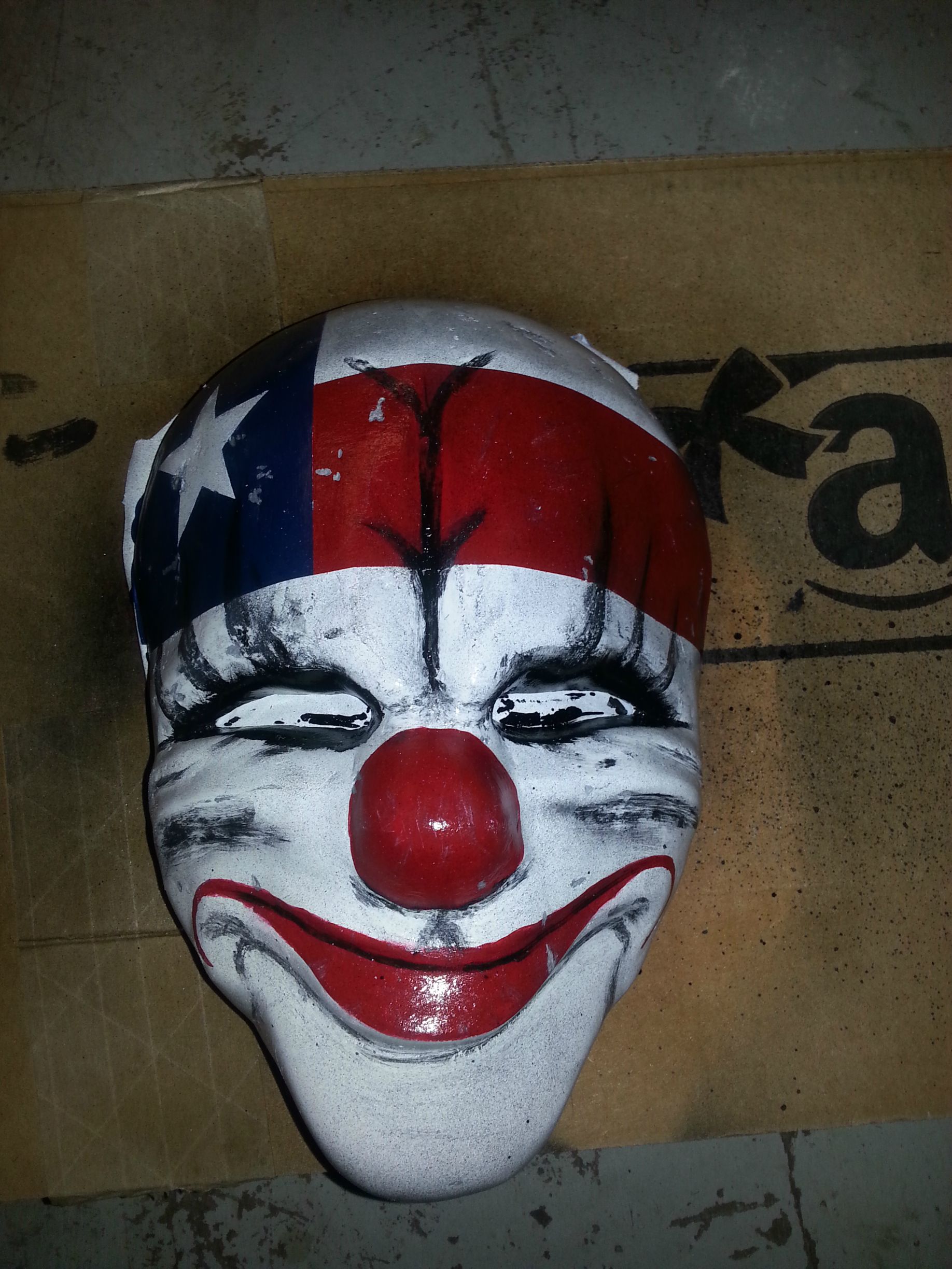

I grabbed some of the artistic license I had laying around and decided to paint the Texan flag.
Painting step Two: Prep for primaries
Acrylic painting
Different approach for the other mask; all drawn. The pep files are from Payday 1 but we decided to mix the styles from Payday 1

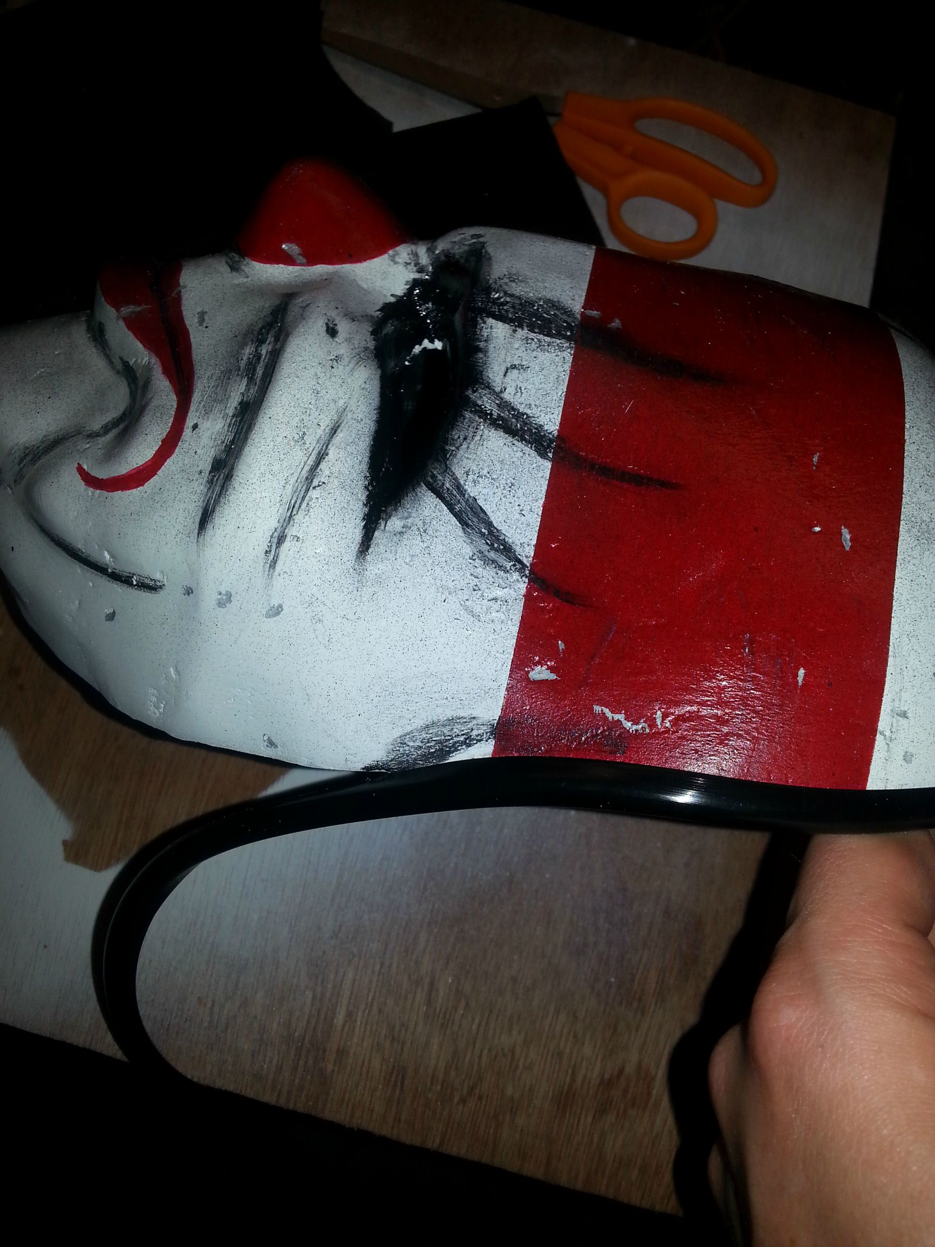

Removed the tape and remembered that straight edge tape is a pain sometimes if you paint into the tape as opposed to over and away from it. I need to clean up the edges (razor blade edge and sandpaper).
I Sharpied the solid areas and dry brushed the shadow areas using the technique here [http://youtu.be/B-Hs1s8rbpw.] My friend used the black acrylic paint on the eyes and filled in with the Sharpie and opted not to dry brush the shadows. To make the mask "dirty" we lightly misted black spray paint from about three feet above the masks.
Also, we added small silver paint accents for battle damage in the pits.
After sanding the shadows and scratching some of the corners up, painting was complete. Time to clear coat.
My friend purposely scratched the first clear coat to get a rough worn look and applied a small second clear coat.

All that was left to do was place the protective edging on the masks and hot glue the cushions (leftovers from the backplate) and a double layer of ultra sheer stockings over the inside of the eyes.

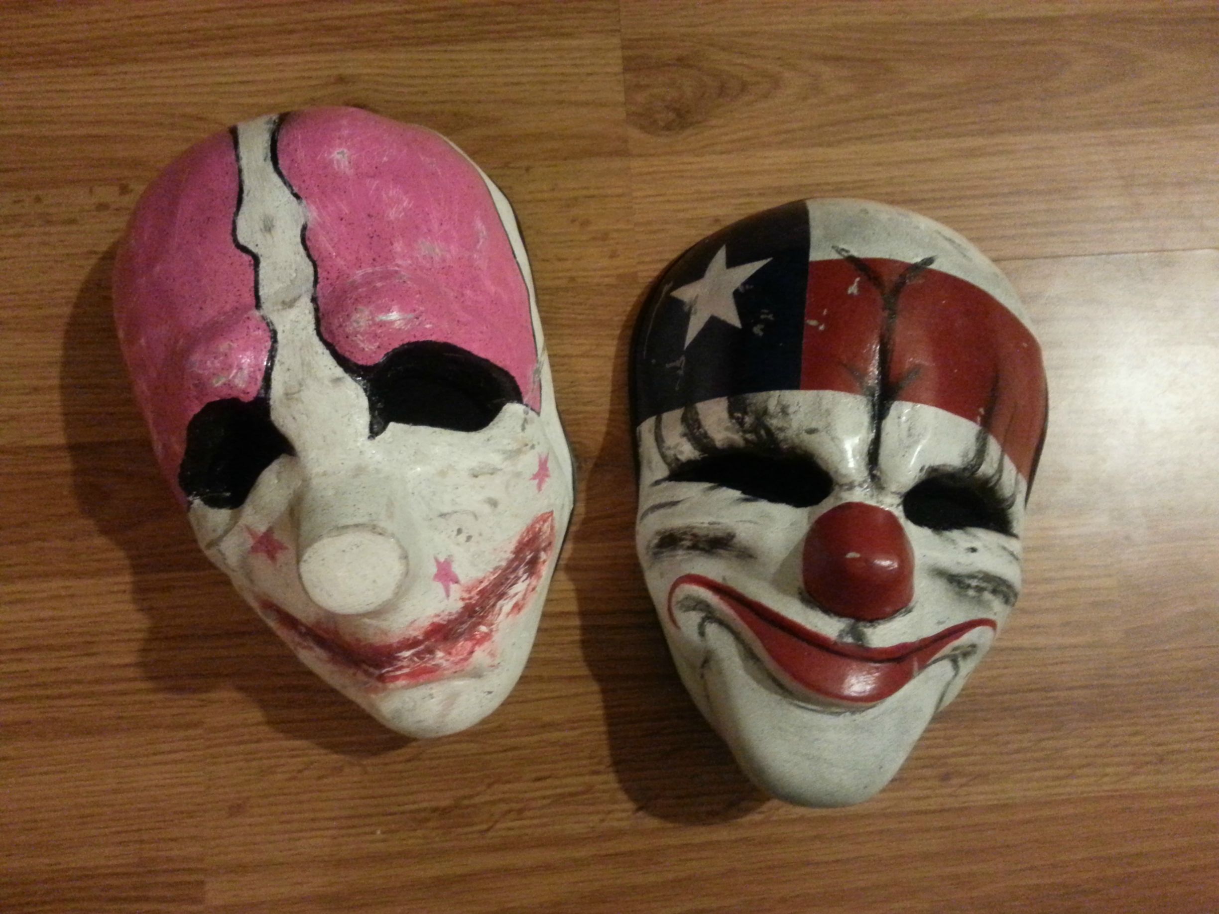

We had stenciled the stars on his mask. He also smudged the paint around the lips with his finger to give it the messy and scratched look. We, literally, finished the masks at bar closing time on the day of the convention.
