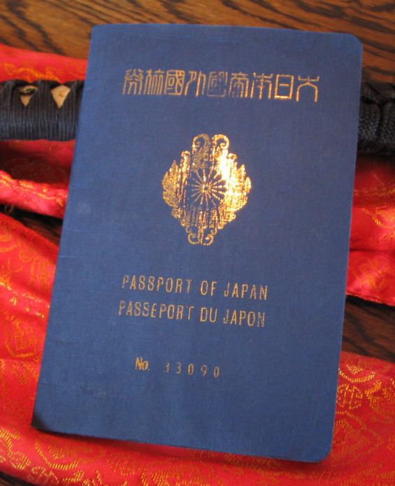

If you want to make the cover yourself, there is no cheap way of doing them really accurately, but a good "close enough" option is using heat-transfer foil. This allows you to print a black design onto card stock with a laser printer or photocopier, then use a heat source (such as a laminator or even a household iron) to transfer the gold foil onto the black toner. The results aren't as good as professional embossing, but it'll work in a pinch. Here are some covers we did using this method:

Indy Magnoli, true. What kind paper works/looks the best for heat gold foil? And the picture of the US passport what material is that / is it professional embossing? How would I do the picture identification page look the way a real one looks. (Clear glue covering the page? Spray gloss? What!?!?)
Heat transfer foil works best on a smooth finish card, but (as you can see above) I have used it with varying results on cardstock with a linen-texture.
The US Passport replica above is coated cardstock with professional embossing.
As for the info page, best to laminate. Most passports have a stiff information page, though the US passport has a regular page with thin laminate, so a regular lamination works fine and looks good on film.
