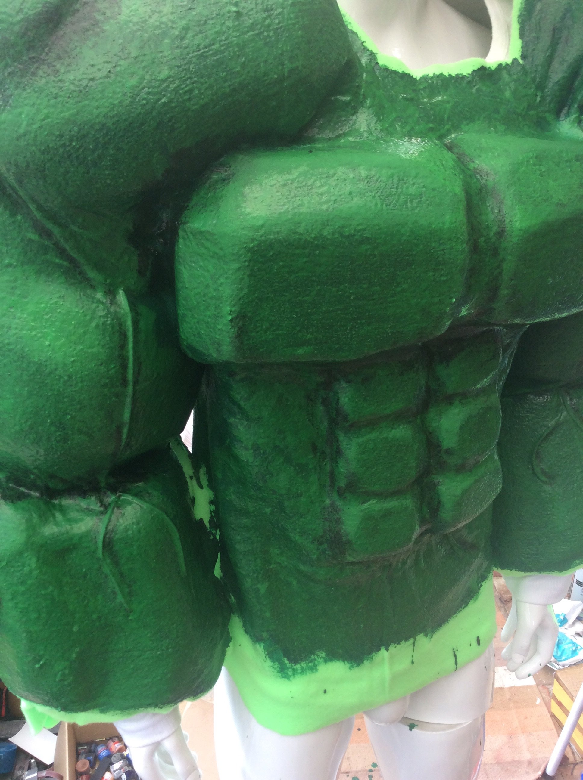

image.jpgYou can also tint the latex with acrylic paint and apply it. I m making an orc muscle suit and tinted the latex. Now it doesnt need painting.
I bought the suit as a kit, and the latex was already tinted just not the right color, but I found the liquitex makes a varnish in matte, satin, and gloss that is acrylic based and flexible. I coated a couple pieces with it last night and it seems to be holding up fine
