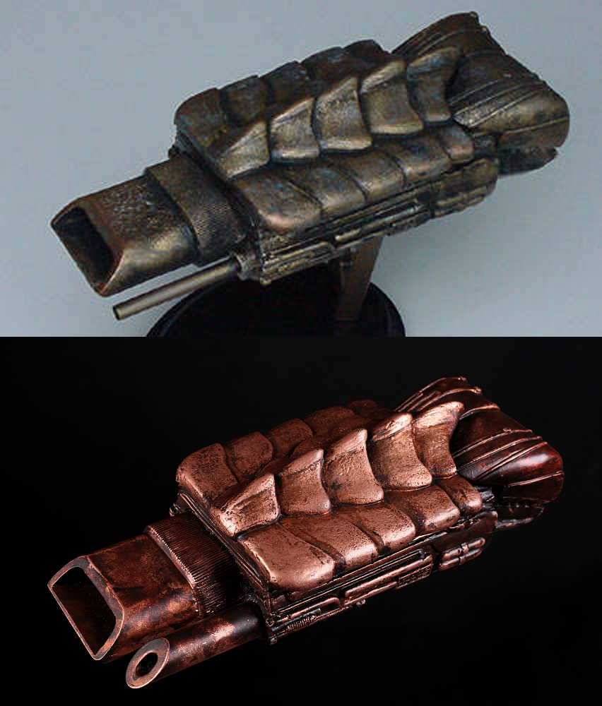

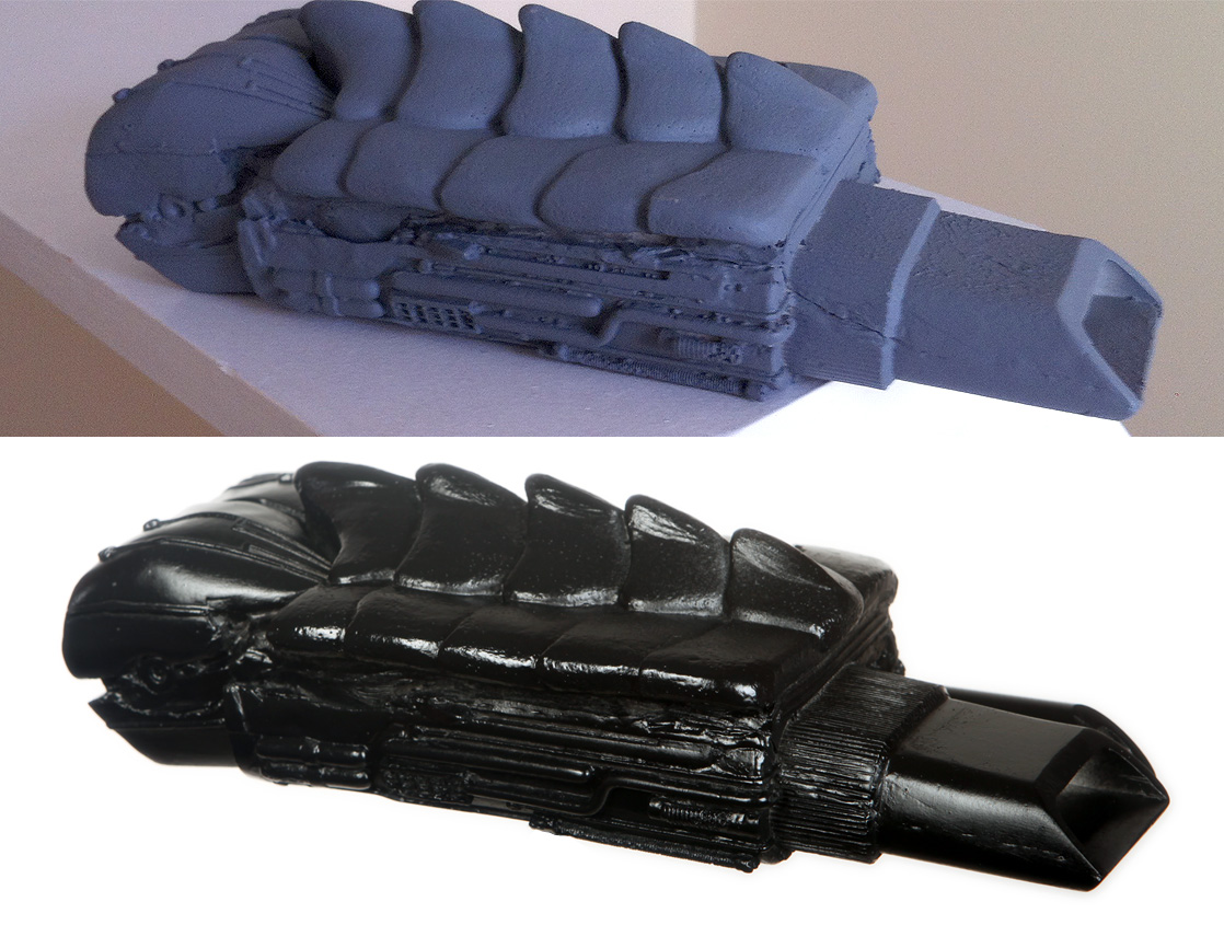

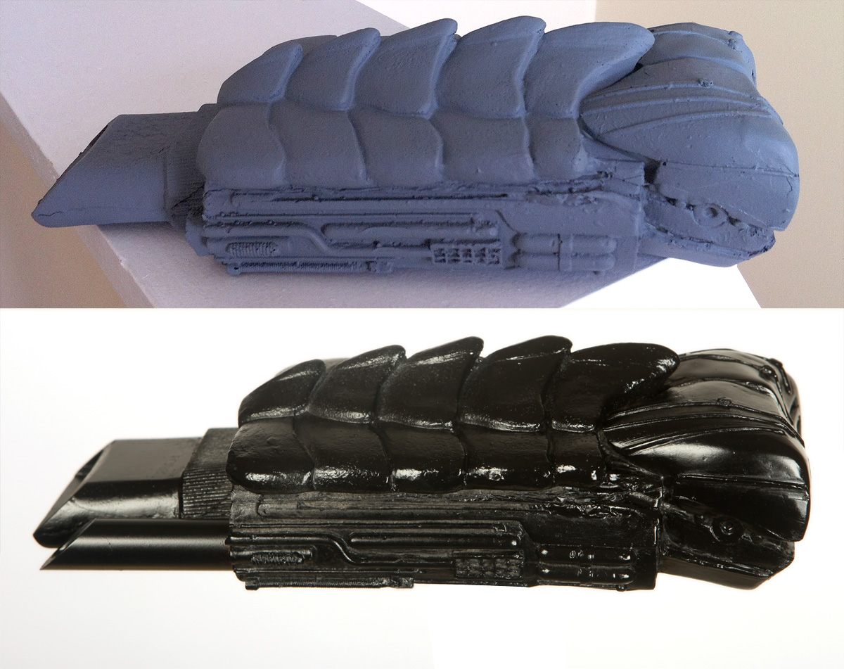

I picked up a cannon that is cast from original (according to the seller, a first gen casting). It is in pretty rough shape (not sure if it is the casting or that the original itself is this rough) so I am doing minimal cleanup on it before painting it. I am trying not to go crazy with it, but there are issues like the cannon barrel has a slouch in it an a little of little boogers and other ugliness. Anyway, here is what a raw casting looks like vs my first pass (mine is in black).
One thing I would like to try to do is paint this myself but I am struggling with the color and combinations to get a close to screen accurate look.
On the prop itself, the color appears very gold/copper, but in some of the photos from the movie the top part appears gold/copper while the gun itself appears to have a more silver tint to it. Thoughts?

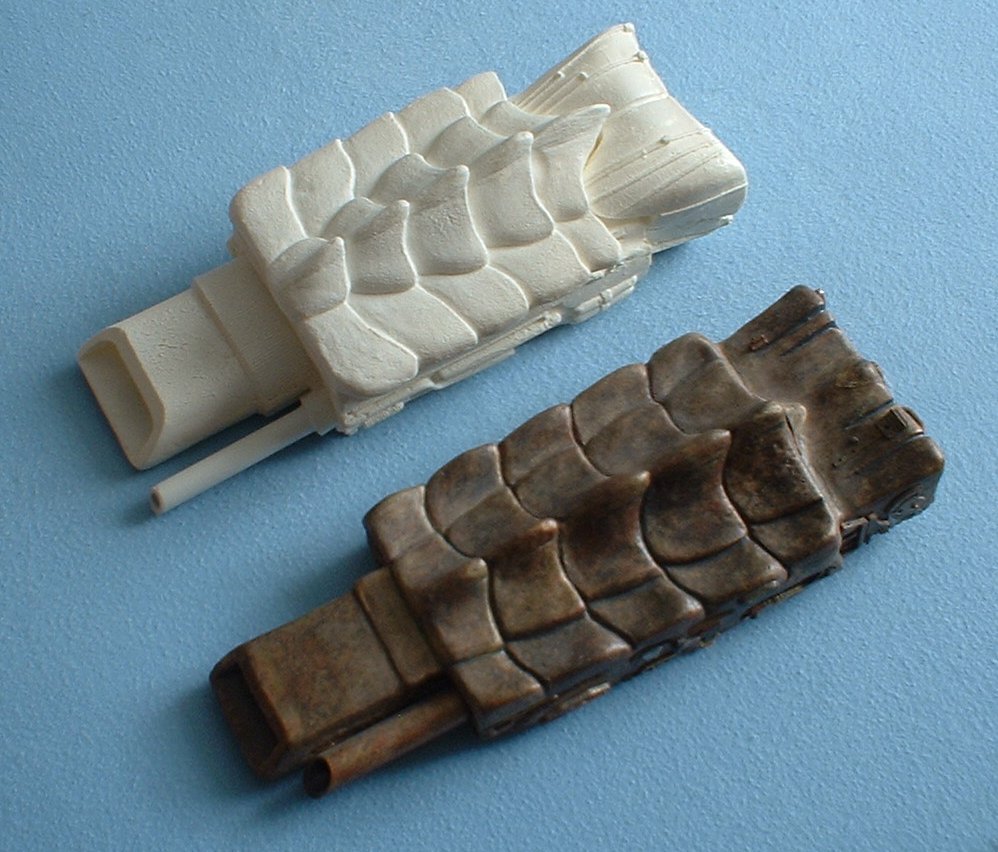

I've got the same casting and had the opportunity of seeing the first test casting firsthand and compared it to the original. For the most part, all imperfections are on the original.

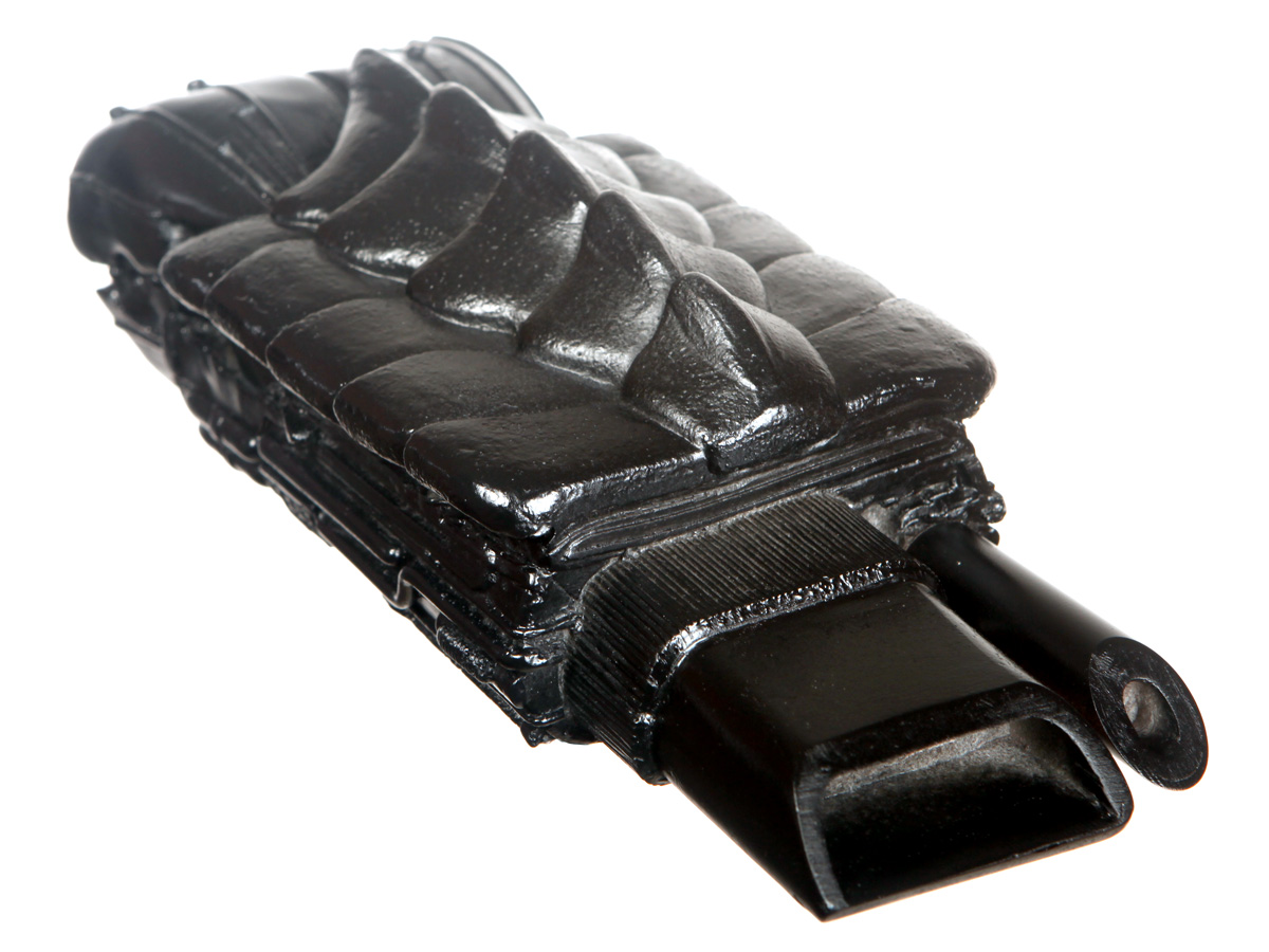

I now have a copy and am pretty excited to have a piece of P2 history. As for the painting of it, I guess I'm going to go this route:

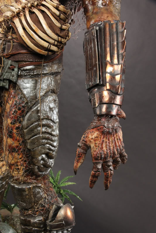

As for the armor itself, I think it's tricky and asked a similar question about how it might have been painted long ago. I wondered if inks might have been used as the base black. It just looks "different" than normal weathering. See the forearm below.

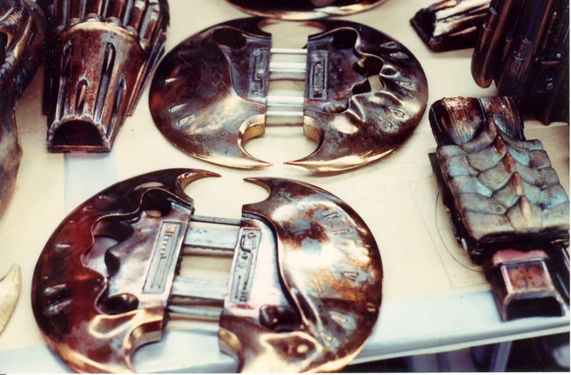

Sometimes the armor looks plated, while other times it looks painted. The P2 disk really looks plated in the above pic. Does anyone have access to any of the costume folks who would have worked on P2?

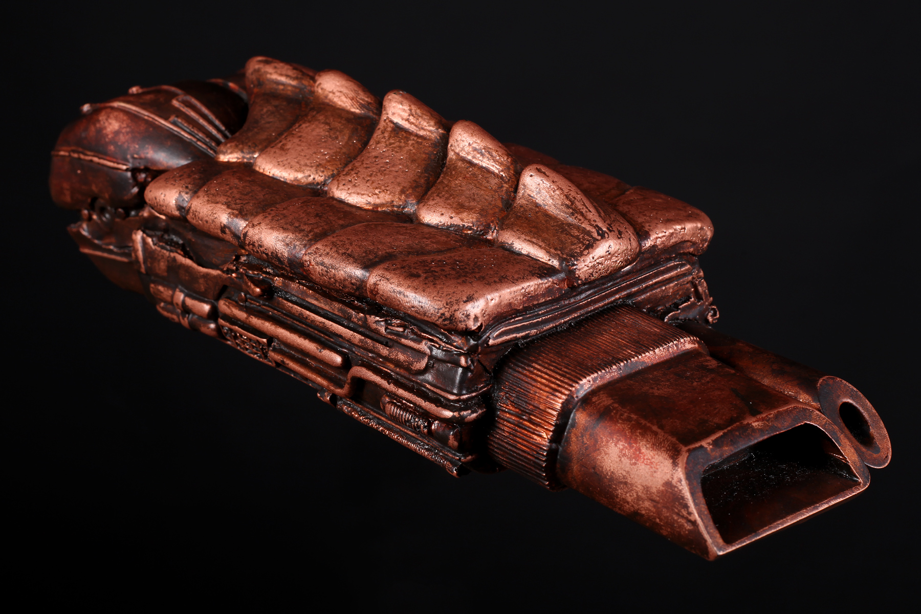

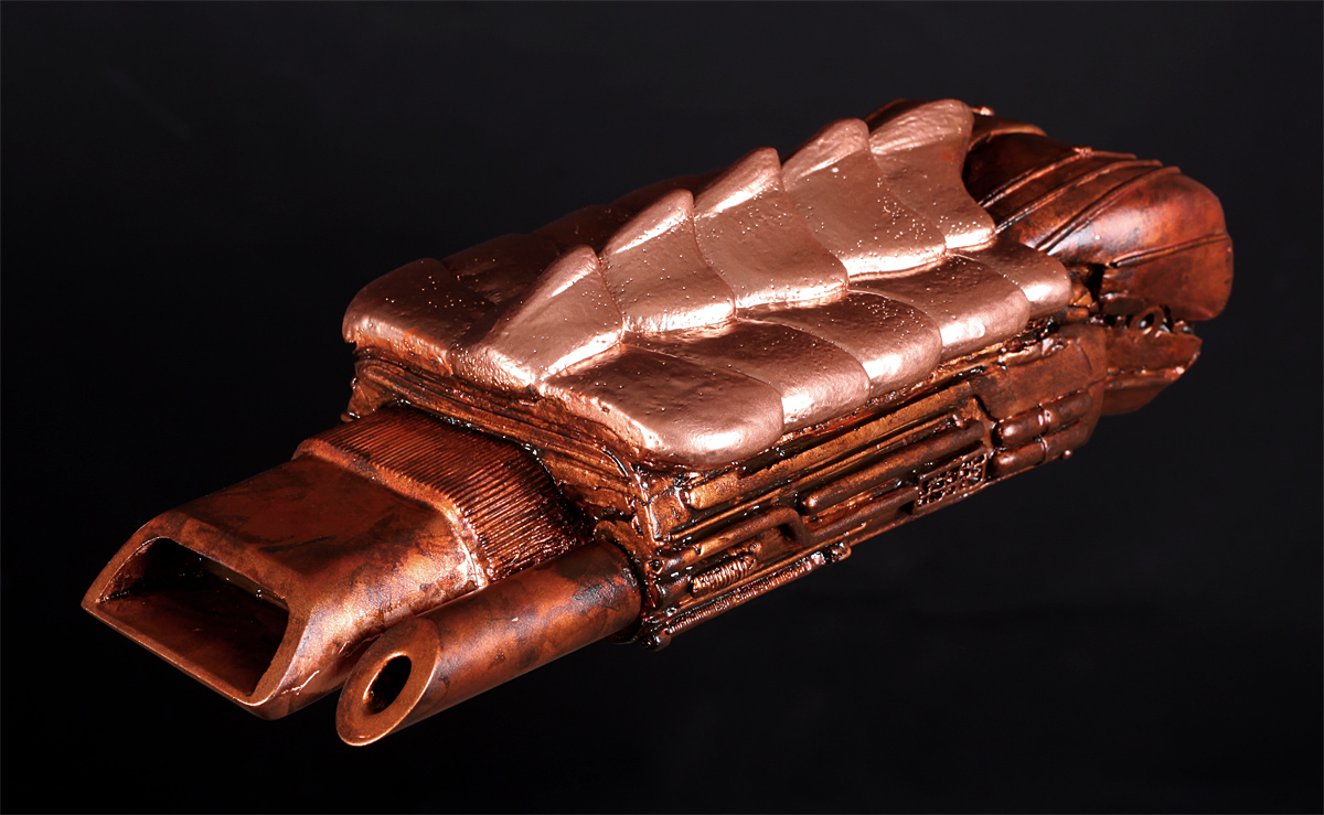

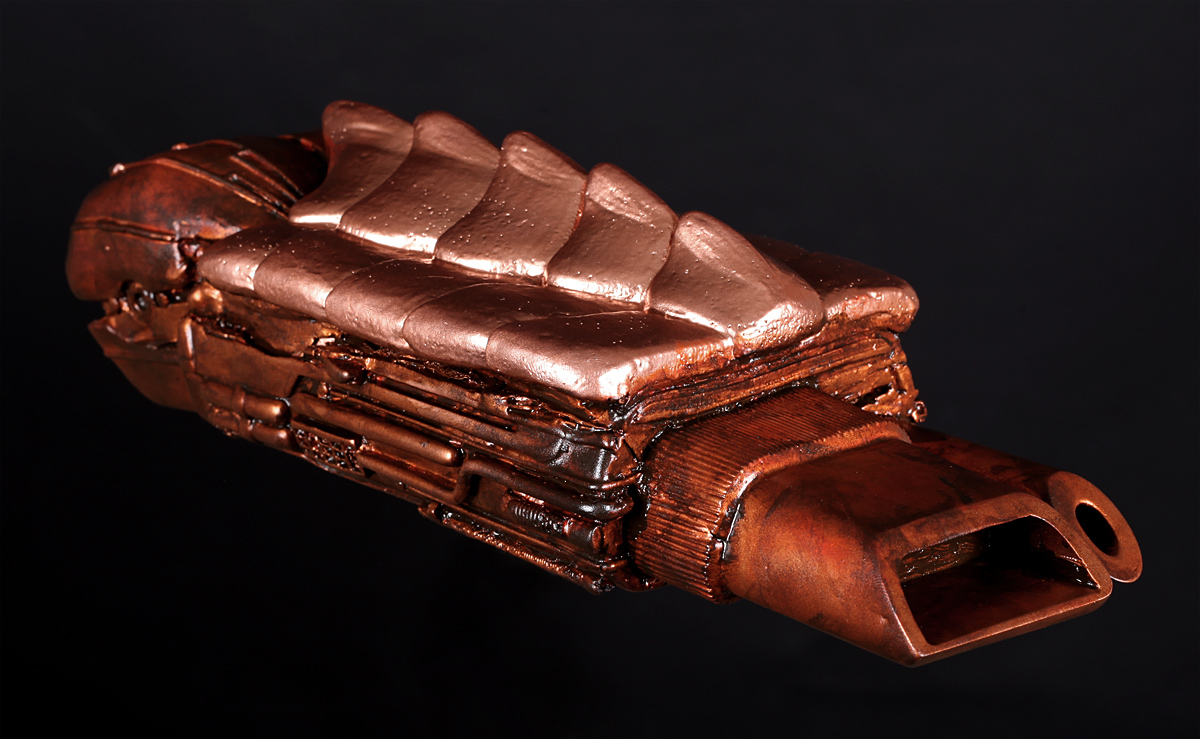

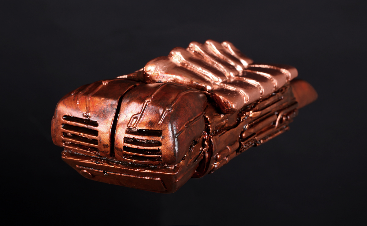

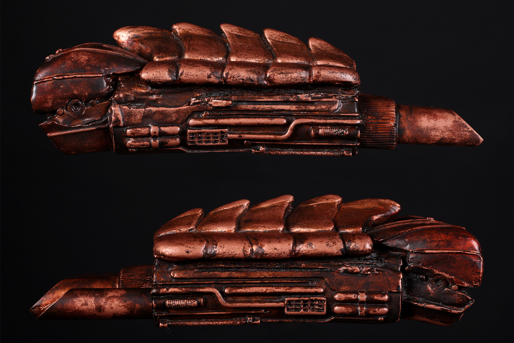

So, here is my progress after initial paint and some weathering. I painted the cannon glossy black, then gold, then copper. I went pretty thick with the copper to smooth out the surface even more.
Now, I could be wrong, but to me, the carapace looks slightly lighter on the hero cannon than the rest of the cannon details, so, I took liquitex transparent burnt sienna and brushed it over all of the cannon except the carapace, then went back over it with raw umber. I lathered it on generously then took a sponge wedge and dabbed it back off and smoothed it out a bit.
These photos represent that work. As you can see, the weathering is still wet.
From here, my plan is to buff the cannon, to remove some of the weathering from the high spots, then to add a heavy black wash to the entire cannon, including the carapace which will further bring out the details.
I don't know how truly screen accurate this is, but overall, I am liking the direction.
Let me know your thoughts.
Put a black wash on the whole cannon tonight as well as raw umber and transparent burnt sienna in the creases of the [background=rgb(24, 24, 24)]carapace. The whole cannon is looking a little dark right now, but once the black wash had dried, my hope is that I can buff the high spots and give it the final look I want. I might need to do one more heavy black wash after that to achieve the exact look I want, but overall, I am pretty happy. Will post pics soon.[/background]

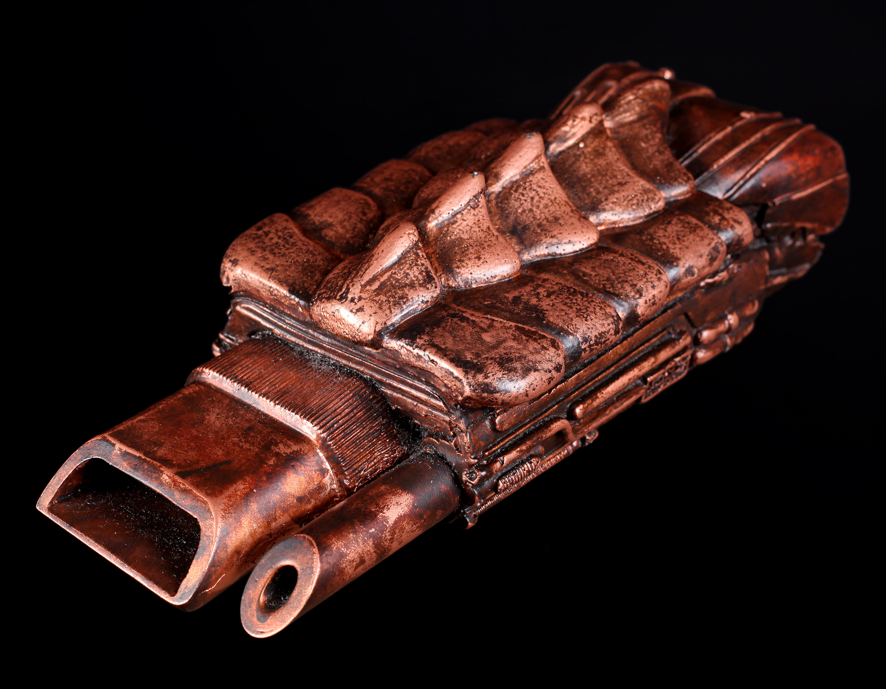

Alright... I think I am pretty happy with it and consider it "done." I finished it out with #0000 fine steel wool to cut through some of the grime and being back a bit of the shine. I think a lot of the dirt really helps distract from the roughness of the piece and even works with it.
Let me know what you think.

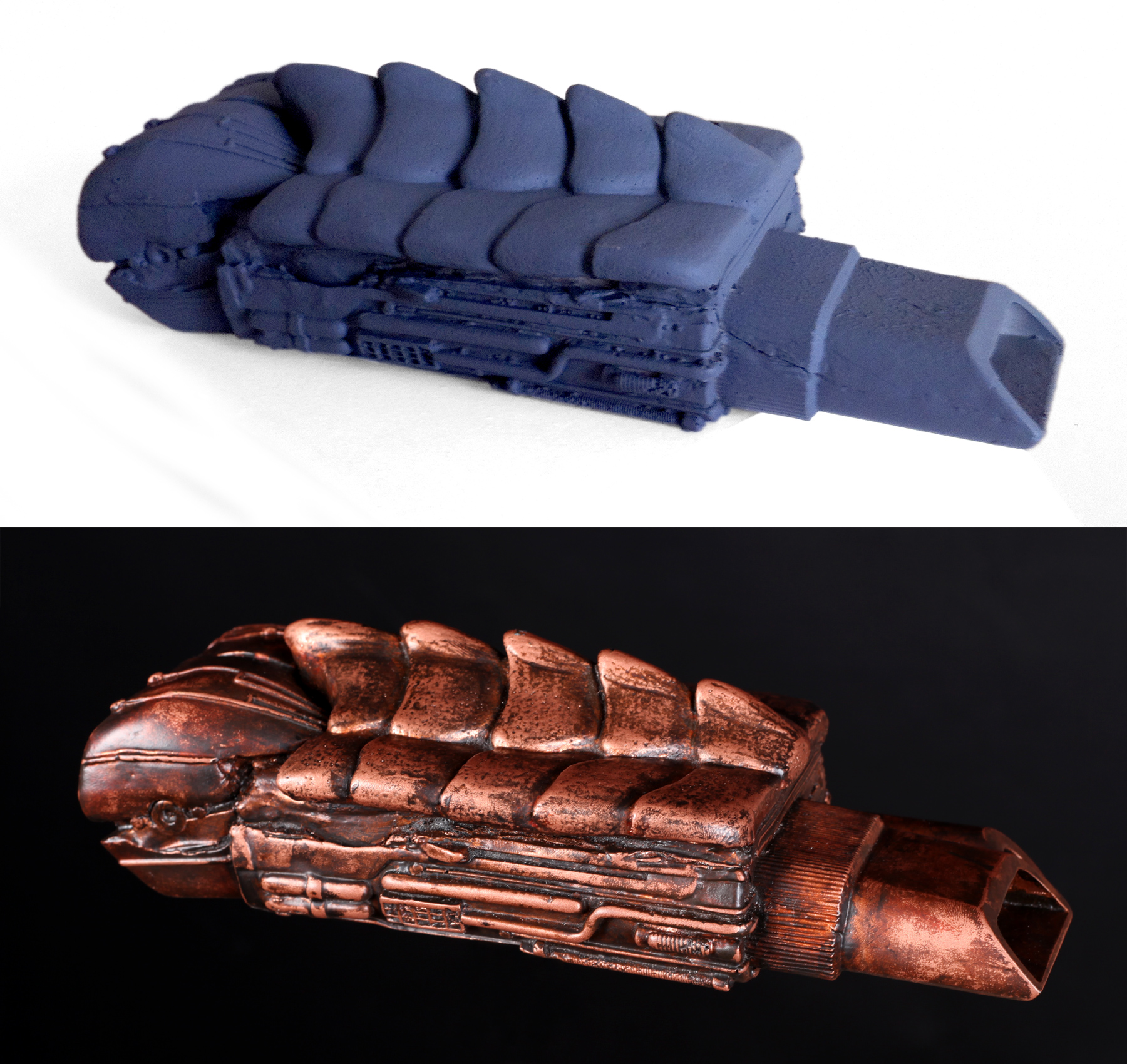

This is a comparison of my casting to the original stunt casting that it originated from. Hmmm... I might have to go back and do one more black wash on the [background=rgb(24, 24, 24)]carapace. I want to make sure it remains lighter than the rest of the cannon, but looking at these photos, it might be slightly too light.[/background]
Alright... went back and added additional weathering to the [background=rgb(24, 24, 24)]carapace.... NOW I'm done.[/background]

I would imagine the steel wool scraping off the paint, but it doesnt look like it caused any damage at all. Did you only remove the top layers of paint with it or...?
I put the copper on VERY thick and then layered the sienna and umber as well as the black washes, so the steel wool (which is very fine, not coarse) was used to cut back down through the grime layers to bring out highlights and to make the details stand out more.
