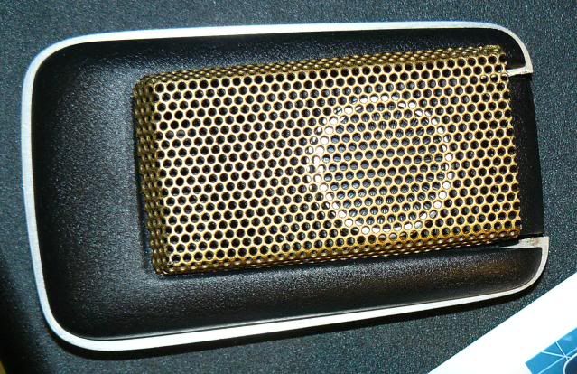

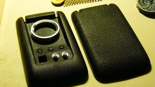

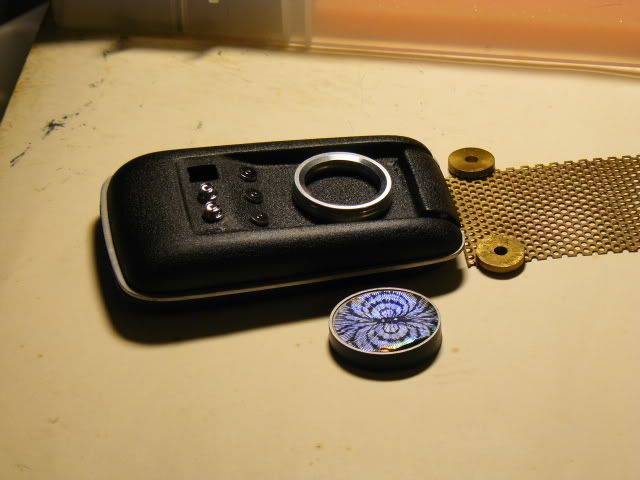

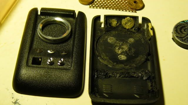

The Playmates Comm can be modified to look better but it takes a little work. I started on one before the diamond select comms were available and again never finished. The old moiré was cut out and the hole was replaced with styrene sheet. The molded mid plate was replaced with a piece of scrap aluminum. I took an old soldering iron and melted the battery cover to the main back piece. Everything was spot puttied, sanded then sprayed with wrinkle paint to simulate the old hair cell texture. As Captain Dave said a new moiré was made from aluminum rings from an old hard drive. The grill as seen in the closed comm pic is a piece of old speaker grill spray painted gold.
-John
Looks fantastic :thumbsup

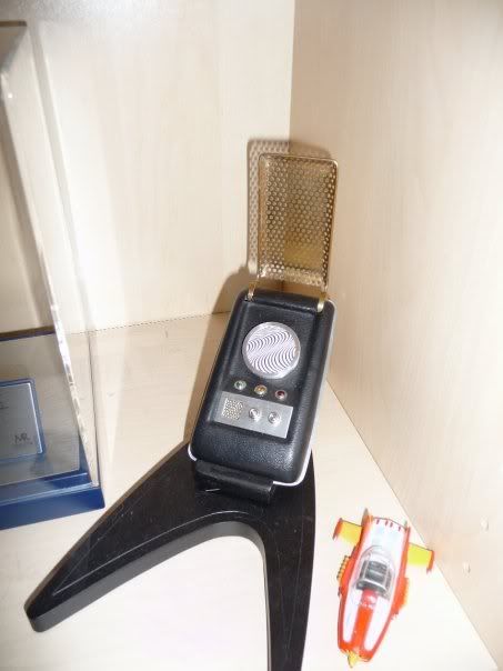

here's a pic of my jlong kit that i built up -- i decided to go with the moire pattern as seen in MAKING OF STAR TREK book as this was the first picture I ever saw of the communicator prop and spent many an afternoon as a child starring at all the details trying to think thru how to make one myself. I also sent a letter to prop department at Paramount asking if they had any extras they could sell me, and they actually sent me an 8x10 glossy photo of the exact same picture...which I had for years in my STAR TREK SCRAPBOOK along with a cardboard package from PROMISE margarine that William Shatner was a spokesperson for their TV spots back int he 70's. Ahh, those were the days. :)
That's a beauty :love
