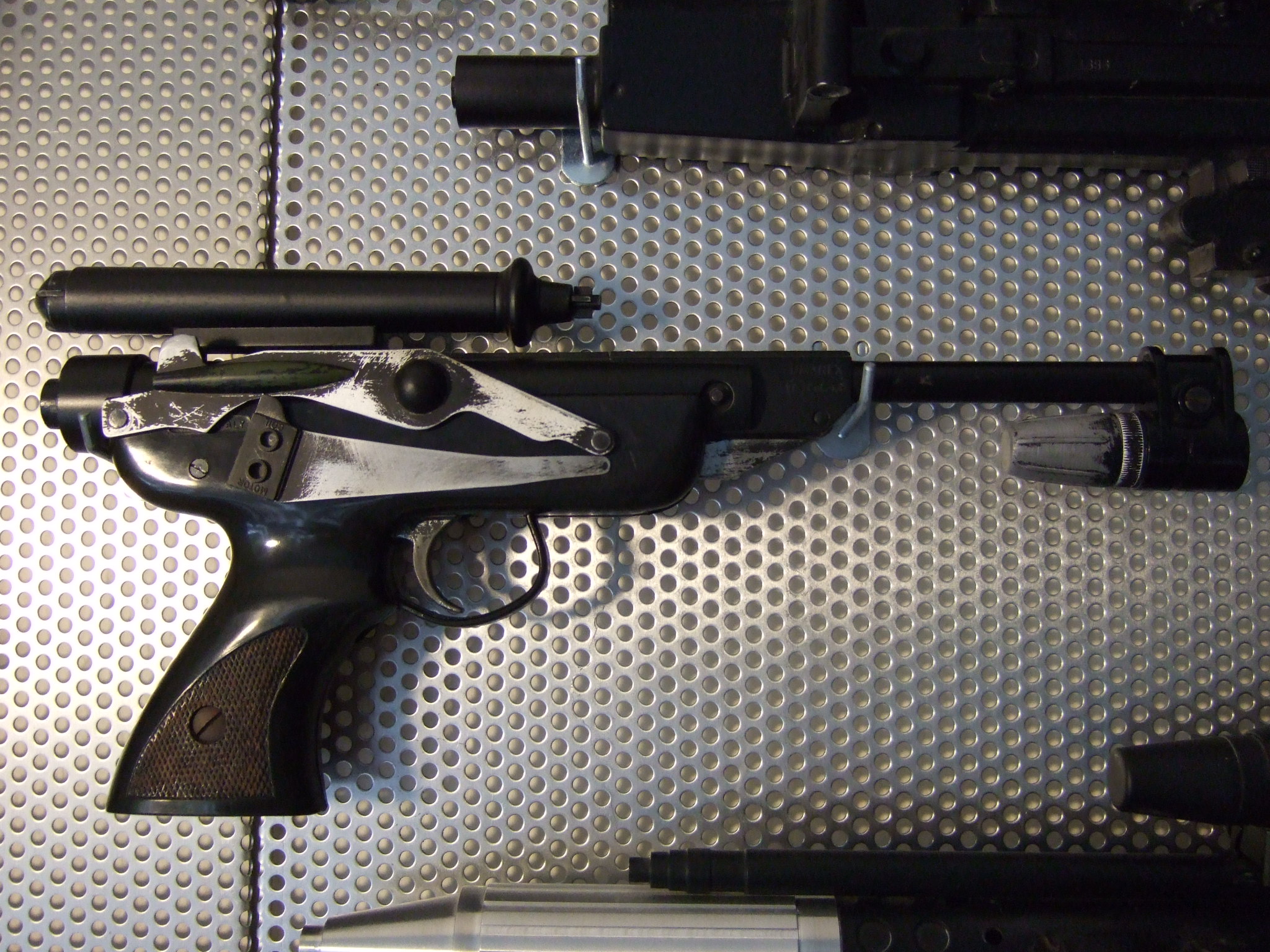

Nu Blaster in da house (SW of course), Jabbas palace guard blaster

Sorry for waking up this old thread :lol - but i have some new parts i would like to share.
Some of us were waiting for Dullas scope, but it seems he is still to stressed to have time for any progress. So i´ve spent today some hours in front of my lathe, after checking pics and making size calculations.
And this is the outcome of my try to make my own scope:
The parts
http://i527.photobucket.com/albums/cc352/Lichtbote/Props/Blaster/Jabbas Guard Blaster/parts016.jpg
Assembled
http://i527.photobucket.com/albums/cc352/Lichtbote/Props/Blaster/Jabbas Guard Blaster/parts015.jpg
And next to the gun, for size comparision
http://i527.photobucket.com/albums/cc352/Lichtbote/Props/Blaster/Jabbas Guard Blaster/parts017.jpg
The parts breakdown is made in a way that it could be cast, as maching it is to time consuming if someone would request me to make one.
I think it looks not to bad. :) Feel free to chime in if i missed something.

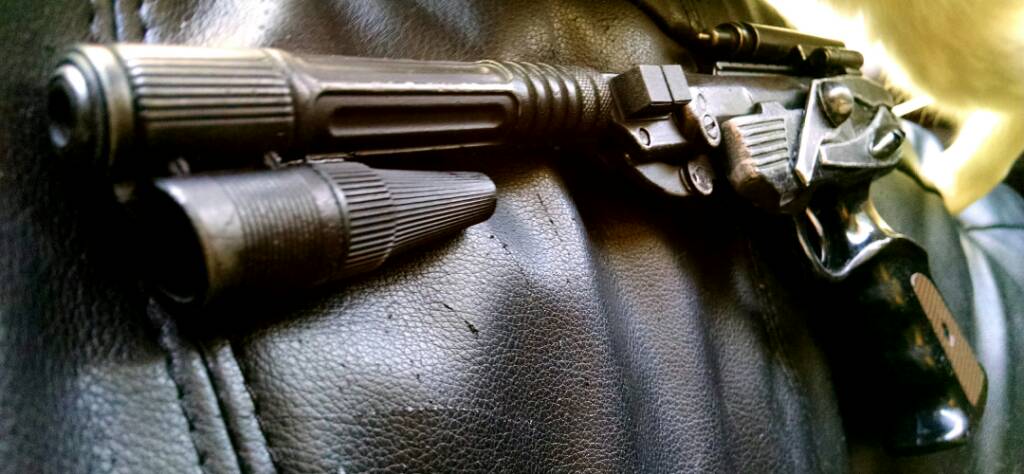

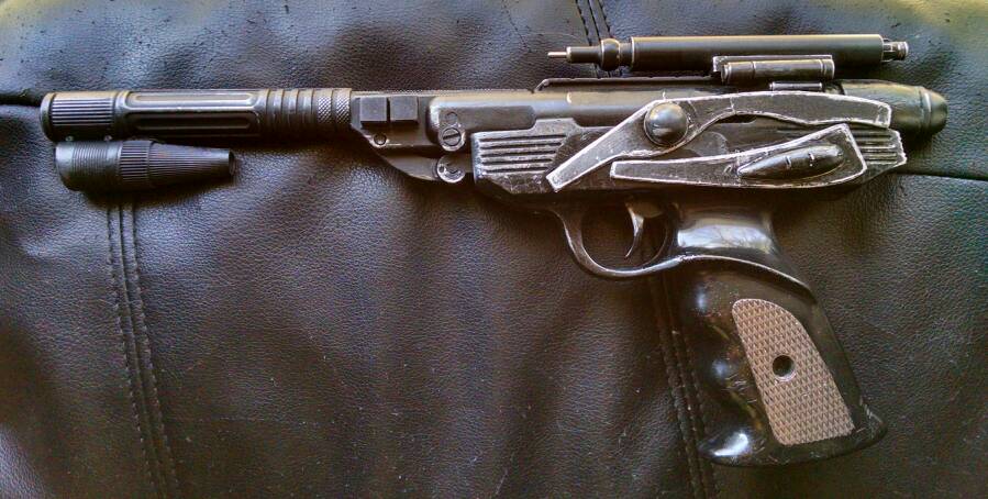

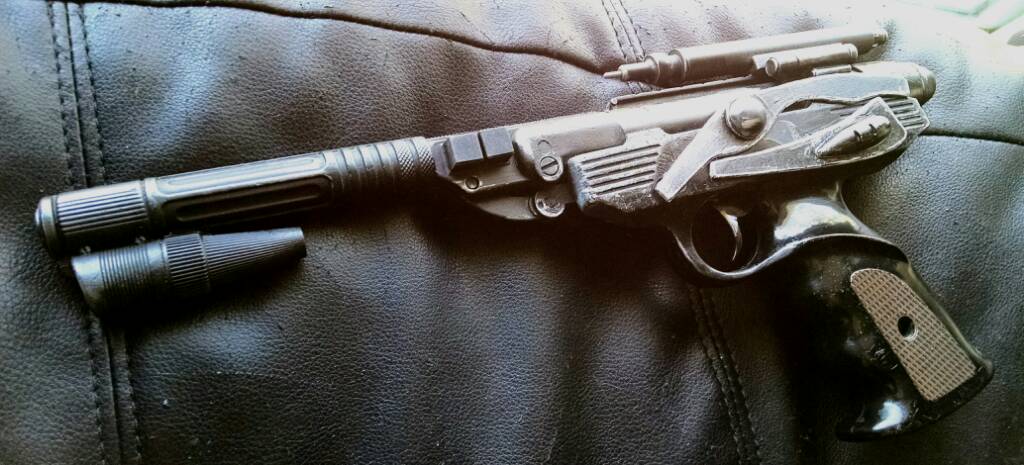

I'm building this blaster right now too! Used a pill bottle, Apoxie sculpt, and a threaded connector I made the end cap, and I cut my own sideplates from aluminum. The f-4e kit is the 1:32 or bigger I think.
No idea on the scope or knob/pen cap. People have taken eberhard marker caps and sanded them down for a close look-alike. a tad small though.
In absence of real sourced parts I resorted to model the various pieces myself and have a friend 3d print them. The pen cap is wip still but is going to print soon. This is the "scope", obviously not painted etc.
