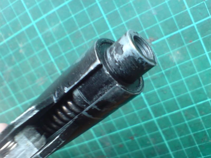

With Petes help i was able to make my version of the threaded endpiece. :cool
Turning some alu to the needed dia:
Drilling and tapping:
turning the step
After parting the ready piece we have this:
Drilling the endcap, first small then the big dia:
Looks gooooooood :love :
You see the rod through the receiver? We need a cutout:
Drilling:
Some sawing and sanding/filing, doesn´t need to be perfect:
It fits. :)
I like it:
After a treatment with Alu-Black:
But i think i will paint it.

This morning i had made the decision that the threaded end needs paint instead of the already used Alu-Black.
2-3 light covers with my beloved heat resistant stove-paint, and some mechanical weathering later:
The tool i like to weather with - it´s great (at least if the parts are real metal ;) ):
Additional the grips and the former silver gunparts got some flat black:
Definatly needs a more shiny and gruffest top layer. I don´t want to use the same paint as for the metal-parts, to get a more interesting/realistic appearance - maybe 1-2 layers of "Future".

As mentioned i got a second RO72, and i bought it to have a spare one if the first ordered would have had some "issues". Well, it happend that both are in a fantastic and undamaged condition.
Nonetheless i drilled a hole in the endcap of the second, and machined a second threaded insert:
The same job i did to mine already:
This evening it will get the cutout for the bolt, and some paint.

The metal is soft, so a needle-file is all you need to make a slot on the side opposed to the original. Don´t spend to much time on this, it is never visible, not even if you mess it really bad):
That way the securing screw can be insertet again in the upside down scope:
It got another 2 layers of a semigloss paint:
Mine, my second one, and another endcap-set ready to use. Next to it the old parts. it´s threading is not M10, and no other M ..... so we can say it´s inaccurate for a german/italian made gun.
