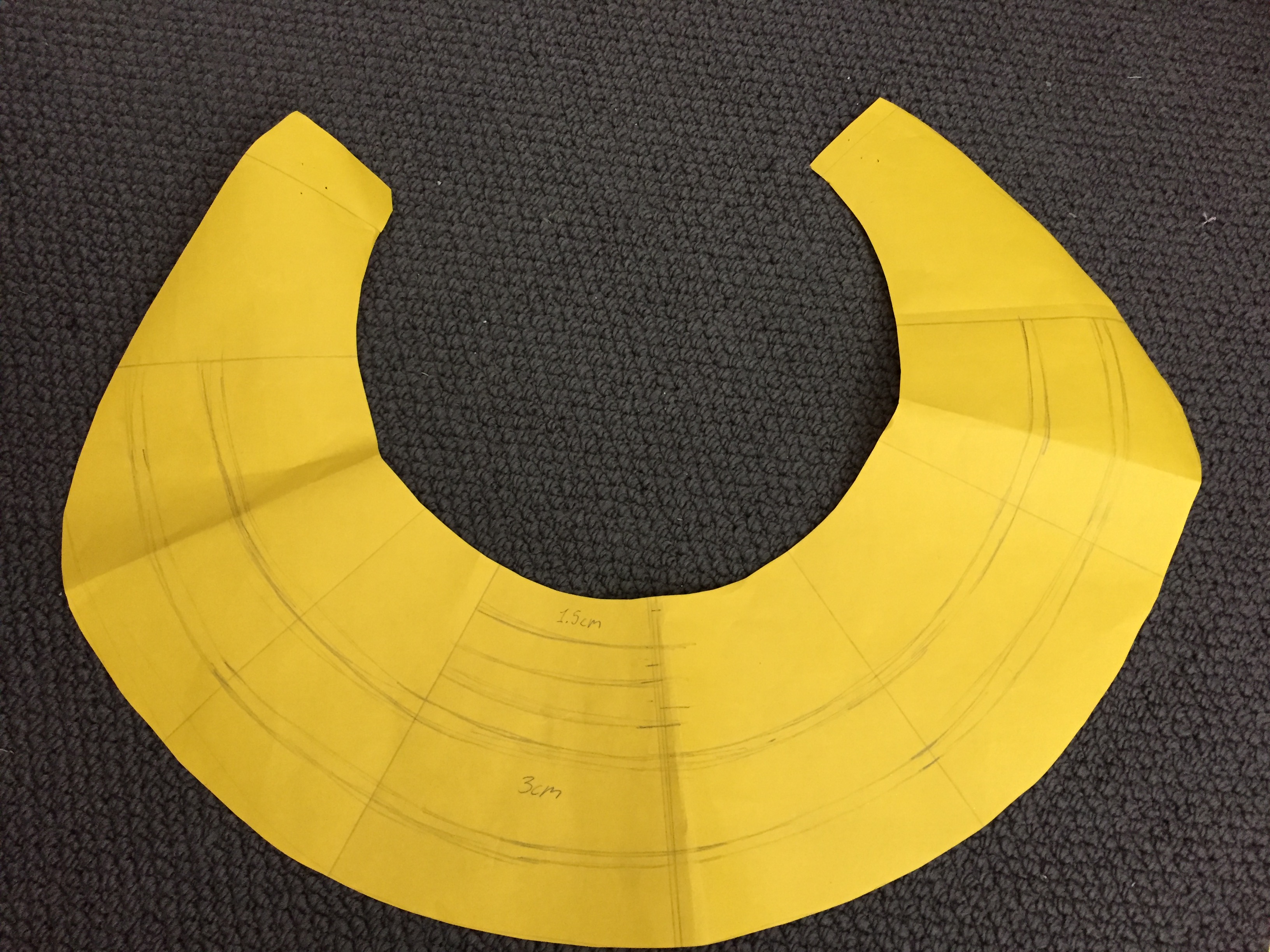

First on the to-do list is to make cardboard templates for the deshret and wesekh.

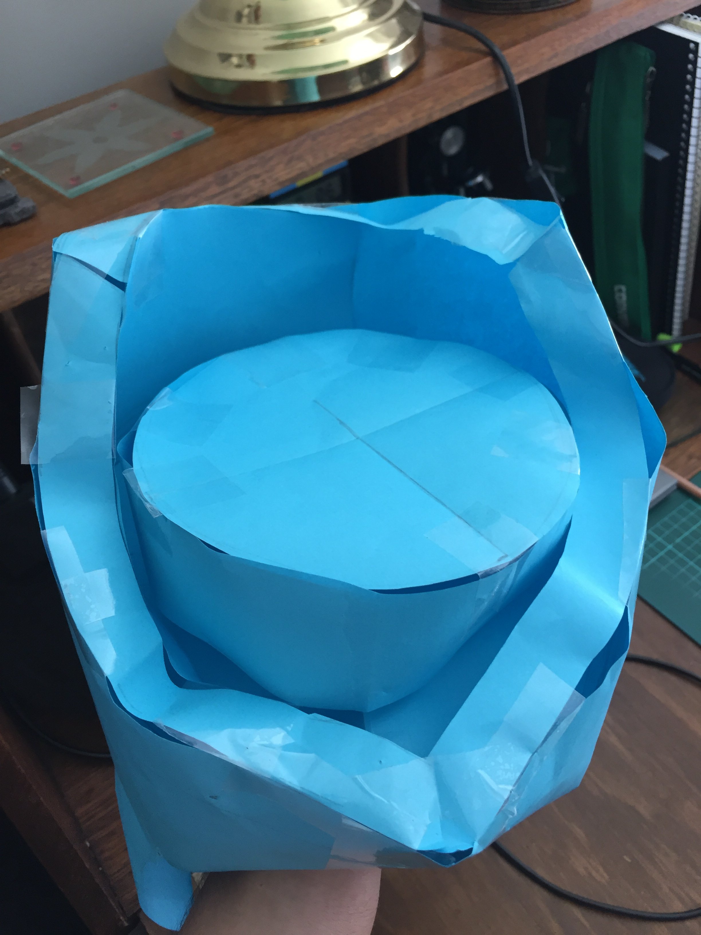

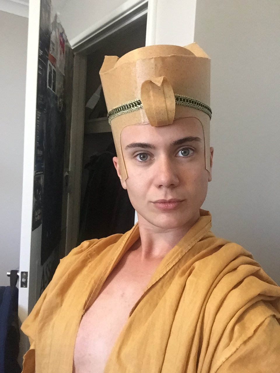

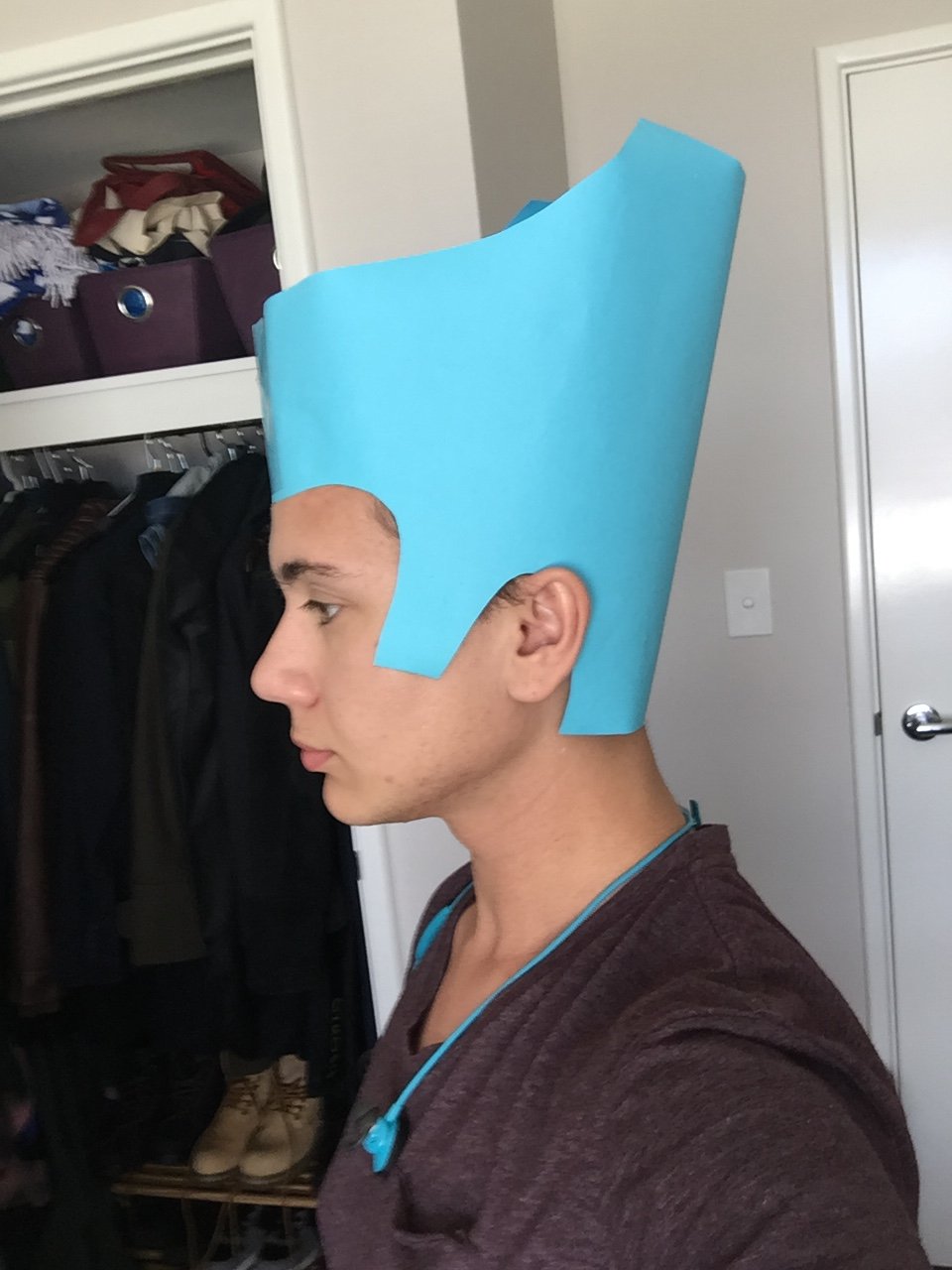

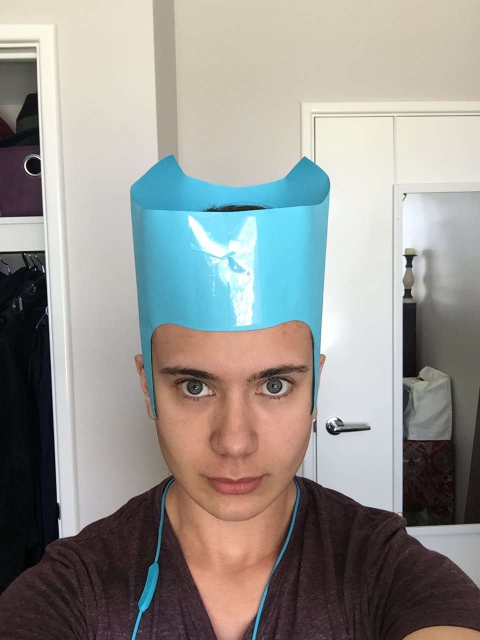

Here's an update. I have completed the template for the headdress, it is a surprisingly complex shape, it took me a few tries to get it perfect, still uncertain of what material to make it out of.

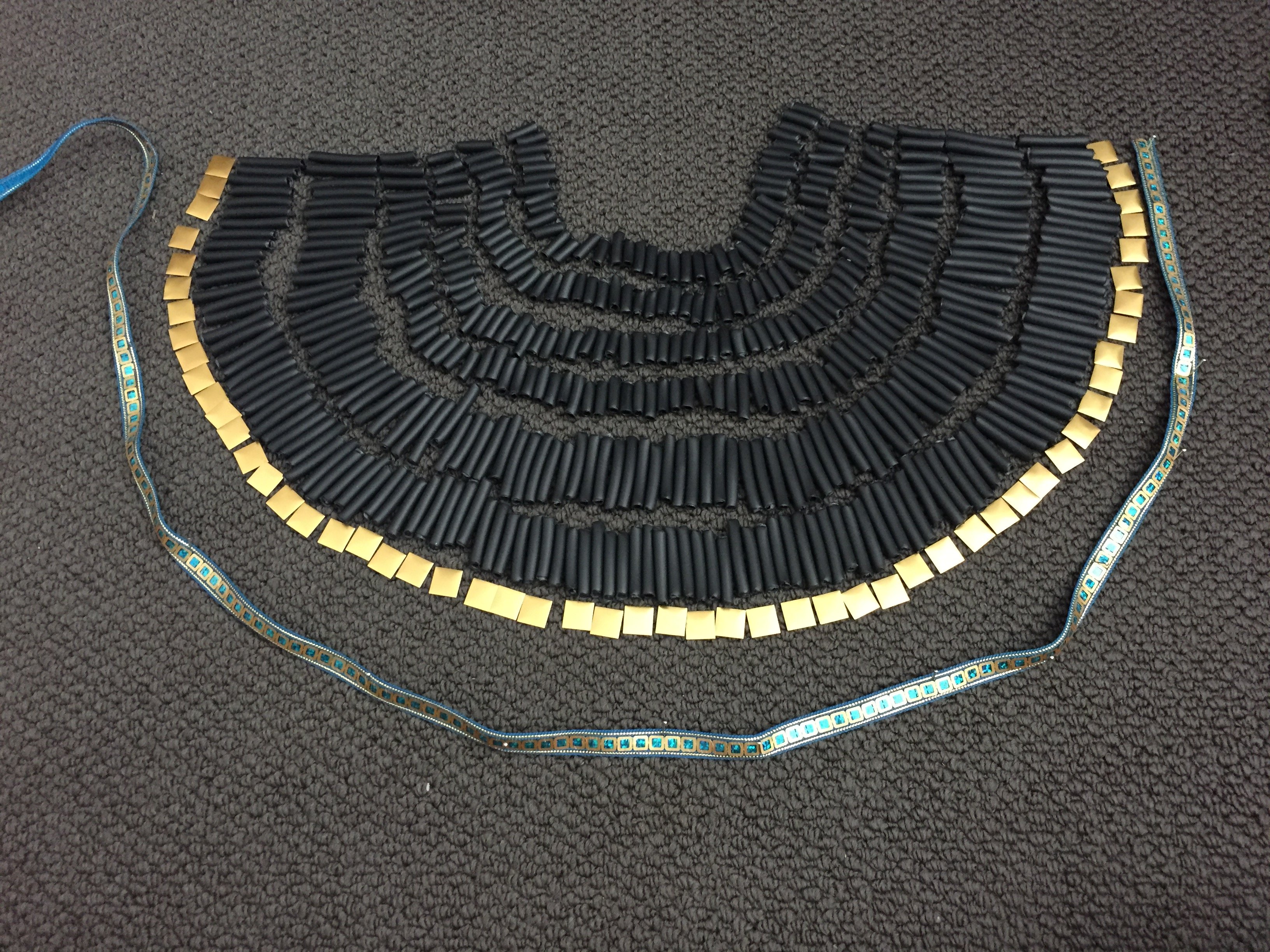

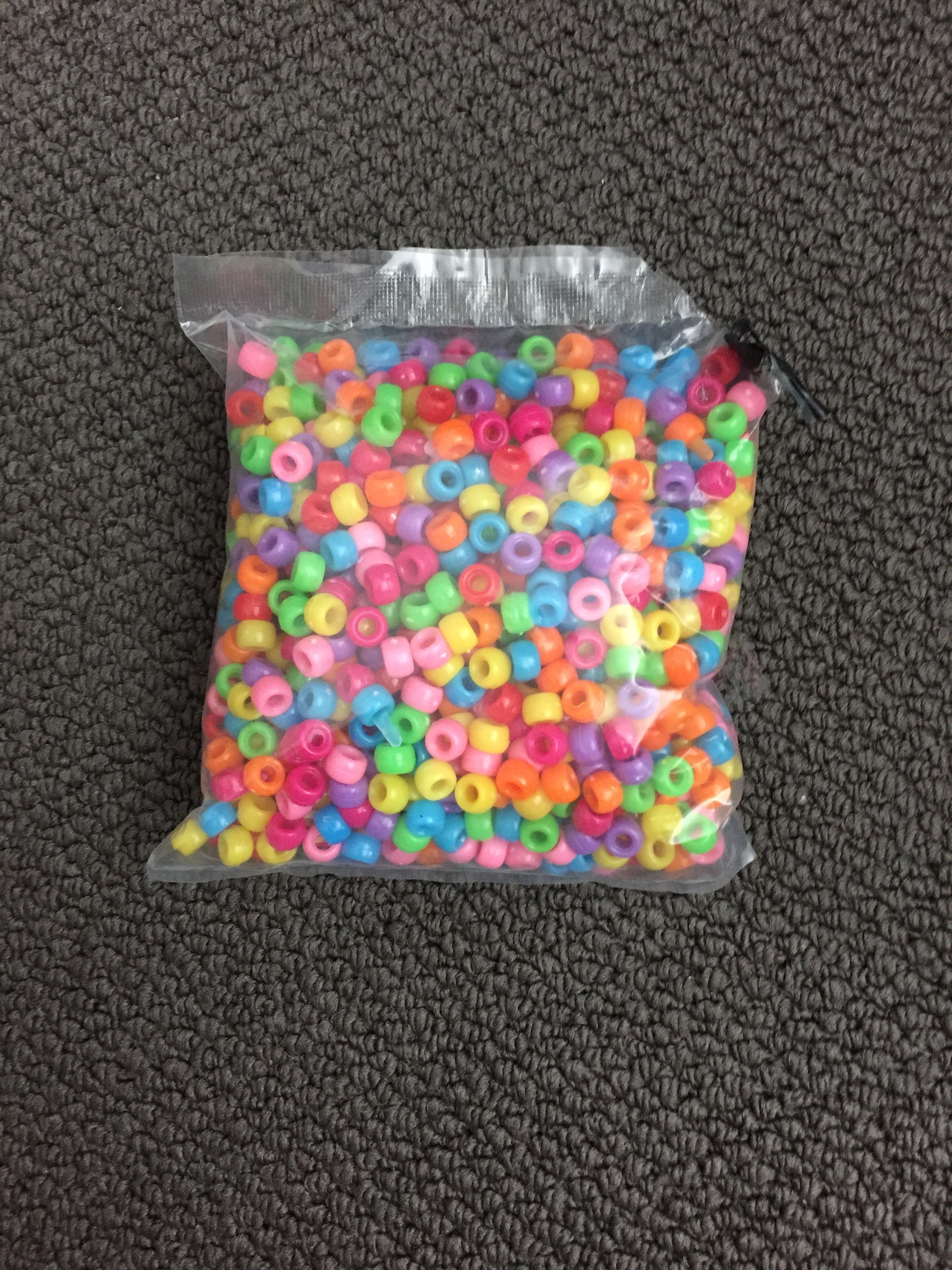

I used paper to create a template for the collar too, mostly to determine the scale and quantity of the beads. I have cut the irrigation hose to make the beads, now I have to sand, prime and paint them. For the small gold beads I will be using these cheap plastic ones and painting them, the gold squares are actually these iron-on things I used for some Loki costumes I made a couple of years ago, I fortunately had more than enough left over.

Regarding the deshret, that's a pretty complex shape for your first metal working project. I'd suggest making it from foam or paper to complete the costume quickly. Then trying your hand at some simple coppersmithing. If you like it well enough to build your skills, you can make the copper one to replace the foam.
Is there a MakerSpace in your area? They are great places to learn what you'd need to make the crown. The one I go to has experts in just about every form of fabrication and everyone is very helpful and willing to teach noobs.

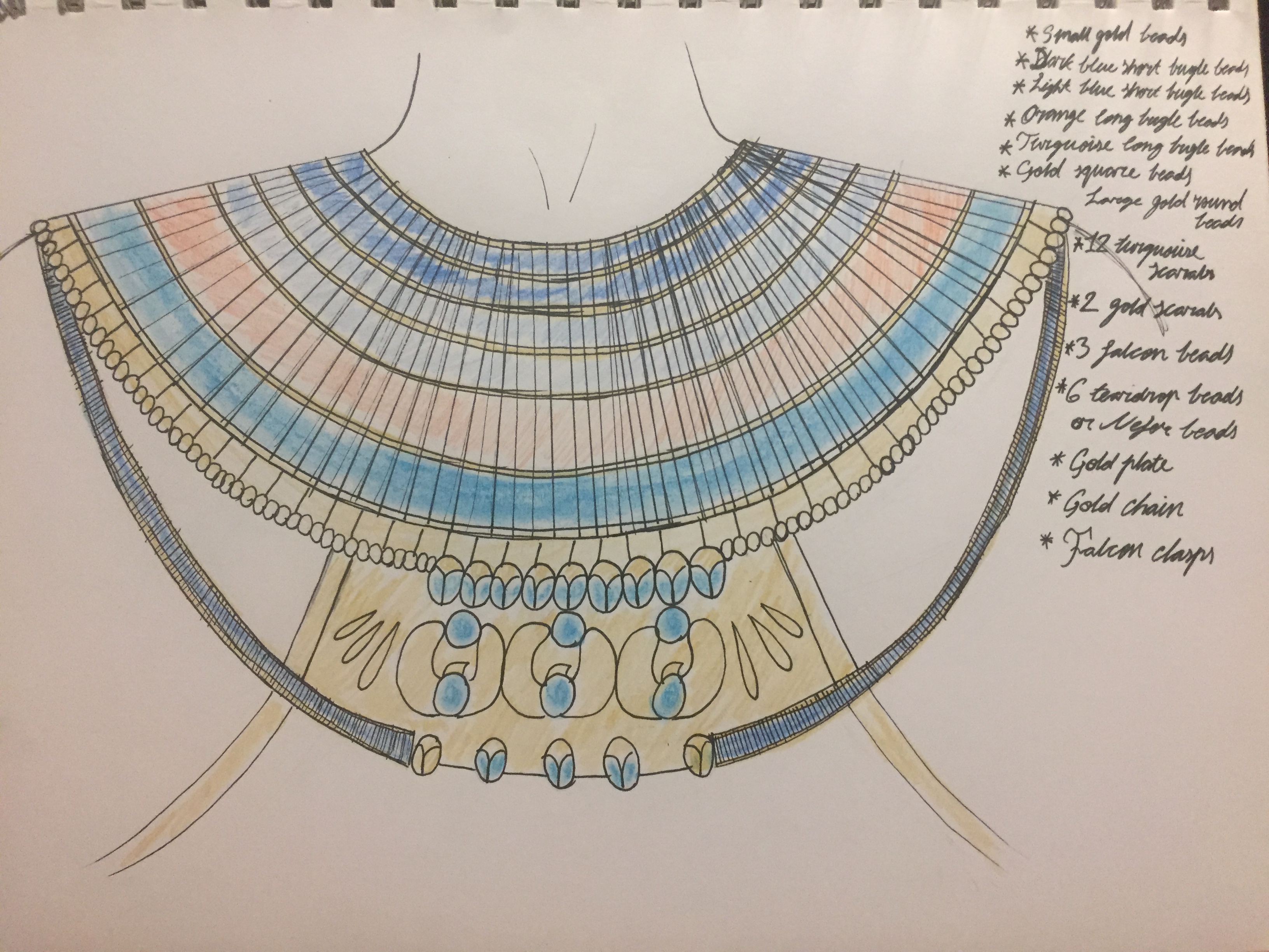

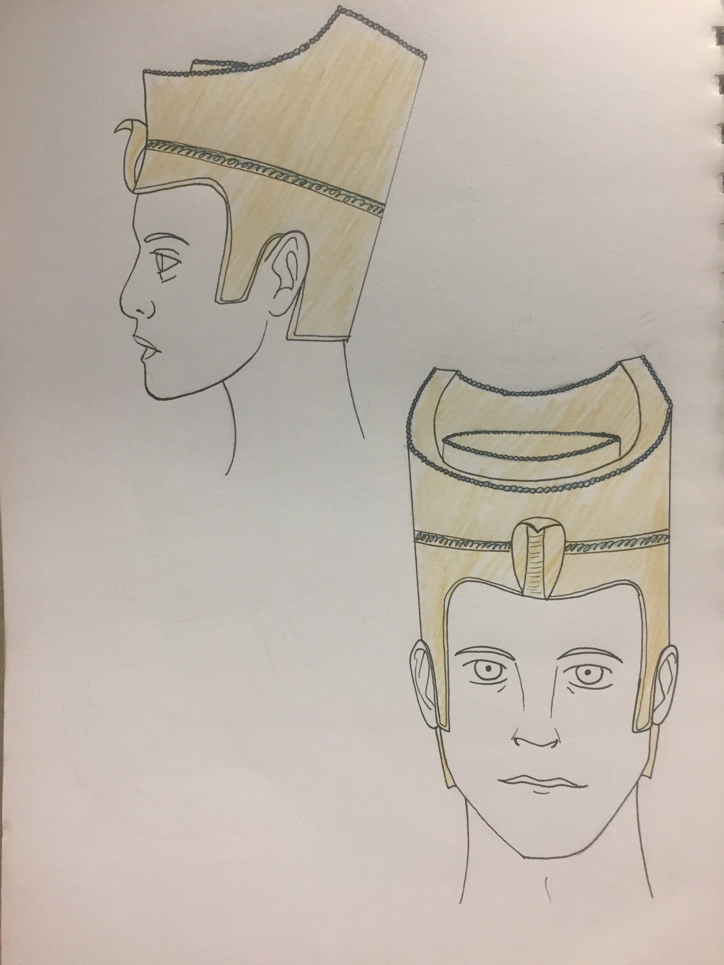

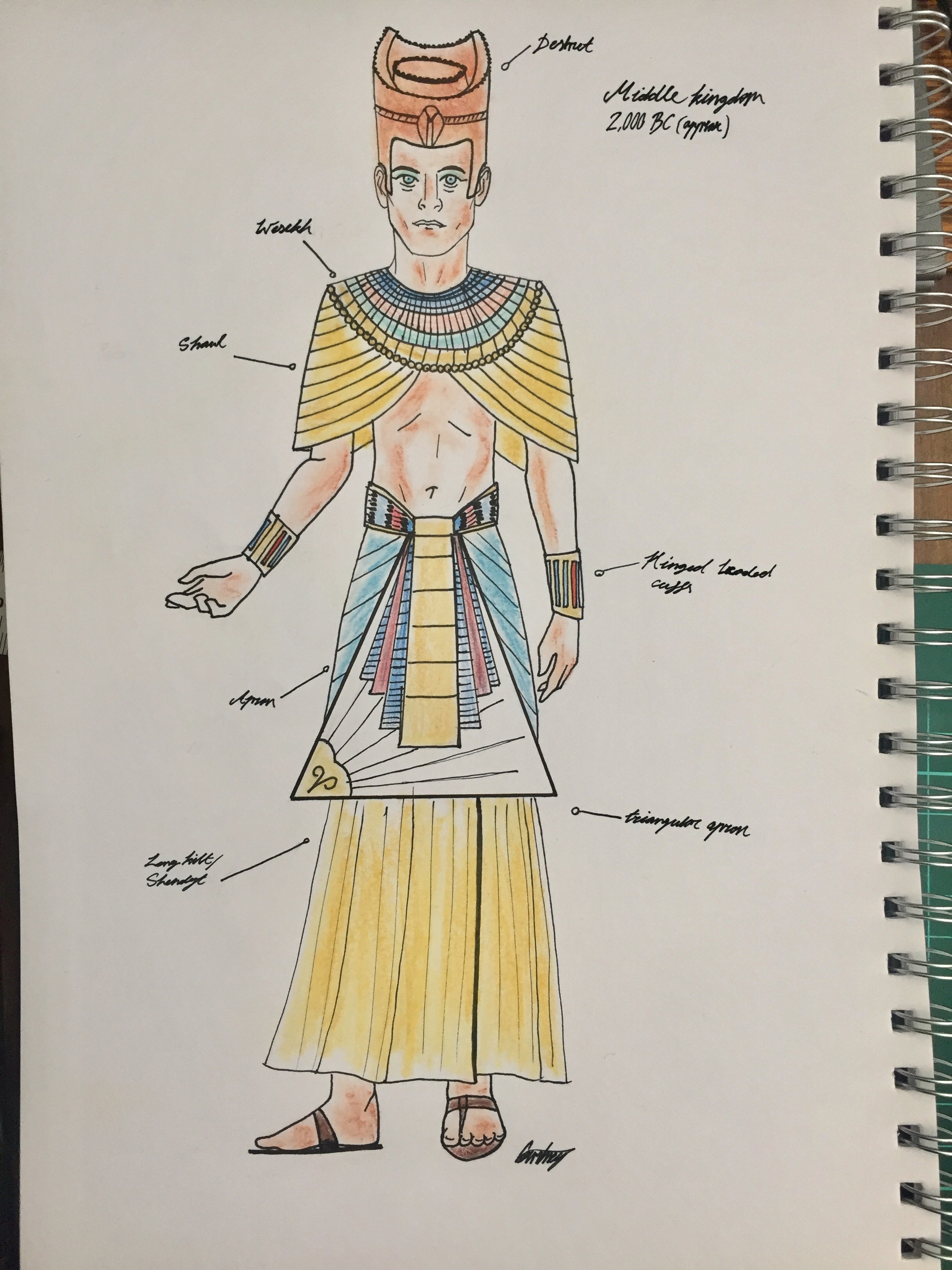

It's been awhile since I've posted an update, for the past couple of months I've just been deep in research, there are very few authoritative sources for Egyptian costume and there aren't many surviving examples of these clothes.The biggest challenge is taking all the paintings and sculptures of the time and trying to imagine how these garments would have been worn. I have been reading "Ancient Egyptian, Assyrian and Persian Costumes", which is a book from the 1920's and "Pharaonic Egyptian Clothing", both are excellent resources on the technical aspects of these clothes. I have drawn a sketch of what the costume will look like, I'll post that once I clean it up a bit. I've also been working on the deshret, I've made it out of worbla and it turned out quite nice, I just need to dremel a few corners and then it's ready to paint. I have made it as screen accurate as possible, I think it's the most iconic aspect of Ahkemnrah's costume, so to change it would make the costume less recognisable, plus it's fairly historically accurate anyway. Below is an illustration of costumes from 2,000 BC, the figure second from the left is basically what I'm aiming for, just add a cloak and subtract the fake beard and you've got Ahkmenrah.

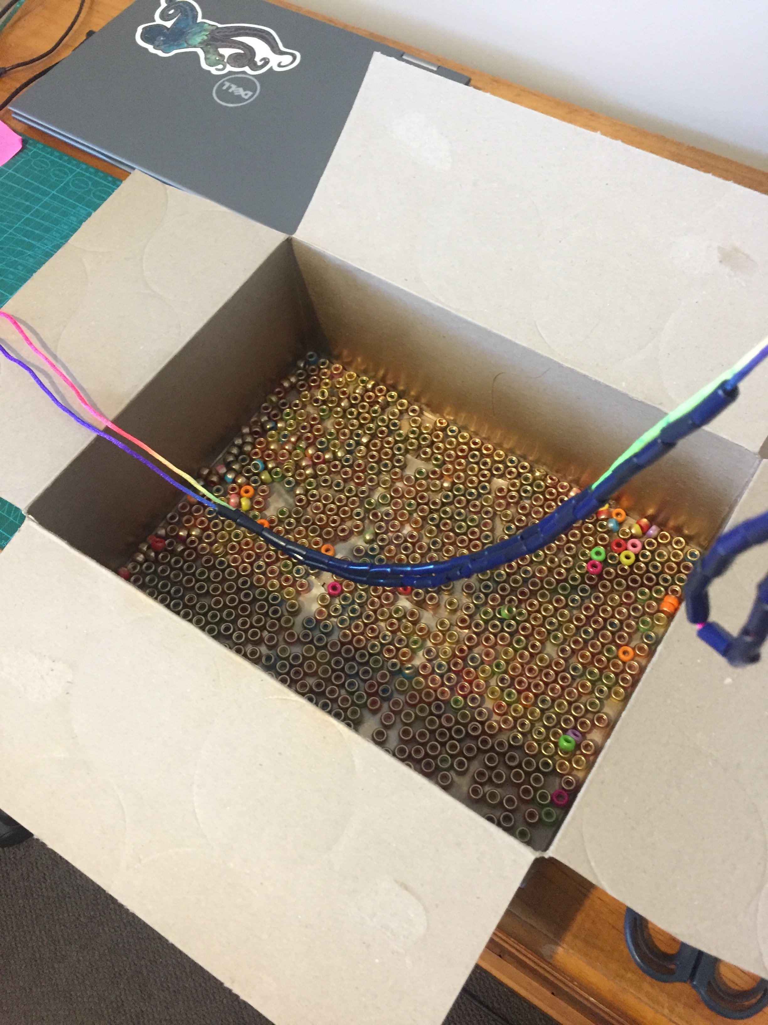

I started Ahkmenrah nine months ago, sine then I’ve been busy with commissions and study and also dealing with various health issues. But I hope to get it complete this year. It is a highly detailed costume, that third photo there is a shot of the beads for the collar, I’m having to spray paint them which is quite labour intensive. This costume is probably 50% complete at this stage. But doing this fitting has inspired me.
