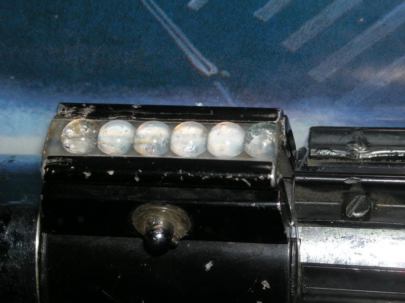

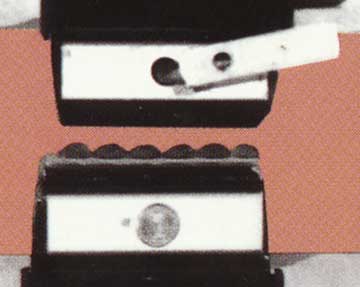

Is your "bubbles between the clamp" assumption based on the Chronicles photo alone or is there something else to suggest it was assembled this way?
I never understood what was going on with the bubble strip in this photo, because it looks so high as to be above or outside of the clamp. Personally I suspect this is the same bubble strip that is in the ESB/ROTJ saber (with a circuit board beneath it), because the bubble strip in the V2 was longer, extending outside of either end of the clamp.

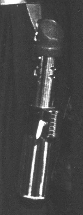

Do you plan on replicating the nail?

The "bubbles between the clamp" is indeed based on the Chronicles pic, and on the ESB/ROTJ saber. I honestly think that all the Vader sabers had the bubbles assembled that way. Of course it's only an assumption based on my interpretation of the pics, and I've replicated it because I think it's an interesting detail. :)
The Chronicles pic is a little peculiar indeed; on one pic it doesn't even look like the bubbles are there at all. But in the ESB/ROTJ saber it's unmistakingly between the clamp, which I find is the way to replicate that detail which makes the more sense. It's also why I cut my strip in the same place.
I don't plan on replicating the nail, no. My Vader will be unweathered and I think that the lever didn't break right away; it must've broke during filming. As an unweathered prop, I'll try to give it a pristine look, like it's just been assembled for filming.

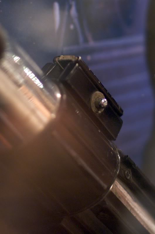

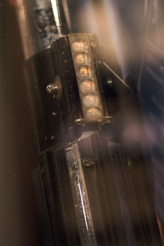

Not tryin to poop in your cereal, but the bubble strip on the ESB/ROTJ saber is definitely under the clamp. I visited it and took these shots. In the second one you can see the edge of the circuit board beneath the bubble strip. It is cut narrower, and presumably glued to the bottom of the bubble strip.
Nice shots. :) Nothing I can do about that with mine, though. Anyway my own Vader is supposed to be a ANH. If I was replicating the ESB/ROTJ I'd be worried. For now my bubbles/clamp kinda look like the ones in the Chronicles pics and that's fine with me. :)
