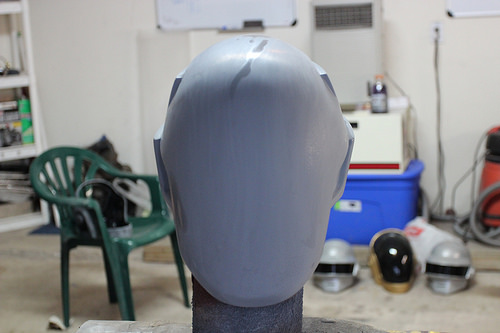

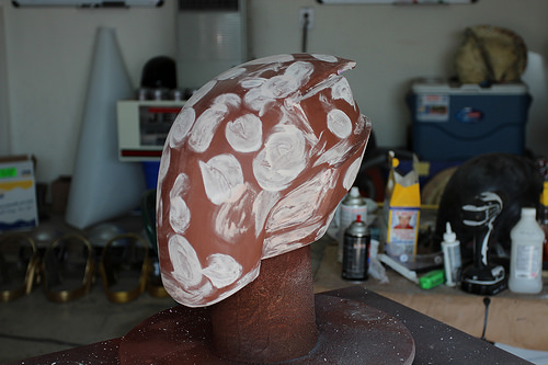

Okay so at this point I'd like to say I got paranoid and tried making it perfect and even in the beginning. Which is stupid now that I am almost done and looking back, I literally had to build up and sand down the same surfaces 5 times after the visor was finished.

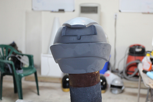

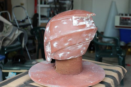

I essentially finished the front and got started on the significantly more complicated back end of the helmet.

The craters in the helmet were a result of my uneven coating as I was still getting acquainted with the filler.
I stopped taking pictures since I found myself sanding everything down, THEN rebuilding, then sanding it all away THEN rebuilding again and It was because I got into this stupid trance where if I work hard it'll all work out instead of being smart about it. So lesson learned, work on one area at a time, if you try getting the details of every area at the same time you'll go nuts and screw up.
Long story short and a couple of life lessons in prop making, I reached this point last night!

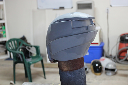

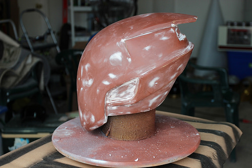

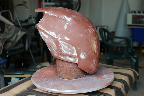

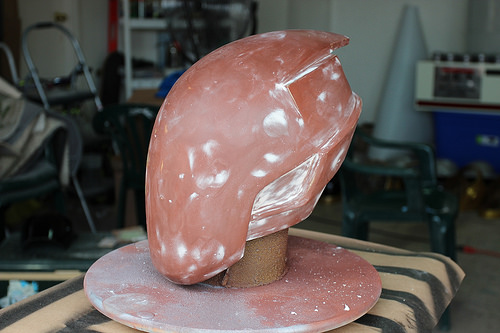

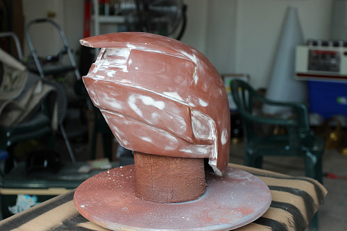

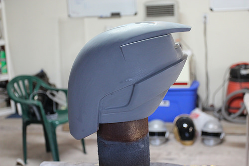

I skipped a couple of photos, but essentially I used brown rustoleum primer. Did a quick wet sand with 600 then 1000 grit sand paper.

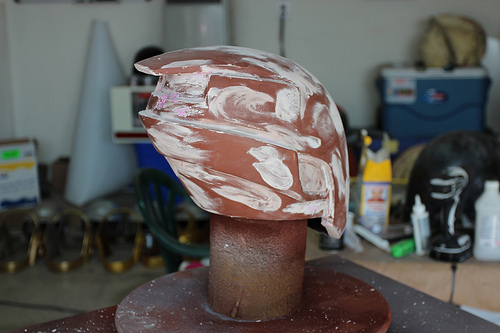

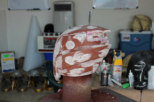

There were a few small holes in the helmet so I used wall spackle to fill them in and used 800 grit sand paper to even it out.

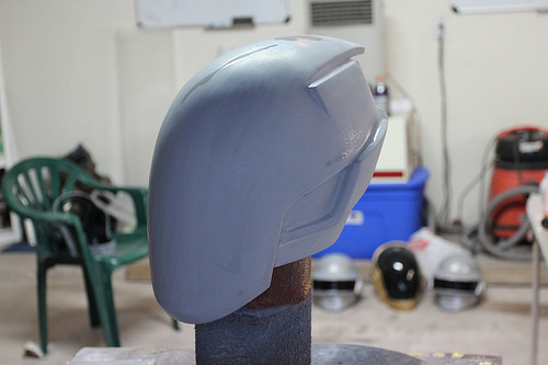

After all the sanding we end up with this.

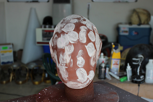

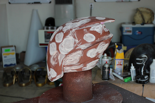

Finally we do a last coat of primer using a contrasting color to make sure we get a nice coat over it all.

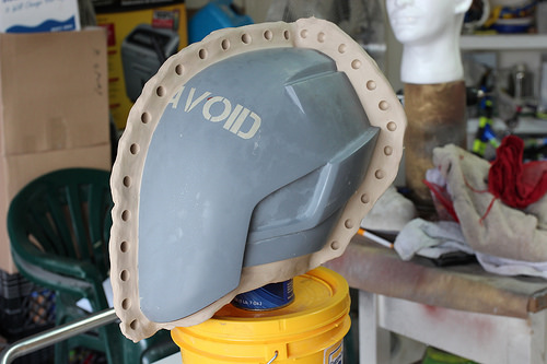

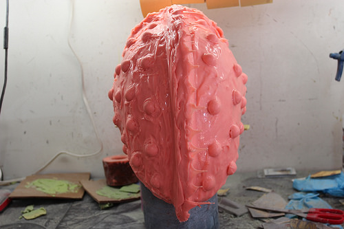

Now we start the molding process. I wanted to do a mold without a seam but that just didn't seem feasible or at least it would
tear the mold apart after a couple of casts... if I could even pull it off. The issue here was that the bottom was much smaller than the widest part of the helmet. So a two part mold would have been a good option... but instead we (my partner and I) made a 3 part mold. It was a bad decision but at the time it seemed like a two part would be a bad option.
We end up with this monster.

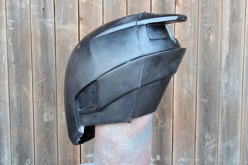

The helmet is cast in Smooth On Onyx Fast and it came out surprisingly well. The seams aren't too bad to sand, however some rebound crept into an area it shouldn't have and so we have a slight build up on the top of the helmet, nothing 5 minutes of heavy (but careful) sanding won't fix.

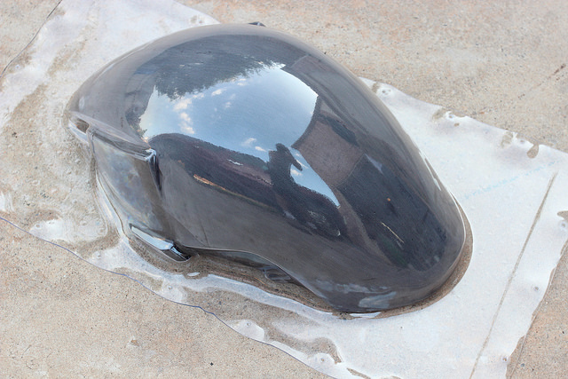

Now when doing the visor for the helmet, we simply cast the front half of the helmet and reinforced it so it can withstand vaccuforming. I simply use a sheet of P.E.T. in our ghetto oven rack and vaccuform it over our... other ghetto vaccuformer, It looks pretty good despite the lack of suction.
