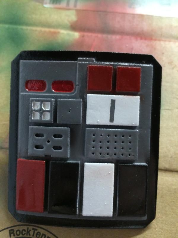

Commpad: 3d printed

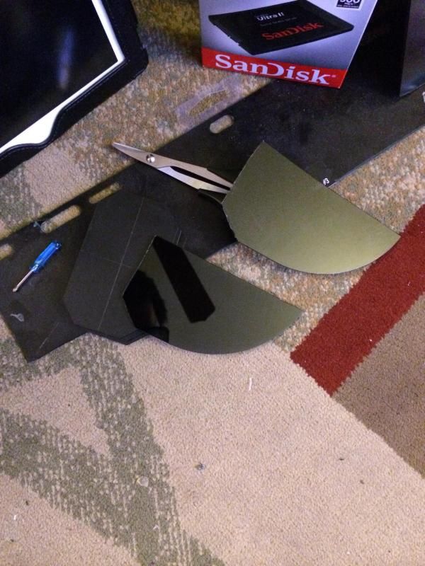

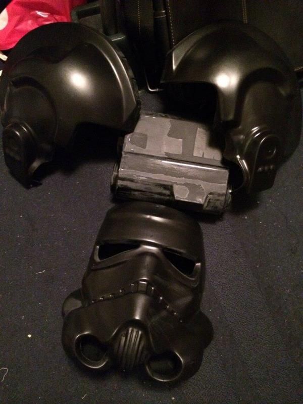

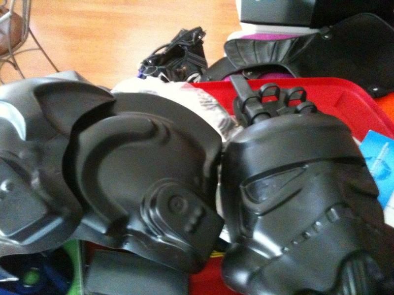

Shot of the helmet untrimmed, its the older ears molded in, came with no greeblies which I'll be sourcing myself. Kit also did not come with a plastic sheet for the Mohawk so a quick measurement from the trident piece and a trip to tap plastics solved it for a dollar.

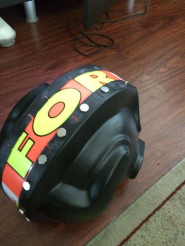

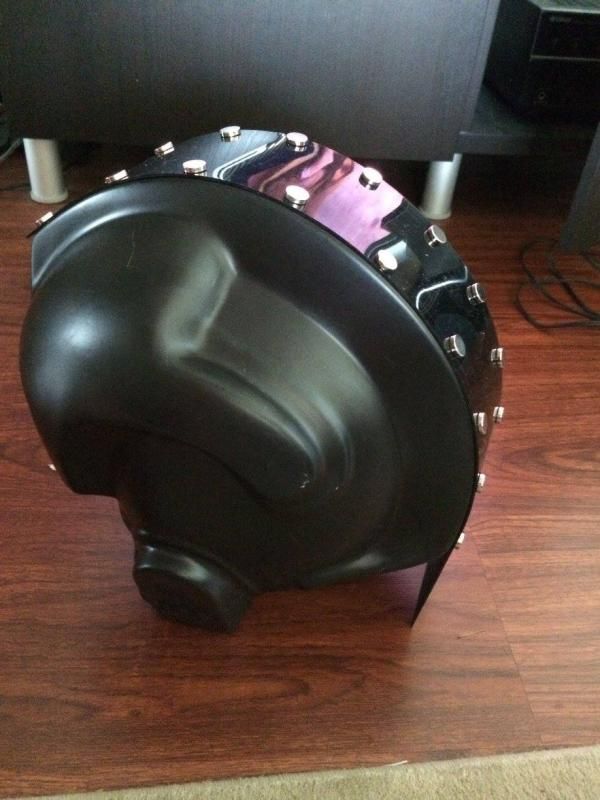

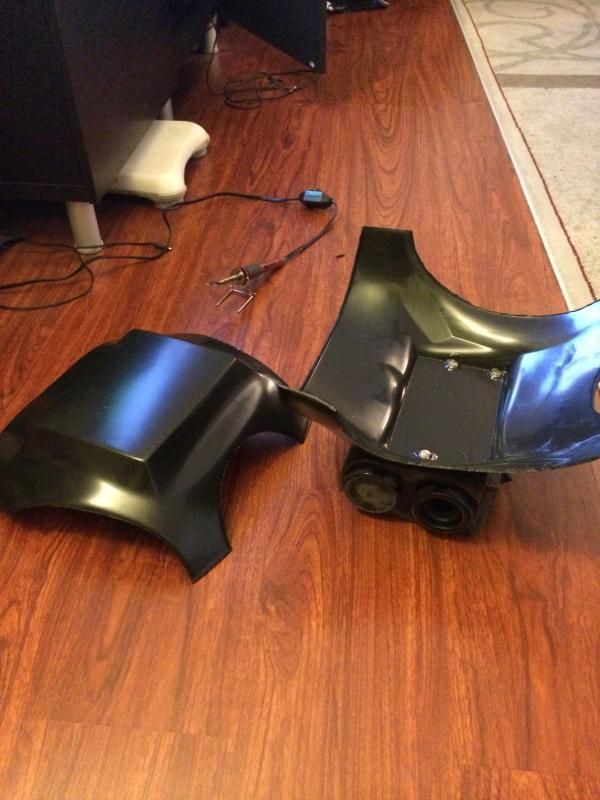

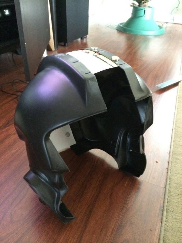

I used a for sale sign cut to build a stable frame for the helmet, kept it in place with magnets and then superglue.

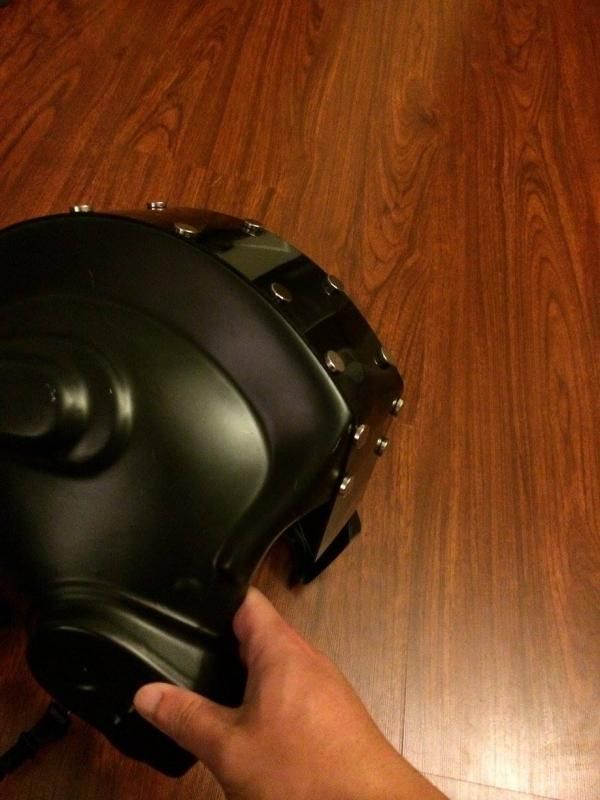

Once the for sale sign was glued in place, the helmet was pretty sturdy so applied the plastic strip, epoxy and used magnets to hold it in place, was pretty impressed at how strongly and firmly the magnets held it.

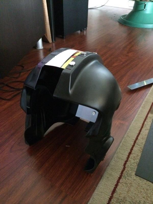

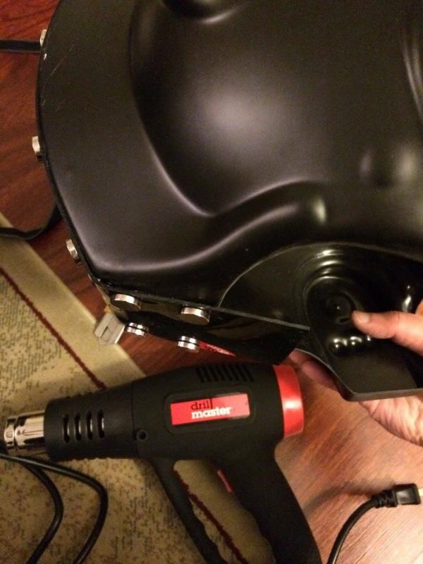

Trimmed the front and used a heatgun to bend the strip at the bottom of the helmet.

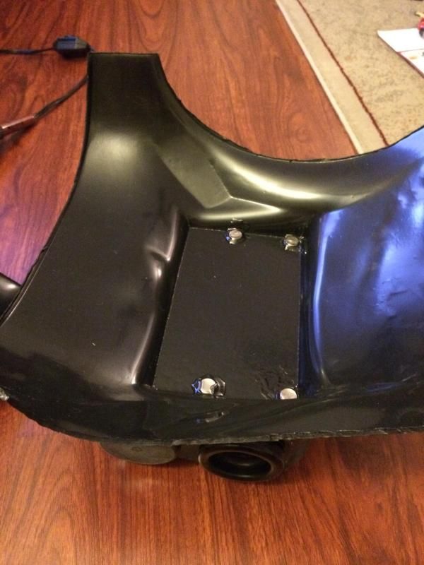

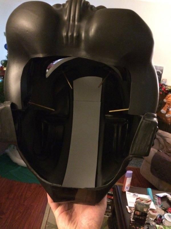

Positioned the face mask portion in and used 4 counter sunk machine screws to hold it in place after drilling 4 holes through the helmet and the face mask.
The only screws they had in stock were very long, I was going to dremel them down anyways so that wasn't much of an issue. Since then, I've cut them down and applied glue to the washers and nuts on the inside of the helmet, need to install the trident piece next and get some lenses made or cut out for it.
