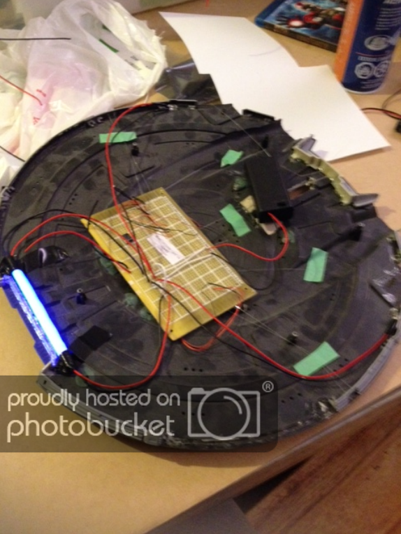

I spent the evening sorting out the wiring for the saucer, it will eventually be wall powered, but for now I'm running everything off of a battery pack to make sure the circuit works.

Looks fantastic! Thanks for the update! Loving the wiring preview and the cargo bay detail. Can you flip your phone sideways so we can enjoy the details of your videos in full letterbox style goodness? :)
