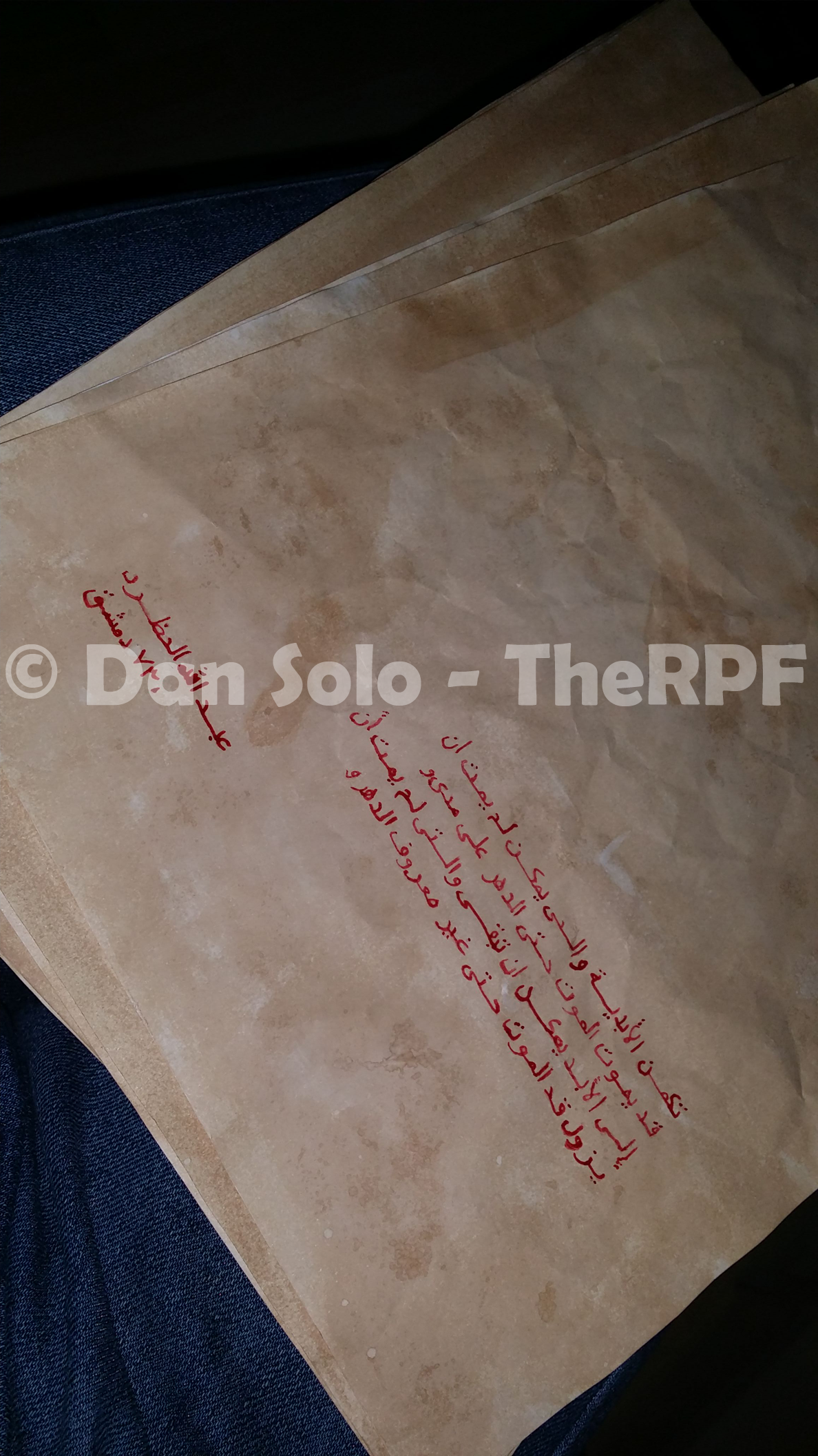

Hey all. I am a huge fan of Evil Dead saga and Lovecraft, and I am making my own Necronomicon since time ago. For the moment I made this:

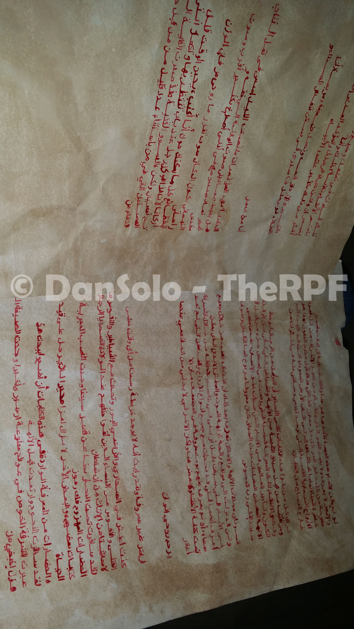

THAT'S MY WORK BY NOW, I HAVE SOME PAGES MORE. OPINION IT'S WELCOME TO!
The legendary book was written with blood, so I used red ink and pen nib to make it. It was written by the mad arab Alhazred so I wrote it in arabic. No, I don't know, speak or writte neither absolutely anything of arabic so I used our friend Google and I also used a phonetic translation for the names or words that hasn't a direct translation.

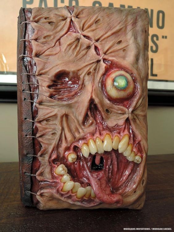

-Second. Making the covers. I am going crazy thinking in a material to make the cover. It must be flexible to avoid it break if falls and let it open it and not be too heavy. "Schlitzie" told me to use traslucid sculpey and airbrush, but I don't know much about sculpeys, airbrush and all that material, so I really don't have much idea of what to use, how mold it and how paint it (with normal brush if it is possible). The idea is to get something like this but with a simpler face 'cause I am newbie in this (the next images is not my work and I don't know who is the author, if I knew, I would also ask him/her too):
THIS IS AN EXAMPLE, IS NOT MINE. I PUT IT TO GIVE YOU AN IDEA OF WHAT I WANT.

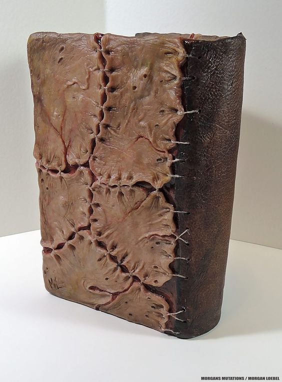

I'm a huge fan of evil dead and the necronomicon myself. I have made a few replicas, Im in the process of redrawing all the pages from all 3 movies, the remake and the tv series by hand, 88 done and about 38 to go!
I sculpted my cover and cast it in resin, then covered it in real thin goatskin leather, I was happy with the results, I think it could work great for a simpler face design. Also it is flexible, won't crack like latex and looks and feels real. Here is a pic of one I made a few years ago.
I hope this helps!
Hey Dan, those pages look good! That Necronomicon is made my Morgan over at Morgans Mutations on Etsy.
Thanks! I'll search for Morgan and I'll see if he have tutorials or something that could help me.
I hope this helps!
This is an idea I didn't think and look awesome! But, resin won't be heavy or is so fragile? Thanks!
Thanks all guys! And come one others who didn't post yet! All ideas are welcome, more than 100 biews and only 3 posted to help!
the resin from my book was slightly heavy but it was strong. If I had to do it again, I would use a lighter resin.Resin comes in many varieties , so I'm sure you could find one that is light weight and really strong.
