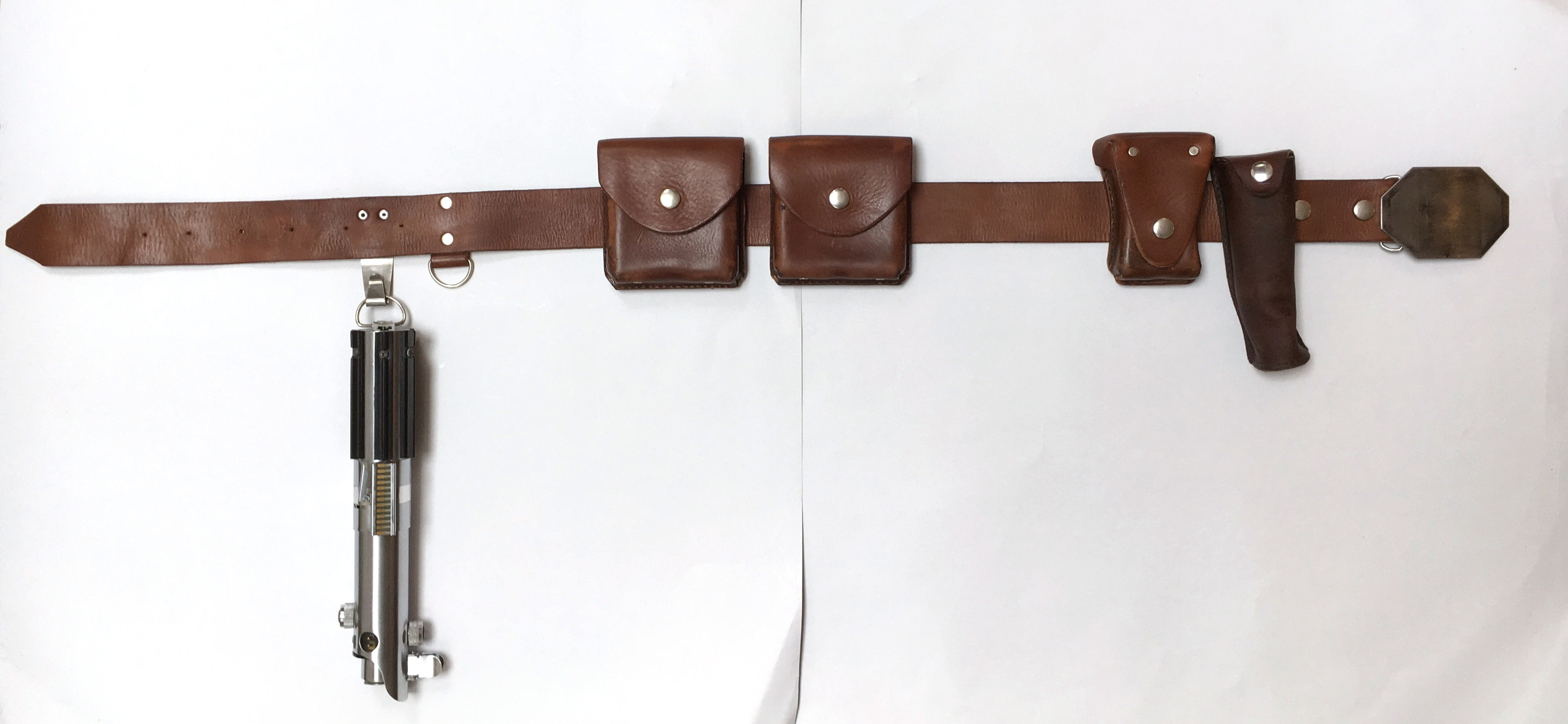

So I decided to make version A. Copying the pouch dims of the Archives belt.
FullSizeRender-1.jpg FullSizeRender.jpg FullSizeRender-5.jpg FullSizeRender-3.jpg FullSizeRender-4.jpg
I am considering this a prototype as there are many things that aren’t correct on this attempt.
1. Belt width is off by a few mm.
2. Pouches should be made with thinner leather – bit too bulky.
3. Stitching on big pouches needs to be cream twine, though not on the long pouch.
4. The bucks for wet moulding need to be refined for more accurate shapes/ dims.
5. Saber clip rivets too big.
6. Spacing between snap fasteners after buckle slightly off.
7. Leather rivets have been set without the tool so have a flat rather than domed look.

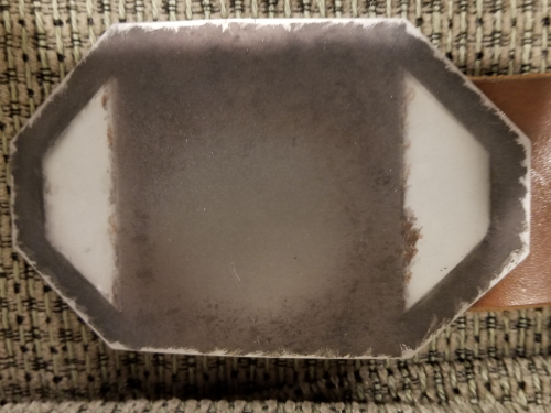

8. Buckle not weathered properly yet.
Hope you like it!

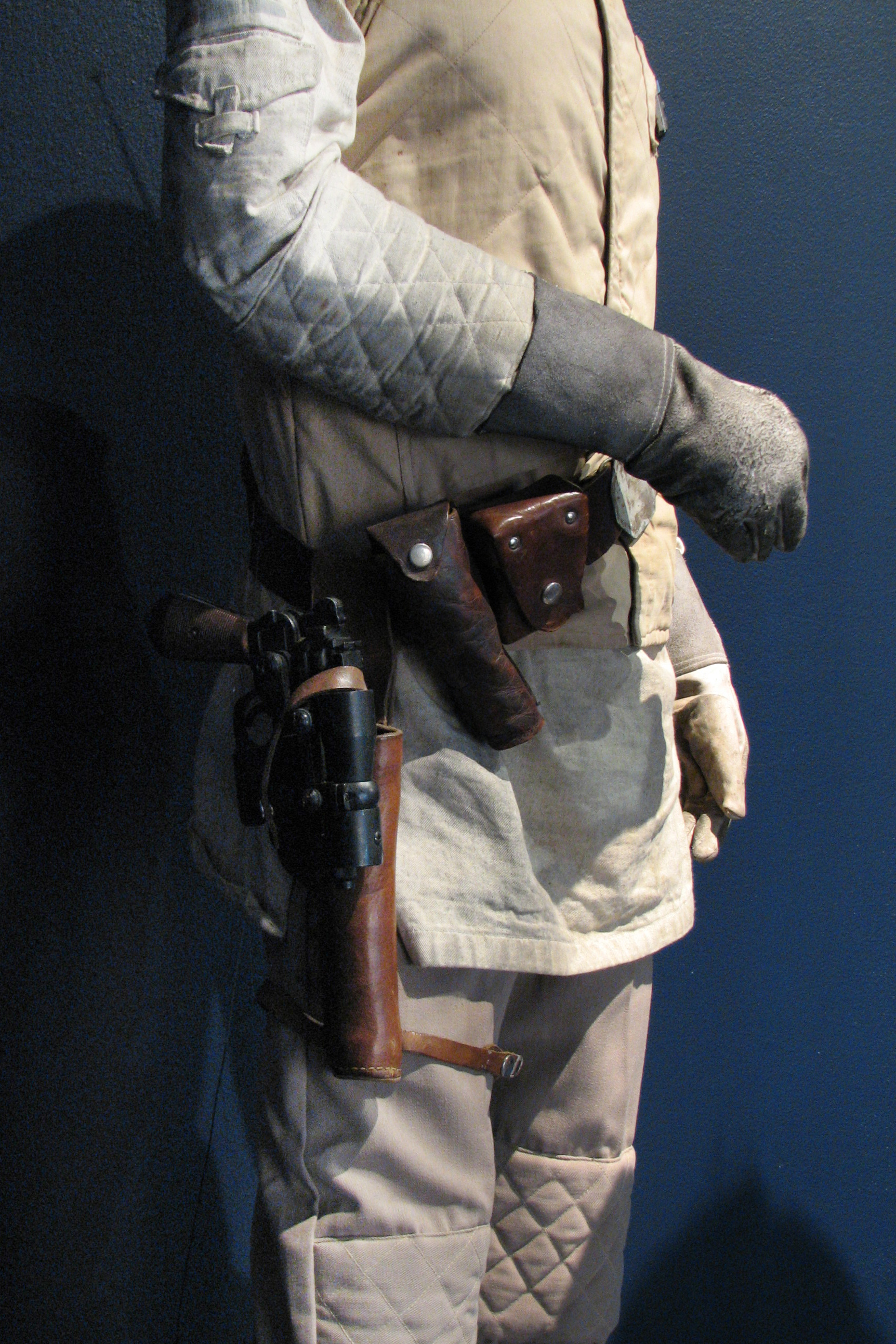

To give you an impression of Luke's holster which is different from Han's in the way it is attached to the holster belt. I thought I had a better picture in my archives ... I'll keep looking :)
Chaïm
Here are a few more photos that may help. There are several differences with Luke's holster compared to the Han Solo holster.
  • 2 inch wide drop down loop sewn to the top of the holster and also connected to the back of the holster with a line 24 snap.
  • The back of the holster has a small strap going across to hold the drop down loop and a line 24 snap (stud) to hold the loop in place.
  • Leg strap is located at the bottom of the holster and has four line 24 snap studs for adjustment on one end and one cap/socket on the other.
  • The blaster retention strap is sewn between the holster and drop loop.
35b.jpg88264074_2f1b0ed4ac_o.jpg3186161030_04329a59bb_o.jpgESBPress020.jpgIMG_20141218_0001a.jpgluke_r2d2_1_.jpg20141030_215933.jpgDisplay 05.jpg

It's clear the Bespin holster in the SW Costume book is a different one from the one on the Hoth uniform. Which does make me wonder, why didn't that original Luke ESB belt make it in the book?

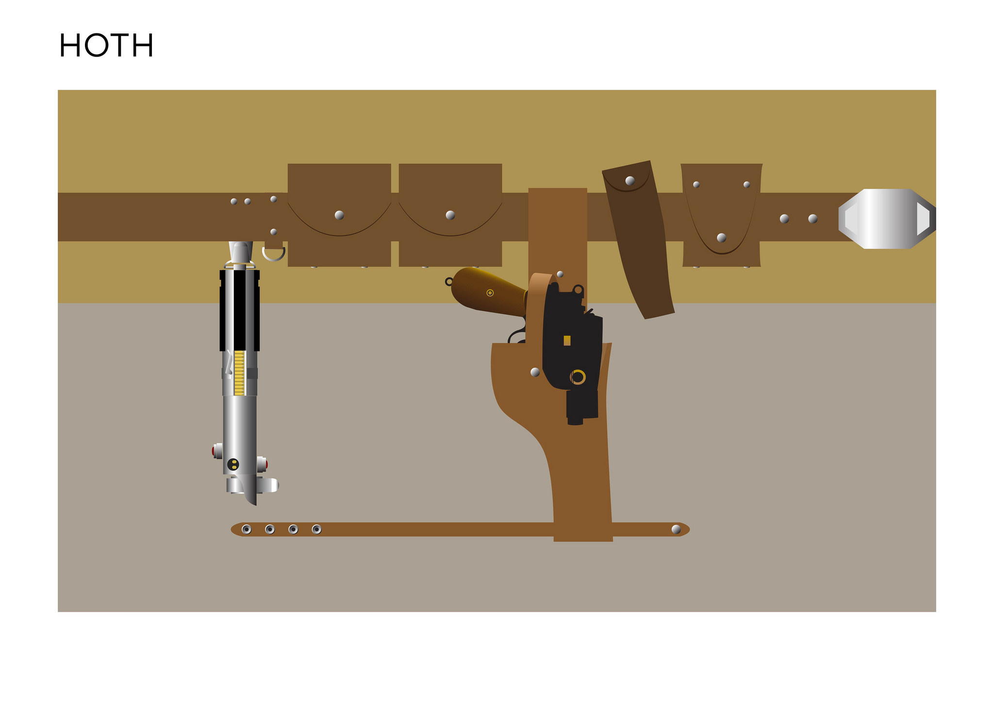

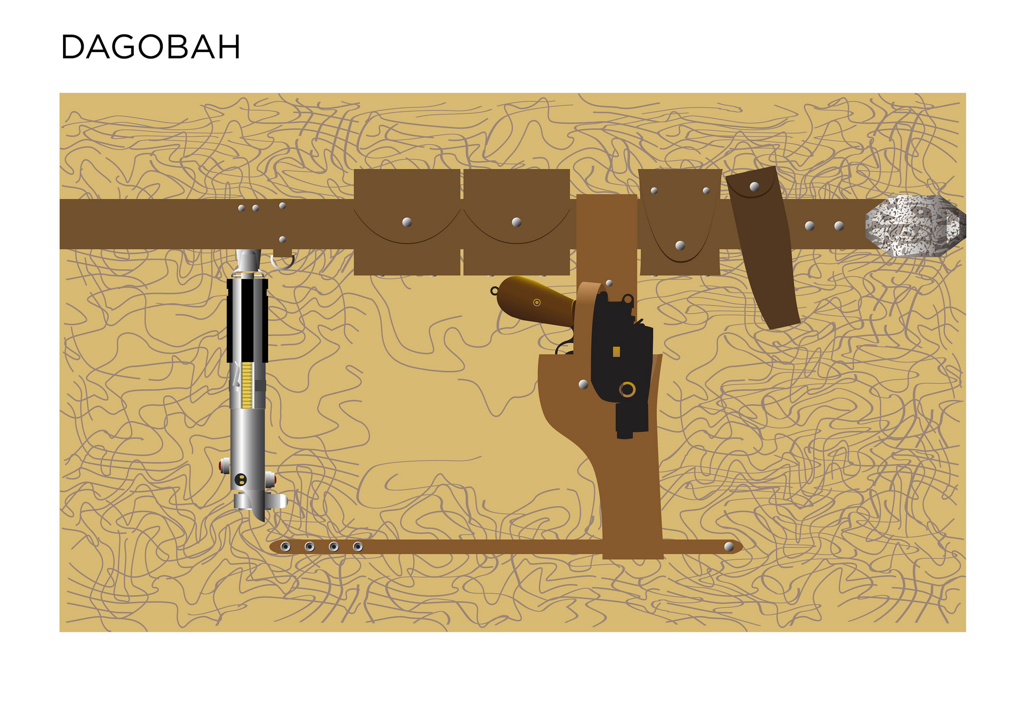

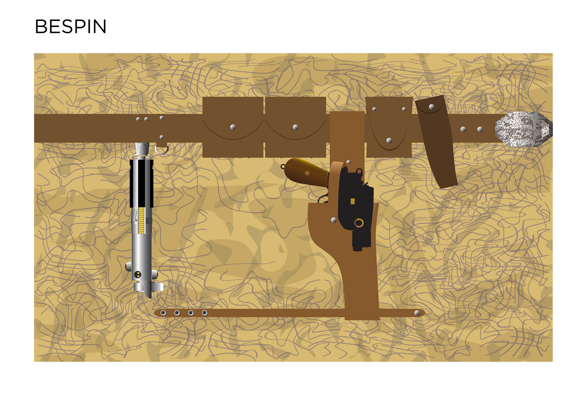

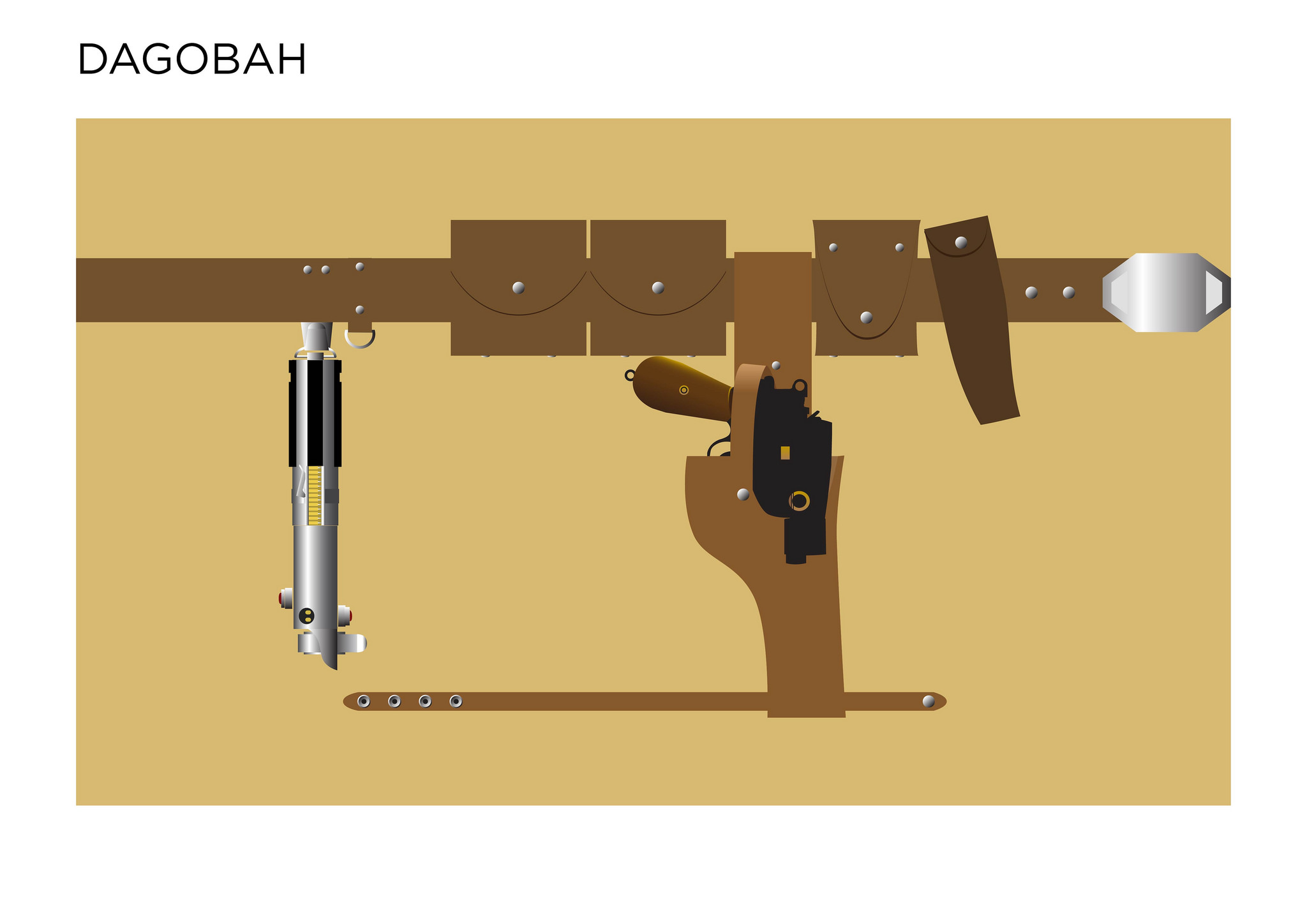

Hi All,
I put these together for Rebel Legion as I’m also trying to build an ESB Luke utility belt rig.
(Purely ESB on-screen. No promo photos, exhibition set-ups, etc.)
Perhaps you guys can point out any glaring errors or omissions.
Meeting Bigfoot & a Torn Taun-Taun:
I think there may be another Hoth variant here
Going Rogue:
Taking a Dump in the Swamp:
Away Put Your Weapon:
Your Weapons, You Will Not Need Them
R2 Bump:
Turning Down the Top Job at Daddy’s Firm:

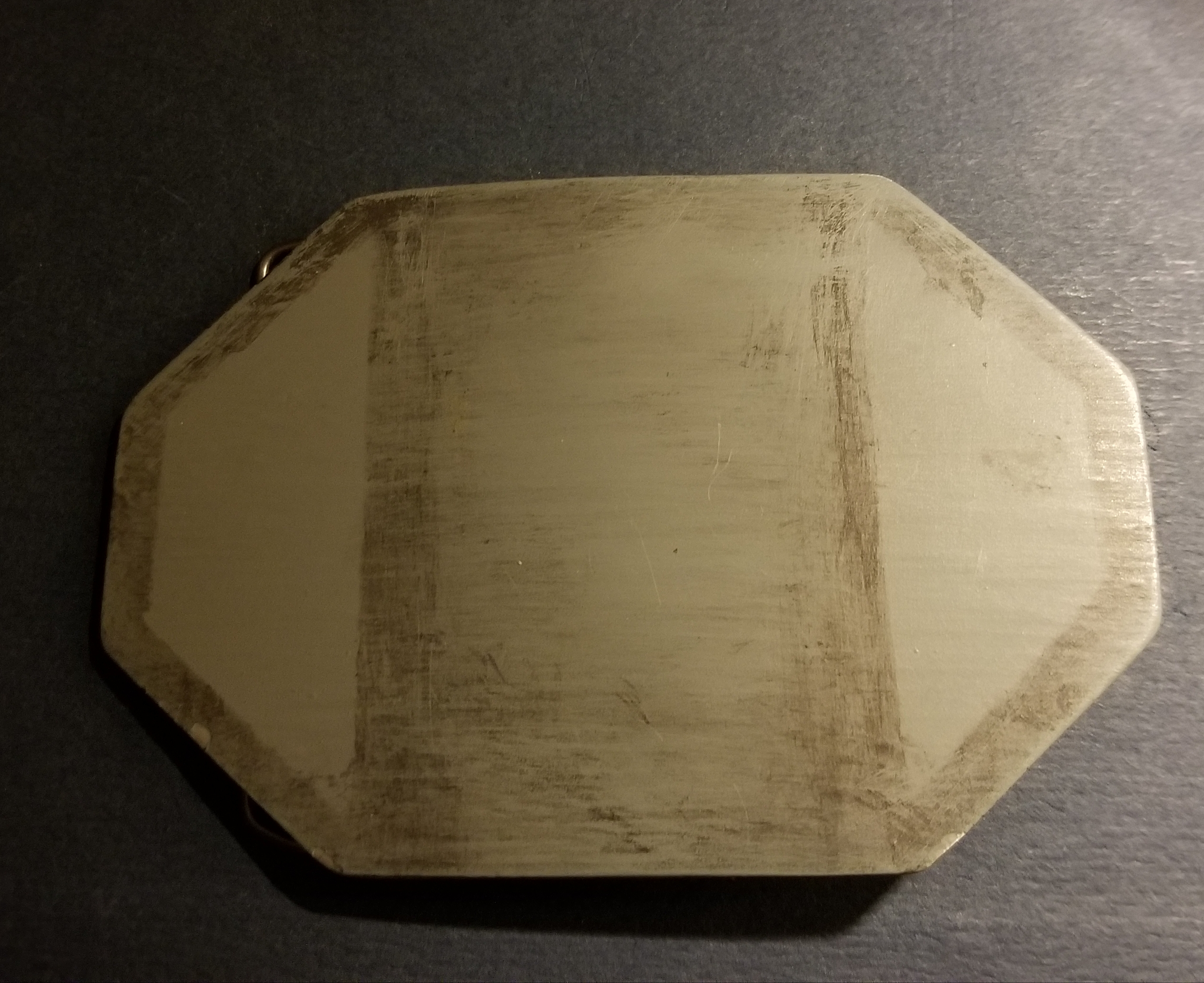

Where the dimensions of the belt and buckle ever determined with reasonable error by the RPF community?
Luke ESB belt info
I saw in an early rpf thread that the belt thickness was either 2 inches or 1 7/8 inches
And that the buckle overall dimensions were 4 1/16 x 2 5/8 inches. (I've also seen that the buckle was a 3x5 ratio... both are very close to each other. )
Also was the buckle flat or curved? In some I'd swear it was slightly curved others flat.
