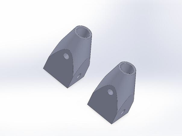

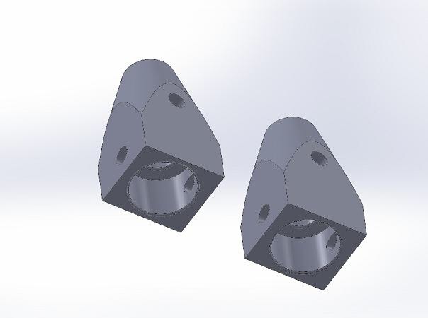

I got Chris at CSB Props on Shapeways to design a JA Mitchell transrotor head. He says he had to take a few liberties with design to make it work , but it's compatible with his stylus brush prints. I ordered a pair of each to test them out. Thought you might be interested. image.jpgimage.jpg PM sent about your barrel assembly.
I got Chris at CSB Props on Shapeways to design a JA Mitchell transrotor head. He says he had to take a few liberties with design to make it work , but it's compatible with his stylus brush prints. I ordered a pair of each to test them out. Thought you might be interested.View attachment 338612View attachment 338613 PM sent about your barrel assembly.
These look good, but lack the "cutouts" that are present on the real connectors.
Do you plan to file these out of the 3D print or would you see a chance to mod the 3D file?

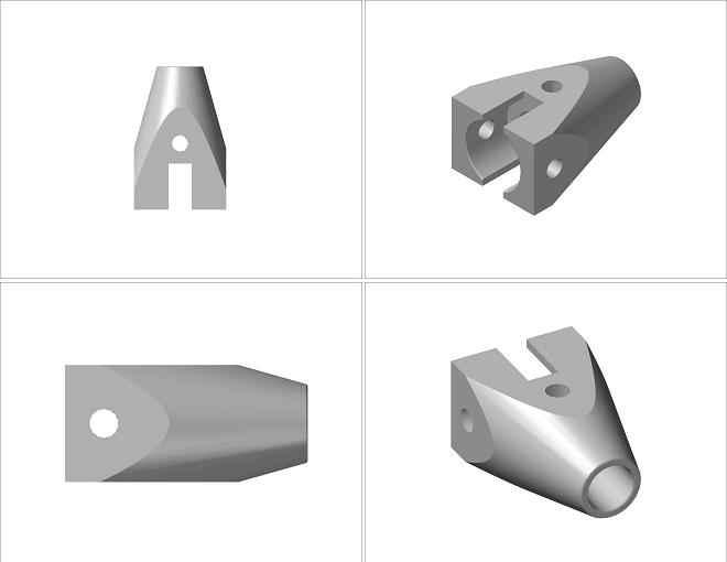

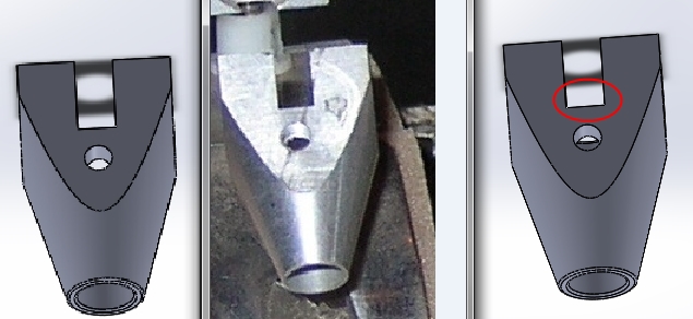

I will have to play around with the model on the Mitchel trans rotor piece to get the slots into it. I was having issues with sharp edges & thin walls which were giving me warnings against having them printed so I omitted them. That was the liberty I took in order to make them printable. Instead of going to a sharp point where the slot breaks into the hole there may have to be a small flat area, but it will still have the look of the slot. Would this be acceptable? if so I will see what I can do about making it printable with the slots.
The wall where the slots are to be is only 1 mm thick & could easily be cut out for the slots on the current model.
As for the sweep arm tips I could model those up as well if in fact they are the same as the Boba Fett toe spikes & knee dart.
Any input to help with accuracy would be great & I will see what I can do.
Did some work on the model & got the slots in but there is a flat area instead of being sharp where it breaks into the hole. Let me know what you think.

looking much better, but the slots seem to be a tad too big. might just be the angle!?
will a real stylus brush rod fit into it?
Thanks for your efforts!!!
Markus
Thanks Markus,
Trying to get this as accurate as possible based off just using reference photos (not much out there) & scaling them for size with really no known dimensions for this part. I tried to match up the view as close as possible & I did go back & shortened the slot by .5 mm which looks better but is tough to get the exact angle of rotation. If I had a real one in hand to measure this would be easy to make a replica.
The counterbore that the stylus brush would fit into is drawn at 10 mm with some clearance. This is based off of reference photos & information that has been out there in other discussions & was used to determine most of the scale for the part. If you have exact dimension of the stylus brush diameter, the model could easily be changed to accommodate those if need be.
Any input would be greatly appreciated.

Even if my real connector has a slightly different taper, I´ll try to get you some measurements.
Reg. shapeways "warning", when you are working with too thin objects...it´s just that, a WARNING...you can still have it printed, they just don´t guarrantee that it works (ultra detail should do the job).
Maybe it´d be an option to model TWO versions...one "idealized" for a better print, one accurate.
They shouldn´t be that expensive to give both a try (actually I have to order some stuff from shapeways anyway)
