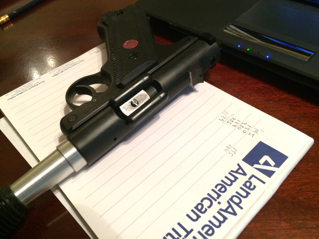

I started this build with an ASG Airsoft Copy of the Ruger Mark 1 (the real prop was built from a real Ruger Mark 1).

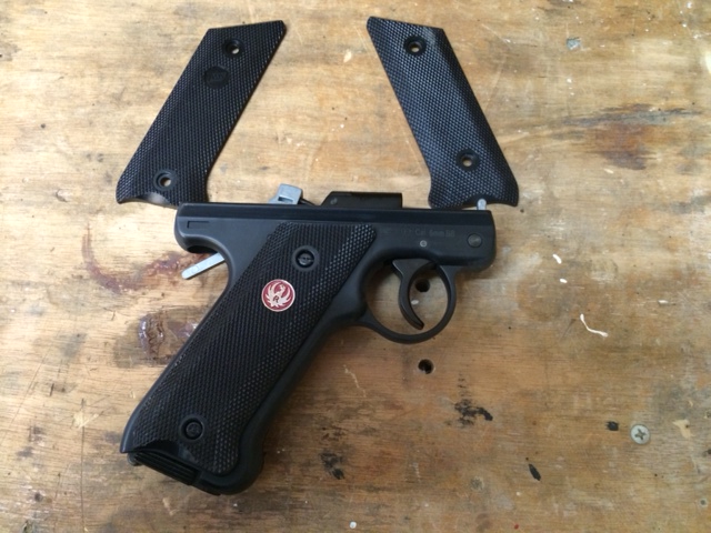

My first step was to order the correct rear sight from Ruger, I picked up a set of grips as well. After a couple of modifications to the sight and grips, I was happy.
The airsoft is pretty cool so I decided to keep it functional if possible, next step was to replace the barrel to a more correct tapered barrel specifically like the prop pictured below. Got this pic from one of the above threads, notice the extended step before the taper.

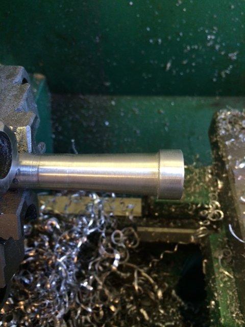

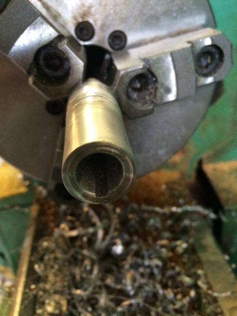

My Barrel Construction
I drilled the new barrel to hold the airsoft metal barrel and recreated the slot and setscrew from the plastic airsoft bull barrel.

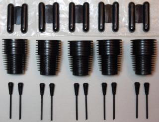

Thanks to the above threads, I found some of the detail parts are from the Hawker Tomtit Model Kit. I got a couple sets of the parts from Reade Models in the UK.
Here is my barrel with the Tomtit Engine part as a Flash Hider.

The other Tomtit detail parts are included in the picture. I cut my imperial disc details a little small, so I will need to make some new ones a tad larger.

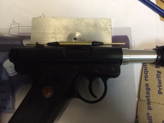

I antennae parts or qtips were a bit small to make on my lathe so I drilled out the tomtit qtips, made a center section and ran a brass rod through the parts for the completed detail. I need to make a base so the detail runs parallel to the gun, but I am pretty happy with the current state of the project.

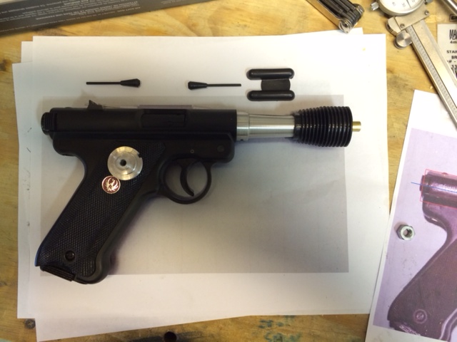

The sight rod greebie (always loved that word). I made mine from the Tomtit push rods, a piece of brass stock, and a 2mm brass rod. Since the tomtit push rods are plastic and I am going to holster the gun on occasion, I decided to replace the plastic rod section with a 2mm brass rod (adding durability and allowing for a mostly straight sight section, since I drilled a 2mm hole through the push rods and the brass center section).
The back of the cylinder head (Catamaran piece) is hollow. At first, I thought about gluing two the heads together, so that the pill sections are cylindrical, but that makes the part pretty big. I have not decided whether to use the part as is (hollow), glue two parts together, or fill in the hollow parts with epoxy or bondo.

don't fill it... the prop dept. didn't do this either ;)
Markus
Yeah, The more that I think about it, I just think attach that sucker and forget it. Thinking of drilling a small hole in the middle of the piece and tapping the bolt / ejector with a 4-40 tap, then filling the space with a couple of washers. Maybe a little over kill, sure the prop department just glued it on
Are we positive that the open section of the cylinder head (Catamaran piece) points to the back of the gun?
Ok. I mounted the cylinder head to the ejection port. I can always glue and fill the hole later, if I decide that I don't like it. ImageUploadedByTapatalk1397519222.174205.jpgImageUploadedByTapatalk1397519230.357051.jpg
