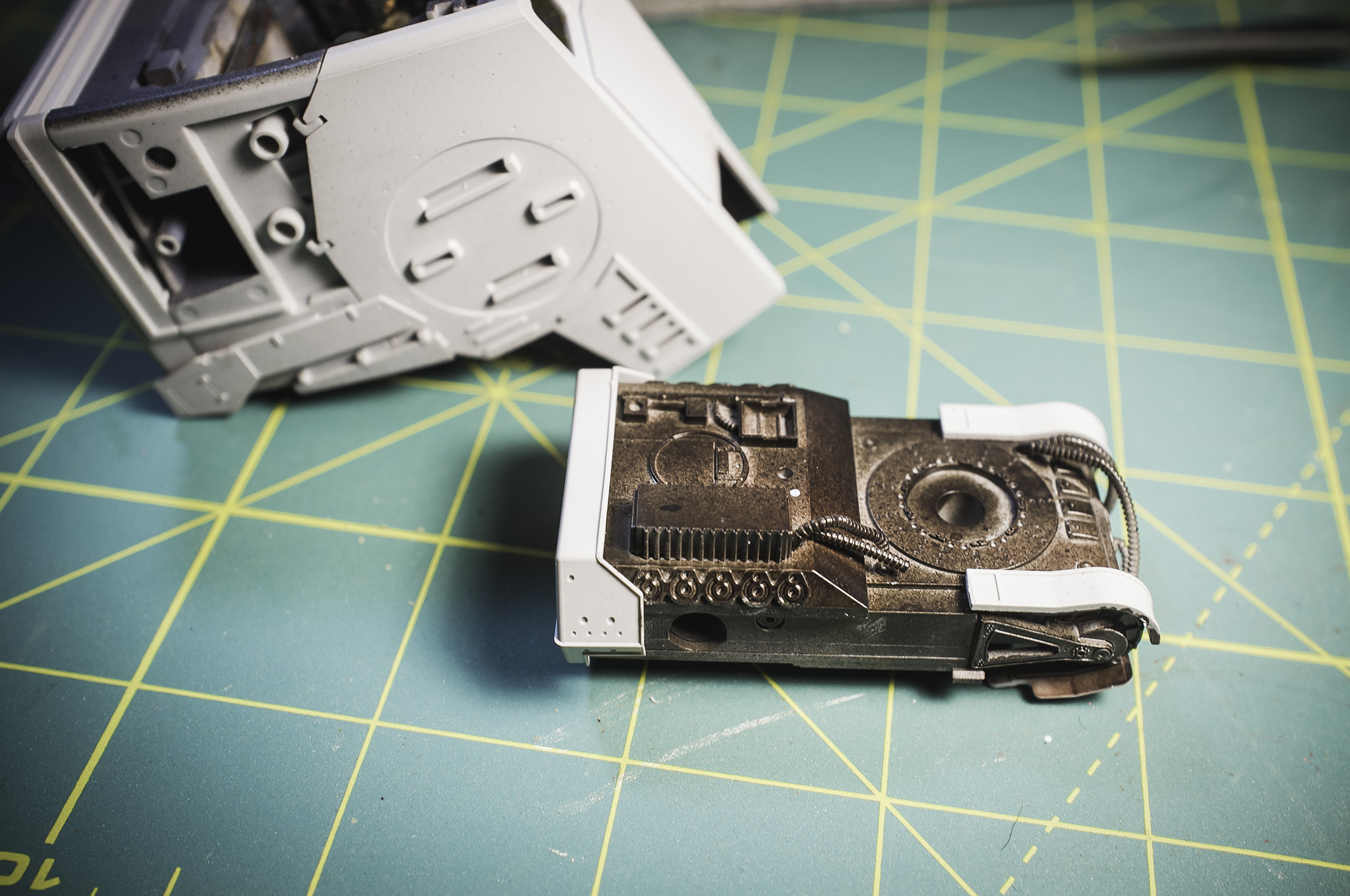

And now for putting together the rest of the kit. But first I paused to dirty some stuff up. I knew that I wanted the bed between the head and the legs to be really dirty, so I figured I'd use some browns to pre-shade it. This plan would be foiled later when I decided to black base the model.... oh well.

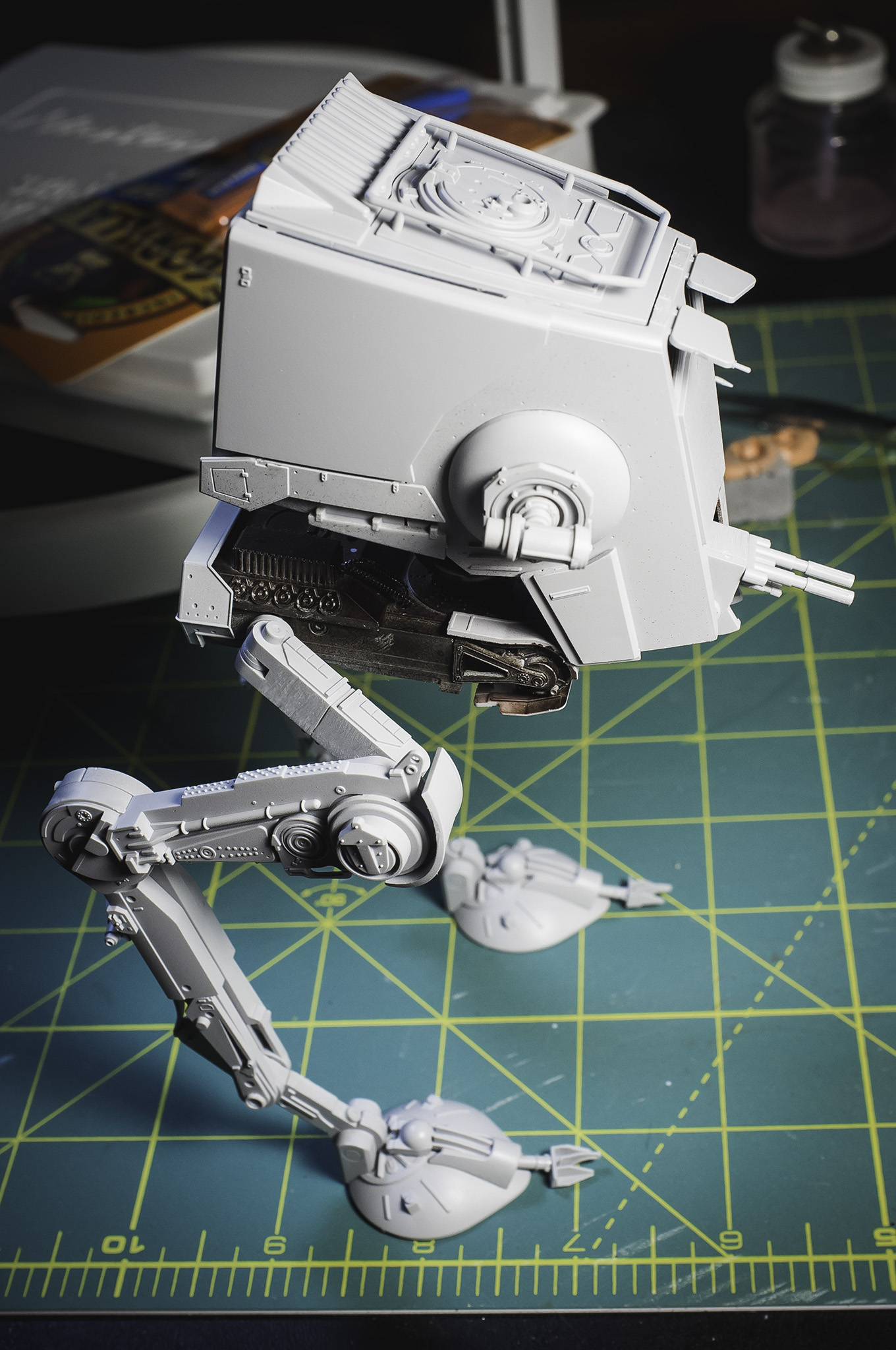

All assembled. You have to admire the engineering of the Bandai kits, but if I'm being honest, I found the legs to be a bit tedious. I wound up splitting them up into two days.

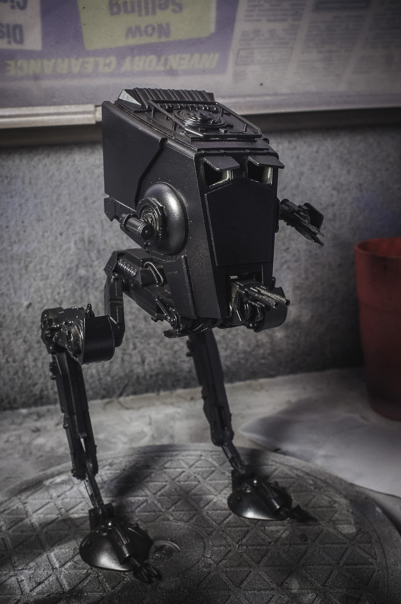

As I said above, I decided after assembly to black base this one. Normally I pre-shade panel lines, but with all of the large, flat surfaces, I thought the black base / marbling technique might work pretty well. Unfortunately, between this and the gray base coat, it covered up most of my brown pre-shading.
For both this and the main gray coat, I decided to use Testor's Aztec airbrush paints. These are pre-thinned to nearly the consistency of water, so really lend themselves well to the black basing technique, where I want a lot of transparency with the coverage. Just a couple of things to note with them, though: the paints do tend to have a bit of a glossy sheen to them, and they aren't really well suited for complex masking. They work great for covering large surfaces and then protected with a gloss or dull coat, but sometimes masking tape can pull up the paint if used for detail work.

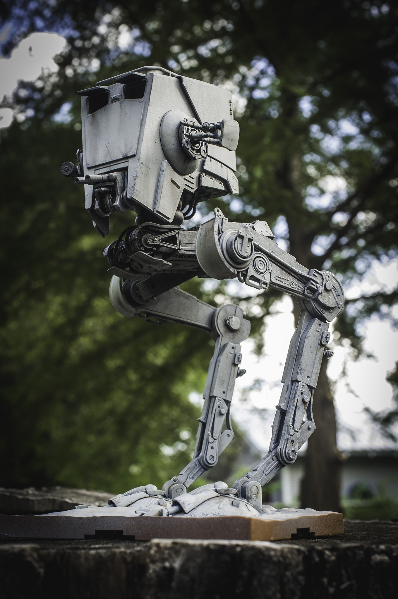

And finally, the gray base coat. I created a light gray from the Aztec black and white, and then added just a couple of drops of yellow to the mix to create a slightly warm gray. The effect of the marbling under the base coat creates a very subtle, but nice color variation to the gray -- I boosted the contrast quite a bit in the below image for clarity. The actual in-person effect is very, very subtle.
I feel like this will give a great real-world worn effect when combined with the rest of the weathering.
And here we are with a light gloss coat in prep for weathering...

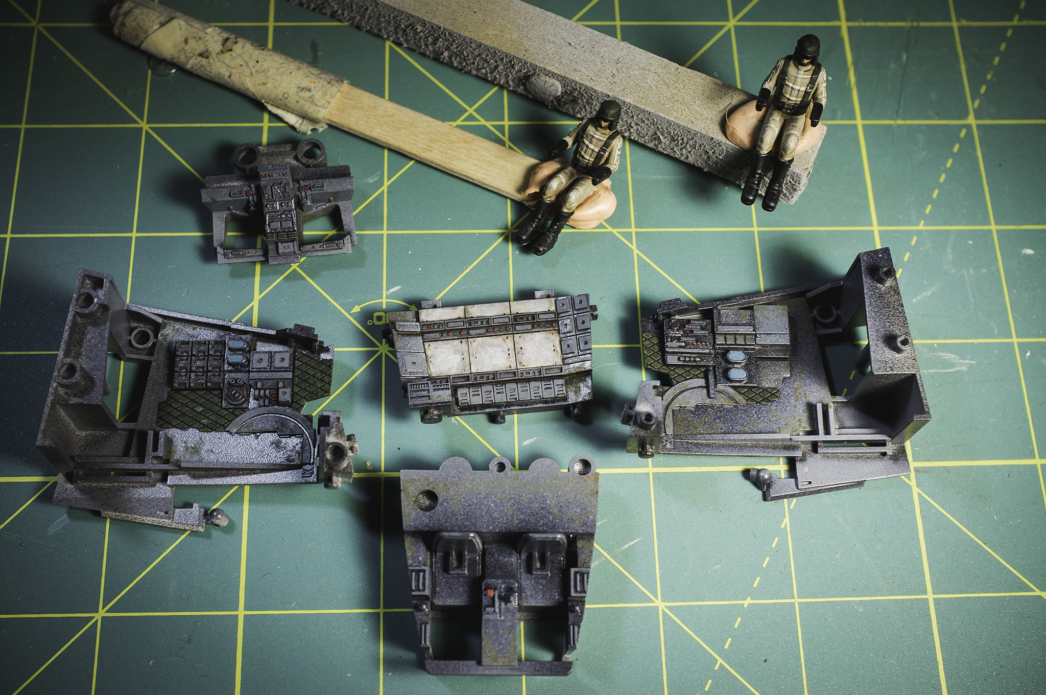

First up, a test fit of the cockpit. As with my experience with the Snowspeeder, so far everything was fitting flawlessly.
As those of you who have built this know, the cockpit really won't be visible at all once the model is complete. Even so, I couldn't help myself with painting it up -- if for no other reason than the practice. I looked up a few images of what the cockpit looks like... and then just decided to have fun with it.
And assembled...

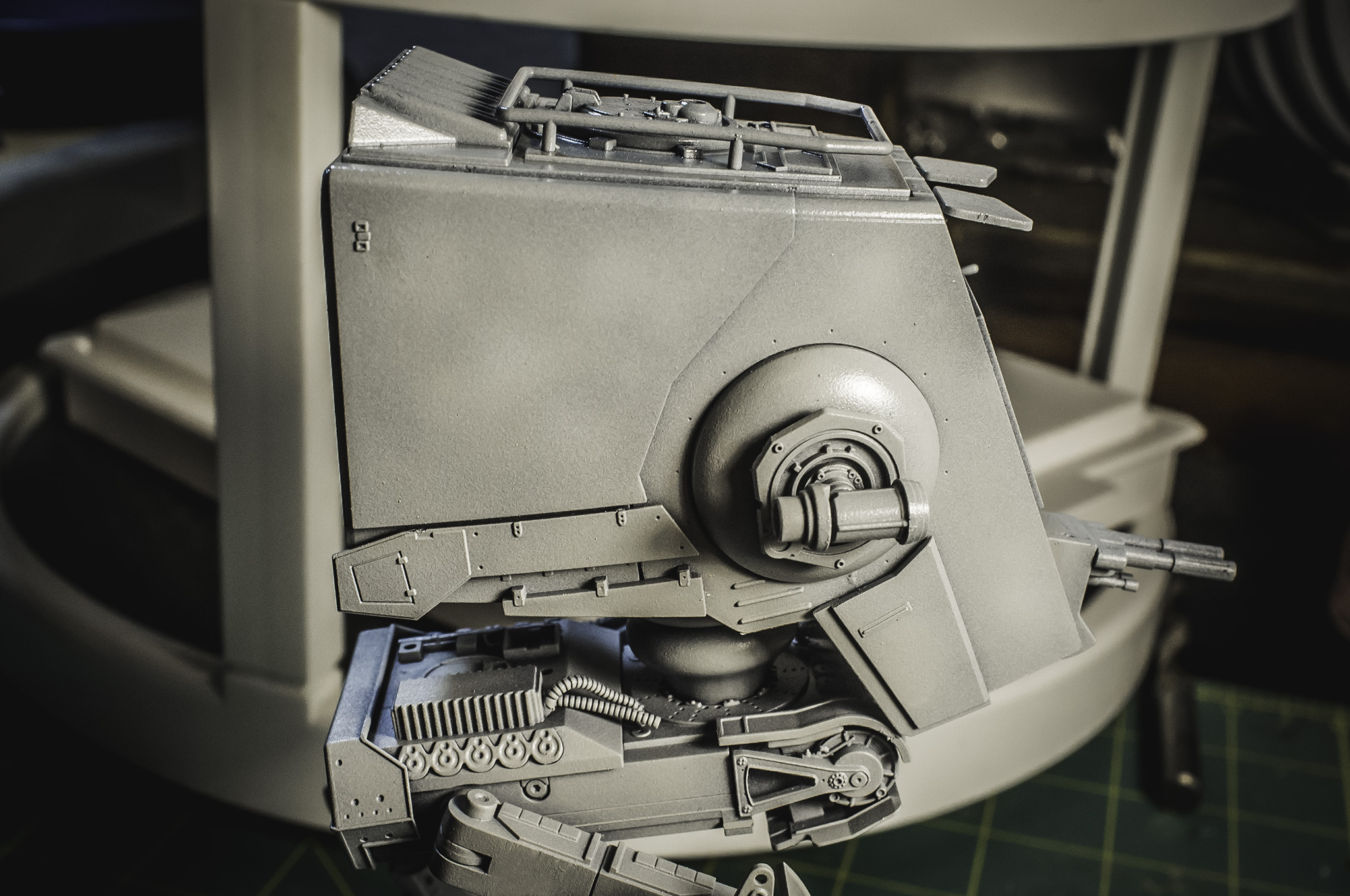

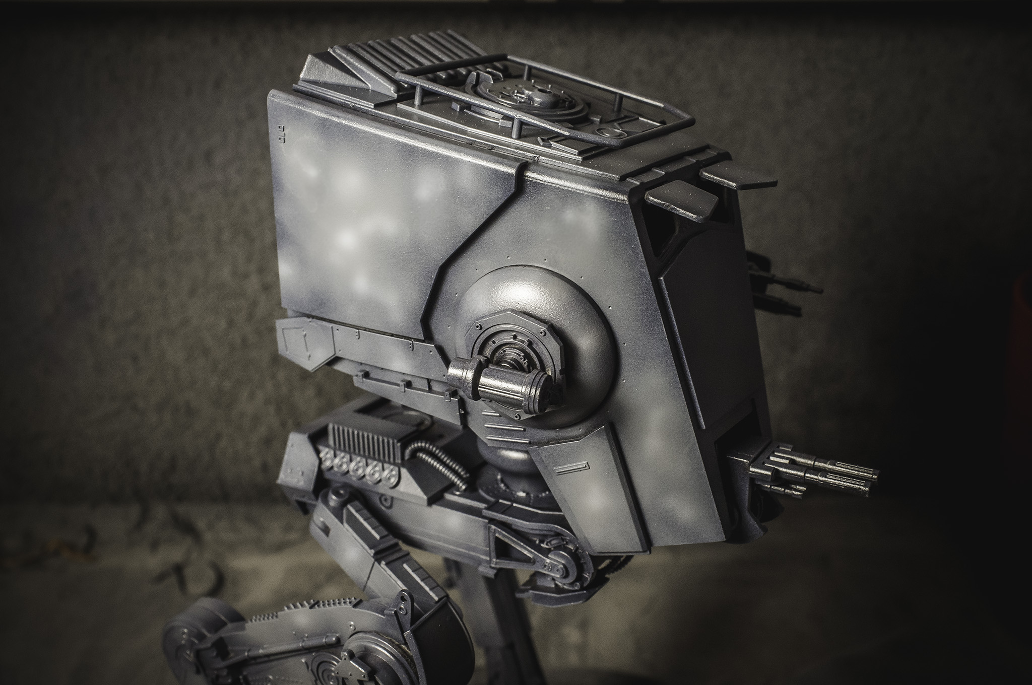

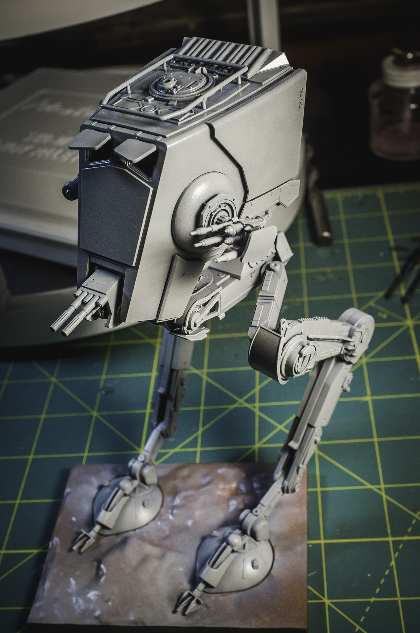

And now for the marbling... I did this in several thin layers, starting off with a mix of black and white, and then progressively adding more white to create the brighter highlight areas. Also, I intentionally wasn't super careful with my spray technique here, in some cases letting the paint spatter, which I was hoping would look like a water stains when the gray coat went on top...
