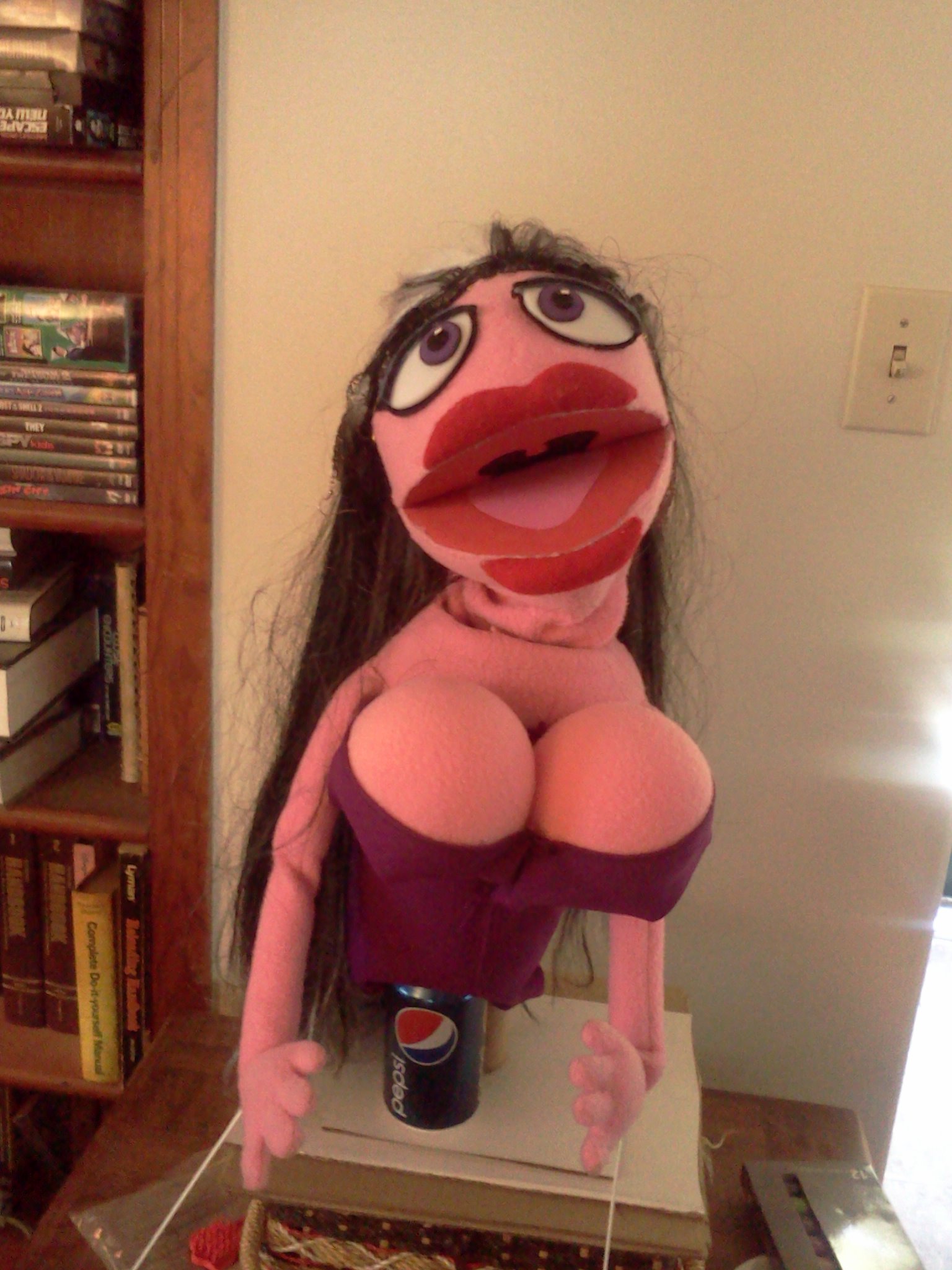

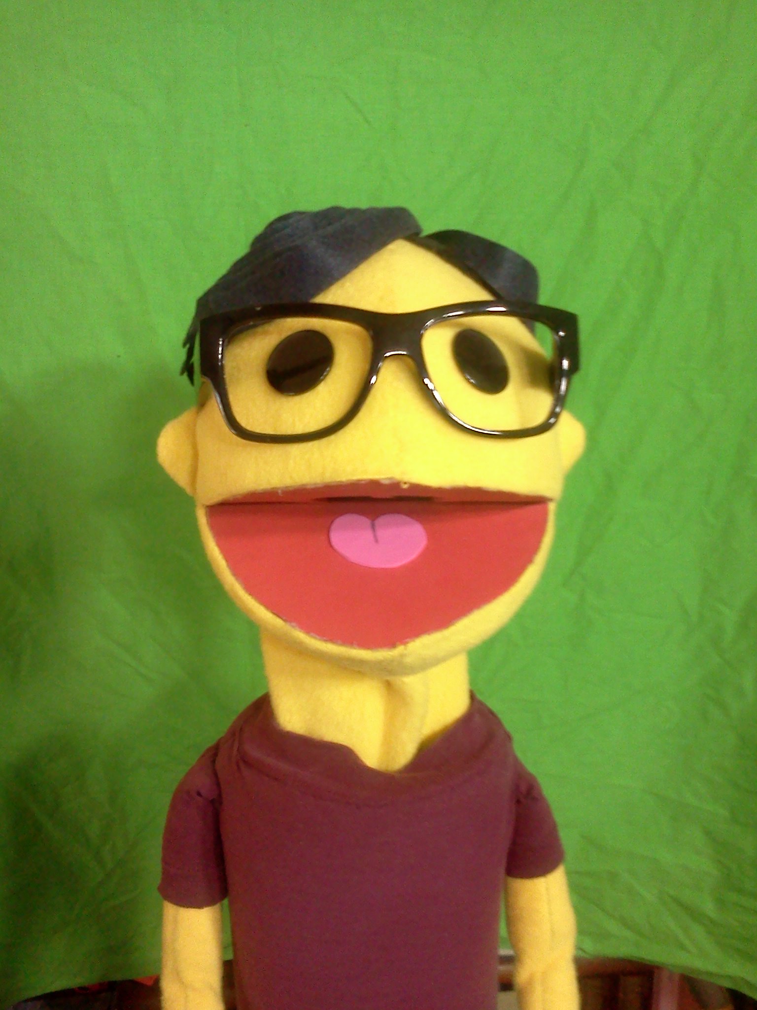

And here's a couple of my puppets, Roger and Lola...
