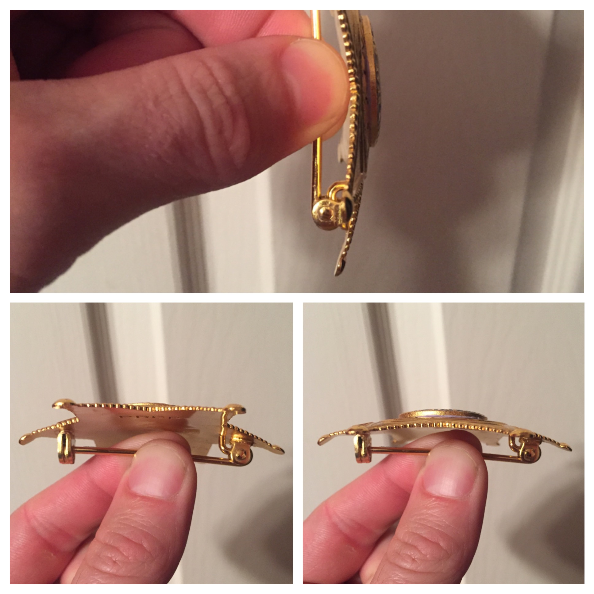

I'm in the process of making a silicone mold but the object is tricky. I'm trying to mold a badge and its curved. It seems like the silicone would just run underneath the voids so I'm thinking I may have to clay up the void spots. Does anyone else have an insight on this? Maybe something I'm missing? Thanks!

It's a star styled badge so the curve is really aggressive. Thanks for the reply!

Sure can! I tried making a mold but it was too rough and uneven angles that it ran resin everywhere. I plan on giving it another shot. Here are a few pics
